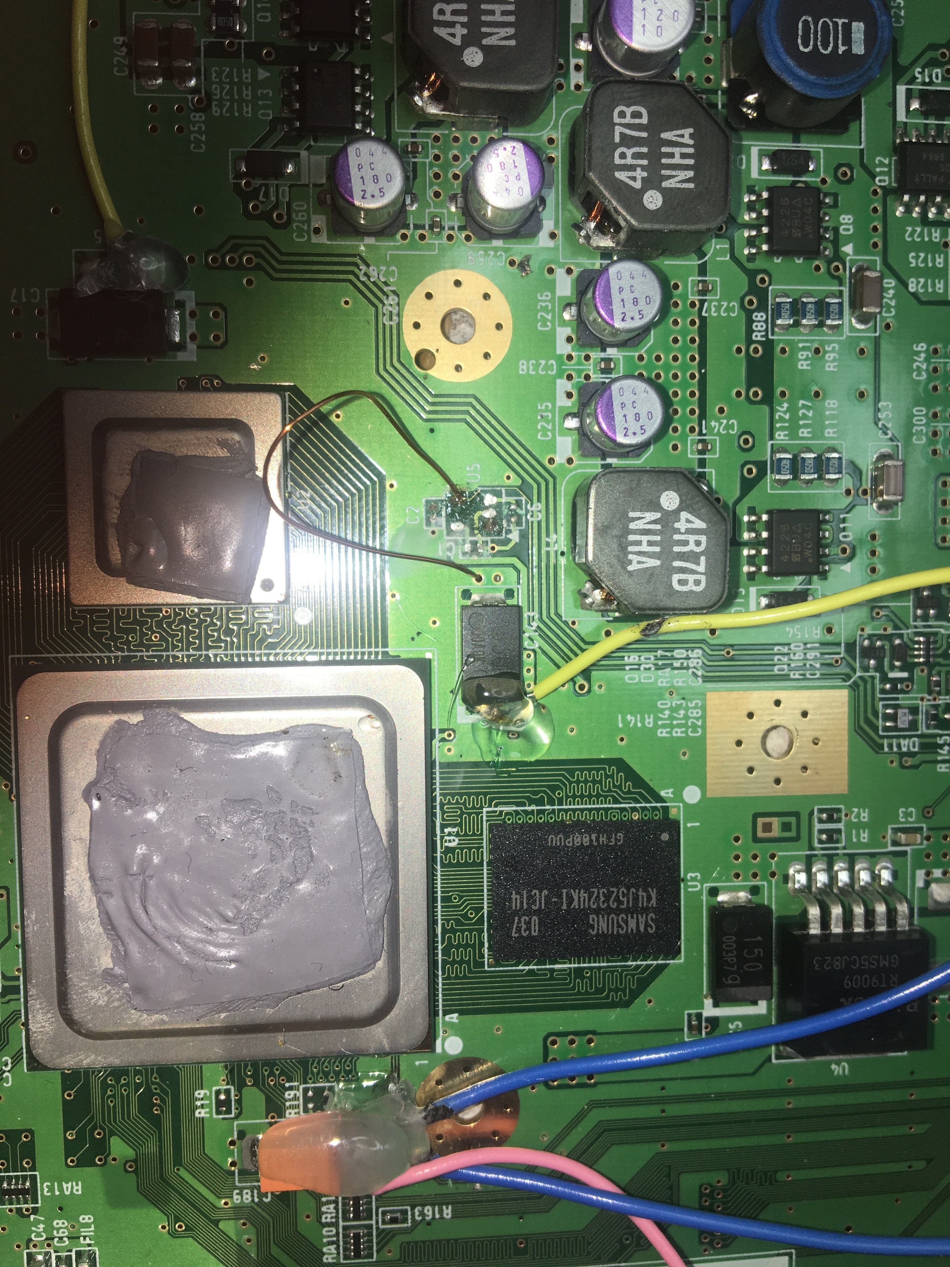

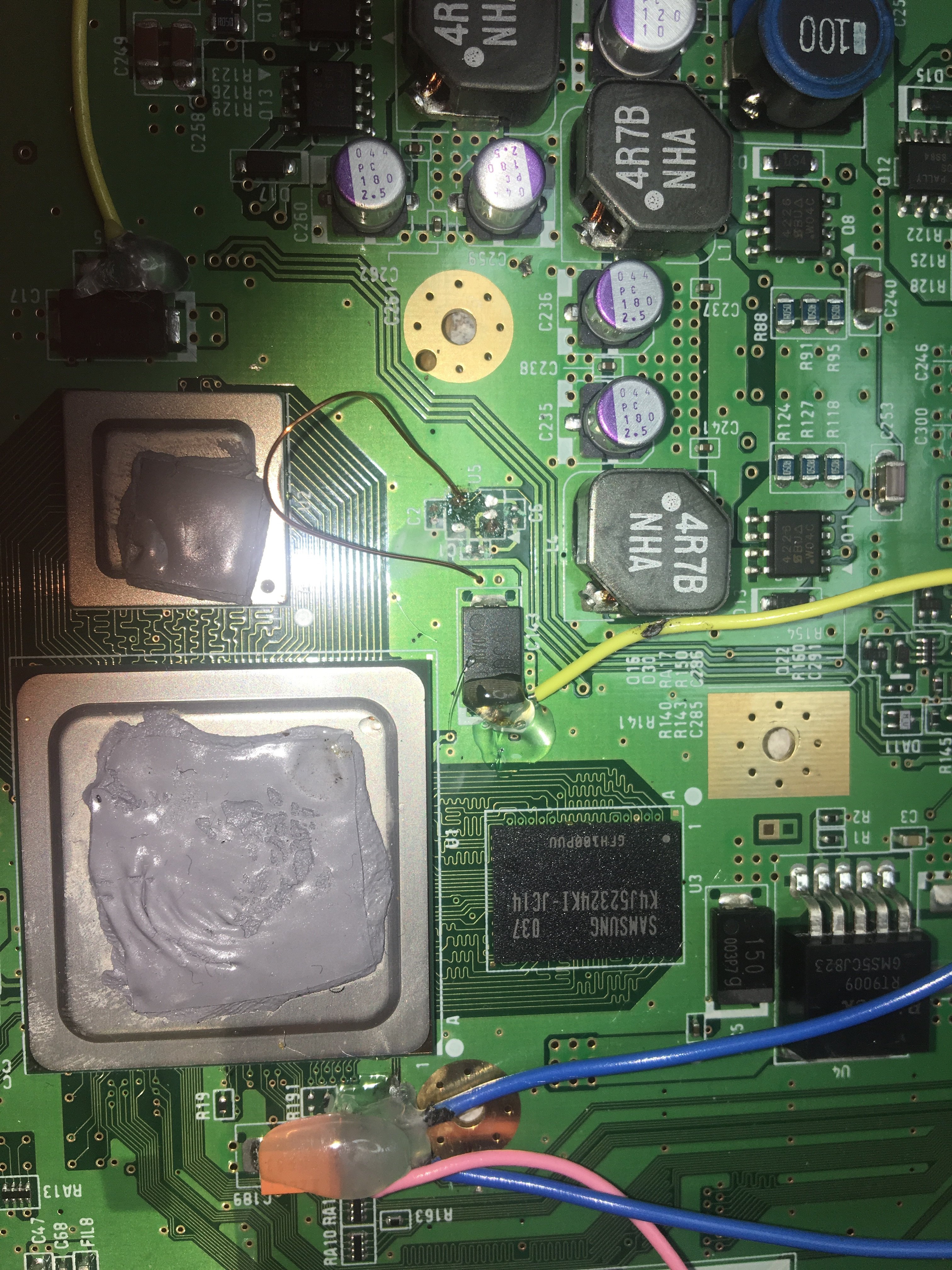

Okay, so i was trying to relocate the U10 and i think i really messed it up...
Anyone know how to fix it?
I destroyed the pad where i am supposed to add the wire and i also destroyed some other pad, but this is messed up in the guide as well so i dont think it is a problem. But that one pad... also, how can i remove the U10 without killing it?
If you clean the area, you can find and scratch the trace that runs to the pad and solder a short wire from the U10 to that.
As for not destroying it, a good iron, some flux and a desoldering braid are handy. A good set of de-magged tweezers help too.
Okay, I'll try that after I get a new iron and will finish bluetooth first then.
I actually did the exact same thing on my board, the pad in the opposite corner of the wire pad isn't needed. As for the pad that would have the wire, I would suggest doing what I did, lift that pin on the u10 and solder to that. It seems there is something underneath there that makes it not work right...
As for removing the u10 I just cover it with solder until it just lifts off with the iron and then flick it on my desk :P The u10 can survive quite a bit of heat, I've never destroyed one doing it this way

You put a blob of solder on the 3 pins on the one side and a blob of solder on the 2 pins on the other. Then you heat both sides repeatedly while pushing with tweezers so the solder stays liquid and it can be easily removed. Here's a good and affordable soldering iron.

A larger tip would be fine, also you don't have to bother putting two blobs, I always just have one big blob that covers the whole chip :P

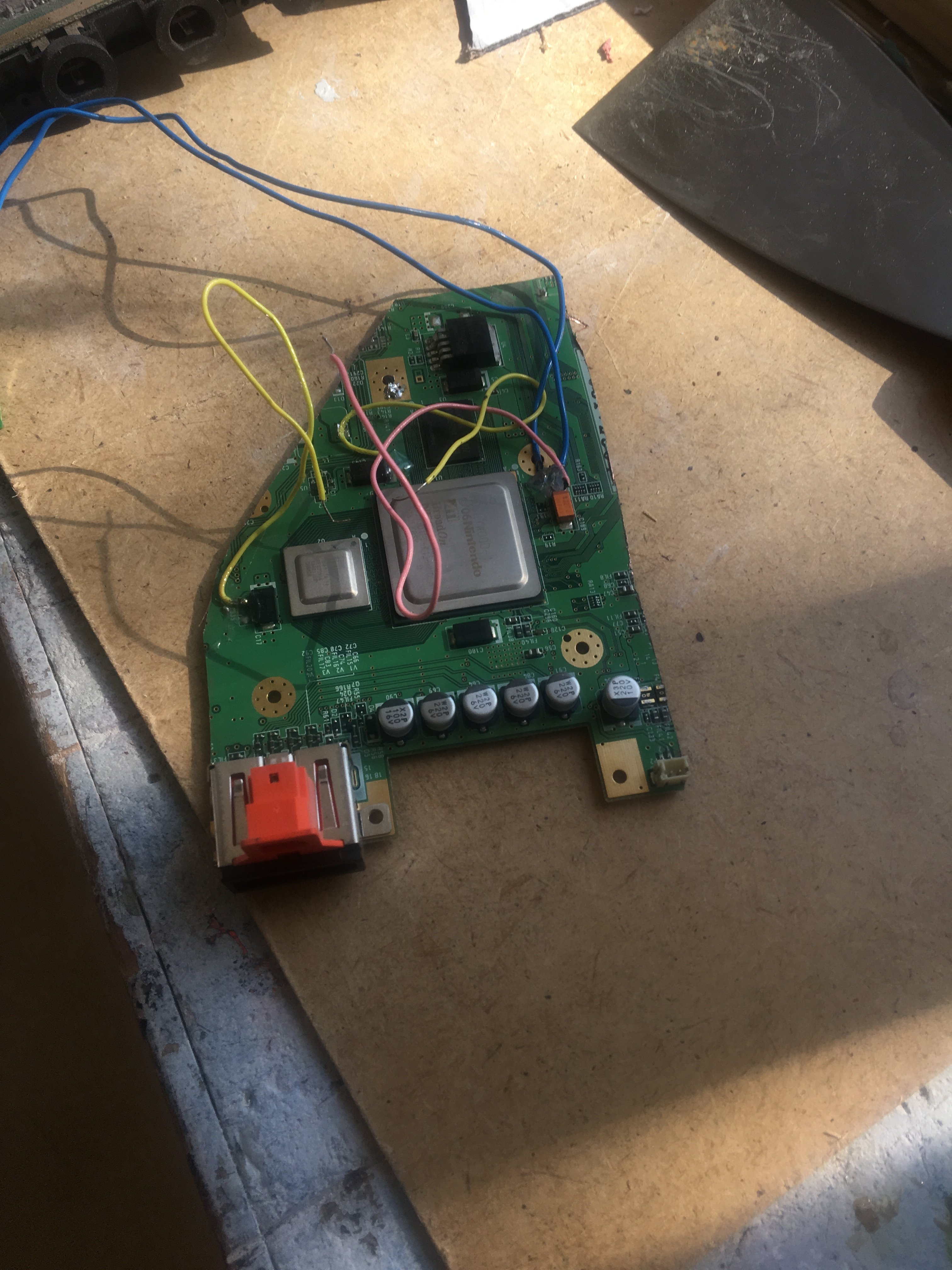

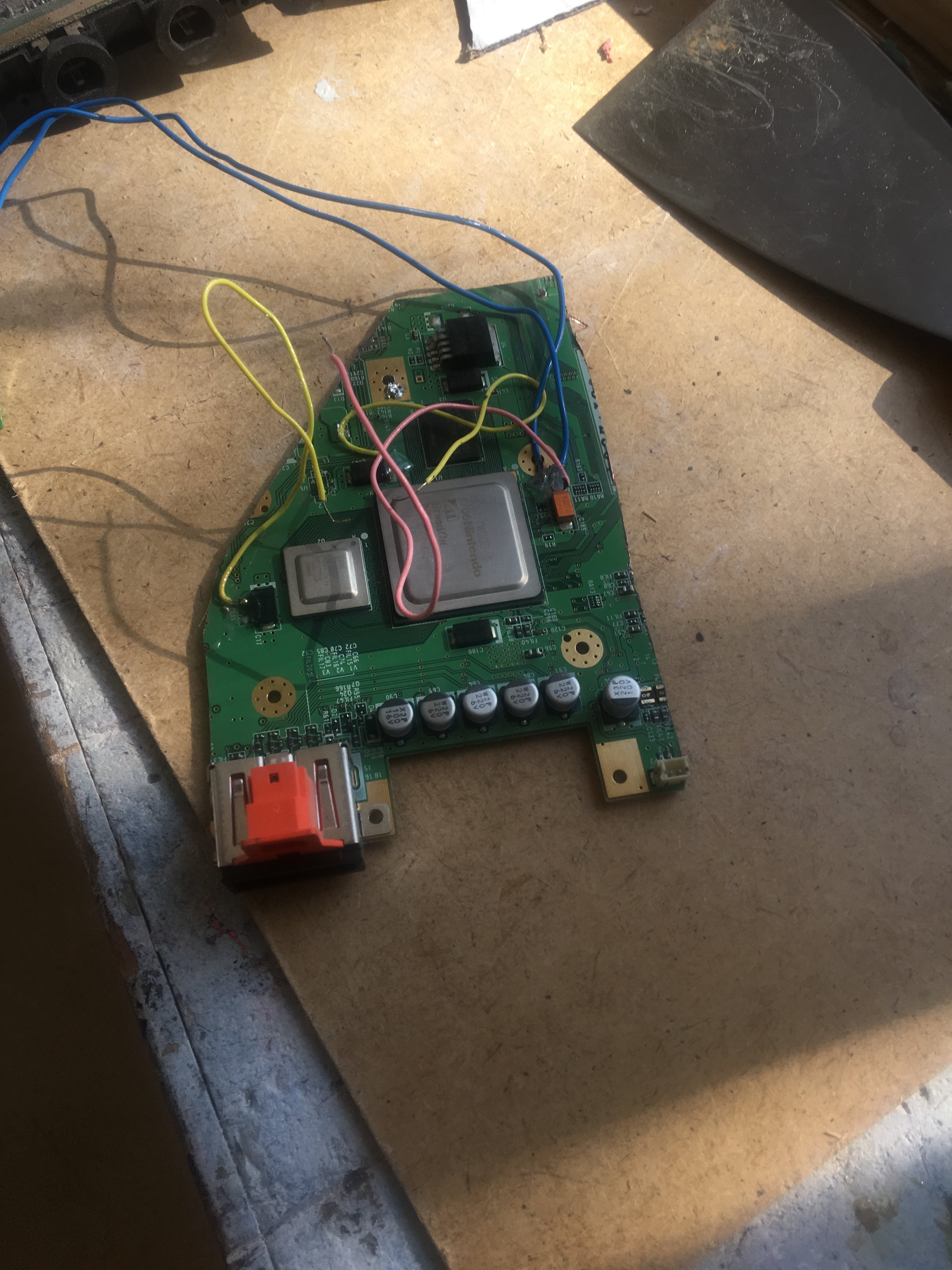

Okay, I just removed all of the onboard regs and hooked my wii up to 3 bench power supplies. I don't know how its possible its working, but it is so im happy with it. I then trimmed my motherboard, and now I'll have to sand for an eternity. Whatever, everything for a working Wii portable. I also just ordered the L7009, and it will replace the 480x234 display I'm currently using. I also trimmed around 5mm around the red line to be safe.
Pics of the trimmed motherboard:
Does it look like I can get this motherboard working, after I solder the U10 on?
Definitely sand it good, especially the area above the NAND, you can see copper pieces on there.

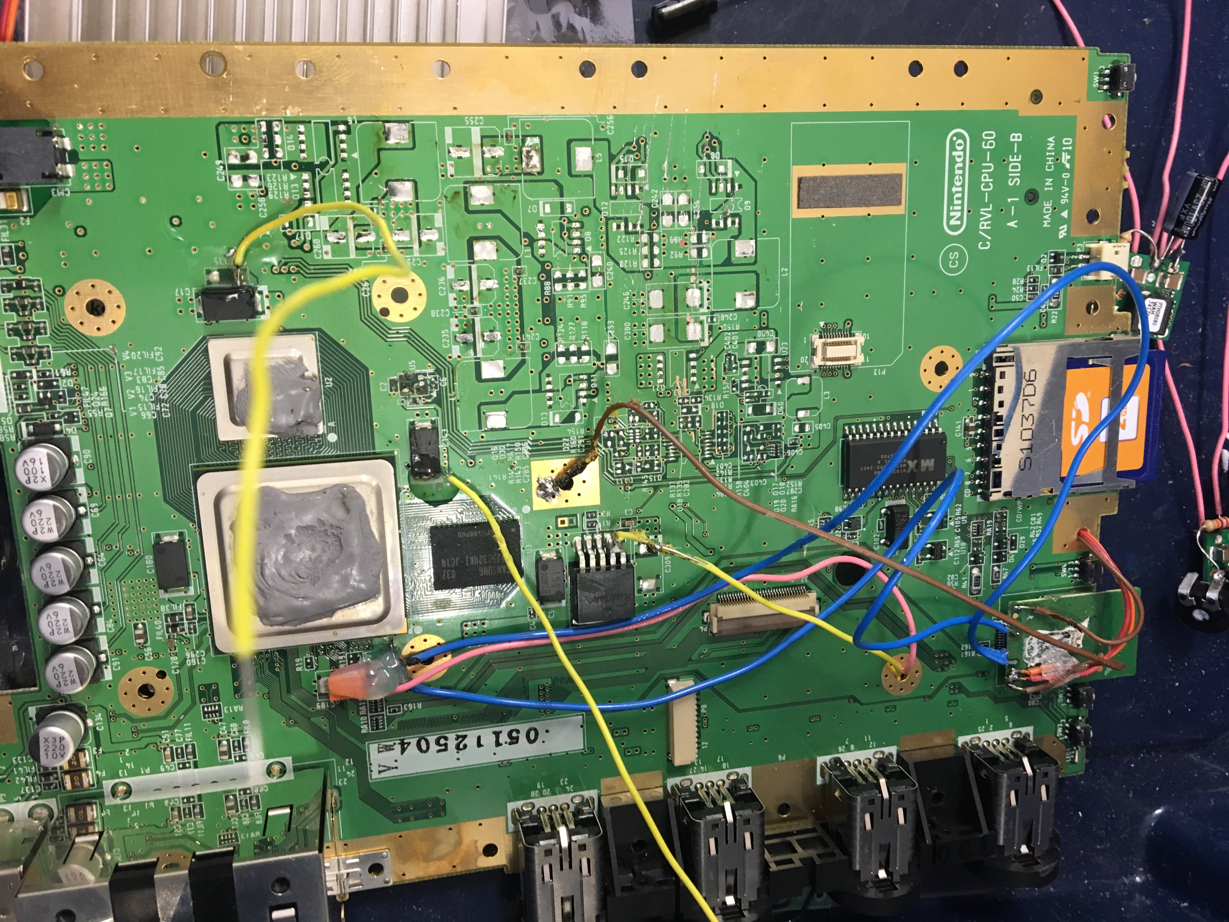

Okay so after ~ 5 Wii motherboards (and fucking up everytime trying to solder a wire to the "U10 via") i just gave up on trimming a Wii. It is the most important part of my Portable so i had a question. Can a mod move this thread back to the Wii worklogs so I can finish this build later? When I get a new soldering iron and am able to have practiced some via wiring on old Wii motherboards, I might try to finish It and I really want to. For now I have another project that I want to submit and I hope you'll like that one. Its an Altoids Tin Pi Zero Portable NES Classic Mini clone based on a Raspberry Pi 2.
