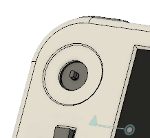

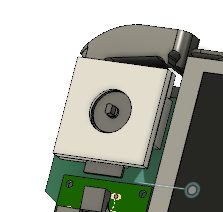

and I also found an easy fix for the 3ds slider guide. Basically there's a square shaped slot on the inside of the case. A modified version of Jeff's slider mount snaps into that. It looks pretty good imo.
He prints the slider part flat on the plate and then slots it in to where it should be, these kinda show what he's talking about

Ohhhhhhh that makes so much sense, okay in that case if my idea doesn't work (printing face side up with minimal support so that it doesn't get disfigured on the inside either) Then I'll be doing this next time, I appreciate the reply thank you.

I actually tried doing that at first as well, but it didn't end up nicely at all. I'd either go with switch sticks or with the separate parts like I used for this one as sanding the supports will be very hard. You could also go Shapeways or some form of SLA, but that's quite expensive.

Shoot, well the case is printing right now anyway and this spool is close to being out so I'll let it do it's thing, I'll post a picture of the finished product along with instructions on how I got it to look good (If it does) if not then I have some ideas on how to make it modular that I think could work, something inspired by what you did but slightly different since my case is not using 3ds sliders, I'm using ps2 ones and I'm making like a volcano shaped extrusion for it along with a g-wii like extrusion for the screen, I'll keep you guys updated because the shapeways and sla are too much hahahahahahaha
