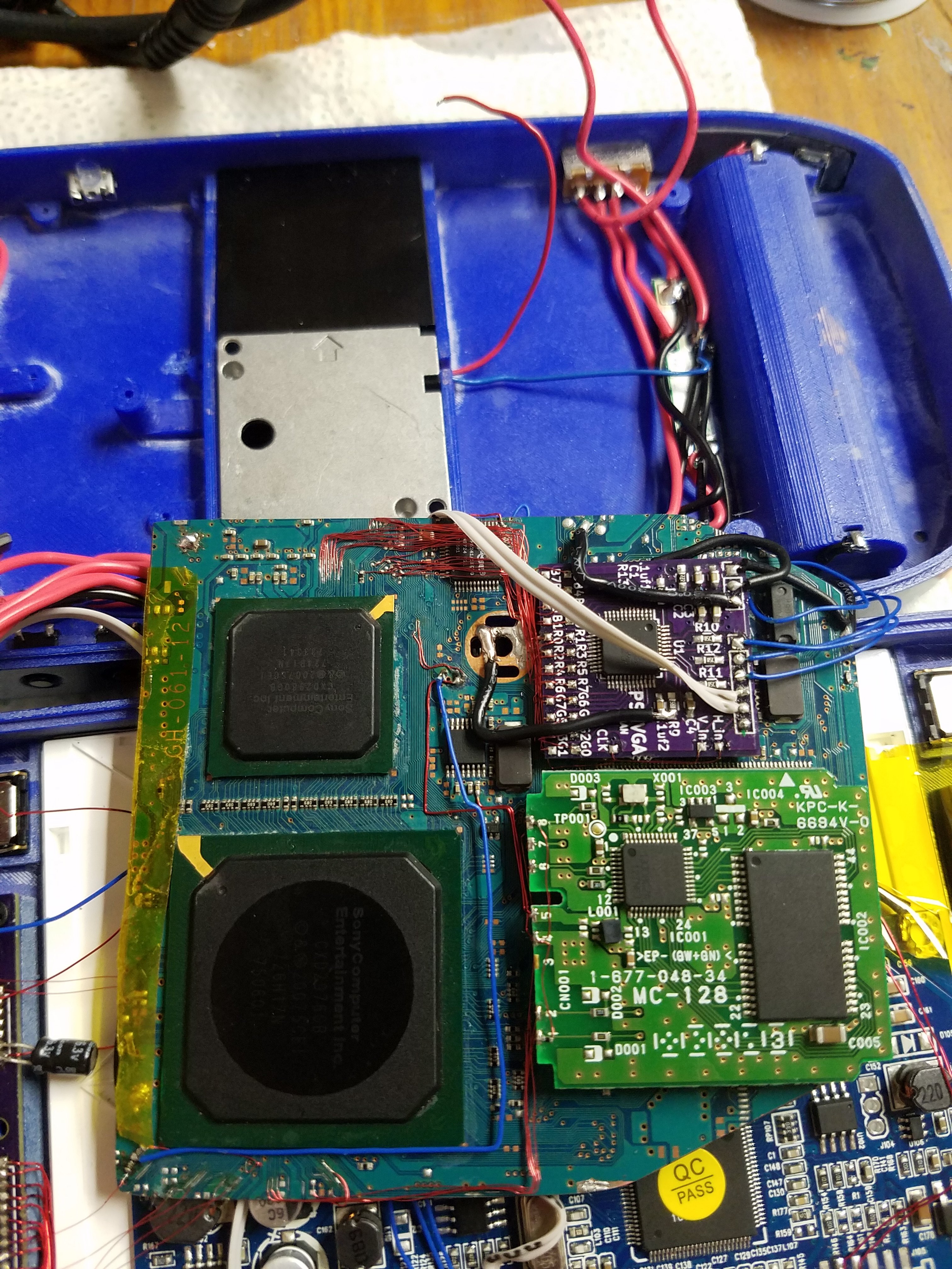

No, it's clearly unacceptable. It's not perfectly soldered or perfectly routed or anything like that.Please excuse the messy wiring
I know, let me chuck this in the garbage real quick.No, it's clearly unacceptable. It's not perfectly soldered or perfectly routed or anything like that.

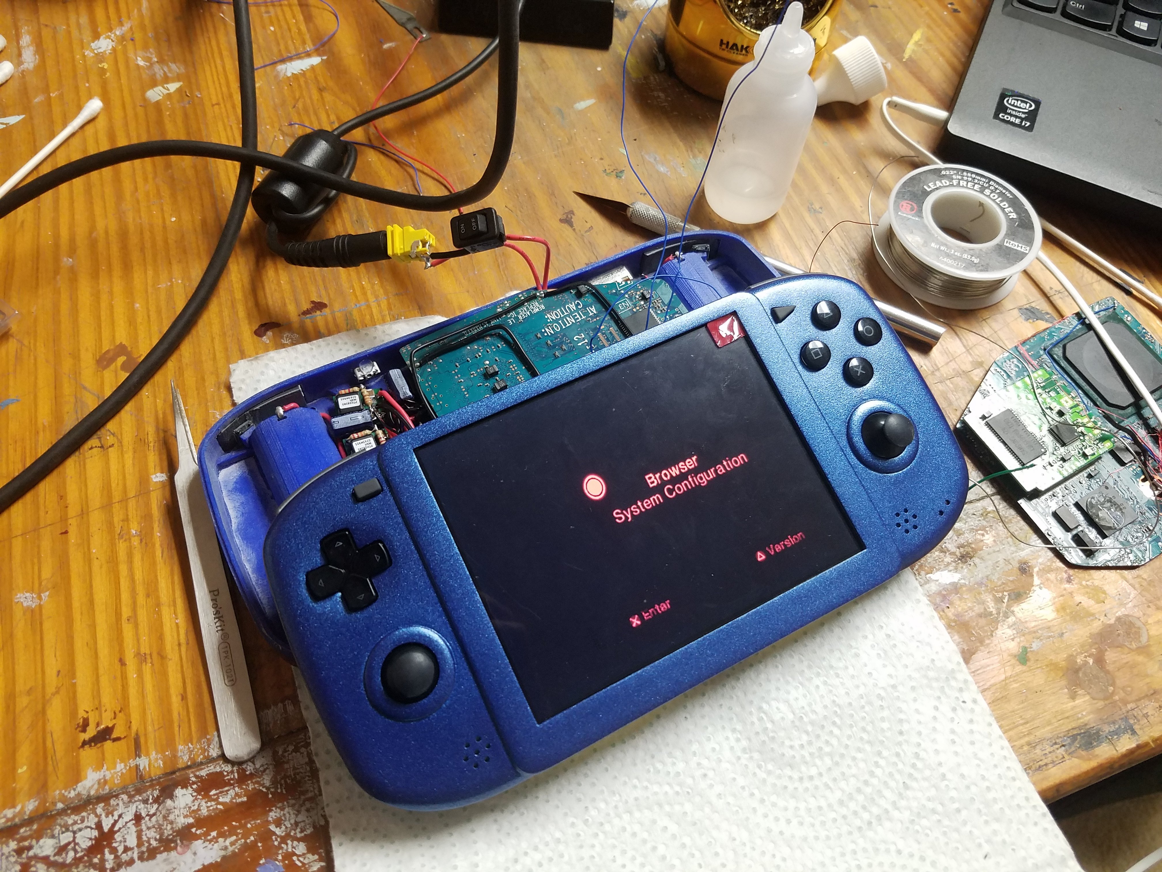

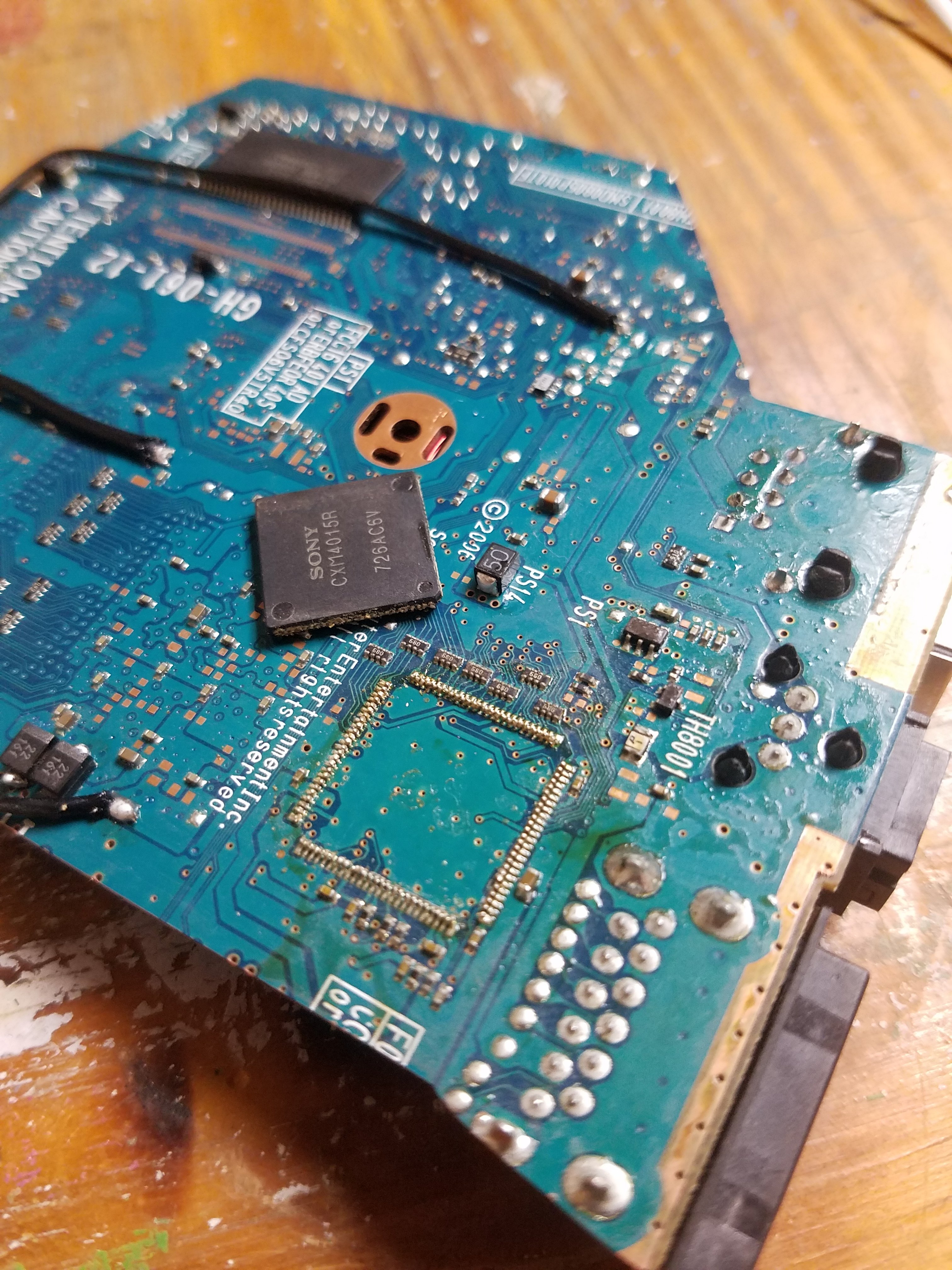

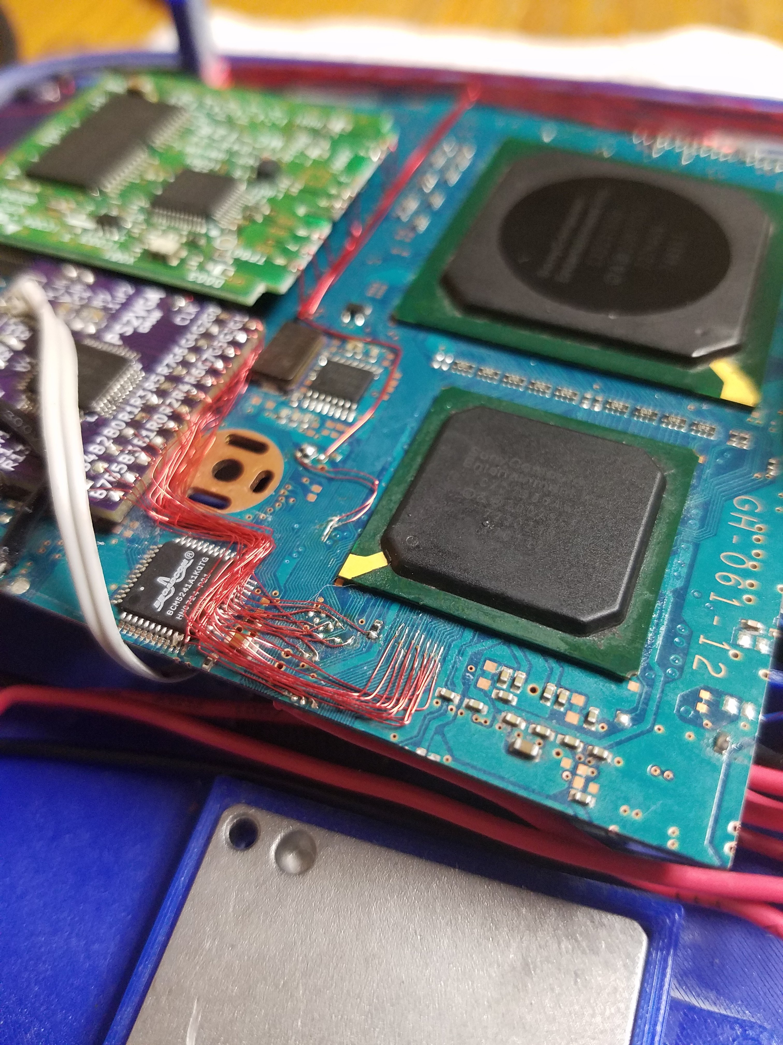

I hate doing this mod. Even with 20/20 vision assisted by reading glassses, I had a difficult time making out which trace I was soldering to.

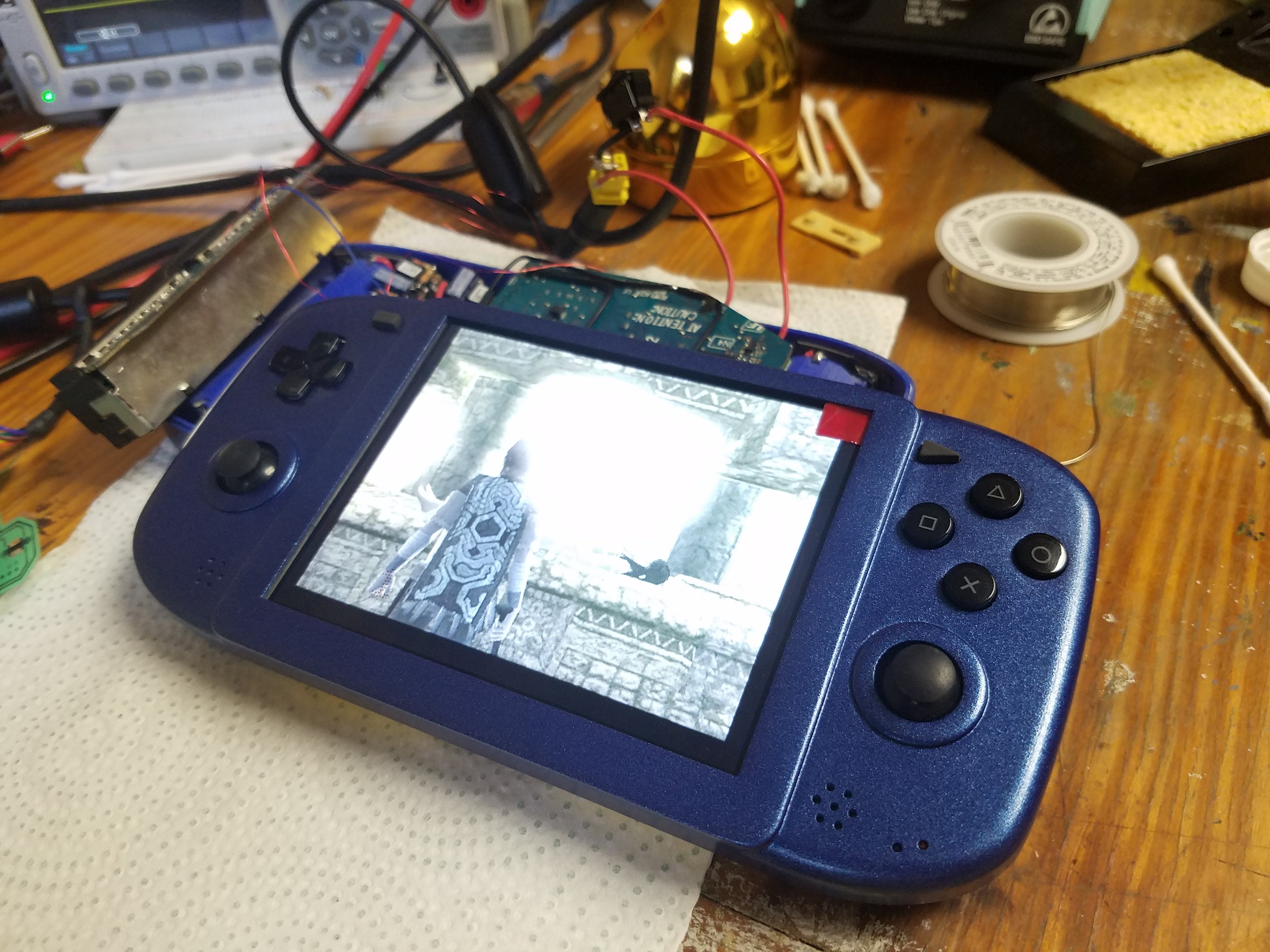

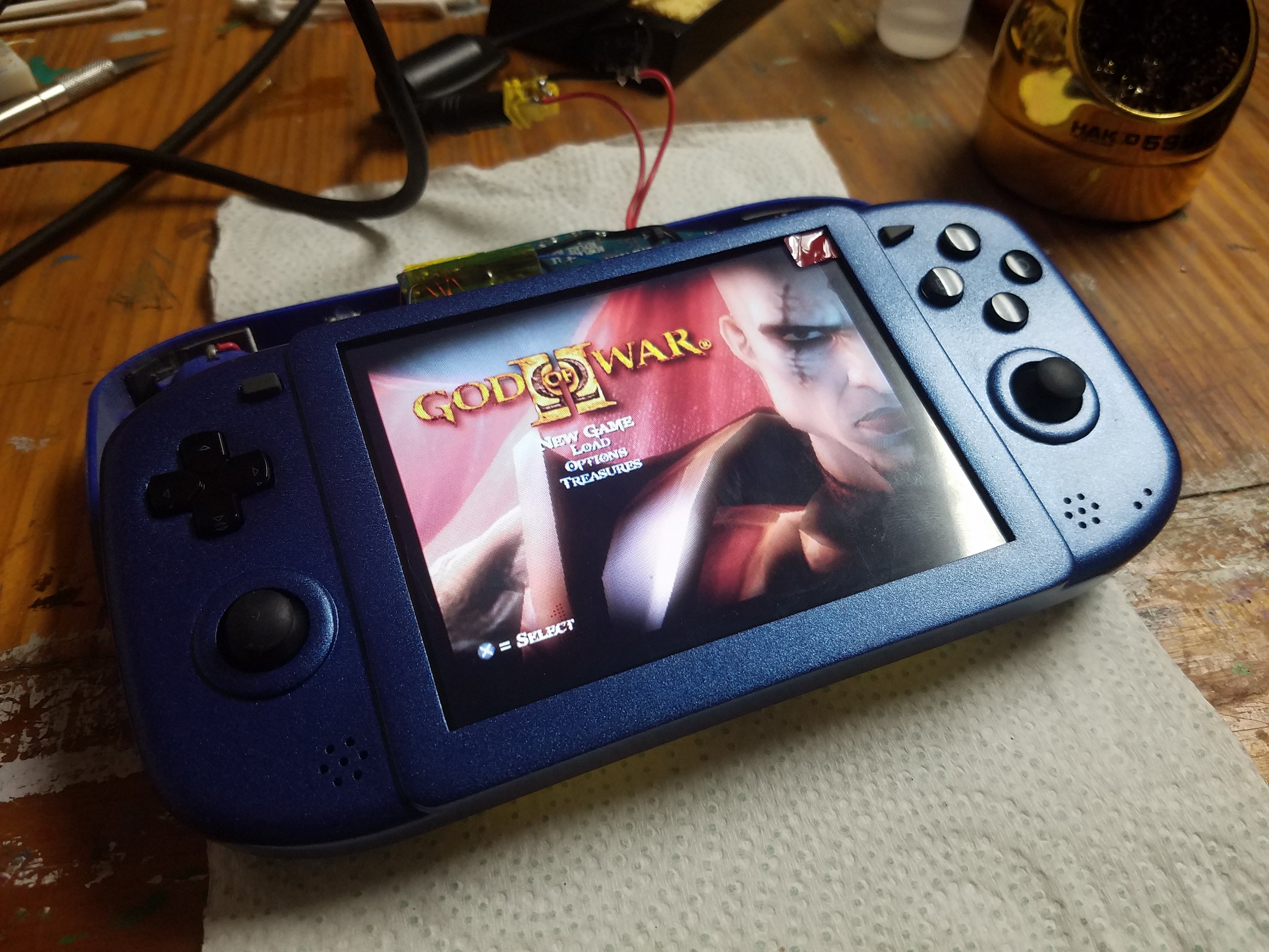

but looks quite challenging for me now..The modded ps2 draws around 4.65watts. In consideration with the efficiency and other portable components, I'd say with a 7.4v 3.4Ah battery, it probably evens out to around 3-4 hours.Nice work gman,
I was wondering how long the battery life is for the ps2 with only the 2 batteries.

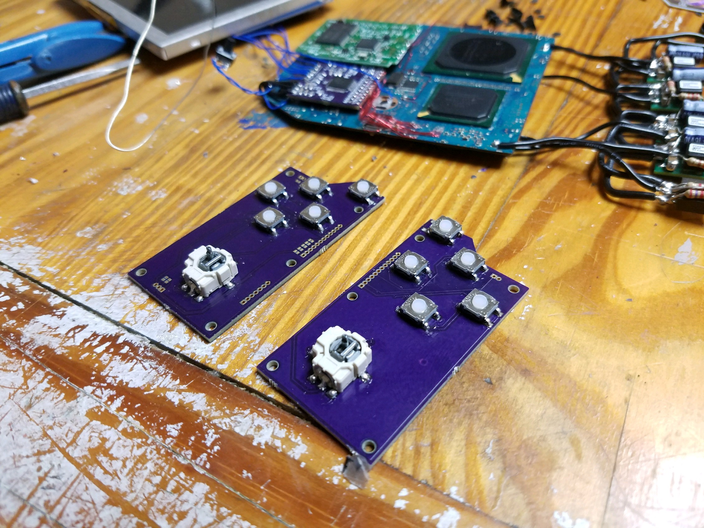

https://www.digikey.com/product-detail/en/cts-electrocomponents/254SA103B50B/254SA103B50B-ND/1755920Hi has someone got a link to the joysticks?
Thanks![]()
I'd like to know where you got those analog sticks ?My controller boards. I used these tact switches because they feel like a combination of squishy and tactile clicky while being shorter than the standard squishy buttons. There is an original PS2 controller IC on the back of the left board.
