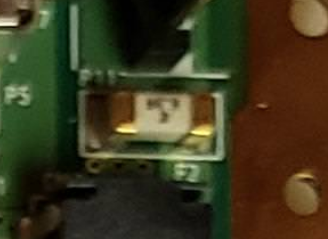

Heres a guess. This component labeled F2 by the power jack is a fuse. Check continuity across it. If it is not continuous, then the fuse is blown and needs to be replaced.

THANK YOU the fuse was blown the whole time thank you, just checked thank you to everyone that helped me
Question: where do i find this kind of fuse? Can you give me a link for this to buy, or can i just remove the fuse and just bridge the two contacts.
Thank you, but i think i have found a link to buy one, also will any 6.3a f2 type of fuse will work. I'll contact you if i can't buy the one from the link.
Nope never found a fuse but since i just wanted to power on the wii for an hour to just install portablizemii, so i just soldered the two pads, and it powered on. But be careful because if you apply more than 12v then the power circuit on the wii will fry.
