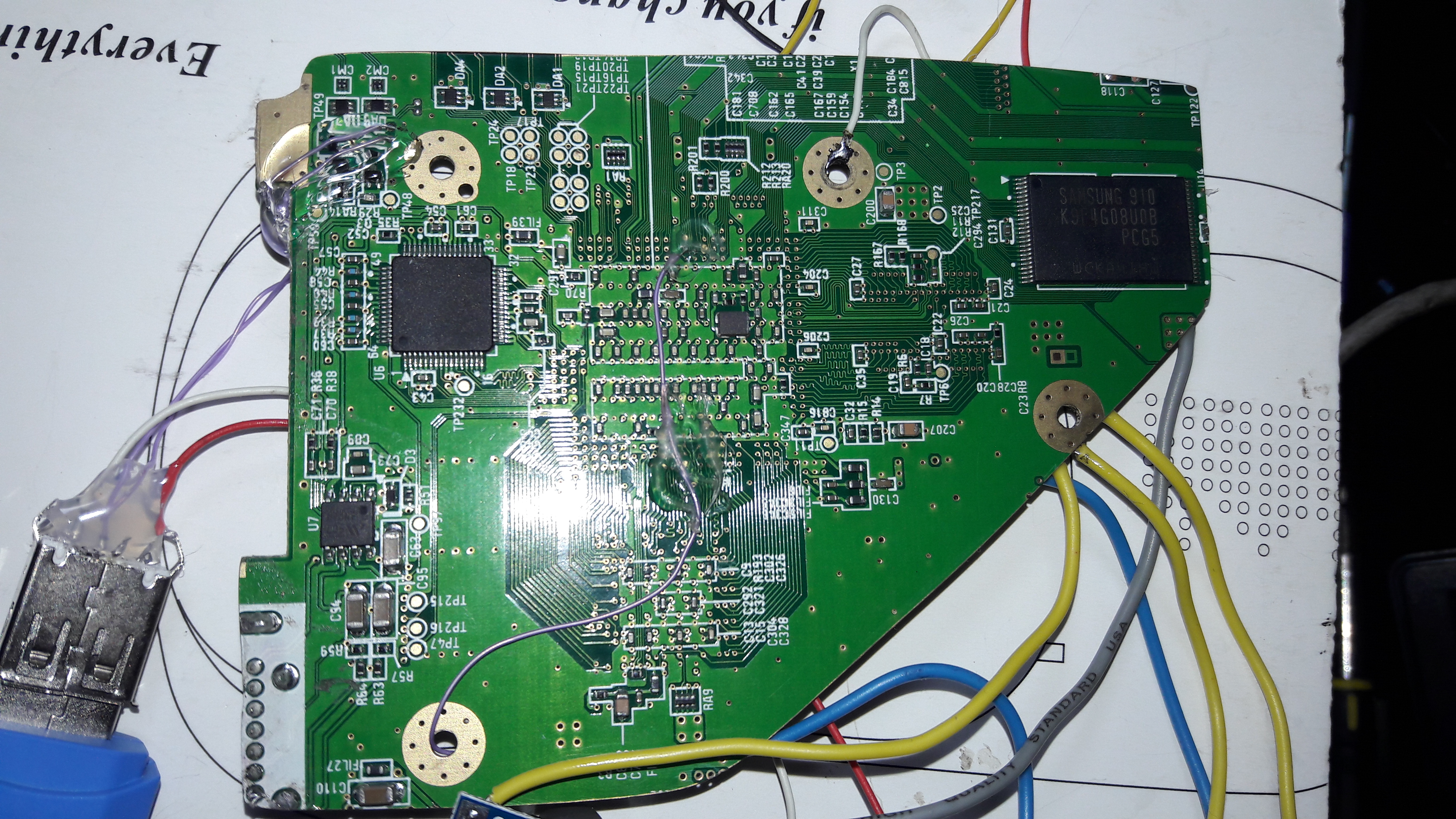

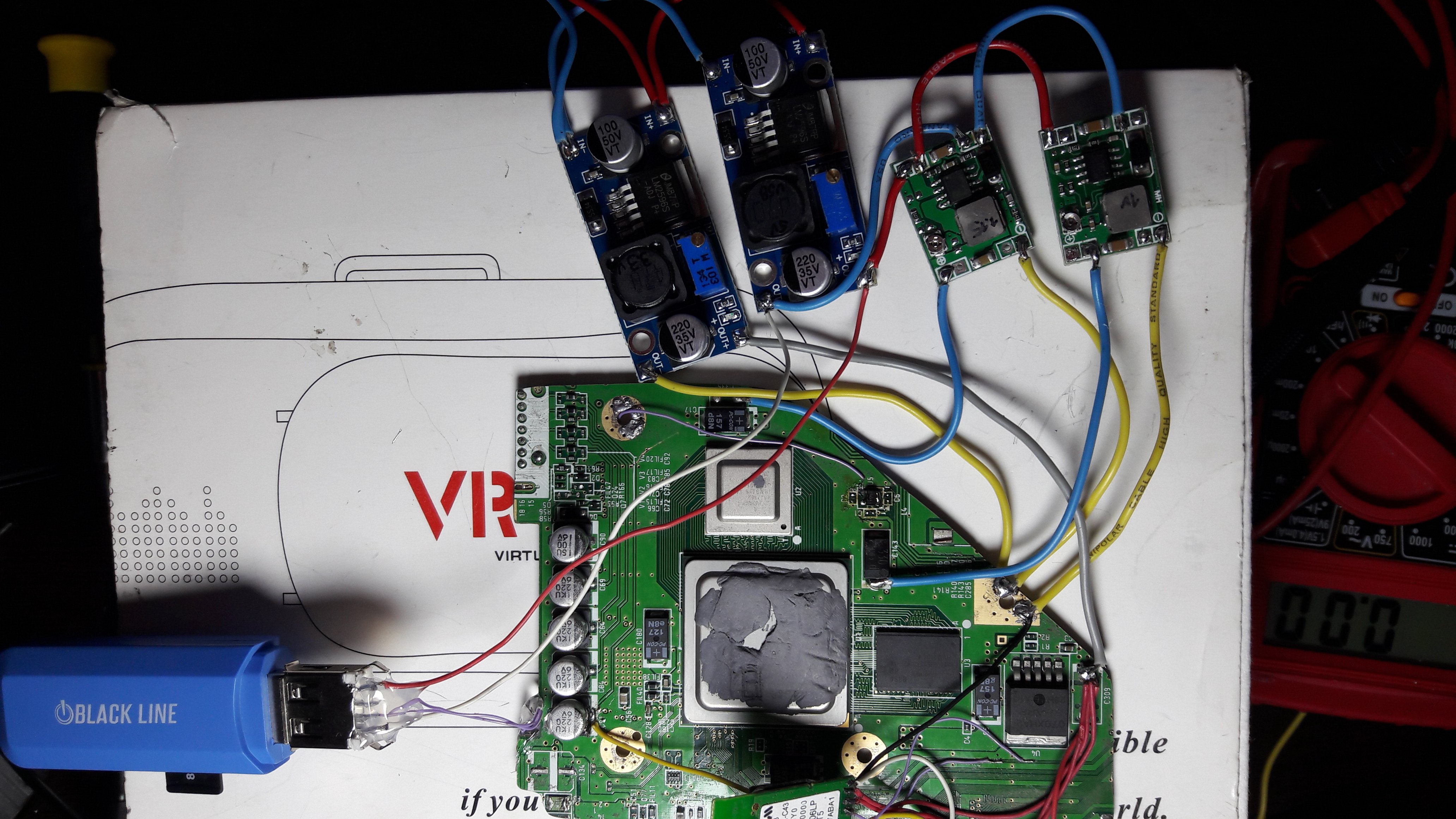

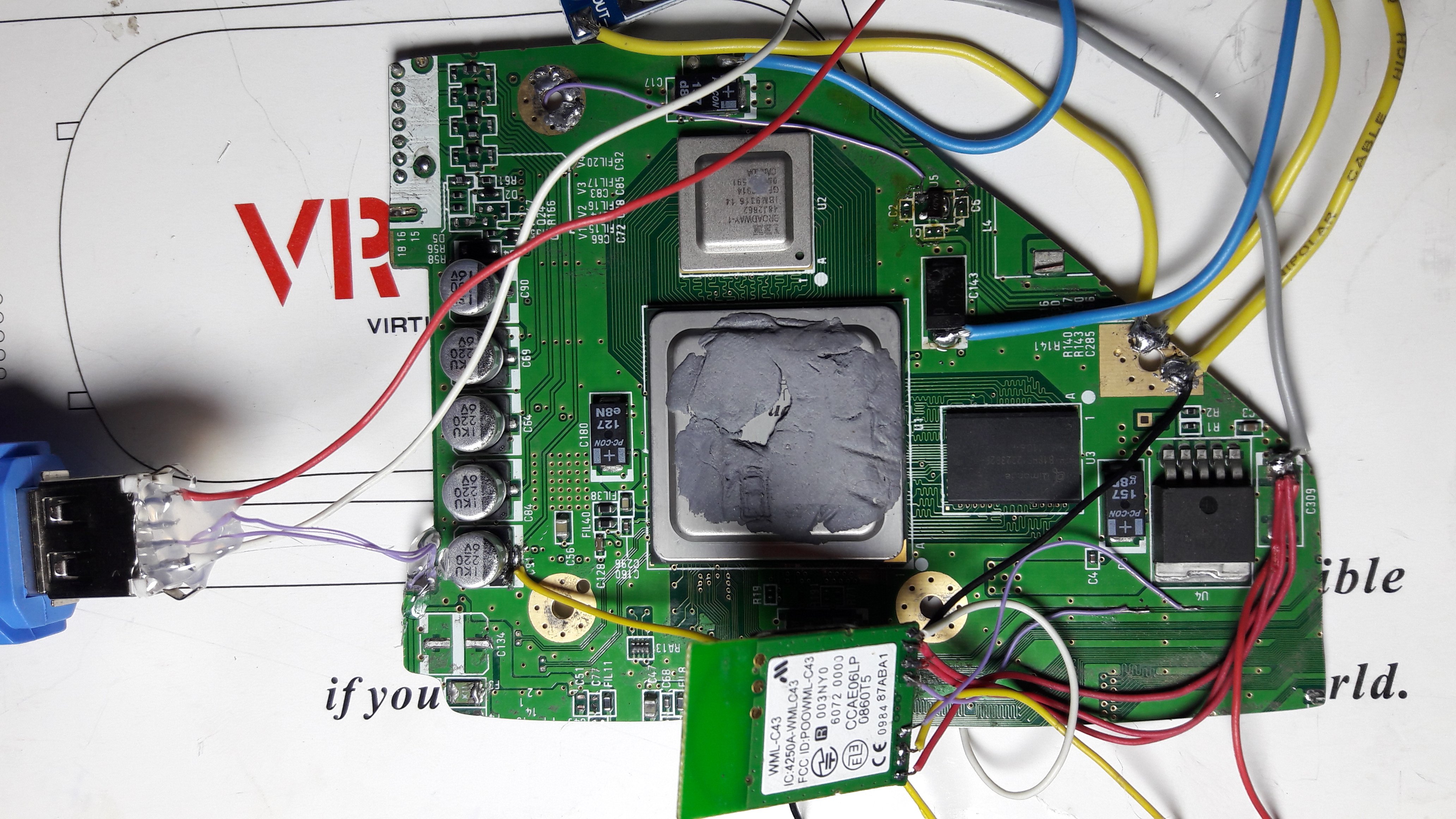

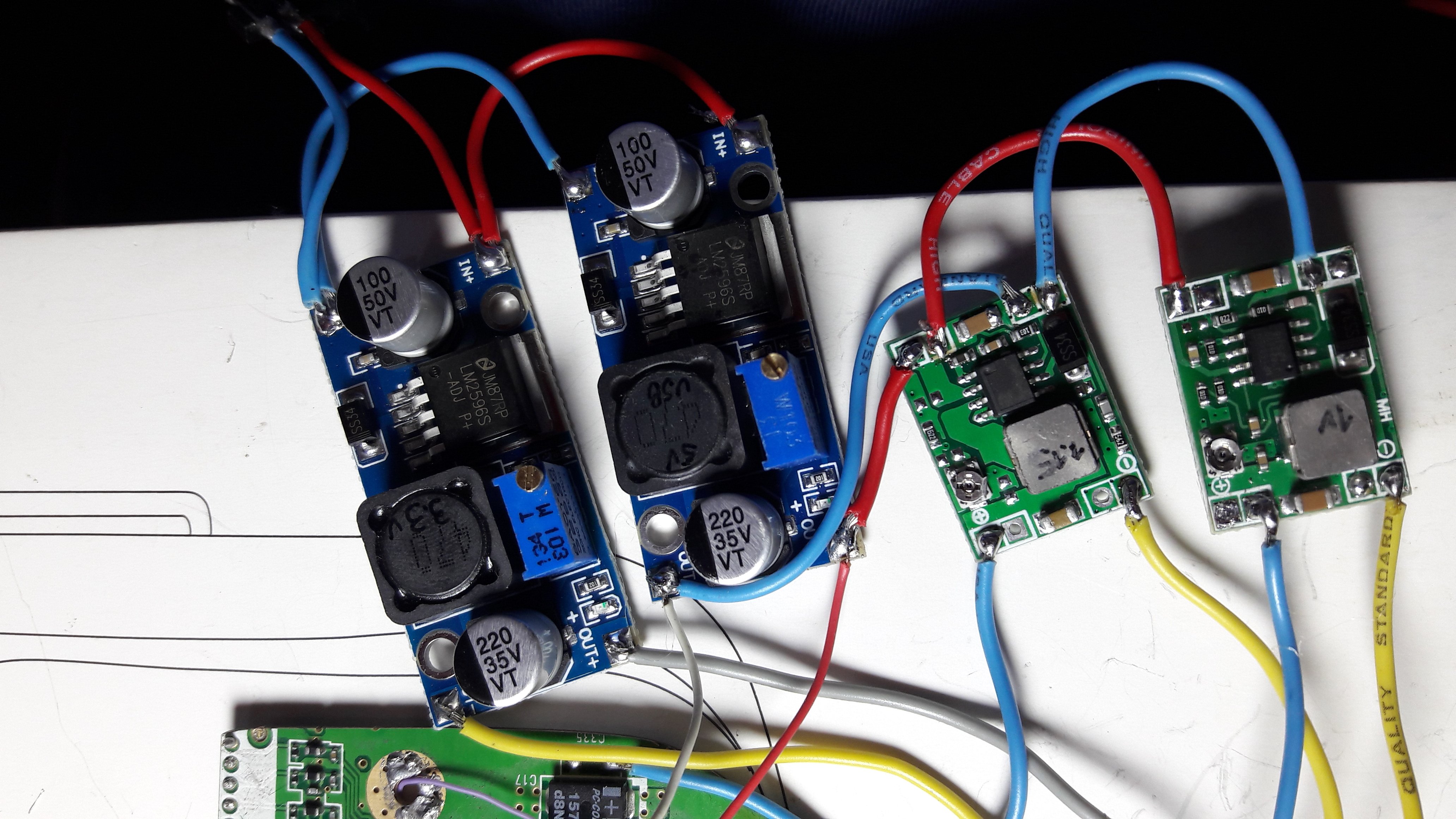

Just at a quick glance at your photos, I’d avoid those buck regulators. I’ve tried to use the blue ones from Alibaba and they really didn’t output stable voltages for the Wii to boot. Also, they get hot and will melt your case and just cause issues down the road, not to mention they are bulky af.

Alibaba is just a site to buy cheap electronics. If you want to do regs yourself, I'd suggest the PTH08080WAH as they will provide enough power without getting hot. Also, don't go from one regulator to another, as you will overload them

With those regulators, it is nearly impossible to turn on wii because of the high unstability, if the wii resitance is still good, change the reg to PTH08080, and try again

Sorry, but you have to use PTH08080 regulators or it will not work reliably. Don't look for them on Ali, you'll 100% get scammed. Order them from Mouser or Digikey, they're reputable sources. This page has more info on how to wire the regulators correctly.

It will not work with the regulators you are currently using, you have them wired incorrectly and they are not powerful or reliable enough. You need a PMS/PowerMii Lite from the BitBuilt Store or 4 PTH08080 regulators. They can be expensive, but the cheap options are doomed to fail. There's little point trying to troubleshoot until you have proper regulators, but if you're set on trying, you need to first fix your wiring. Currently you have some regulators running off the output from another regulator, you need to undo that. The regulator inputs need to all be connected to your battery setup in a line, and all the outputs connected only to the Wii. Do that and perhaps it might work, but no promises.

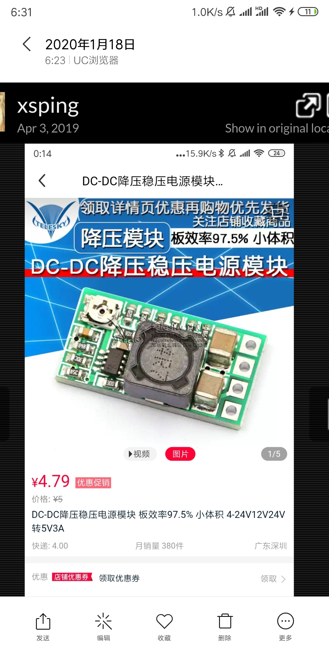

if you really want to try cheap tiny regulator,i recommended to try this one, it can be easily ordered from alibaba or taobao for almost half dollar one each and you can easily got 3.3v and 5v from this regulator ,for 1.15v and 1v, change the resistor on the regulator,don not use adjustable resistor on its own, they work fine on my 6 layer trimmed wii for nearly one year even though it may be not effient on power consumption, i think it will be ok
No, do not do this. They're fire hazards and we do not support their usage.
