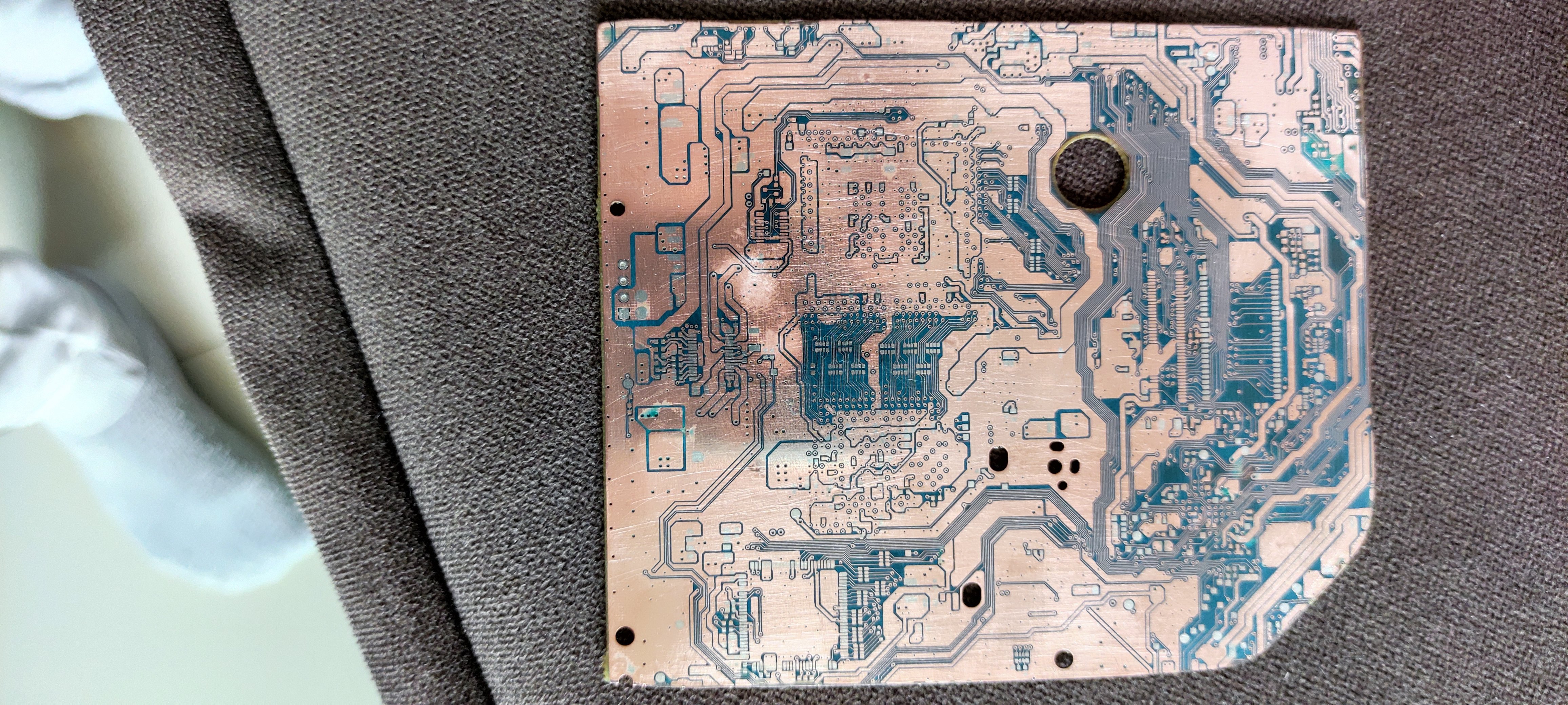

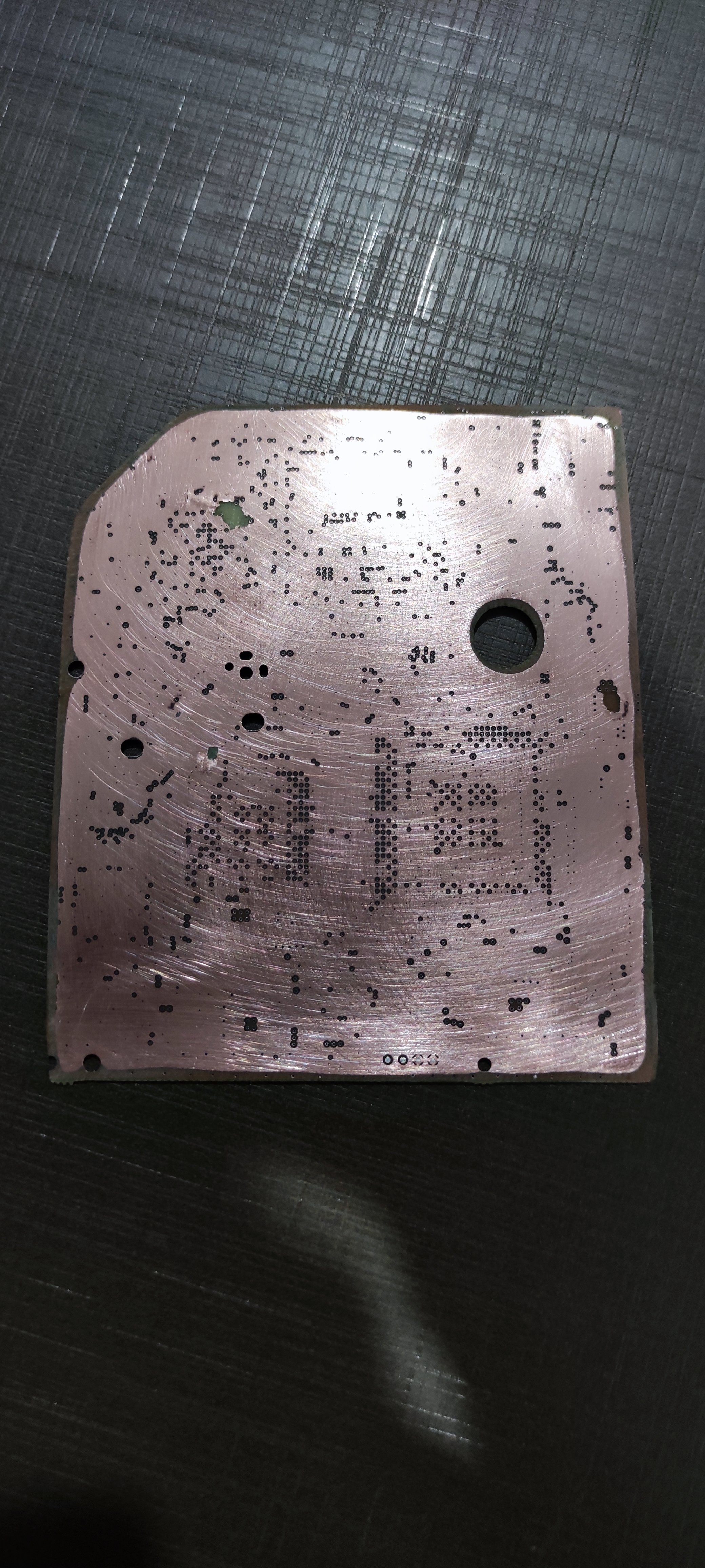

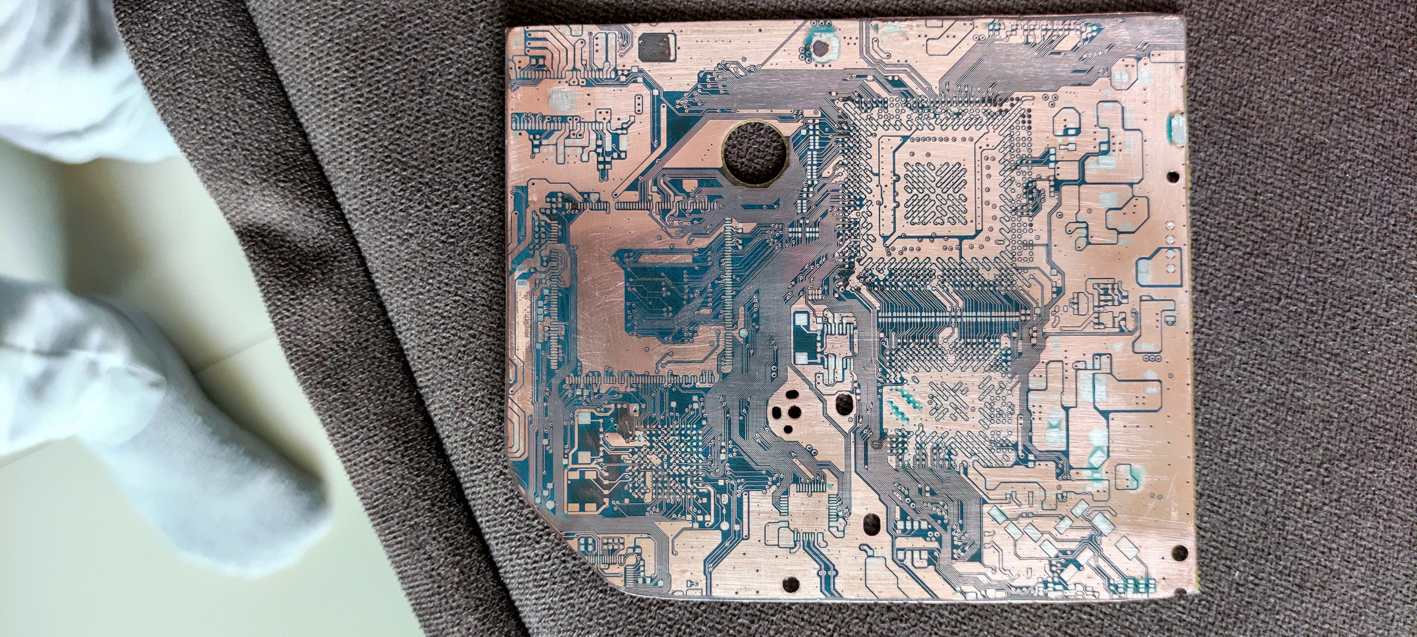

Man you're gonna have to make your own compendium for the 9000x version!! How are your hands BTW? When I started doing the 79001 back in the day I got awful blisters from the sanding
No bubbles for now. But one side is still missing. As soon as I take a break, But it is more to support someone who wants to map the trails ... because I don’t think to do it for now.
Hello, vpu make a shared folder available on the drive, with the scans of the 90006 card, as I proceed with the sanding, I will put it.
Link

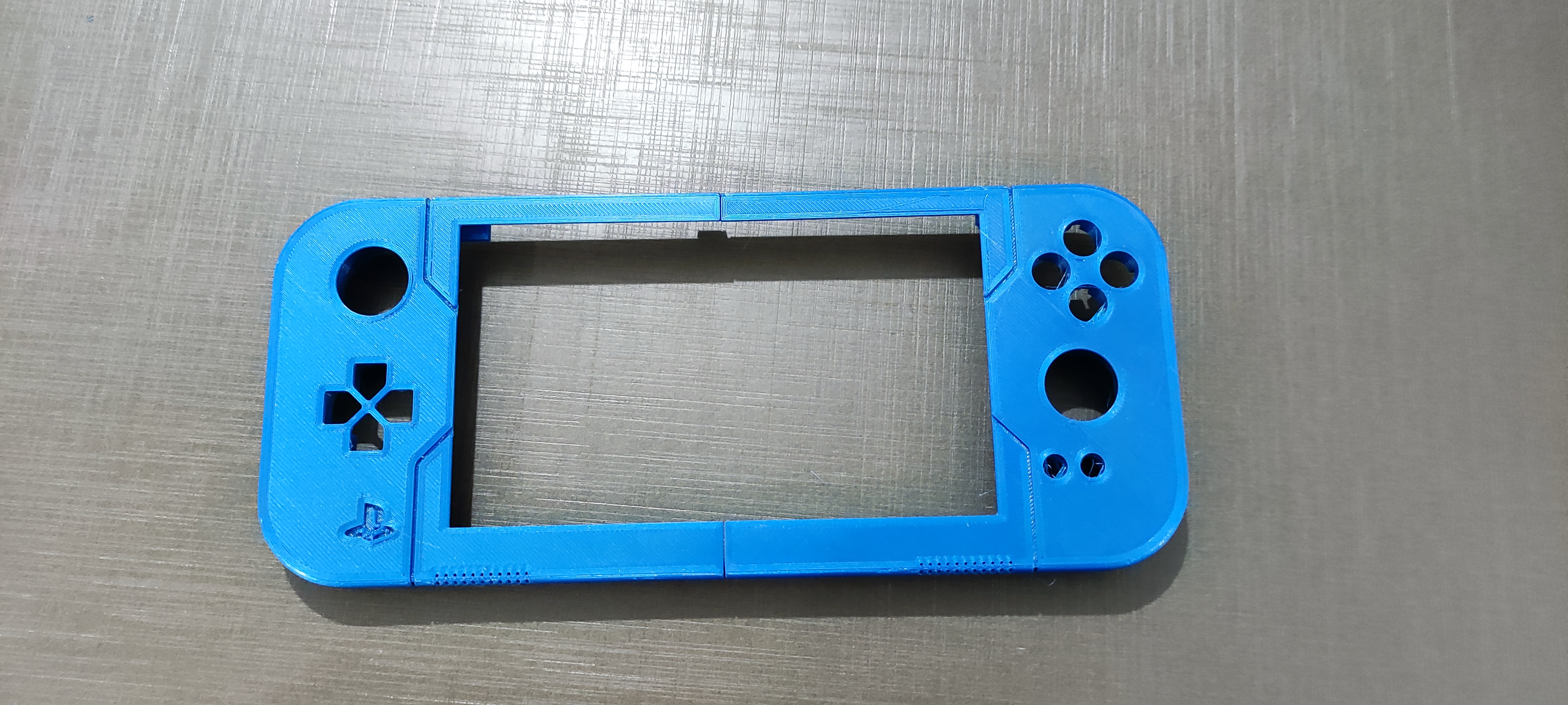

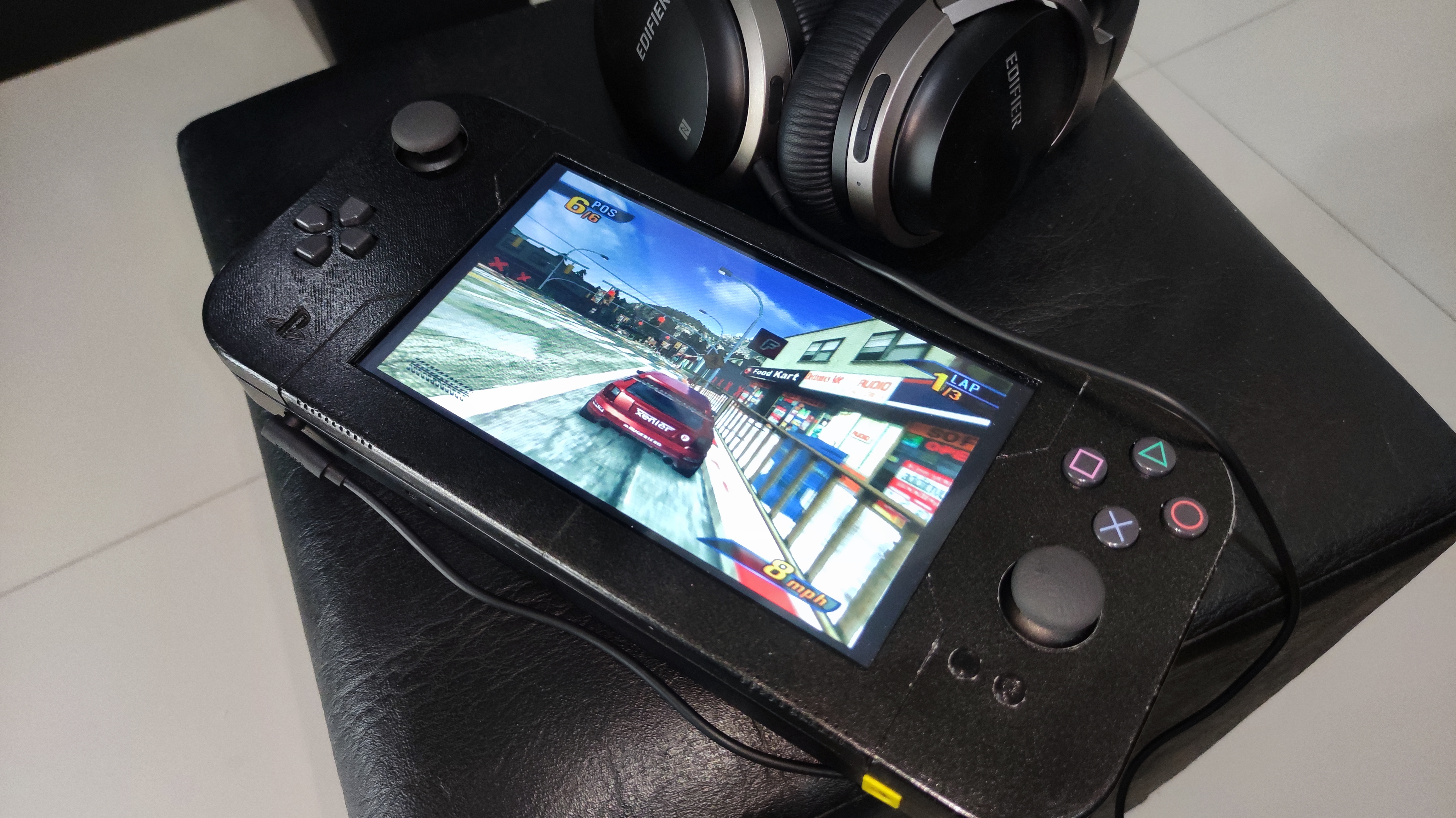

Hello, the game is semi finished.
I'm going to print a new case in the future, maybe in resin, as I didn't like the position of the left analog so much, otherwise it's great for me.
I believe I can improve the build even more, but it takes a lot of time and the real thing that the PS2 irritated me with weird things in the process ;D
Before printing the new case, I'm testing it well so I don't have problems with the buttons, today the left analog needs to be moved a little more to the right and the action buttons approximated
I recommend seeing in 4k\:

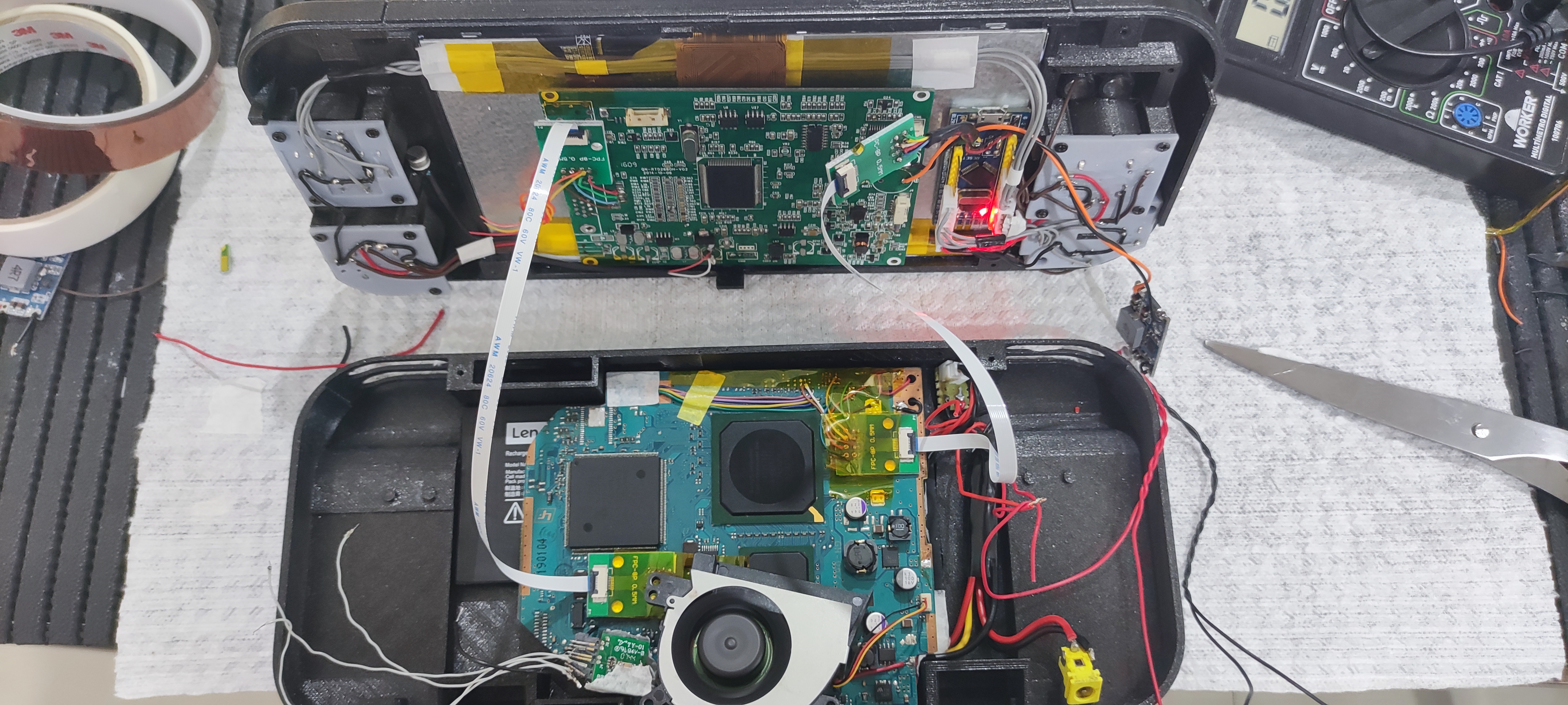

Hi, I'm posting my project, provisionally called PS2RP. I am using a box, similar to the Switch, which is a common case to use with a rasperberry. Possibly I use a translator, so I'm sorry for mistakes in writing and grammar.
Specifications:
• 7 "TFT Chinese LCD 800x600
In tests I have identified that the brightness and the viewing angle of this screen is horrible, I will change soon.
• Generic PS2 control
• 2x tablet batteries for use in series ~ 7,4v
• Stereo Sound
• Headphone output
• Freeboot on the memory card
• Games uploaded by Orange Pi Zero Plus
• Cut-out 79xxx GH-061-12 board
Some points have not yet been defined, such as the BMS and the type of connection to the screen.
My option would be VGA, but I could not make the connection yet, even taking the H and V points from the motherboard, the screen did not display. In this case I believe they can help me without the synchrony should not display the image in green at least?
