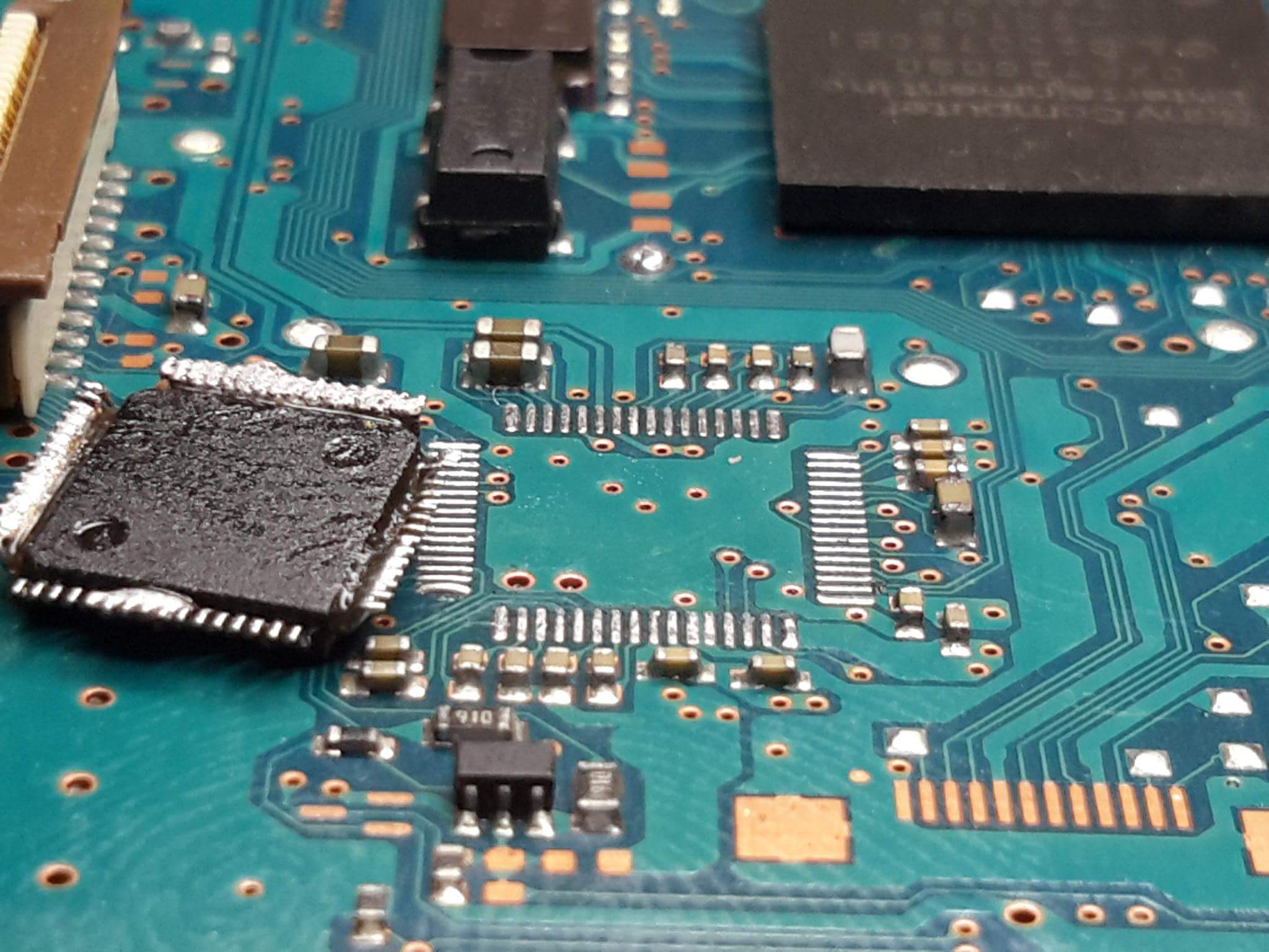

Hi friend my ps2 portable no printer 3d
I like ps2
Sorry, I'm using the google translator

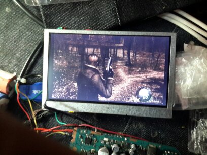

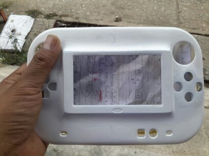

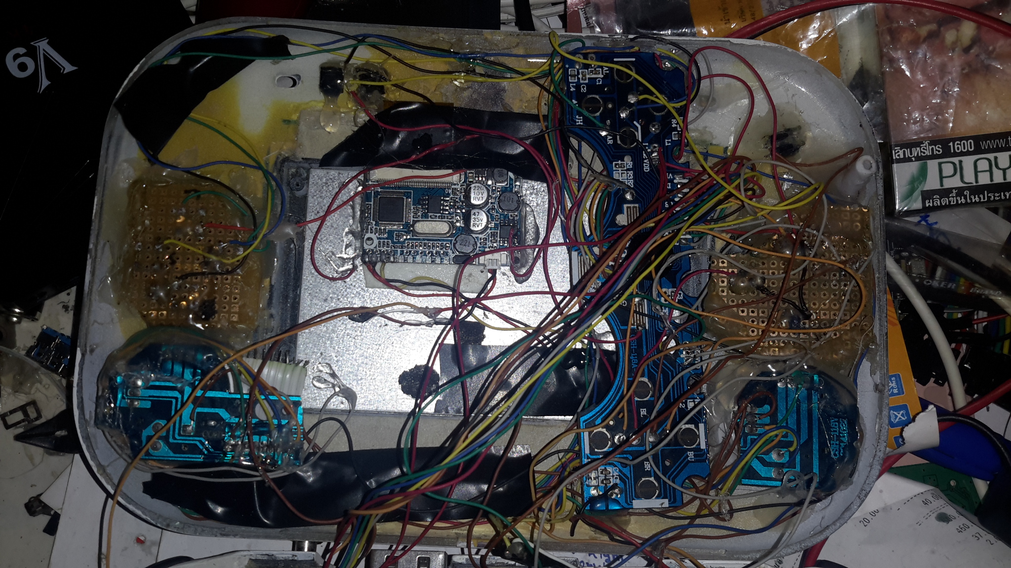

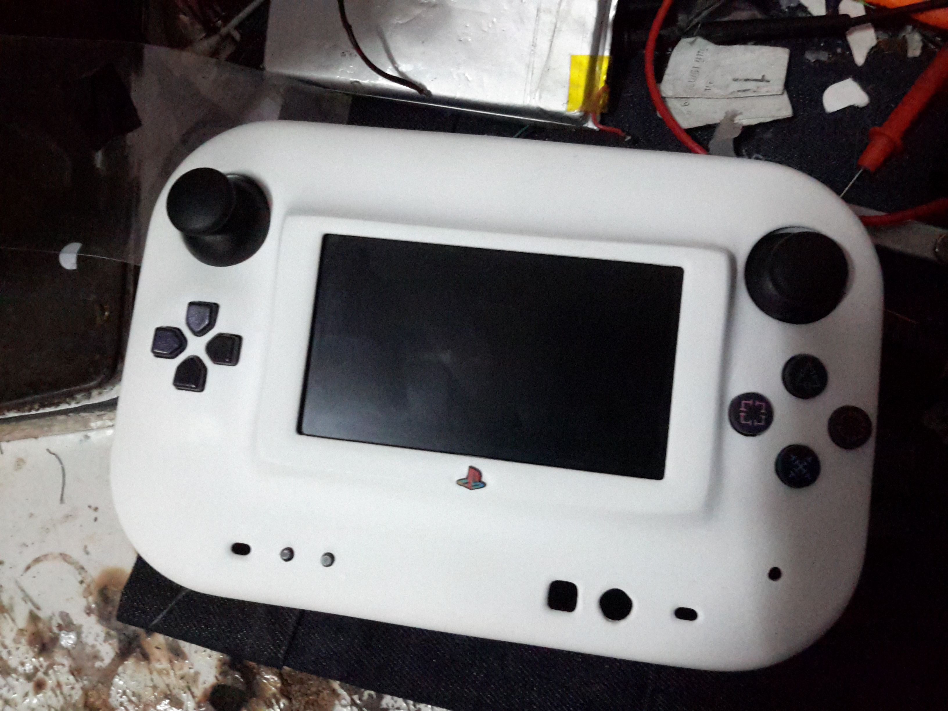

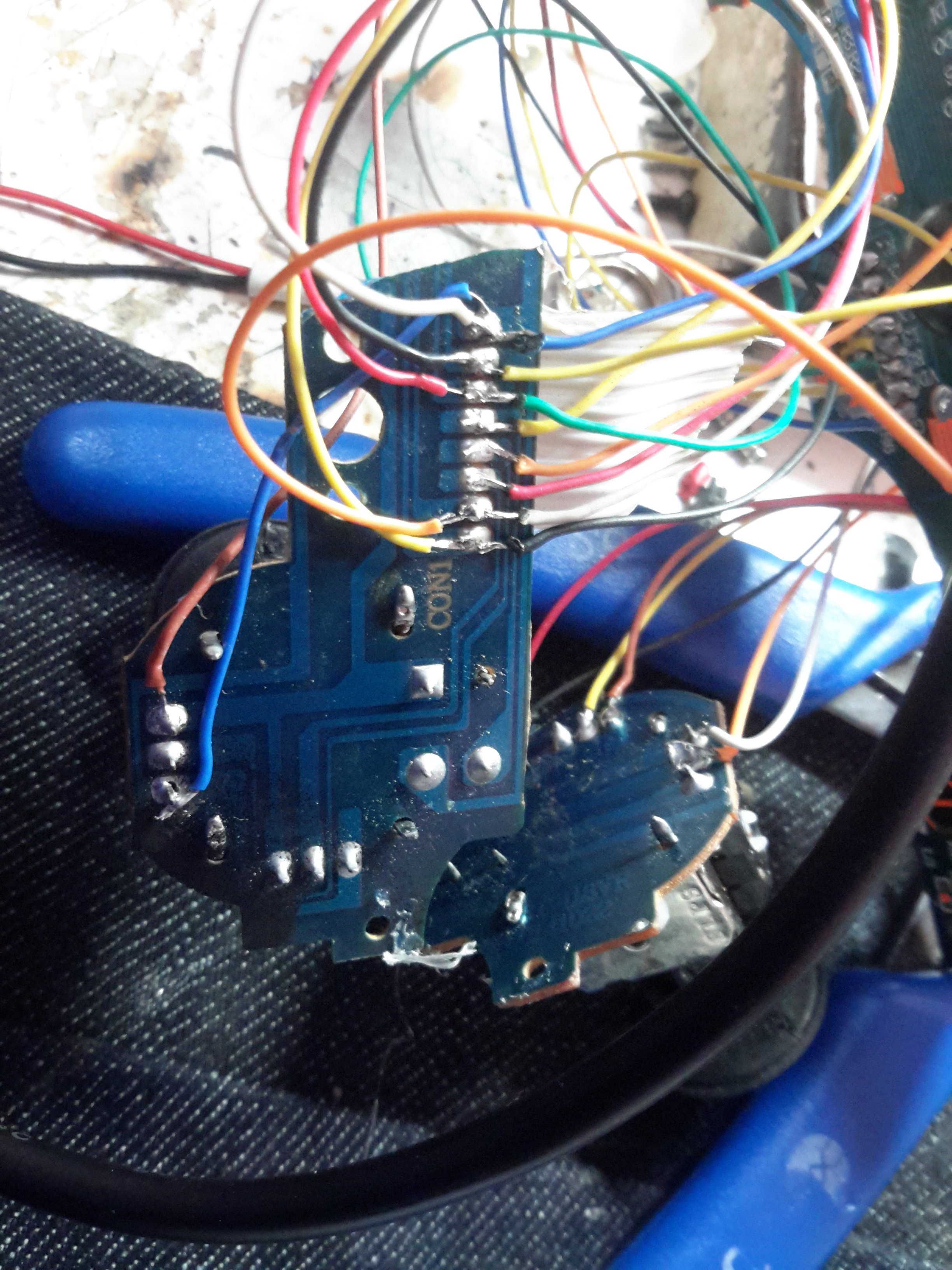

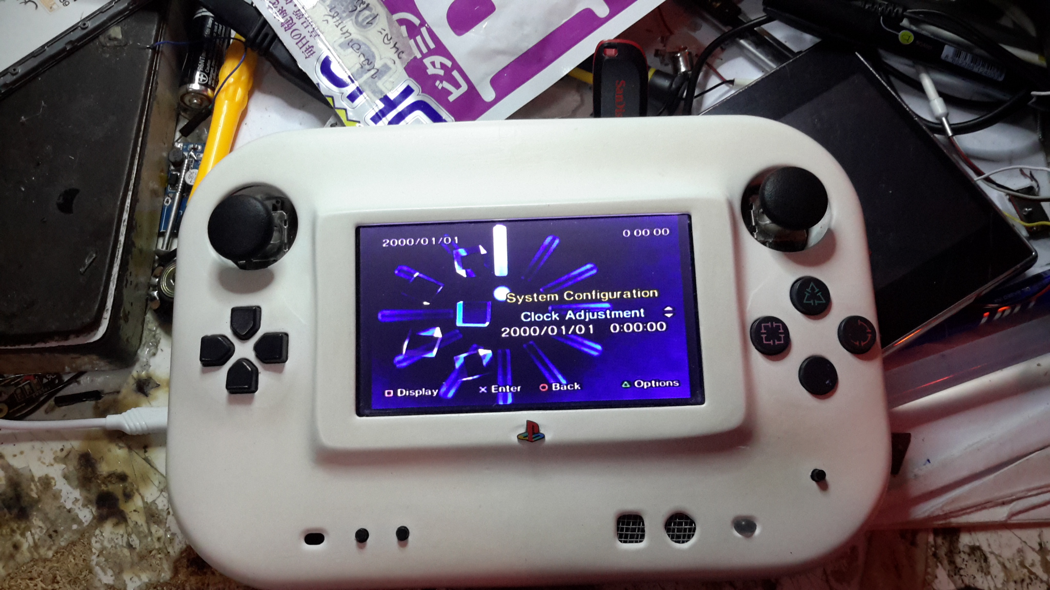

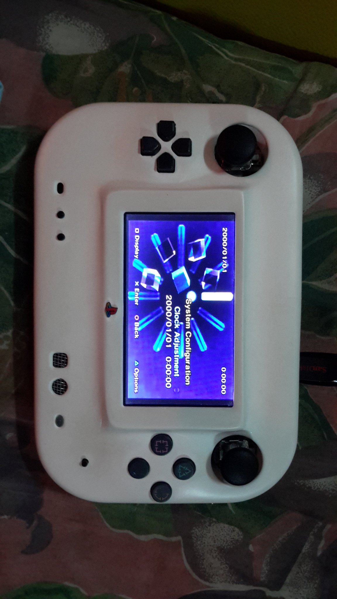

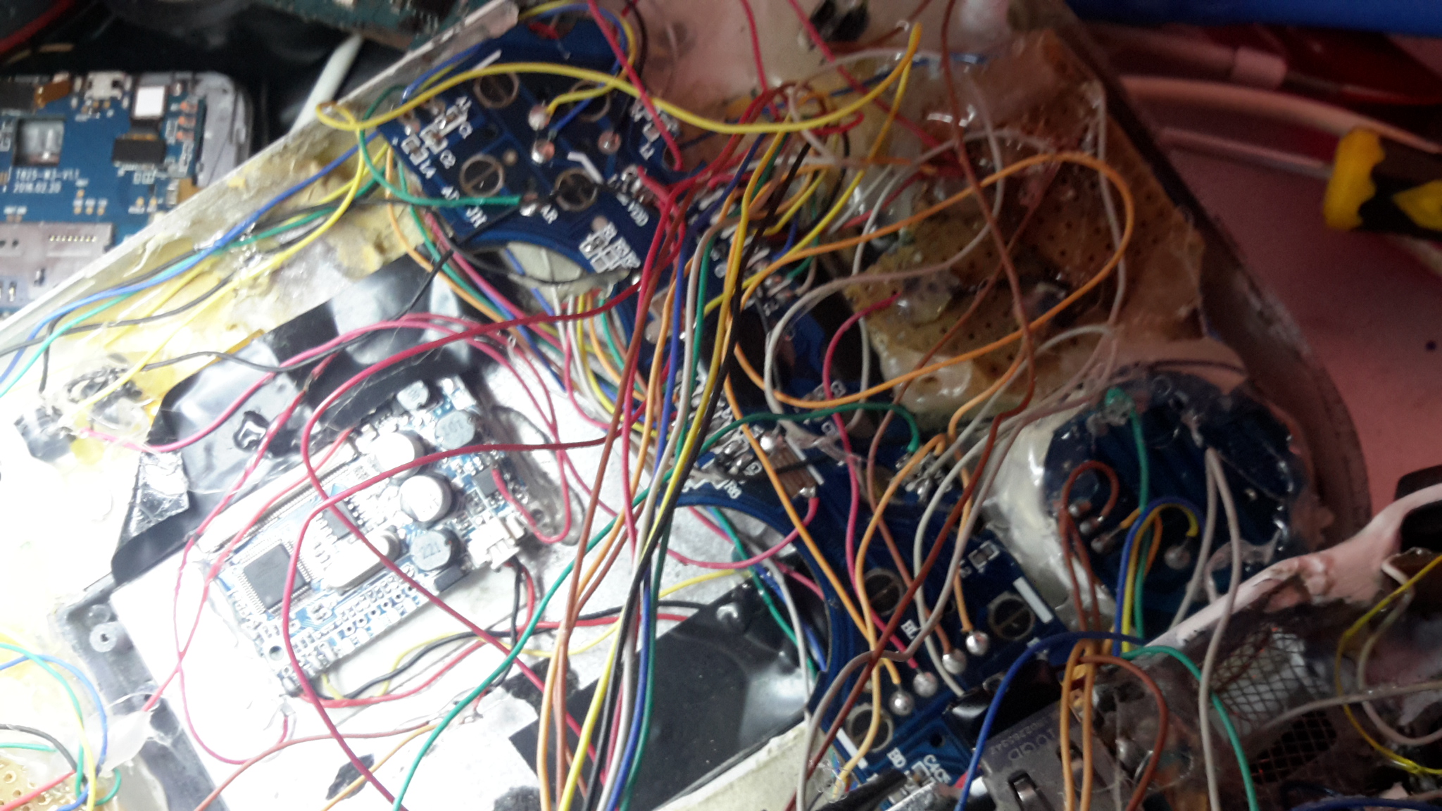

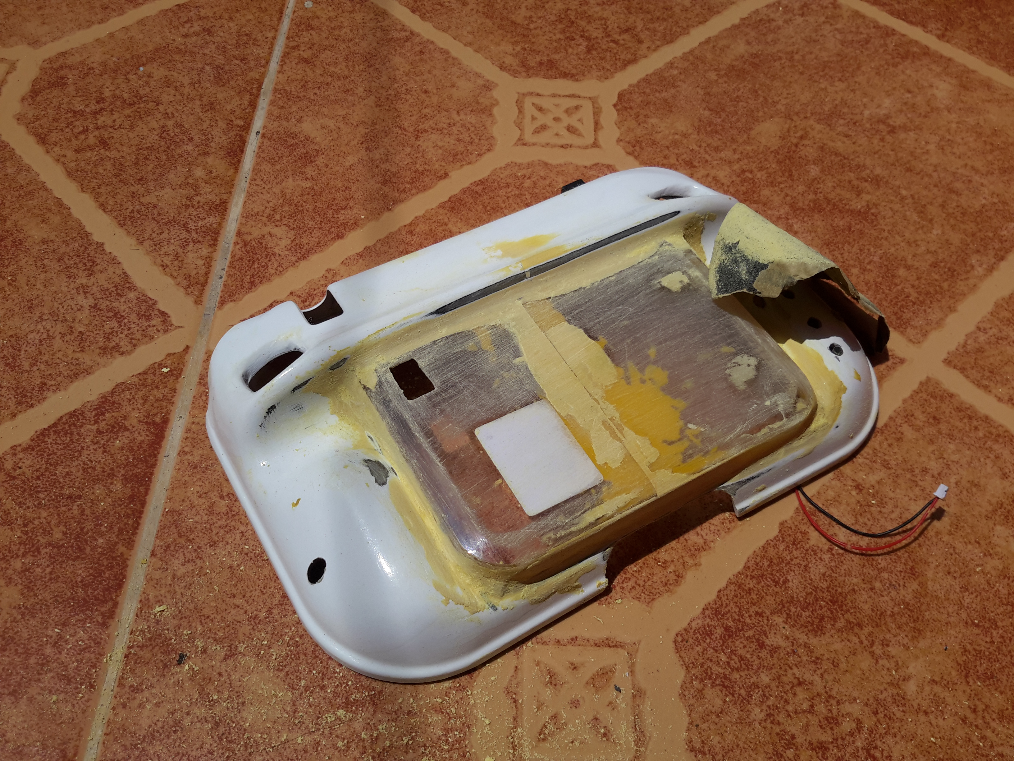

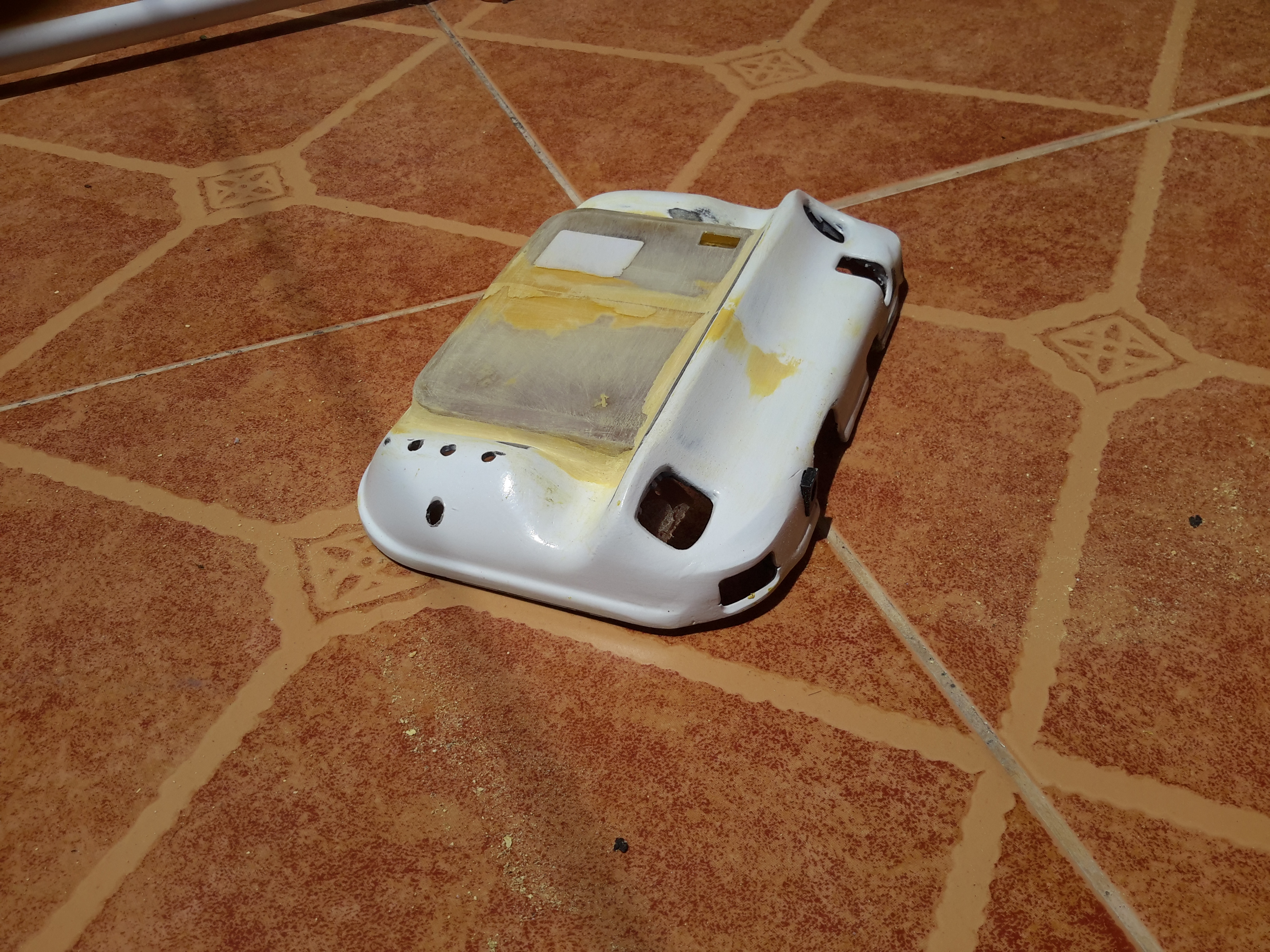

The project started due to thenew cutting guide of the 79xxx plate, thank you to everyone involved for the excellent guide, which is making this project possible!
Neme my projact The PS2P o - ho kid
* Case no printed in 3D
* control buttons ps2 original
* mono Sound
* av output
* screen 4.3 tft
* freeboot on memory card
* games loaded by USB
* Internal Batteries 6000 mh
* 79xxx plate cut followin
Thank you everybody for guide

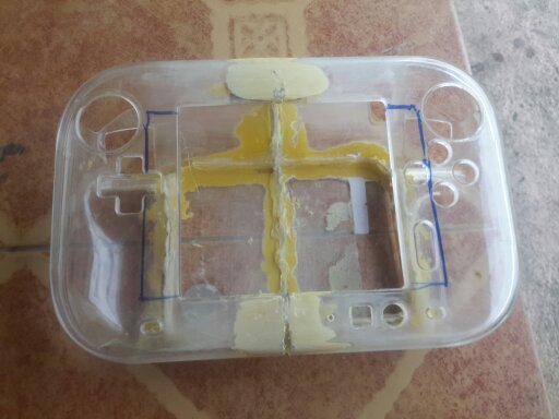

That looks absolutely amazing. Did you cut a wii u gamepad case in half for that case? The detail in that case work makes it look like it was 3d printed. Excellent work!
Thank you sir
Printer in 3d in Thailand very expensive
I was adapted from wii u caes
maybe I'm tired, but I'm very happy sir
