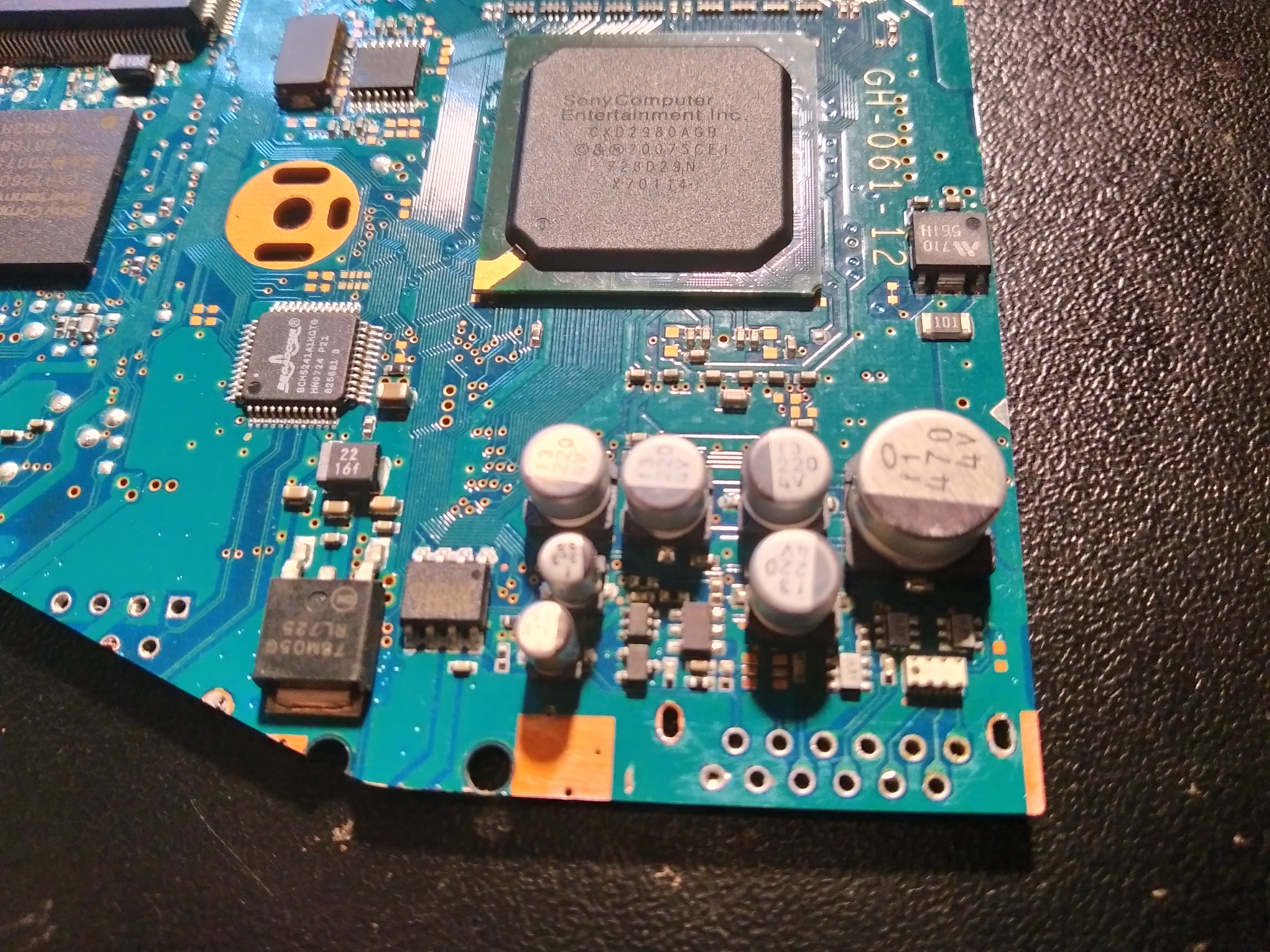

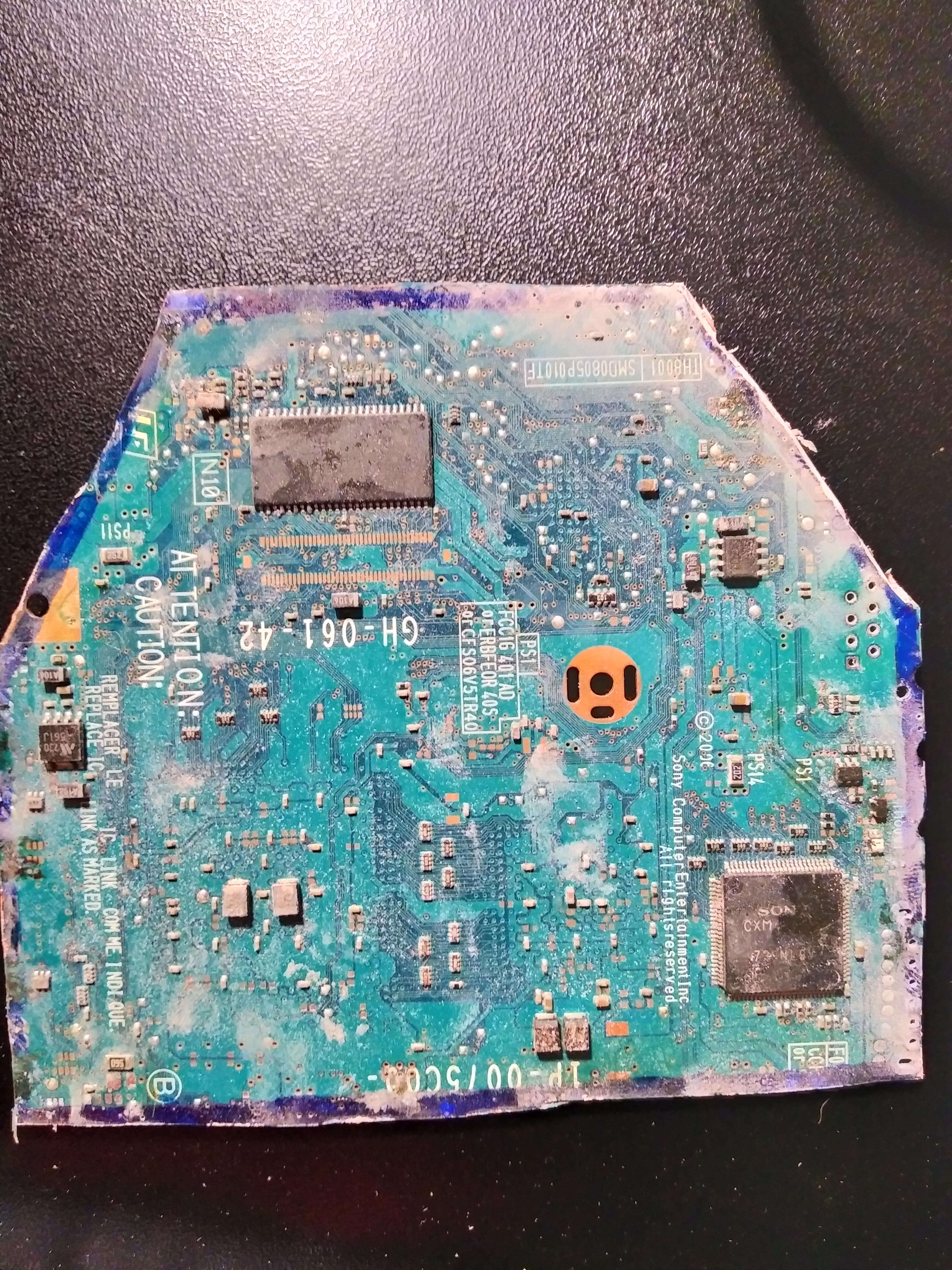

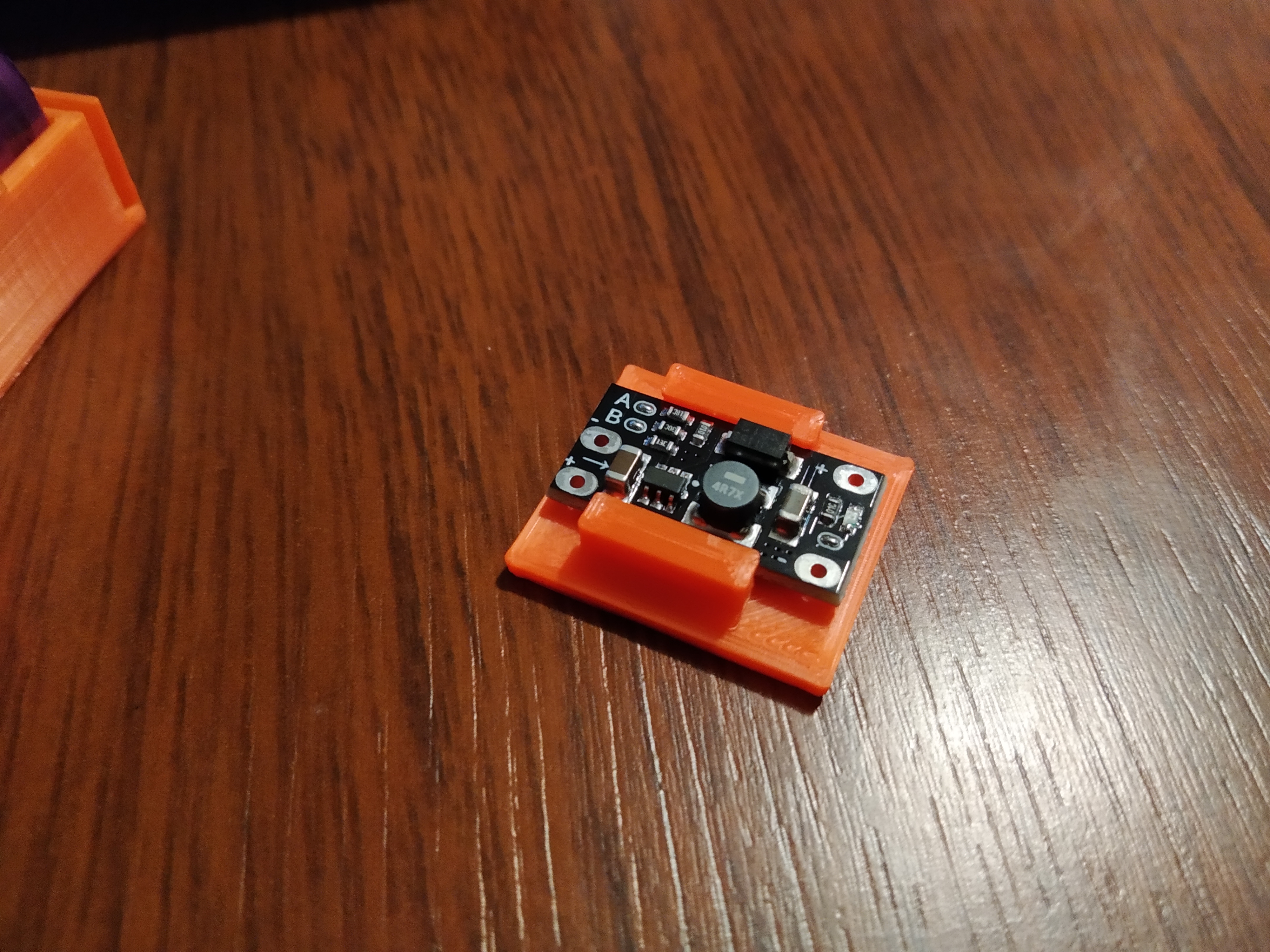

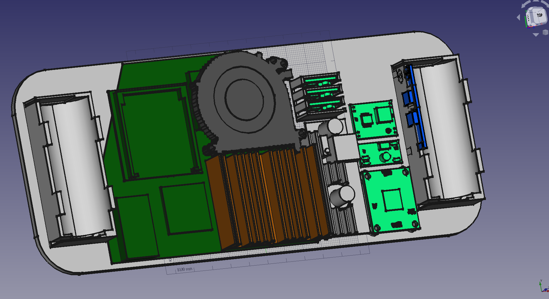

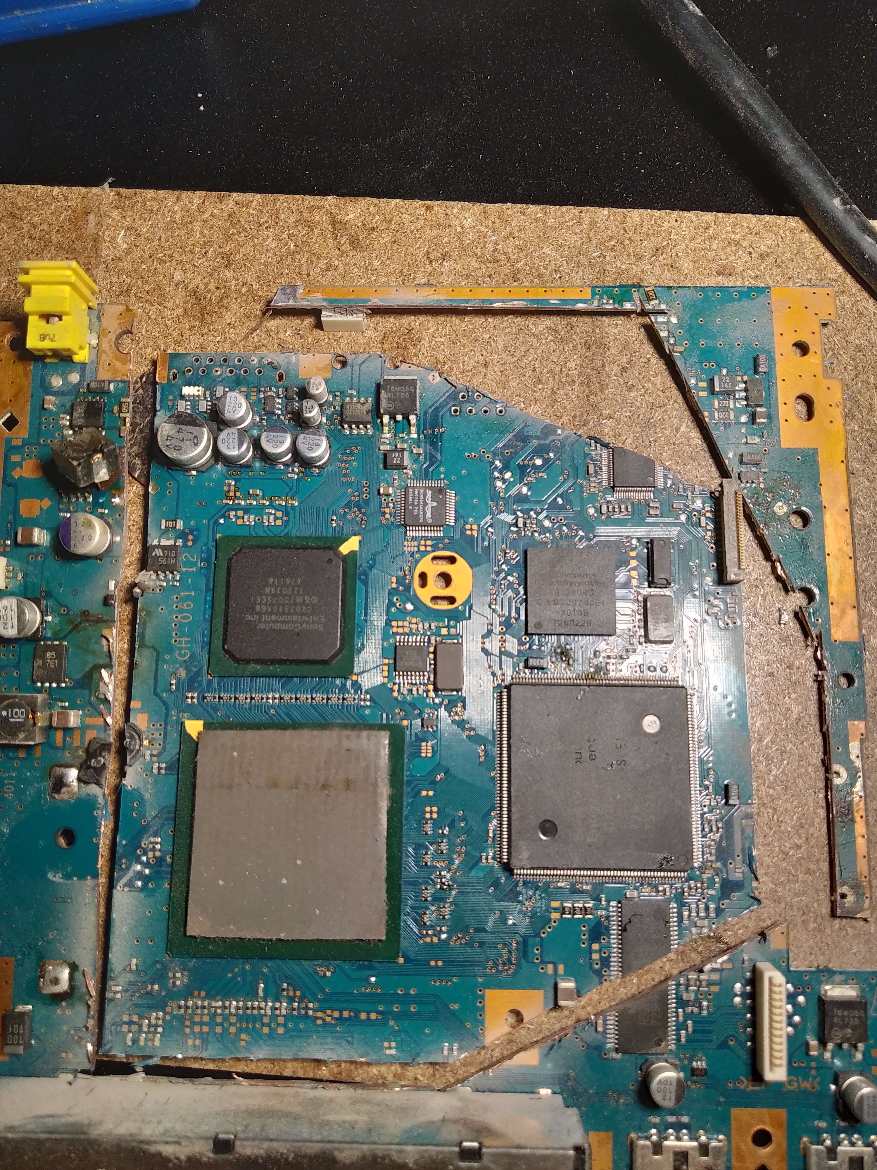

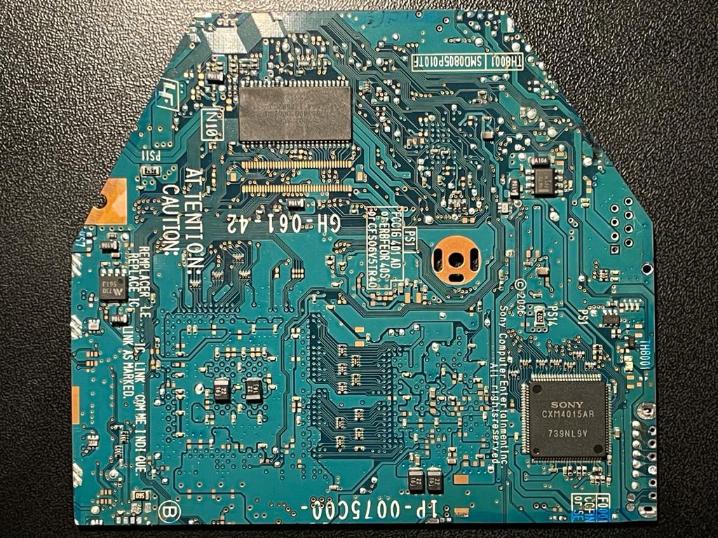

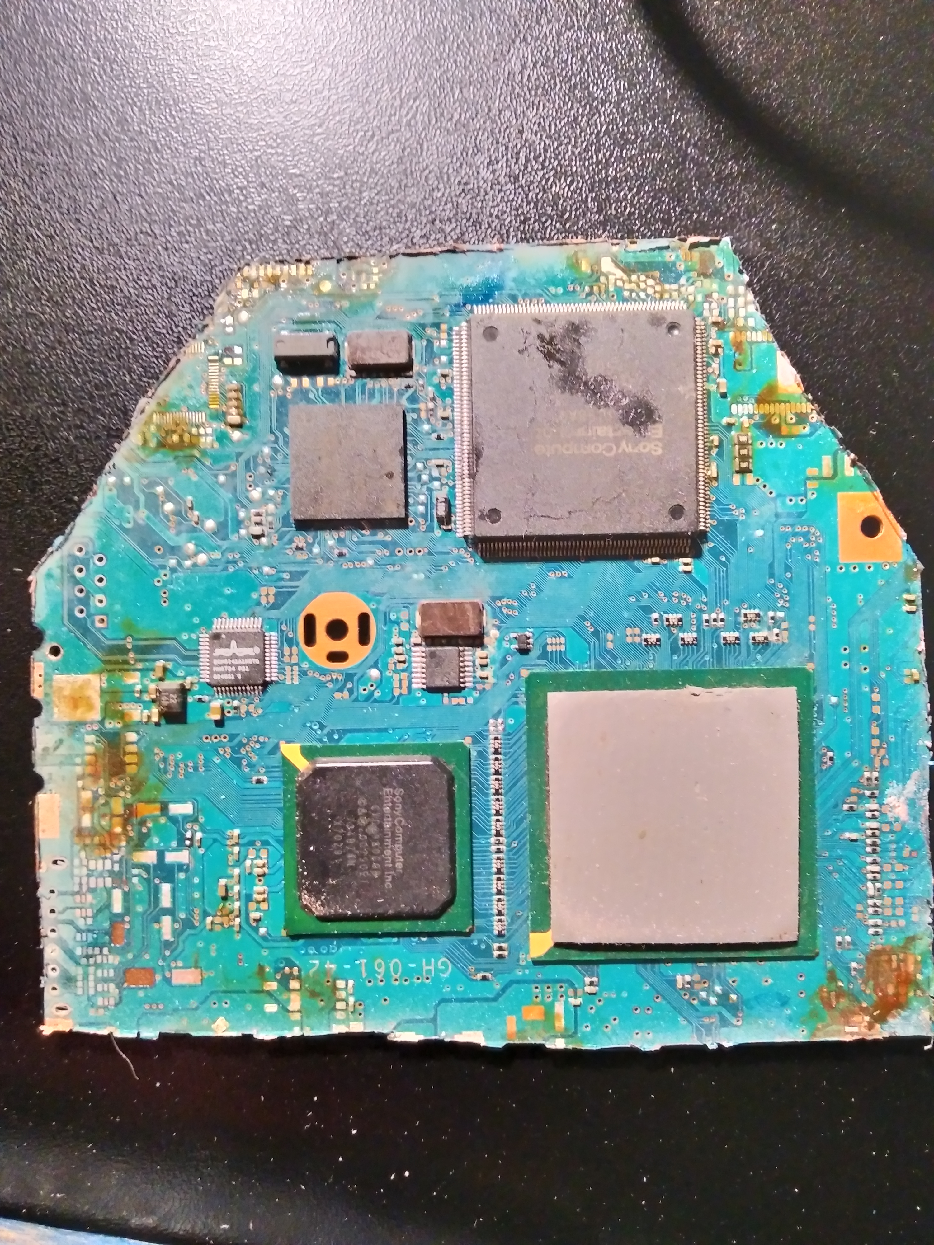

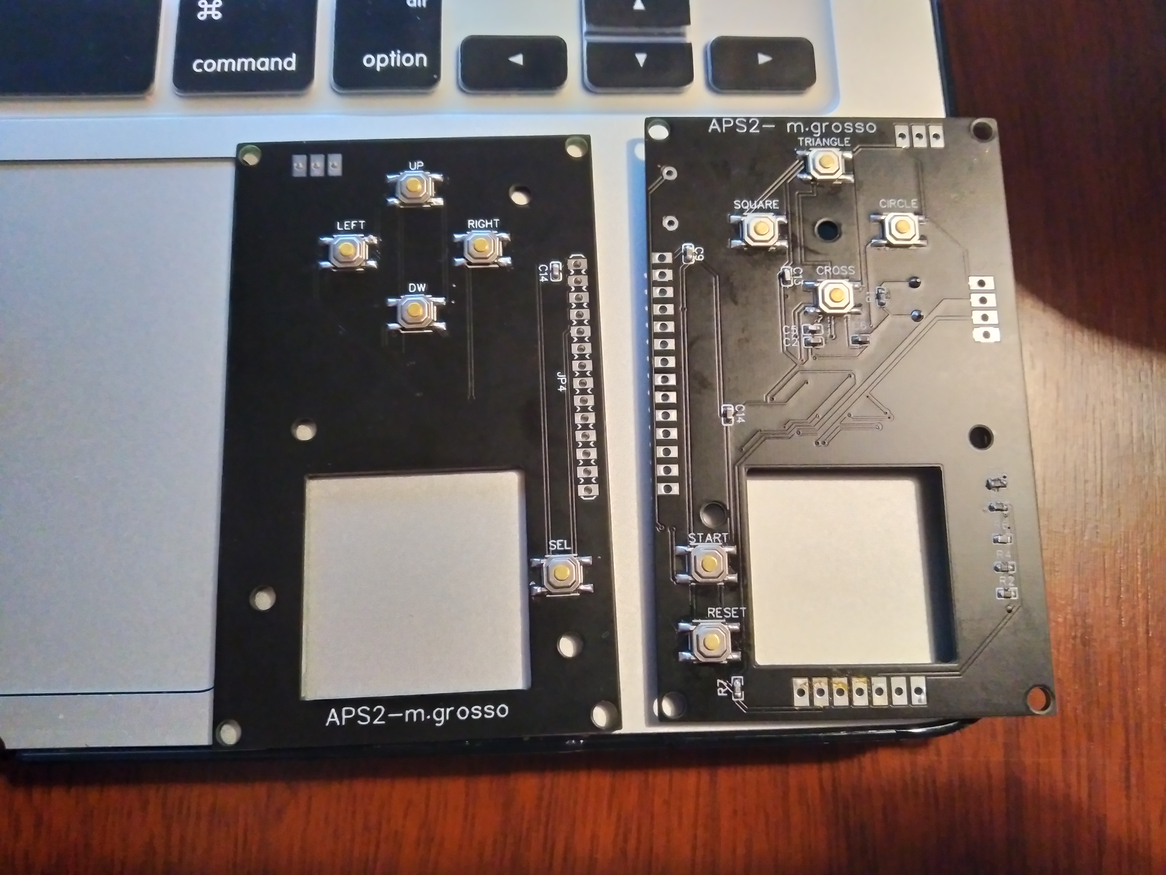

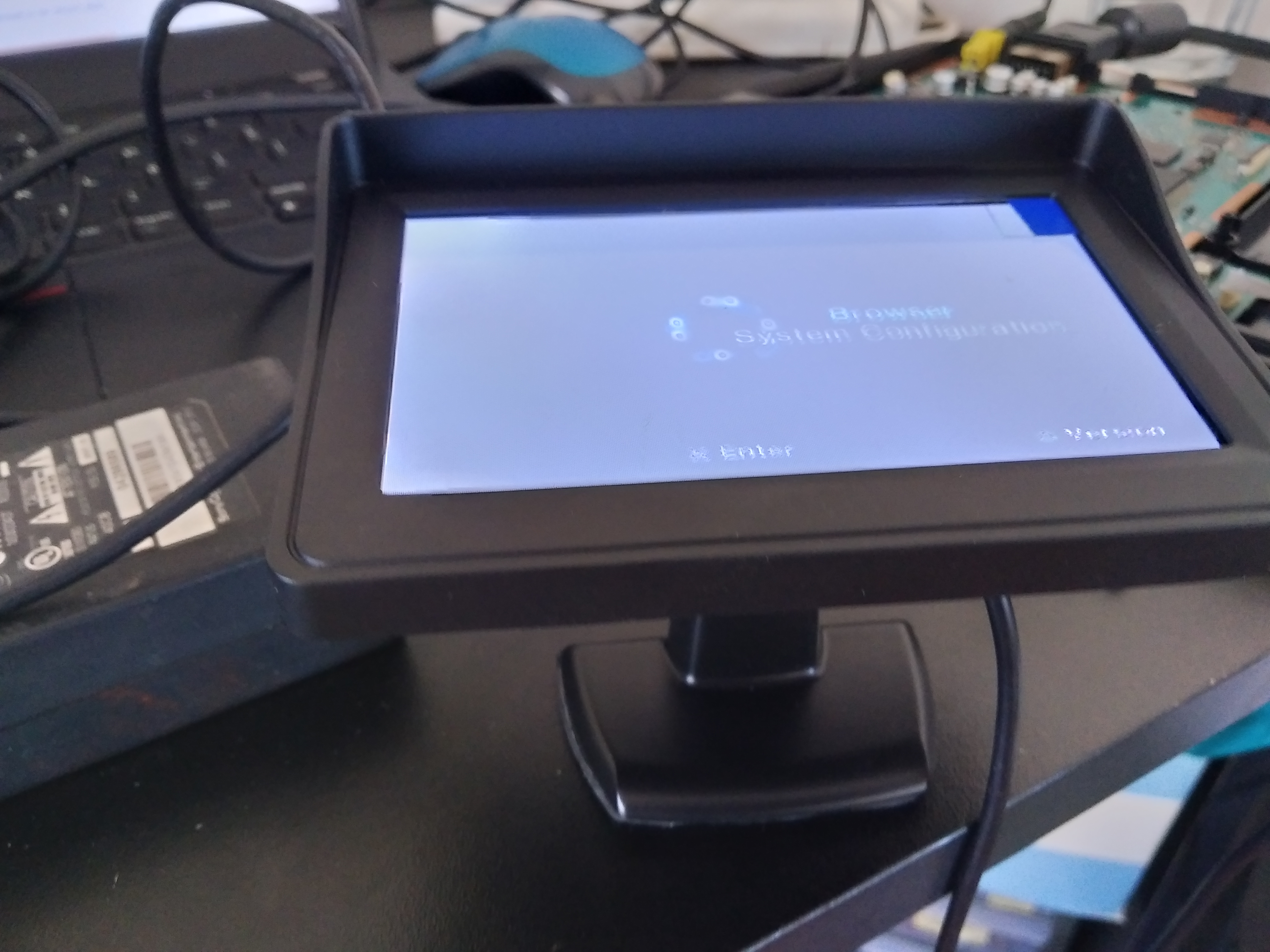

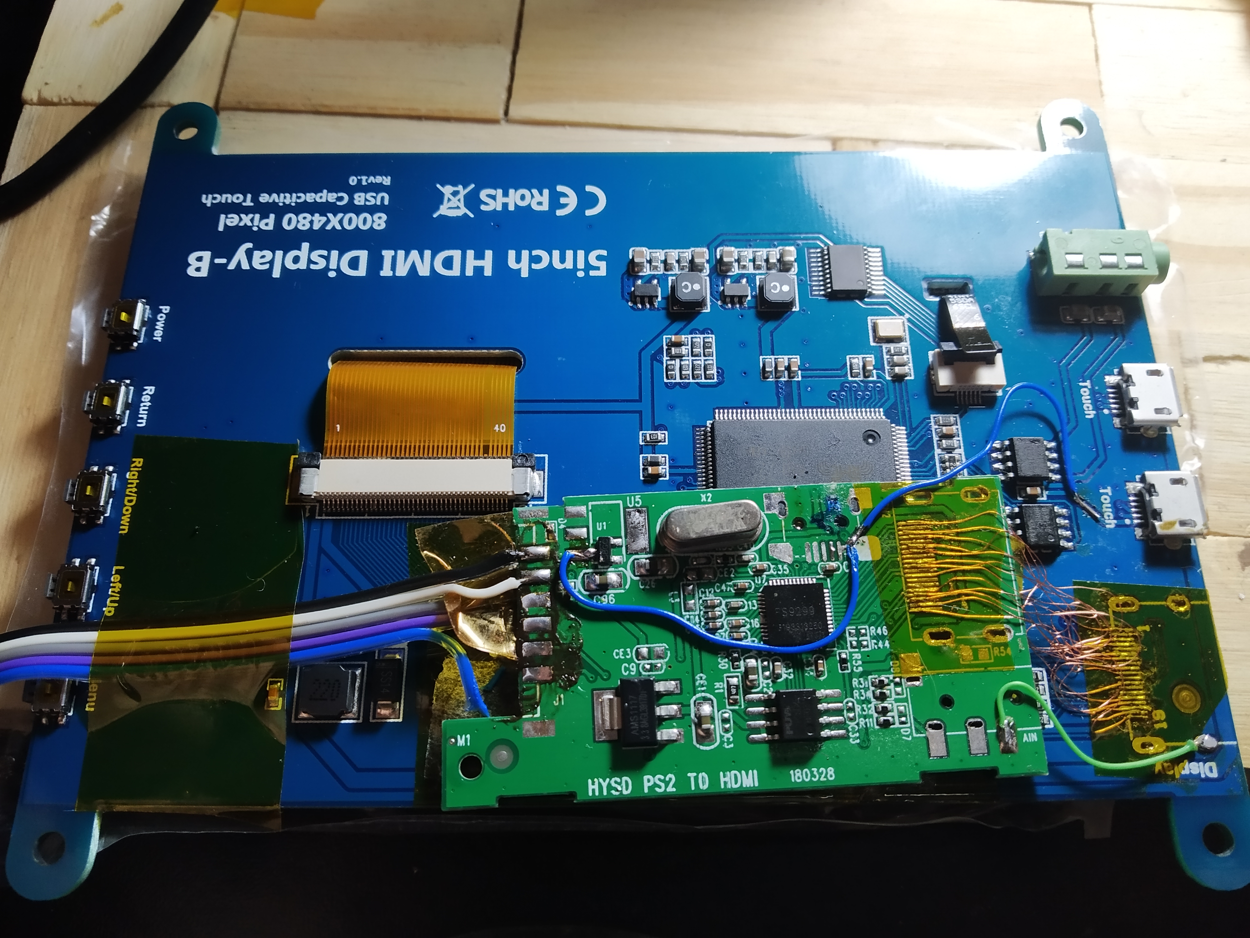

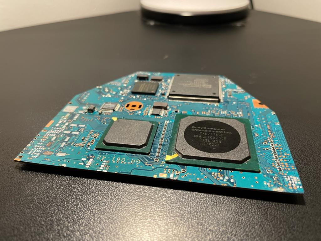

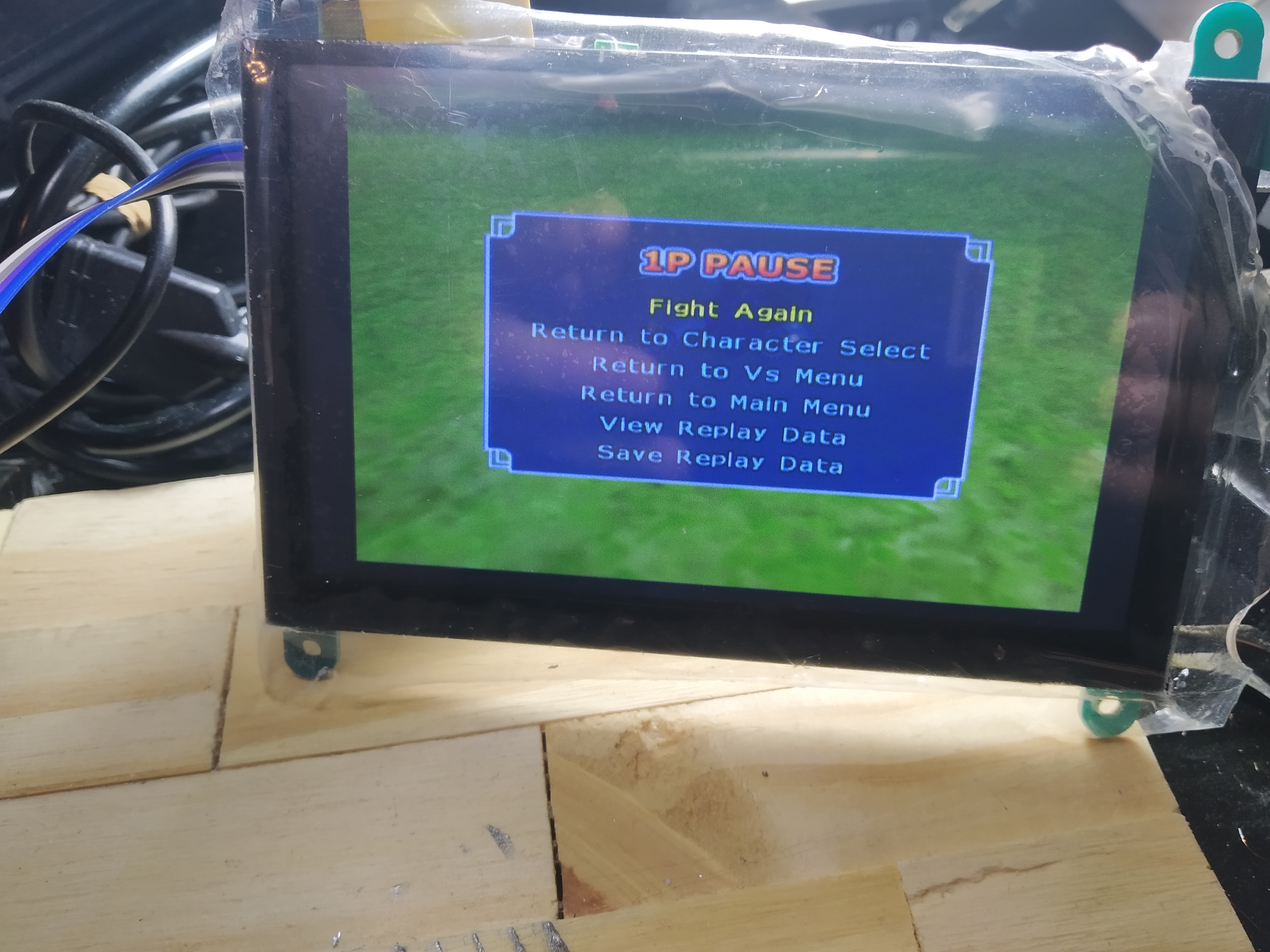

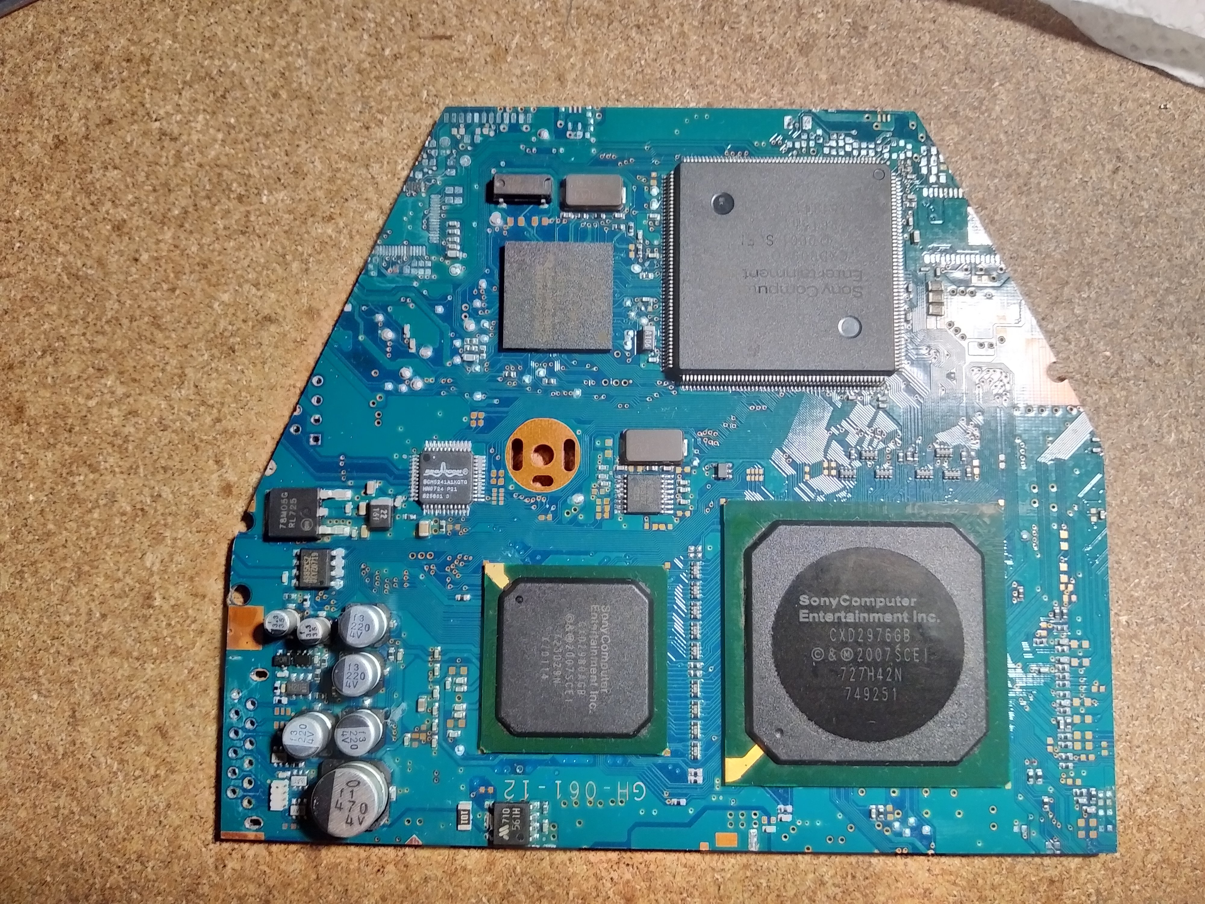

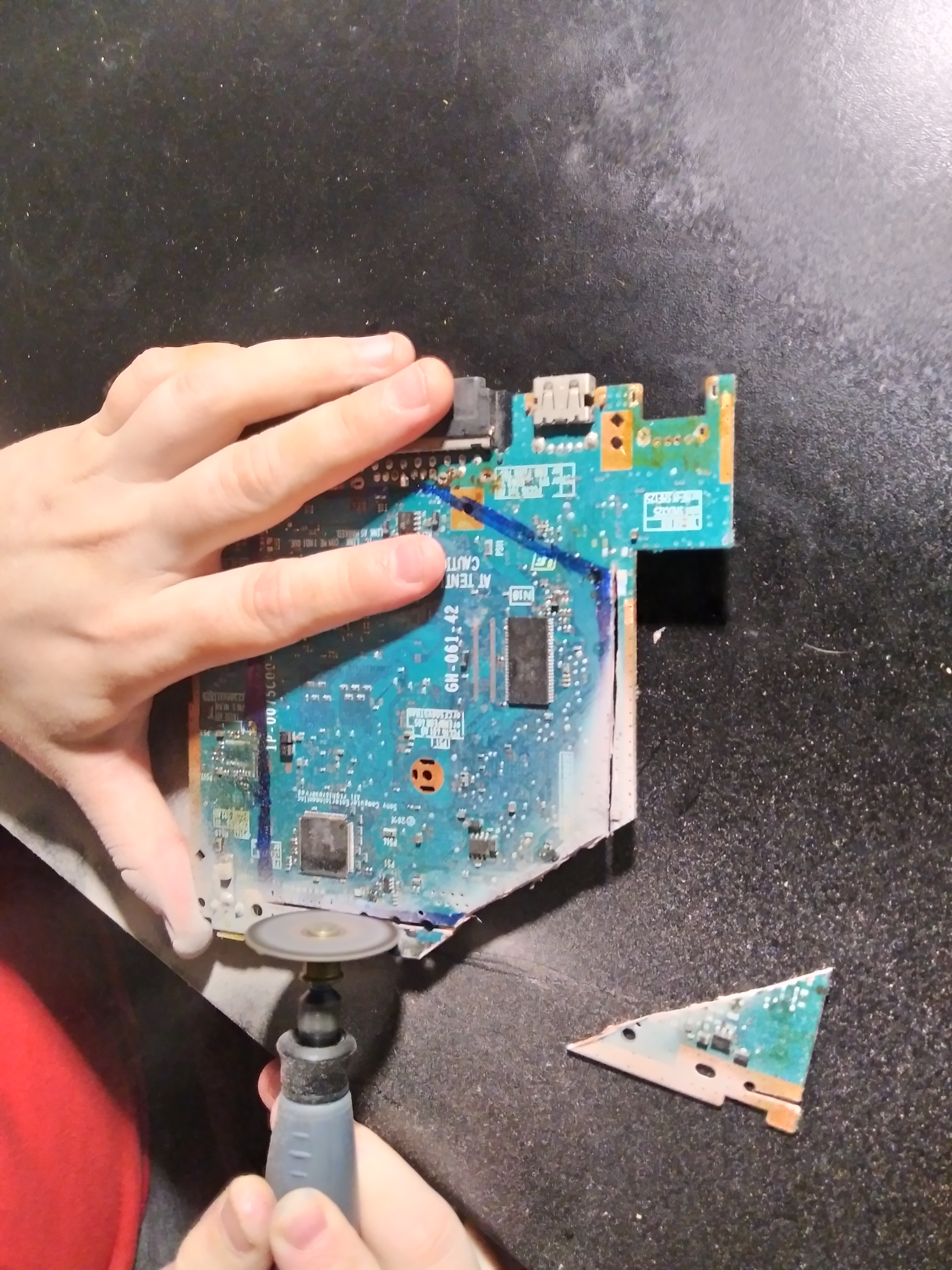

yo that looks amazing man, awesome work. I am curious though what is the screen you're using? And are the 2 Red PCBs your own creation or were they boughtGood bro it is alot of work what u have done congrats it looks nice, im also working on a ps2 portable or better yet my second model i made the fist it is call "ps2 shiden" and the second model im work is the "ps2 shiden type-s" the fist image is the ps2 shiden and the second and third is the 3d model and the intenals of the type-s model, i was able to run the ps2 with 5v in the main input of the ps2 with a diferent trim of the motherboard it is about 116mm x116mm big but i keept the pads for everything the usb port, the mem cards, the controller ports, the video output, and the onboard power management and with a little mod to the board i was able to run it with 5v in the main input at 1250 mAh, with out a custom regulators just 5v in the input and with a module that i got that it is 1s that suply the ps2 with up to 2.5amps and comes with a usb type c for changing the battery i can run the ps2 with a single 3.7 lithium polymer battery or a single 18650. Check the pics out View attachment 18565View attachment 18566View attachment 18567View attachment 18568
This discussion should move to a dedicated worklog for the project. This is megamti's worklog, it's a bit rude to sidetrack it with your own project discussion.Are you powering your ps2 and screen off the RPi UPS Pack v3, how long do you get with the battery?
