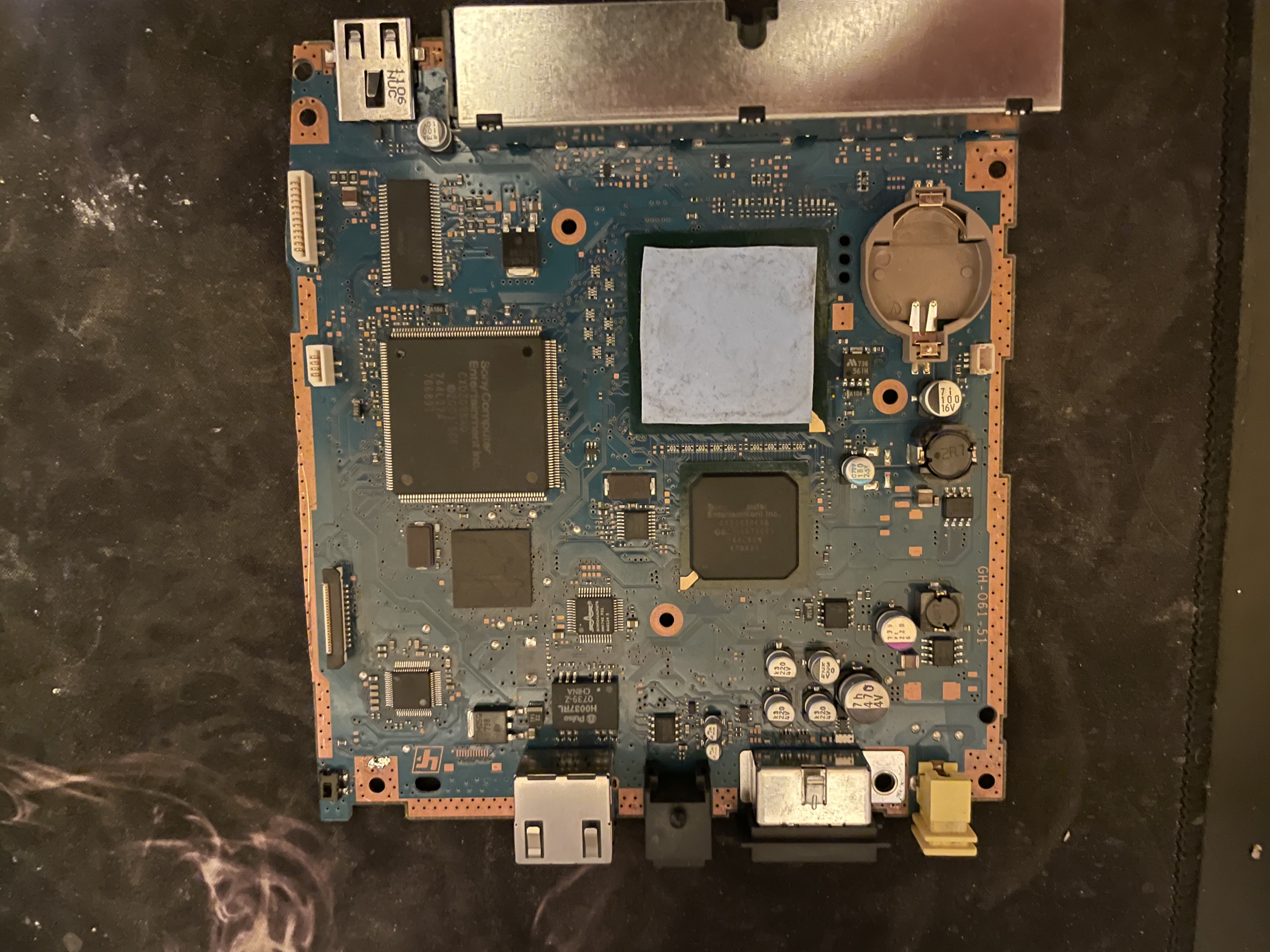

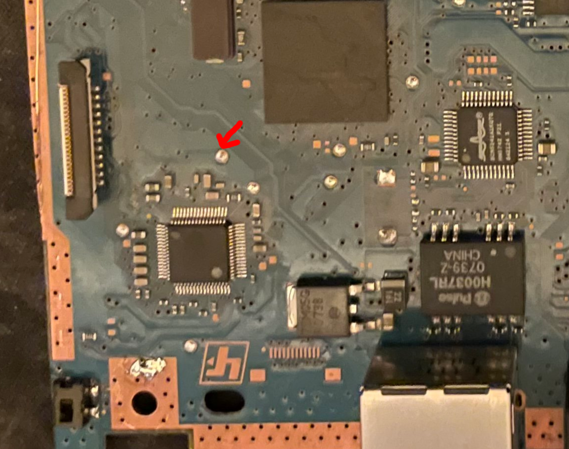

i wanted to do ps2 ultra slim mod i allready cut motherboard and it didnt have reset pad shown in this video .

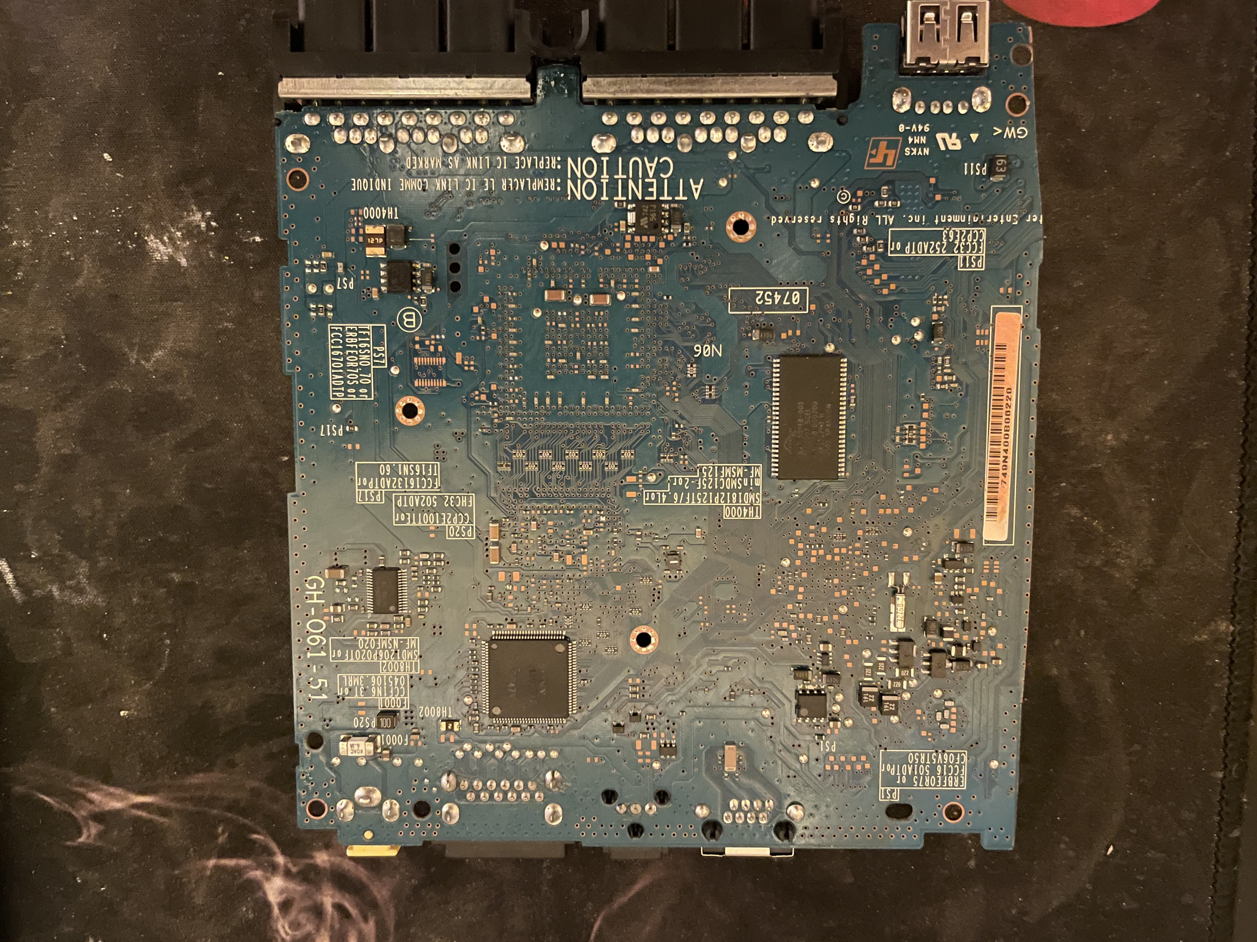

i have ps2 slim 79004 with motherboard GH-061-51. Is where any schematics to locate missing reset pad and how does ps2 power on
Here
I searched everywhere the only thing I found is that there’s a reset pin right behind the usb port you trimmed off. Hopefully someone else has the info you need

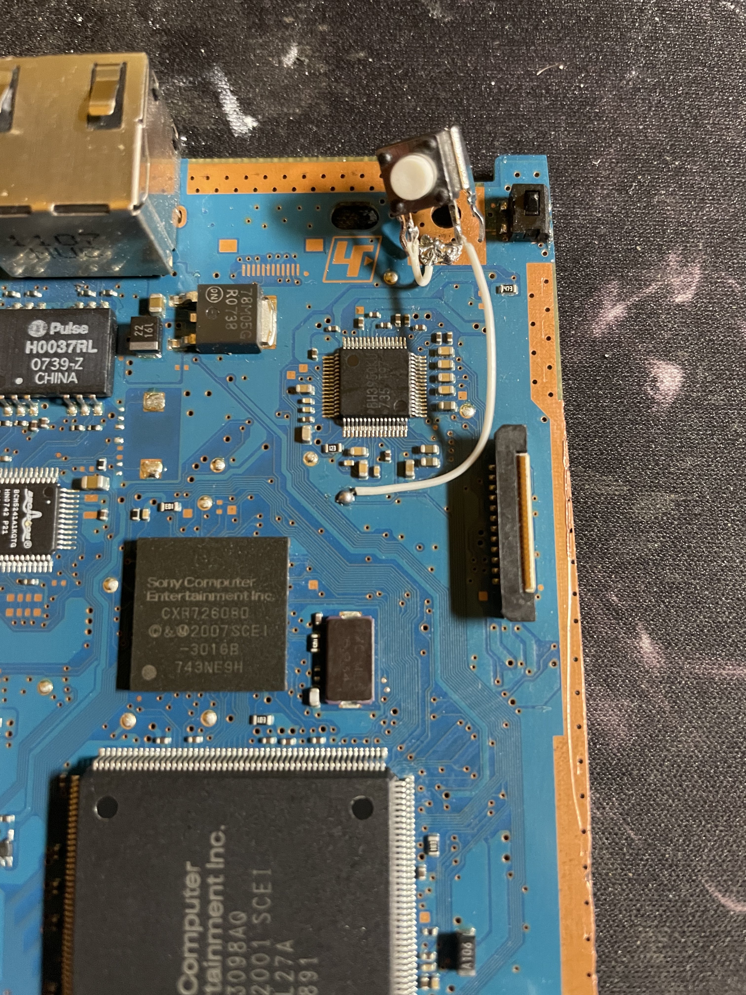

Well i did solder to that point and still no power
Did you solder a regular tact switch to it to test? Or did you wire it to the lid switch?
solder to lid switch
Try using a separate tact switch, or if you don't have one handy just solder a wire to the pad and touch the other end of the wire to a ground location to simulate pressing a button

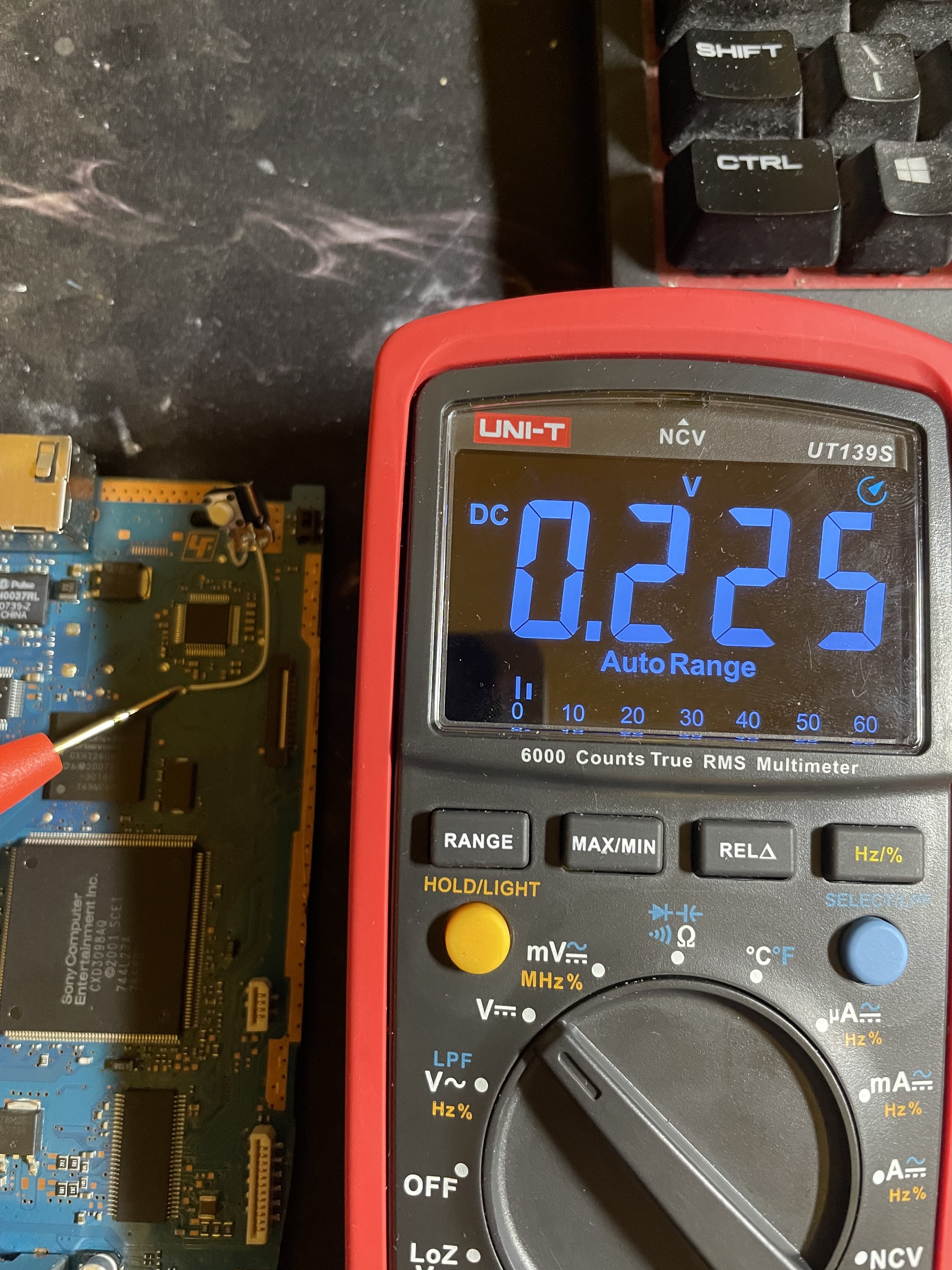

I solder the tacktile switch still no powering on . I checked with mulitimeter there is 0.225 v on that ponit when i press tacktile switch it gonig to 0v when relasing come back to 0.225v what does that even mean

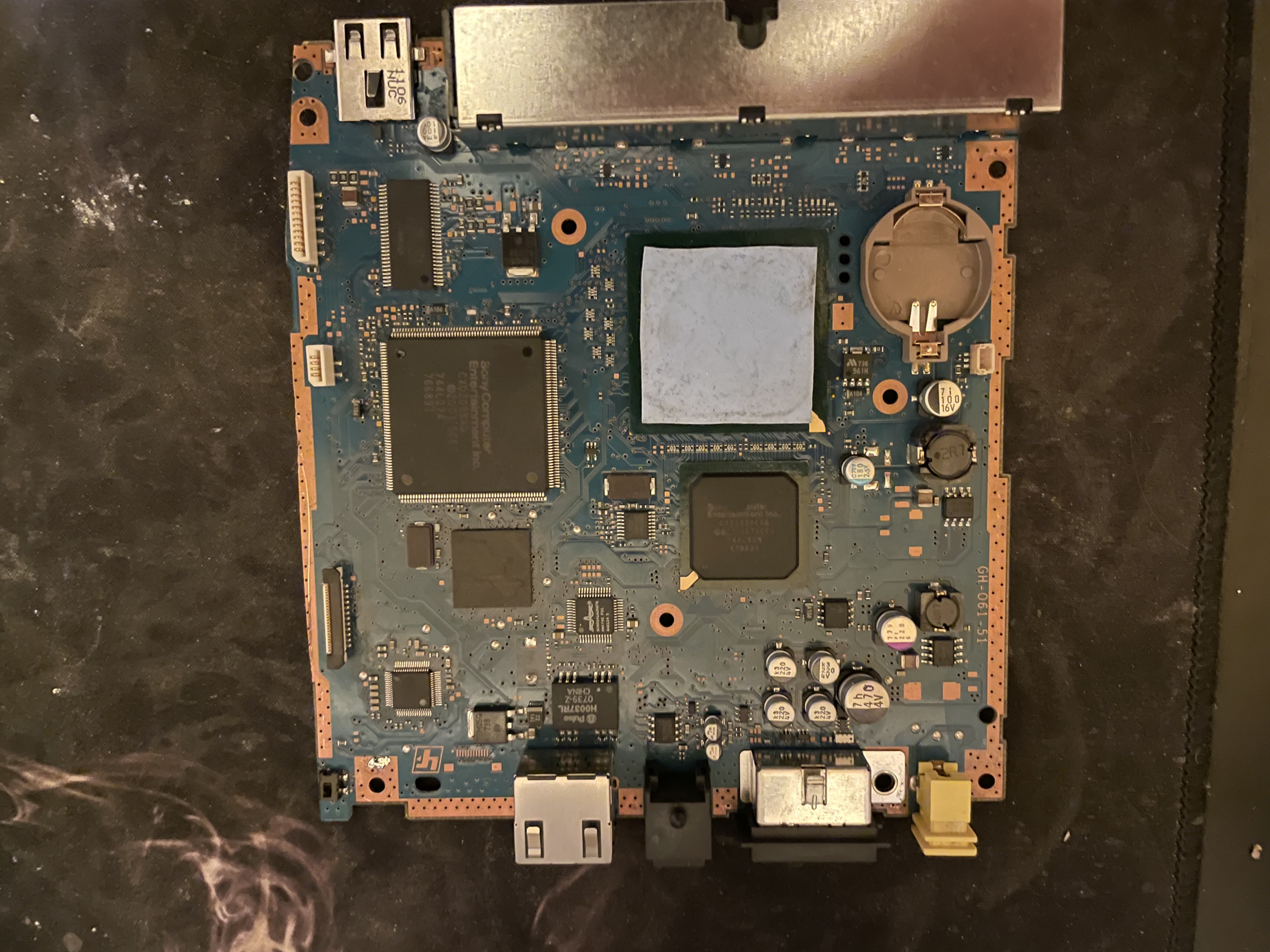

I do have the same mainboard here with all chips removed. The RESET input pin on the Mechacon is G3 and from that pin I traced it back to the test point I marked in the image below. I verified it by measuring the continuity to the tact switch on the front power board, sadly I don't have a working version of this exact mainboard to confirm for you.
thanks guy its powering on
