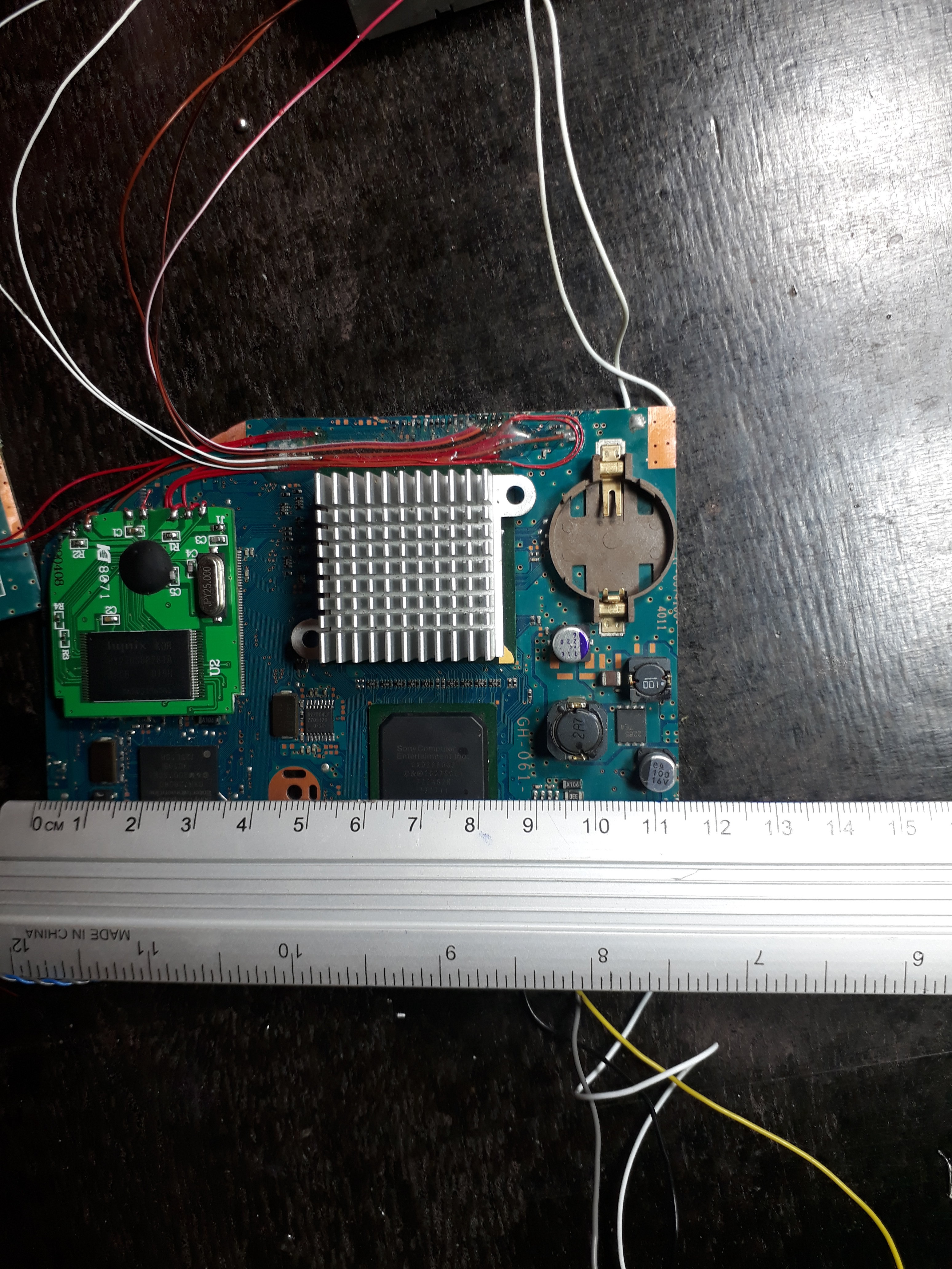

could you give me the link of controls board?I find there is a regulator between the ps2 board and theScreen drive board,is it the Hailrazer'sMod ?

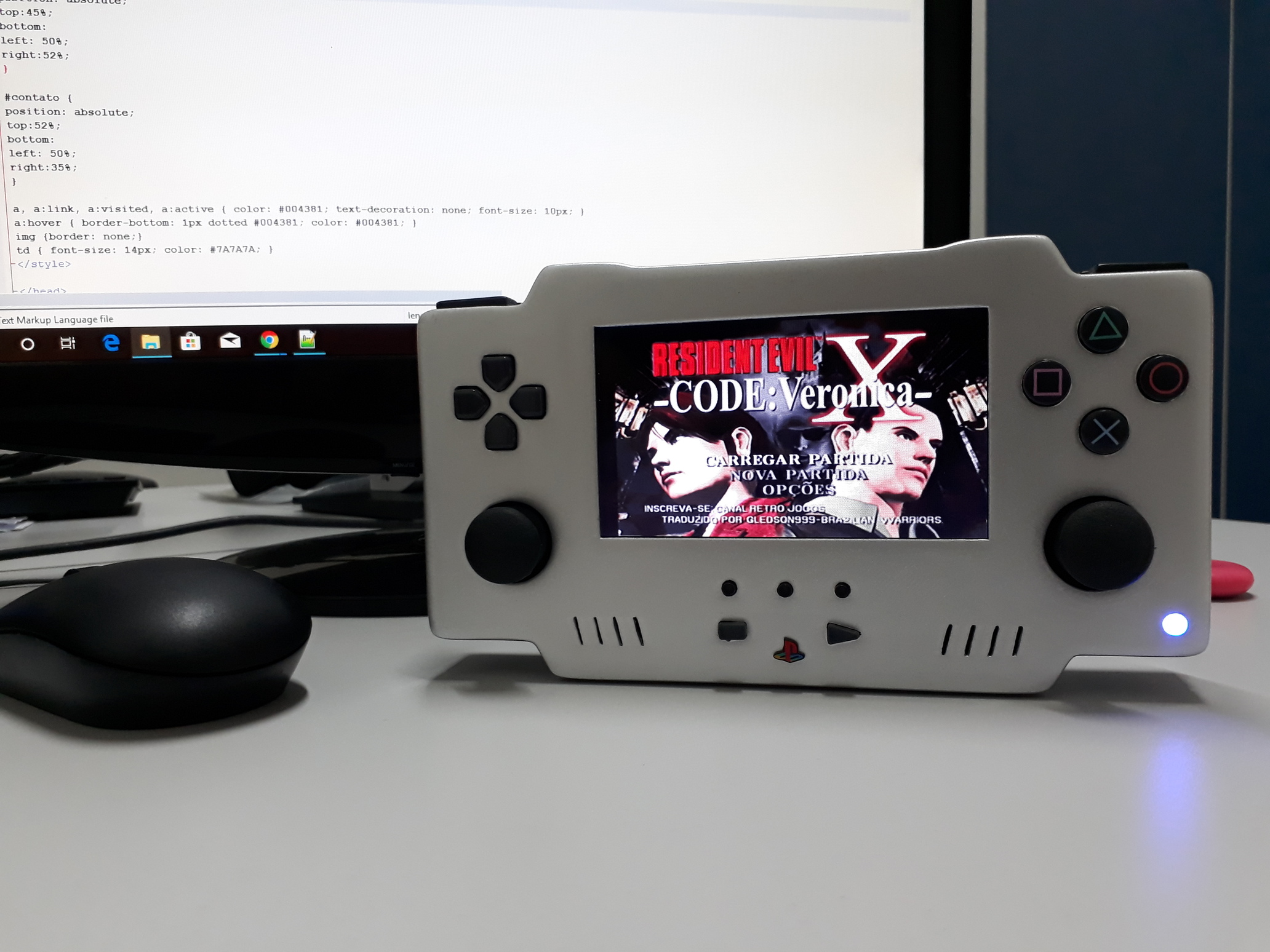

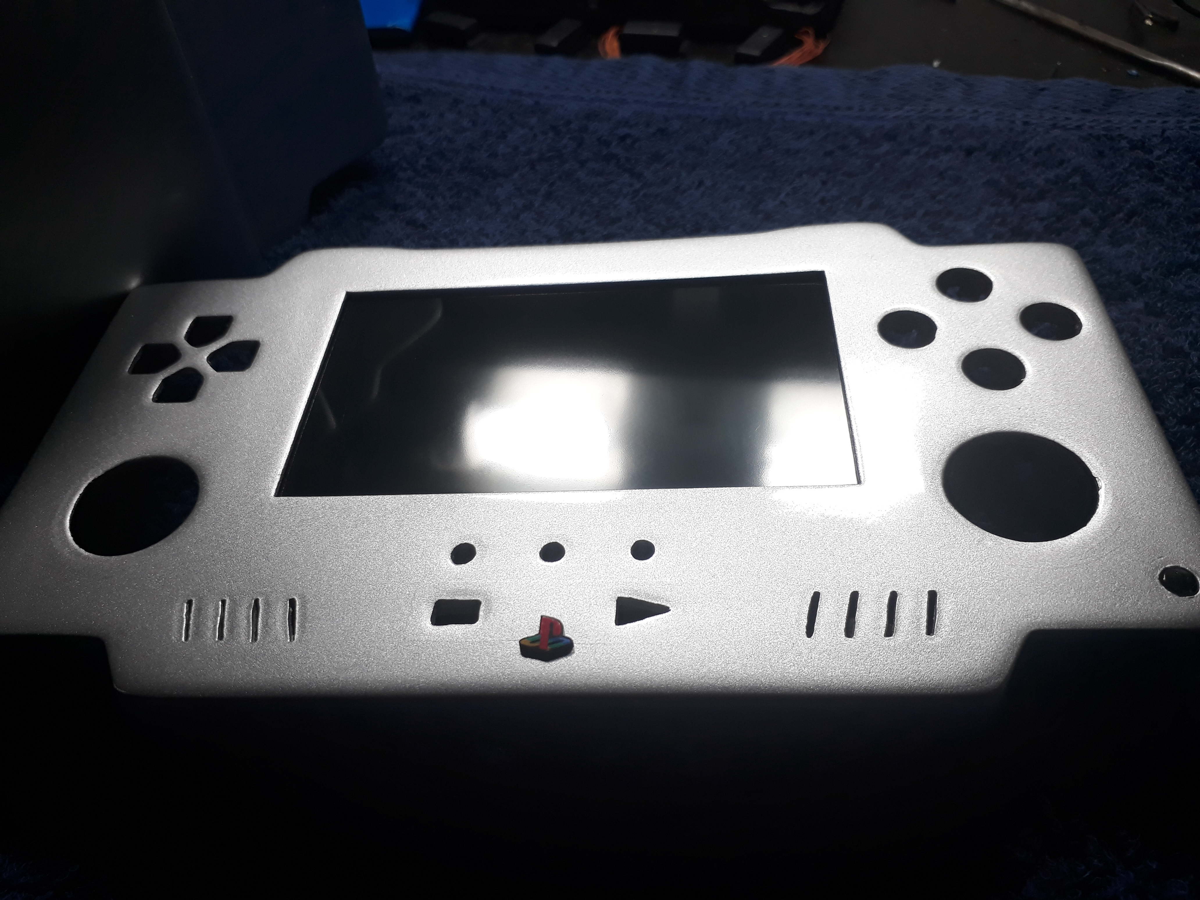

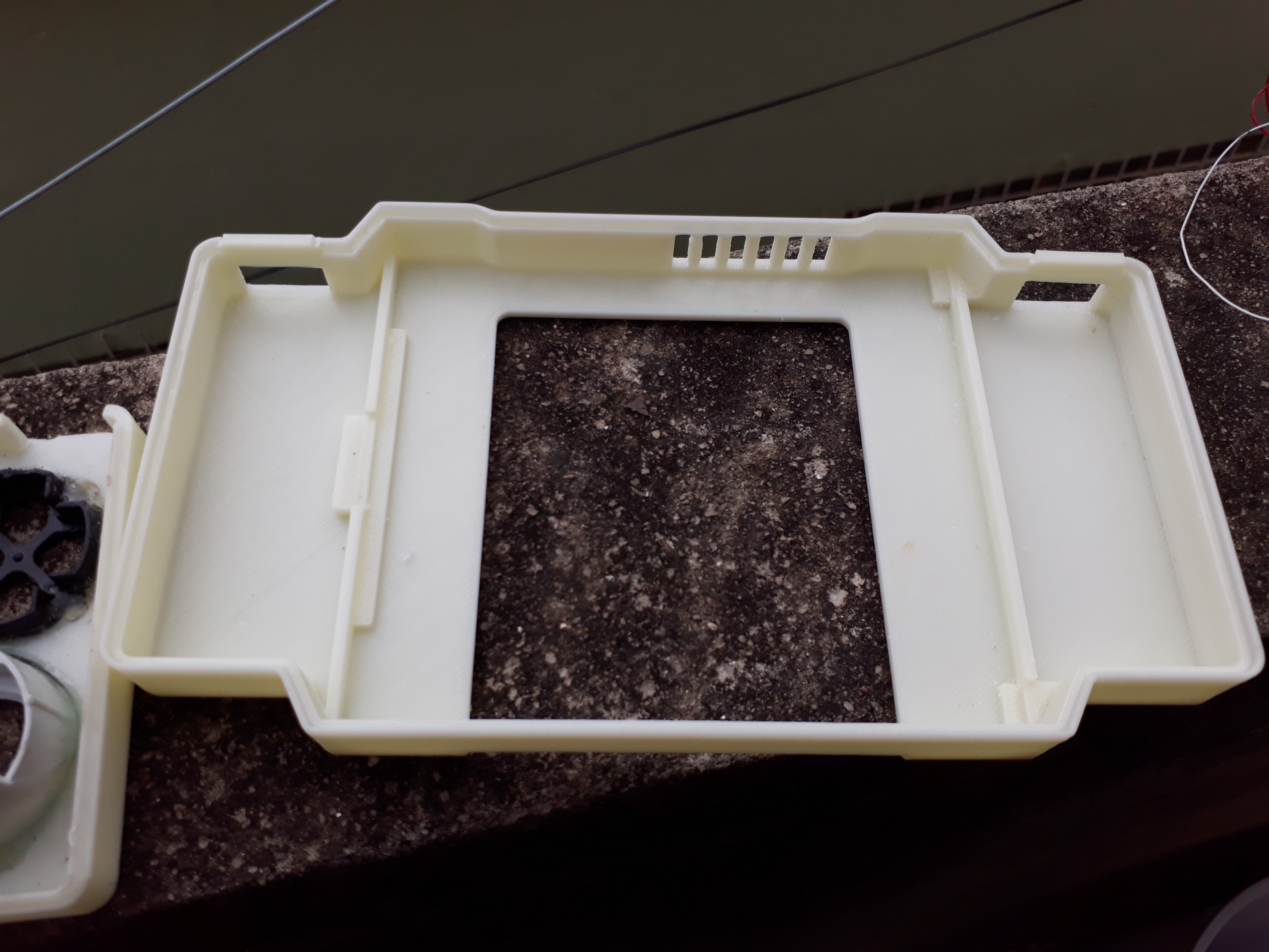

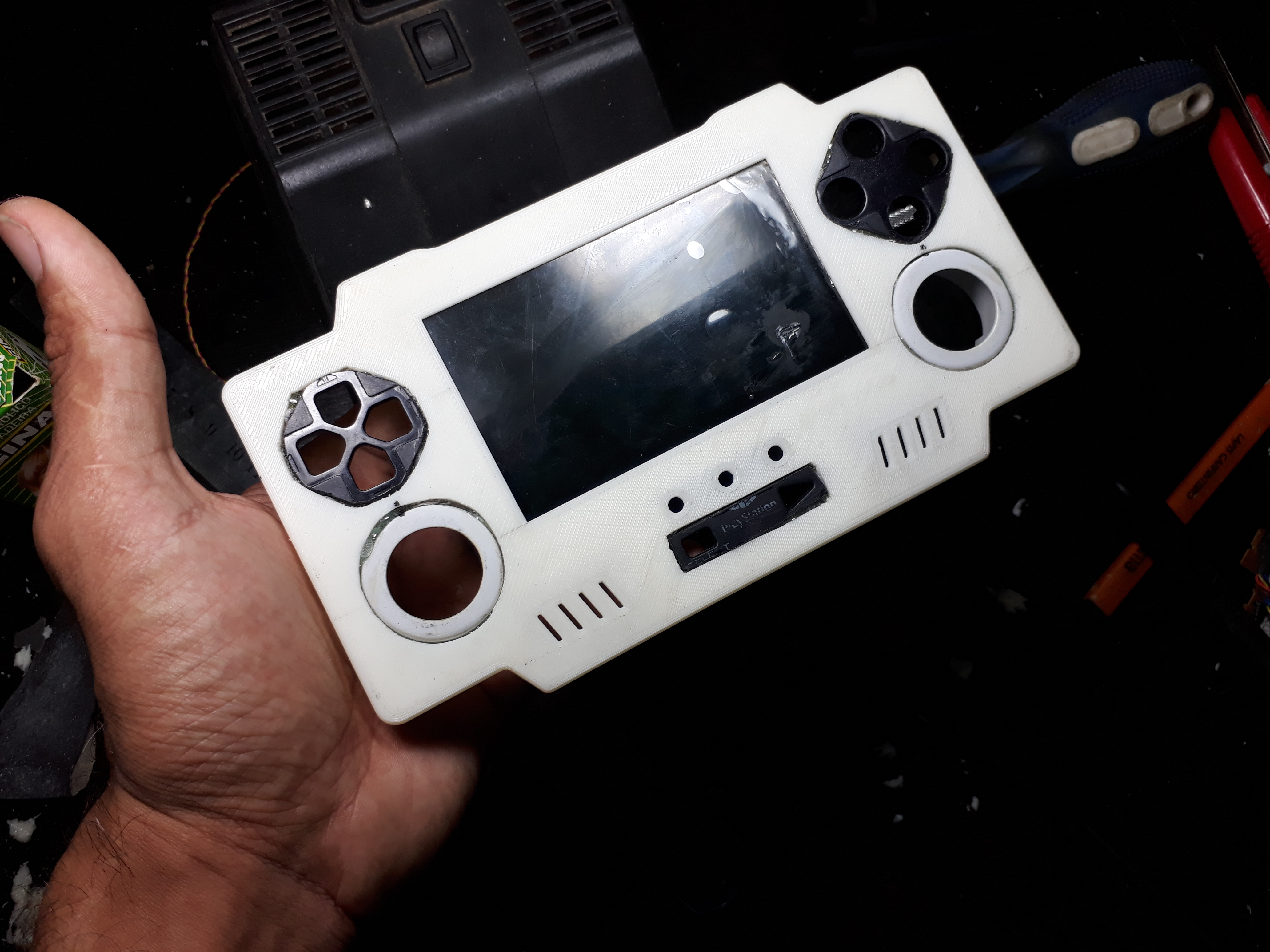

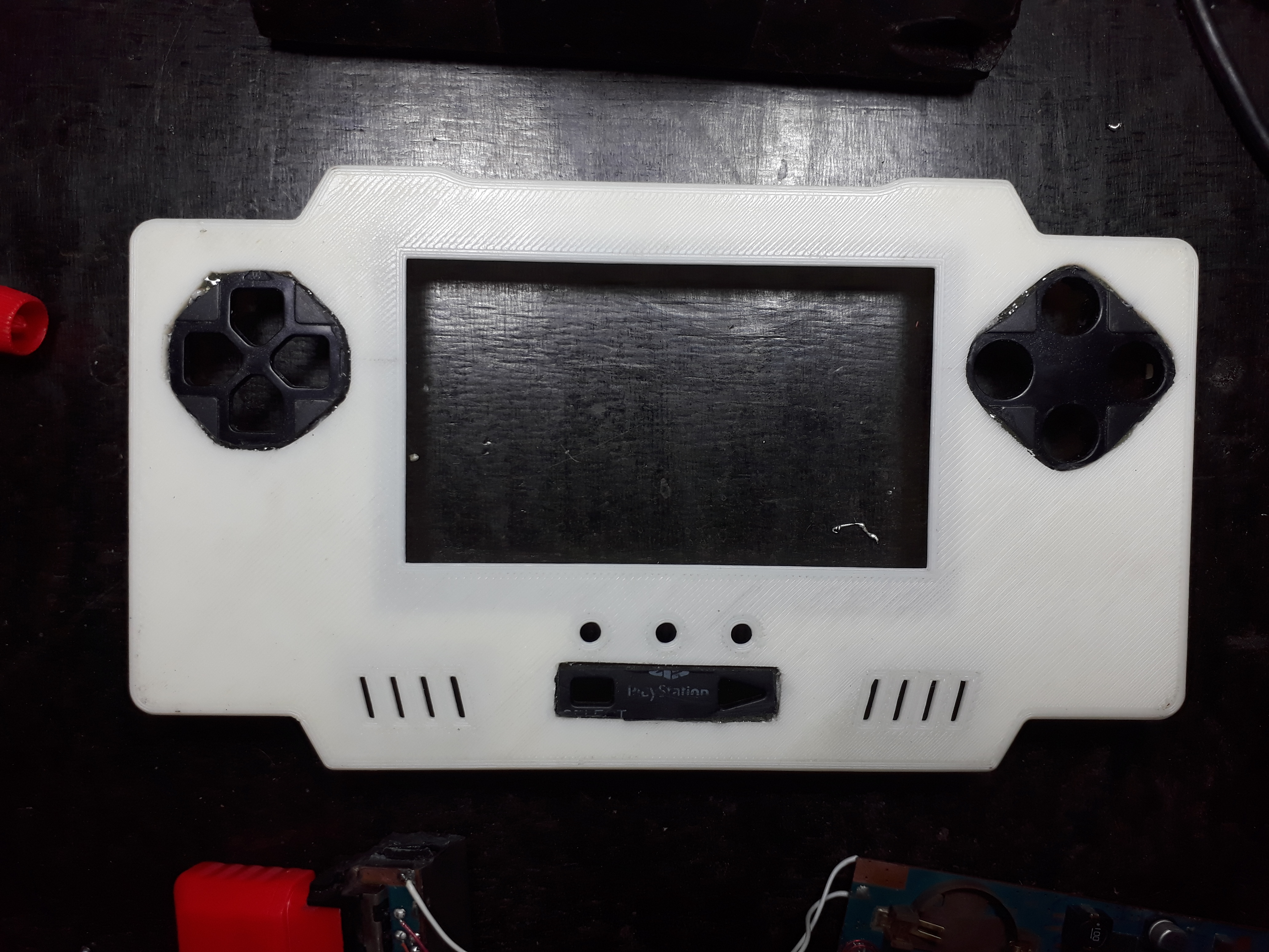

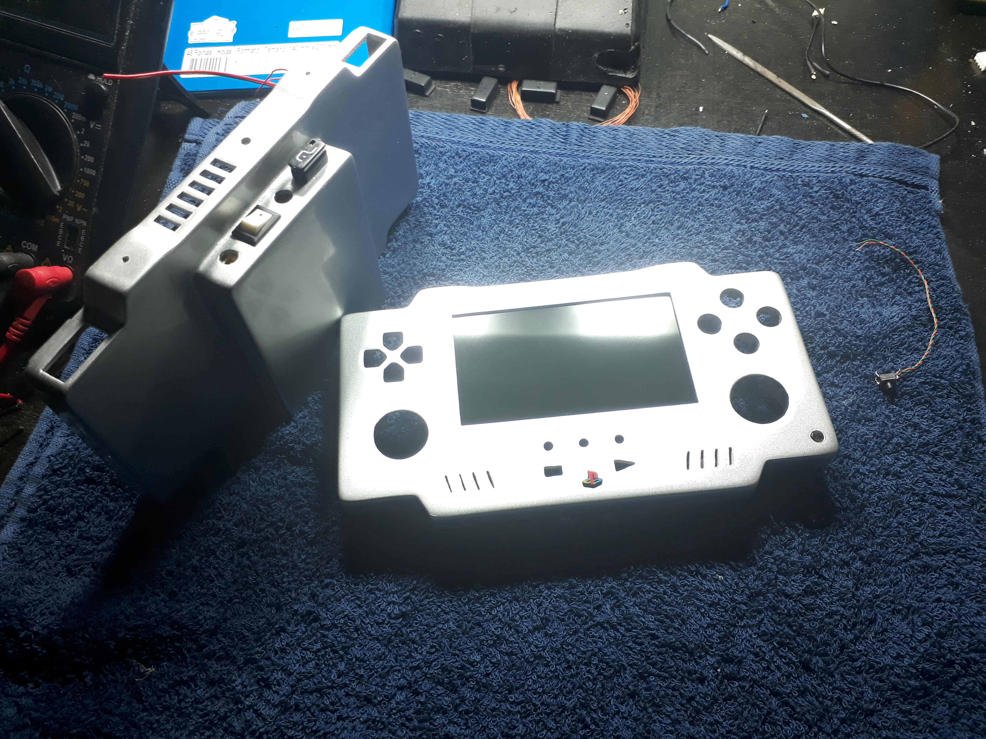

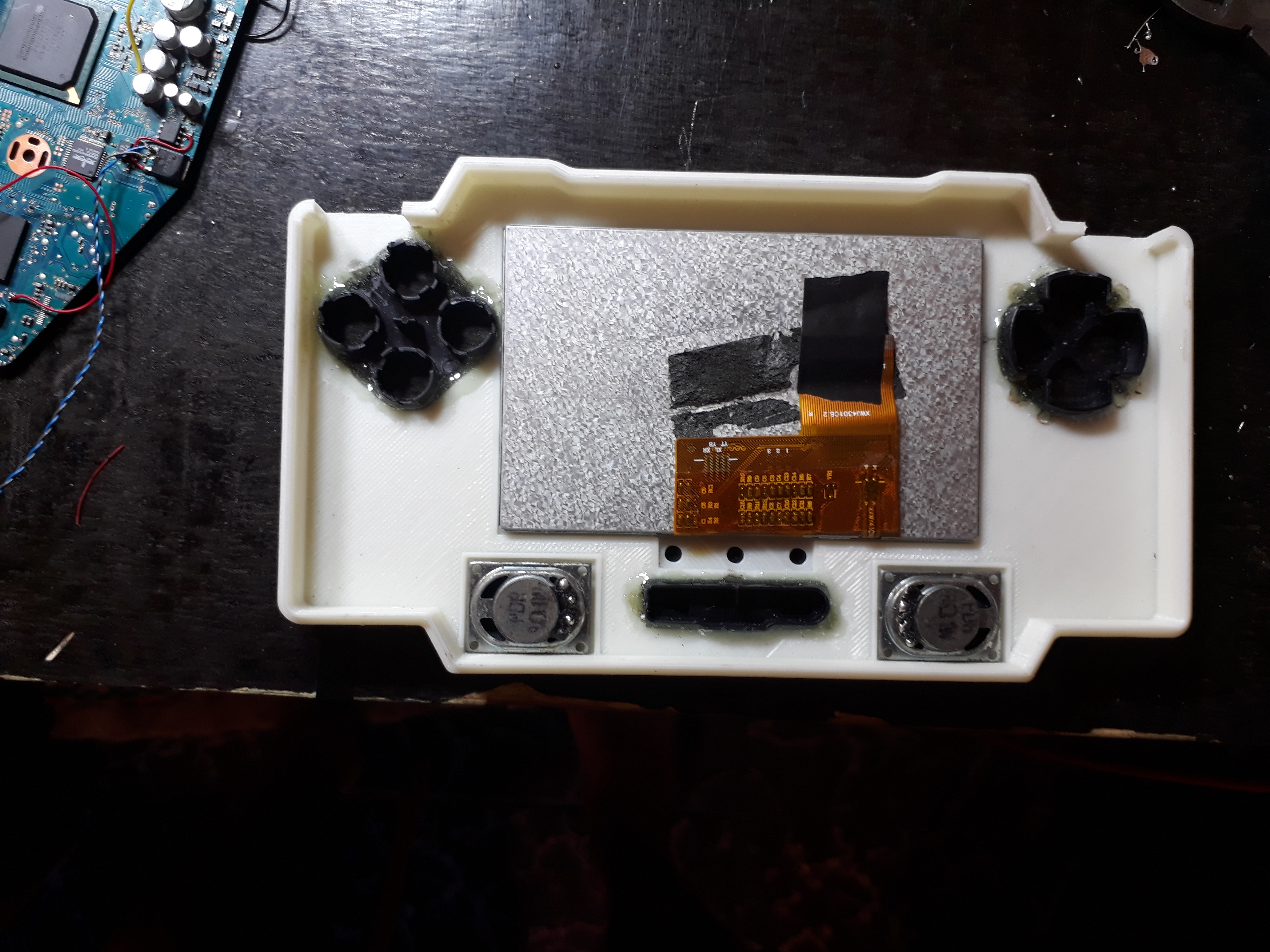

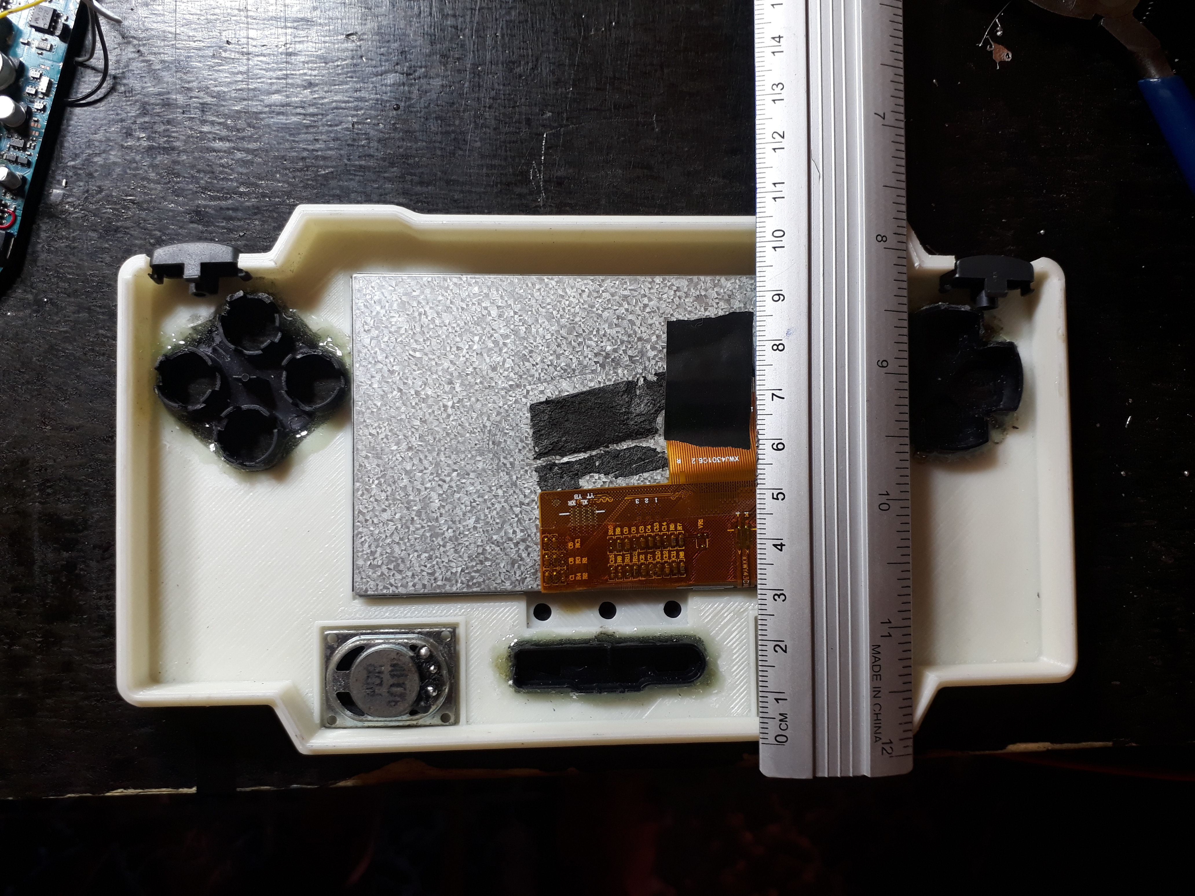

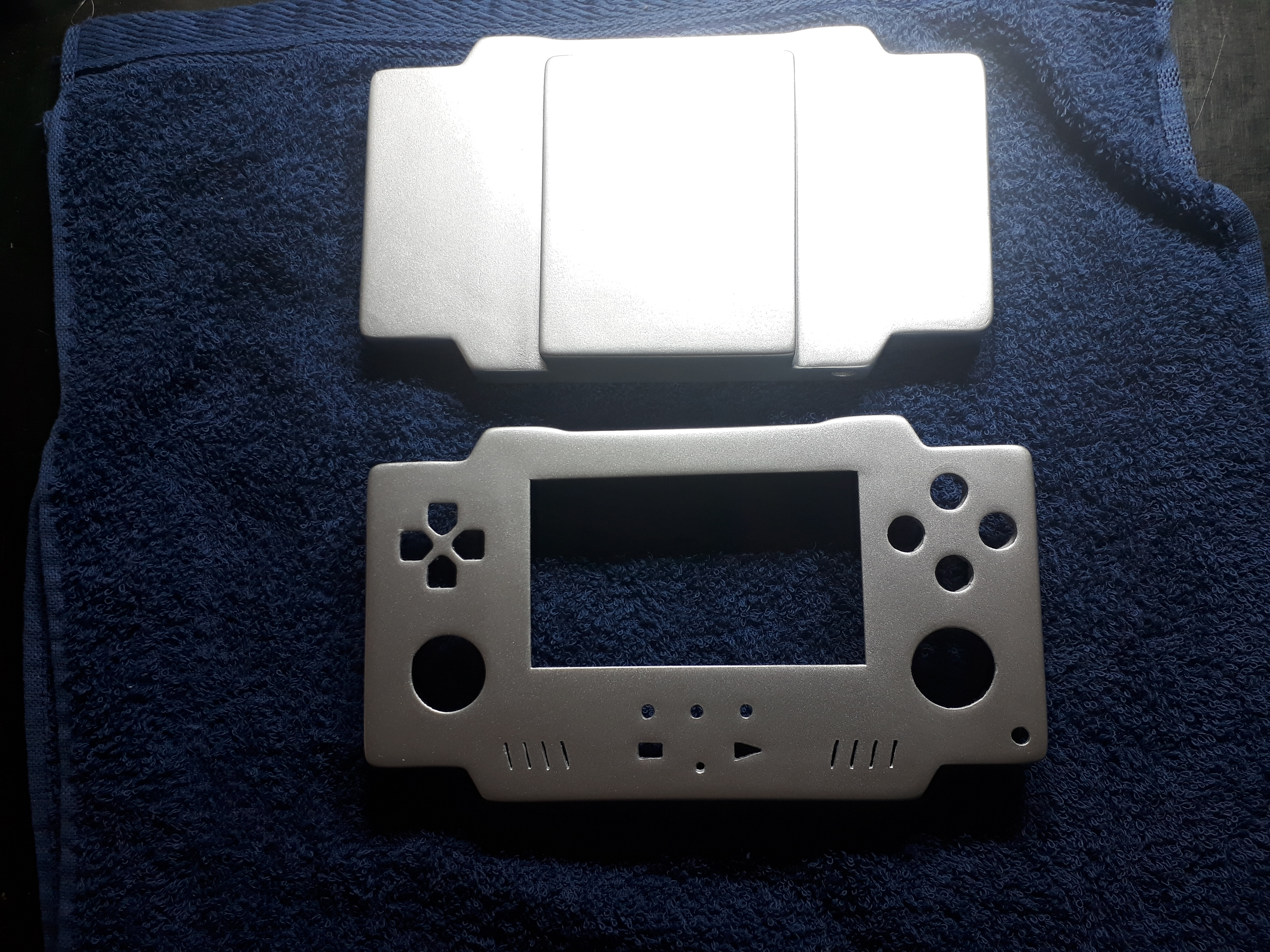

Hello friends! I am updating the project with new photos ... I just finished painting the case, I'm now mounting the laptop ...

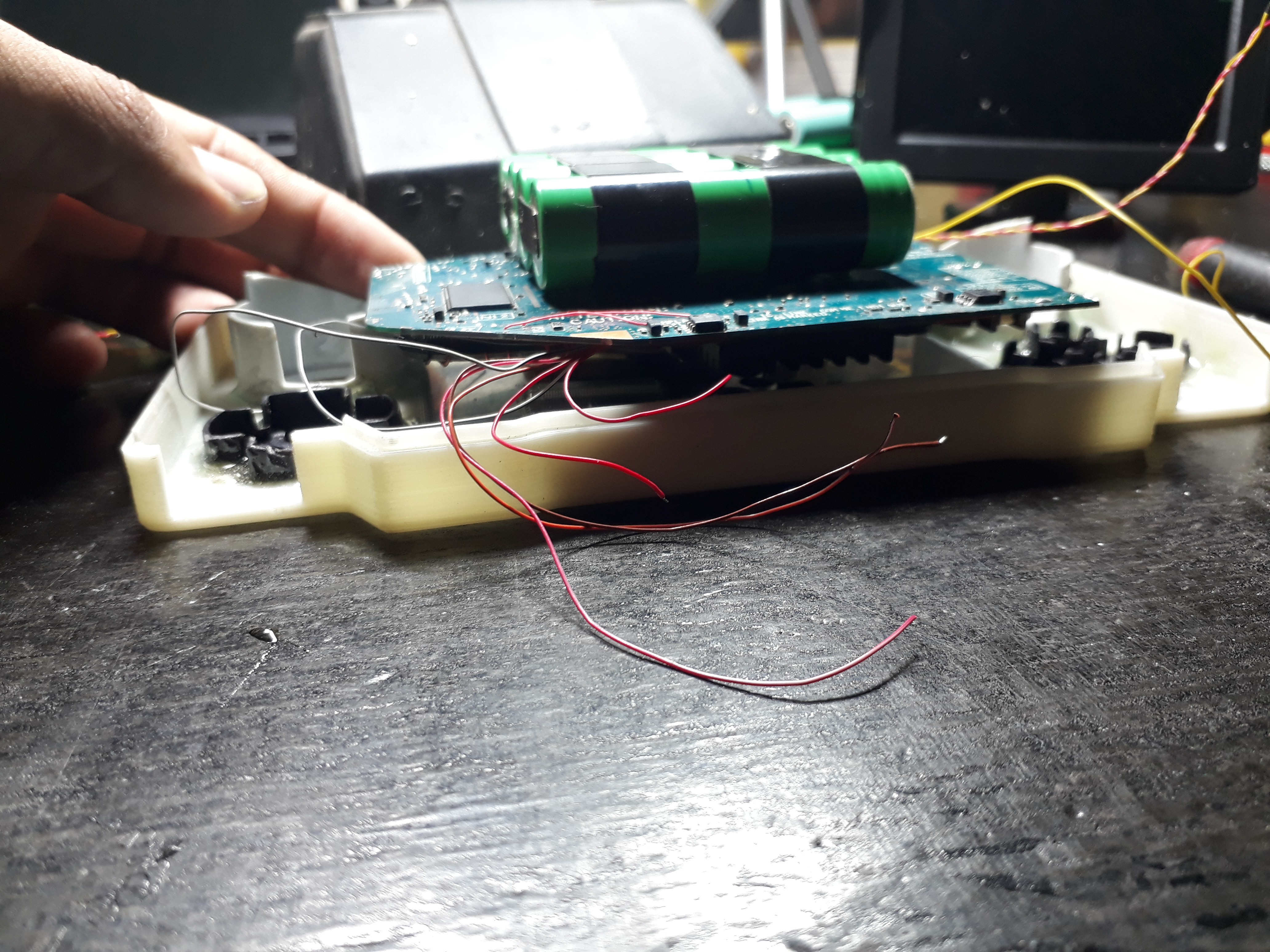

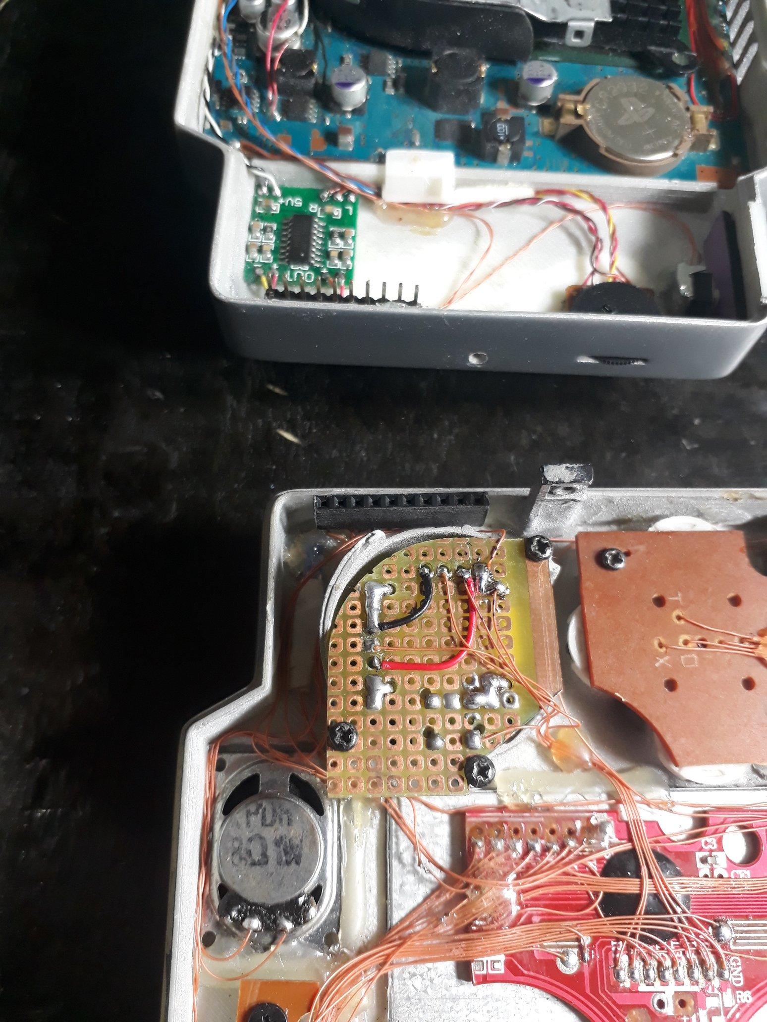

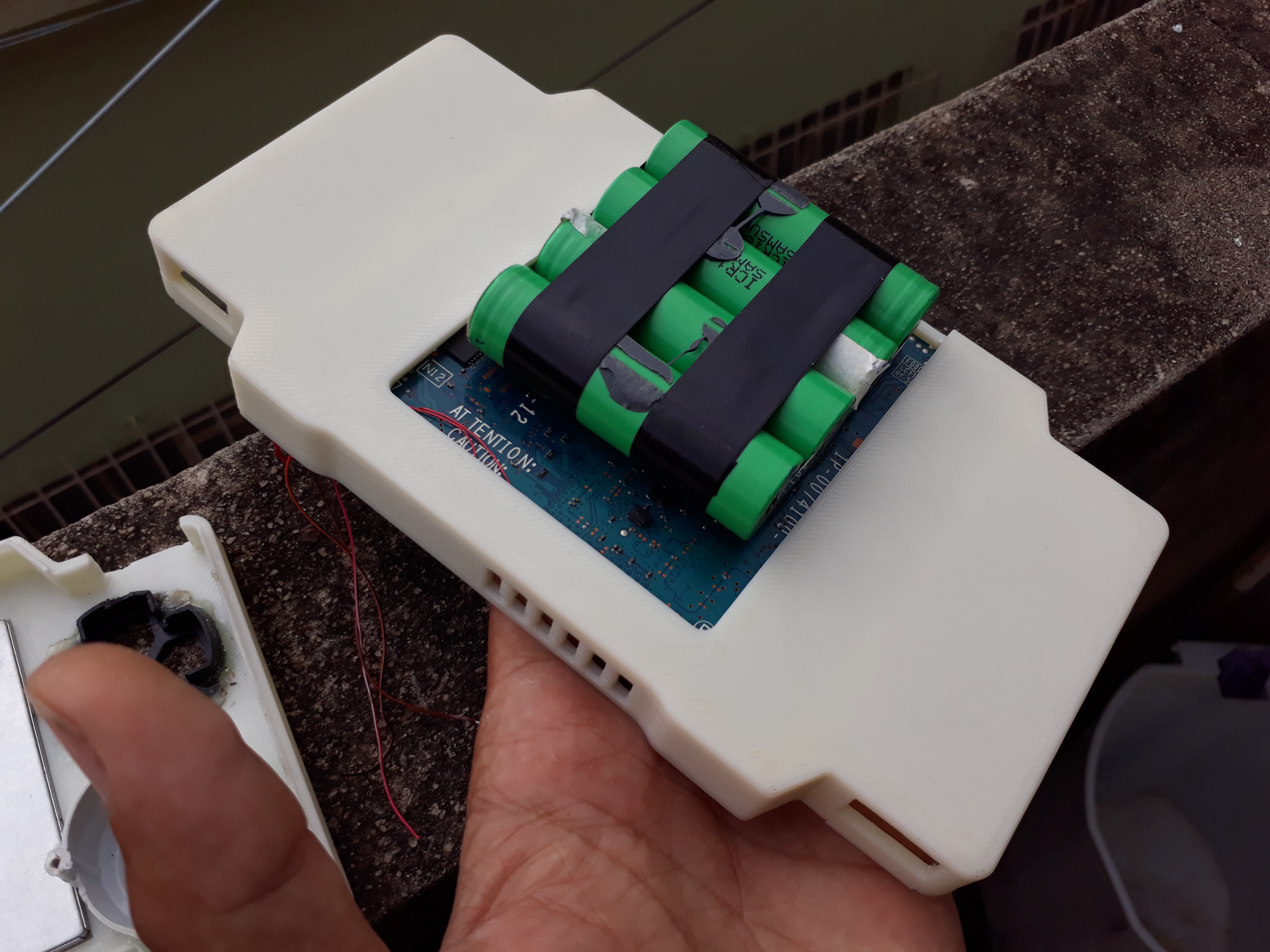

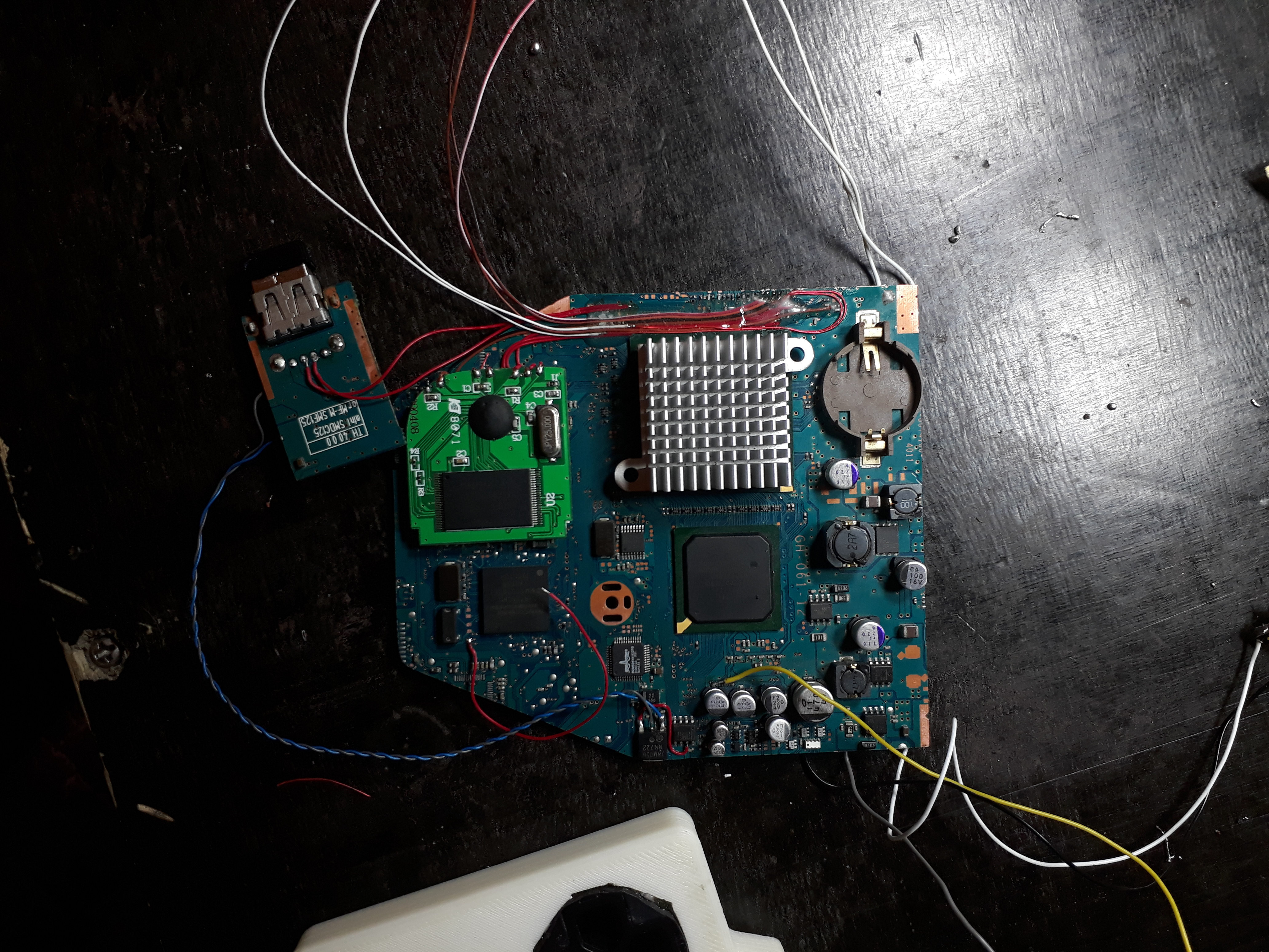

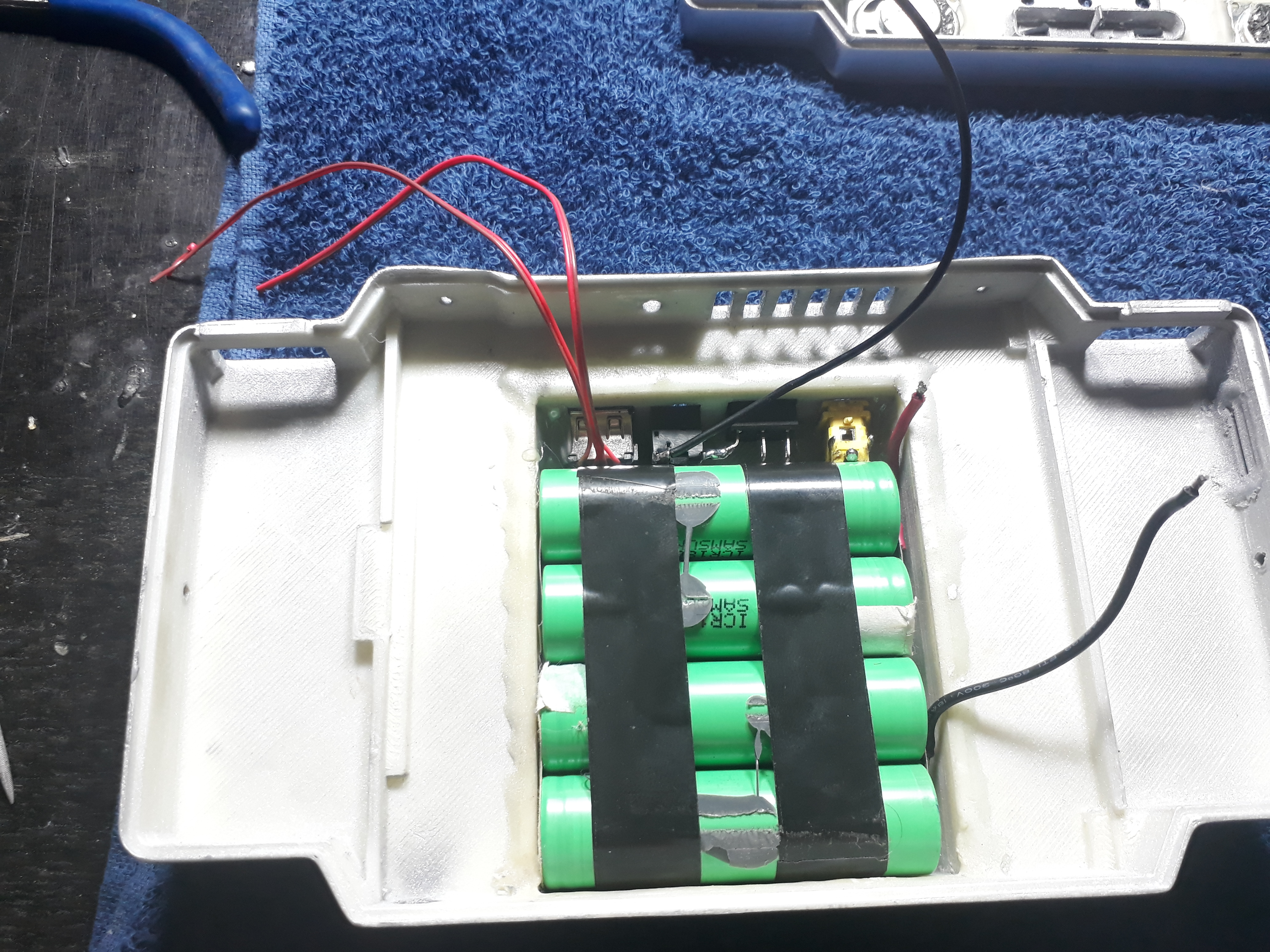

Batteries, USB port, power port, charging port and power switch ...

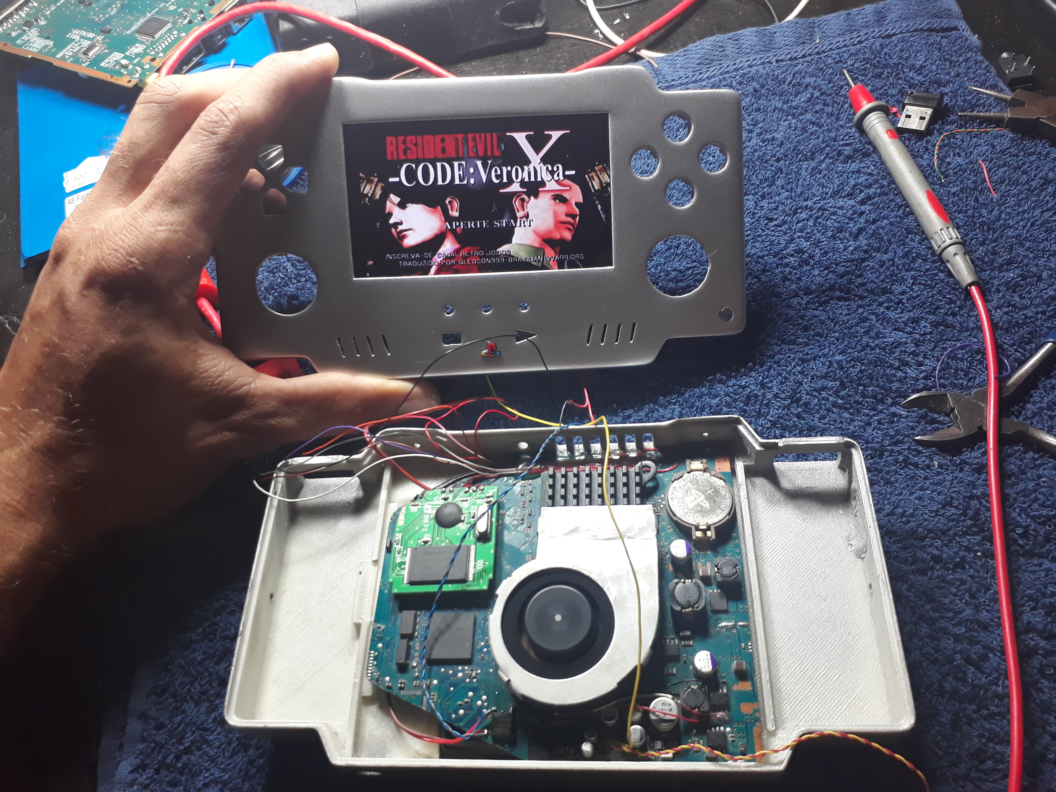

Resident Evil Code: Veronica, one of my favorites!

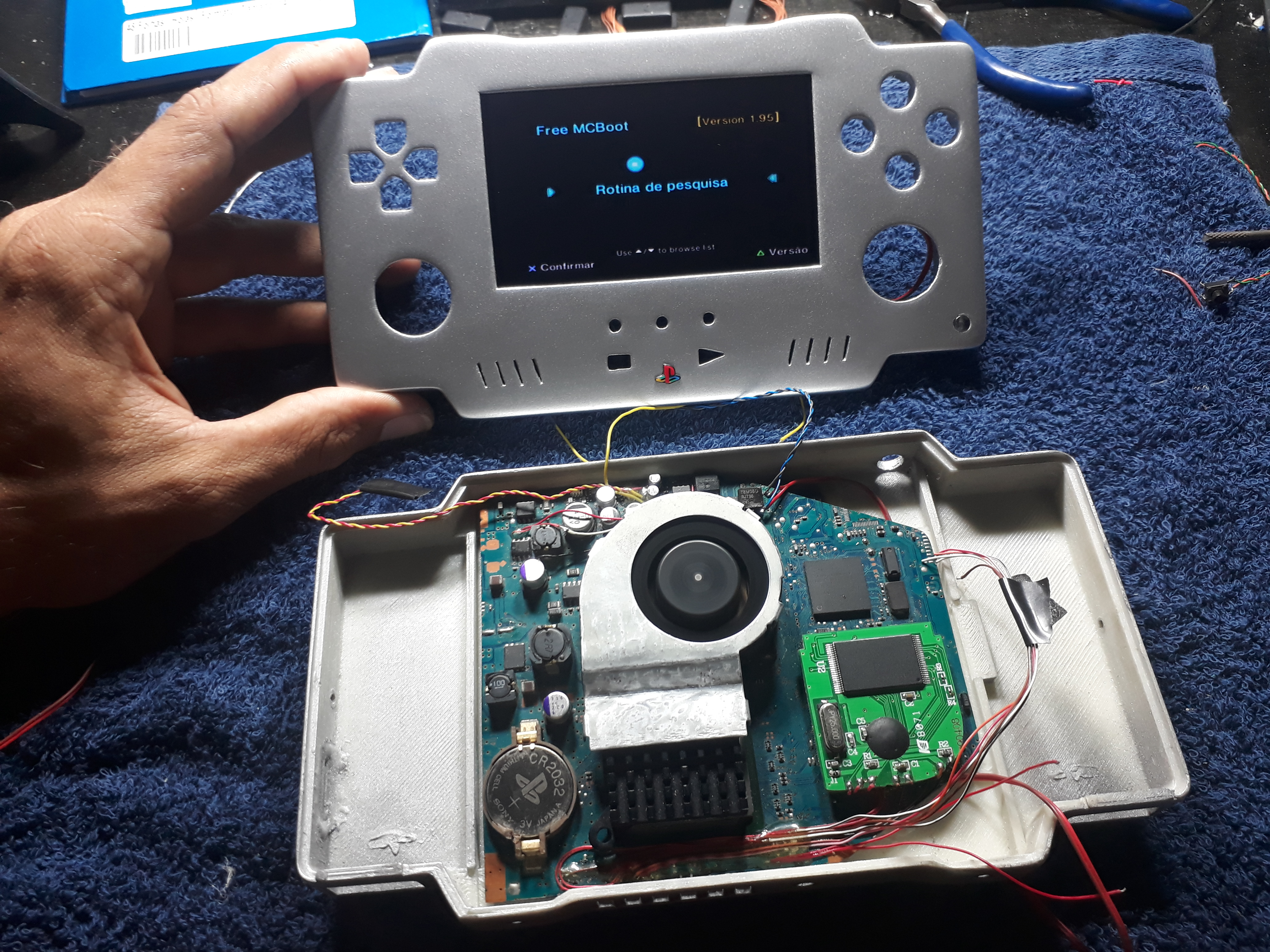

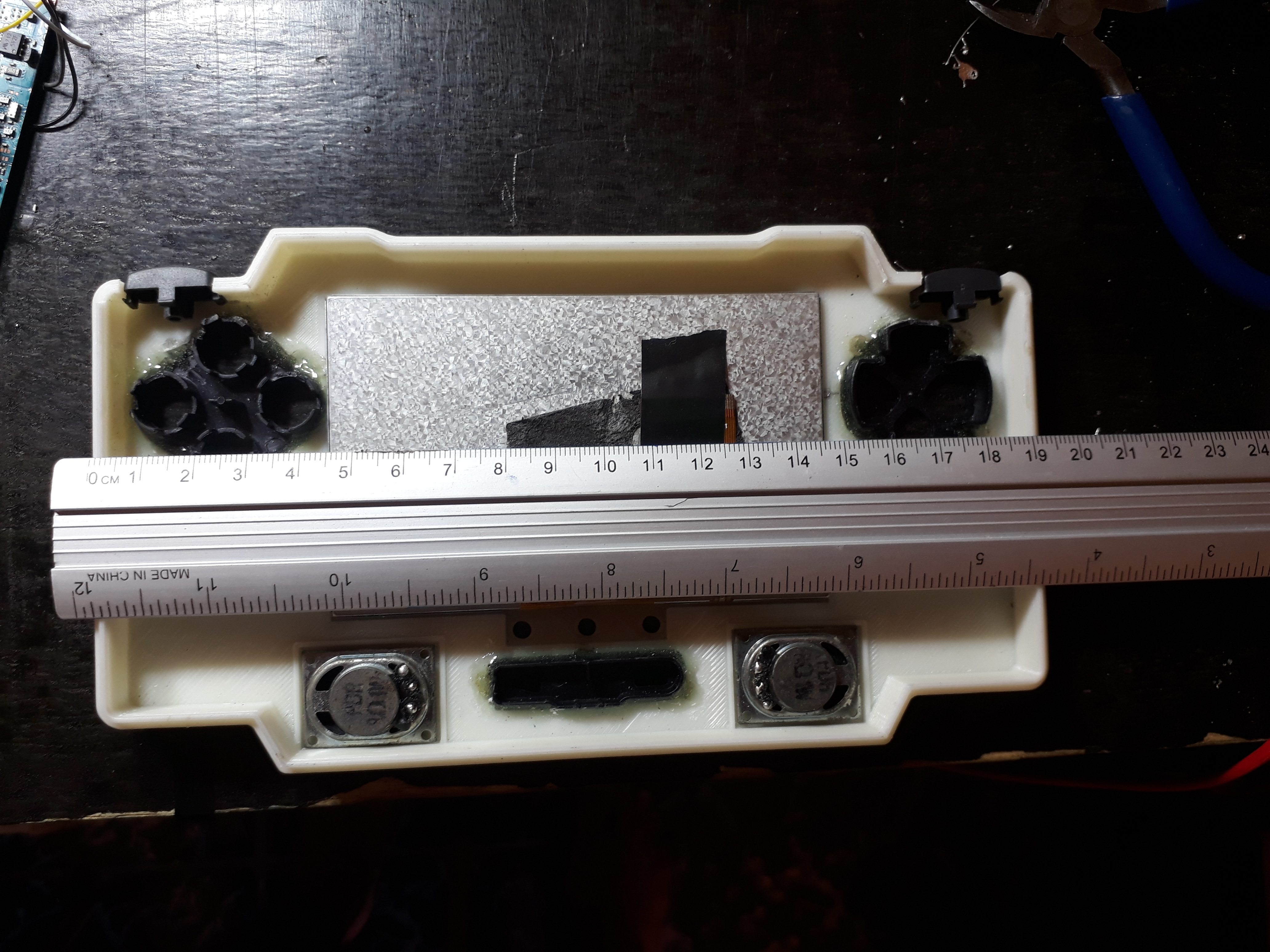

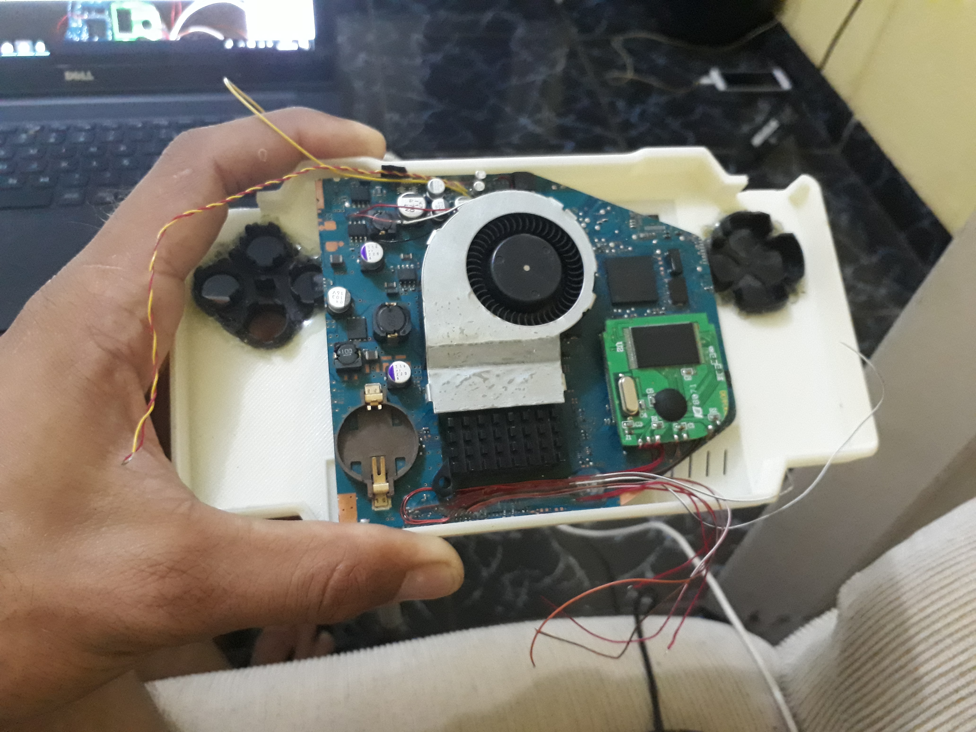

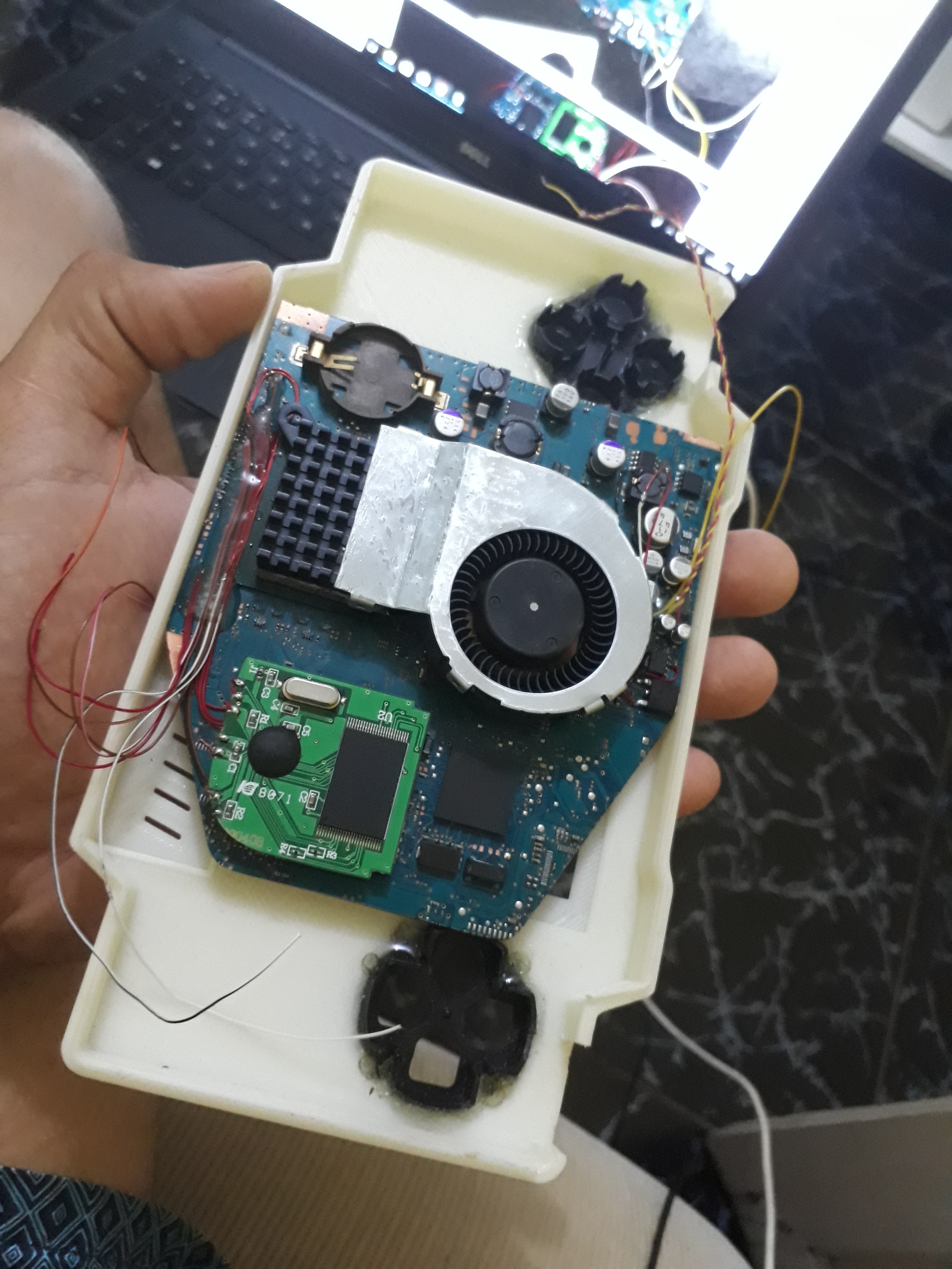

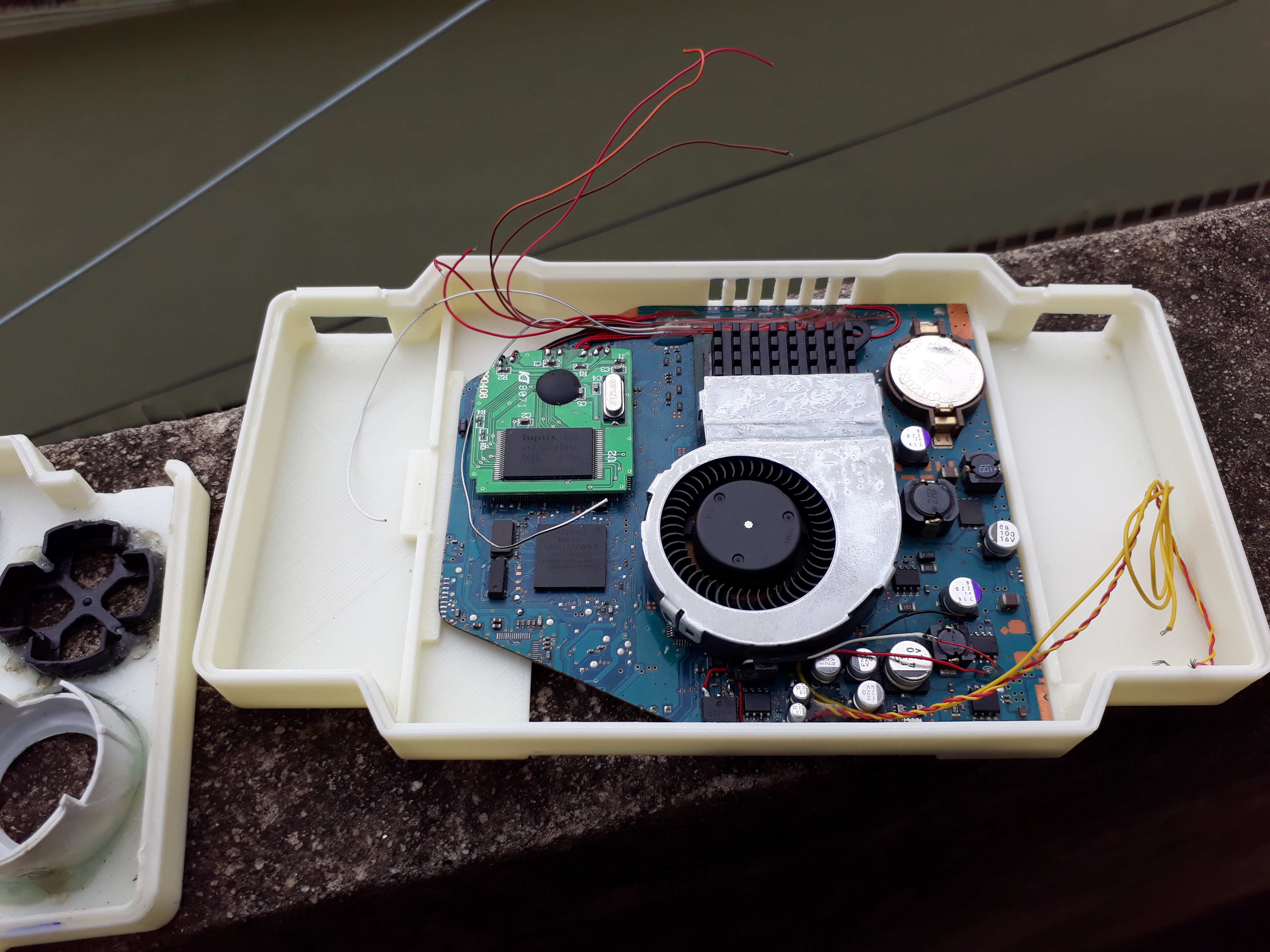

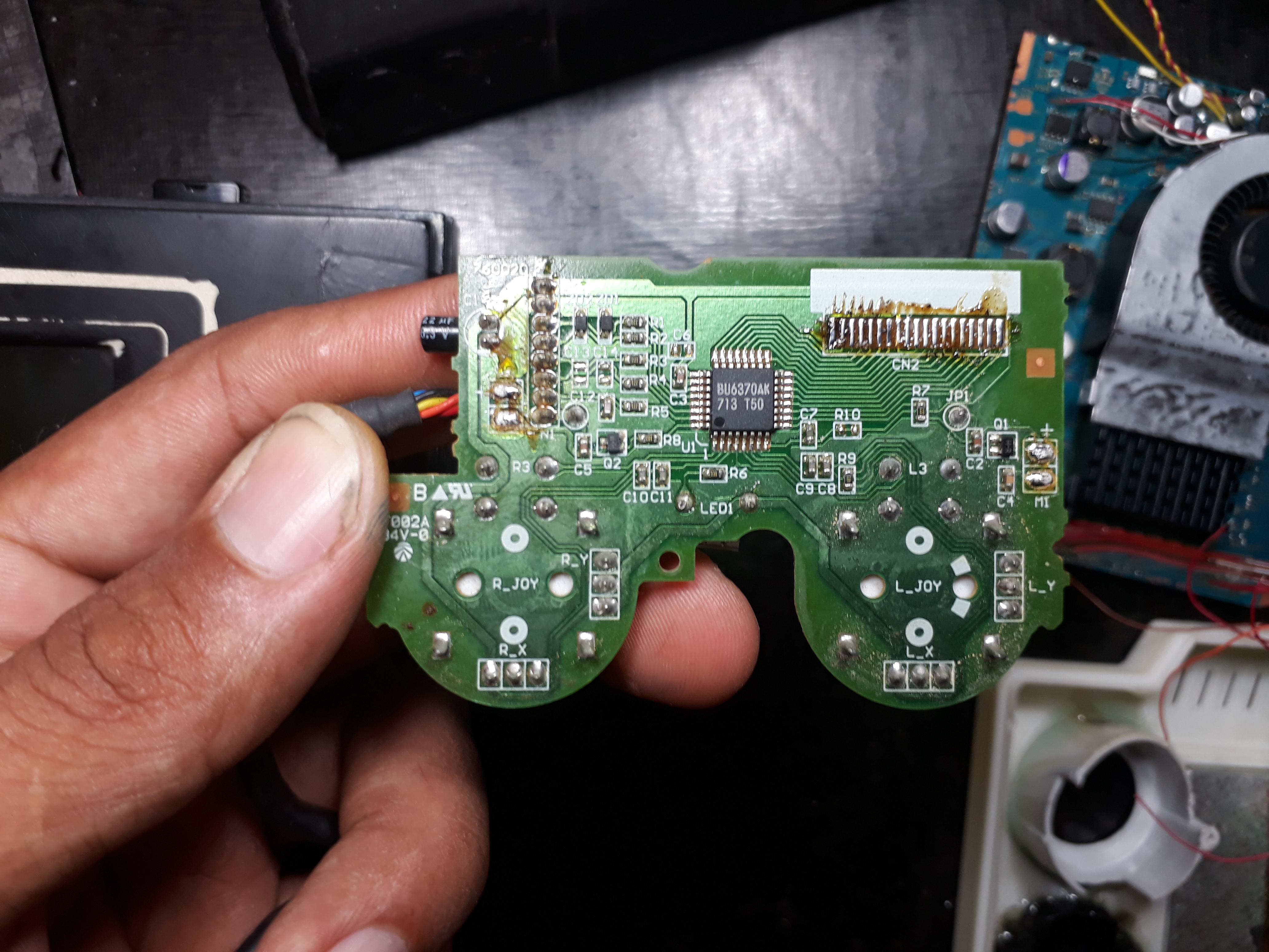

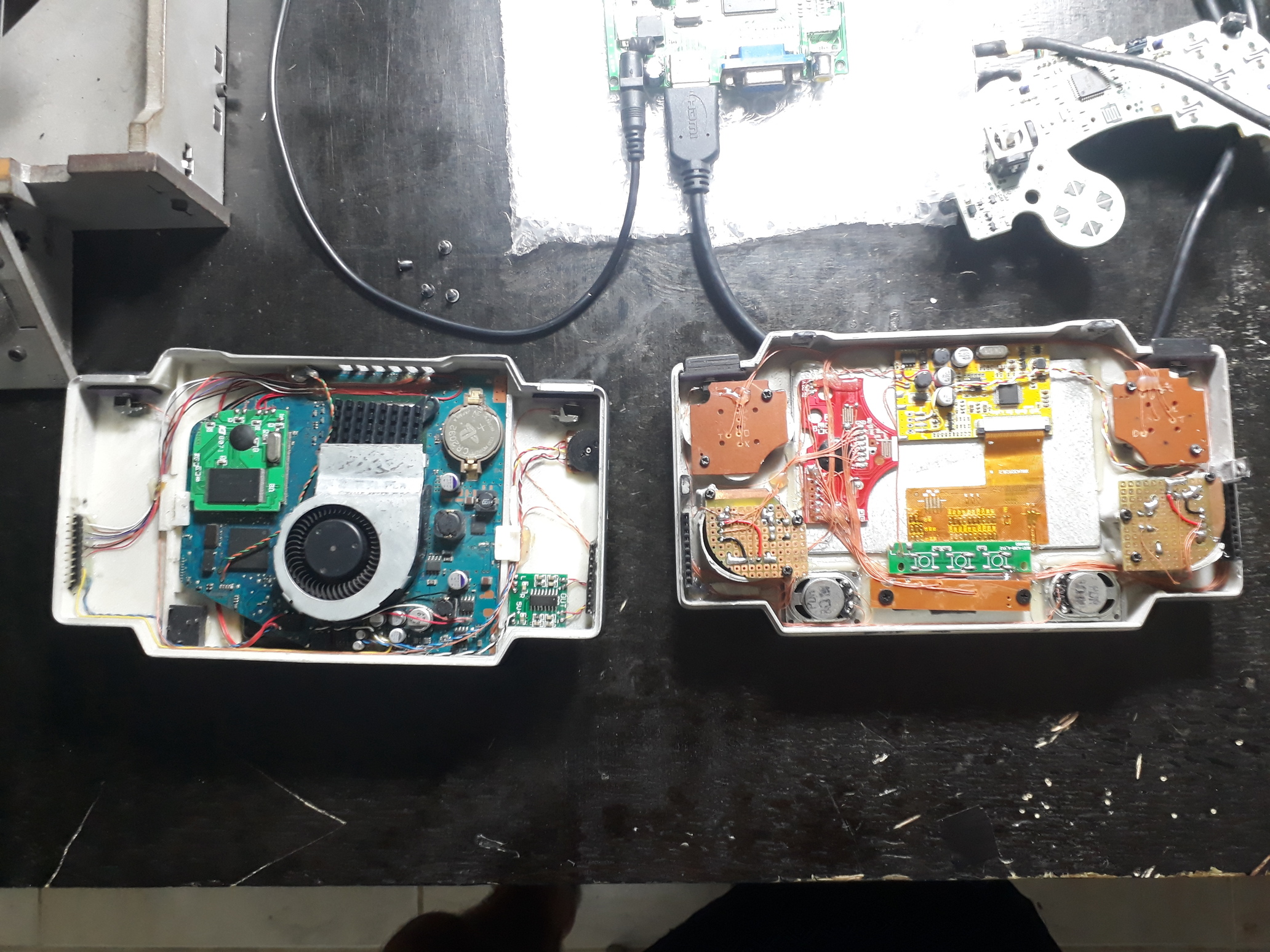

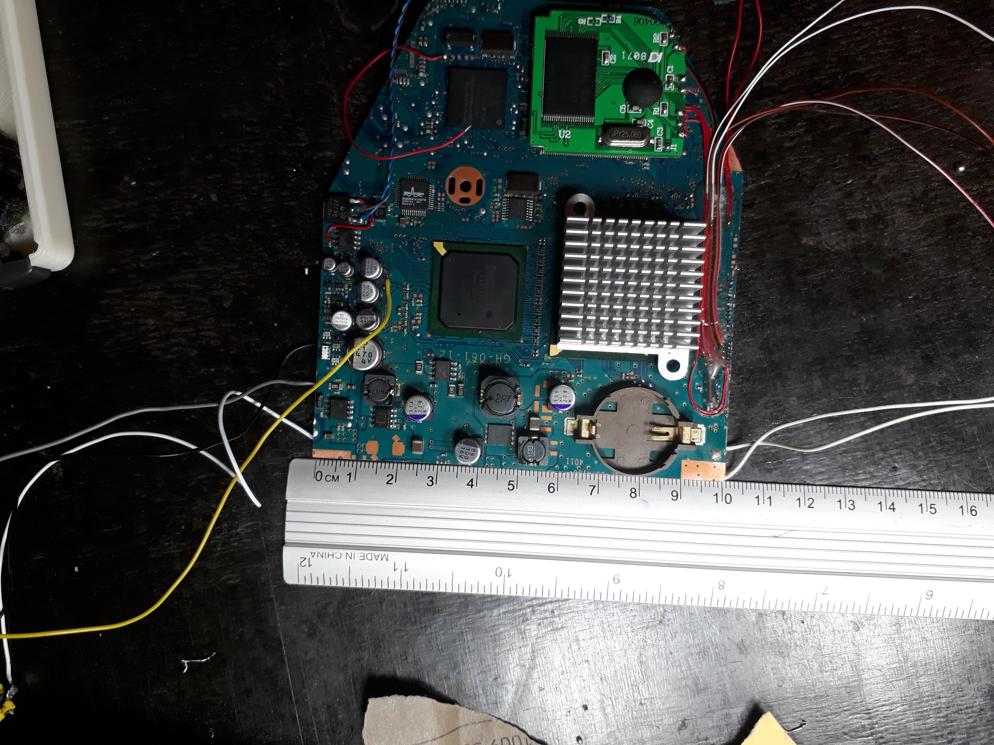

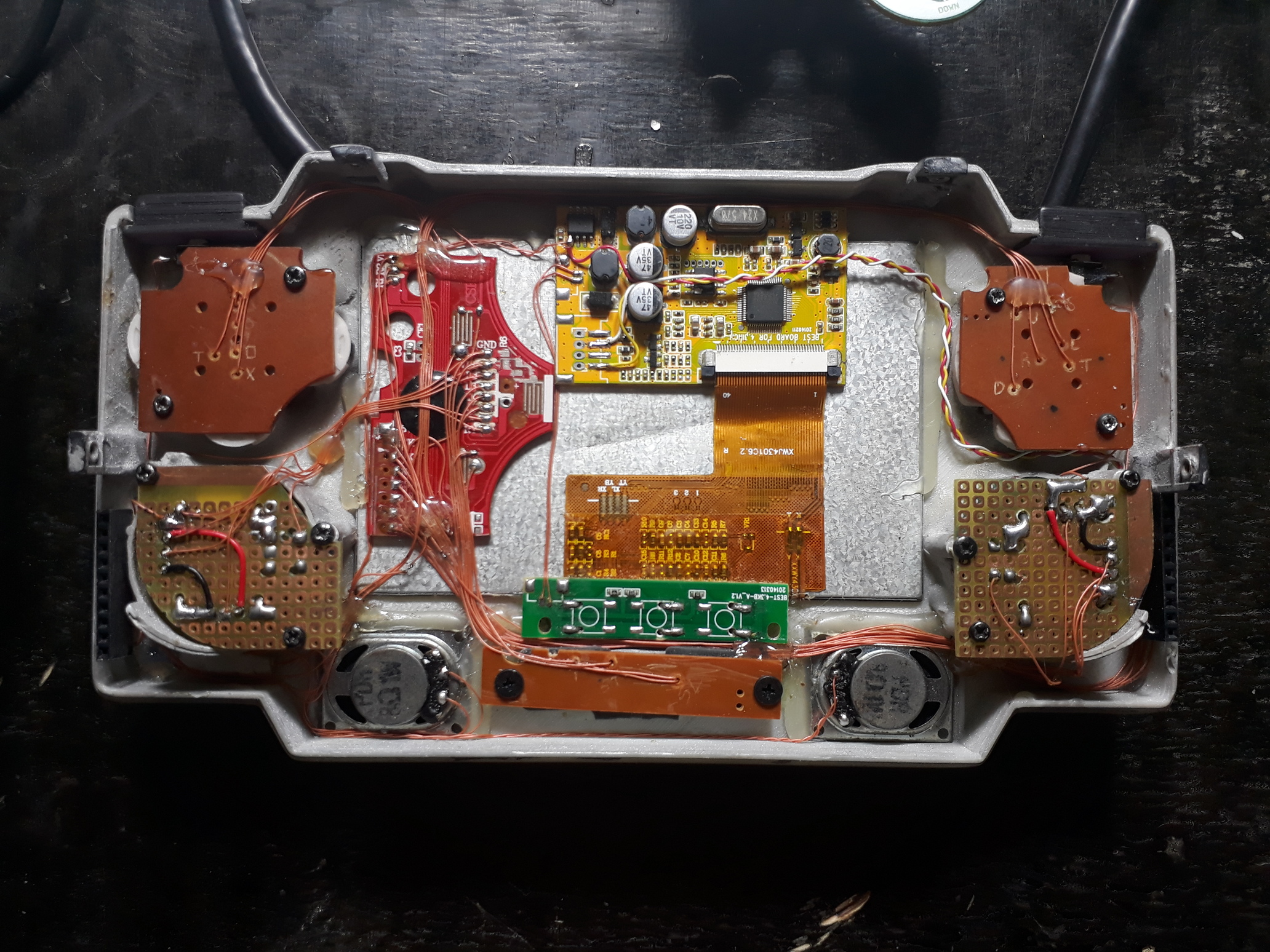

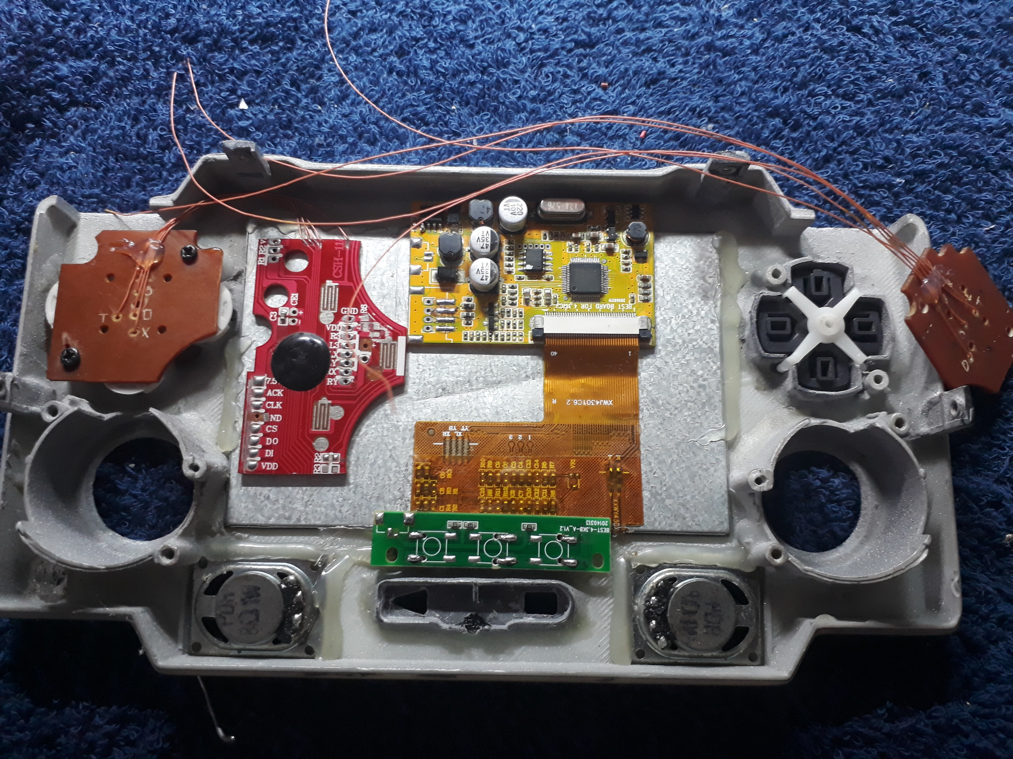

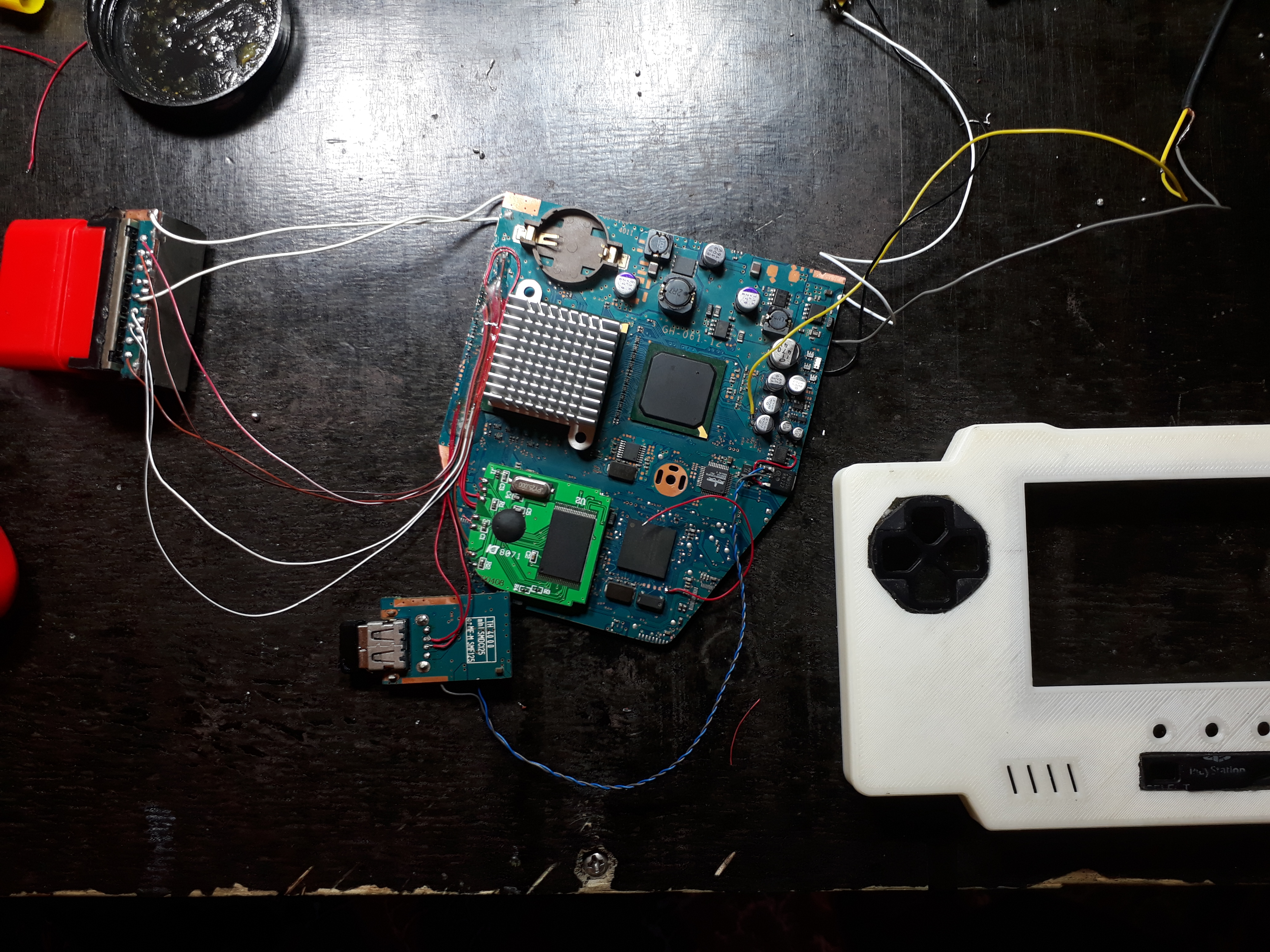

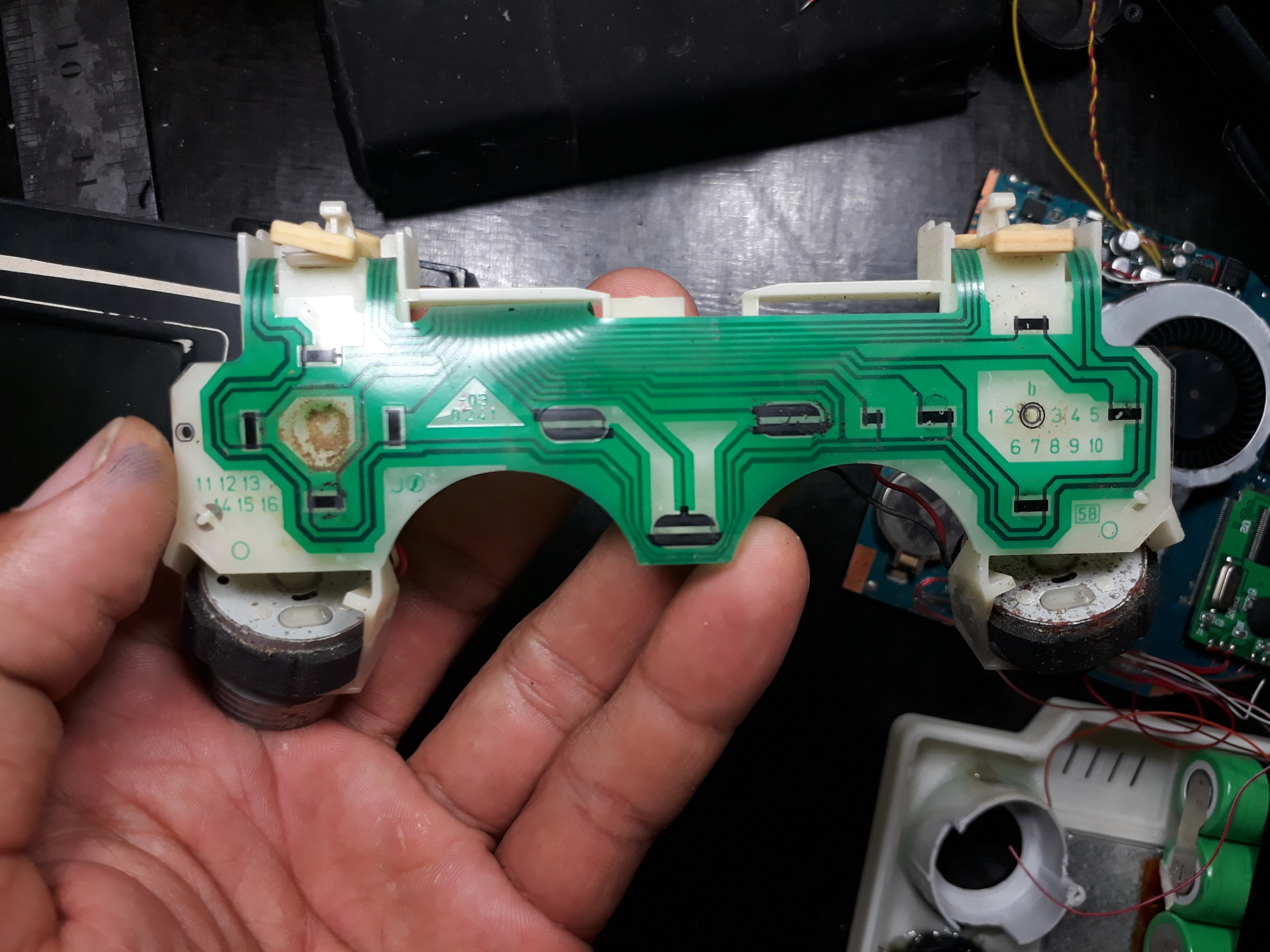

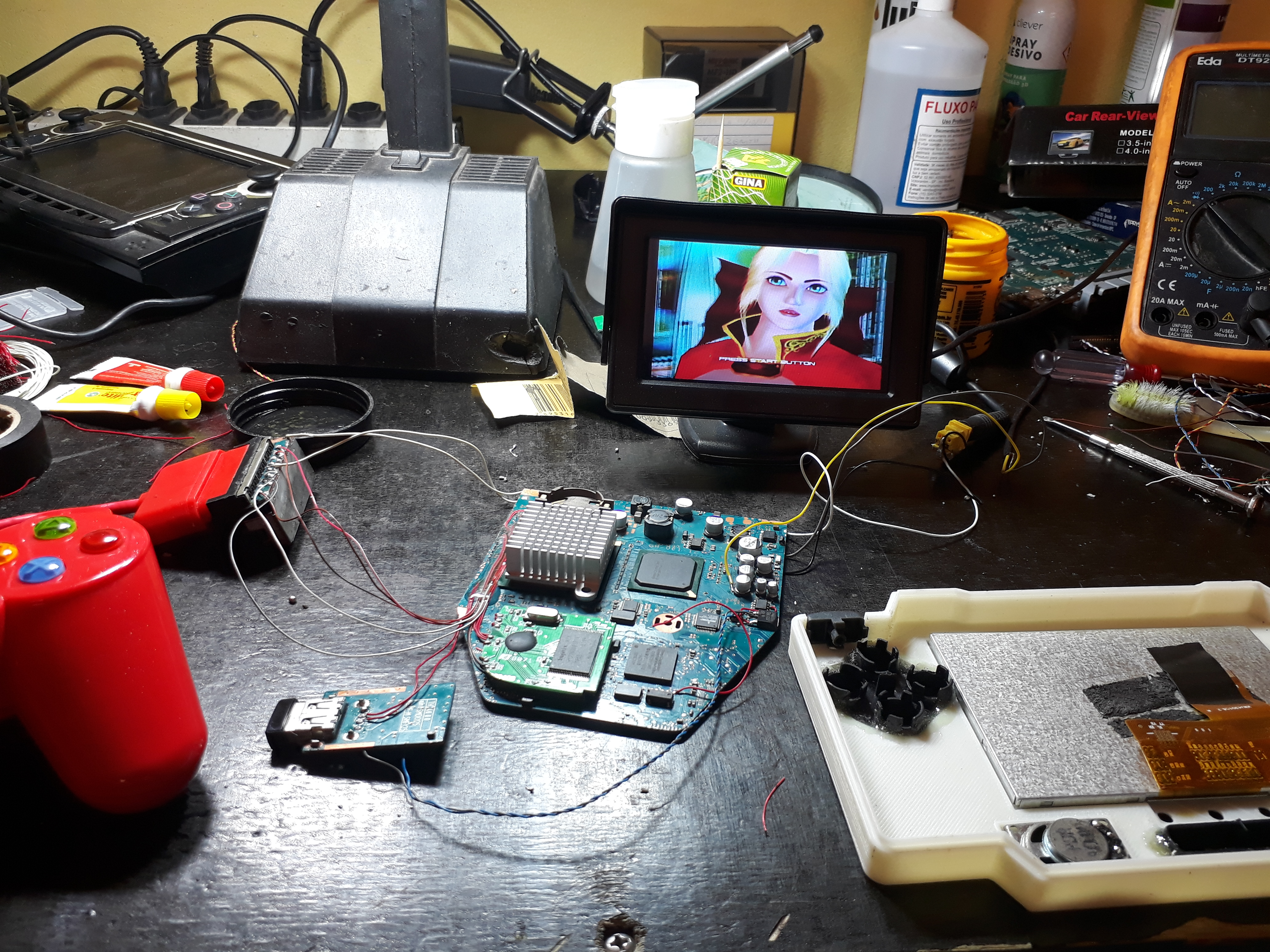

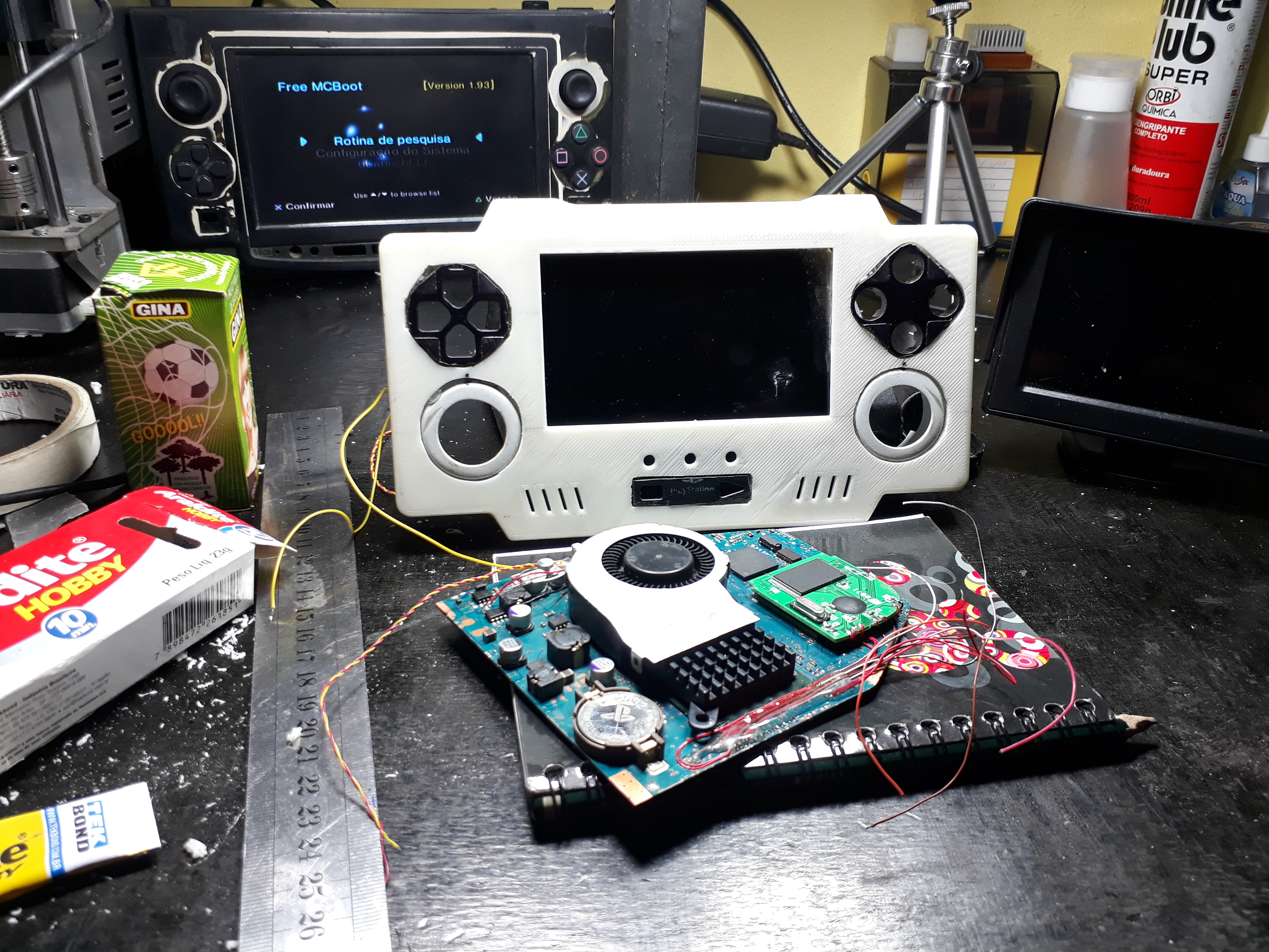

Pictures of assembly of controls, other parts and wiring ...
Mess =)

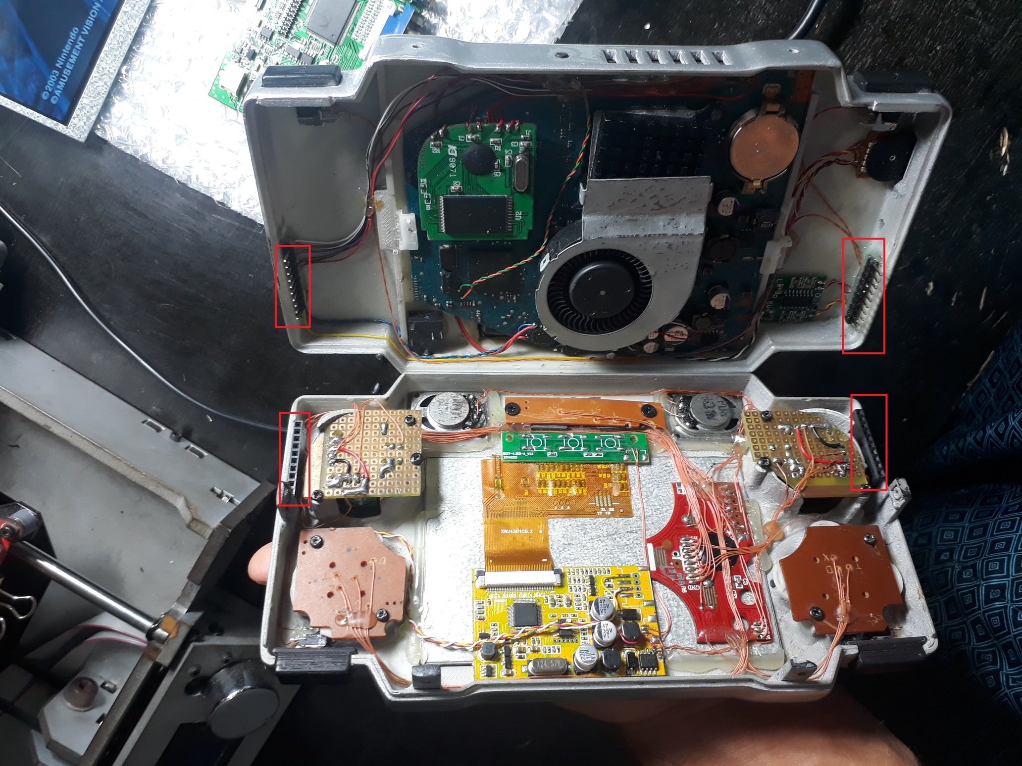

I mounted a docking system so it does not get through wires between the two parts, any maintenance with the laptop open I use arduino jumpers ...
I highlighted the fittings in red ...

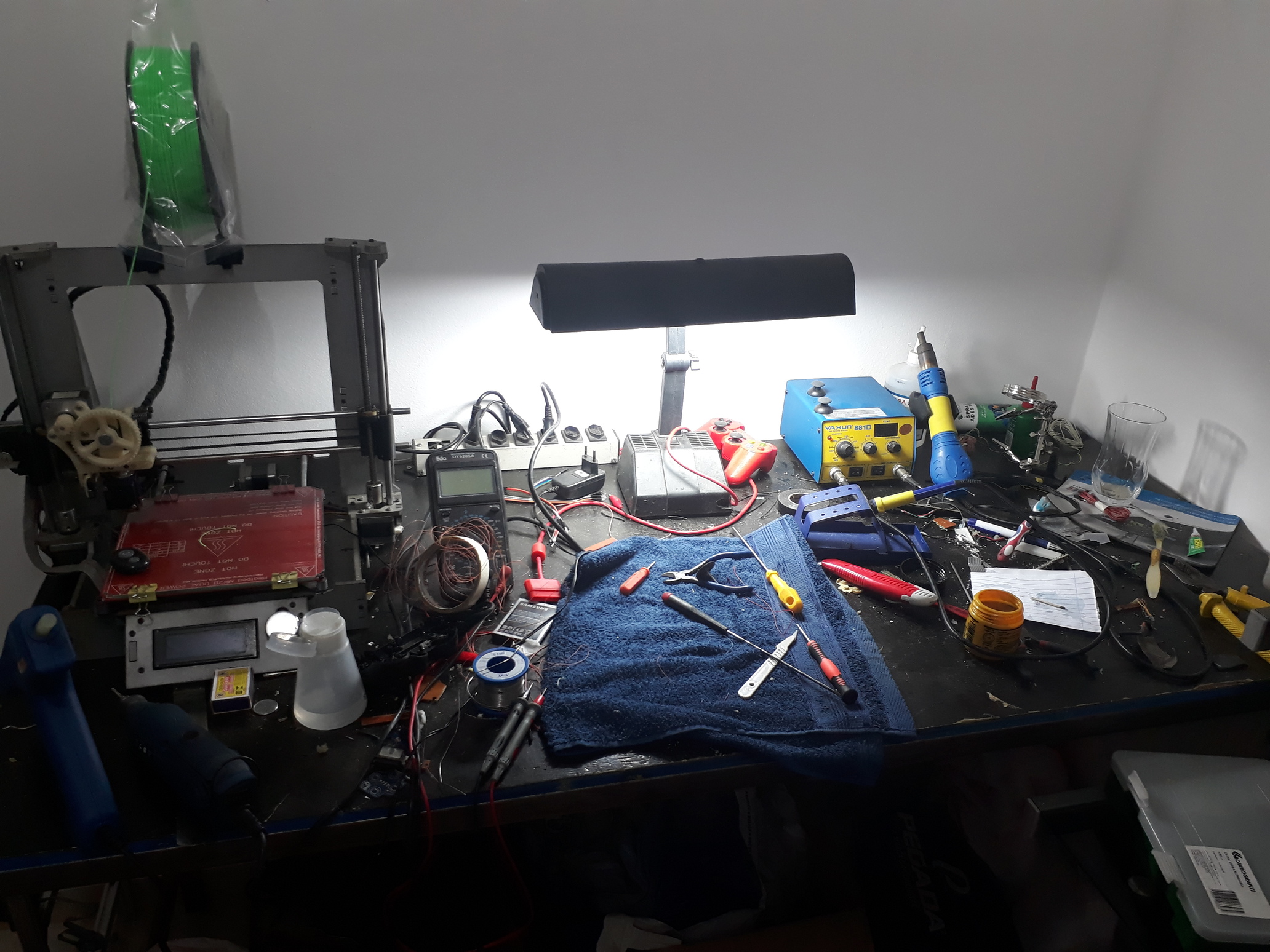

My desk was a big mess ...

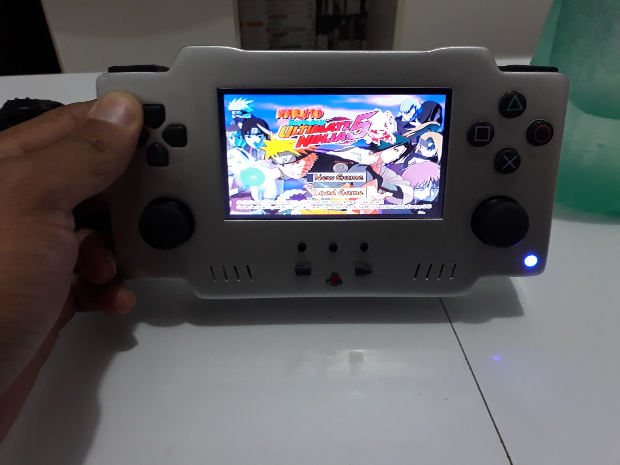

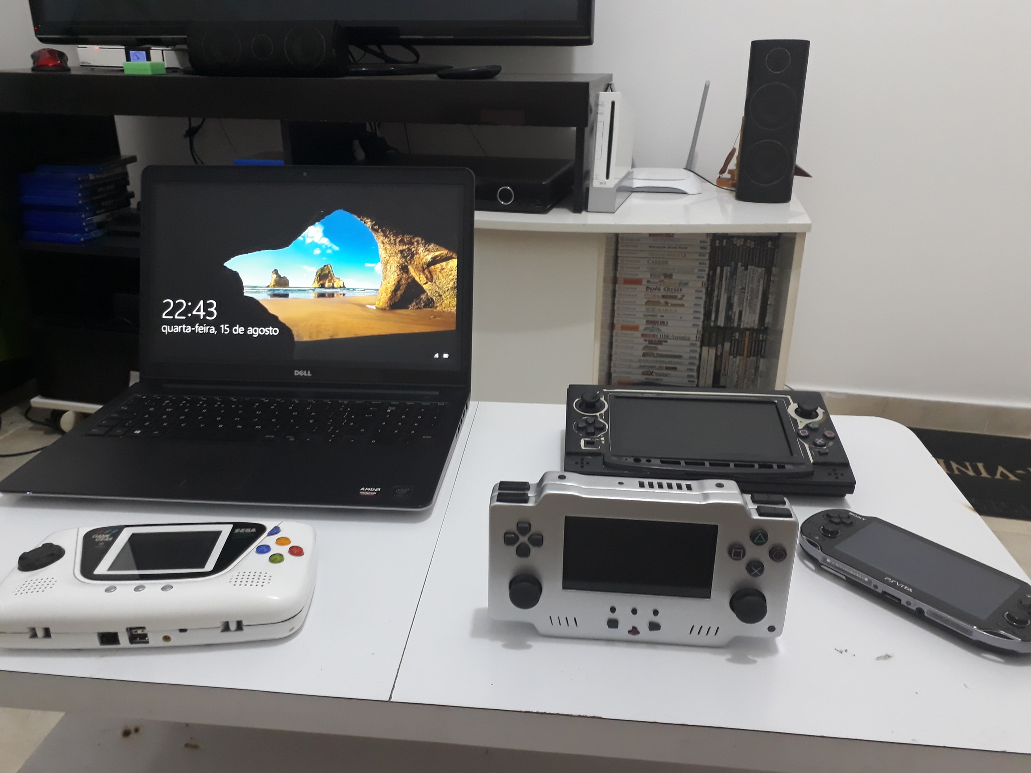

But it was worth it!!! finally done!!!
Welcome to family "PS2Pocket"
Resident Evil Code: Veronica ♥♥♥

insanely awesome work dude!
did you do the hailrazer mod?
Very nice work! I really like the header connectors between the two parts, it solves a lot of spaghetti wiring.
sir, what's the dimension of your portable?
