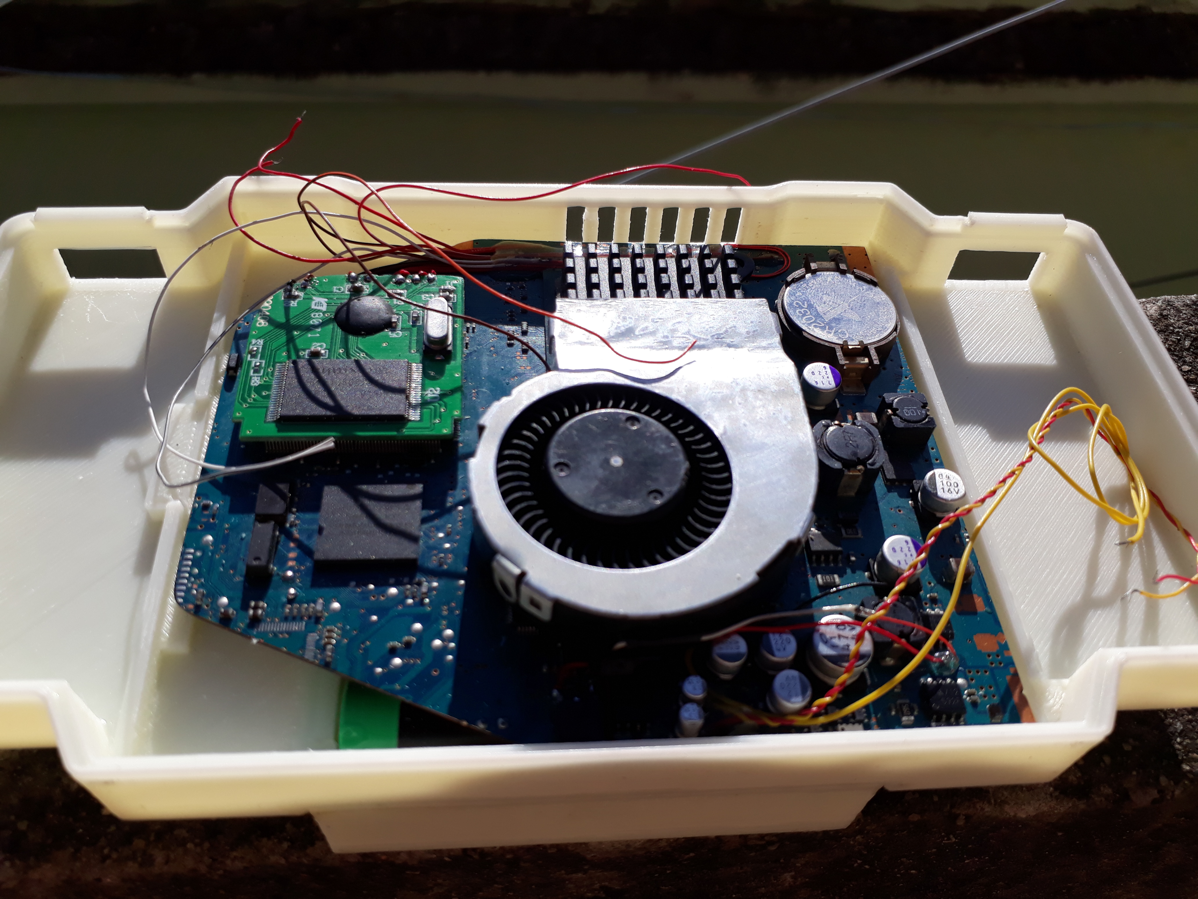

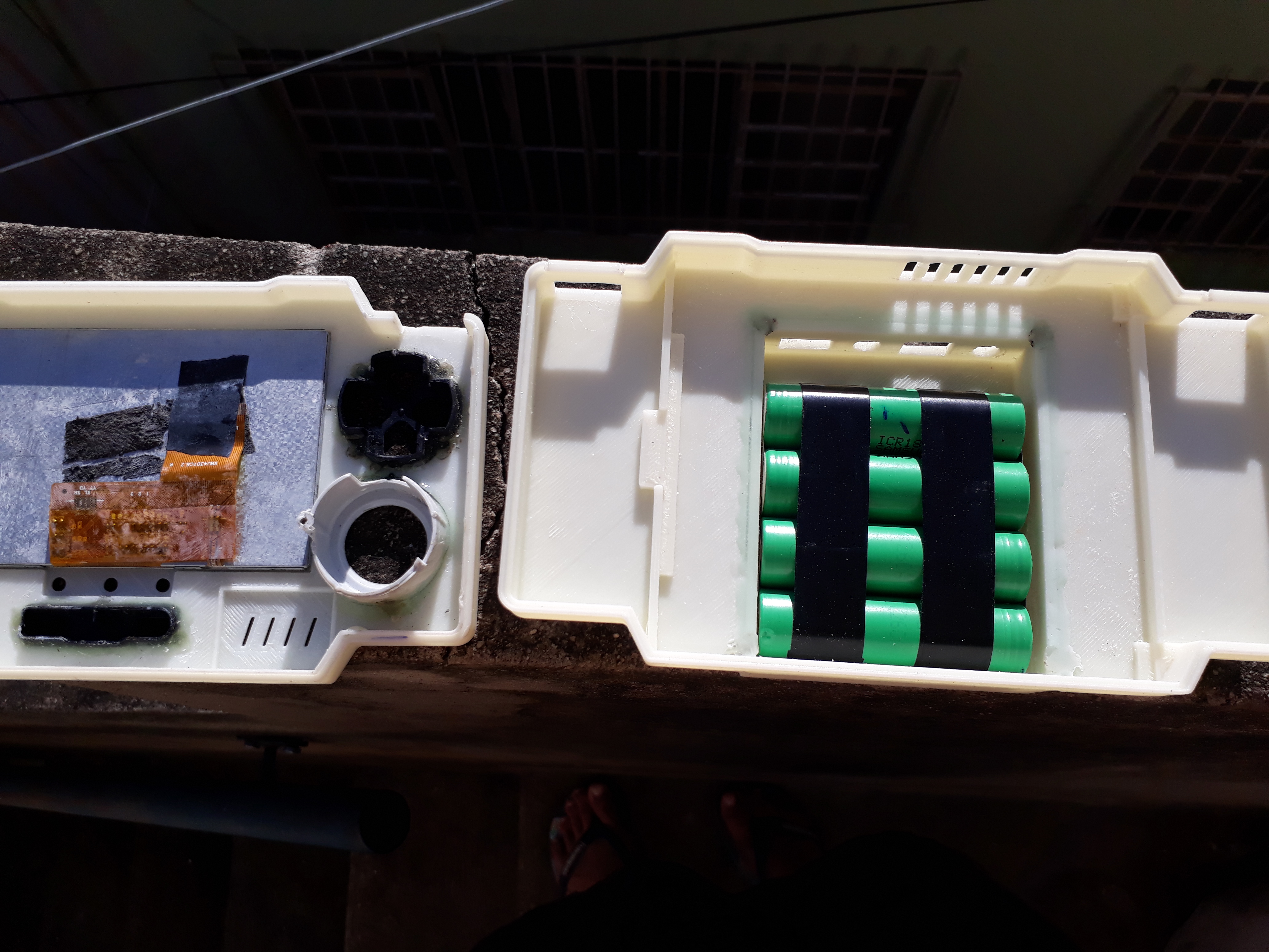

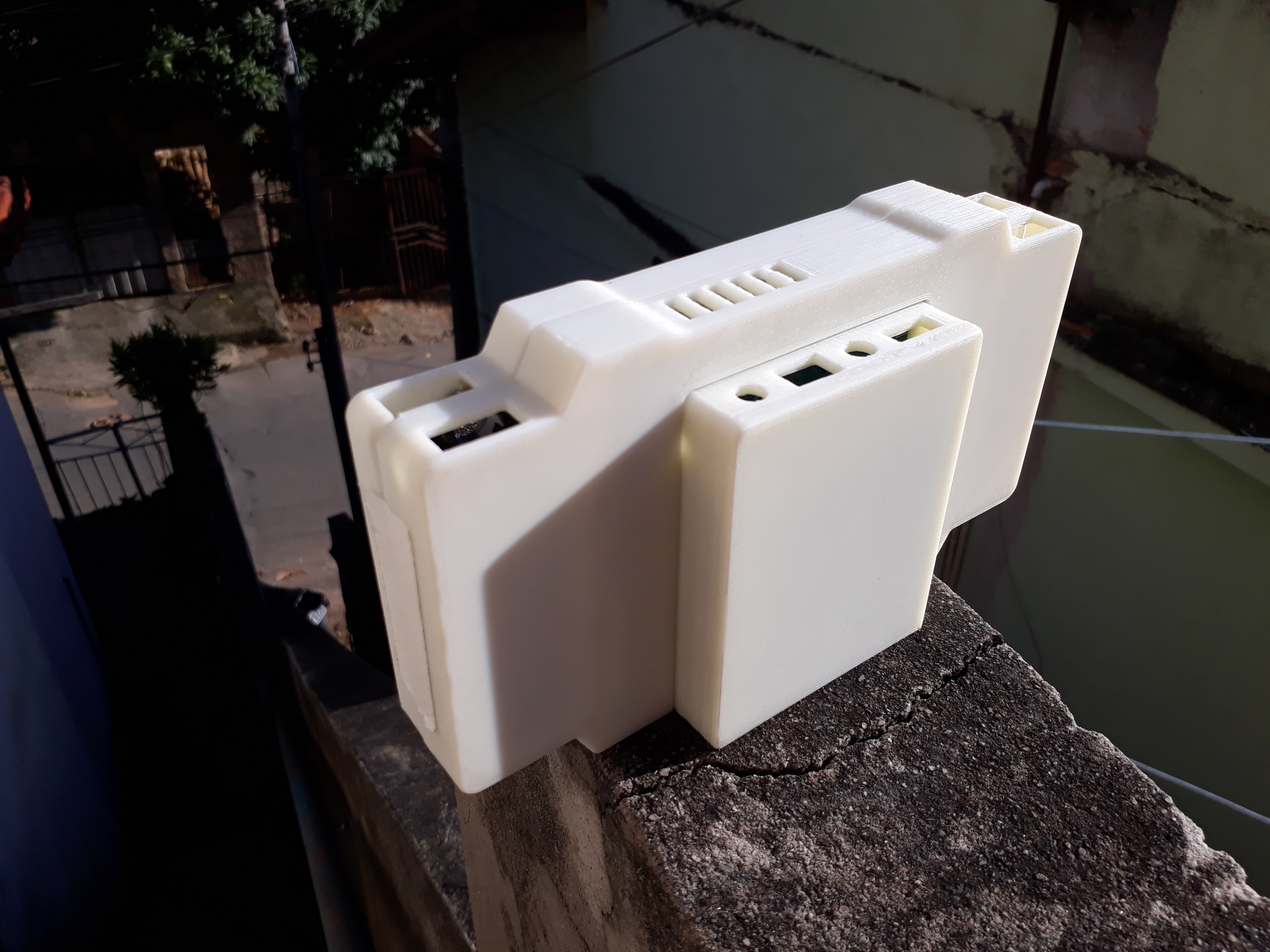

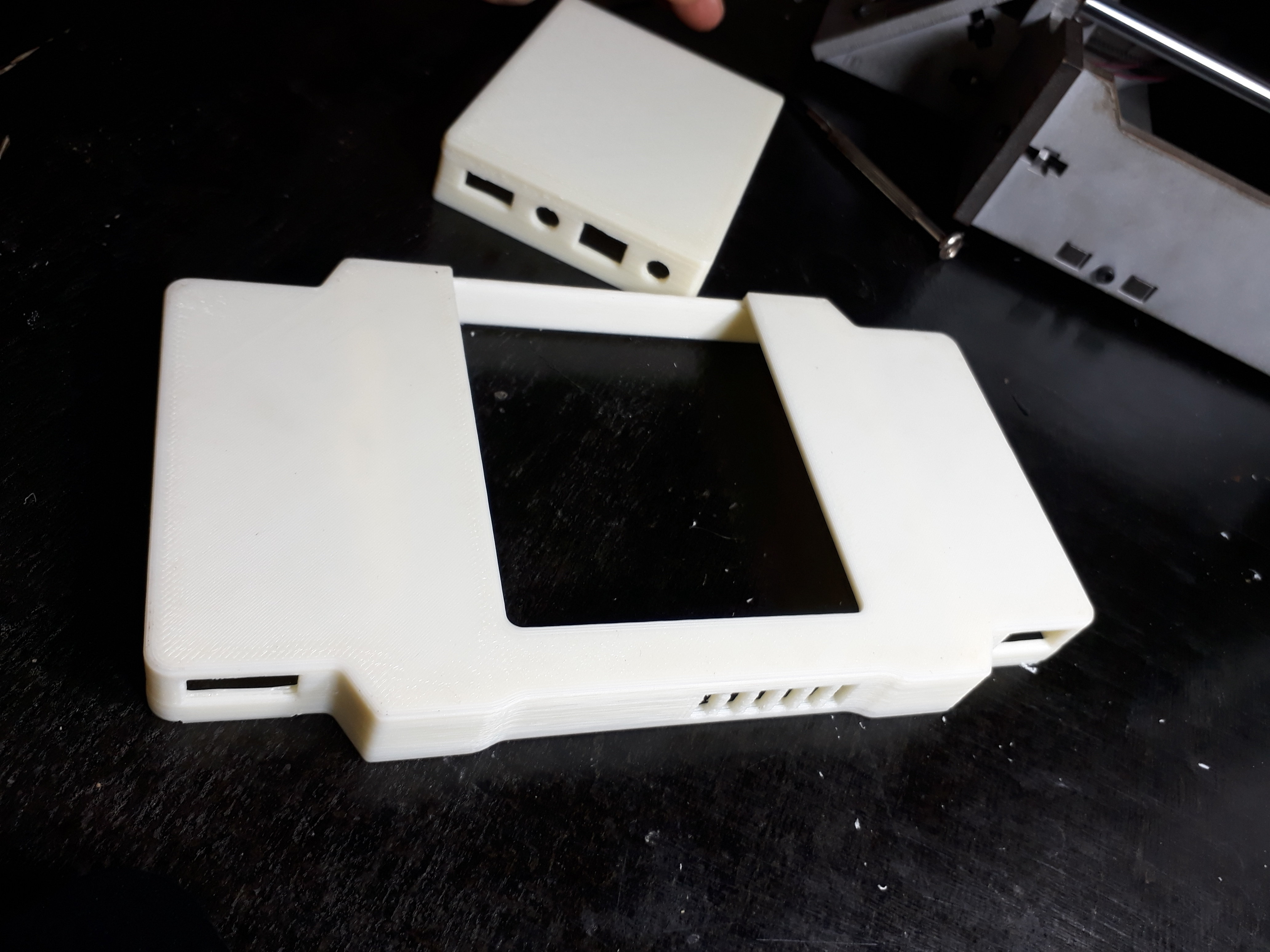

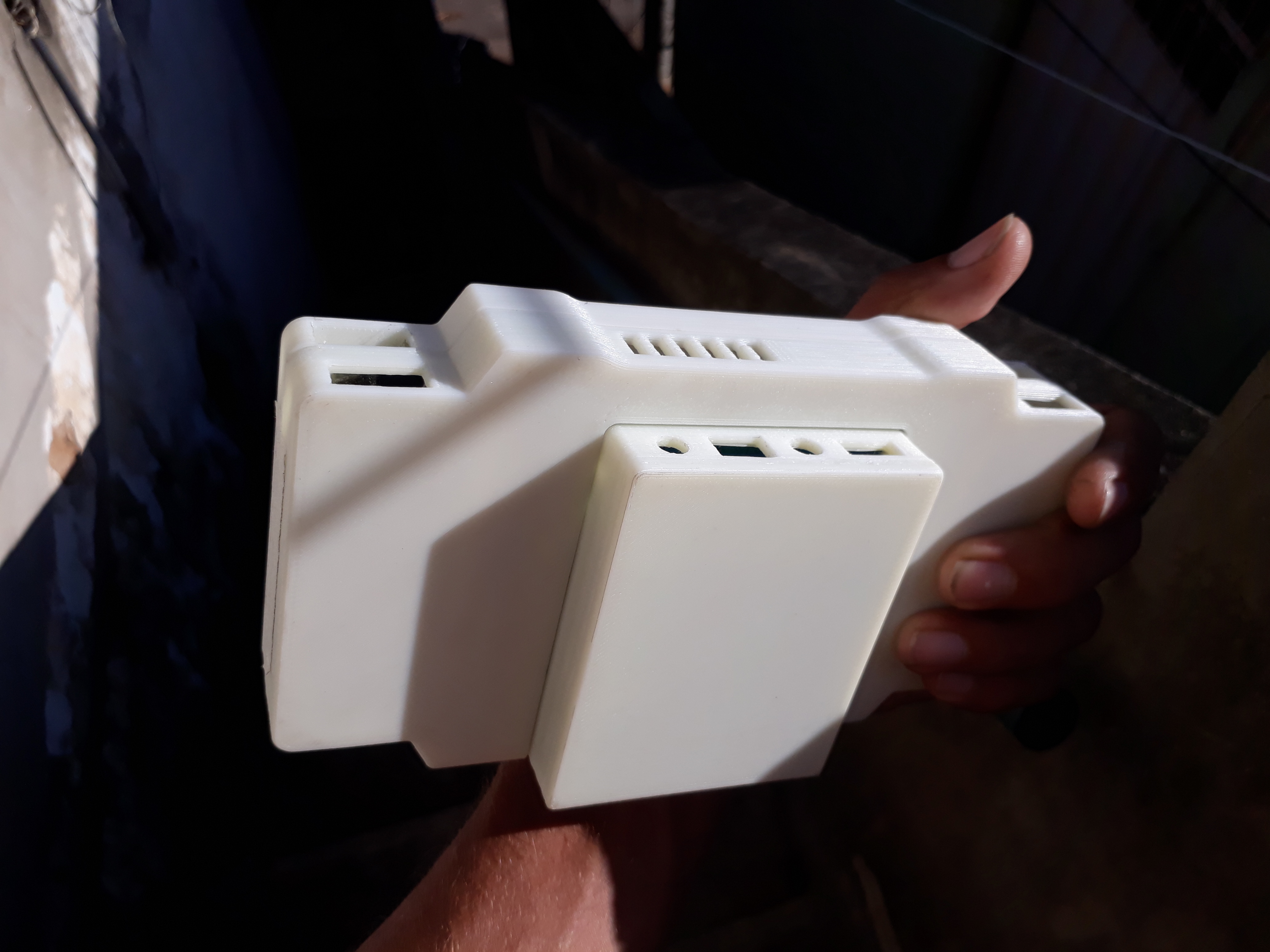

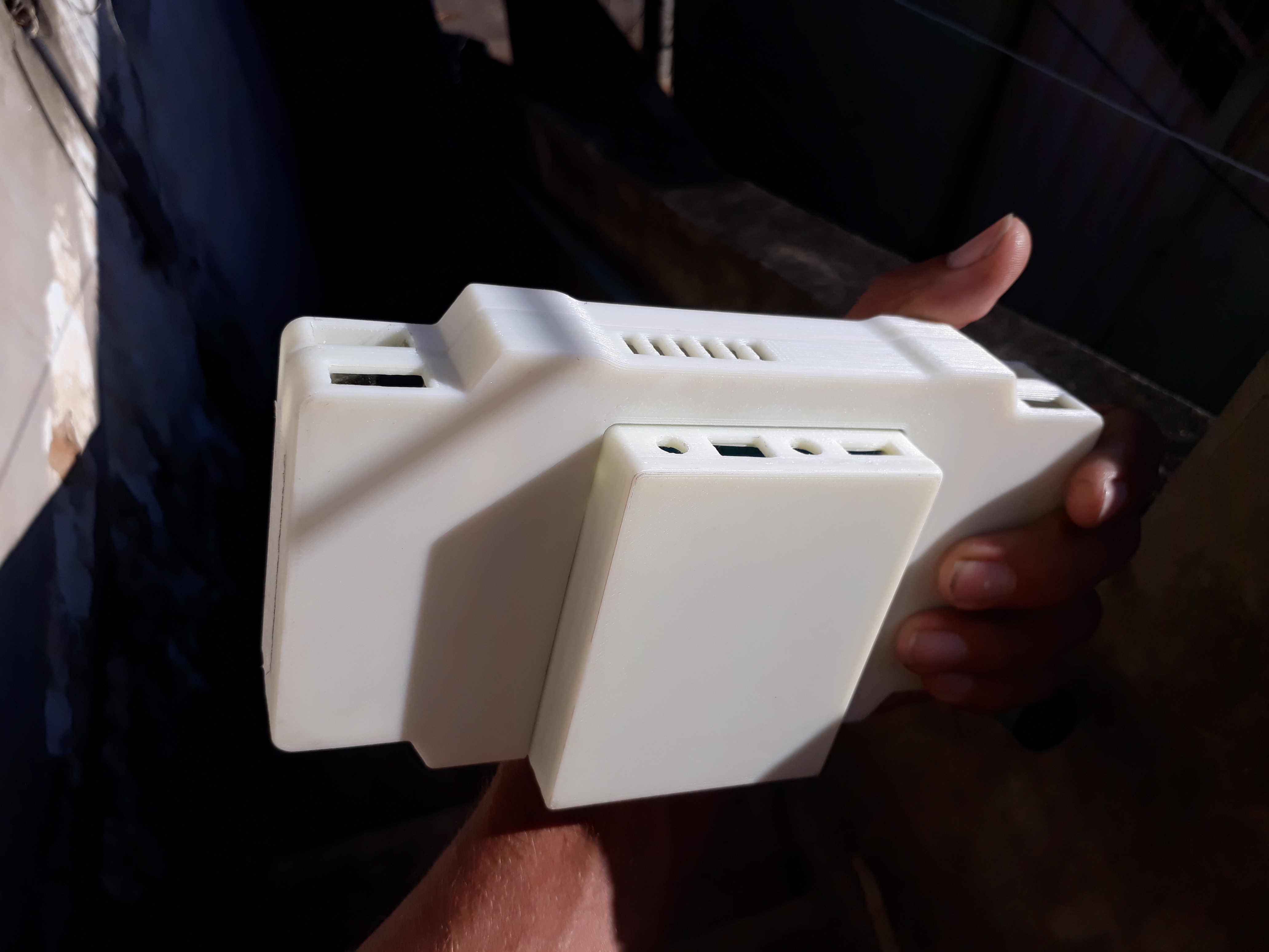

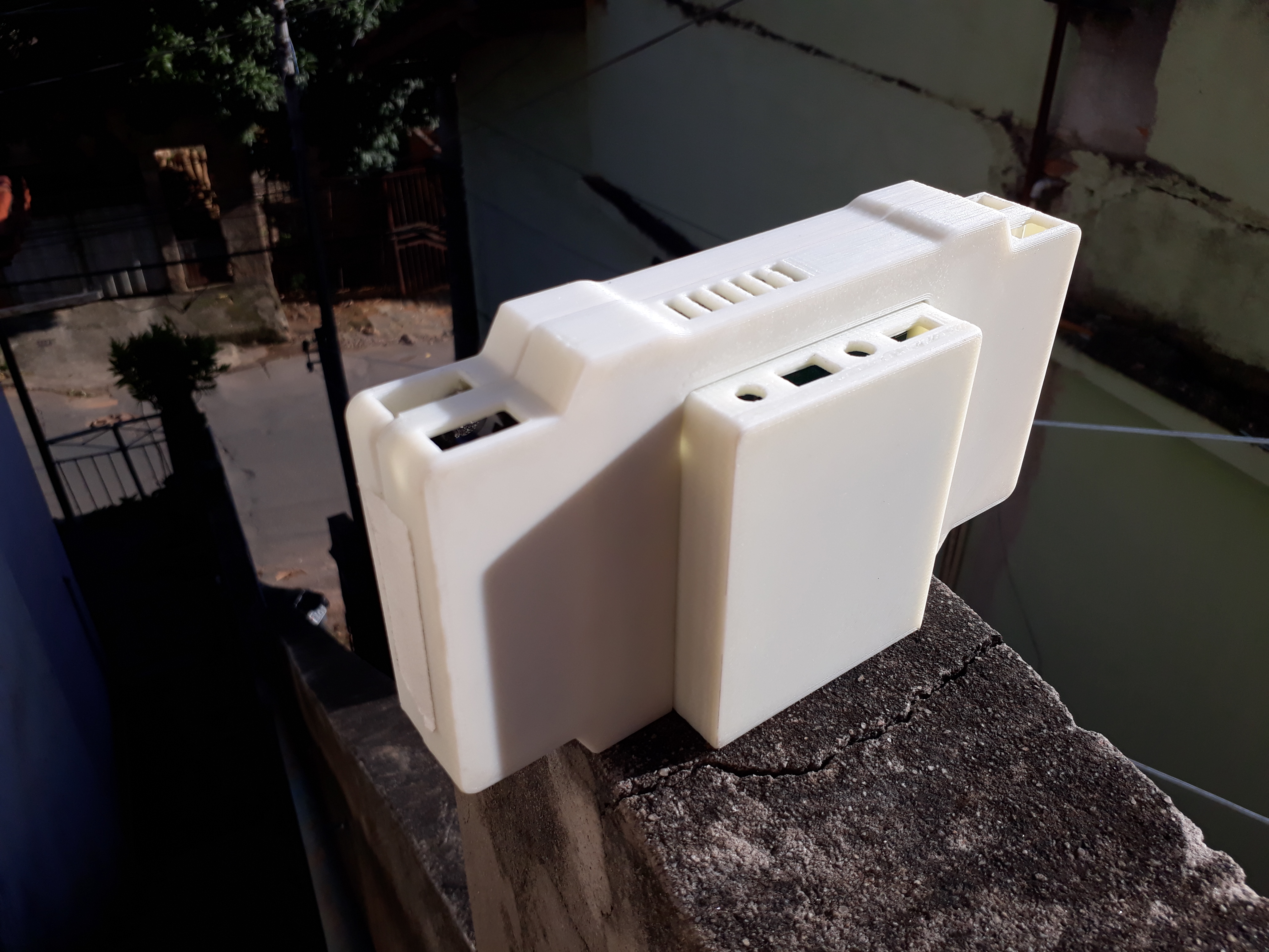

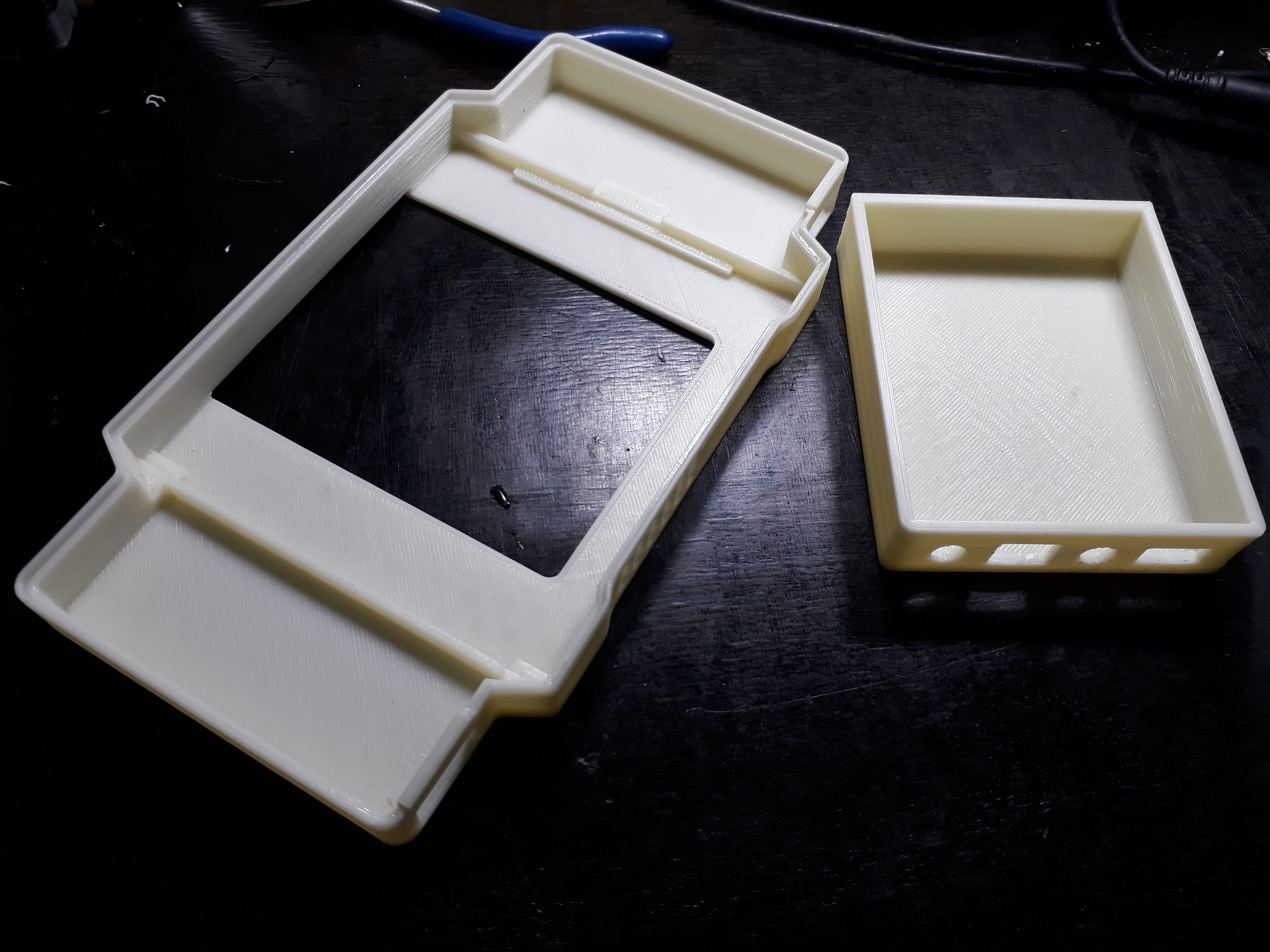

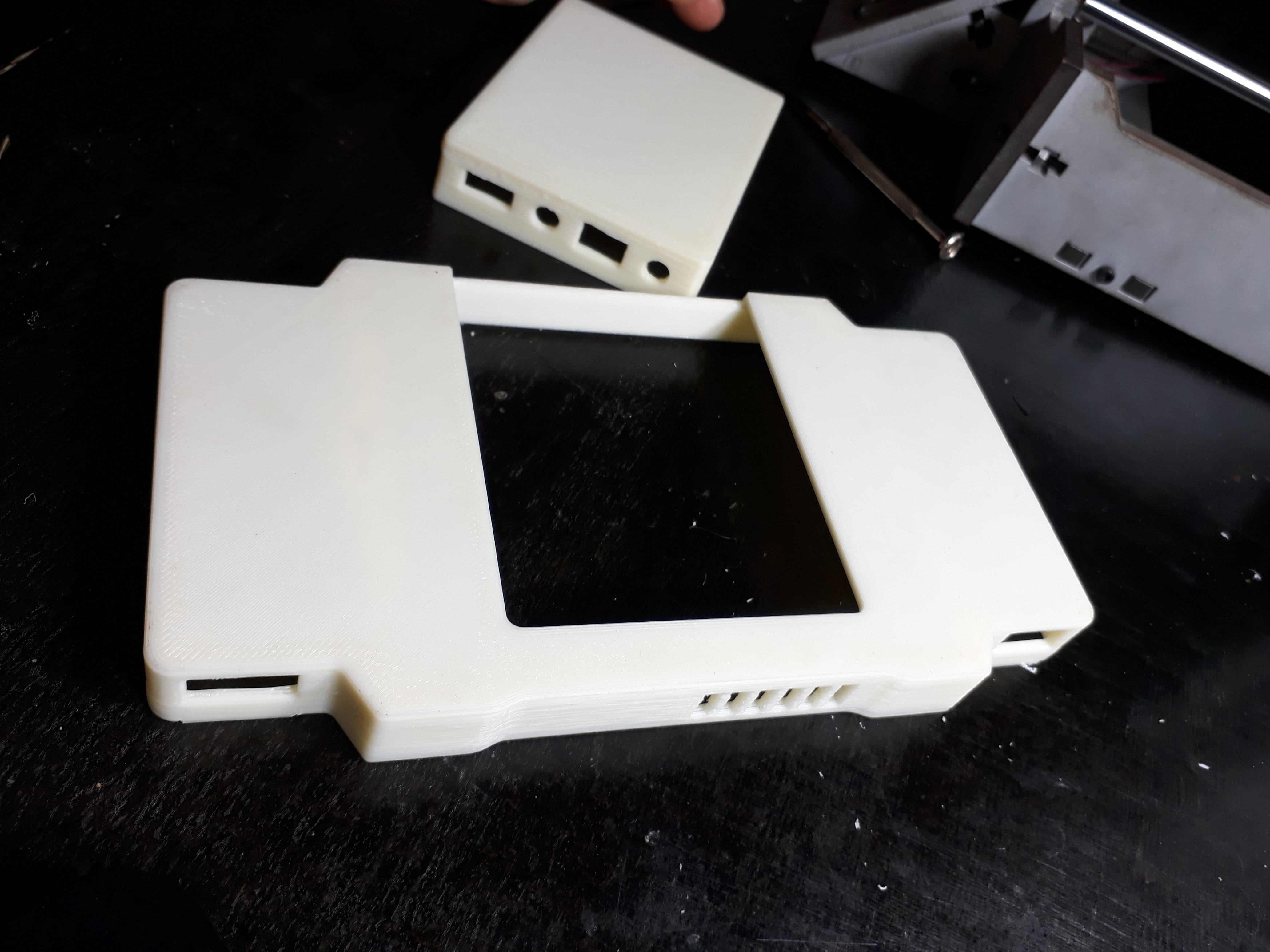

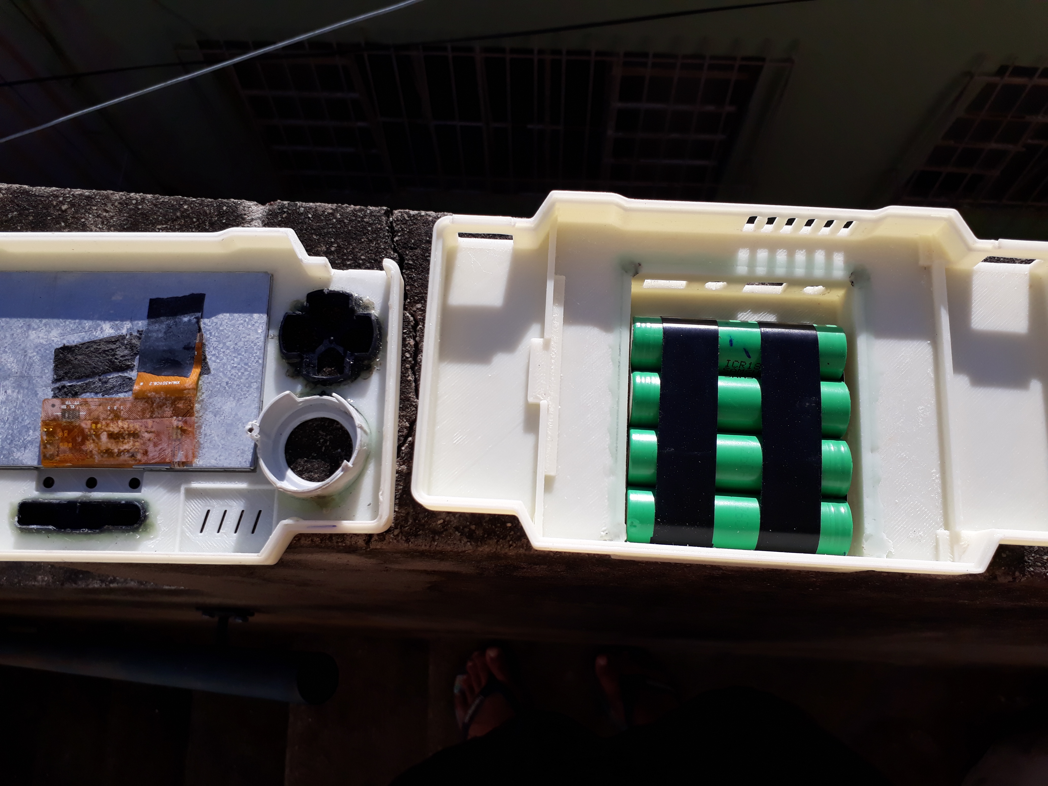

Update !!! Battery Cover:

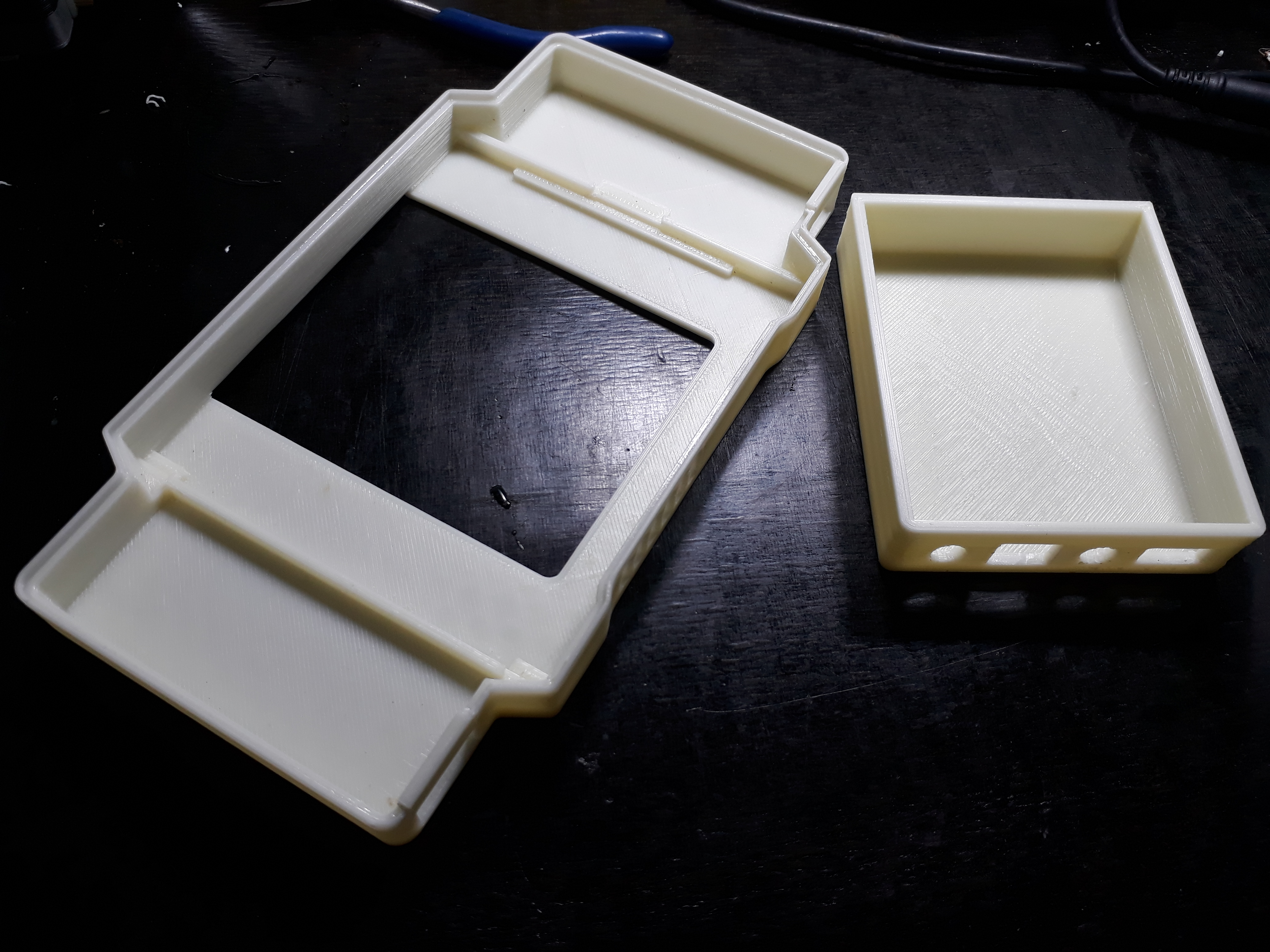

As you can see, on the battery cover, it will accommodate the power inputs, power switch and USB port.
(Do not look at the tape on the side, I used to attach the case for photo)

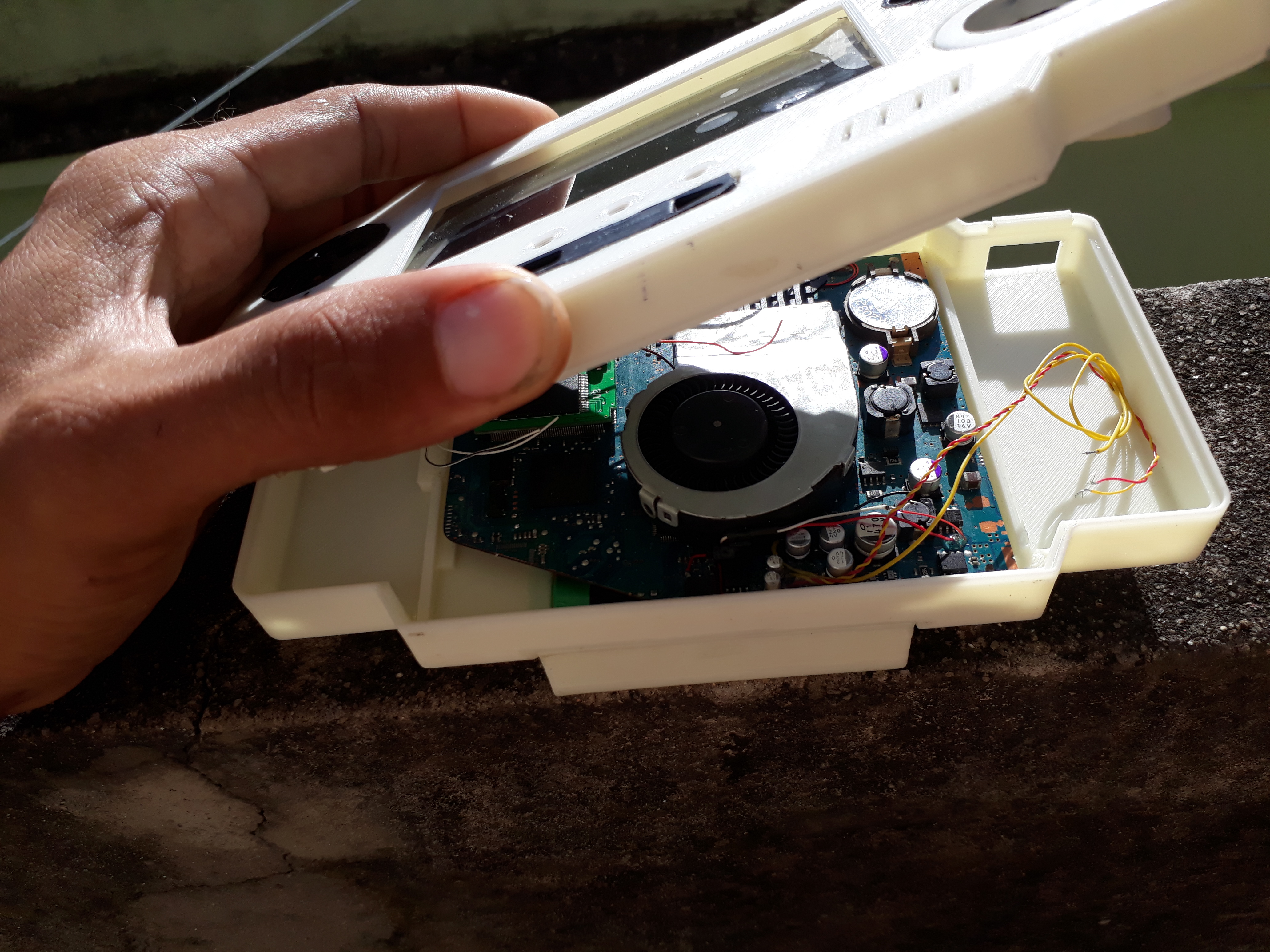

Batteries accommodated, and space for the entrances.
Hot air outlet ...
I still have to worry about a few things, I forgot the volume hole, a headset, and a solution to screw the case.

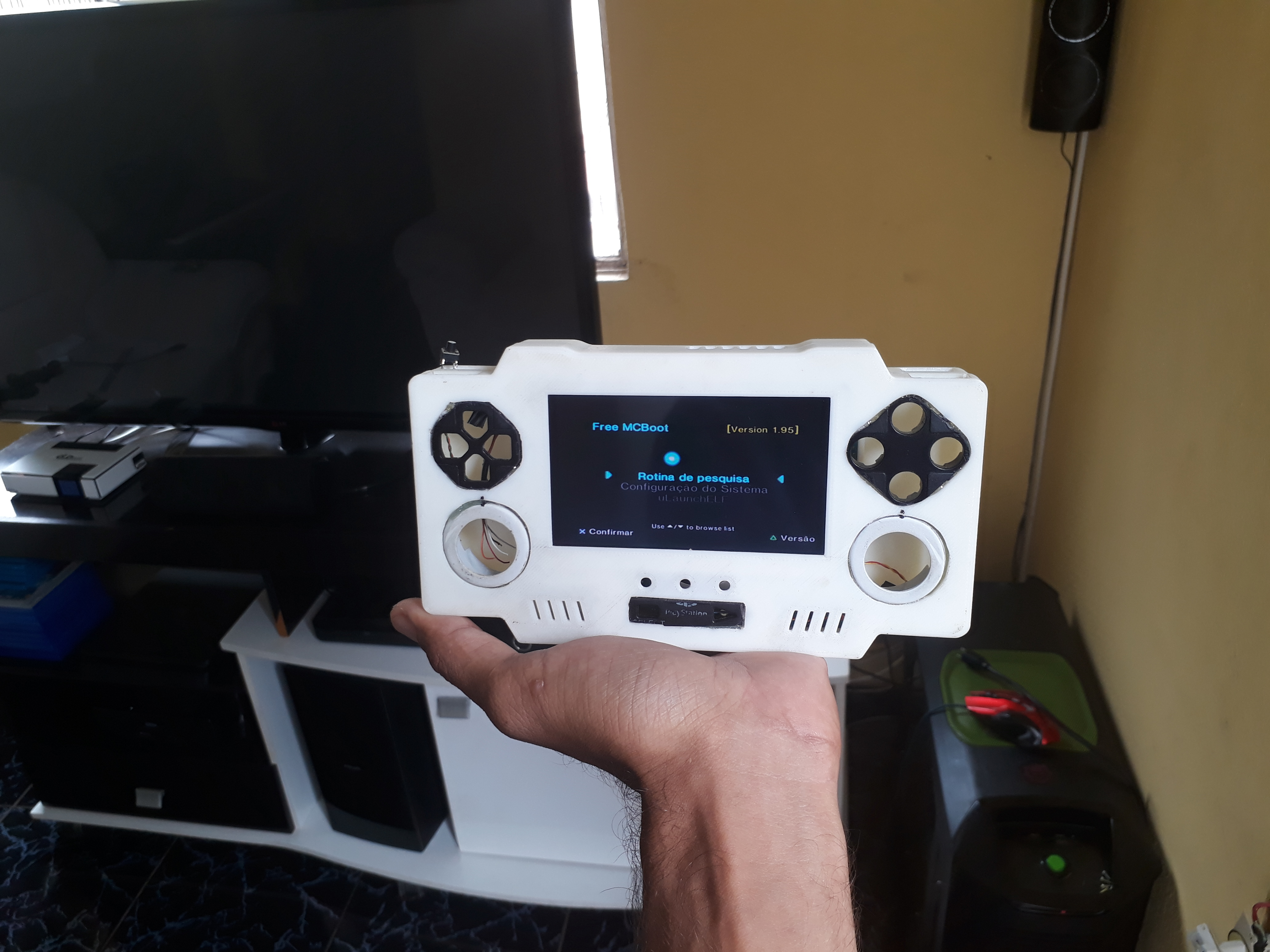

I also await help from Gman or the other friends, to draw the button holes in my case, as soon as possible I will print a new one with these corrections for the new version of the laptop. Thank you!

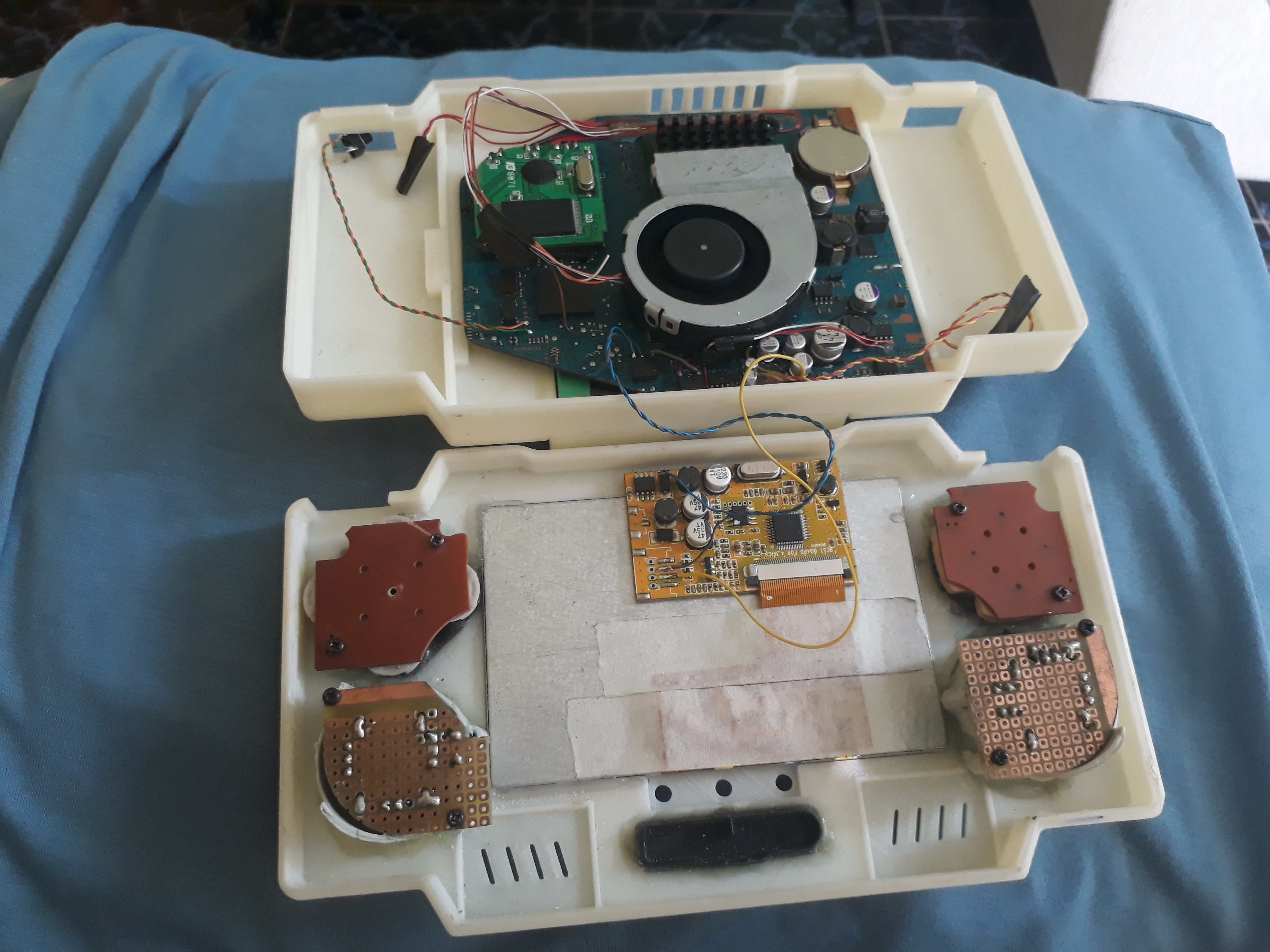

How long can you play? friend for Battery 18650 batteries at 3400 mAh
Estou fazendo um novo projeto 7 polegadas ps2 Portable screen.in vertion 90006
But the battery does not long playing

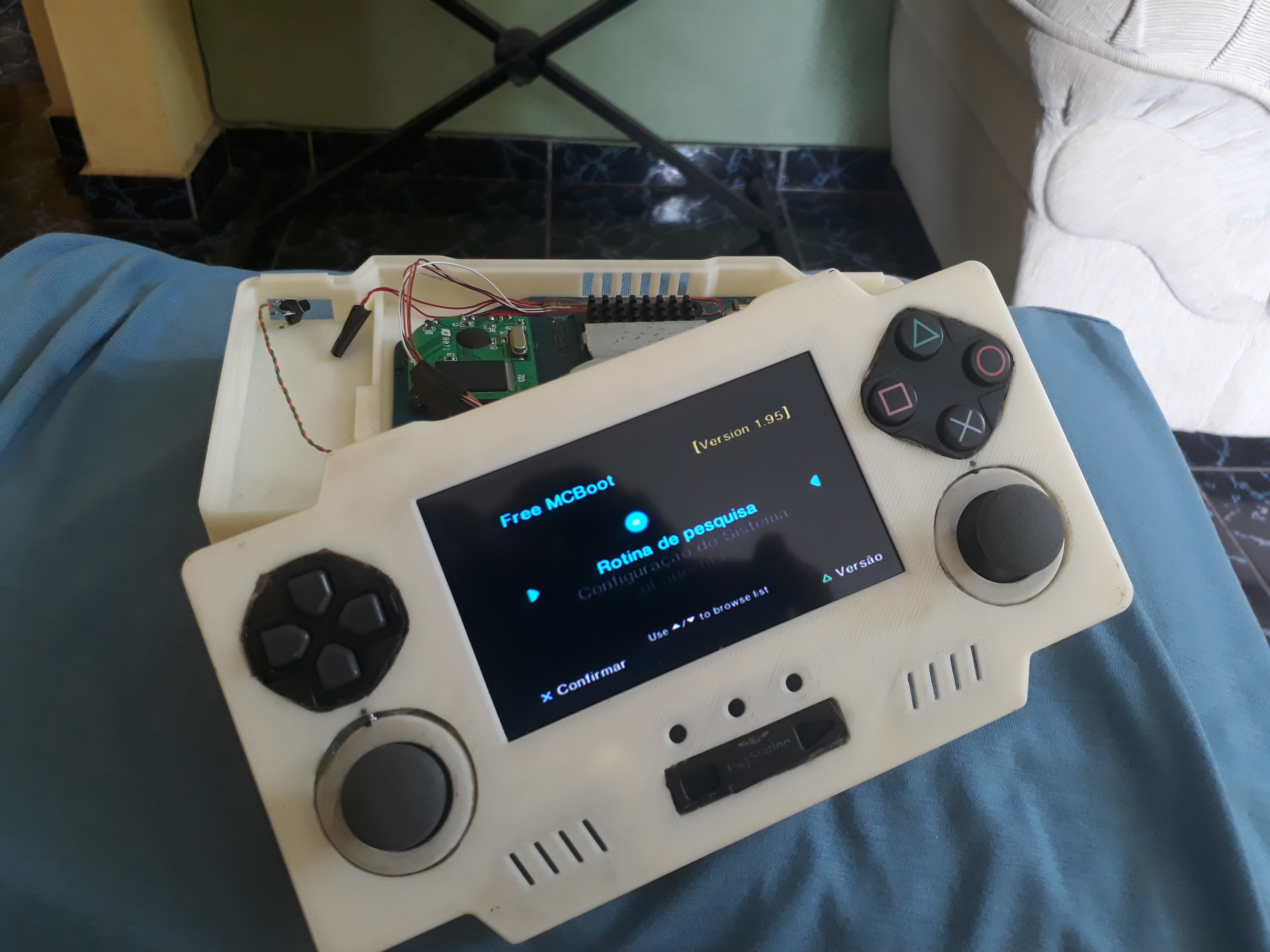

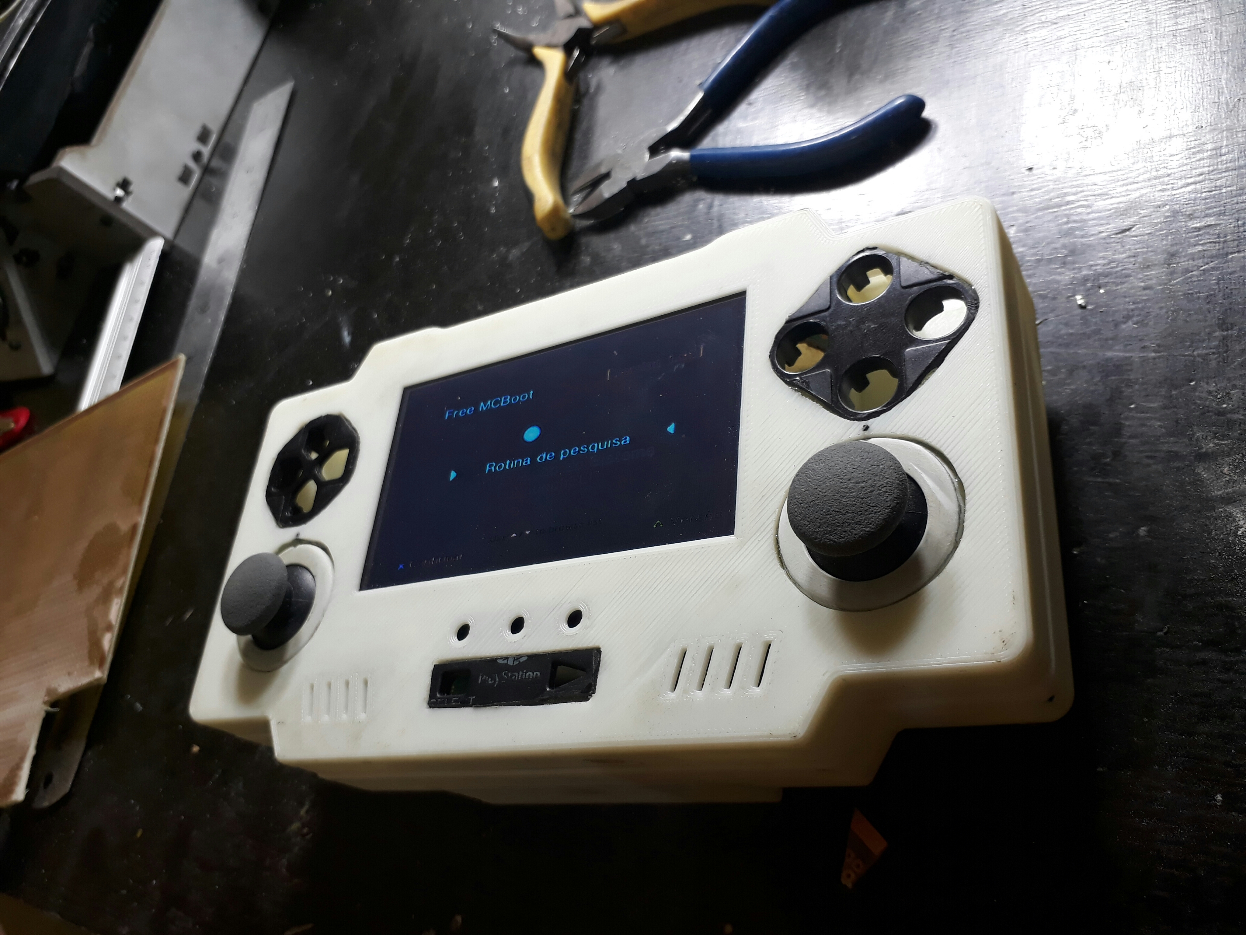

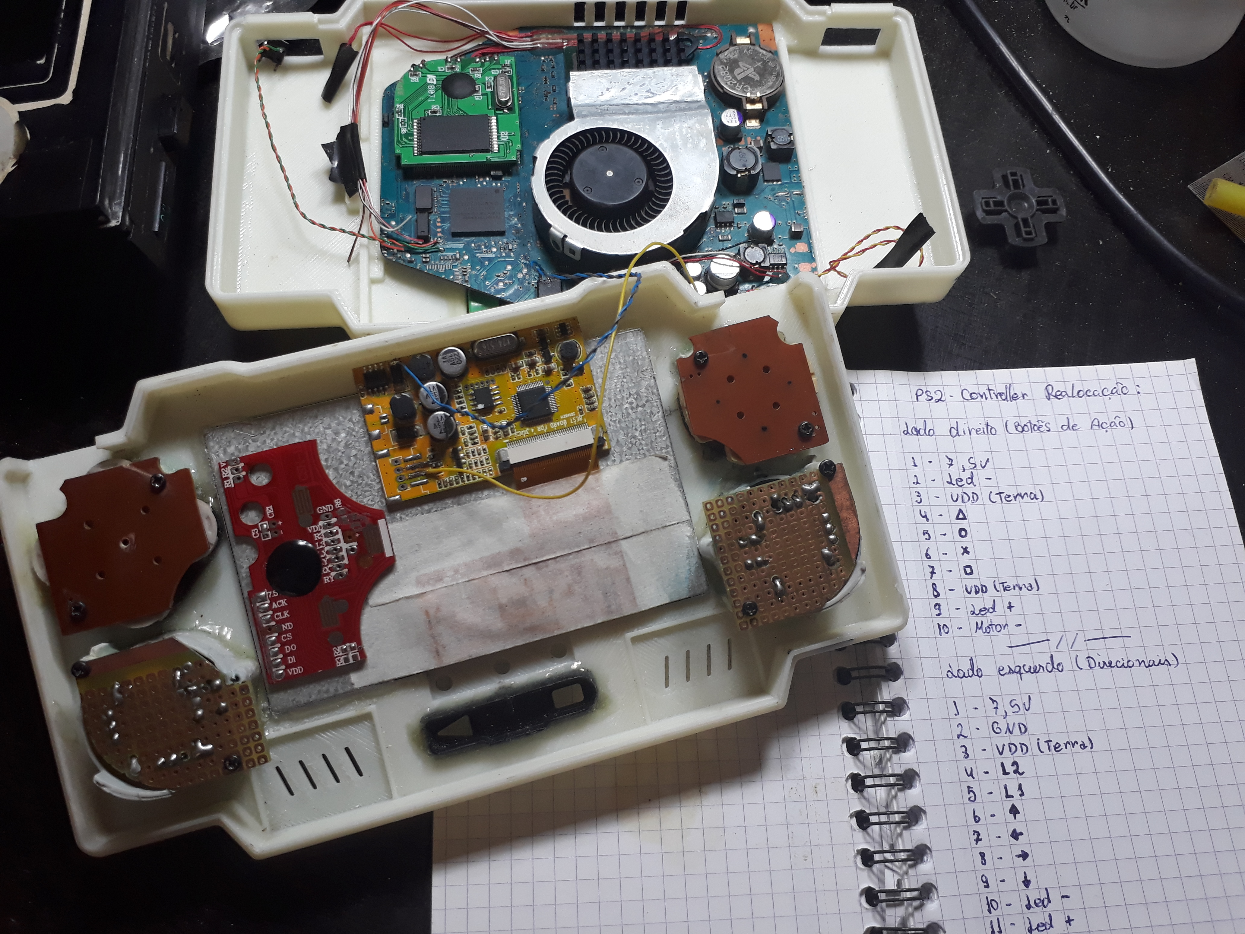

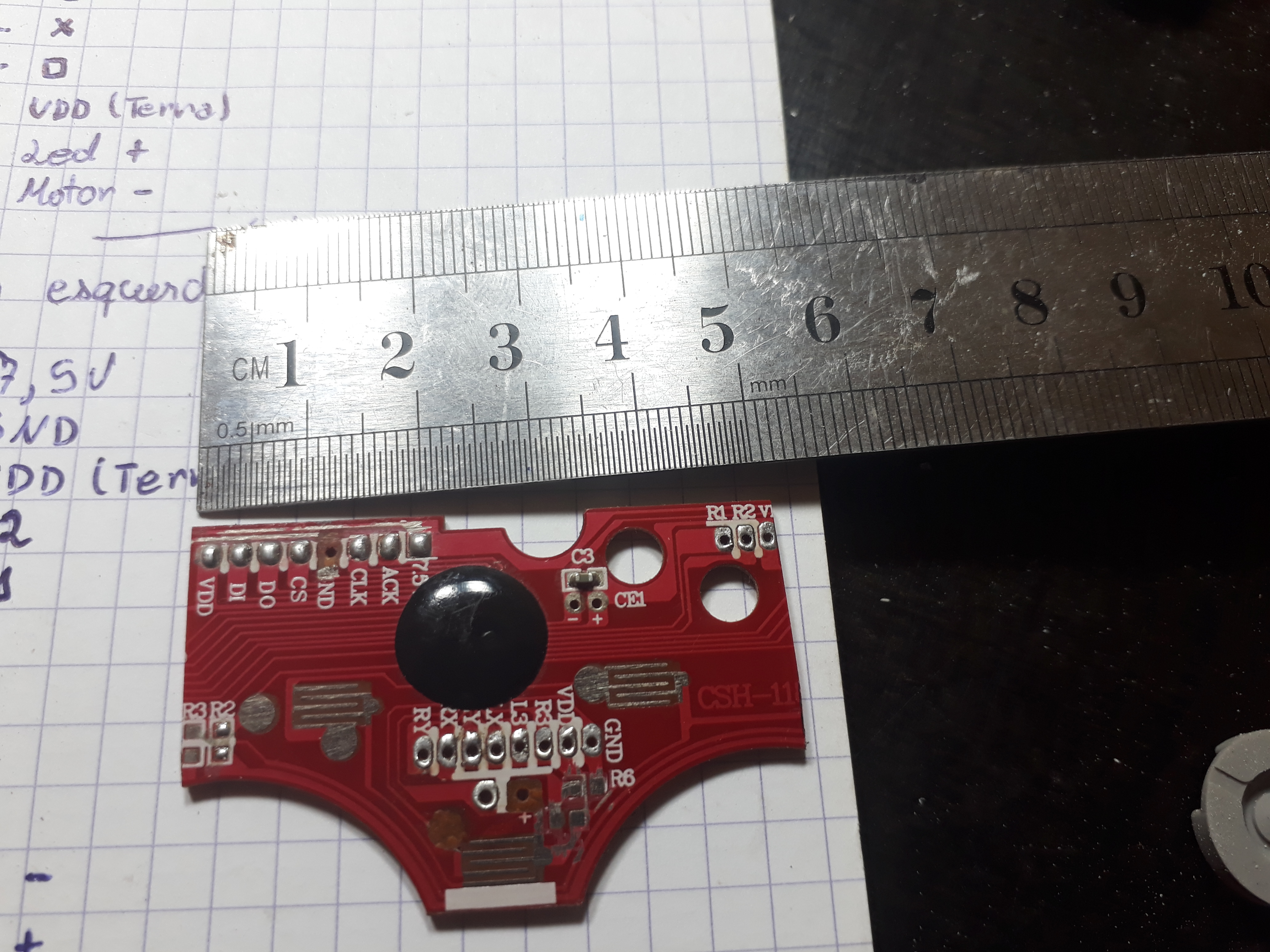

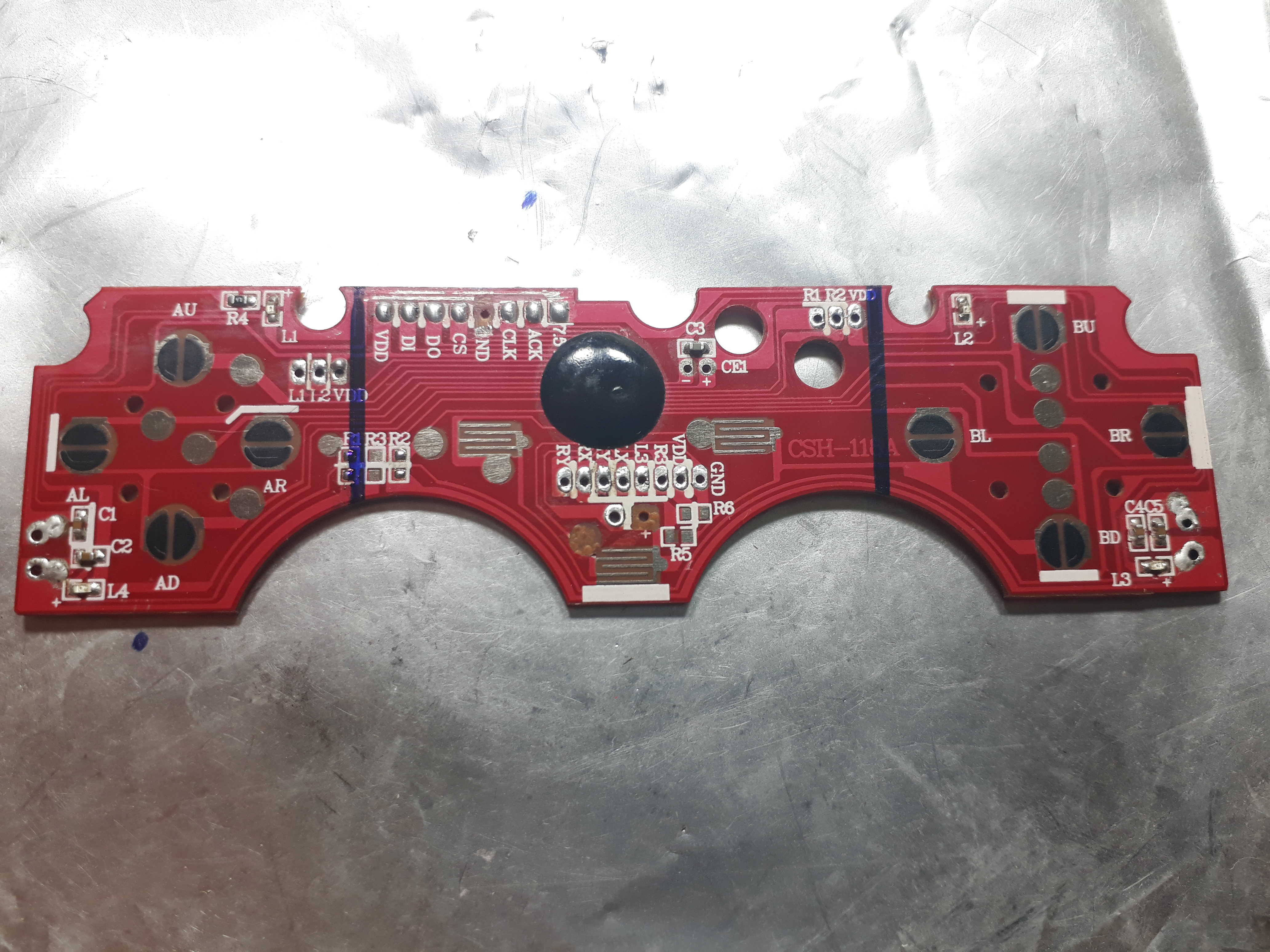

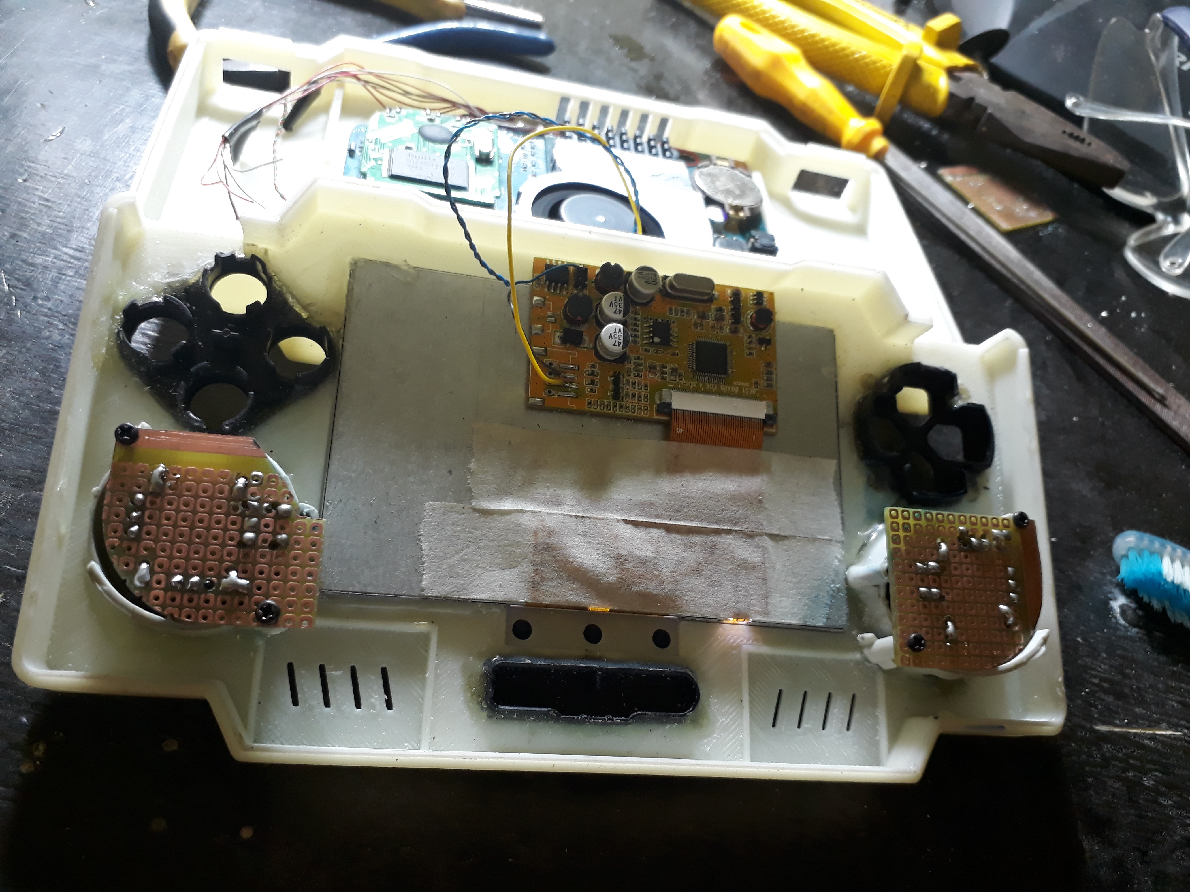

If you want the controller to register as a DS2(required for certain games), you must have a resistor (around 22K ohms I think) connecting each button to the common. If I recall correctly, start and select is exempt from this.I'm about to start working on the controls, I need your help to set which control board to use ... I really wanted to be able to use the official control board, it's small enough that I can use it in my laptop, but I know it's harder to use, but difficult? Once upon a time a user of the forum had problems with an official control board, where he reported that he would have to add a resistor for each button ... is this true? I know there are very small solutions like MINIDS2, but here in my country, everything is more difficult, I can not buy a ...
Same, I have the same battery, after charging for more than 8 hours, I can only use it for less than 20 minutes
I understand, I think it is feasible since the board is small ... as soon as I have all my controls fixed I will do some tests to see if it works ... thank you very much for the answer!
There seems to be something wrong, with my battery pack, I'm working at 7.4v at 5000mha. I'm sure it lasts more than 3H at full charge ... Are not you using poor batteries?
Cool case, but try not to double/triple/quadruple post. If you need to add things to a post, use the edit button. Also, this definitely needs its own thread!Can we use a bad battery? Because I brought from the old notebook.
Good work. I use the same controller, it should work. Are you planning on painting the case?
