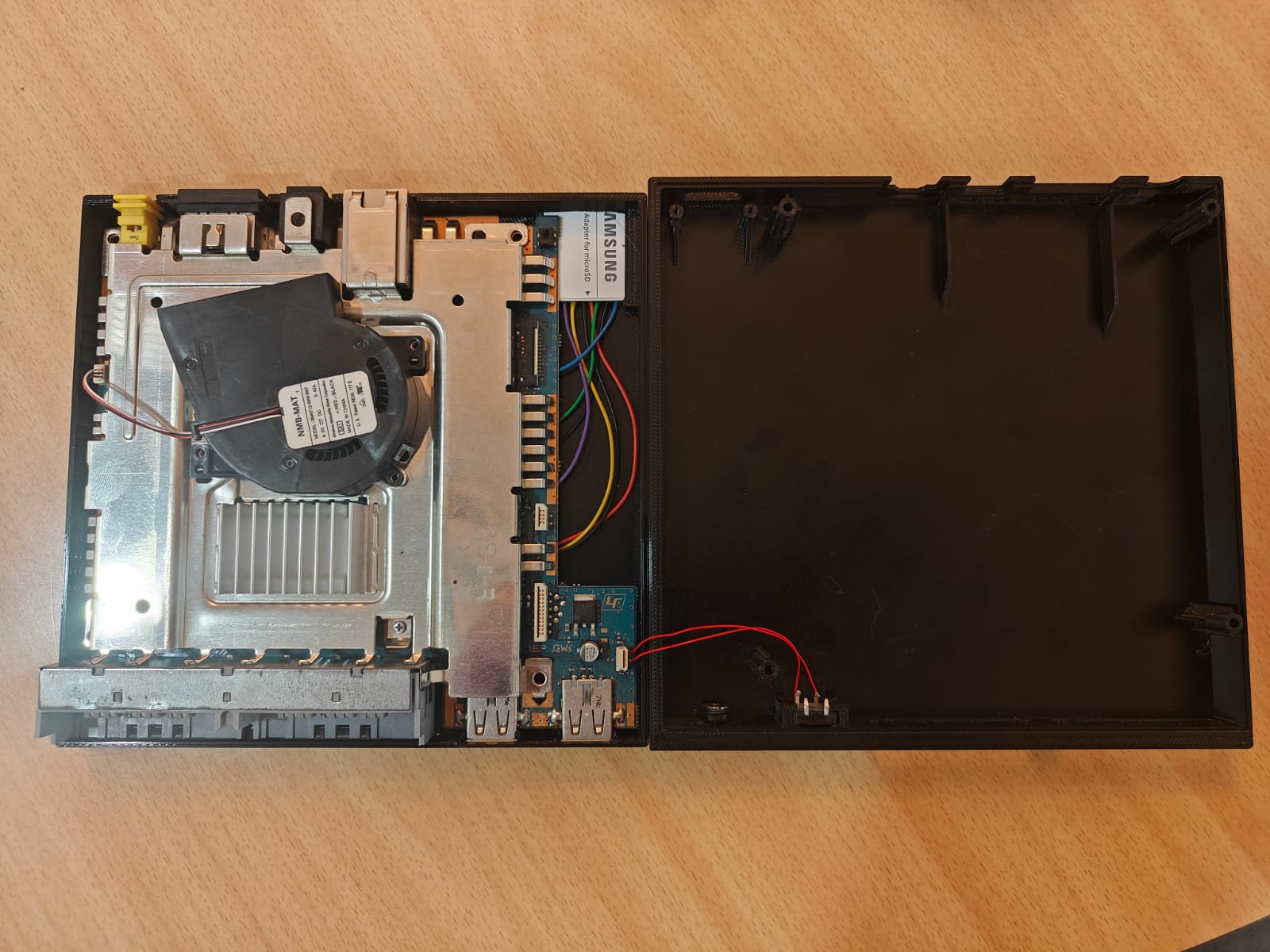

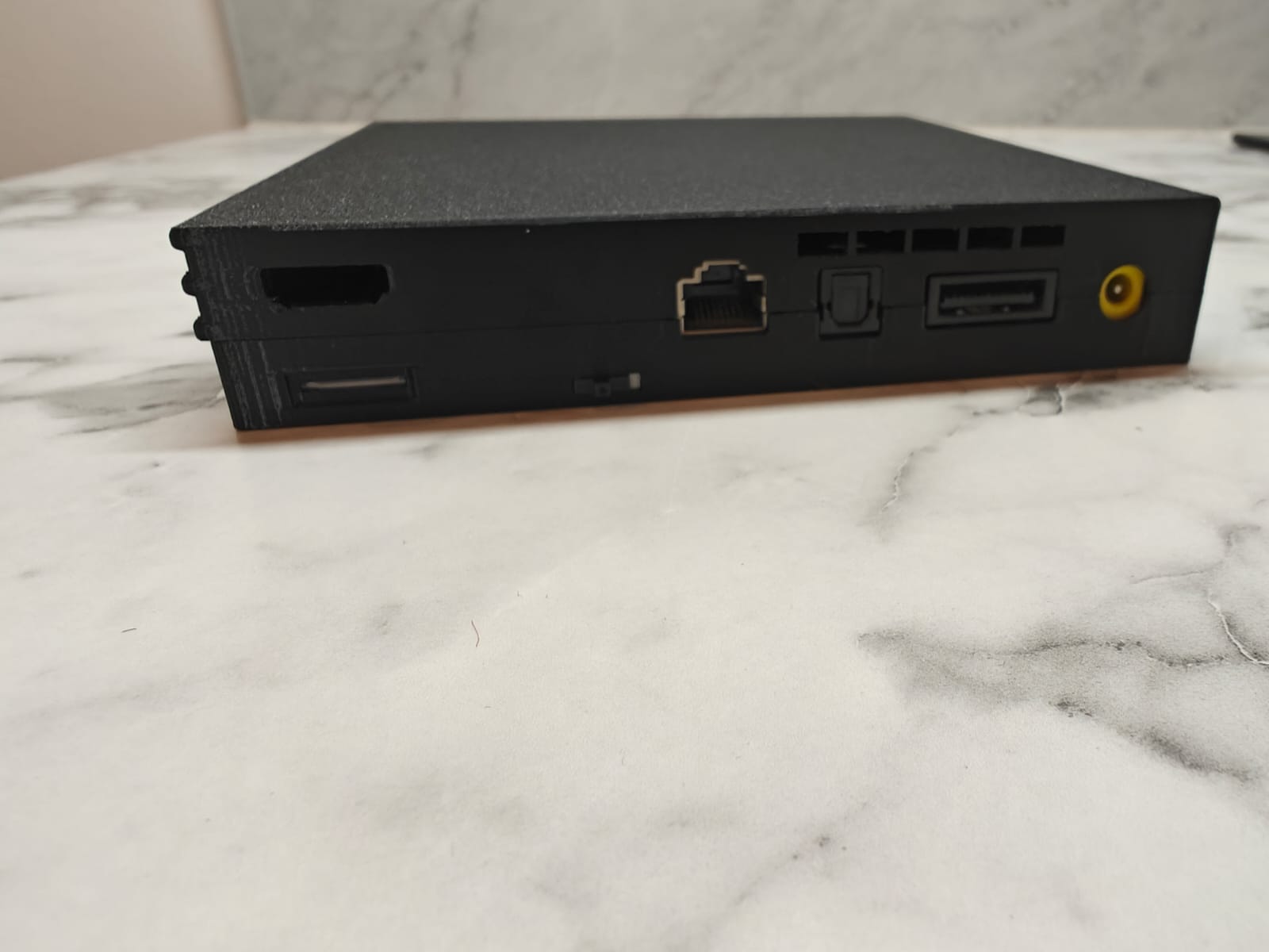

I made this version by modifying the files provided by wesk. This is a result of my frustration with my first try of the project ( I managed to lift the reset pad and bricked my board when fixing ). Also I liked the idea that the console is theoretically restorable to stock, as no traces are cut with the included power button. Other modifications include the sd card and switch moved to the back, and the sd card holder changed so that the board holds it in place.
The power button is a 12mm push button with a holder.

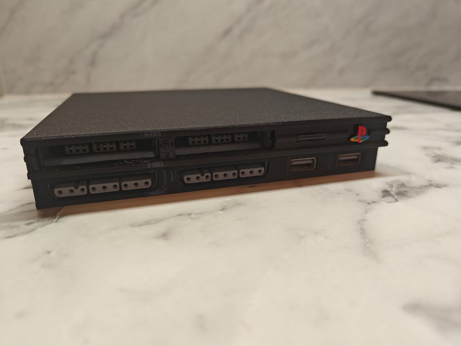

Managed to get my hands on a 79k and try this project, managed to cut the board and power it on but I am thinking of relocating the front ports since there isn't enough space to plug controllers/memory cards in, inside my car's rear arm rest. Has anyone ever tried relocating the ports?
