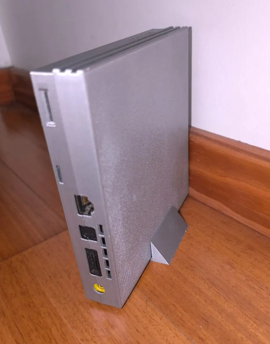

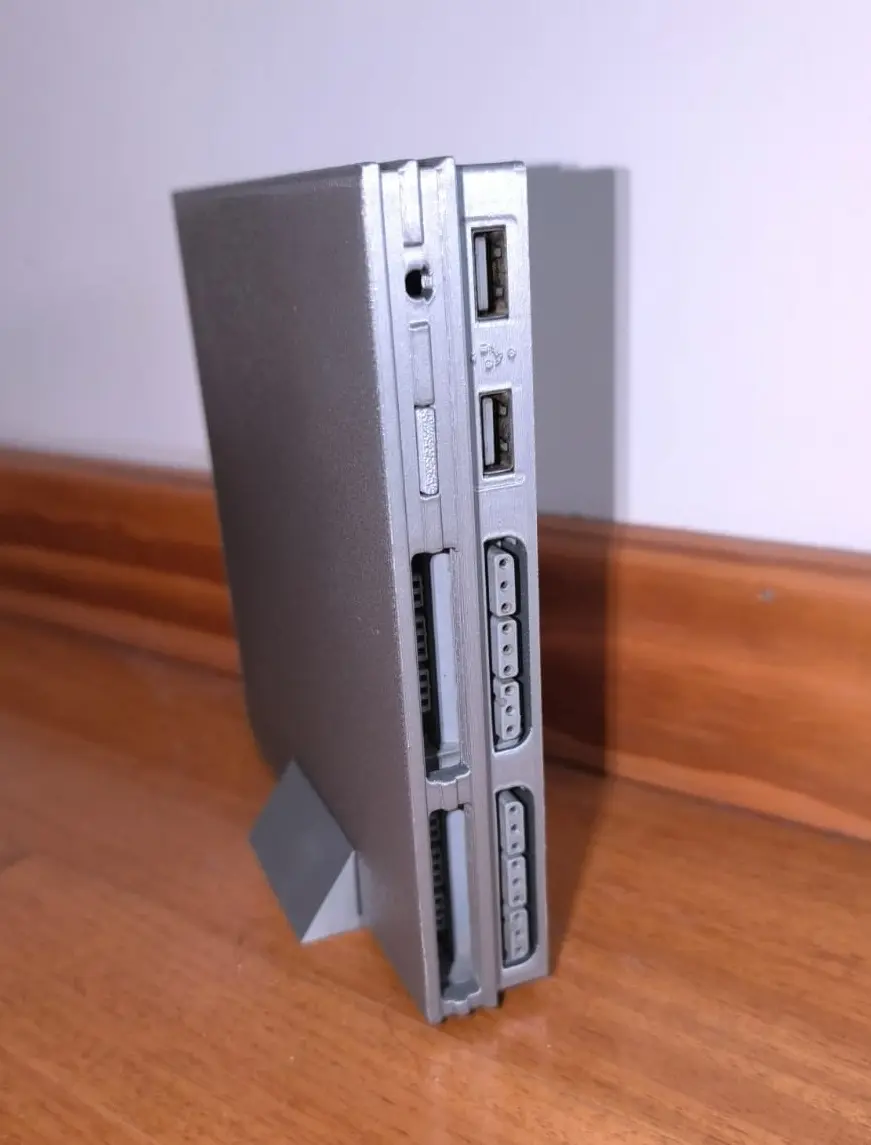

Done! i am missing the ps2 fat logo
i like to have the 2 USB Ports
wish i had a transparent colored PLA, but i only have silver color

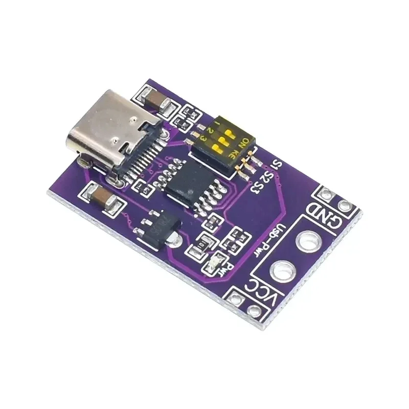

i was thinking again about this mod and, instead of using the sd card reader pcb, we include a usb-c 9v power delivery board
to get rid of the big fat original external power supply and use a PD cellphone charger
10pcs-PD-QC-AFC-Fast-Charge-Decoy-Trigger-Support-5V-9V-12V-15V-20V-Fixed-Voltage.jpg__1.webp
You can easily do it; I did it with a 70004, so it’s even better with a 7900X since it has lower power consumption.
