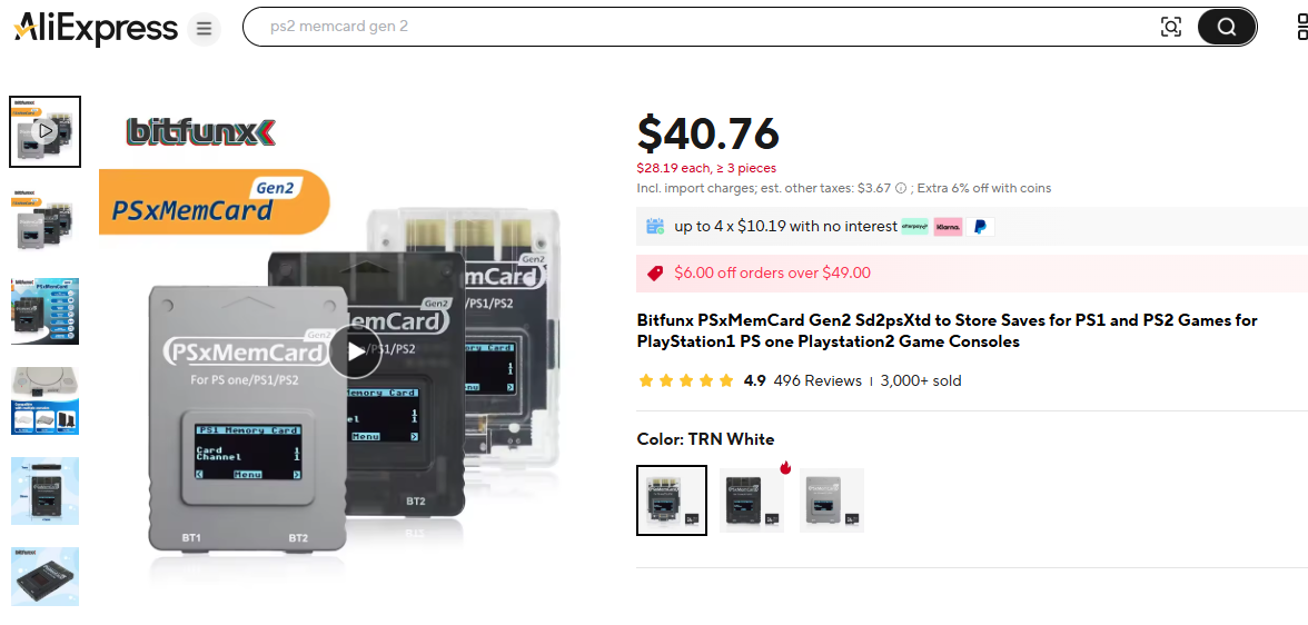

There are a few different flavors of Memory Card Emulators (MCE) in this case, since you are putting this in a car and will not have complete acces to the console here is a better suggestion in addition to the PicoMemCard option.
1. Buy one of thePSxMemCard Gen2 MCEs
2. Solder a cable from the MoBo to the card (this should be tested first).
3. Mount the PSxMemCard someplace conveniant in your car
4.You now have acces to the OLED disaply and also the mSD card slot (this means no soldering a mSD card slot at the mobo, nice!).
5. Load the mSD card with Ripto's AIO card image.
You can run your exploit and also your games from this neat device. Make sure you get the latest version of OPL, you will need to enable MMCE.
Note: You might want shielded and 28 awg or larger for the cable, depends on how far away you are mounting the card from the Mobo.

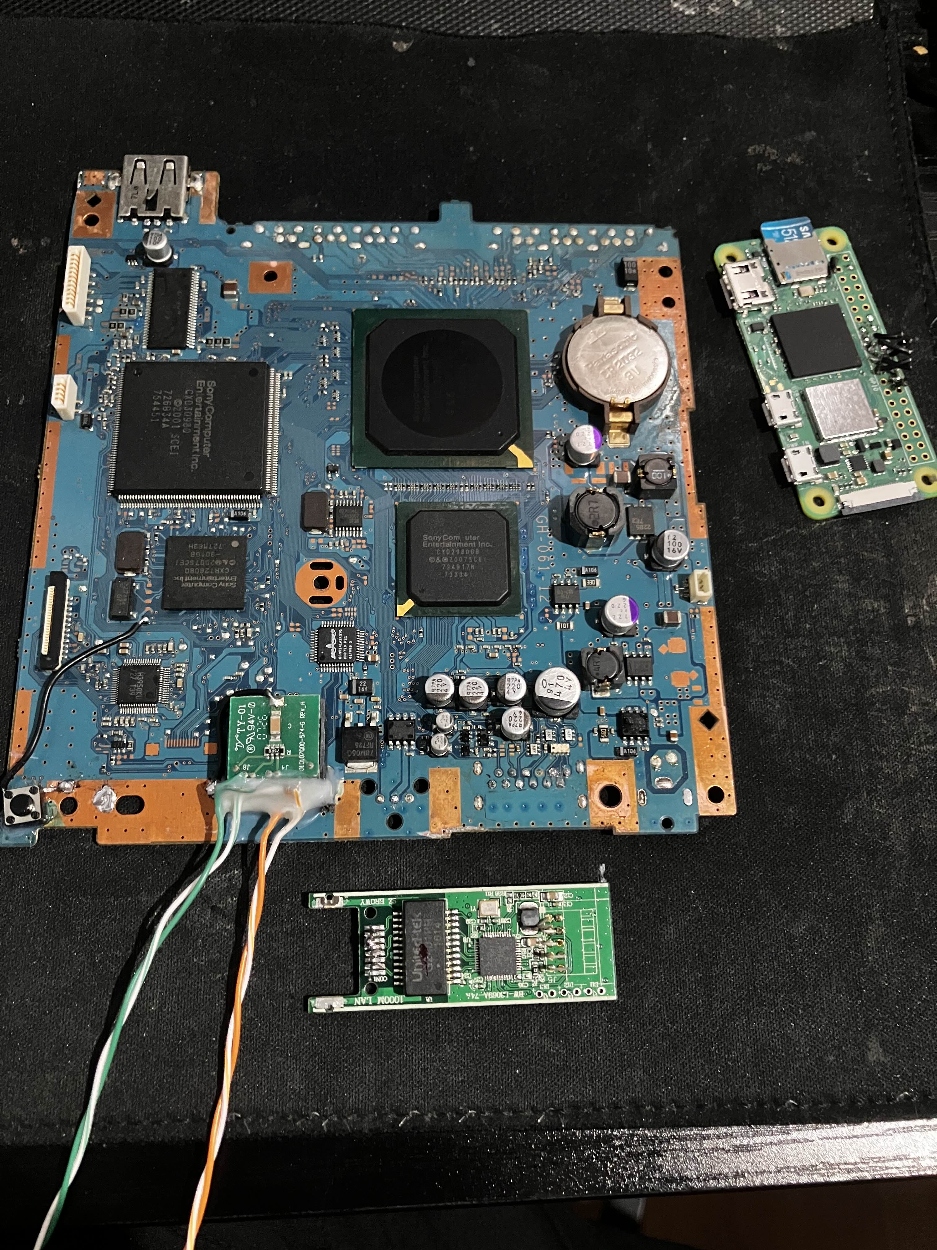

Little update on my own build. The PS2 works with the USB-C and turns on, and boots just fine.
However, I must have done something wrong with the memory card cause it's not booting from the memory card. I do have a feeling that because it's not a Samsung card, that could be the reason it's not reading. Which, if that's the case, i'll have to wait until I can buy one. lol.
But I also wouldn't rule out the fact that my wiring could be wrong as well, even though I did follow the instructions exactly.
Will update once I figure this out. :)

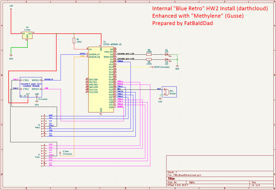

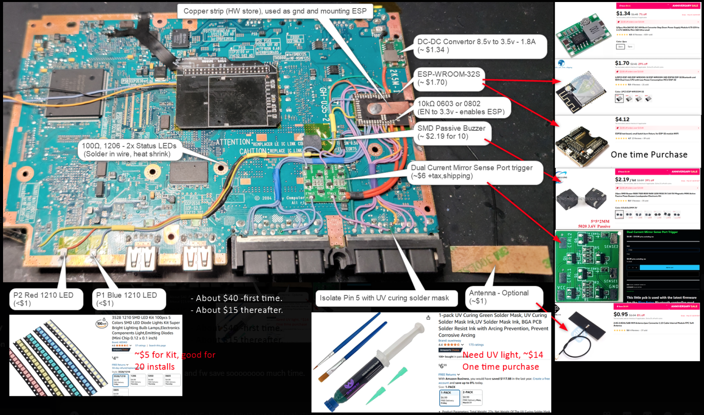

I’ll drop this here for now, since I include this mod in a lot of my Ultra Slim builds—but if we continue we should probably go to a different thread as we may get into some details of just the BlueRetro.
This isn’t the same as simply soldering in a BlueRetro Core. This is the internal BlueRetro HW2 "enhanced" install, which allows you to power on, power off, and reset the console using a Bluetooth controller. It functions exactly the same as Gusse's "Methylene" so exact, it uses the Methylene FW.
I've been working on a tutorial for the fat and slims—it’s not quite finished, but for now, it lives in a thread over on the "PS2 Scene" Discord (highly recommend joining if you haven’t already).
Below is a screenshot of the BOM (in a diagram form) to help you get started. I originally set out to follow Darthcloud’s HW2 internal BlueRetro install, but I ended up creating what I jokingly call a “poor man’s Methylene”—or the “Ali-thylene.” To be clear, my intent was never to reverse-engineer Gusse’s work—just to build the internal HW2 install. However, I found myself naturally converging with elements of Gusse’s design as I progressed.
I’ve since reached out to Gusse and received his permission to write a tutorial on this DIY version. He was completely supportive. Honestly, this might convince some folks to just buy the Methylene, because it really does save time and avoids a lot of potential headaches.
That said, this DIY method is cheaper—but it’s a lot more work. Still, it was a rewarding challenge, and I learned a ton from the process.
Please remember to support and credit Darthcloud and Gusse—they’ve both contributed amazing work to the scene.

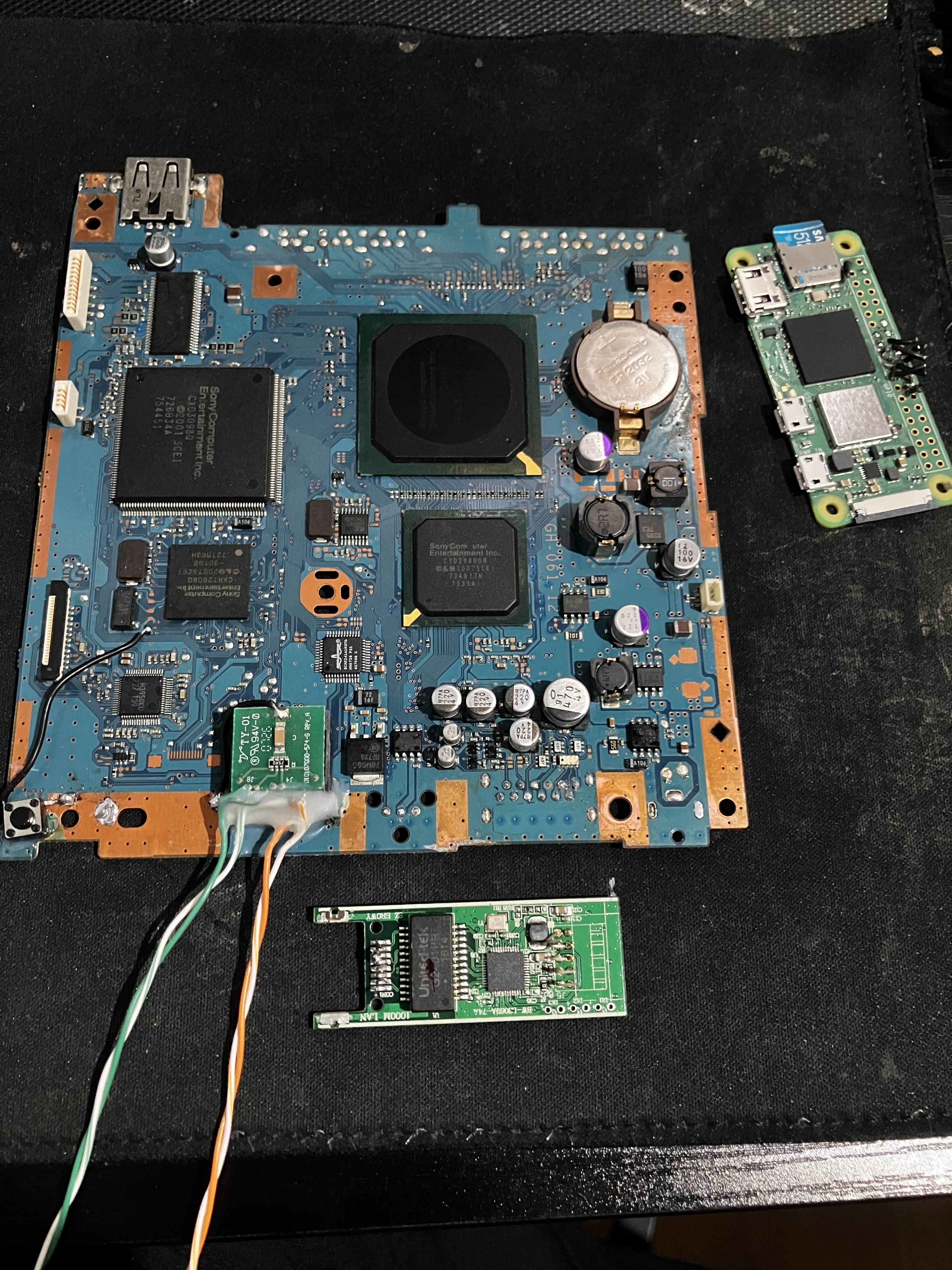

Little peak into where I'm at. Again; will be putting everything internal - except HDMI port, power port (USB C), Front USB, and likely USB C for blueretro + the button for it.
Haven't tested anything since removing all the components but yeah, pretty optimistic about it working still. Printing out the bottom part as I type this, so I'll probably start tacking down things that'll be underneath the motherboard at least. Can't wait!
(Oh the bottom PCB is a usb ethernet)

Hi, could you tell me what you're using the Raspberry Pi board on the right for in your project? Is it for sharing games via Ethernet?
Yep. I'm going to be wiring it internally, with a UPS Hat for the pi zero (so it can turn off safely, rather than immediately when power is removed).

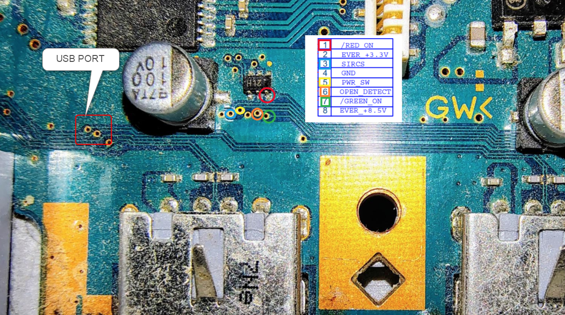

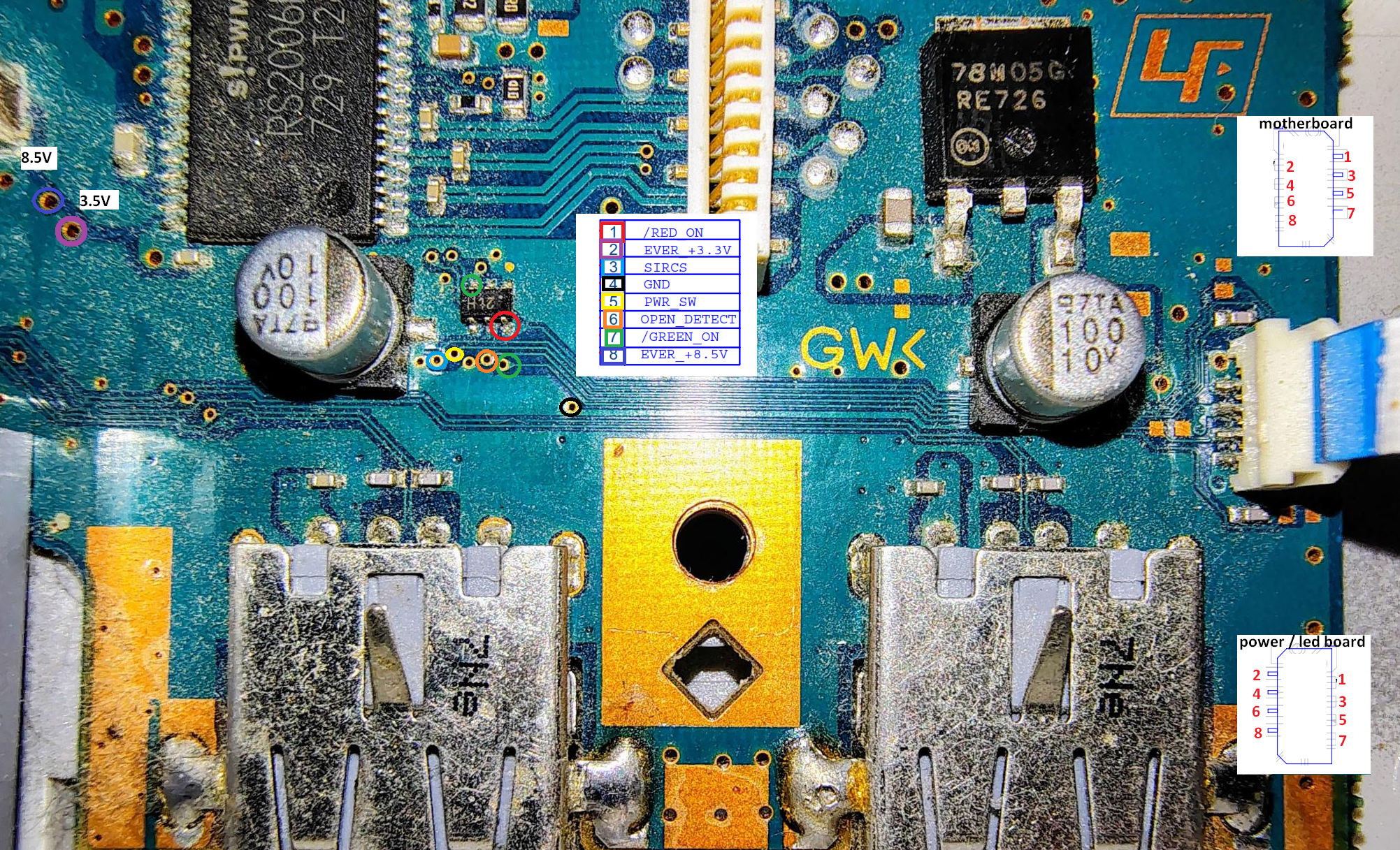

Hello everyone just wanted to share an image I made just in case anyone wants to use the original power board for 7900. I have mapped out the points to connect to. FYI they're TINY. I assume it will just be for the green, red LEDs and the power button so it's not that bad i suppose. I'm beggining to build a ultra slim but I will be hacking / cutting the orignal case and see how that goes lol
P.S. I have not tested this yet but just made the measurements. I will report back after i solder the wires to the board!
Nice, thank you for sharing!
In addition, consider mounting the piece piece you cut off with a USB drive then solder the vreg and the data lines back in. You can update the files with the external port that remains. There are pics in previous posts in this topic.
