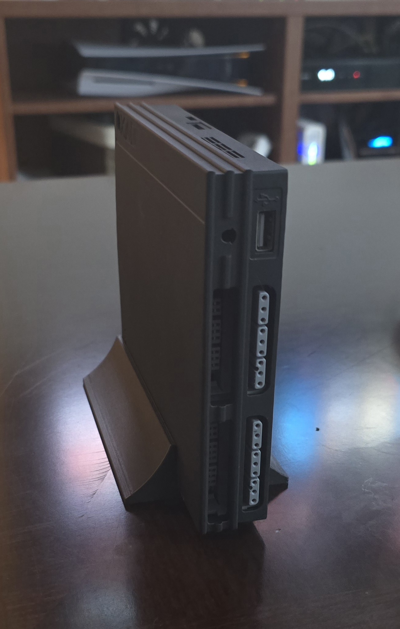

This is how it looks printed in black resin, from PCBWay. Not bad, the only problem is it feels fragile, like it can break if falls. The original PS2 was silver satin, so that's why the color of the controller ports.

Yeah resin is a bit fragile, no way around that sadly. I like the two tone appearance that the pale ports provide. Very nice build!

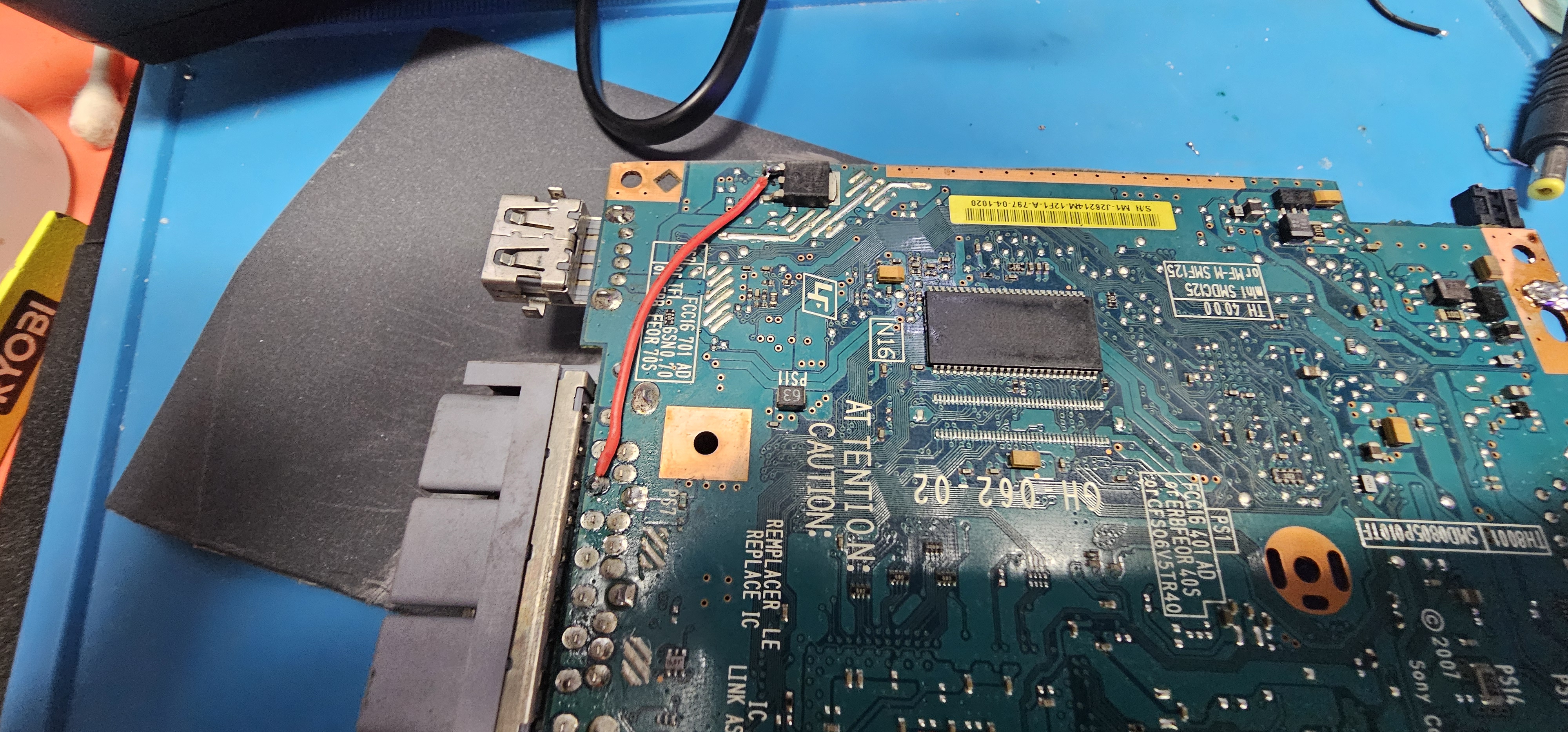

I got tired of the stock squishy disc tray switch. I absolutely couldn't stand how that felt when turning the PS2 on. So I decided to use some clicky buttons I had ordered previously for the power button. They were slightly too big, but I got it working! Had to shave down the plastic power button a little bit, but now it fits great. No more accidentally turning on the PS2 with a slight touch. And it gives a nice firm click when pressing the power button.
I kinda also want to make a better power solution instead of just using a wire from the board to the USB-C port. Something like a port or plug that I can just solder onto the board and have the other plug on the cable, easy to detach without soldering.
And I also still want to figure out how to add a power LED, so I'll need to do more research on that as well.

I've attached pictures of my latest build to give you an idea.
The material is is:
HP MJF Nylon PA12
The color is:
Dyed black
The texture and finish is:
Shot peened
I used a website called CraftCloud that guides you through the whole process and makes it easy for you, then gives you a selection of 3D printer vendors to chose from depending of what you selected, your location etc etc, give it a try and it will show you what the finishes and materials look like.
If you want transparent, the PCBway transparent resin is the answer, but be prepared to pay extra.

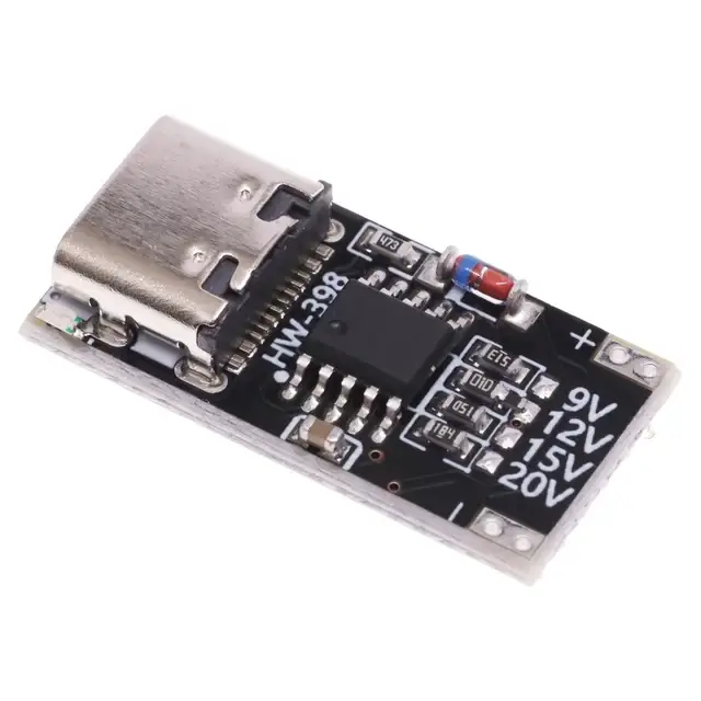

I modified a v1.2 case to accomodate a PD trigger board to use instead of a regular DC jack. @Wesk might want to add this somewere in one of his posts
This is for a HW-398 trigger board.
Make sure your trigger/decoy board is set to 9V
There are no guarantees that powering your console this way will not fry it. PS2 79XXX is rated for 8.5V input so do this at your own risk.
The print for me was a snug fit and I think you can just push the board in without a retainer but you risk displacing it. You need to push the buisiness end into the hole first and then push the rest of the board flat onto the platform.
You will need to use 2 M3x6 screws to mount a retainer. The screw holes are small enough for the screws to self tap. Make sure to not overtighten them else the standoffs will break off.
I am including a test part so you do not need to print the whole half to test fit your board.

Hi! I've got question regarding the usage of HW-398 trigger board - does it support modern PPS standard chargers which provide 3.7-11v at 5Ampers? Some GaN chargers have support for such standard at theoretically can be use to make 9V/5A output for PS2.

I've found that they do require a specific type of charger. Either a fast charger or super fast charger, as some cheap chargers, or ones that just provide basic charge don't seem to work.
I have these specific chargers, and can confirm that they work very well:
- UGREEN 65W USB C Charger Block, Nexode 4-Port
- SAMSUNG 50W Duo Power Adapter Wall Charger, 2 Ports
- Samsung 25W Wall Charger Power Adapter
I would assume any GaN charger, Fast, or Super Fast Charger for phones would work just as well.
I just tend to buy multi-port ones to use on multiple consoles at once.
However, something like this should work, too:
UGREEN 30W USB C Charger, Nexode Foldable GaN PPS Compact Fast Wall Charger Block

You missed the point of my question. These specific chargers that you sent work, sure but they can't provide 5A at 9V through PPS... Advertisment of HW-398 have usually written that they support PPS handshake and some people have issues with it. PPS is the only way that you can have 5A at 9V. For example this one from Anker have compatibility with PPS and can provide range (PPS): 4.5V-20V, 5A (100W Max). This is really cool but like I said some people say that HW-398 board cant communicate using PPS and just use 9V 3A from PD 3.0...

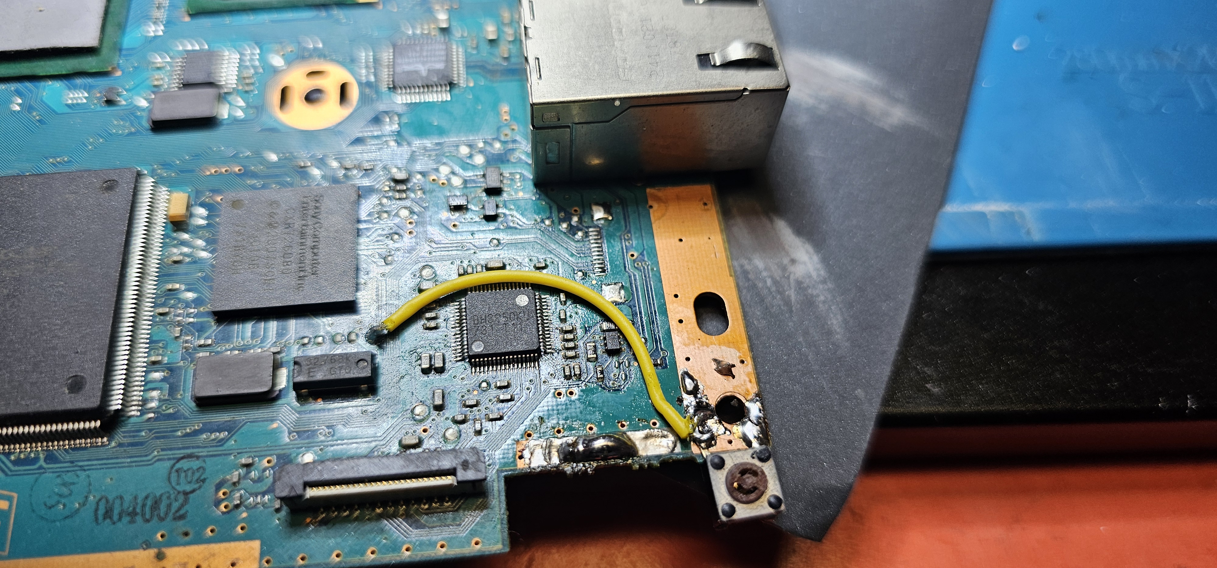

hey so i have one of those boards that does not have a power switch ive followed titos build do far but i dont know where to cut the trace and i am also not getting power
i am new nice to meet you all:D
Do you mean the lid switch? When there is no lid switch you can skip that step (cutting the trace).
Can you explain "not getting power" more, please?
If you mean you cannot power it on. You need to ground the reset pad with a pb. Read up on this thread it's covered a few times with some clever solutions.

Here's the pictures of my build so far
I see the problem here: you have the reset pad soldered to ground. It should be connected to the N.O. (normally open) contact on your push button. When you press the button, the reset pad should make contact with ground. Additionally, you have both contacts of the push button tied to ground. One side of the push button should go to ground, and the other should go to the reset pad.
