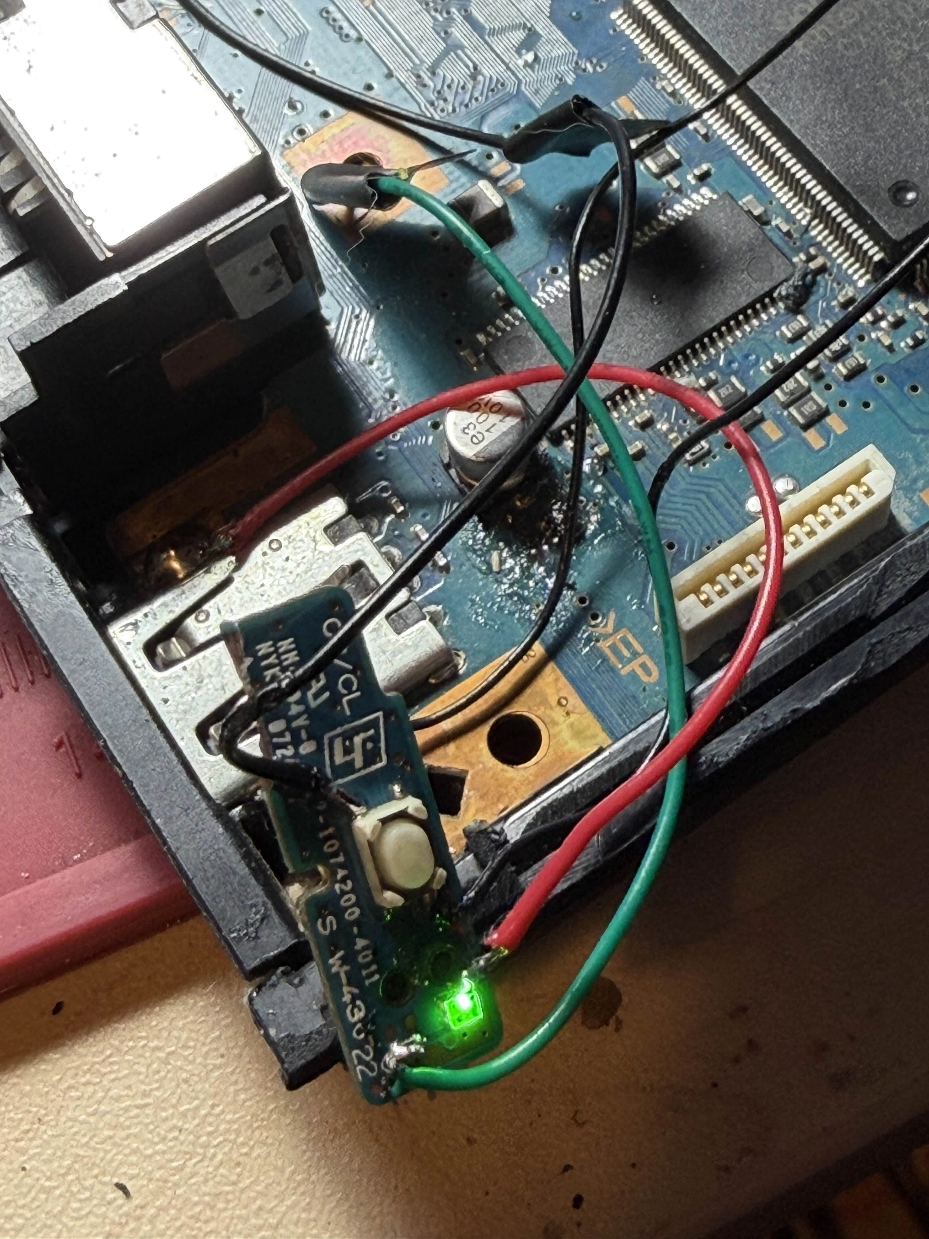

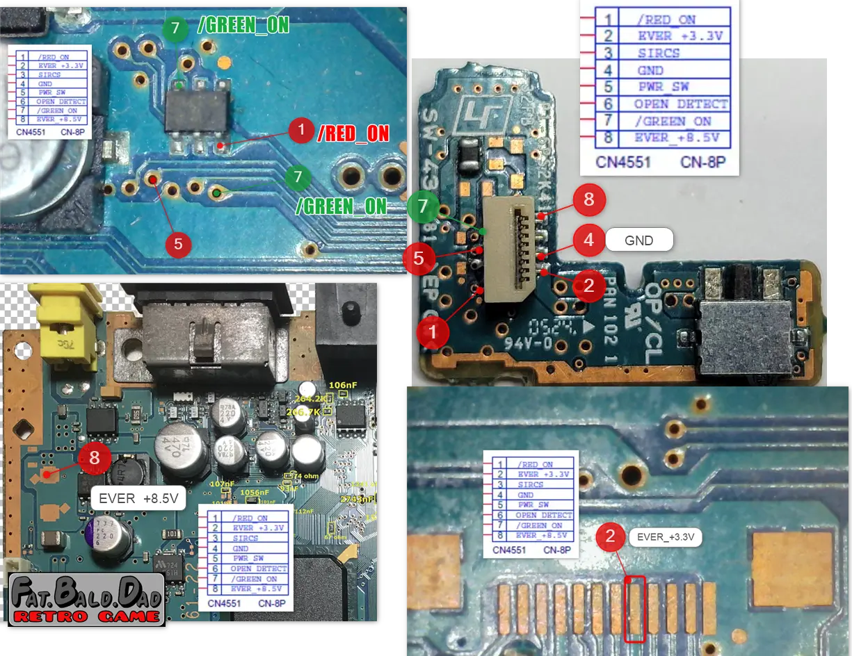

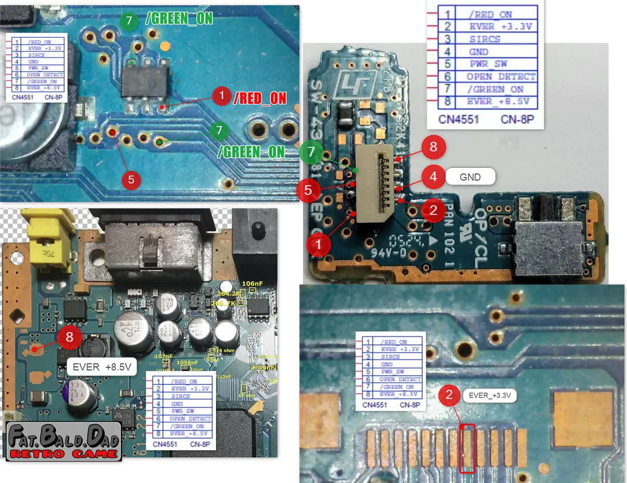

Hah, I might be wired badly or something but, whenever I touch, well, pretty much any pin OR ground with Green LED (7), the console just shuts down. And I cant get the green light to turn on, only the red one. Weird.
Are you following the schematic in the above link?
I added a diagram that may help a little more.

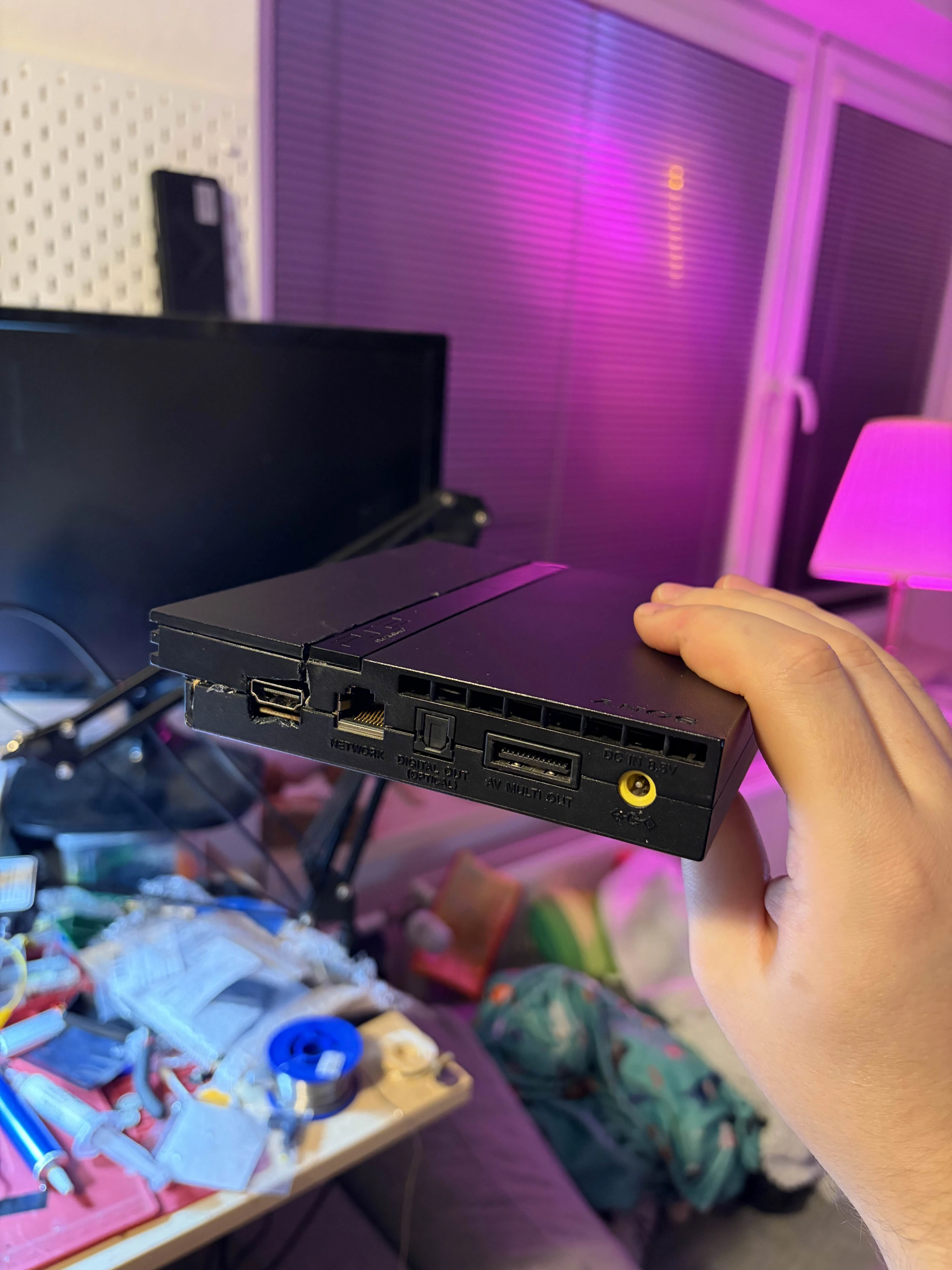

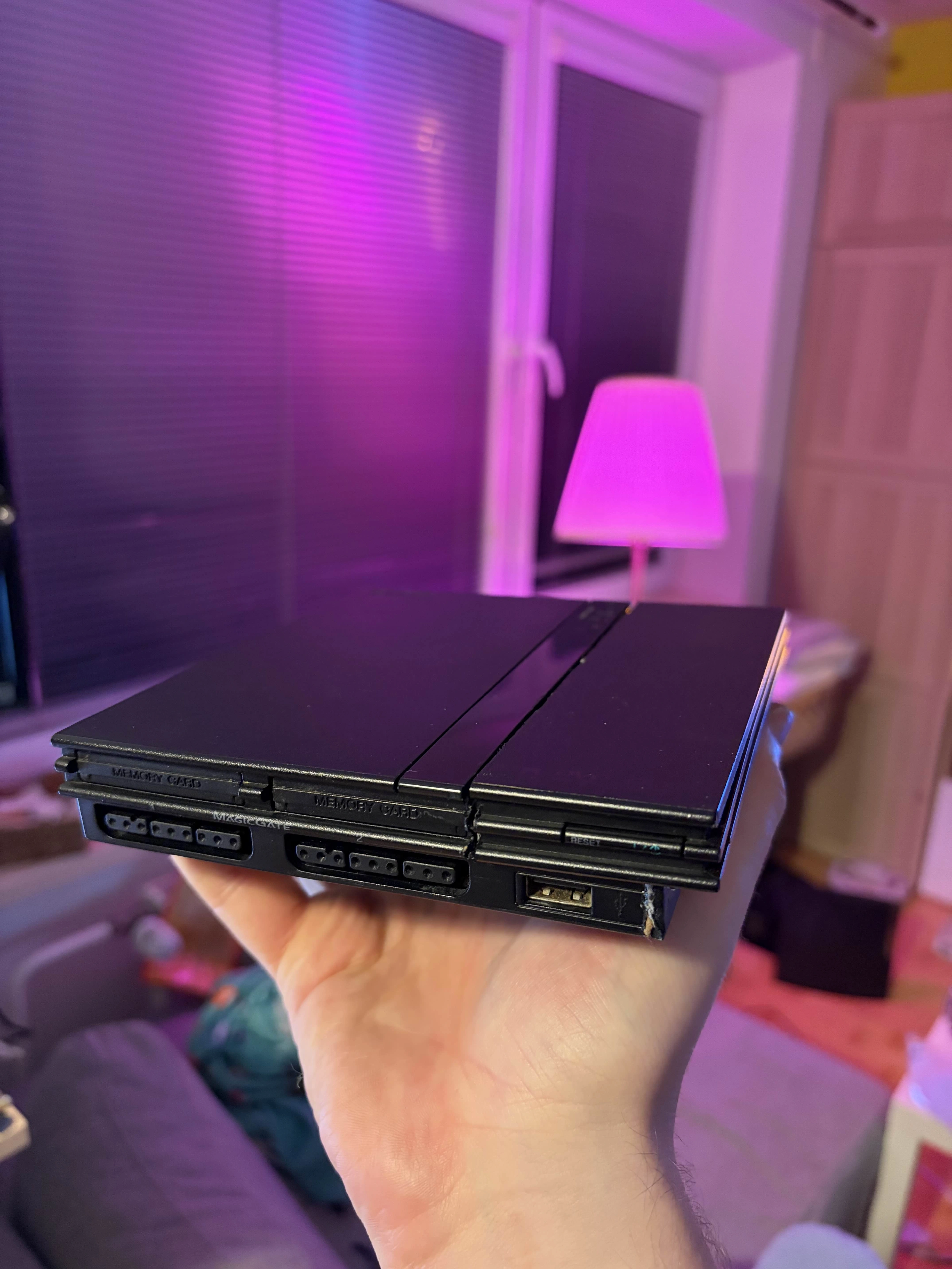

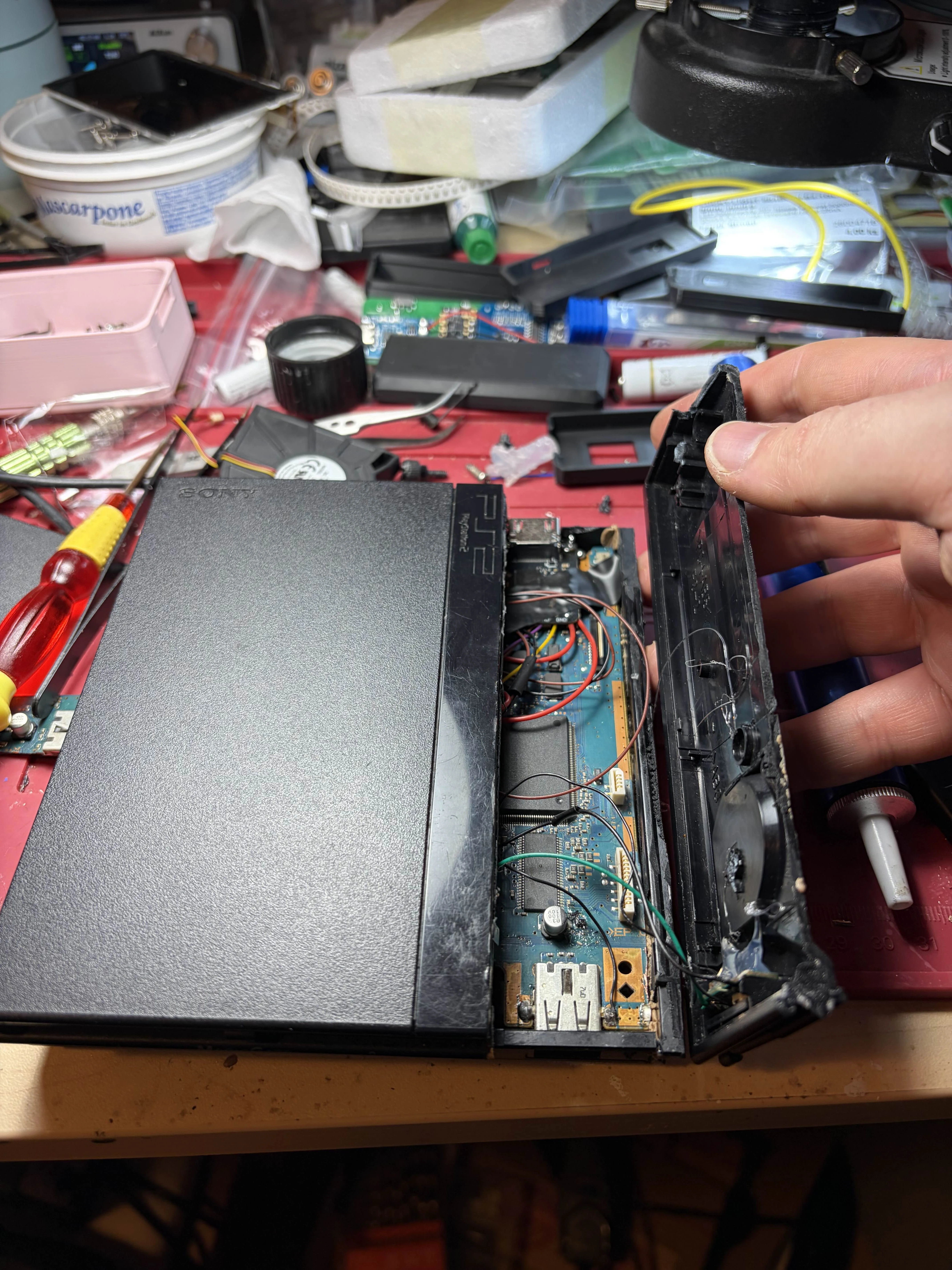

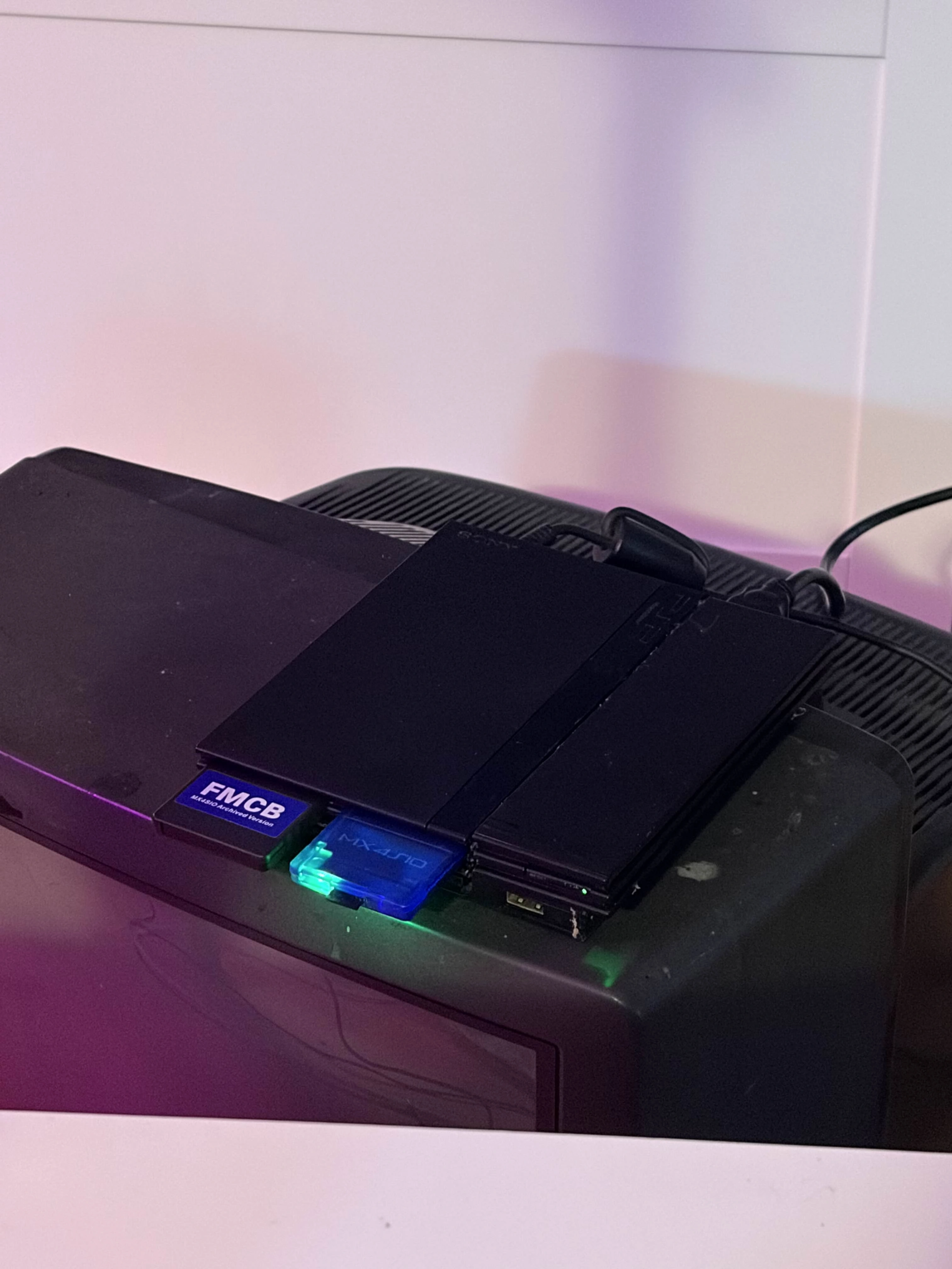

Thank you @FatBaldDad for previous advice. I have "completed" the UltraSlim, I wasted 2 days doing something I didn't have experience with and now that I'm looking at it, I hate it :/ I wanted to have a true "PS2" UltraSlim, as in, a true original shell, memory card springs, the LED, bells n whistles! So I spent 2 days fighting the pinouts for the power pcb, I dremelled entire today which just made so much mess, uneven surfaces, it all just looks crooked asf :/ Here, take a look. It's "done", but I am going to dissasemble it out of spite and print myself the usual UltraSlim shell. On mine, the ElectronShepherd doesnt hold properly, the power button holds by the will of the hot glue... eh... I tried. I didn't comppllletely waste the time, I guess, it taught me some stuff.

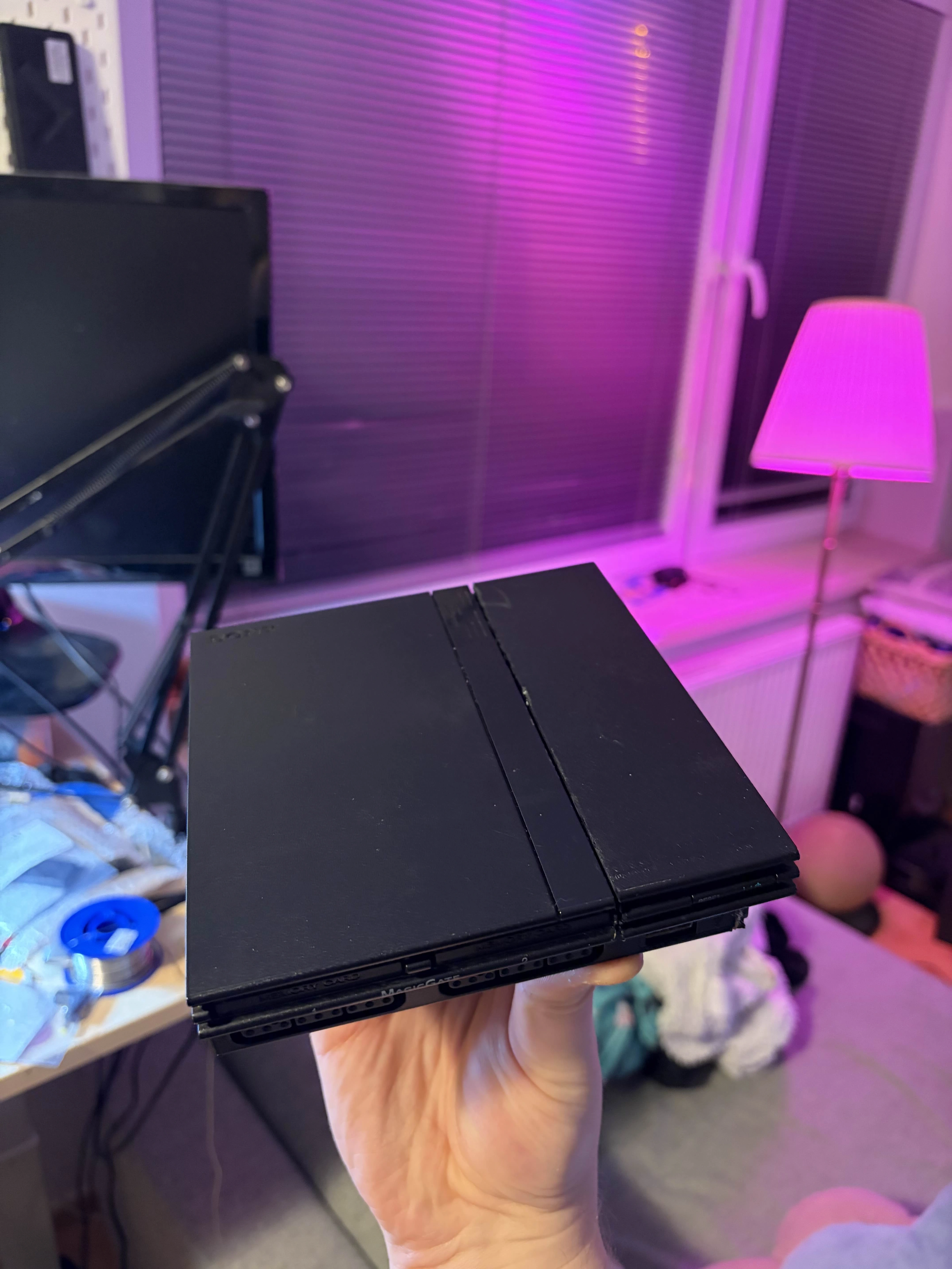

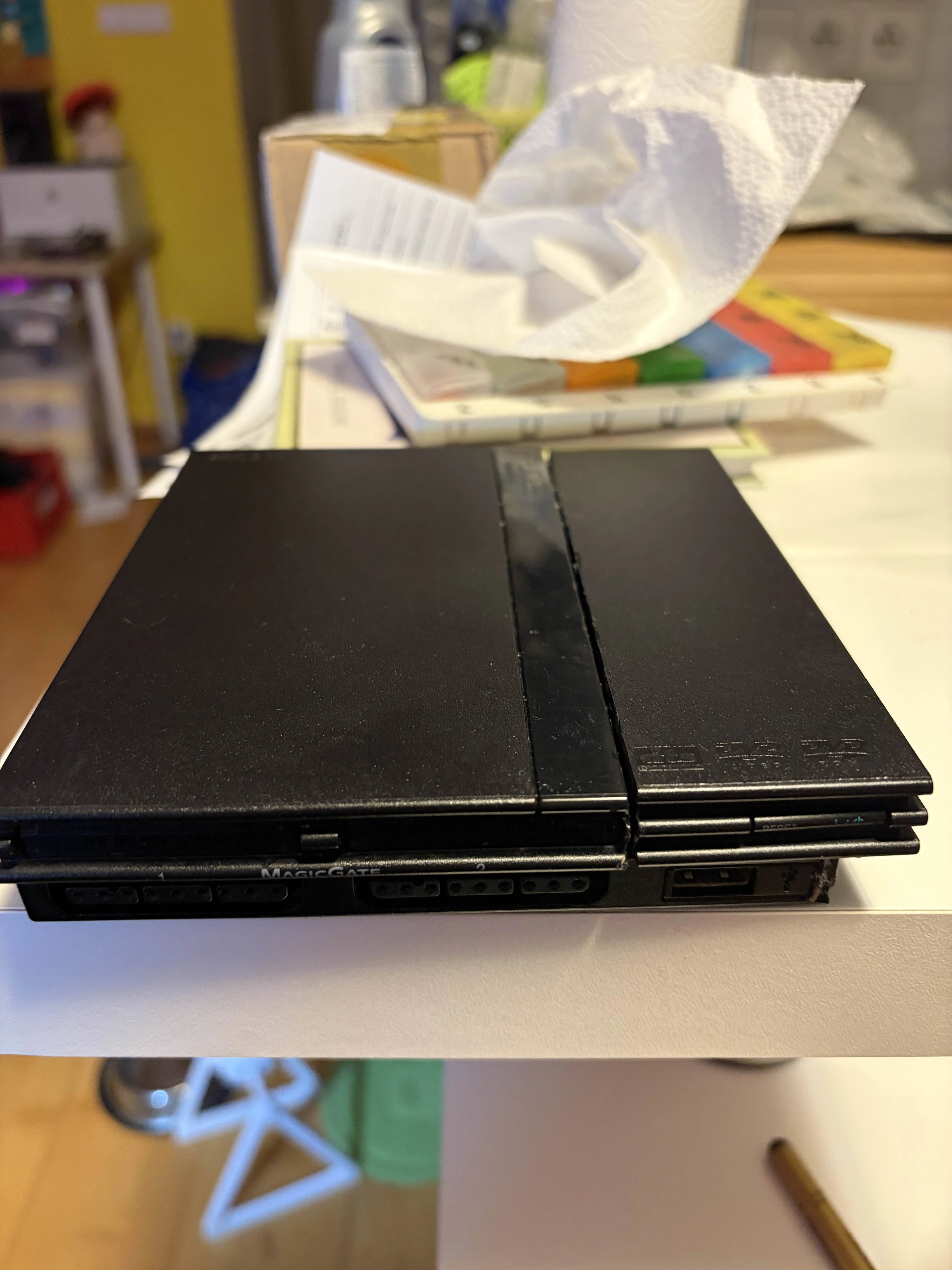

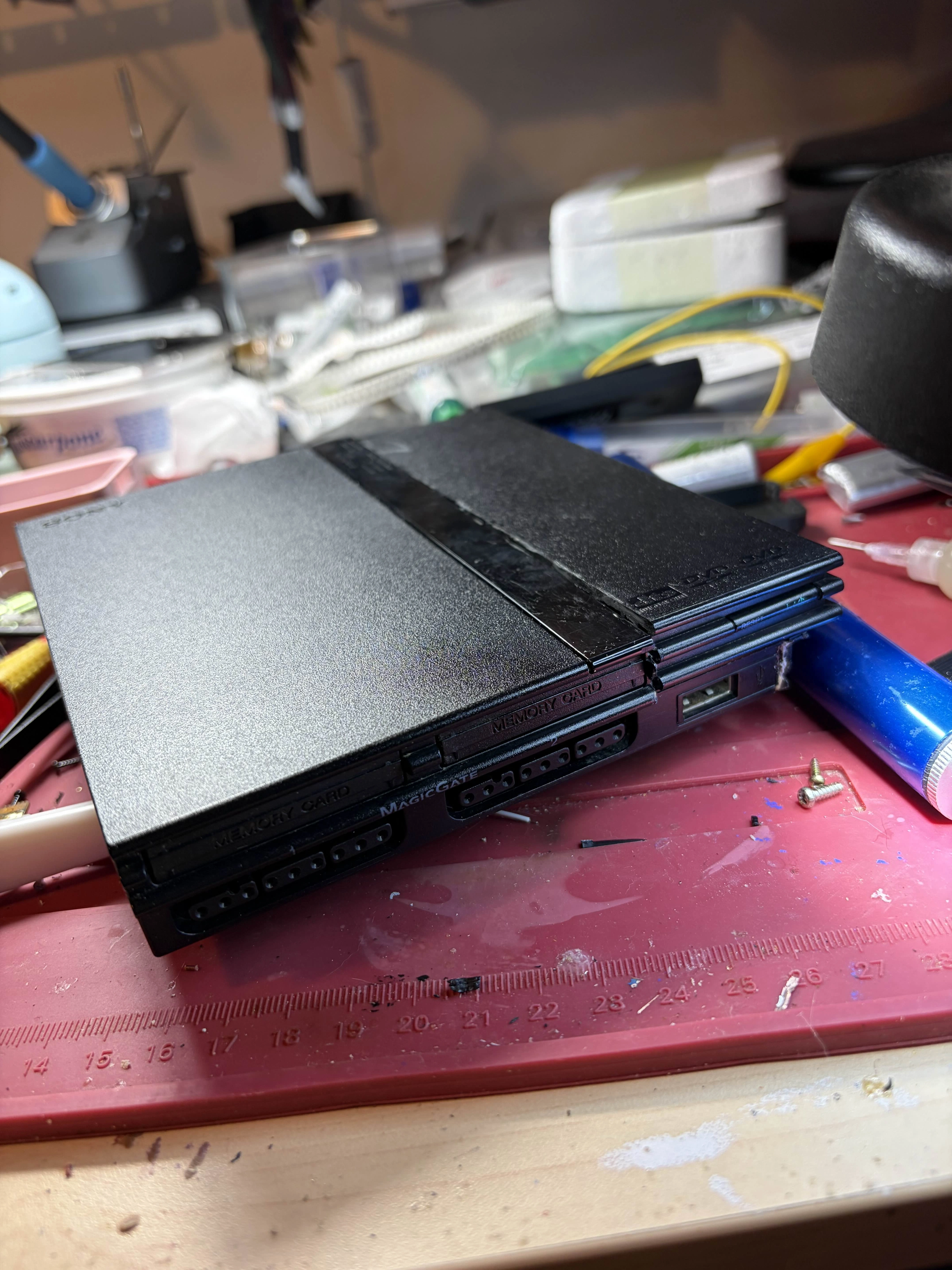

Aww, that just made my day ^^ Thank you for the positive words, and you are absolutely right! At the end of the day I had learned quite alot about the PS2, I scoured the forums for board scans, schematics, various 3.3 and 8v standby locations, I know the SCPH-79000 like my shoes now lol.
And you know what? I cooled down, I looked at the poor thing, and I thought... Well.. I already trimmed the shell for 2 days... I already cut into the heatsink for this specific case... I already snapped the power pcb in half and I really really wanted to have the LED right... I reeeeally really wanted the memory card spring doors that are missing in every UltraSlim build right?? :D So I said forget the new shell. I will do the unspeakable and help myself with a bit more hotglue - I assembled the shell and hotglued the necessary uneven spots, I secured the power button, taped the video wires away from 5v cause that was causing interference... aaand look! Doesn't look too shabby once FULLY closed and hopefully forever!

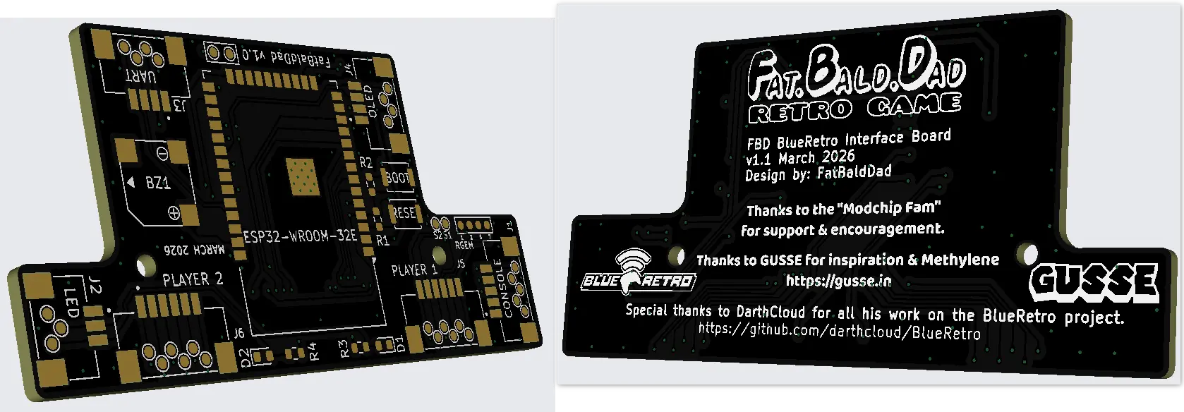

On this build I used a dev board. Now I have my own board.
I
I went with a more universal approach, has the boot/reset buttons, UART interface, and OLED. I put the pads together so you could use a JHT connector or solder to to a pad. I use it in other models.
