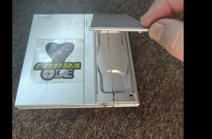

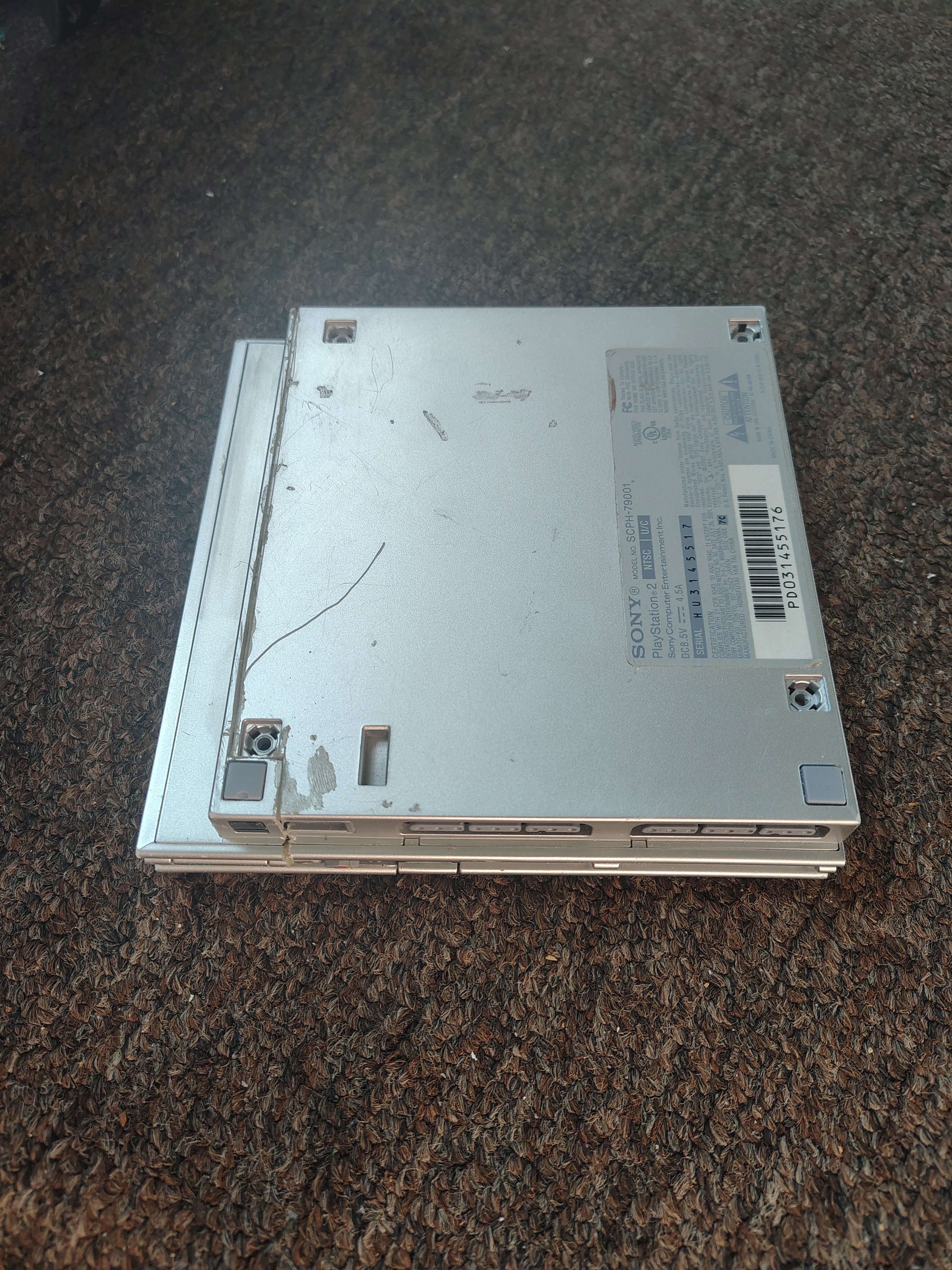

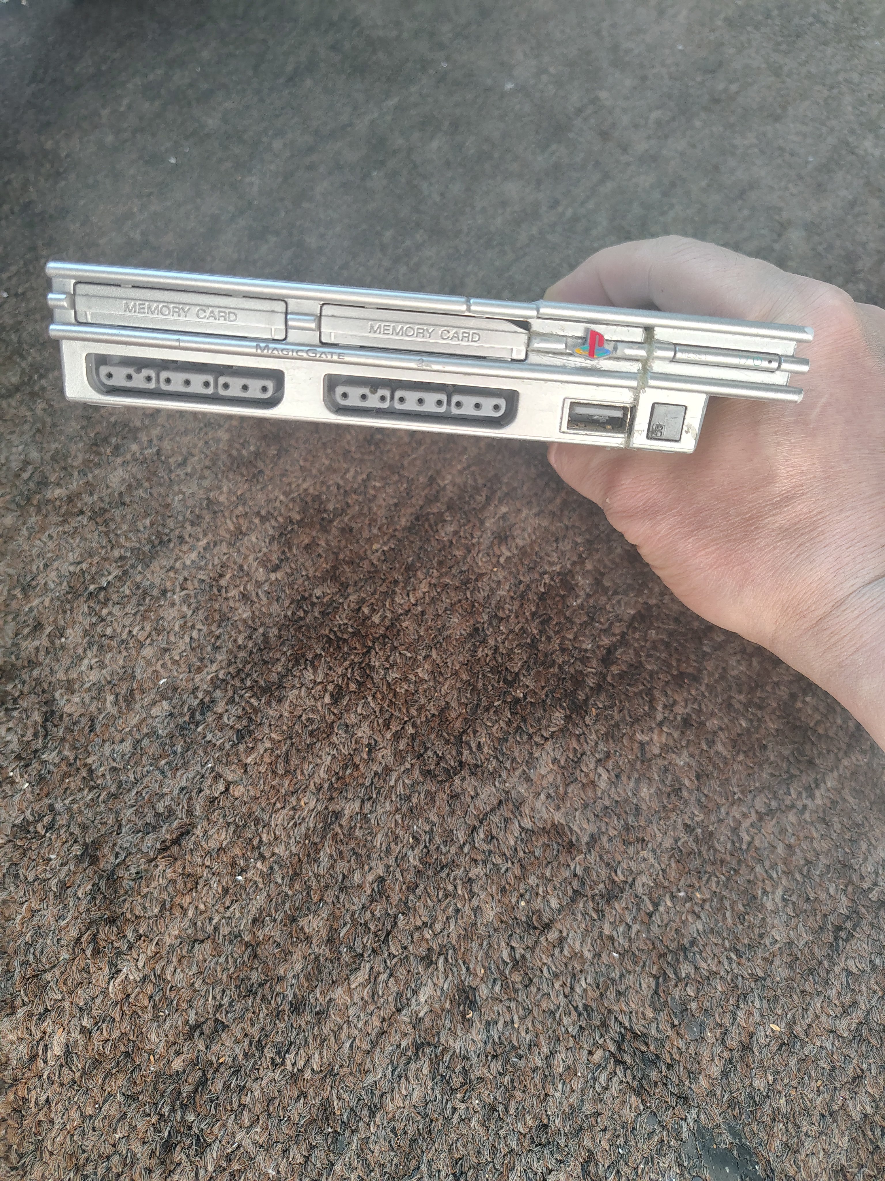

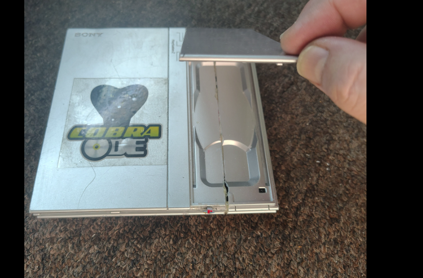

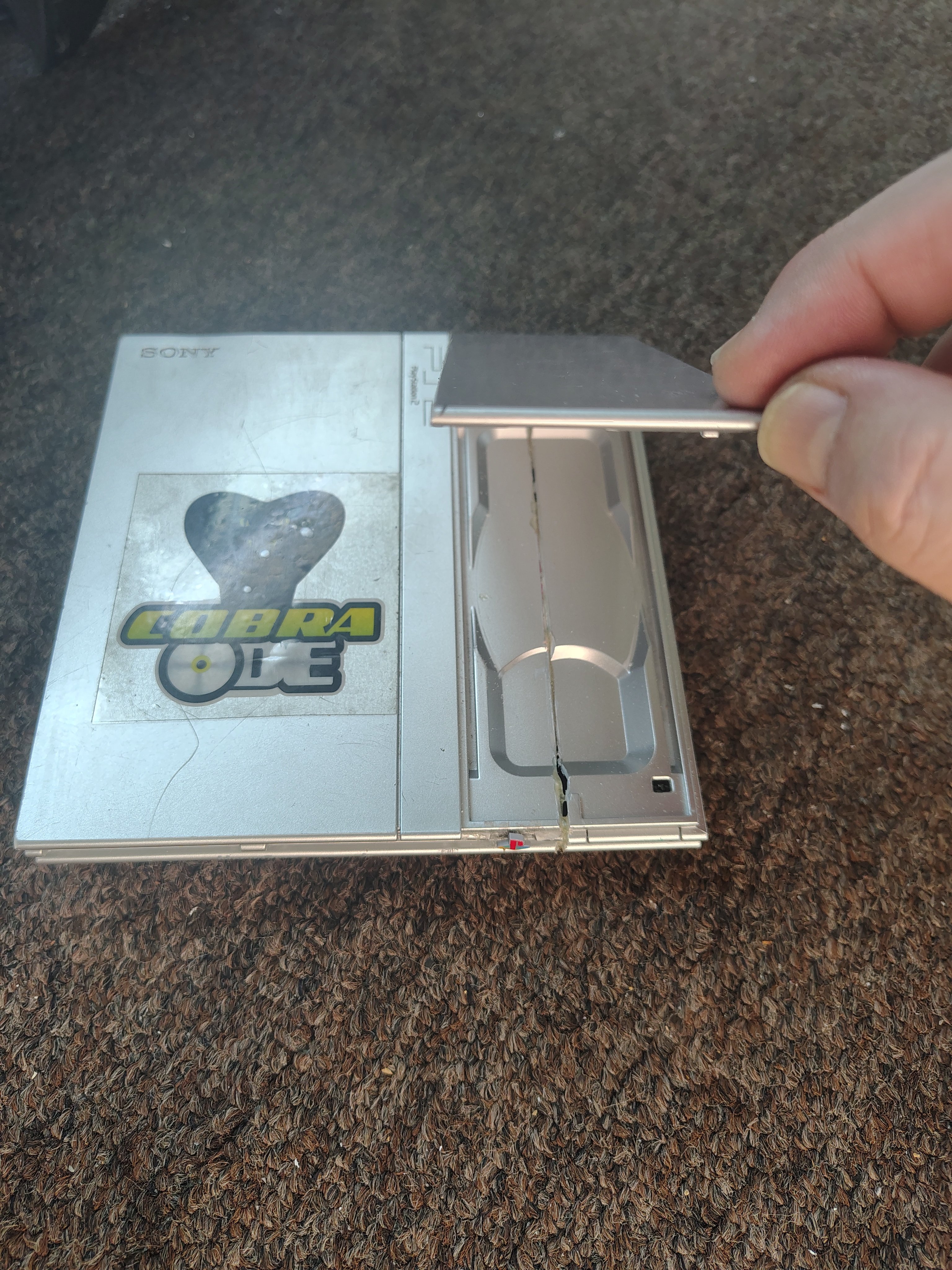

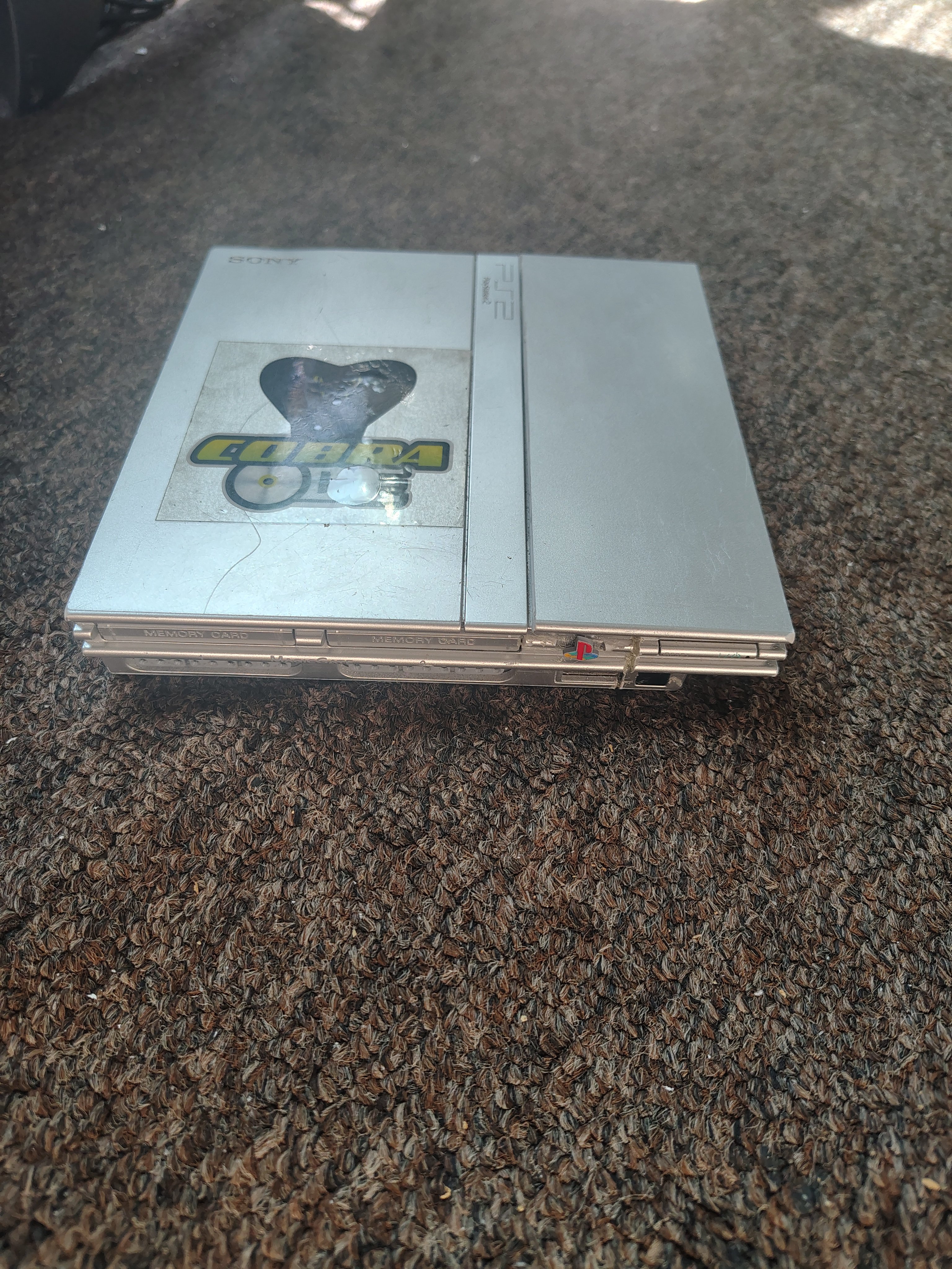

PS2 Ultra Slim
Here we go the PS2 Super slim. The sticker is there to cover up some deep scratch / tagging by a previous owner ;) Overall the stock look is very attractive! I still have to add all the other goodies.. hdmi, blueretro, SD card and a sd2psx board. As i used a case in really bad shape I really didn't do a great job cutting and gluing all the parts together. May have to try on a black console next time. I will post again after its completed.

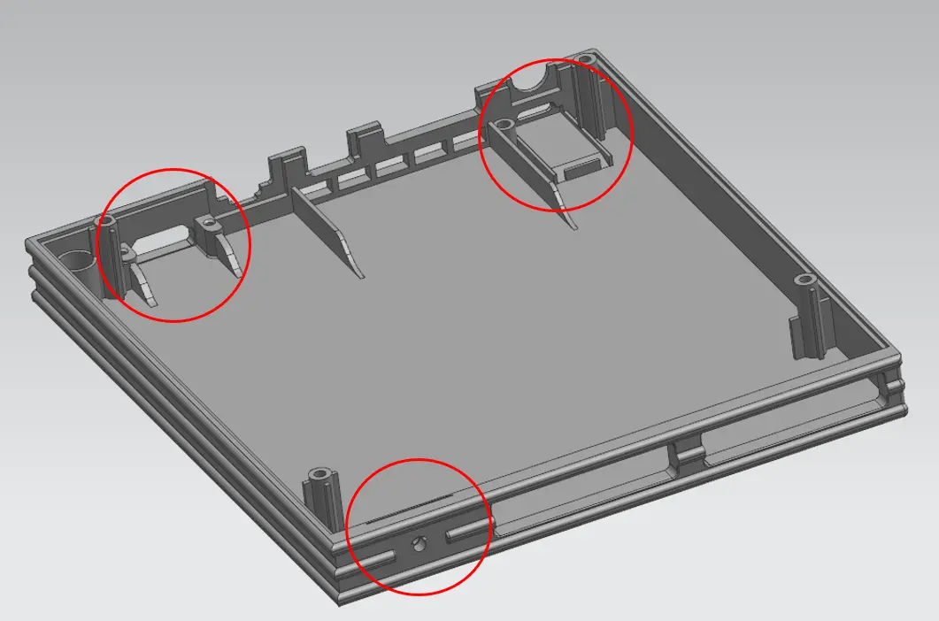

I have combined a few things in this stl file which was mentioned before, but i cant find a file so i edited the PS2 Ultra Slim Top v1.2 ElectronAnalog file.
USB-C PD combined with the original charger so you can choose what you want to use.
Electron Analog is flush with the outside of the Shell and is a bit more secured through the wall of the case.
Also the hole for the PS2 Logo was way to big for my 79004 Model. So a smaller hole with the slot for the original mounting bracket.
