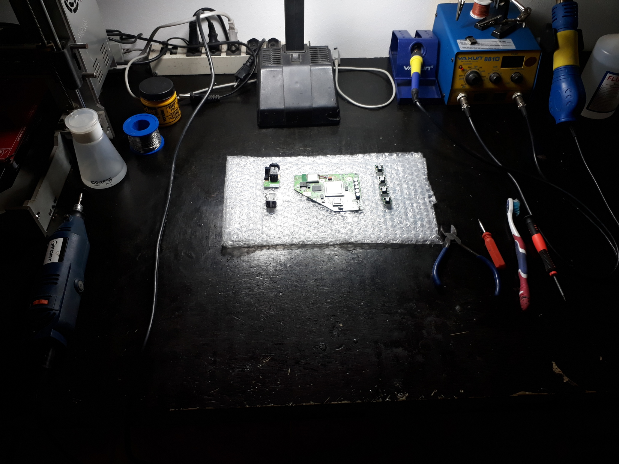

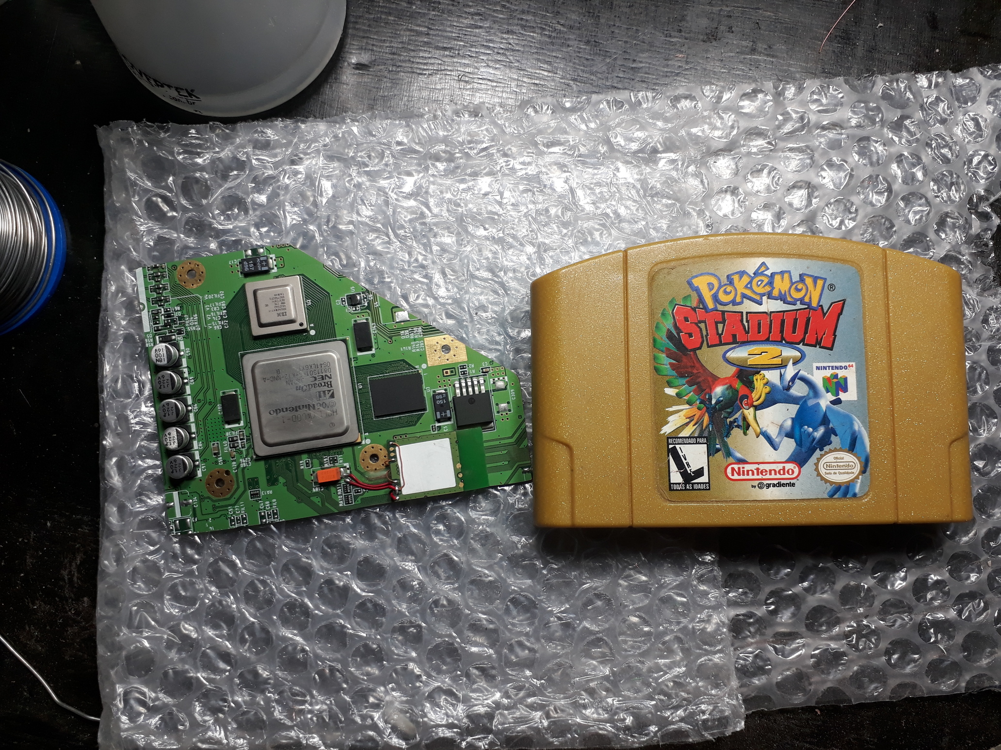

Some photos of the project so far:

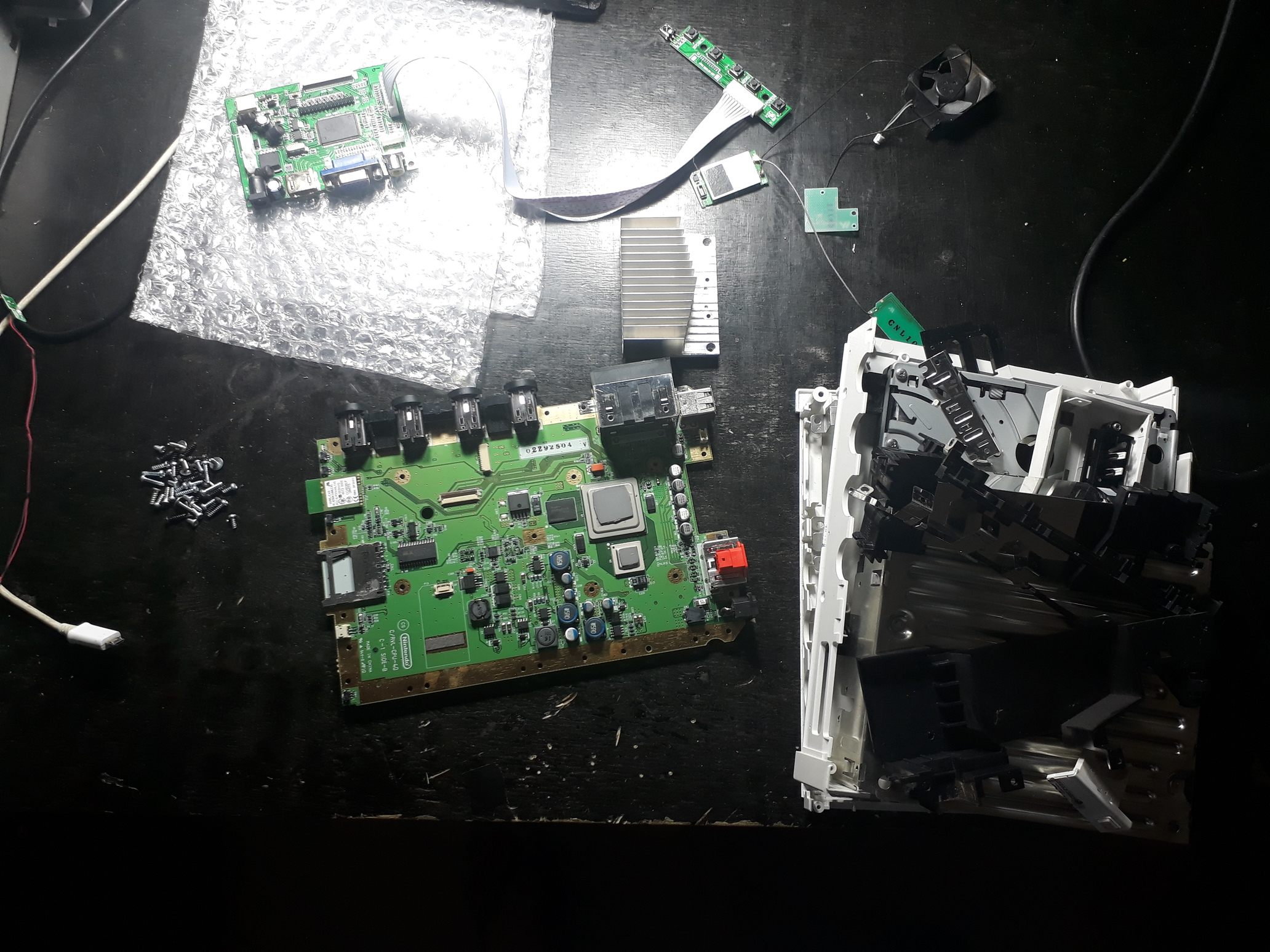

Unmounting the Wii ...

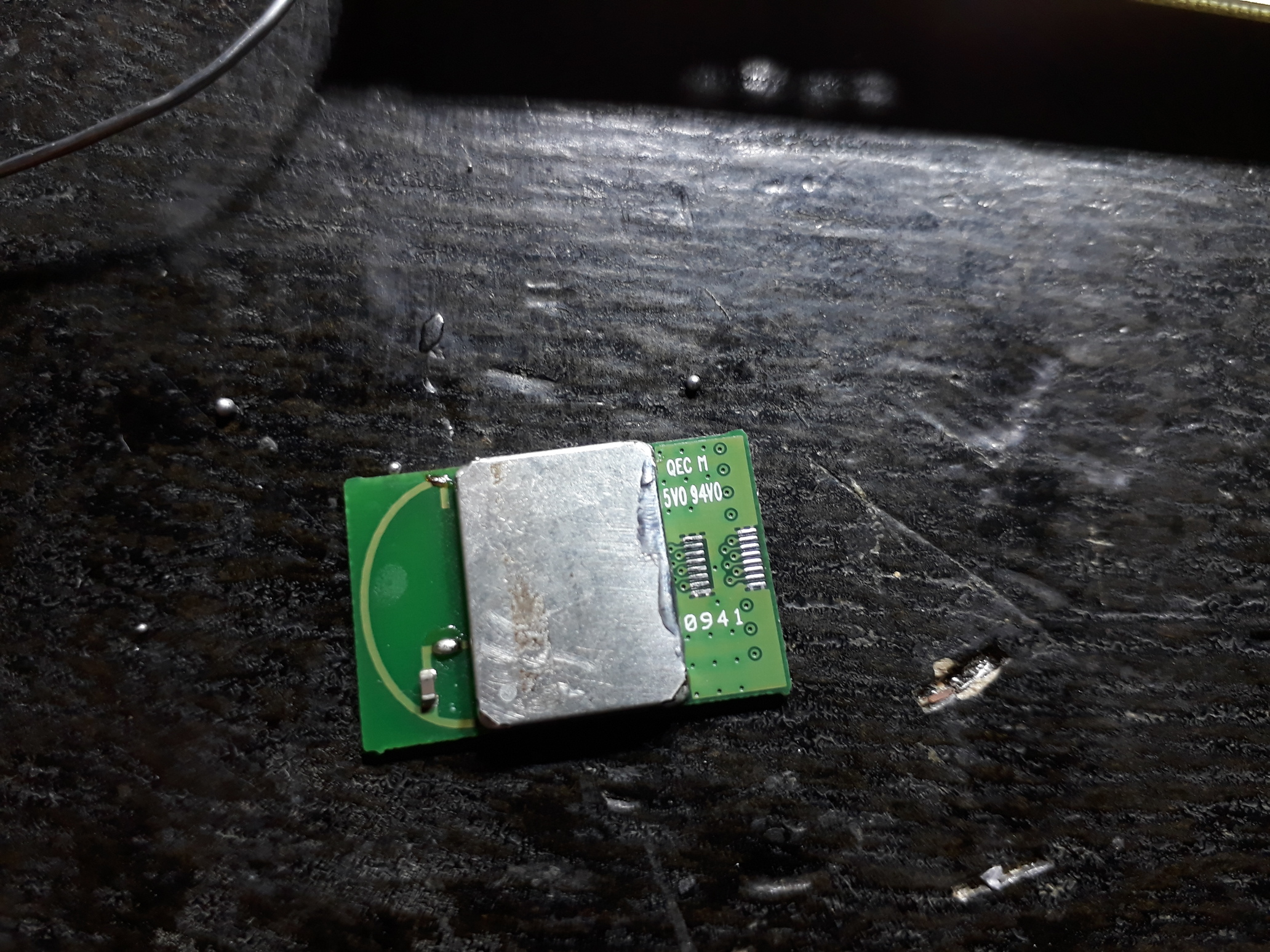

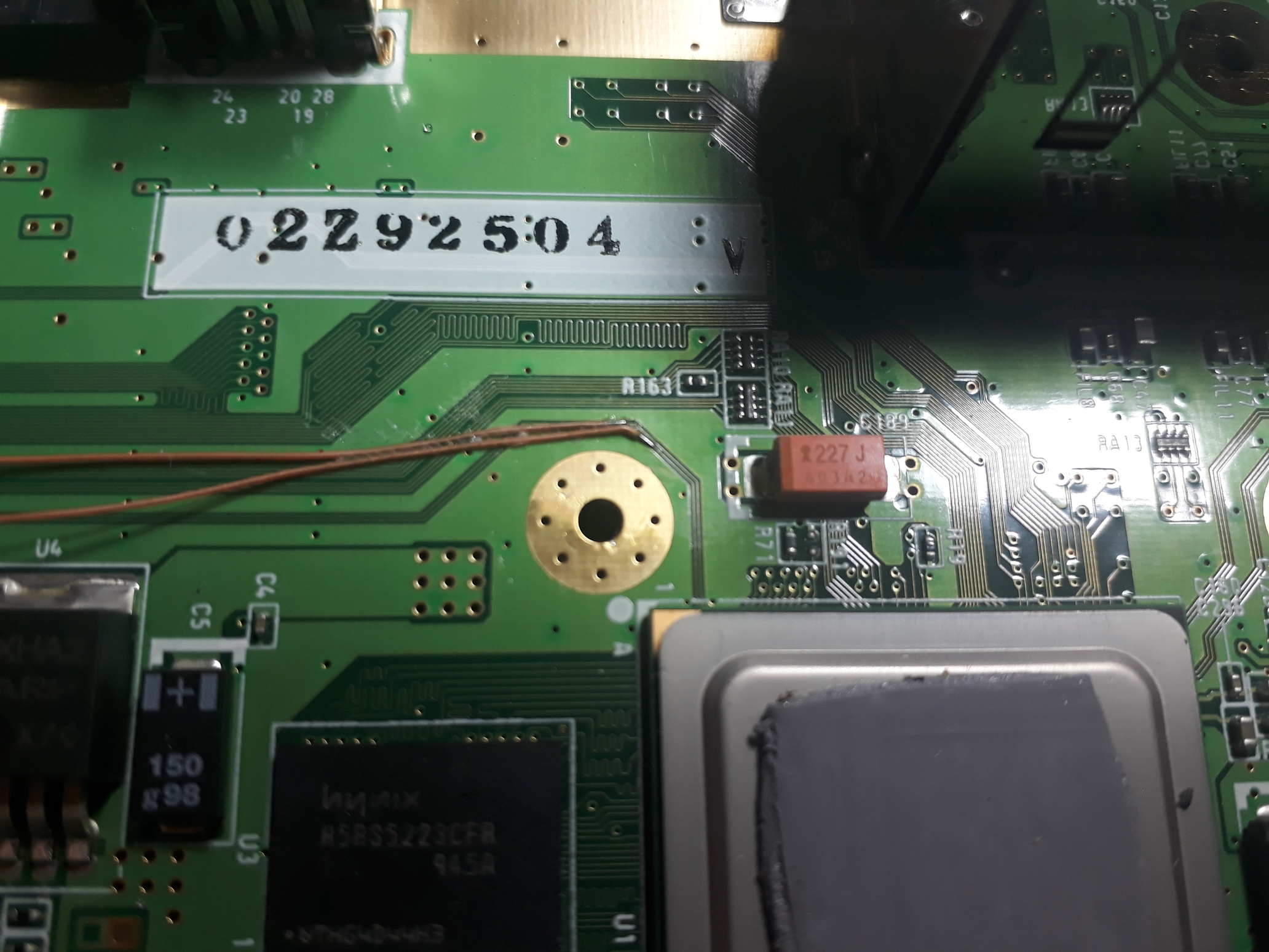

Relocating Bluetooth ...

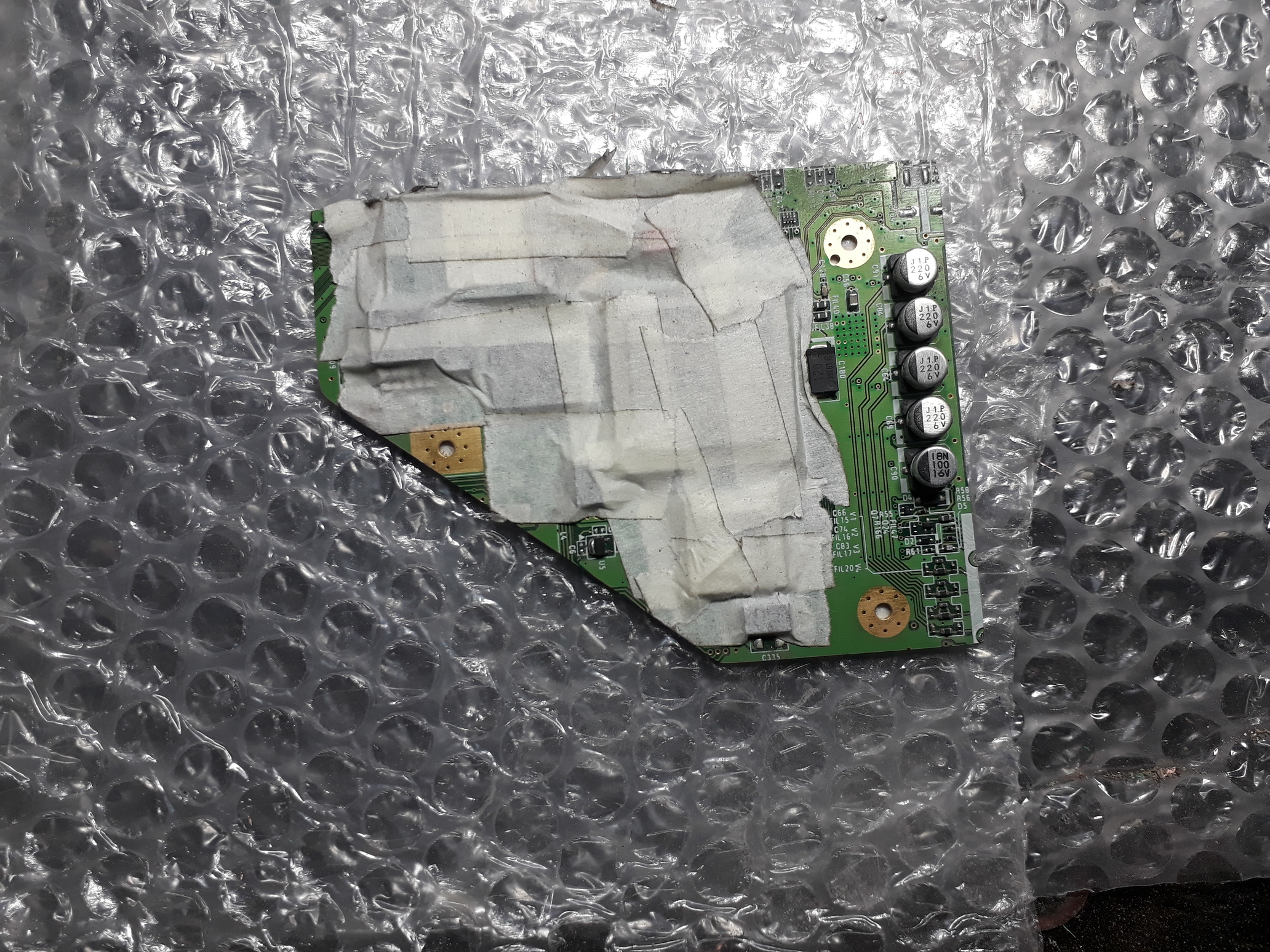

Glue on top of welds to protect, was fast service ..

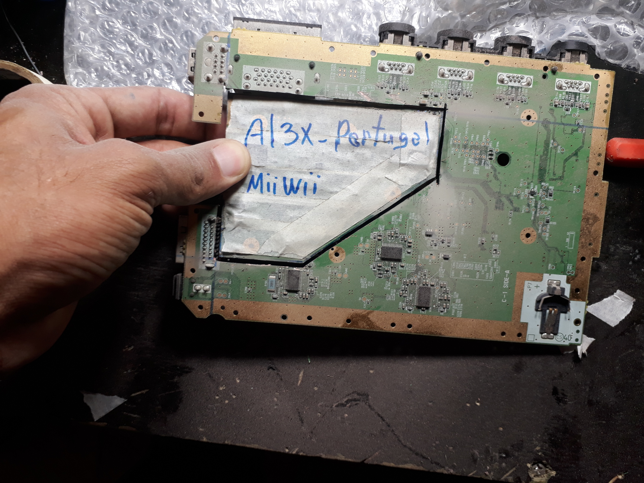

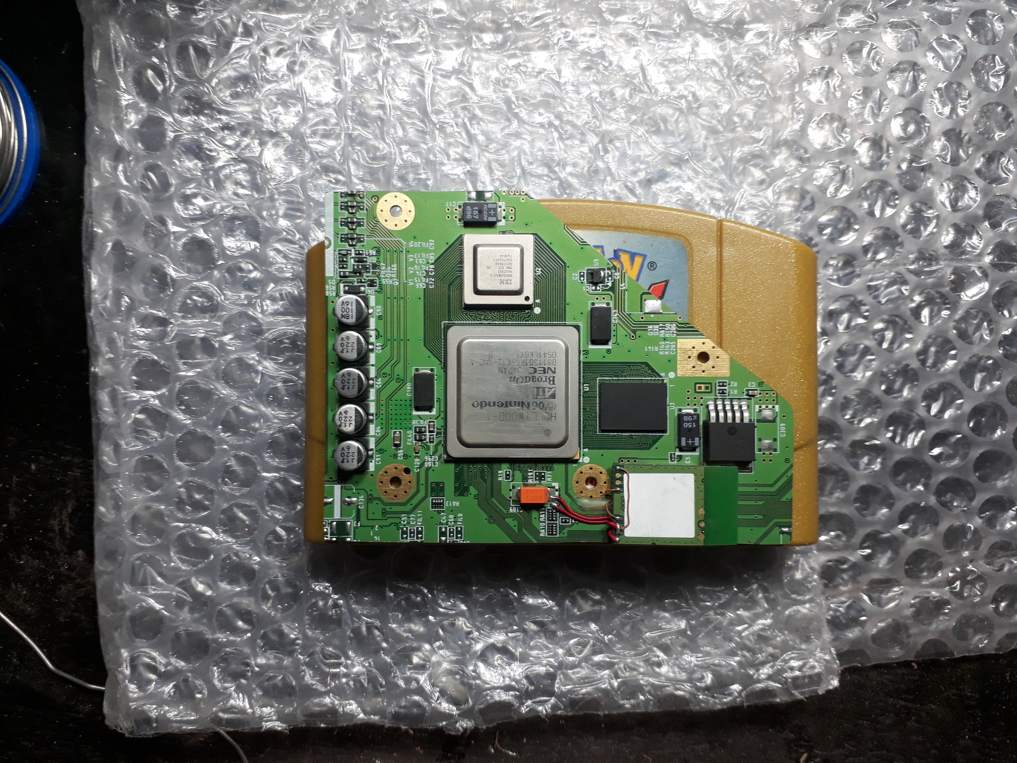

Plate cutting ...

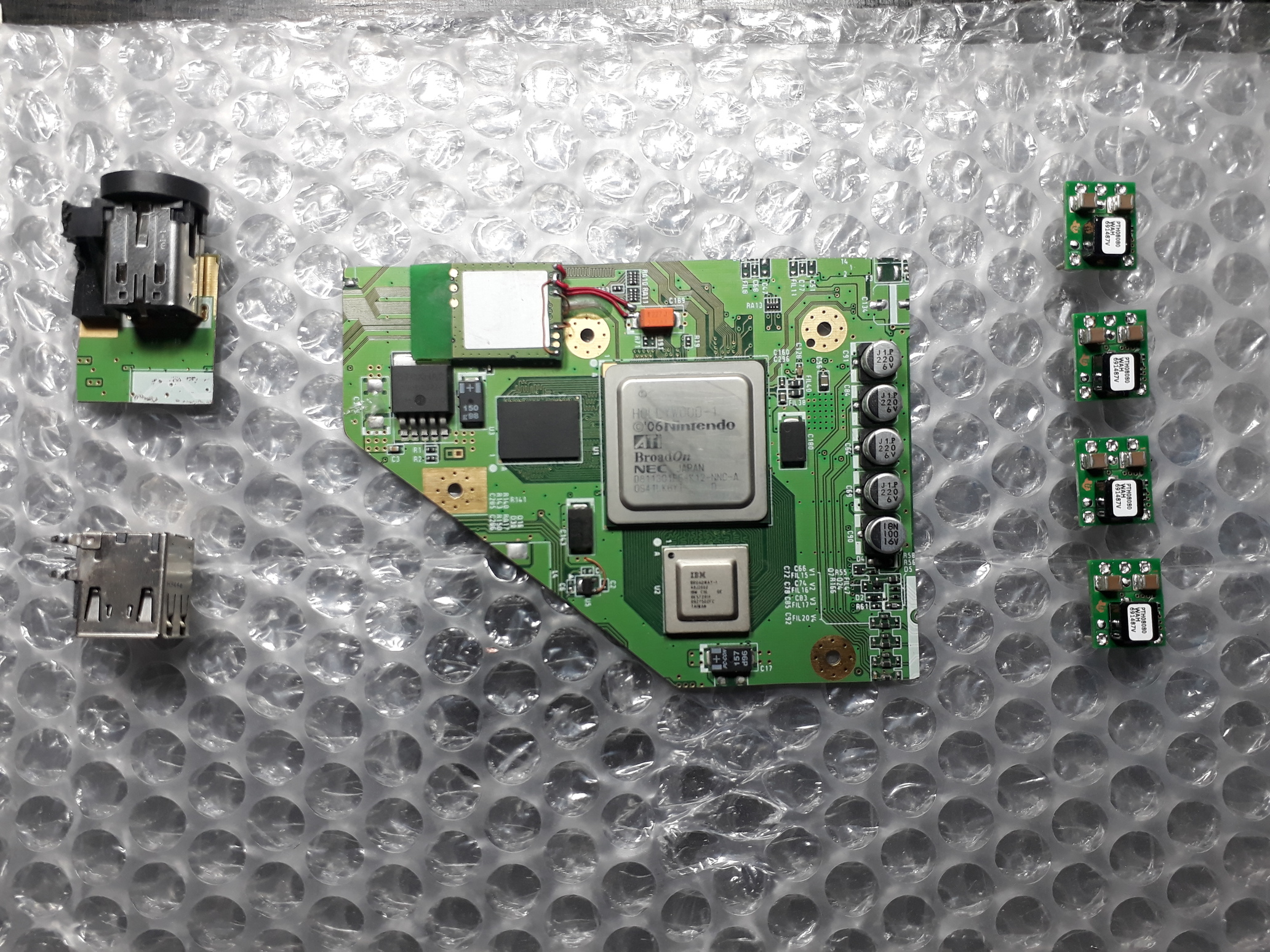

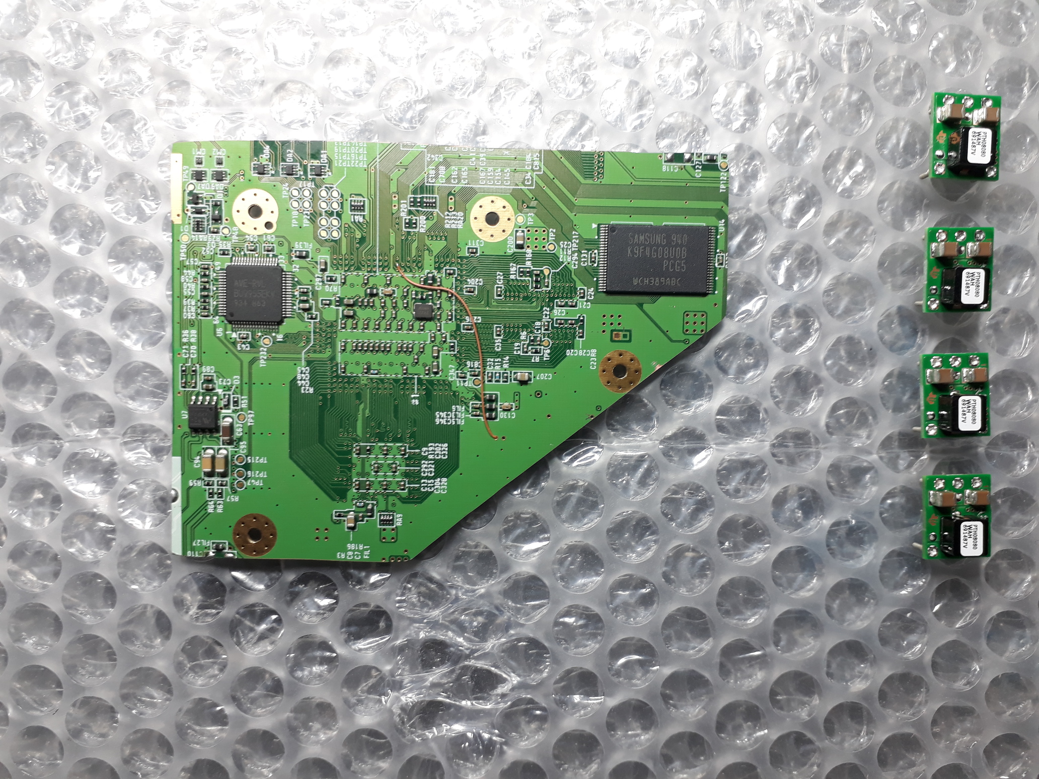

Sliced =)

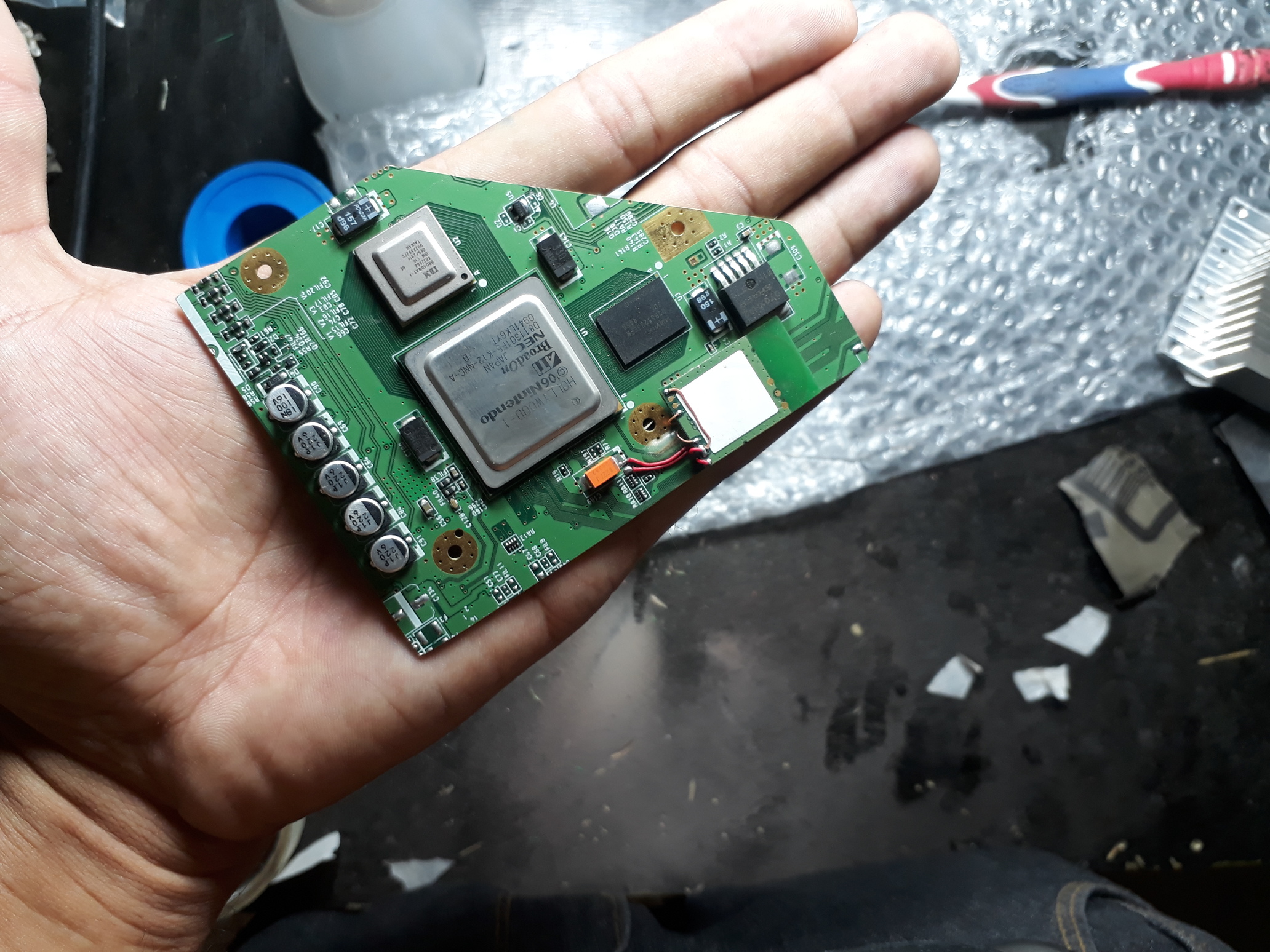

Bluetooth and U10 Relocated ...
Who start the games =)
