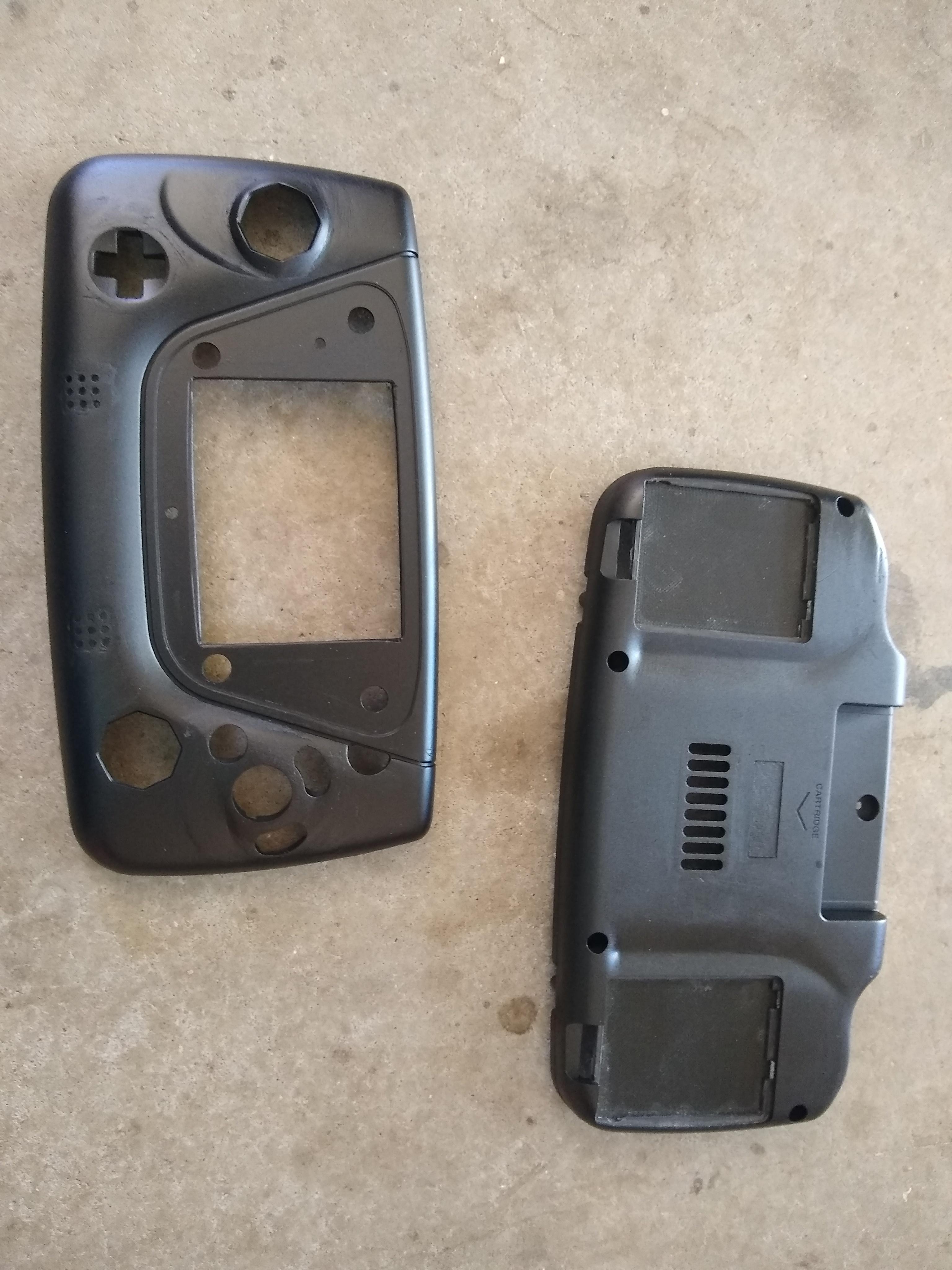

My original plan was to use a Game Gear shell, with buttons from a GC controller. And probably a small 4:3 screen that will keep it looking like a Game Gear, with the original convex plastic lens. Time to frankencase.
I picked up a controller for free+shipping, because it wasn't working right and the cord was already cannibalized. Perfect for GC+!
I went ahead and gutted a broken Game Gear and cut up the controller. I ordered the parts for a GC+ and made one. I installed PortablizeMii, and relocated the U10 and bluetooth module. Starts right up! I haven't trimmed yet and I'm terrified.

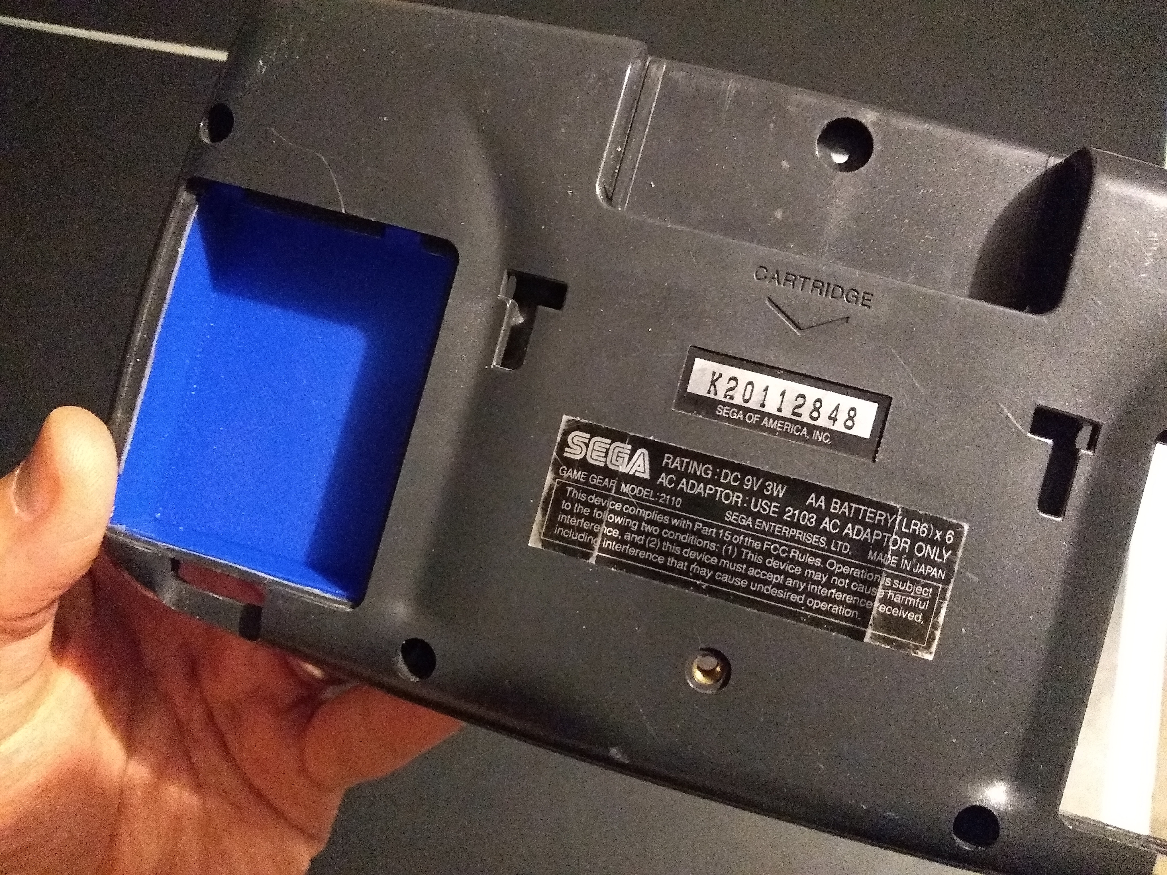

The Game Gear has two battery doors on the back, and I'm planning to use one for hiding all the controls and switches that I don't plan on using during gameplay, such as a switch for IR leds, sync button, screen controls, USB port & flash drive... and I think that's it. I call it the Control Room. Here's my first print:
I have an idea for the other battery door, but I won't say it out loud yet because it's kind of a dumb idea. In thinking of something creative to do with the cartridge, I think maybe use it as a power button? Push down on the cart to turn it on/off, either a toggle switch or a PMS.

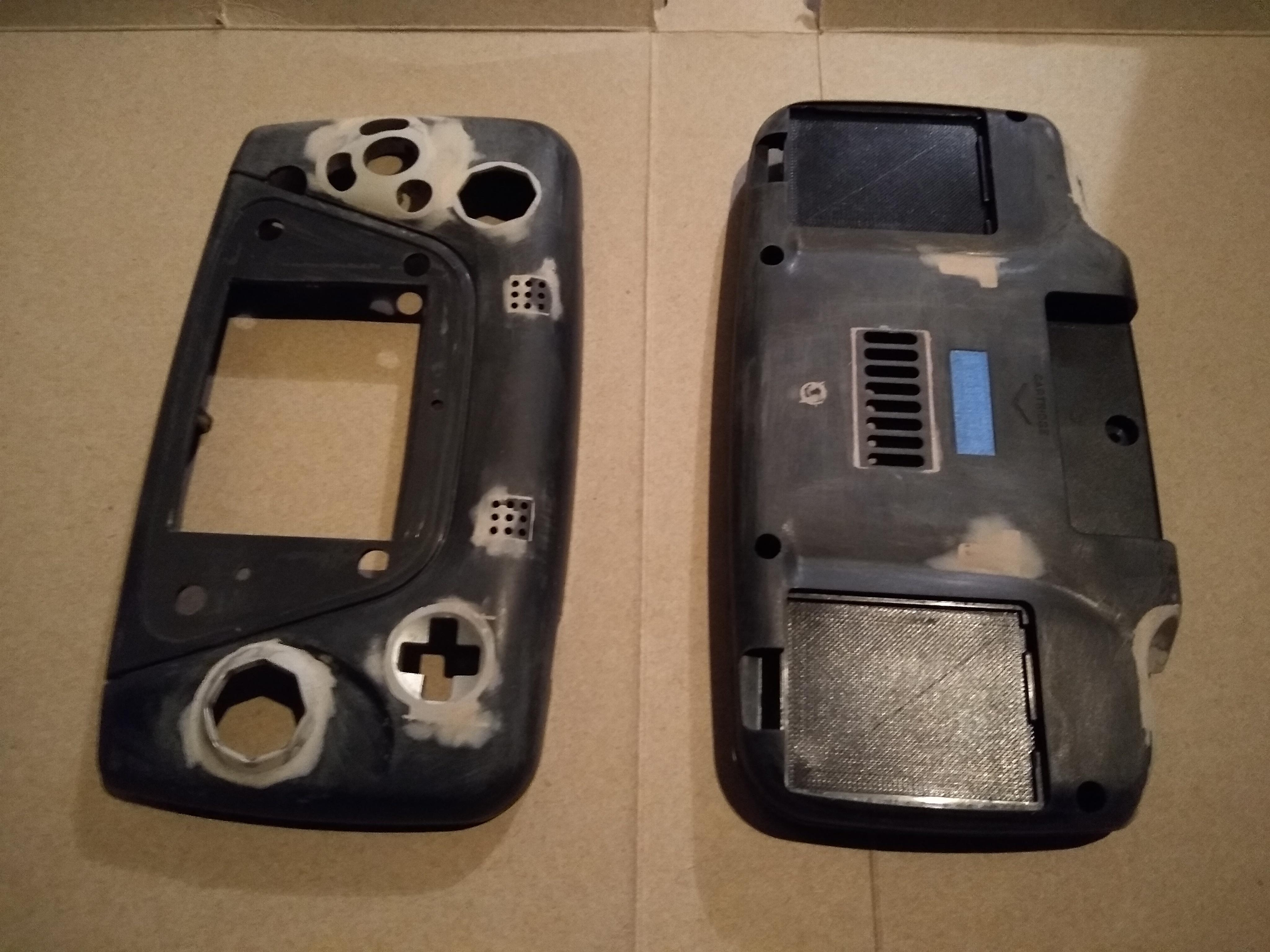

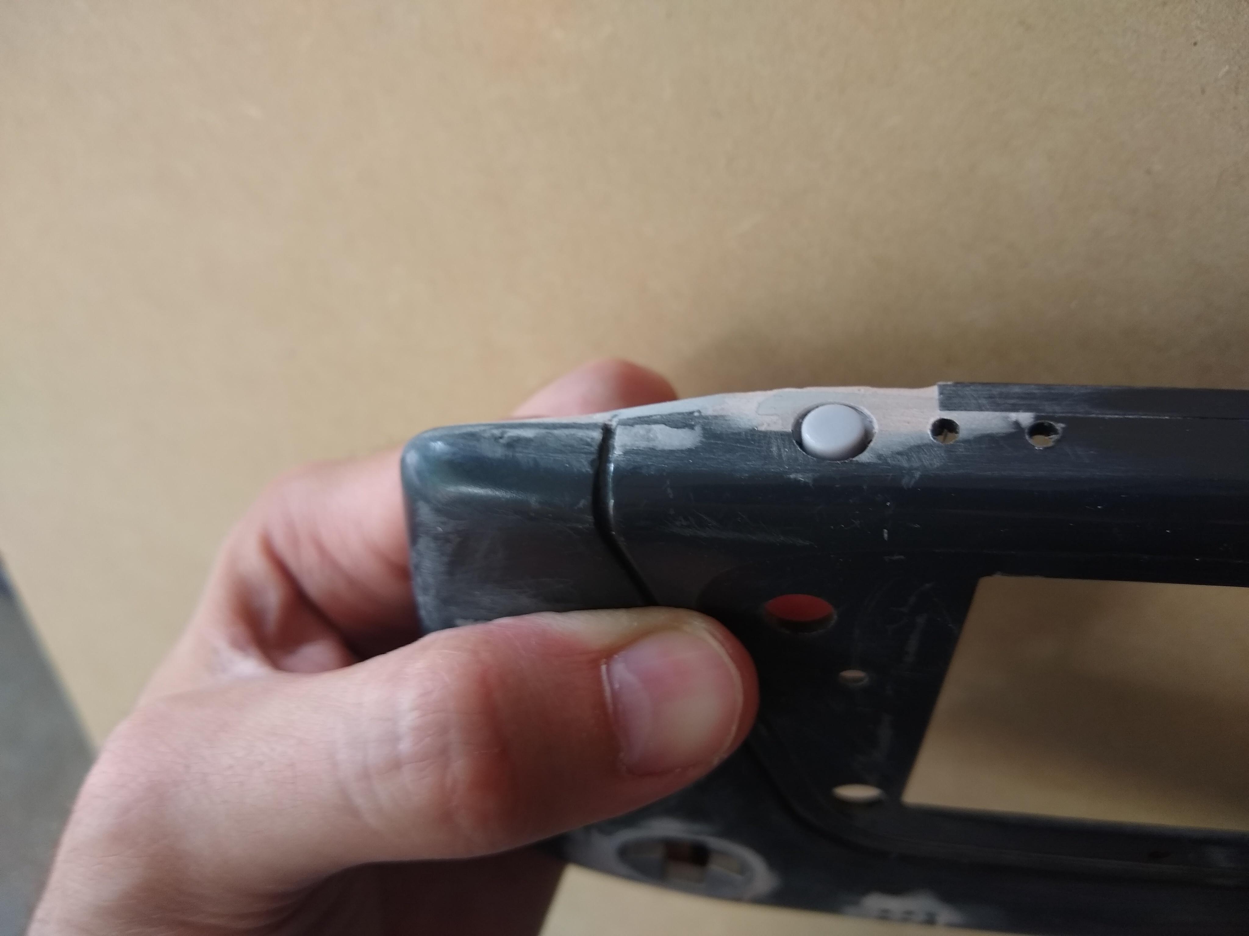

It's time to finish up this portable. The pandemic messed a lot of stuff up, and a lot of my stuff is even more outdated, but I still want to finish this. What have I done in the past 2 years?? I'm a good way through frankencasing the shell. I'll be putting the power button and volume buttons on the top, just like I'm used to on the Switch. Since I'm using the Game Gear's Start button on the face of the Wii, I'm using the GameCube start button for the power button. I have a lot of filling, sanding, and priming still to do, but I can see the portable within. It's been weird putting the shoulder button wells onto the GG shell, but I think it's going to work. I uhhh, still need to put a Z button on there somewhere. That air vent piece is from the bottom of an N64.

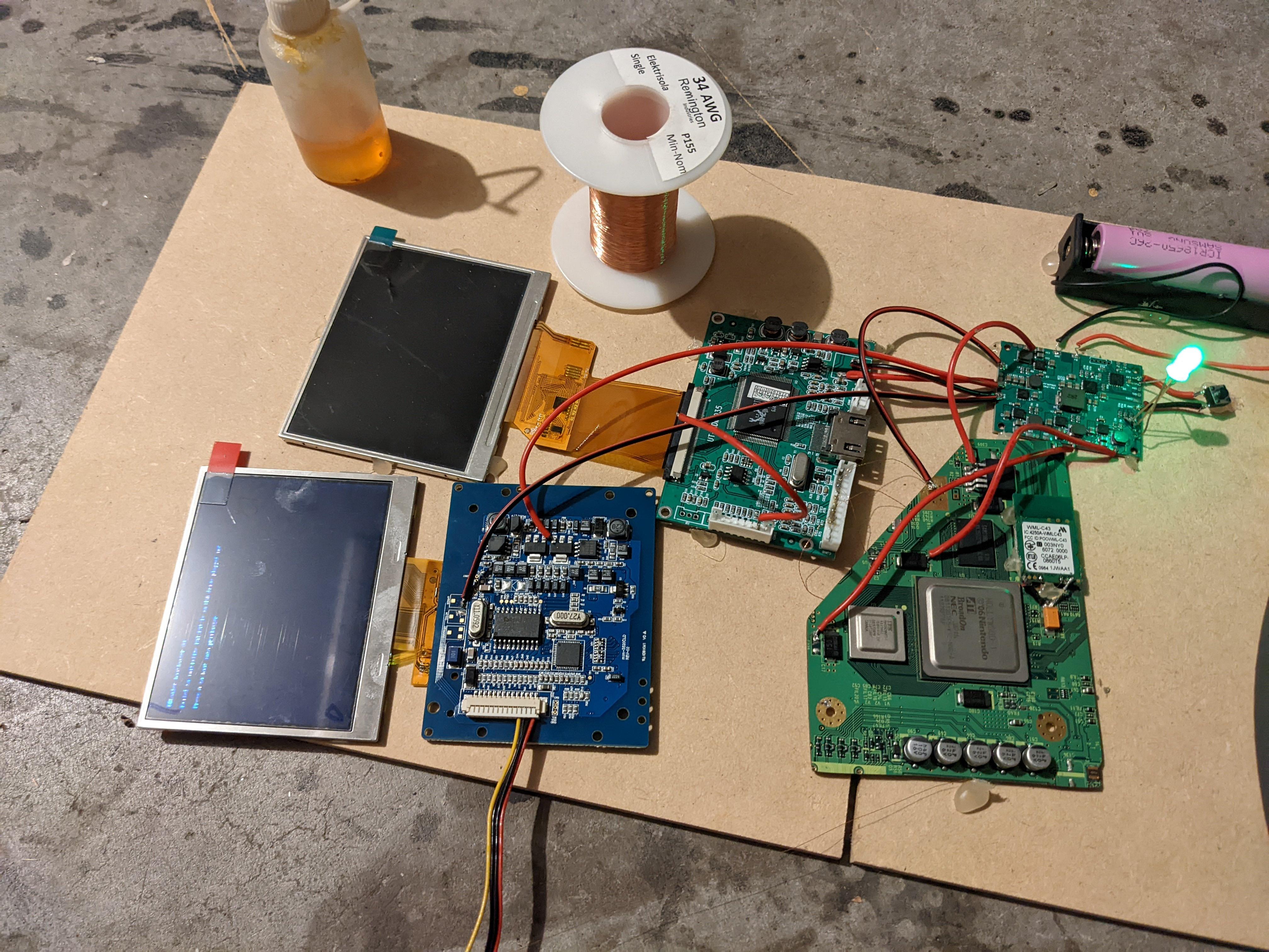

I trimmed the Wii mobo. I got one of those pricey 480p VGA 3.5 inch displays, and I couldn't remember if I had enabled VGA when I installed BBLoader forever ago. Turns out... nope! But I get a video signal through composite. So now it's time to hook up my homemade GC+ and see if it works, then wire up USB and install RVLoader.
Hot gluing stuff to a board has been very helpful.
