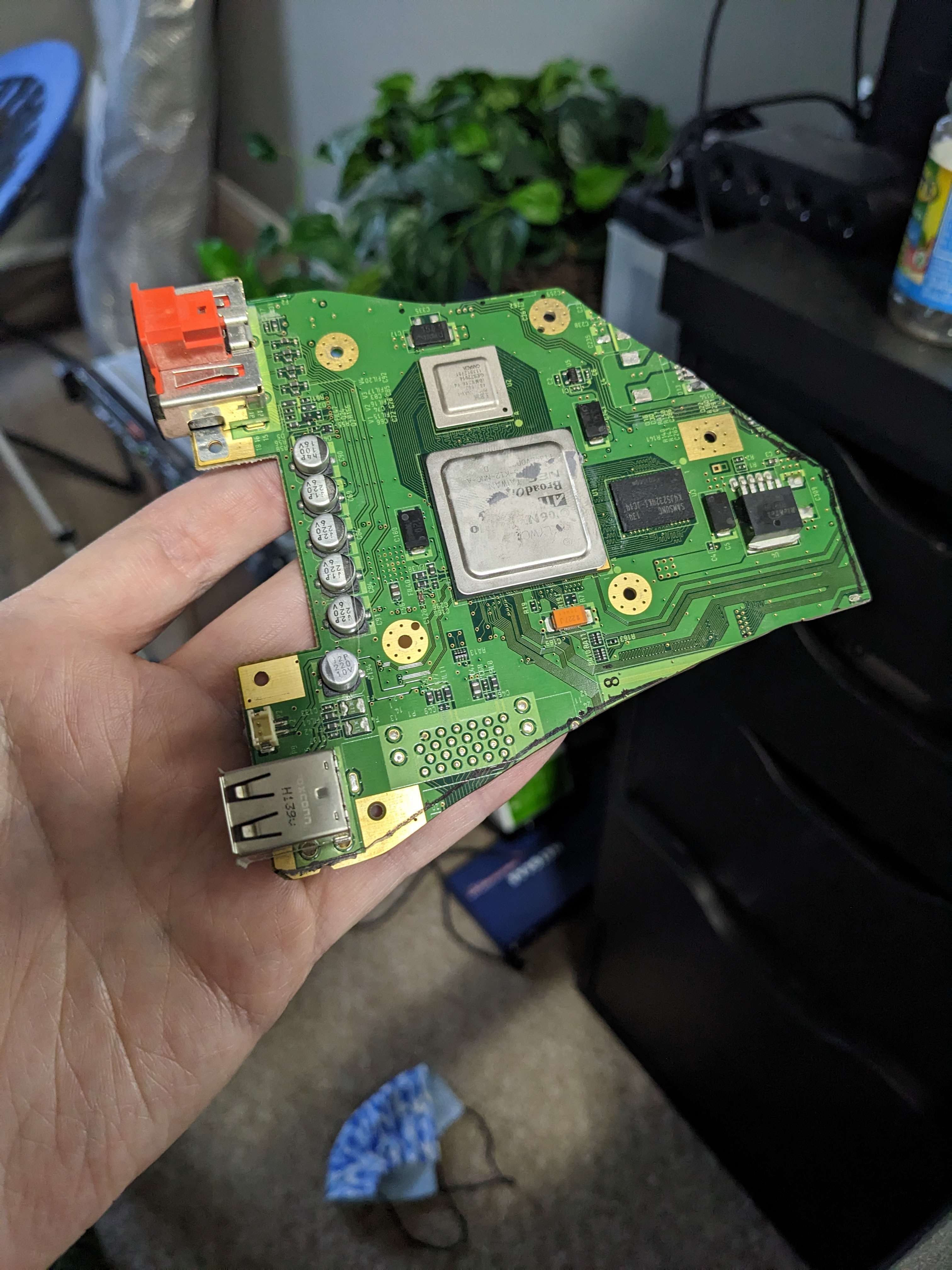

The PSU-Plus arrived pretty quickly, and after a lot of double checking my trim wouldn't cut anything important I went for it.
The trimming was thankfully a lot less difficult than I expected and I had what I thought looked like a pretty good trim.
The U10 relocation was the smallest soldering I had ever done, but using 34 gauge wire in a via made it so much easier than I expected.

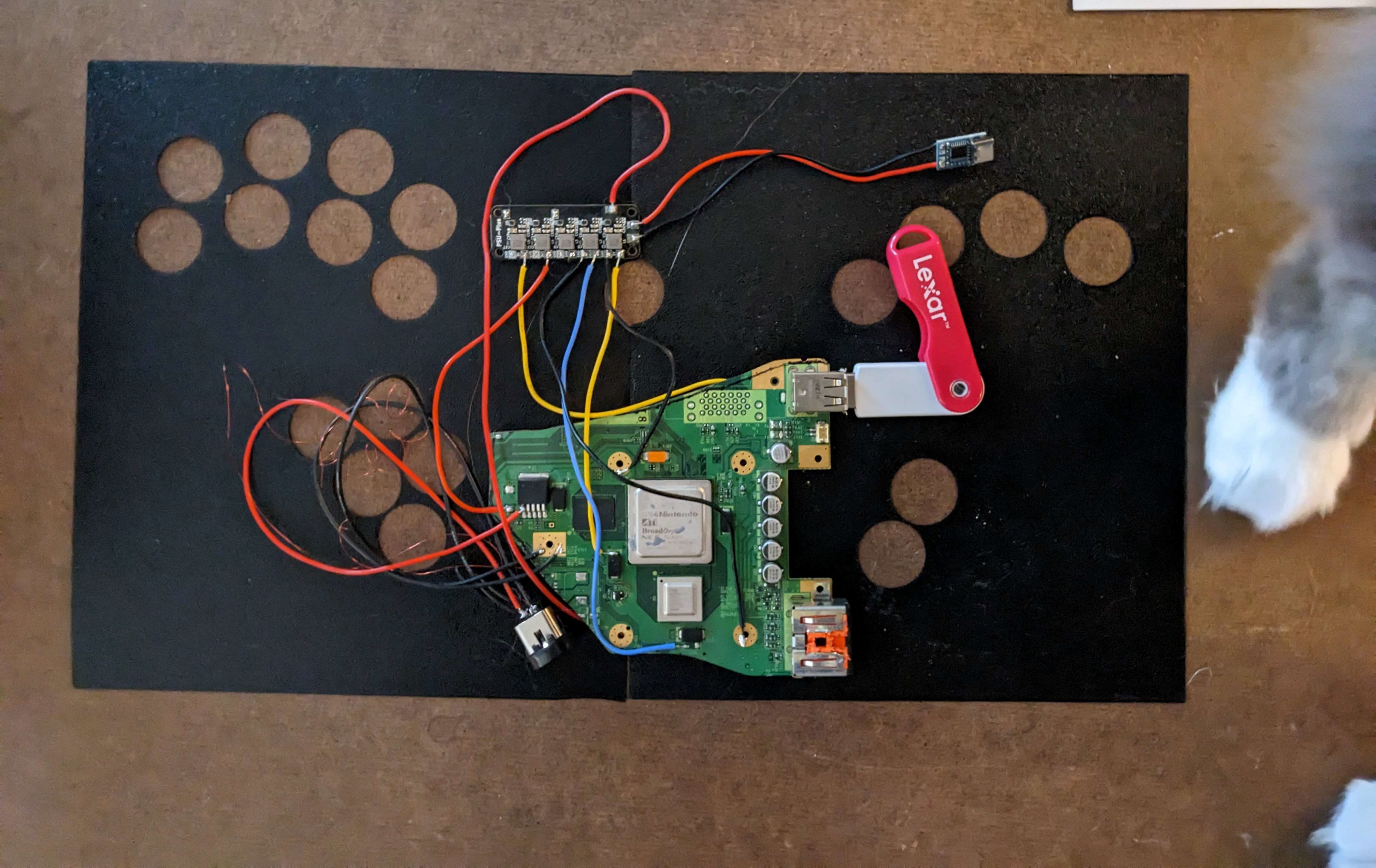

After wiring up all the voltages from the PSU-Plus I was ready for the moment of truth and plugged it in.
It booted! But it didn't recognize the USB. I double checked the continuity between various parts and the PSU-Plus but everything seemed to be okay, then I checked the voltages coming from the PSU-Plus and found that nothing was coming from 5V. I double checked the PSU-Plus page and realized that I needed to bridge the jumper pads.
After doing all that I plugged it in again and it loaded into RVLoader successfully!

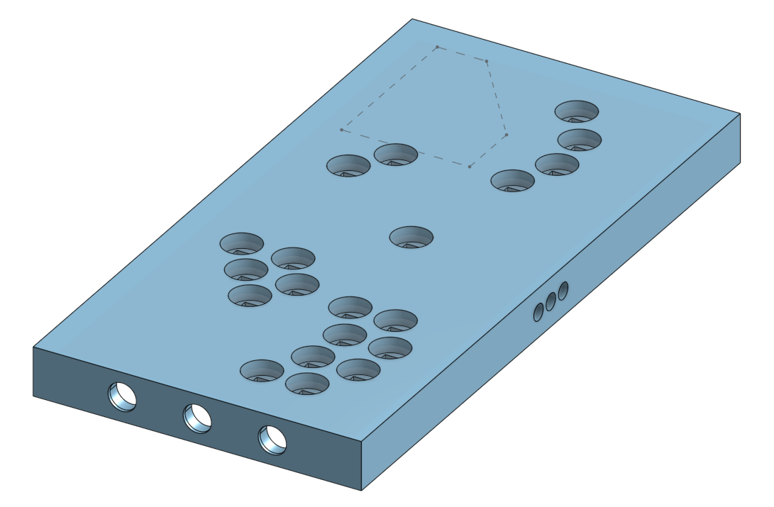

After a good amount of trial and error I've gotten a rough draft of my model design, I had to print out a lot of little prototype parts to test the fits on the GCC ports and RCA female to female connectors I am using. Initially I was going to include both composite and component outputs on the controller, but I realized that component plugs are usually in the back of the TV and I didn't want to have to plug in back there.
Here's my model right now, I've got three GCC ports on the right side and composite out in the front.
That's where I'm at currently, I printed a test print of just the top layer and found that my button placements need to be adjusted. In theory there is enough room for the wii on the left side of the controller but I'm not certain of what the final dimensions will need to be.

I spent a lot of time working on the case design last night. I printed out a single layer of my button holes to make sure they lined up well with my current controller and they didn't!
I also hadn't spent too much time refining the holes for my AV out ports, I went through a few iterations and got to a hole that I'm very happy with.
I printed a cross section of the middle of the board last night to test the look of the AV out and check how the thickness of my walls looked.
The front and back walls are THICK, I didn't realize how much space I had given them, I'd like to decrease that but I'll have to see how much I can trim while still leaving support for the AV connectors.

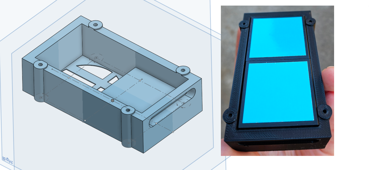

I whipped up a prototype last night and started the print before bed, I was surprised this morning to find that I got everything flush on the first try!
I need to slightly shrink the width of the cavity, add a hole for the fan wires, and raise the wii mounting posts a little bit more.

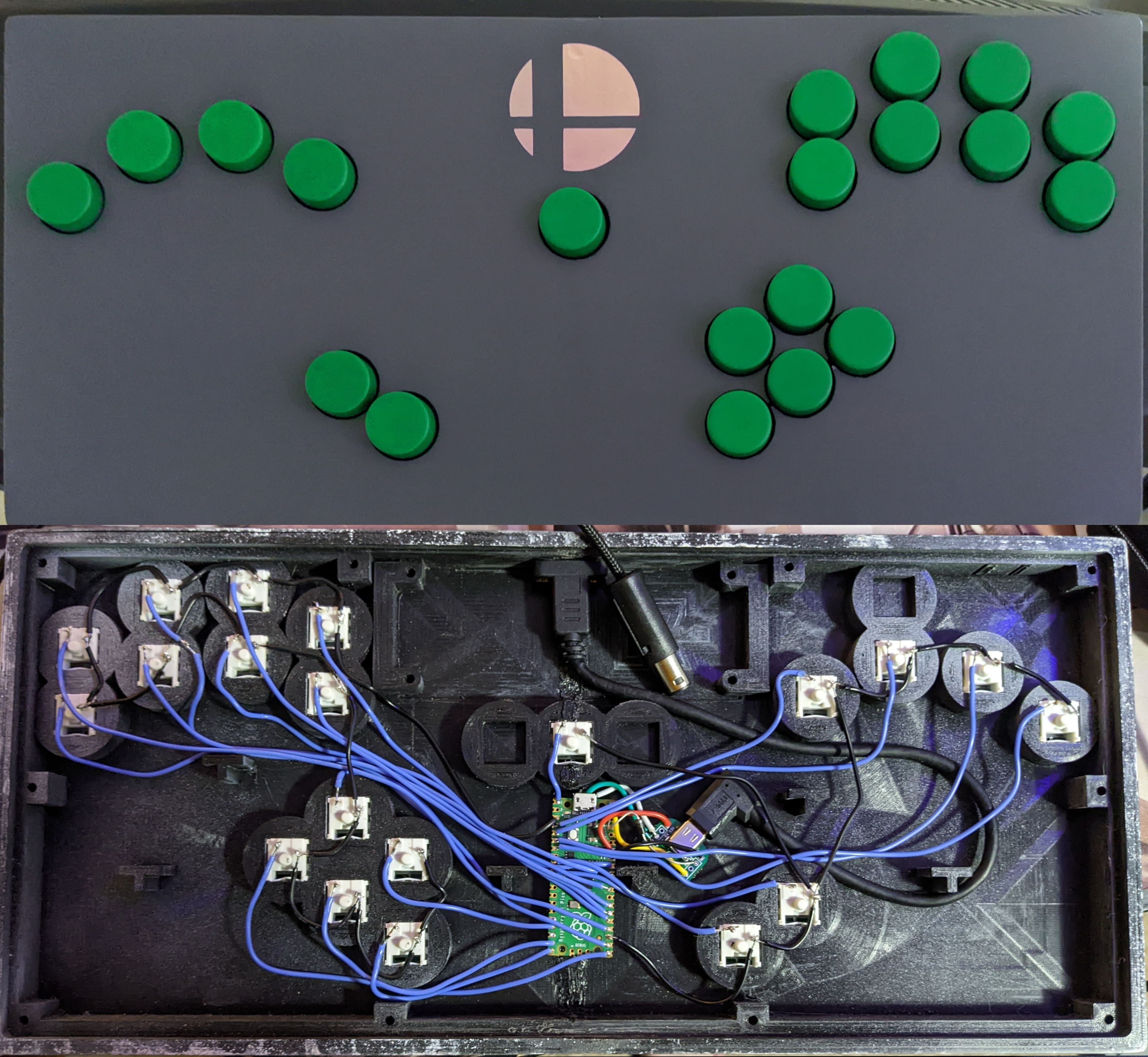

I finished this a couple months ago but forgot to update my forum post!

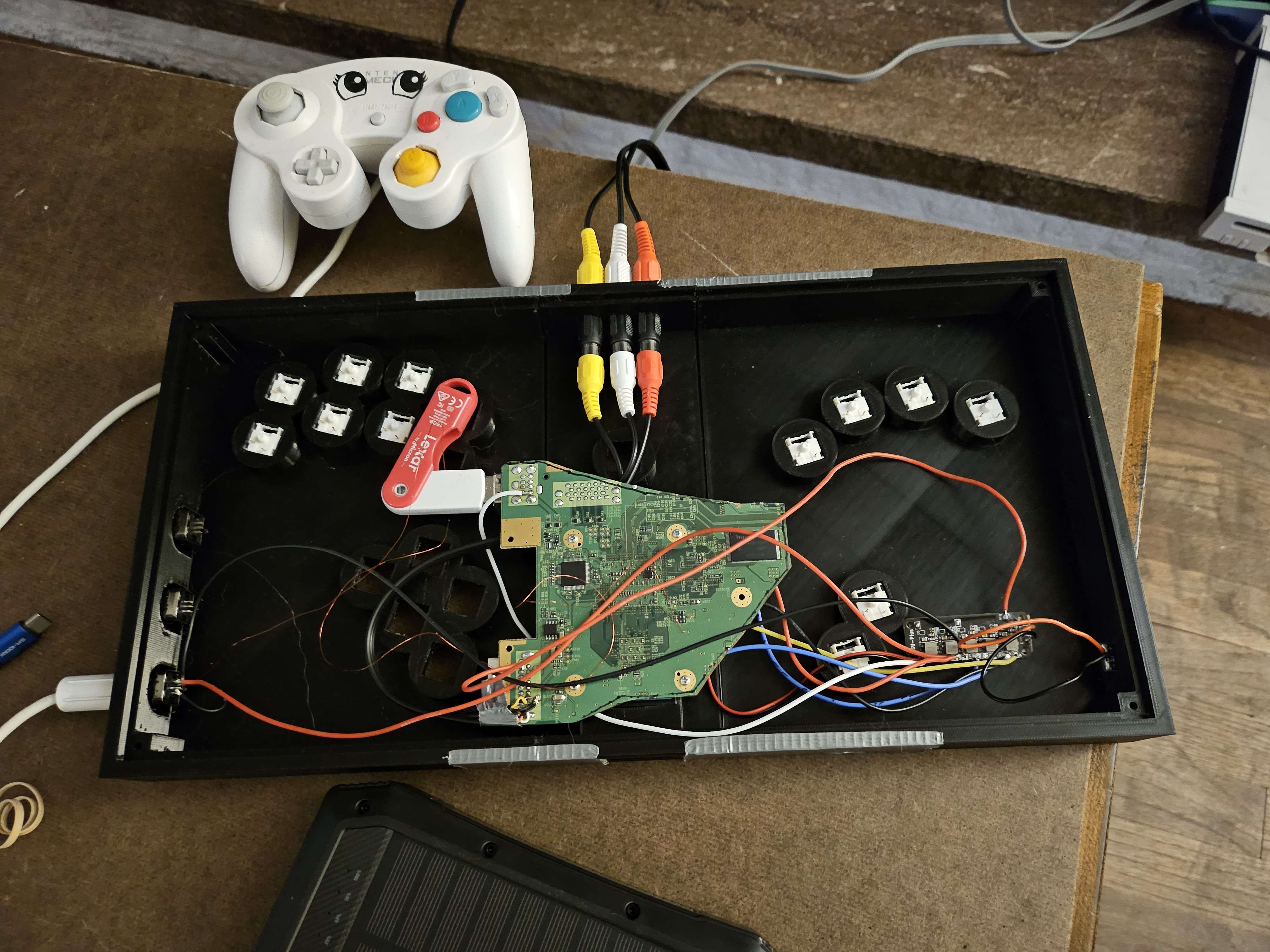

I printed the full body in three parts and I held them together with duct tape for testing.
After printing I realized that I had forgotten to round the edges of my corners.
My wii mount didn't fit against the heat sinks just right and I would need to adjust it a tiny bit more.
I shared pictures with Crane's DIY rectangle discord (https://discord.gg/S3qgZWD) and got some feedback.
I wanted to decrease the size of the controller a little bit more, and they convinced me to put 4 ports on the side so the controller could plug into itself or a different console. Having the controller plug into itself was also kind of funny.
I also found that my button layout had the wrong dimensions because the reference model I was using had it wrong and I hadn't realized it.
I ended up getting a composite cable from goodwill and stripping it then soldering that to the AV pins.

Feeling reinvigorated from my cool new controller, I made the necessary changes to my 3D model.

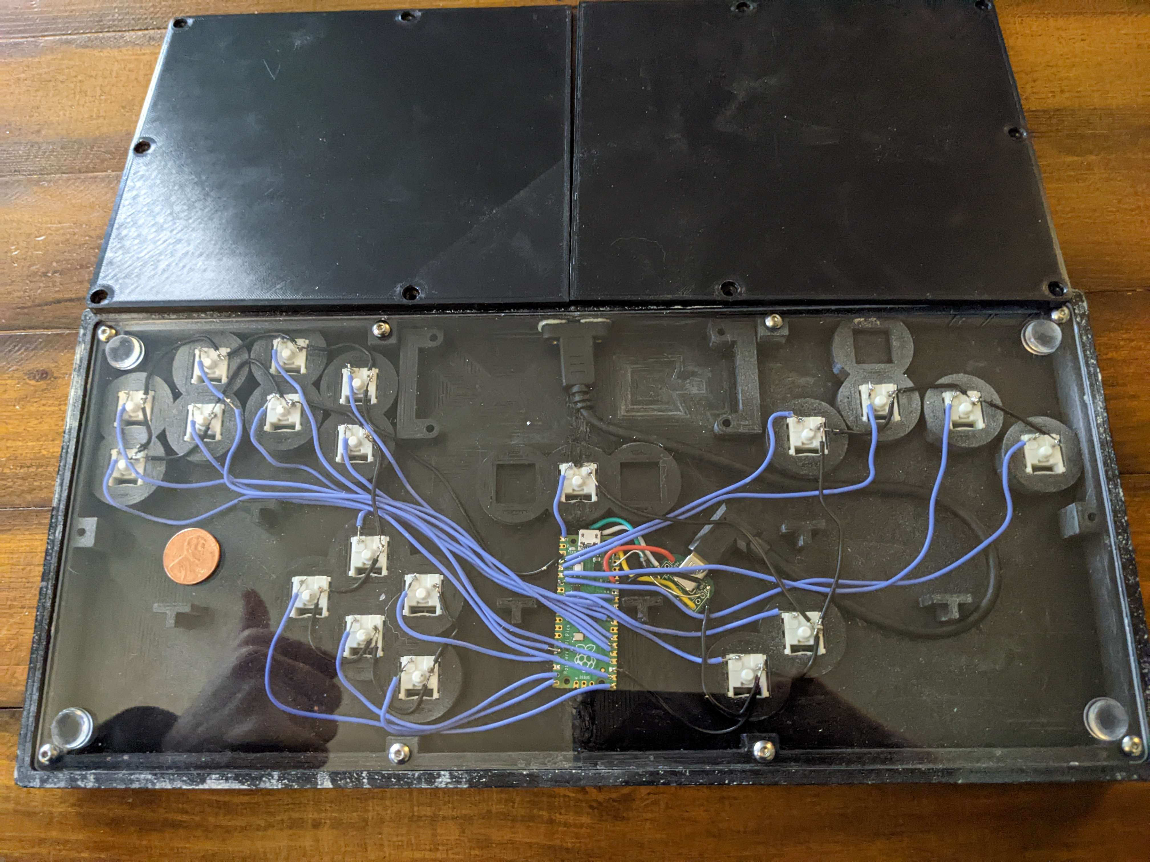

I still printed it in 3 parts, but I made pegs and holes for the parts to fit together with, then used epoxy to stick them together.

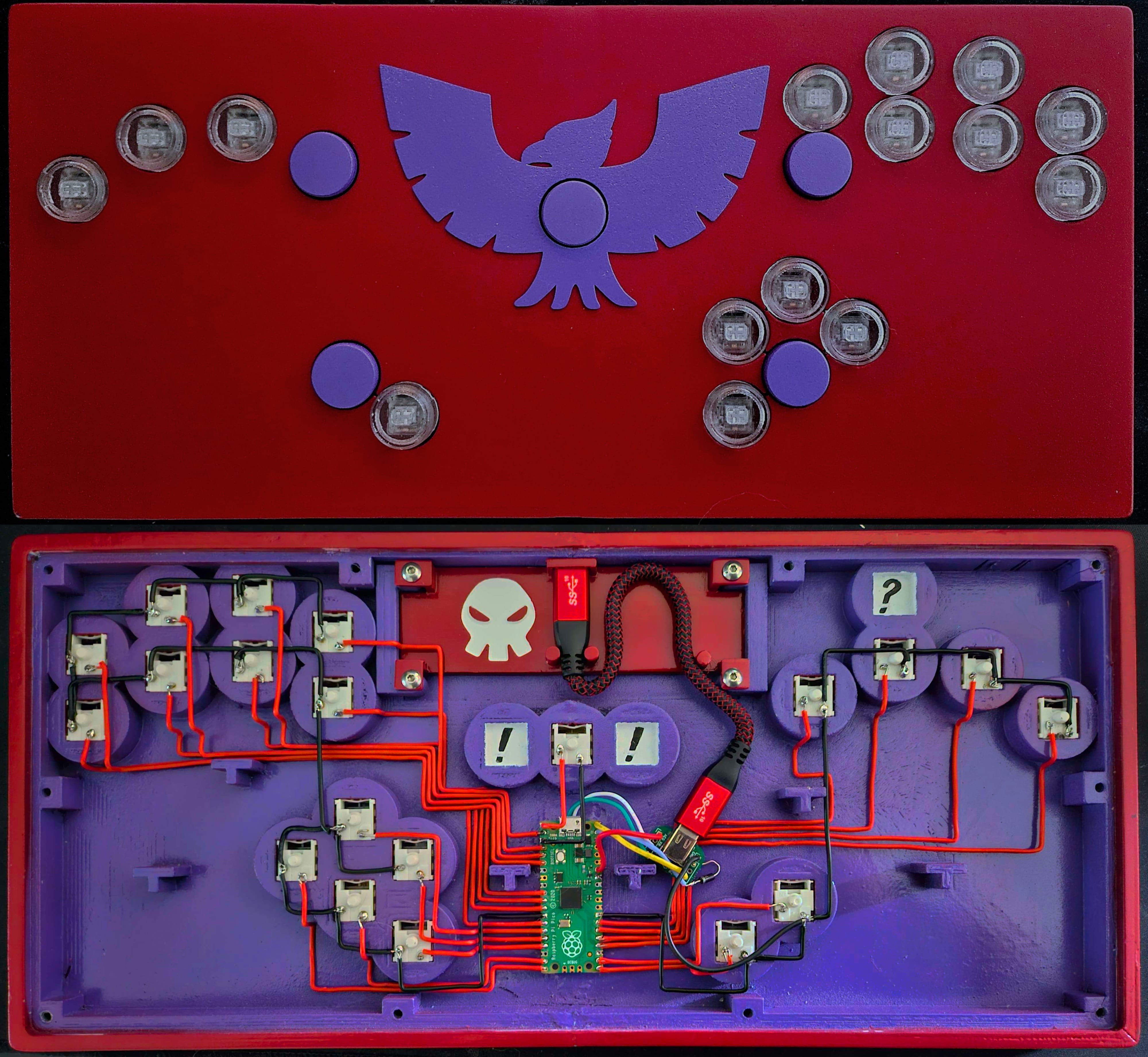

I forgot to take pictures of a lot of steps from here, I was close to the end and I mostly wanted to finish the project after so long.
After a lot of sanding, painting, and wiring it came out looking like this:

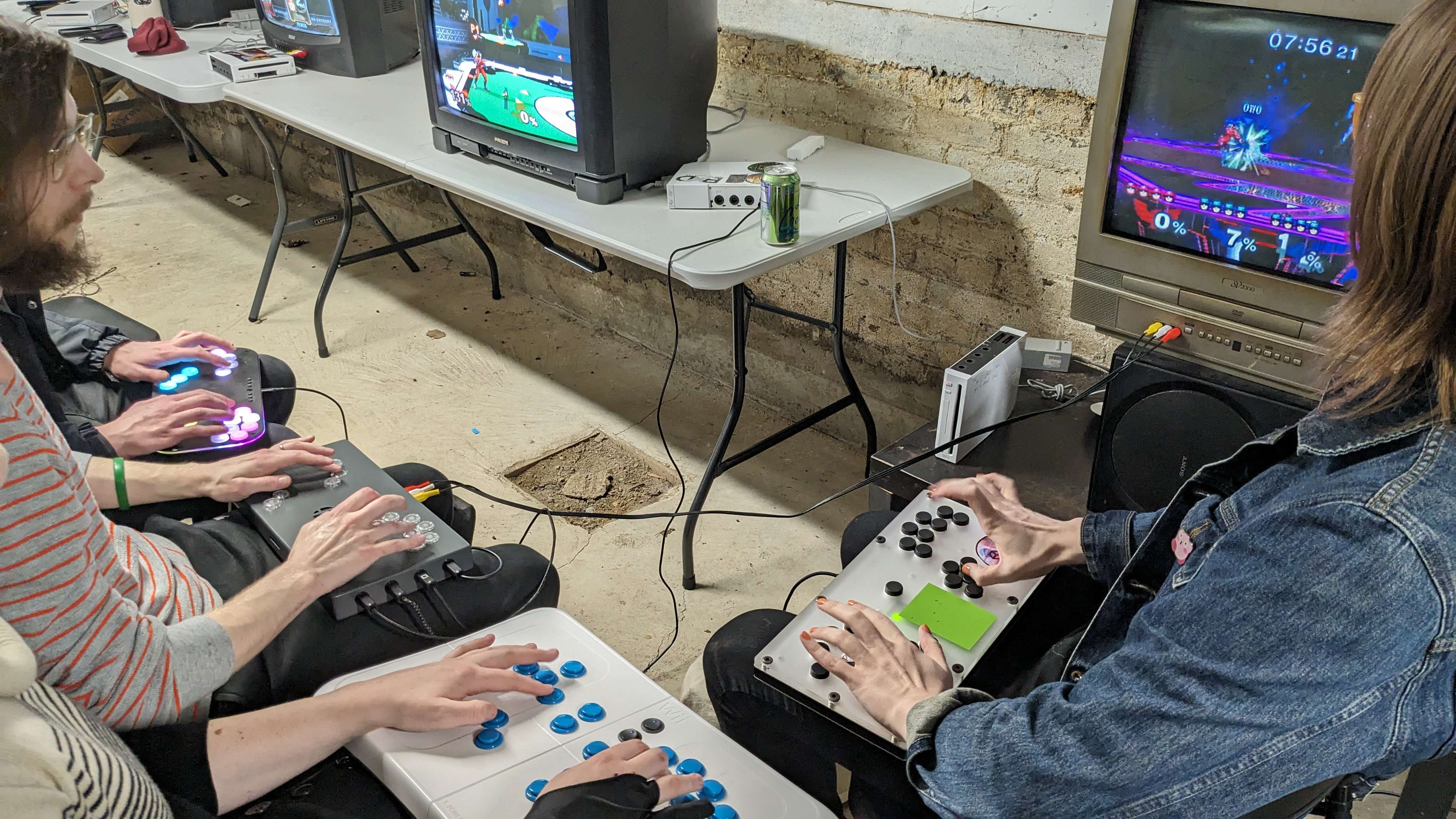

I brought the controller to my local tournament, here's a pic of me playing doubles with it.
I also used it for bracket, I brought a GCC cable extension so I could plug the controller into the tournament wiis.

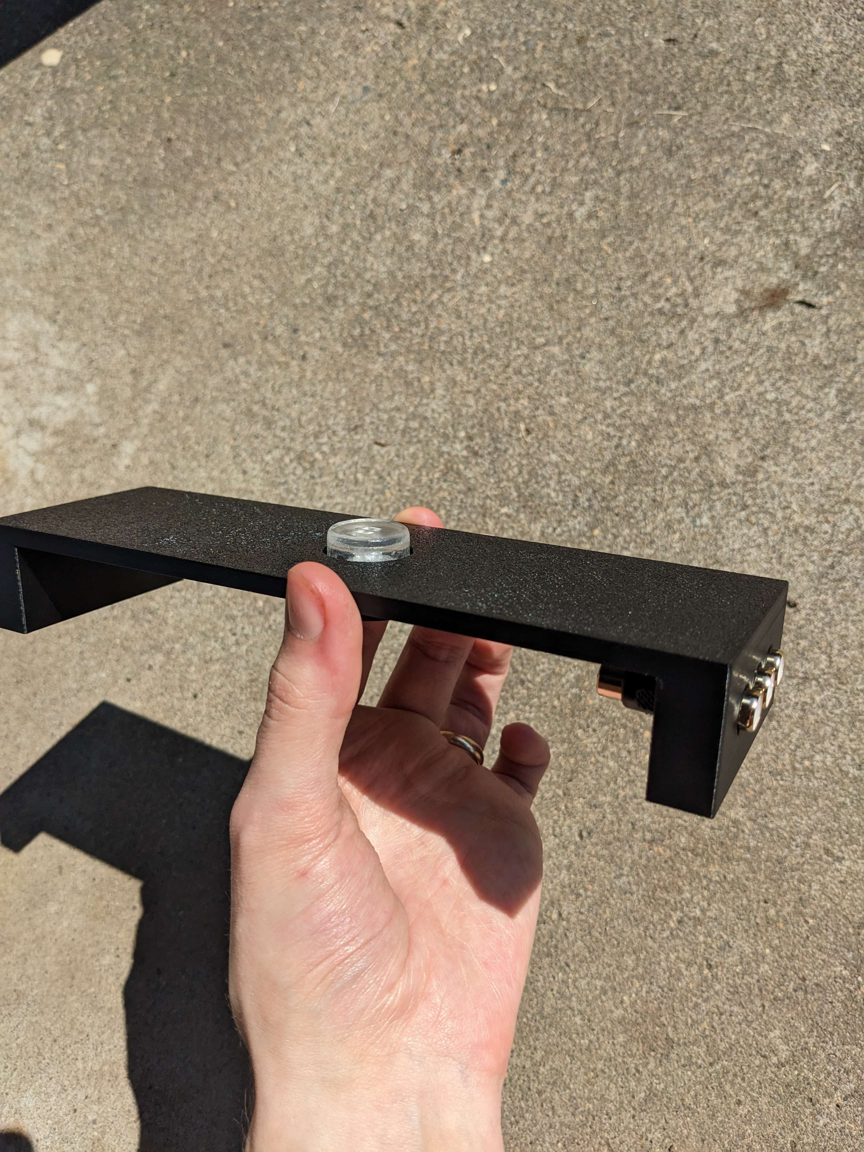

I'm going to try out cleaning up the rough edges of my design.
I want to add mounts for a 4layer PMS and the Pico, as well as for some batteries.

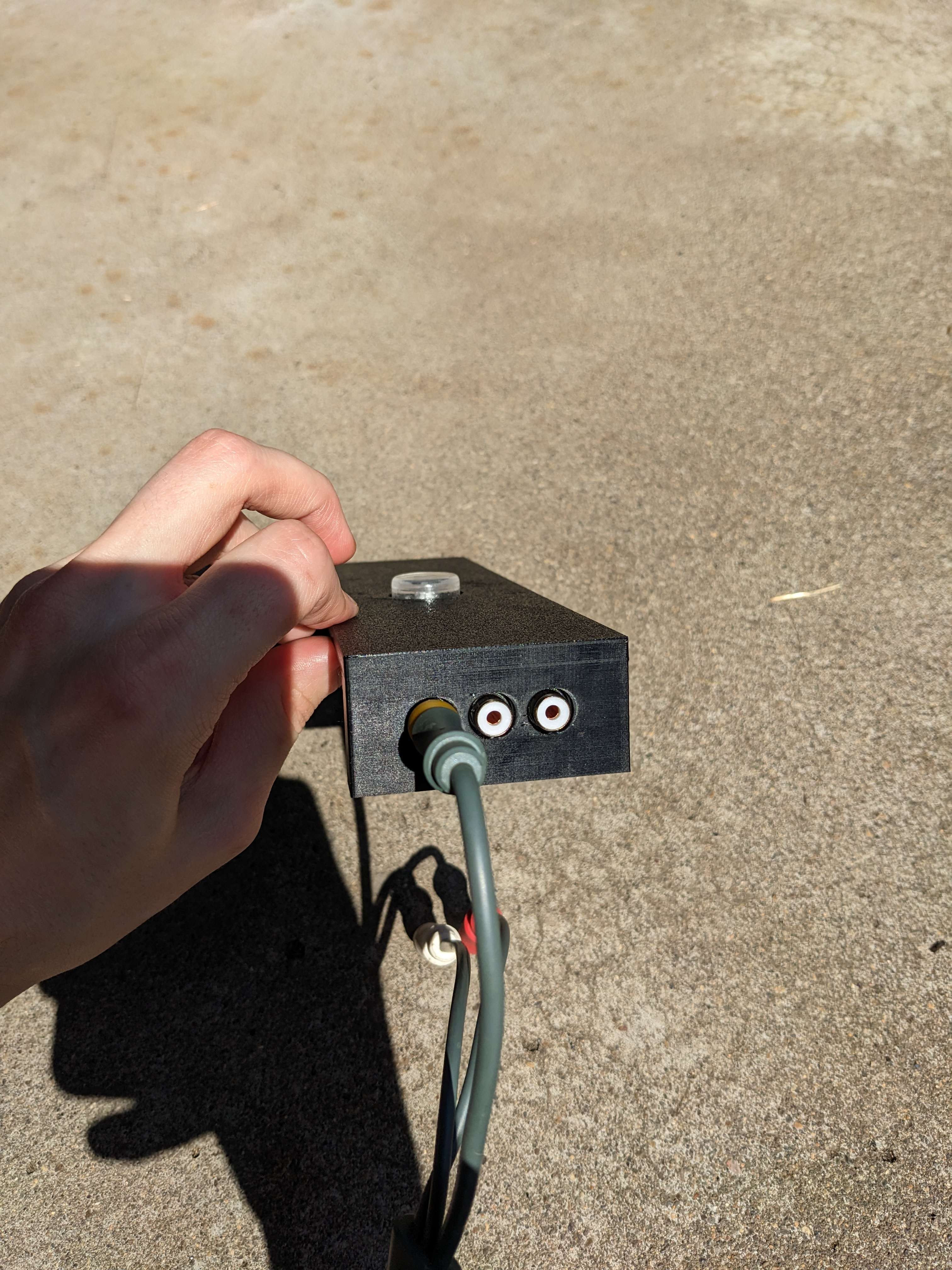

I'm planning on getting some proper RCA jacks for the composite ports since the female to female ports I'm using right now take up a lot of space.
I'm also going to make my button holes a little deeper, right now the bottom of the keycaps are hitting the bottom of the holes and the controller is kind of loud.
