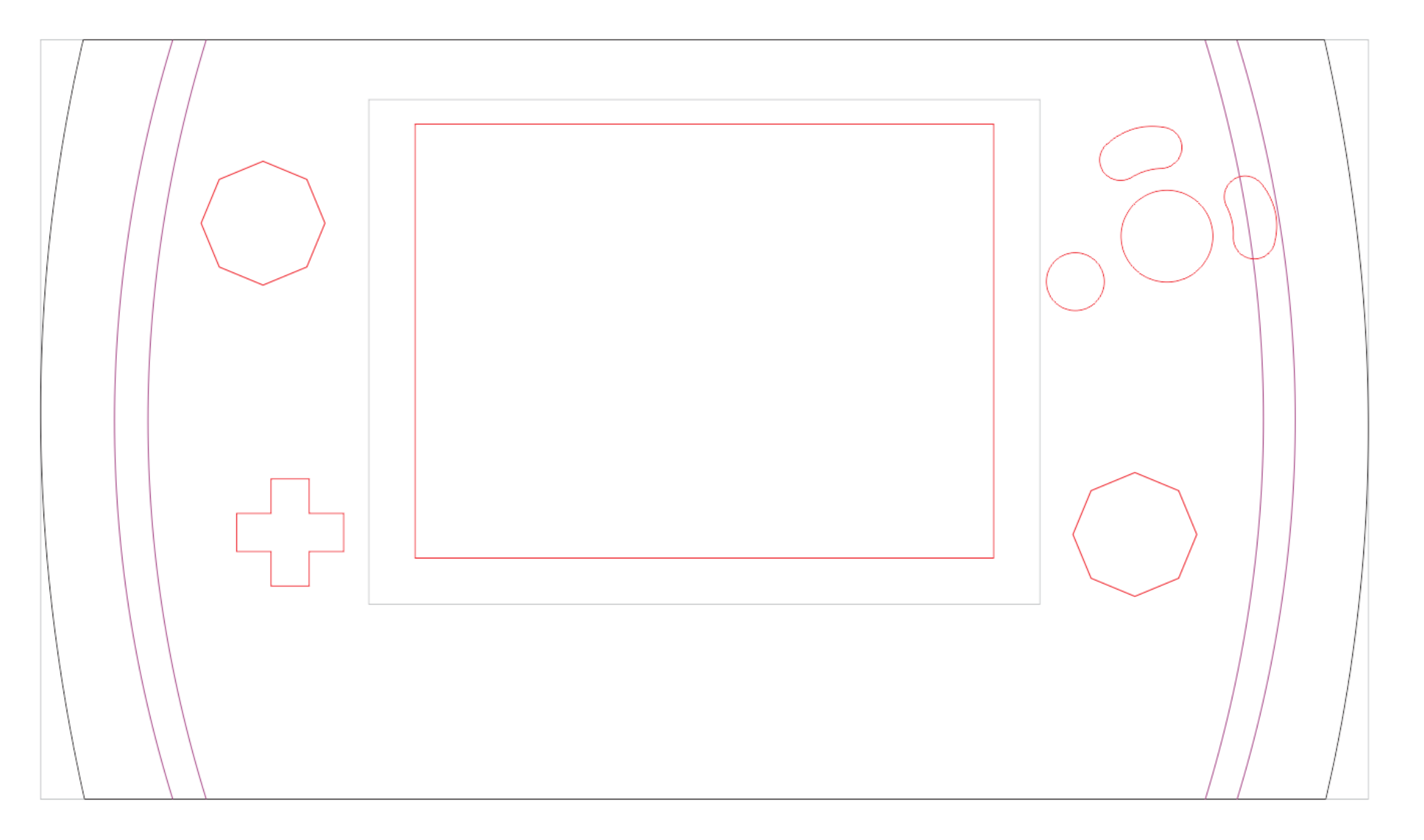

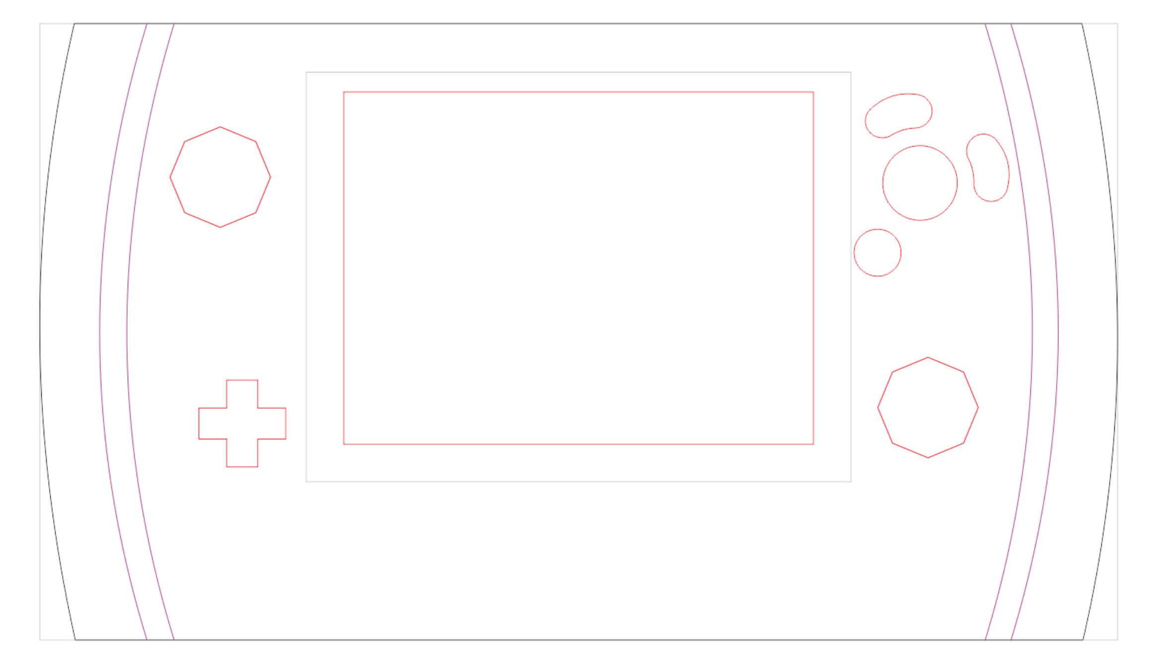

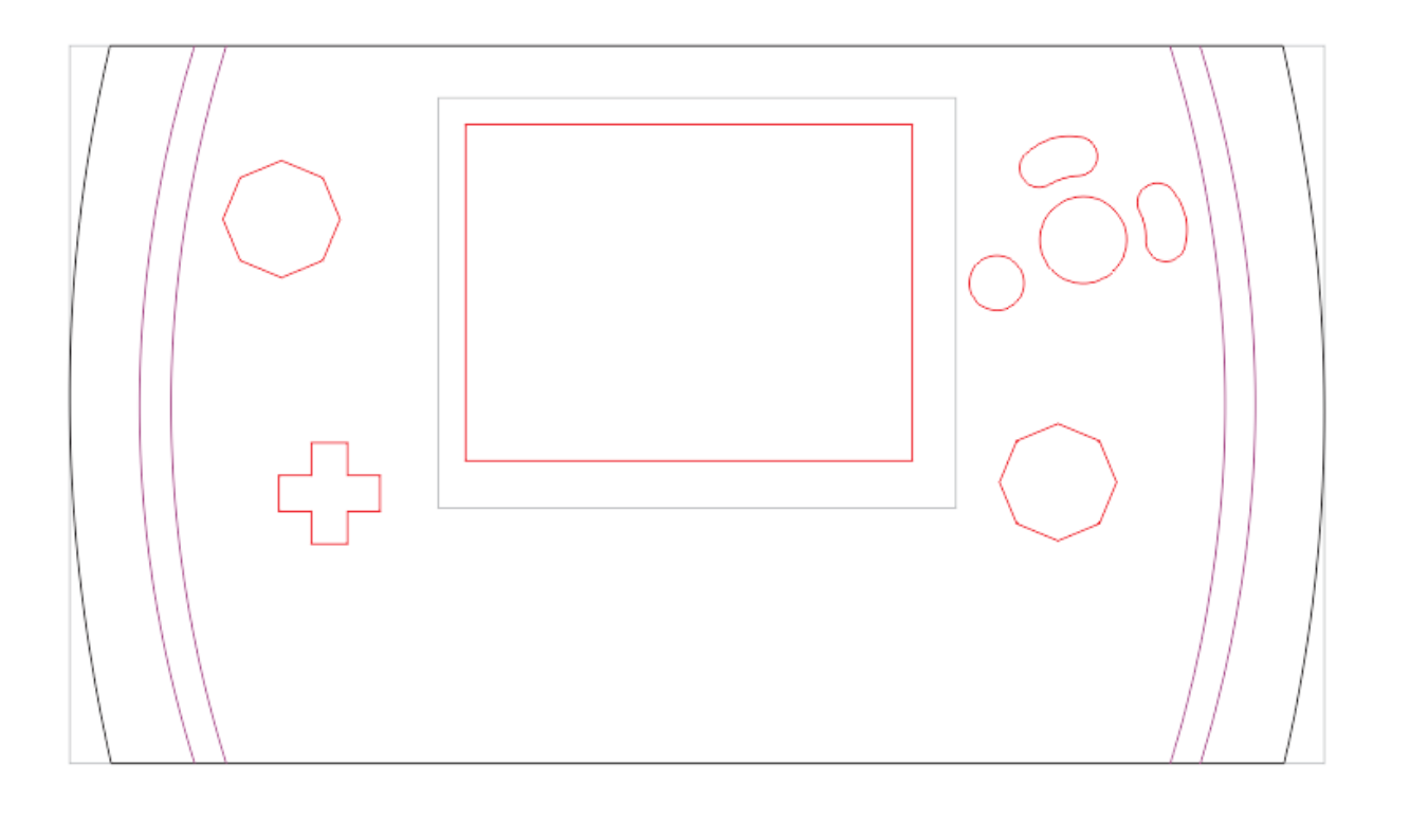

A laser can only cut along a flat surface where the laser can focus. The curved edges, noted on by the area between the purple lines, cannot be effectively cut by a laser, and would need to be hand cut. This area will be referred to as the danger zone.
Decisions:
-5" 640*480 screen with moved or hand cut buttons OR 4" 320*240 with regular button layout
-Joysticks or 3DS sliders?
-Cooling vent holes on the back?
-What speakers, and what size speaker grills?
Here are 2 mockups to show how things fit with 2 screen sizes. The buttons are just thrown on for size reference, but have not been placed in an ergonomic way yet.
Here is the 5" 640*480 screen. This is a larger screen with 4x the resolution of the 4 inch. The problem here is that the X button rests in the danger zone, and will need to be cut out by hand. Another solution would be to do the unpopular inverted x layout with the x button between the B and Y button.
Here is the 4" screen. It is a smaller, less nice screen, but leaves room for the standard gamecube button layout on the flat face.
Anyway, Im early along on the project, but would love to see who is interested and suggestions!
I would be super interested if u could make one with a 7" screen. Because that is the screen that i have available.
A 7 inch screen would not have room for any controls.
I like the layout with the 5" screen. It might be better to rotate the ABXY button bit instead of hand cutting it, especially because the B button is particularly close to the display...
Clever. Yea by moving the b button to a new location, I could keep the X and Y in the same locations and rotations relative to the A button. A sketch is below.
Thats one of the great parts of using a laser: you can get away with things that close. Keep in mind the red line is the actual hole, while the grey line is frame of the screen, assuming its the largest dimension allowd by the tolerances on the screen's data sheet.
Thats one of the great parts of using a laser: you can get away with things that close. Keep in mind the red line is the actual hole, while the grey line is frame of the screen, assuming its the largest dimension allowed by the tolerances on the screen's data sheet.
Yeah, I know, but I still like to err on the side of caution :P Also, where are the screw posts on the ZN, for reference?
That layout looks dope though, I may actually want one if I can afford it... Gotta finish my current portable first though, need to get out of the habit of not finishing what I start .-.
The screw posts are past the purple lines so these cuts shouldn't be an issue.

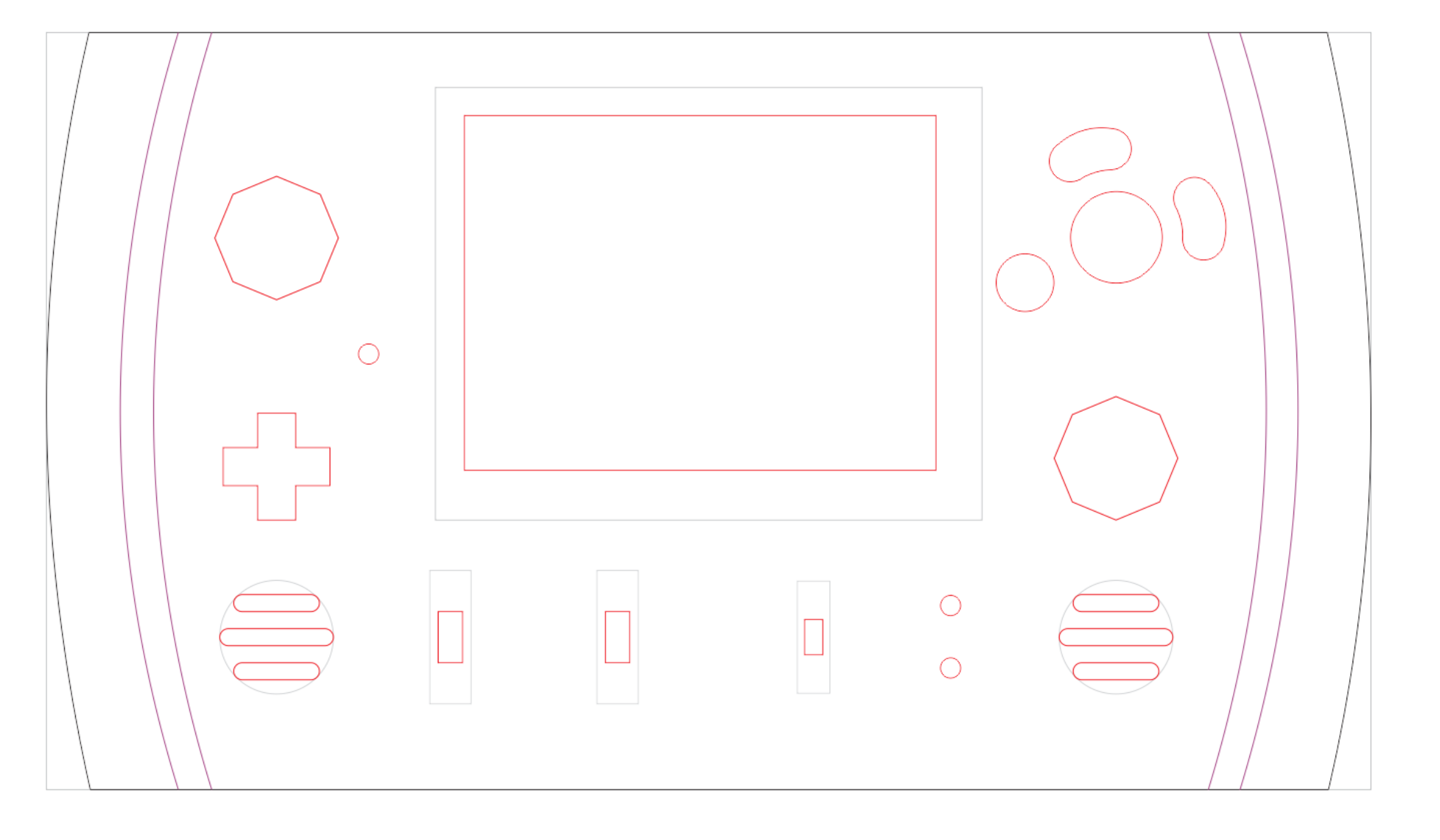

Just finished up a long chat and a custom custom design for @jefflongo. I probably will not be doing any more custom one-off designs. It is built around fitting many of the parts he has already purchased and wired up in his worklog. While it hurts me deep down knowing that my work will be used for a gamecube portable, I know its what's best for his project given how far along it is. He's put a lot of work into it, and I know its going to be a great first portable.
I am posting this design, with his permission, for inspirational purposes. If this design proves popular, I can cut more than 1 of them. I can also reuse assets from it for the final community chosen design.
I am posting this design, with his permission, for inspirational purposes. If this design proves popular, I can cut more than 1 of them. I can also reuse assets from it for the final community chosen design.View attachment 2819

Just finished up @jefflongo's cut.
