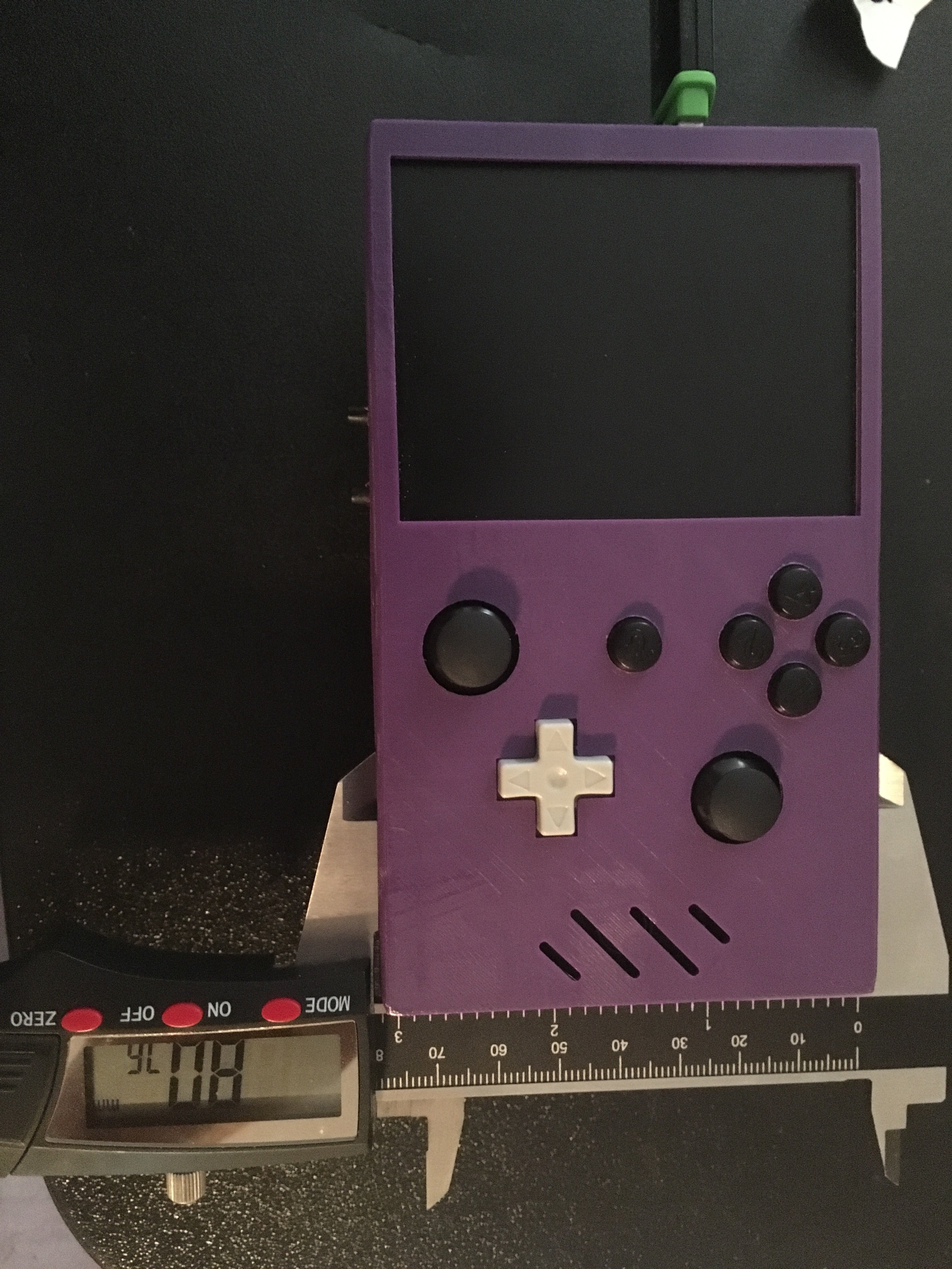

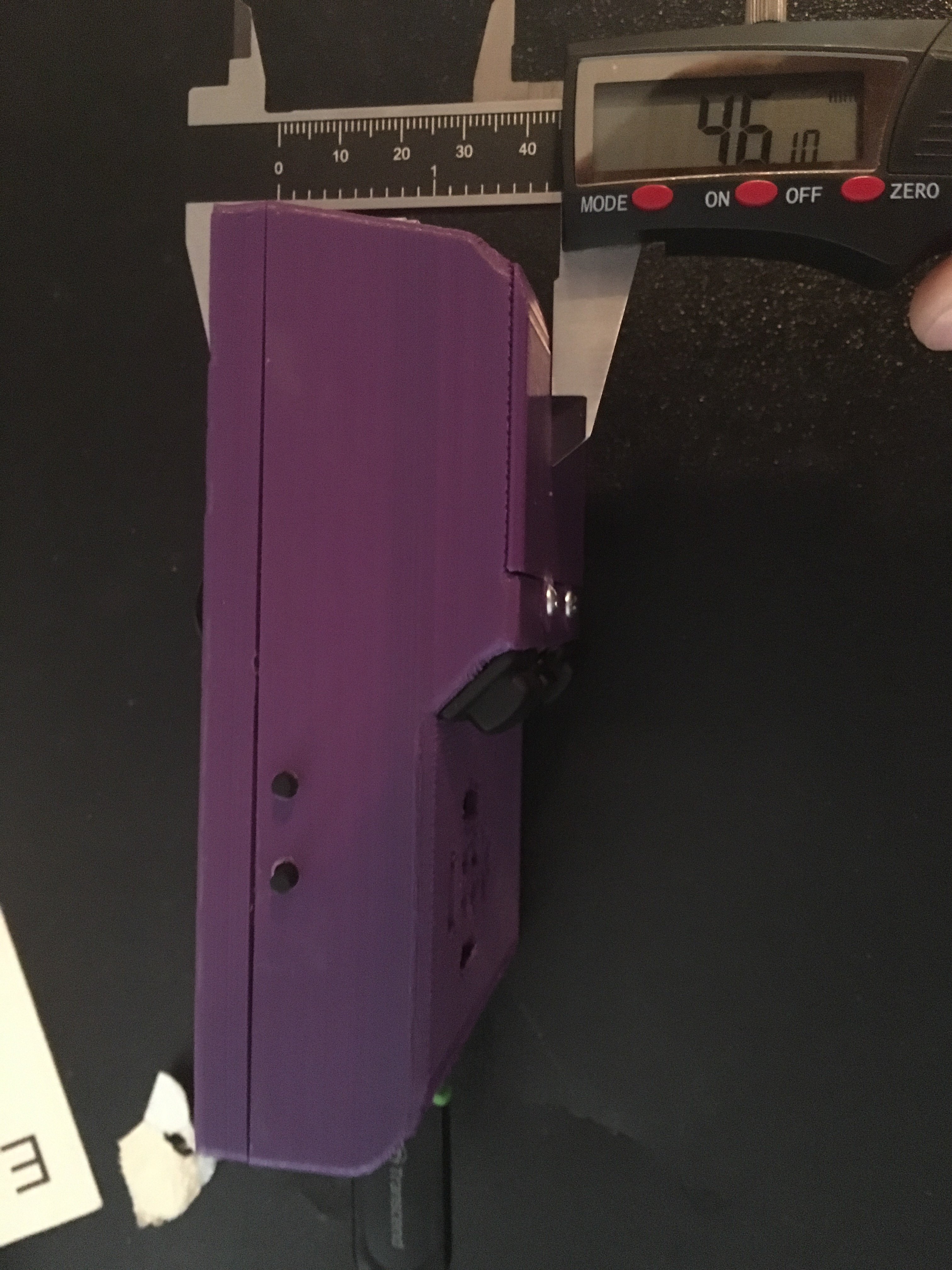

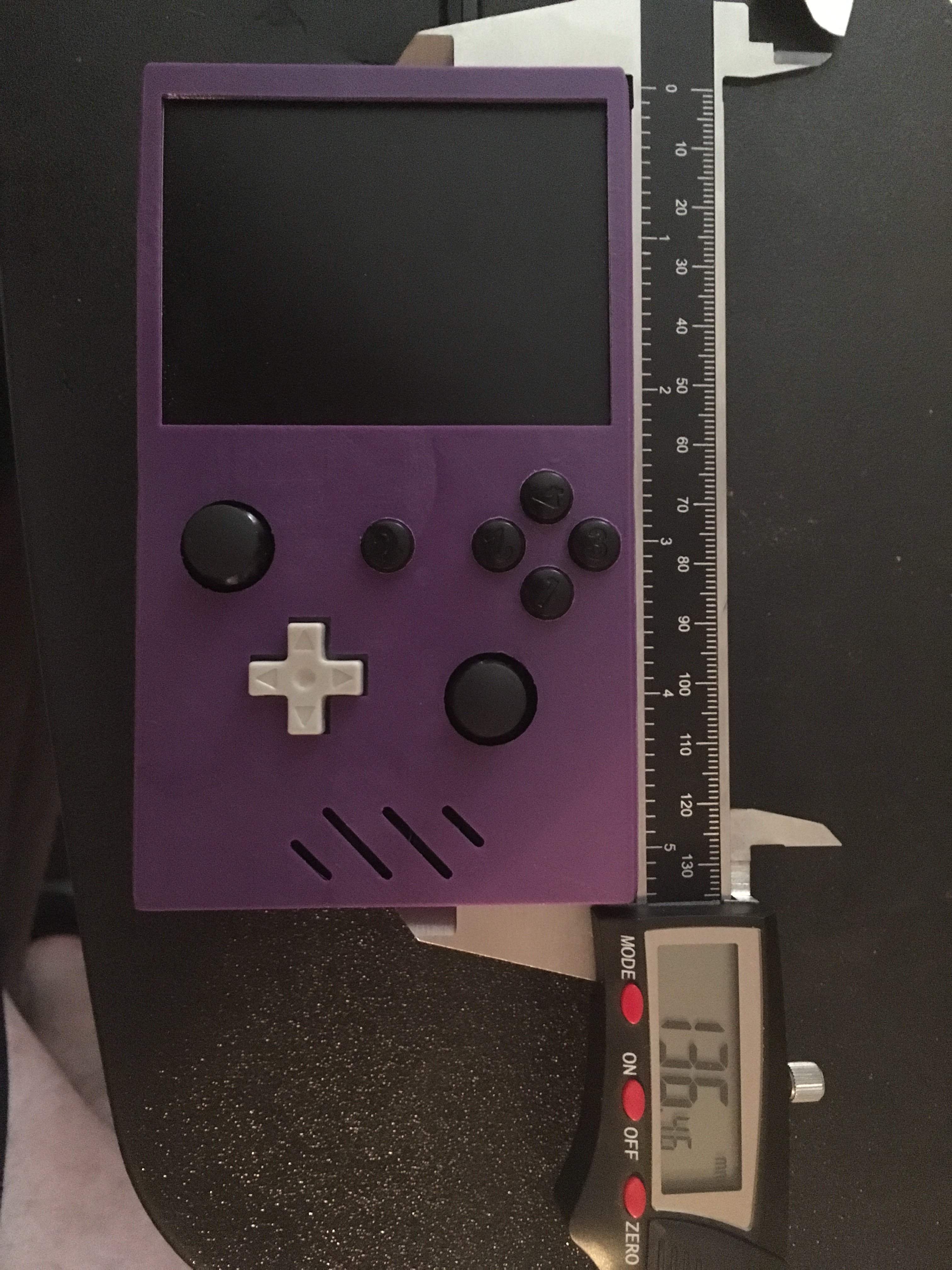

Thank you for the kind words. I'm not sure it's small enough for the record. In fact, I know it could have be at least 6mm thinner in the battery area. Even more so without the removable batteries.
Here are the measurements.

Overall dimensions, its about 25% bigger, but I think yours is smaller volumetrically because of how its shaped. Regardless, I think its awesome. Also post nudes internals pls.
