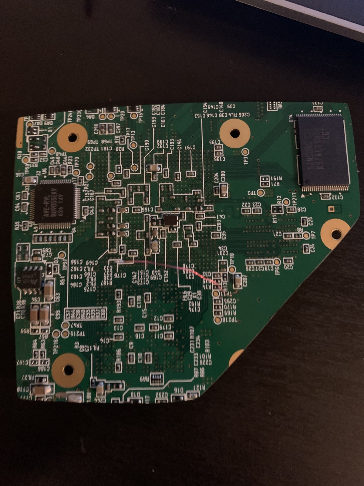

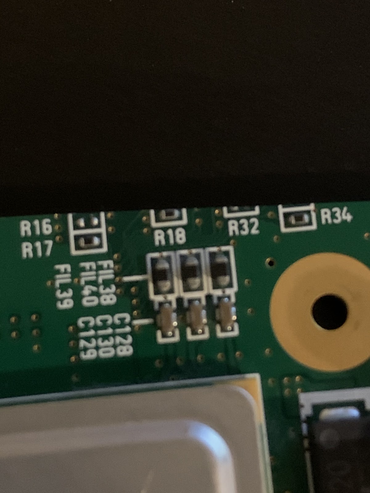

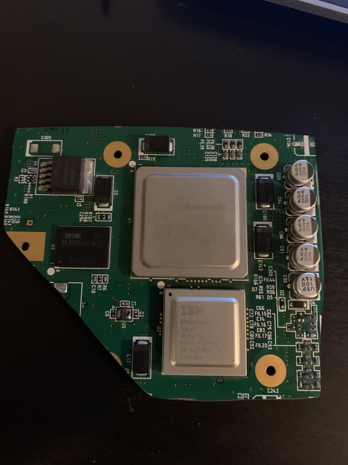

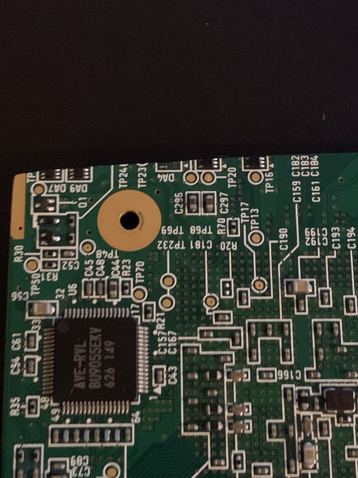

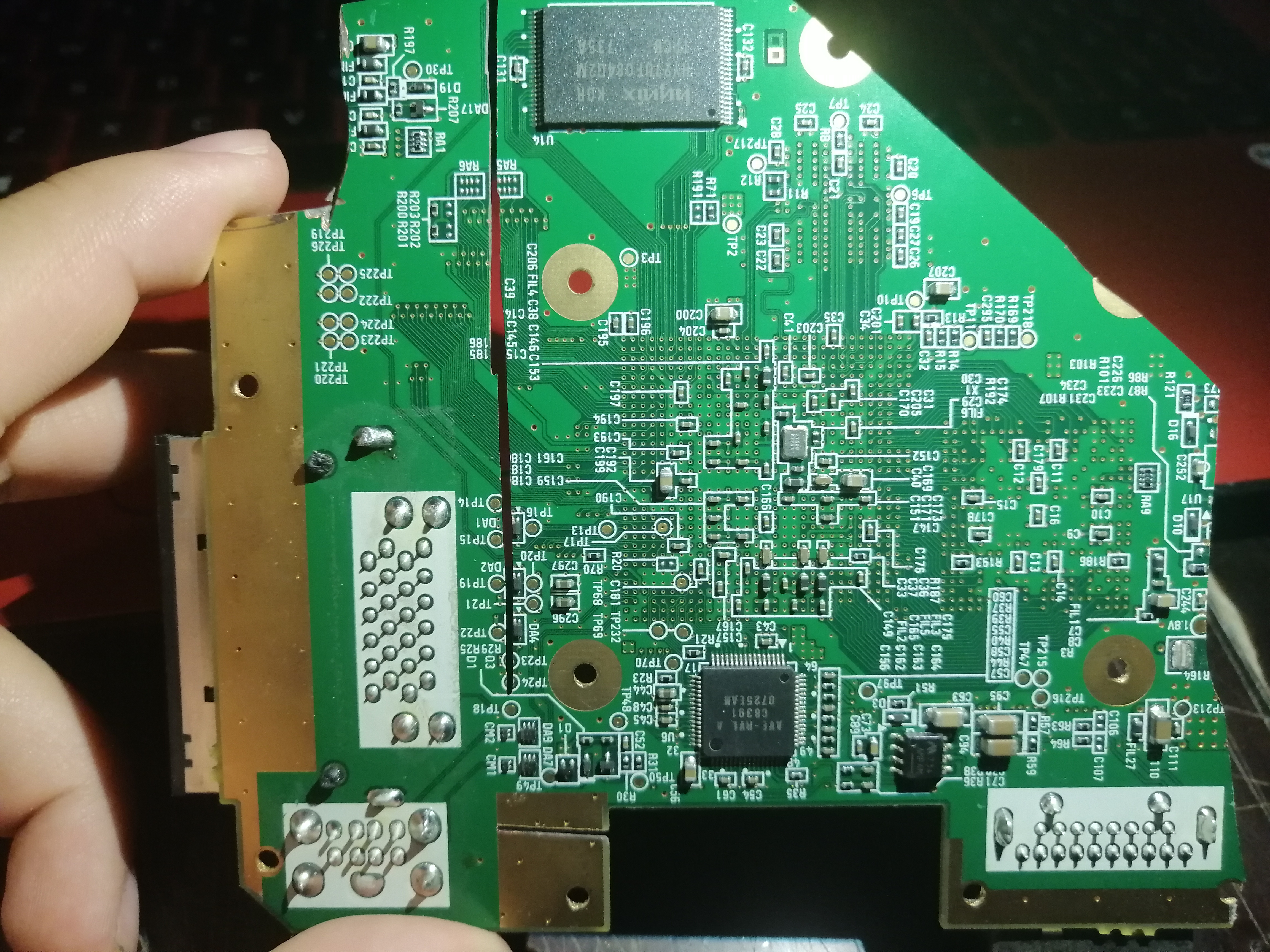

I did the OM6 trim and i feel like i overtrimmed a little bit on the top. Can i still use this wii? Thanks unnamed.jpgunnamed (1).jpgunnamed (2).jpgunnamed (3).jpg

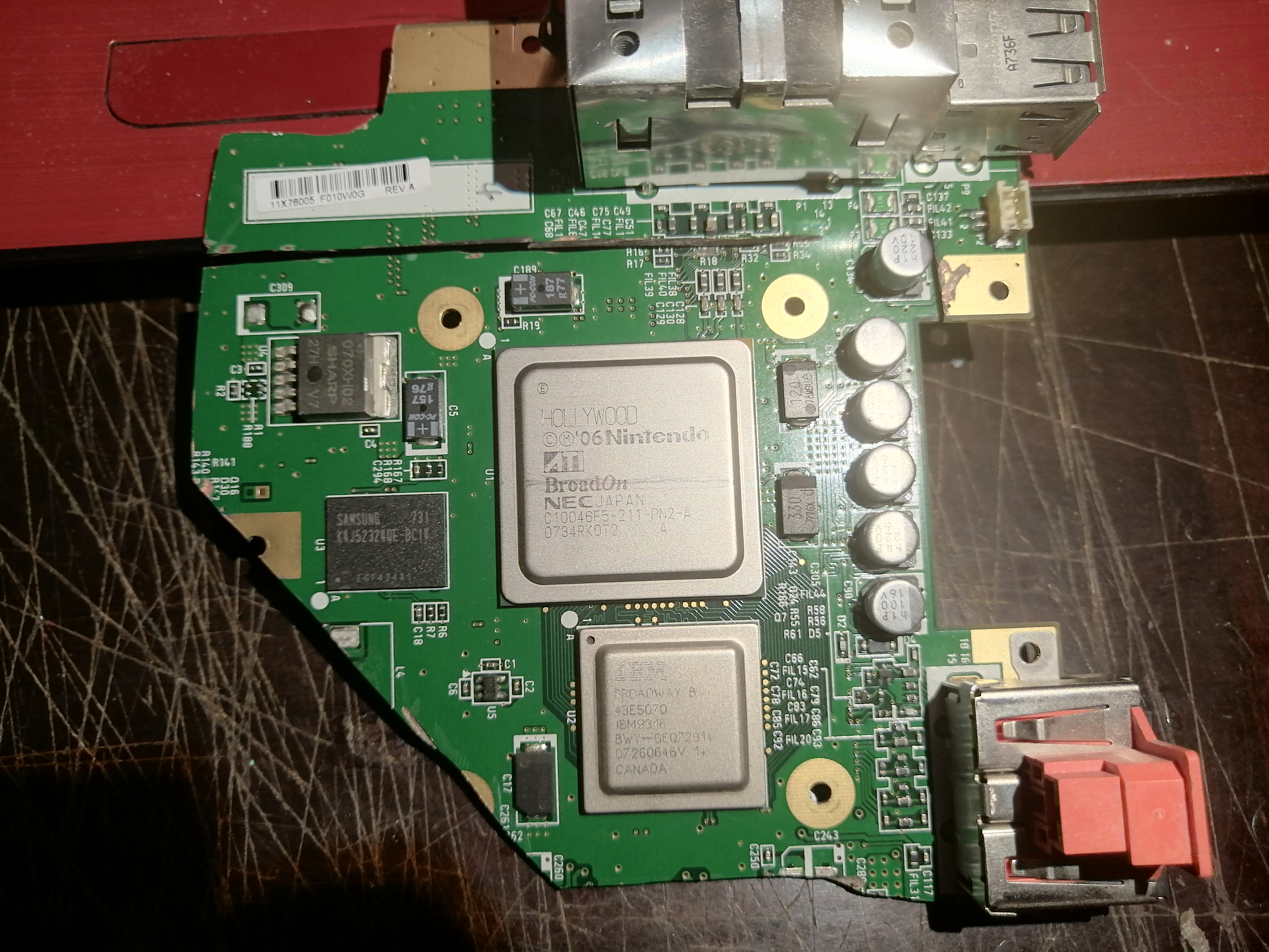

Hello, I tried to make the OM6 trim but i think i mess up or what do you think?

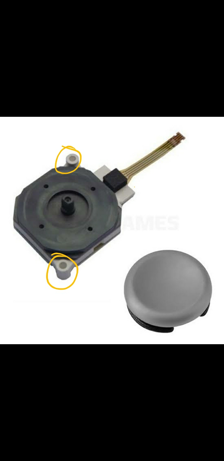

Hello first of all I'm new to this forum so I hope I'm not doing anything wrong. I'm currently working on making a super portable controller that I can take with me said that I'm going to use 3ds joysticks since they're so low profile. I will be 3d printing the vas e it I know nothing about screws so to my question.
What kind of screws does the 3ds use to hold it's joystick in place? Or how can I secure the joystick in place?
Sorry for the long post and the small question and hope someone can help me.
Hey Jilermo If you check out my worklog https://bitbuilt.net/forums/index.php?threads/gc.3592/ i made a mini gamecube controller using 3ds sliders. I ended up using some of the longer screws off of a broken ds lite that I scavenged for the buttons, membranes, screws, pcb and various other parts. perhaps it can provide some guidance or inspiration as you make your mini bluetooth controller!
