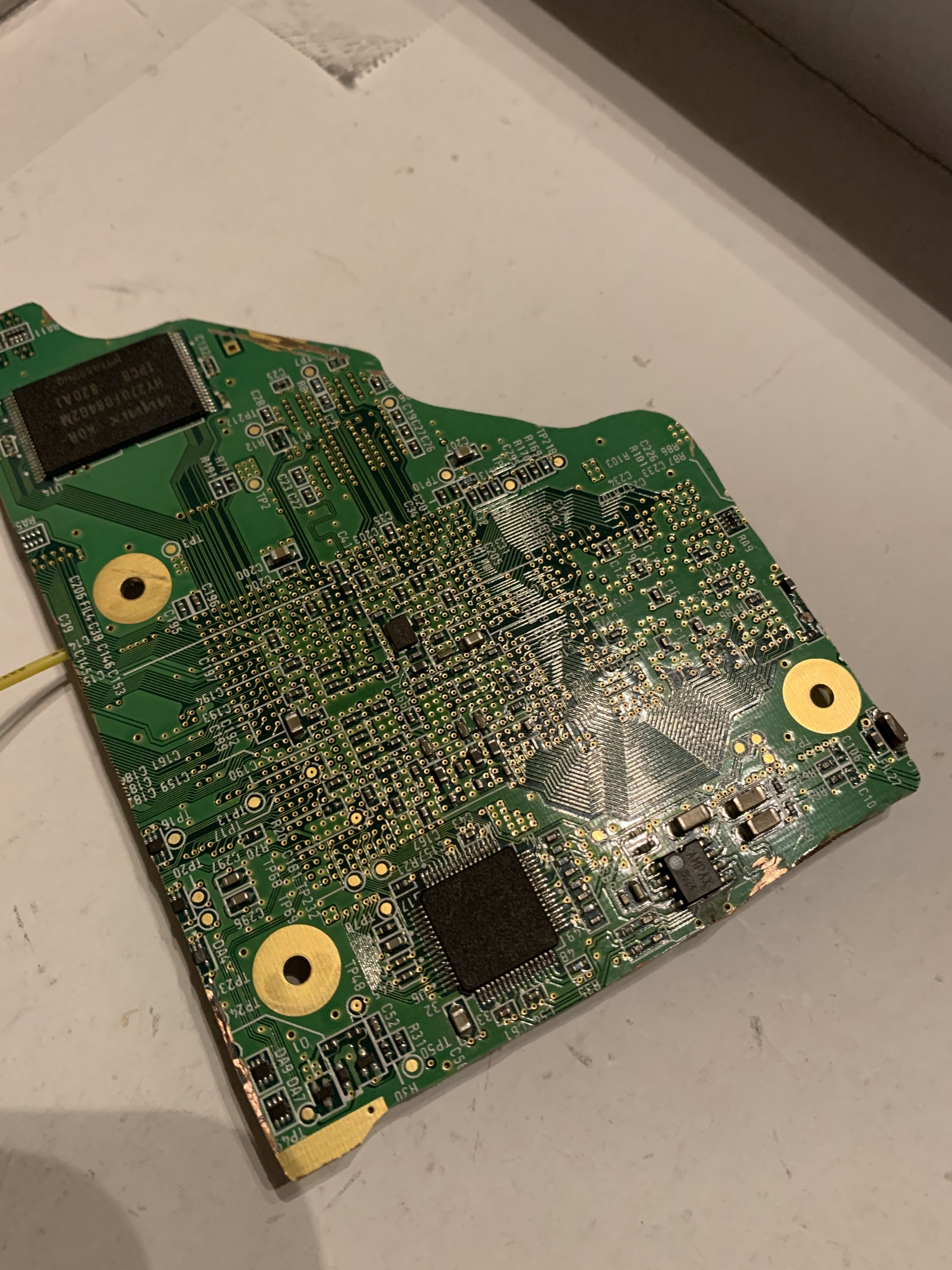

I am new to modding and I was following the trim guide and got to the point where I am relocating the U10 and I flipped over my board to realize that it is completely different from the guides. The parts are in different locations and I am not sure how to continue other than buy another wii... suggestions?

Did you look to see what the board revision is? From what you're saying, I'd guess you have a 6-layer board. When Nintendo changed from the 6 to 4-layer boards in the Wii, they moved stuff around, although the U10 relocation should be the same on all the revisions. This thread will show you how to find out which revision you have; if you still have the scraps from trimming the board, you should be able to find the revision number. This thread will show you what to do differently if you do have a 6-layer board. This being the case, you may still have to buy a new Wii, since the 6-layer board is trimmed a bit differently, but don't quote me on that. I am also new to this, so who knows? You might be able to still use it. Hope this helps.

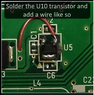

It's kinda hard to tell from this picture, but it looks like I'm supposed to bridge the bottom 3 pins on the U10. Is that the case?
