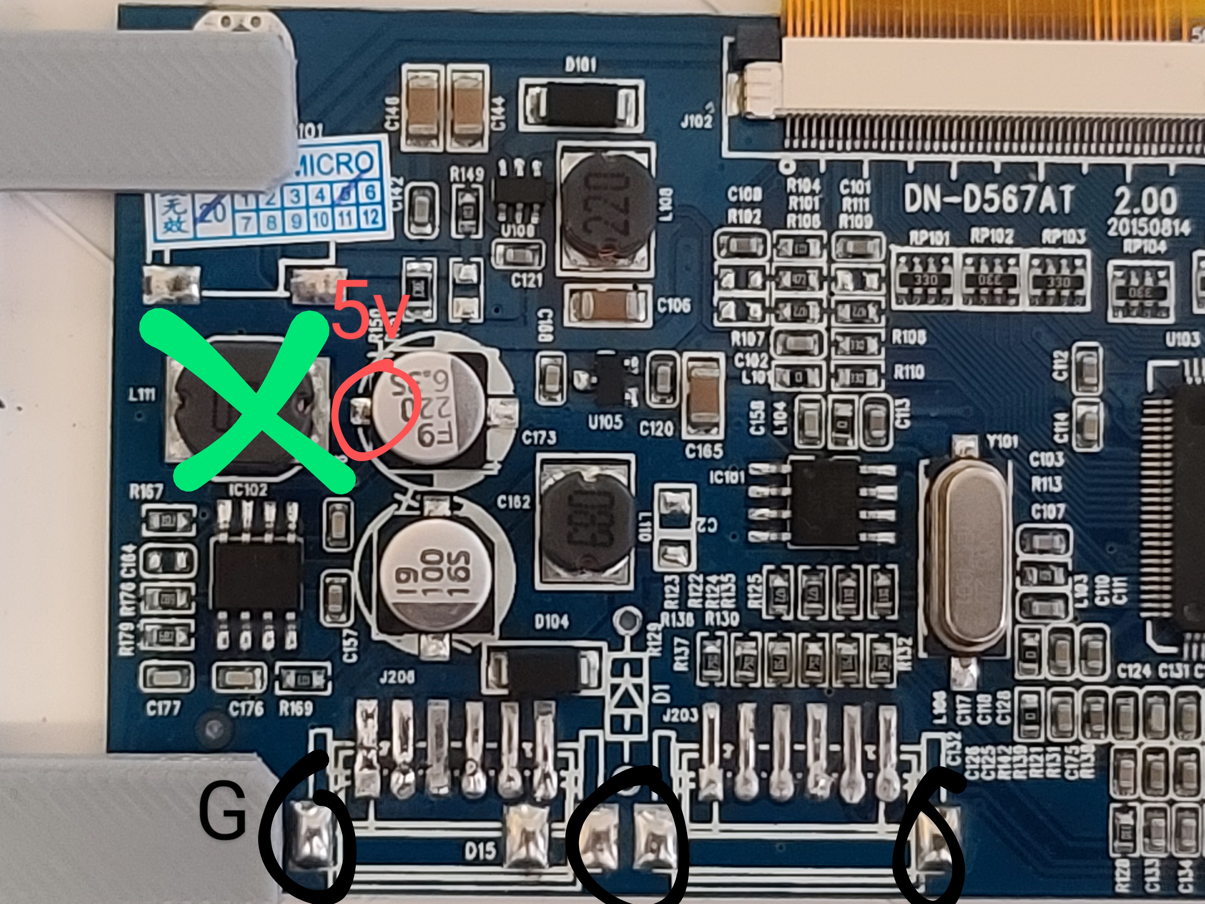

Hello was woundering how I could get the LCD to power on with 3.3v instead of the 12v?, I can't find any guides anywhere about how to do this but the LCD screen is the 5" screen from bitbuilds siteView attachment 17373
The screen needs more modification to run on 3.3v than running on 5v, something about the display backlight I think it was needs at least 5v. I read it a while back on the discord. The screen will run on 5v easily. I believe I'm alright to post this pic, I removed my wire connectors to solder directly but the green x component you'd removed and 5v is listed. This is the mod I did for my 5" LCD in my PS2 portrait build.
Thank-you !! Got it to power on but it just says no sync

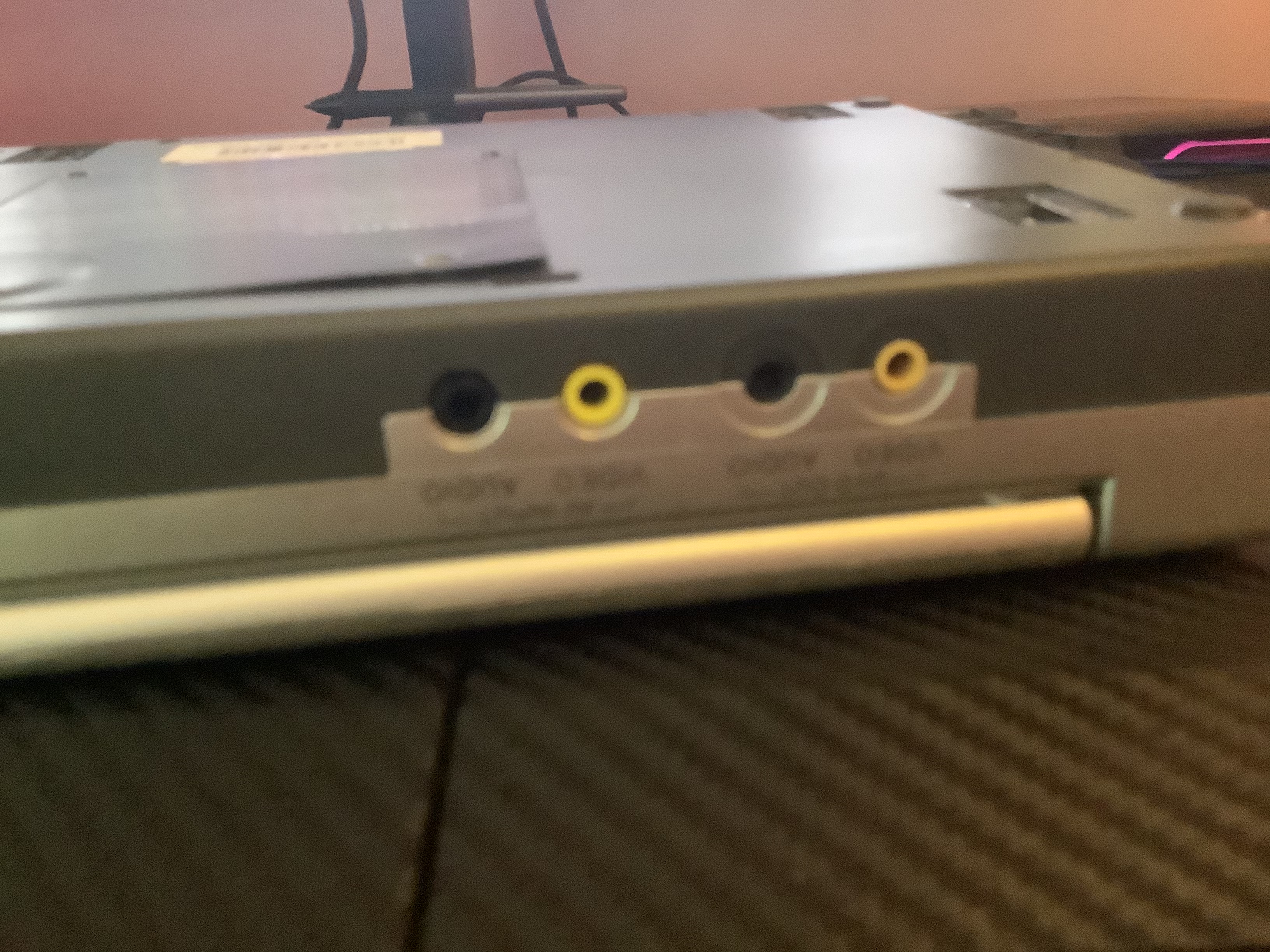

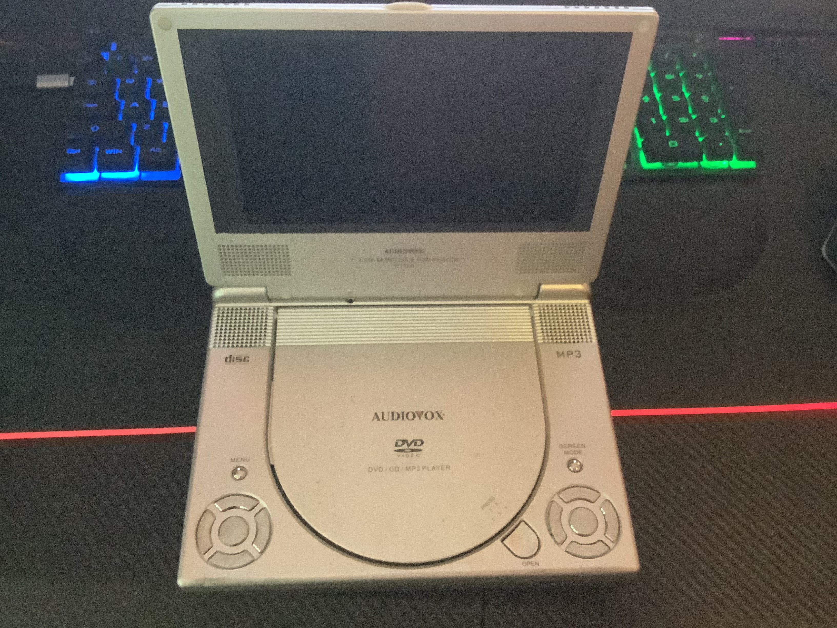

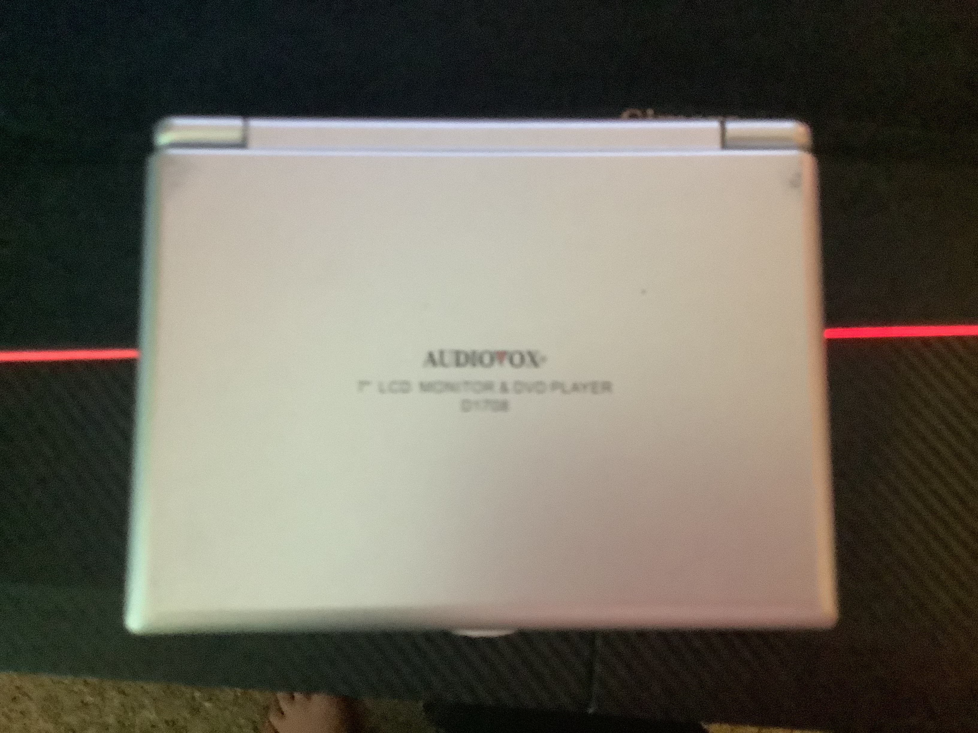

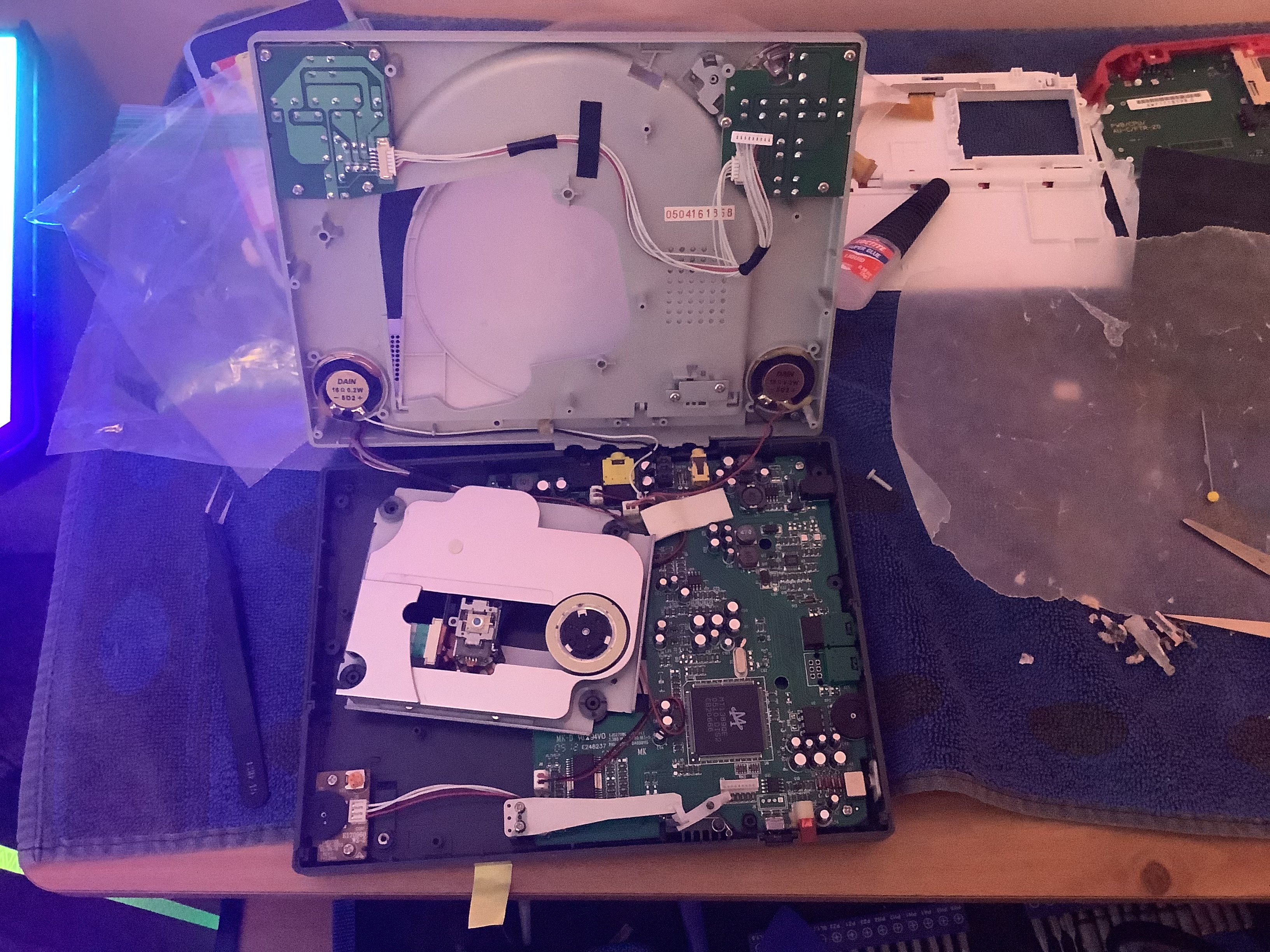

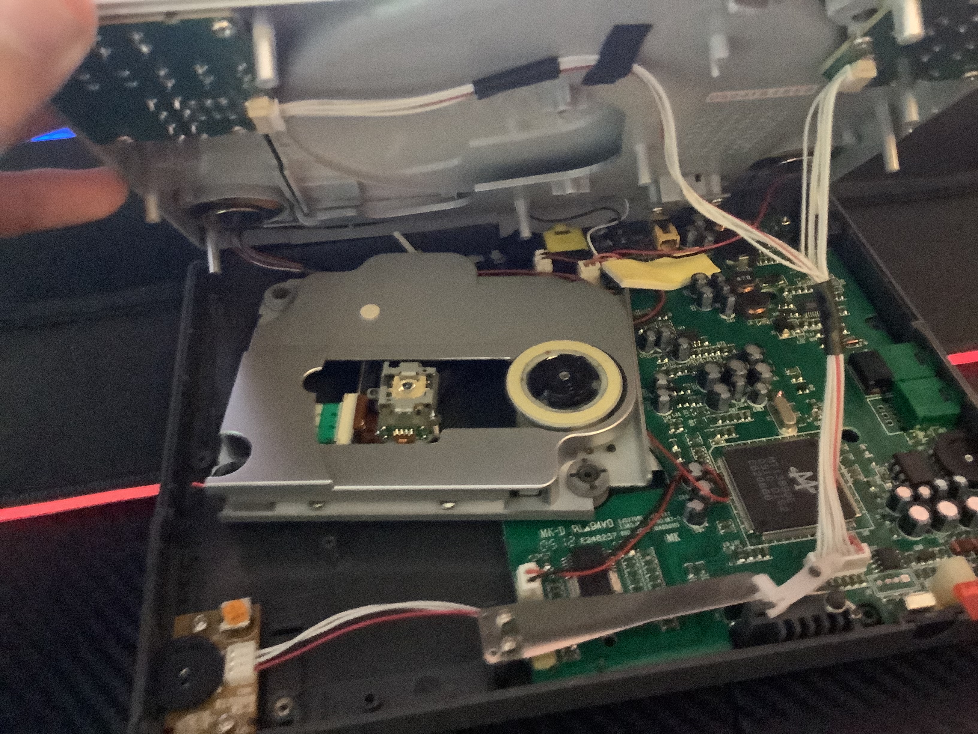

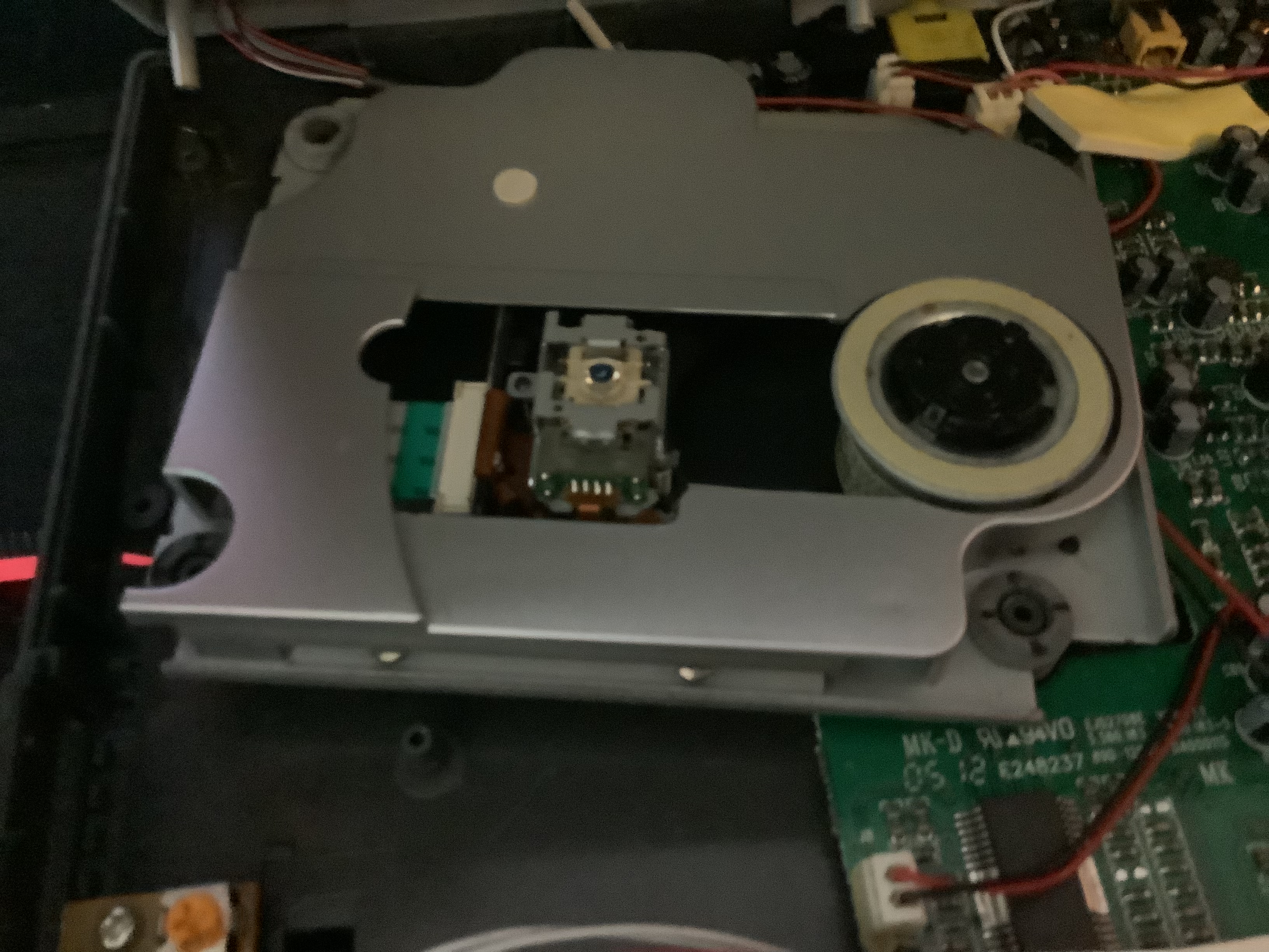

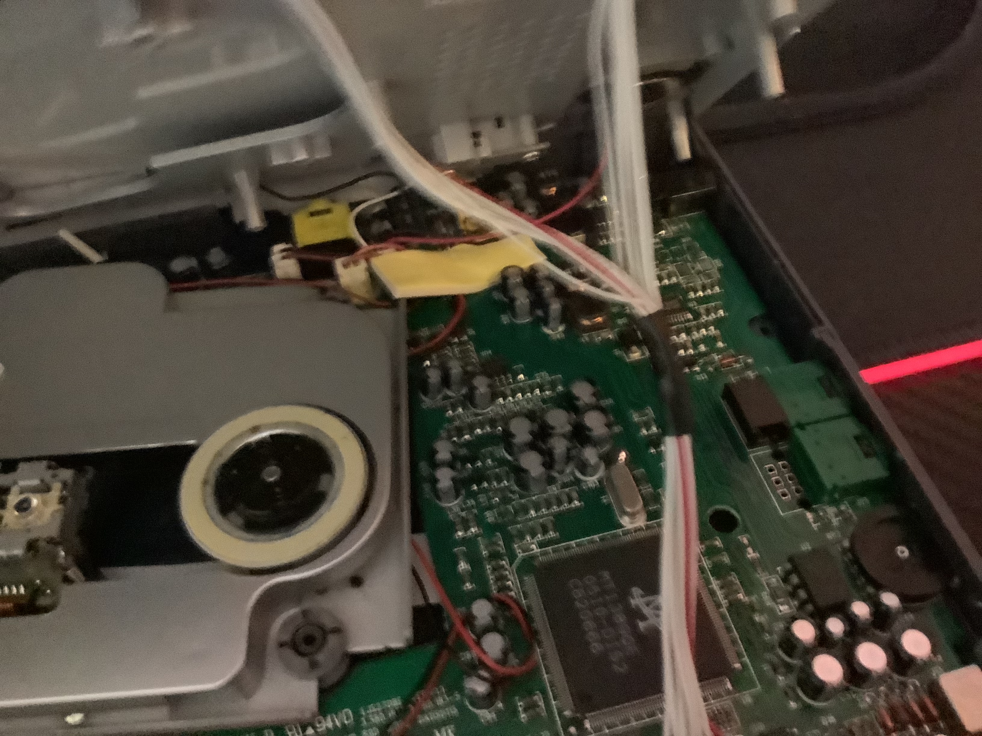

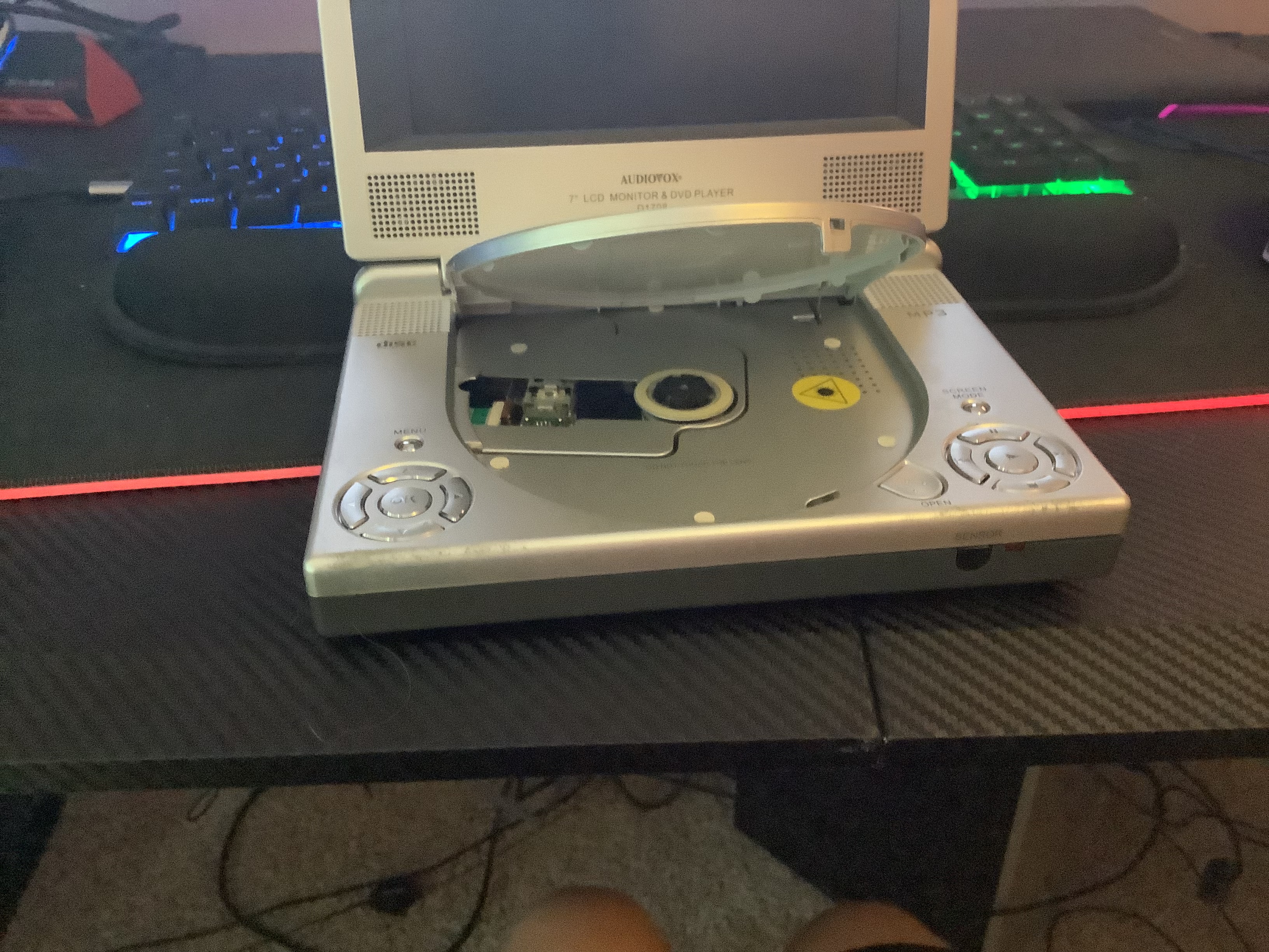

Could I use an old foldable DVD player with speakers and screen already on? This would make everything easier as I wouldn’t have to buy everything new like a case, screen, or speakers and I could easily cut specific parts of the case to make it fit ports, buttons, joysticks, etc. and work decently well. It also has video in and out ports, headphone jack ports, volume control wheel, on and off switch, brightness wheel, buttons for dvd controls(although I think I will change those), and a dvd reader that I could possibly use but I don’t know how that works and if that would be possible. I have 2 of these DVD players so I’d also have multiple parts and cases in case something goes wrong. Is this possible?
It's possible, yes

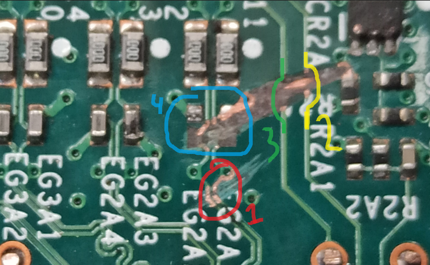

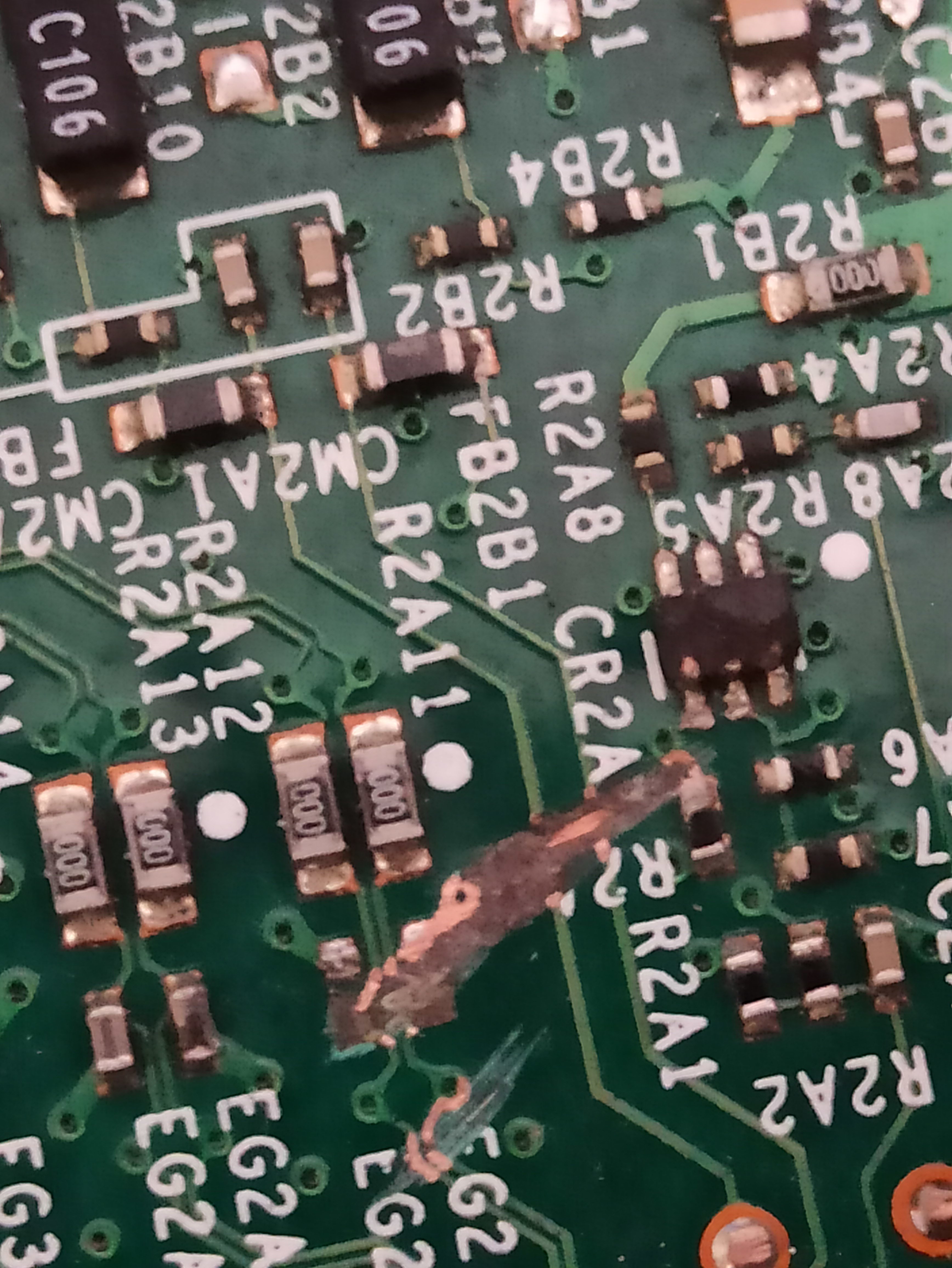

Hello. i hope this is the right place to post this...

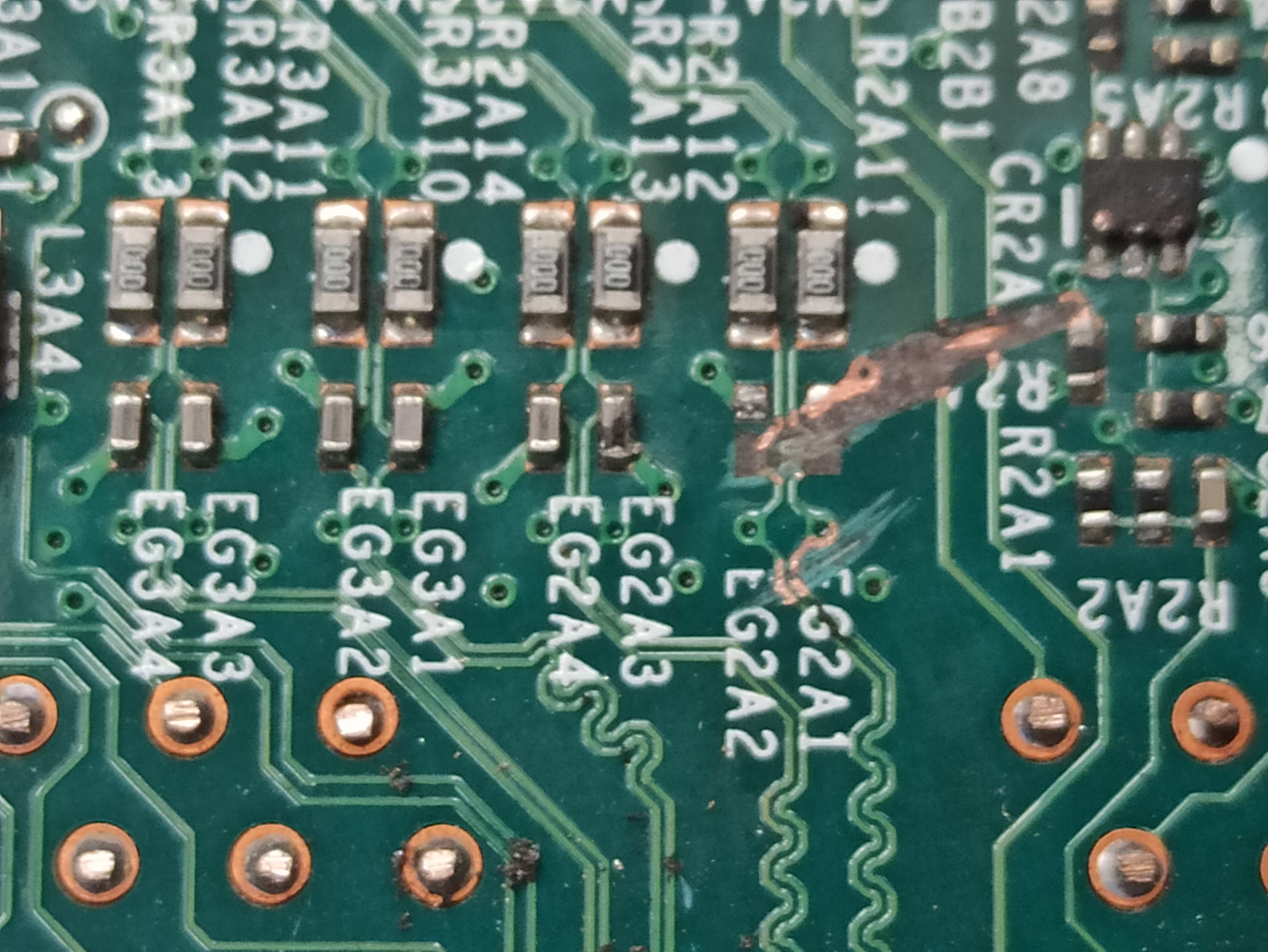

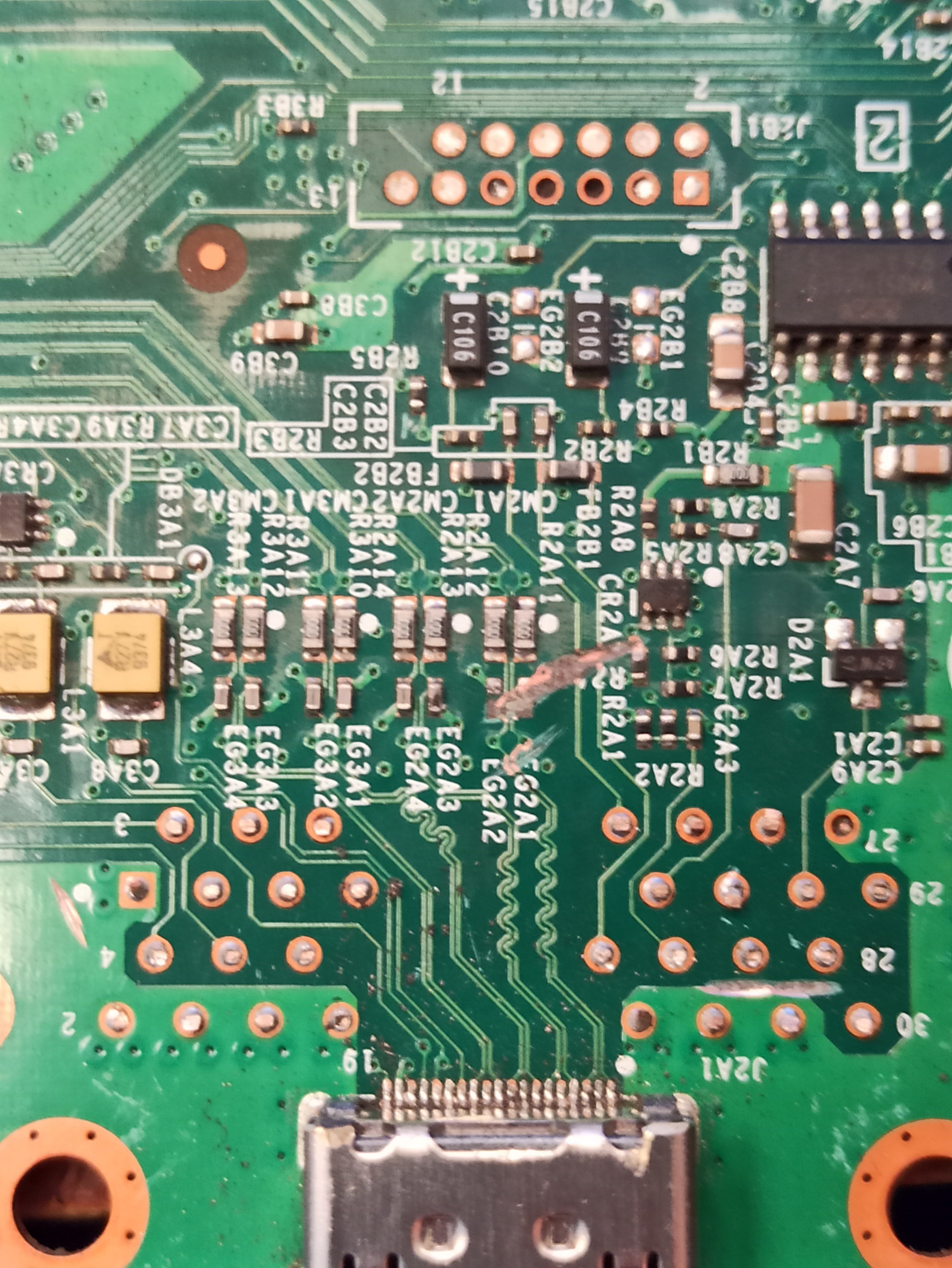

i'm making a laptop Xbox 360, and wanting it as flat as possible, i decided to remove most of the conectors, including the Microsoft video output, since it has HDMI.
but while cutting it with a Dremel, my hand failed me, and this happened...
Can this kind of damage be fixed, and if so, how do I go about it ?
Looks like you're lucky, you've only shaved off some of the first layer of the PCB.
Area 1 looks fine, the right trace might need some solder to bridge the gap, but I don't know if you need to since it looks intact.
Area 2&3, you'll need to use some magnet wire to repair those traces like I showed below. Scratch off the solder mask to expose the copper some more and solder to that.
Area 4, you've knocked off two "EG2A" components. I've no idea what that designator is for, I've never seen it anywhere before but it looks like maybe a capacitor for filtering the HDMI signal since it's wired in parallel to the signals. So you should get an output without these, but make sure to repair those two traces. You could stick one end of a wire to the bottom of the "000" resistor and one to the via above area 1, but make sure to scratch off the solder mask first.
I noticed some damage next to area 2, but I can't quite see what happened there. A closeup of that area would help but from what I can see maybe it doesn't need repair at all.
It may sound daunting if you've never done this before but it's definitely doable! Good luck dude
thanks, you are great help already.
here's my best shot of the damaged area. the trace seems cut off, but i dont know what that trace is about
