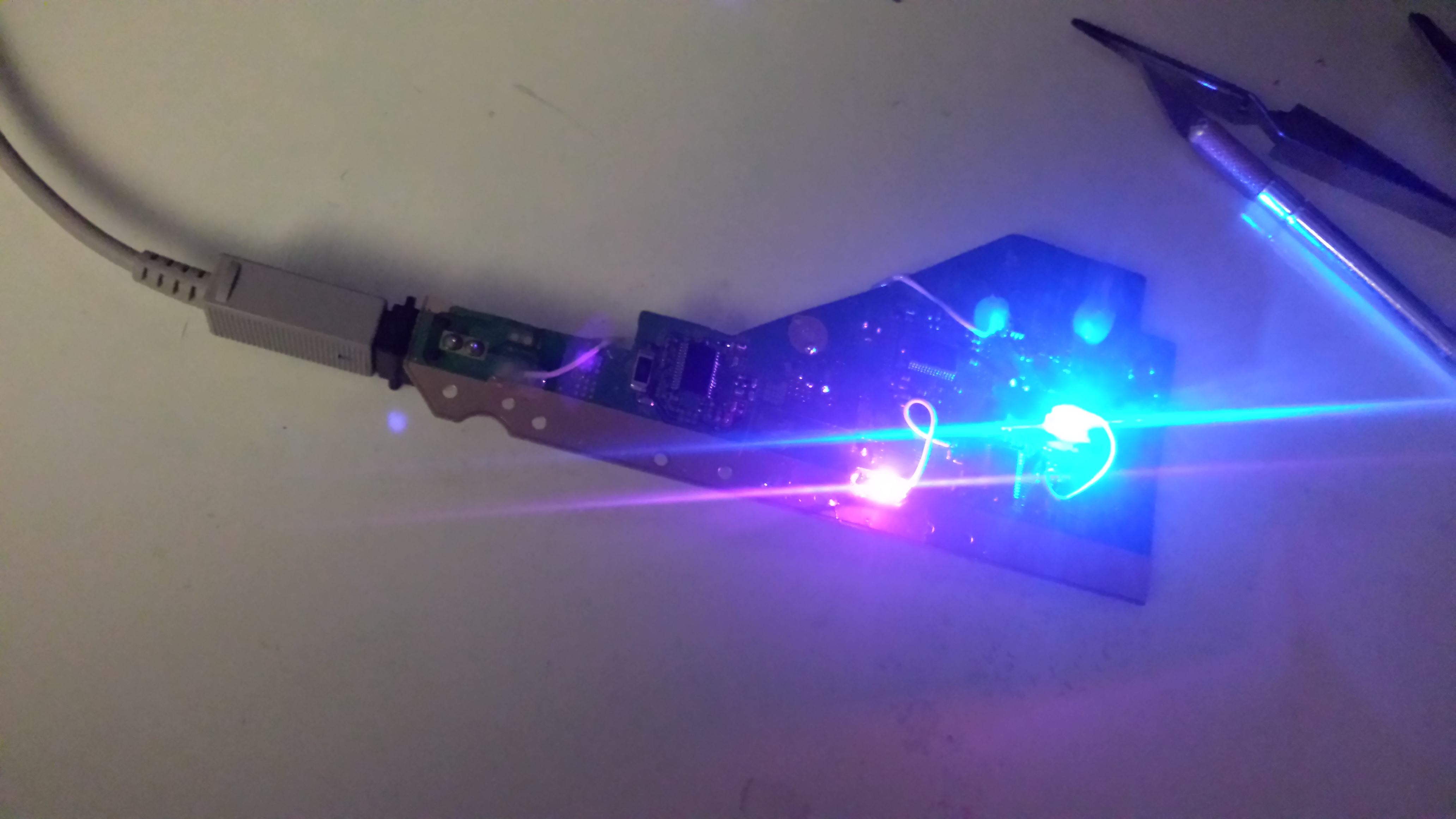

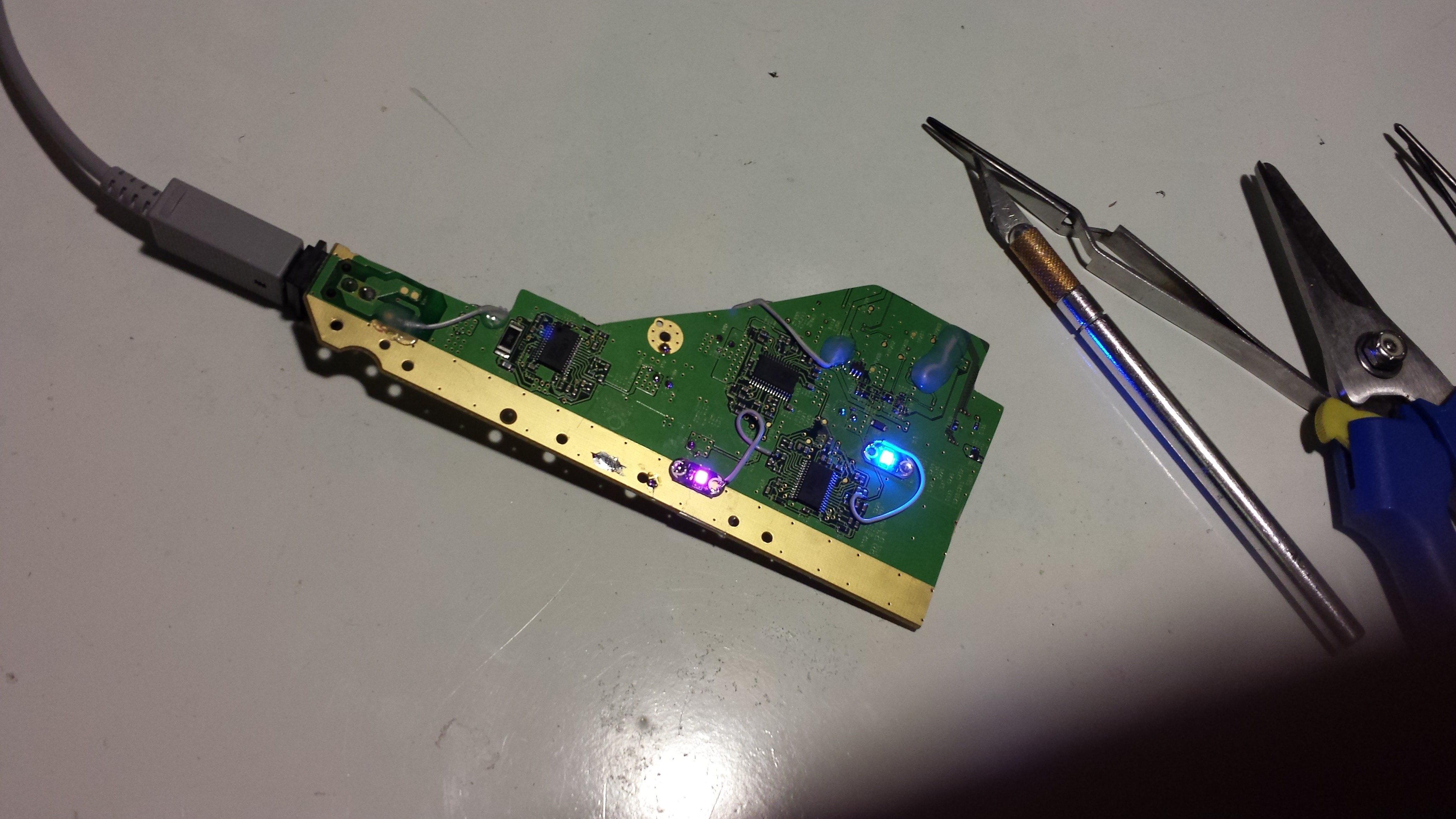

I'm pimping mine out with LEDs so I can always verify that I've got power coming out of all 4 lines.
