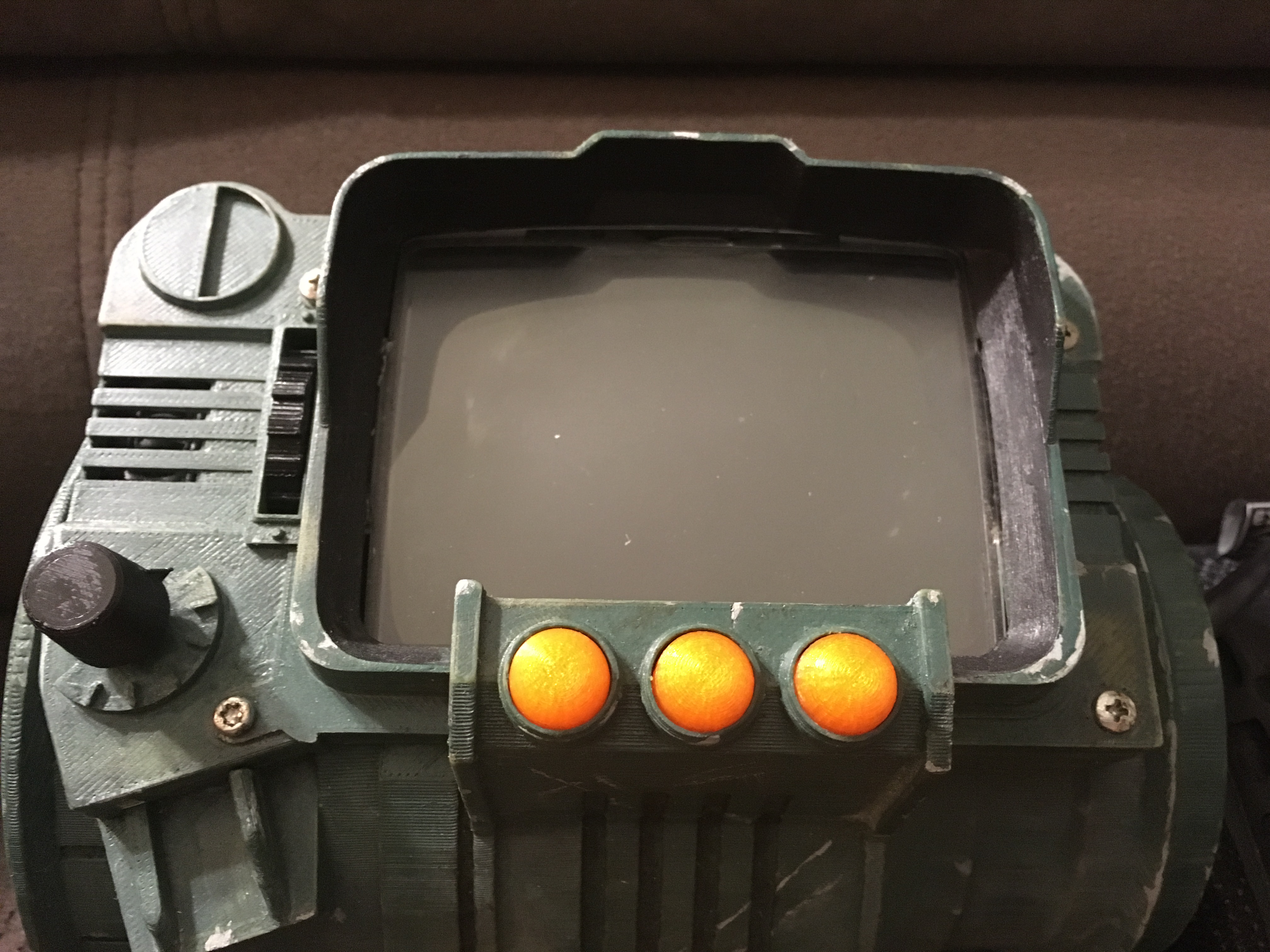

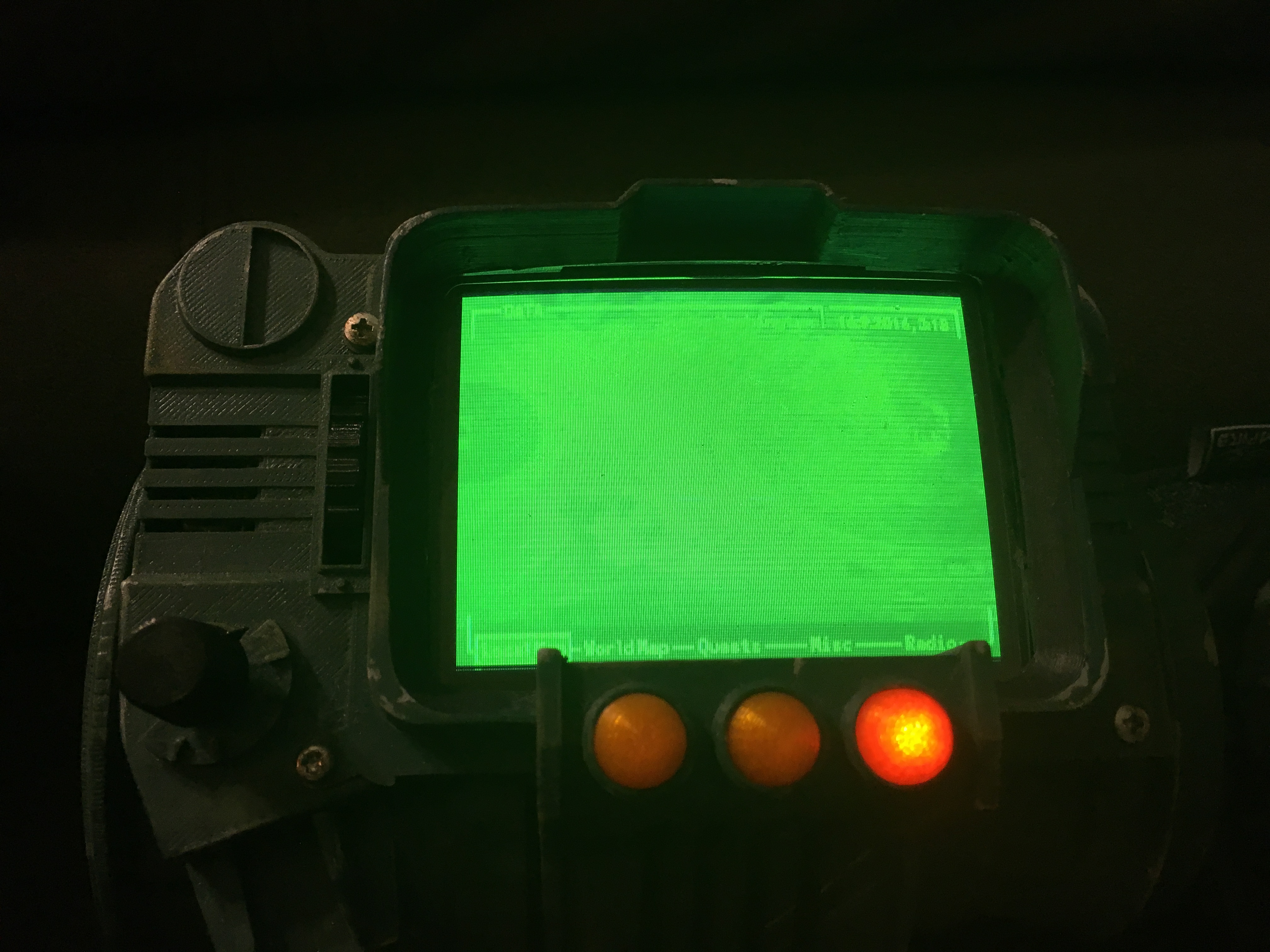

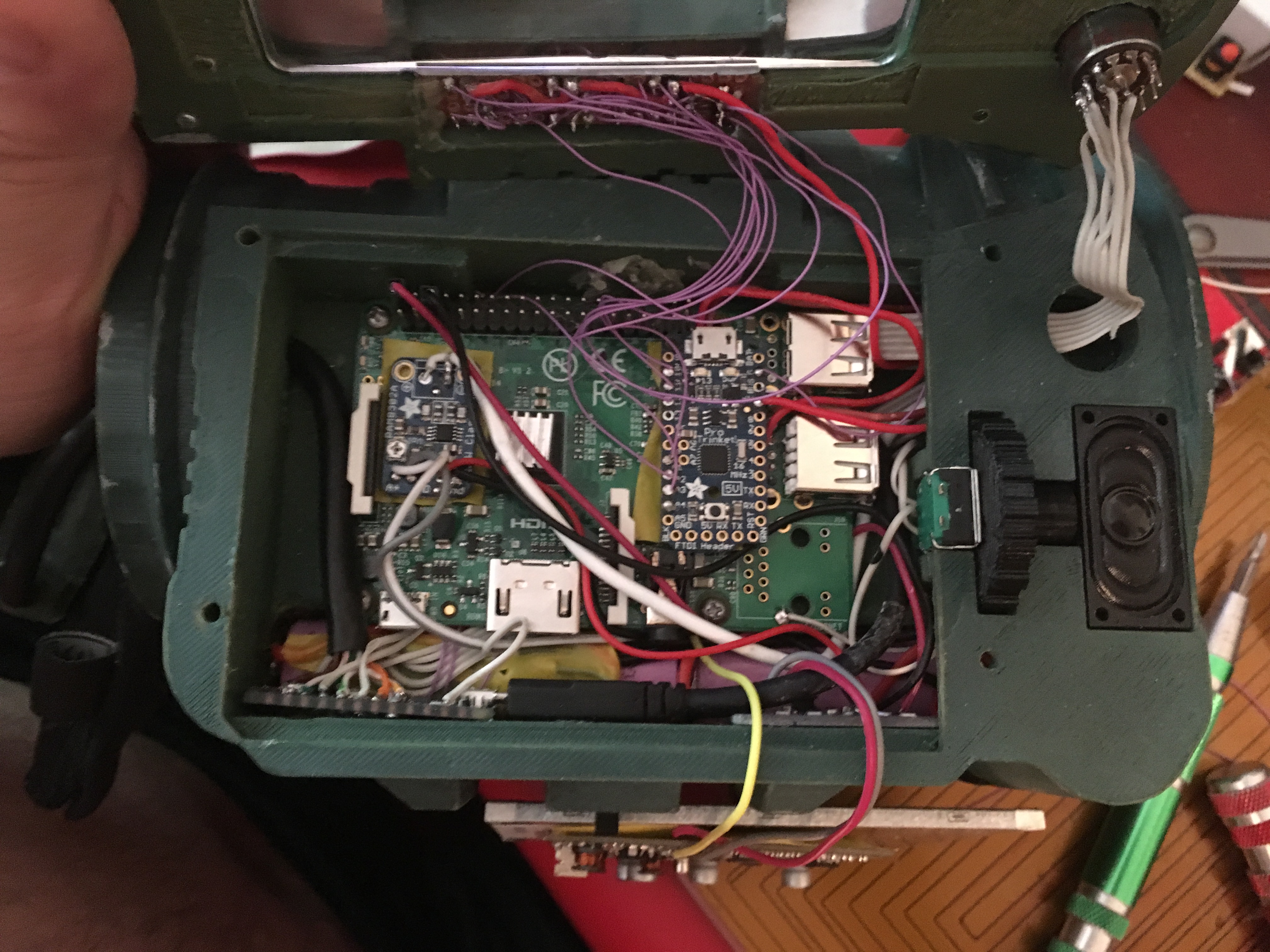

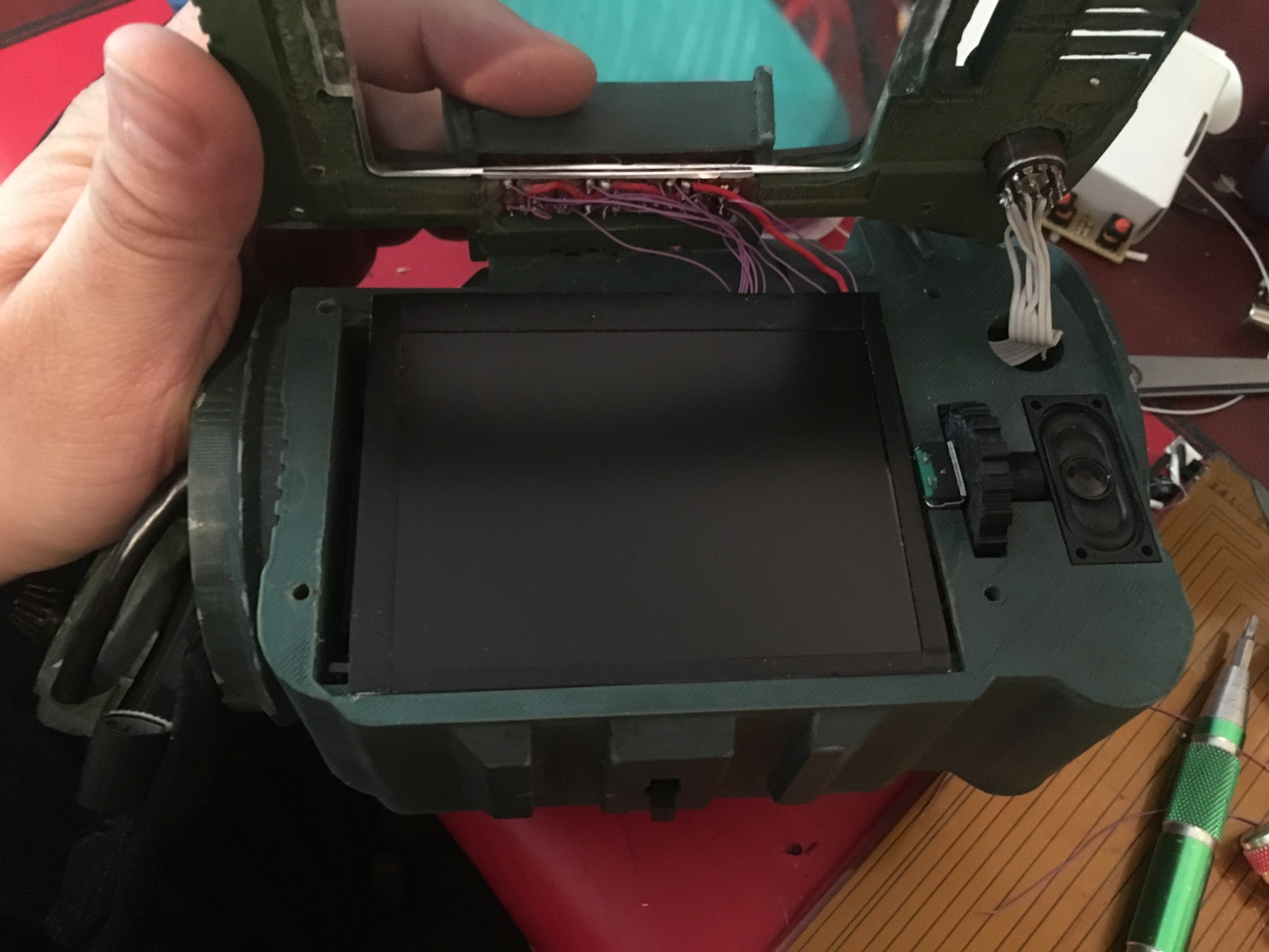

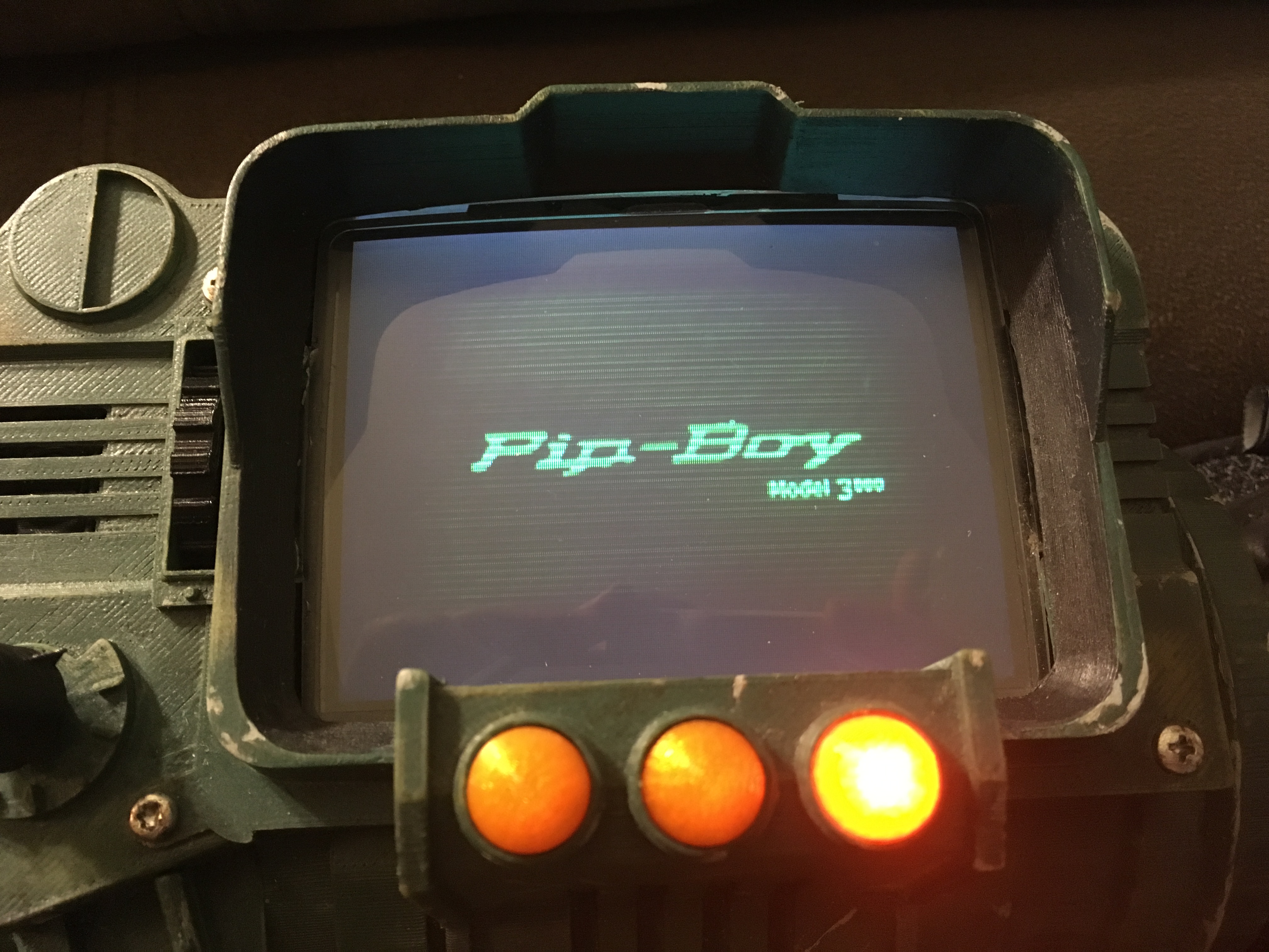

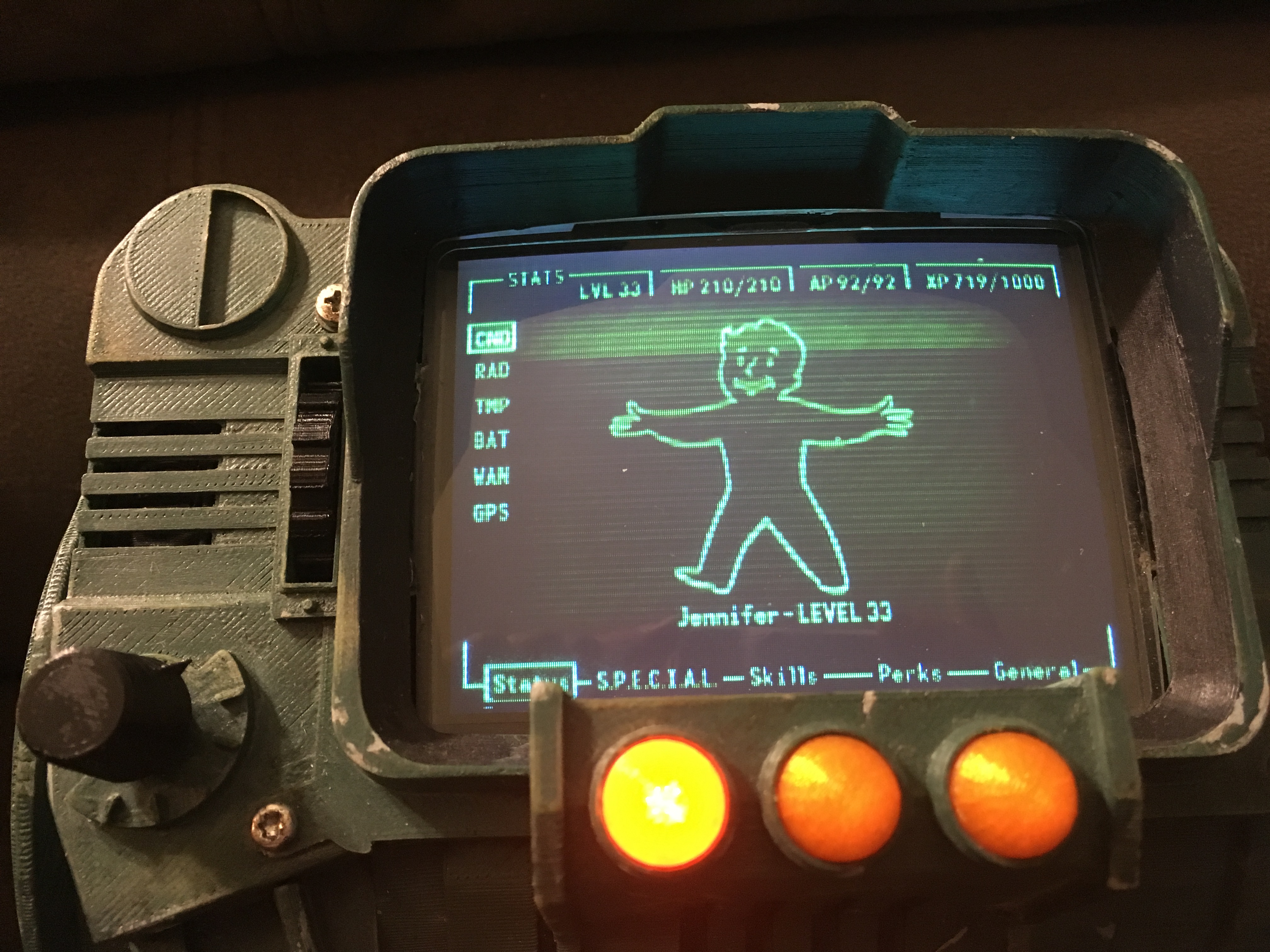

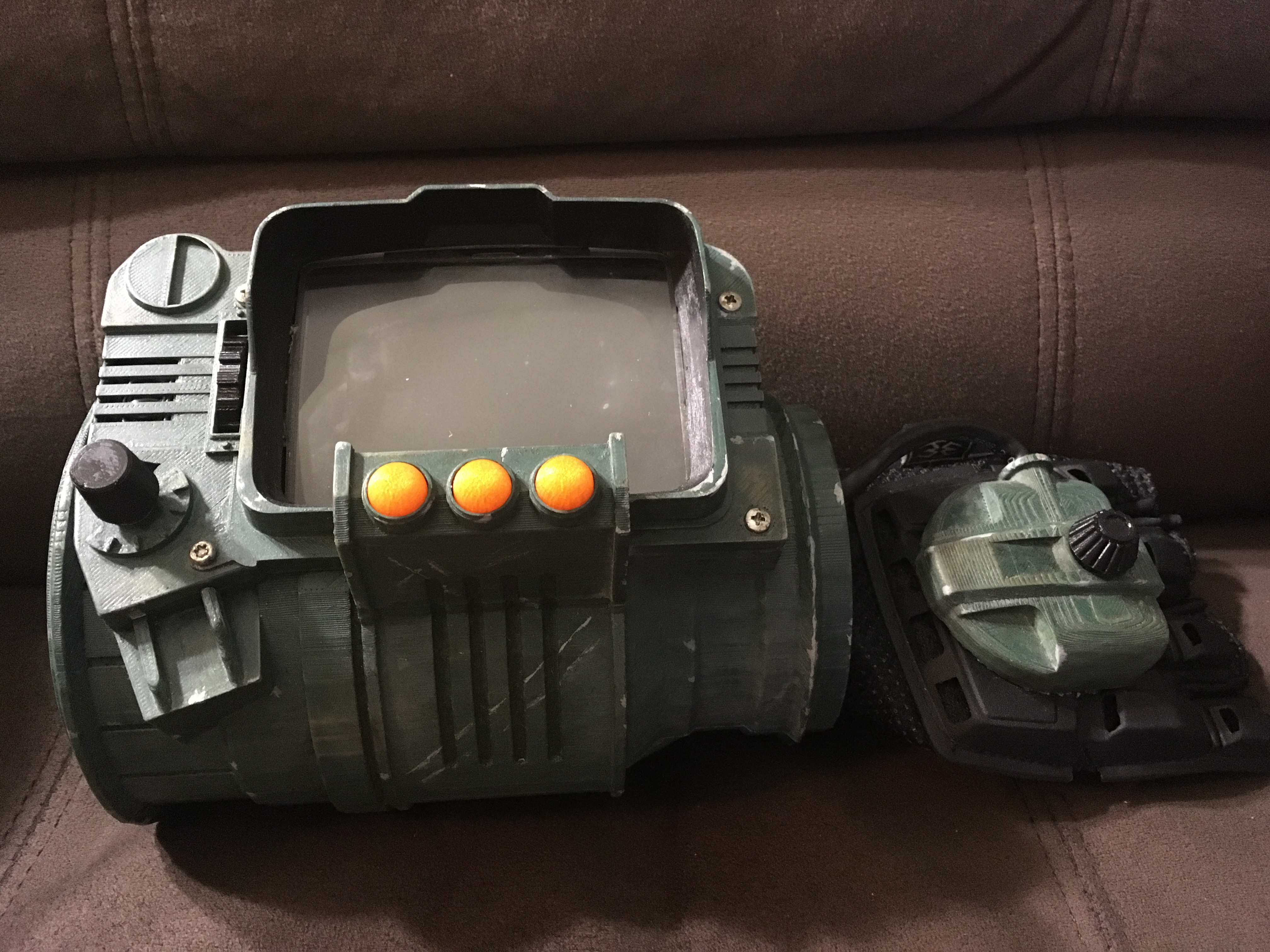

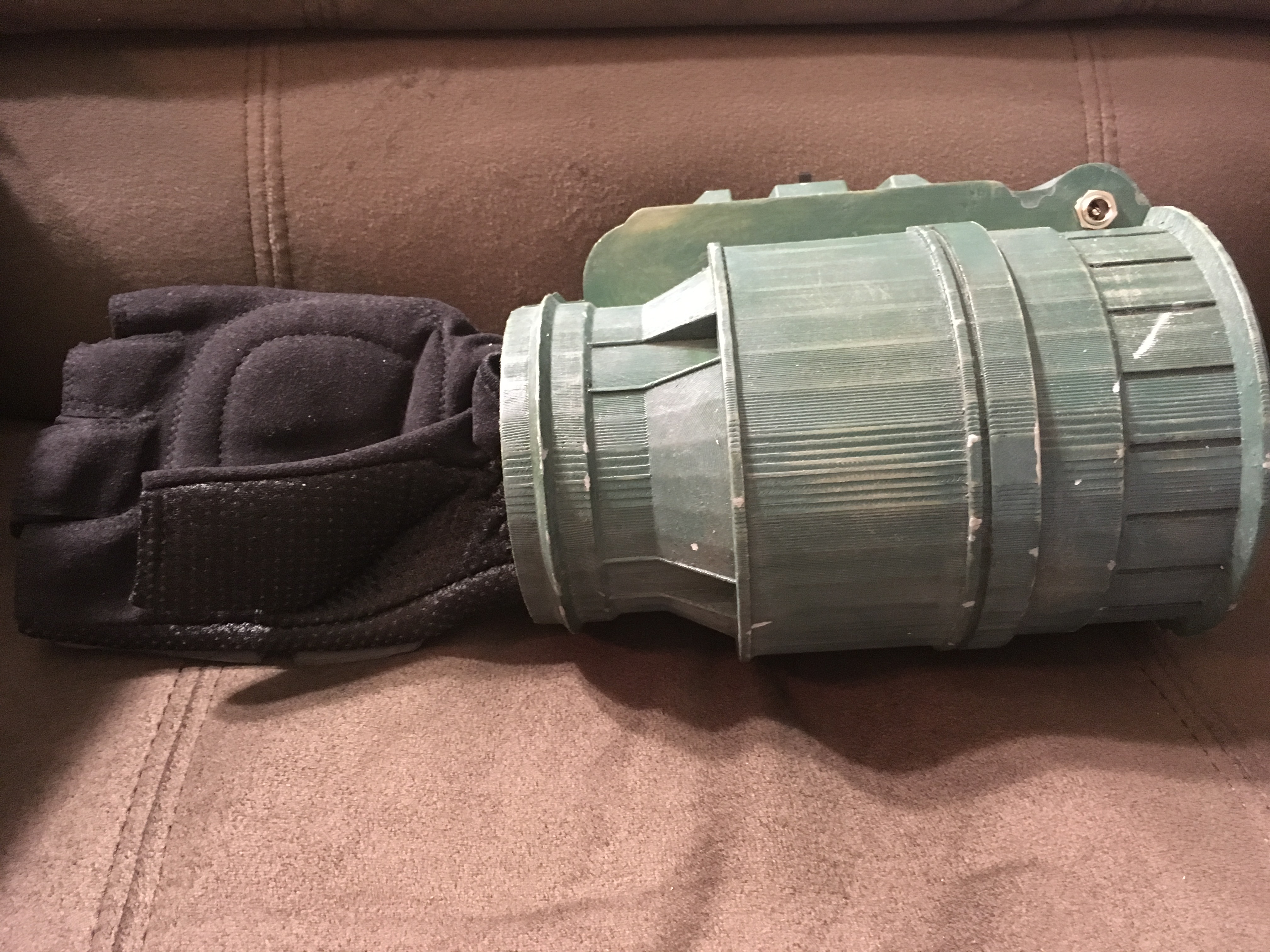

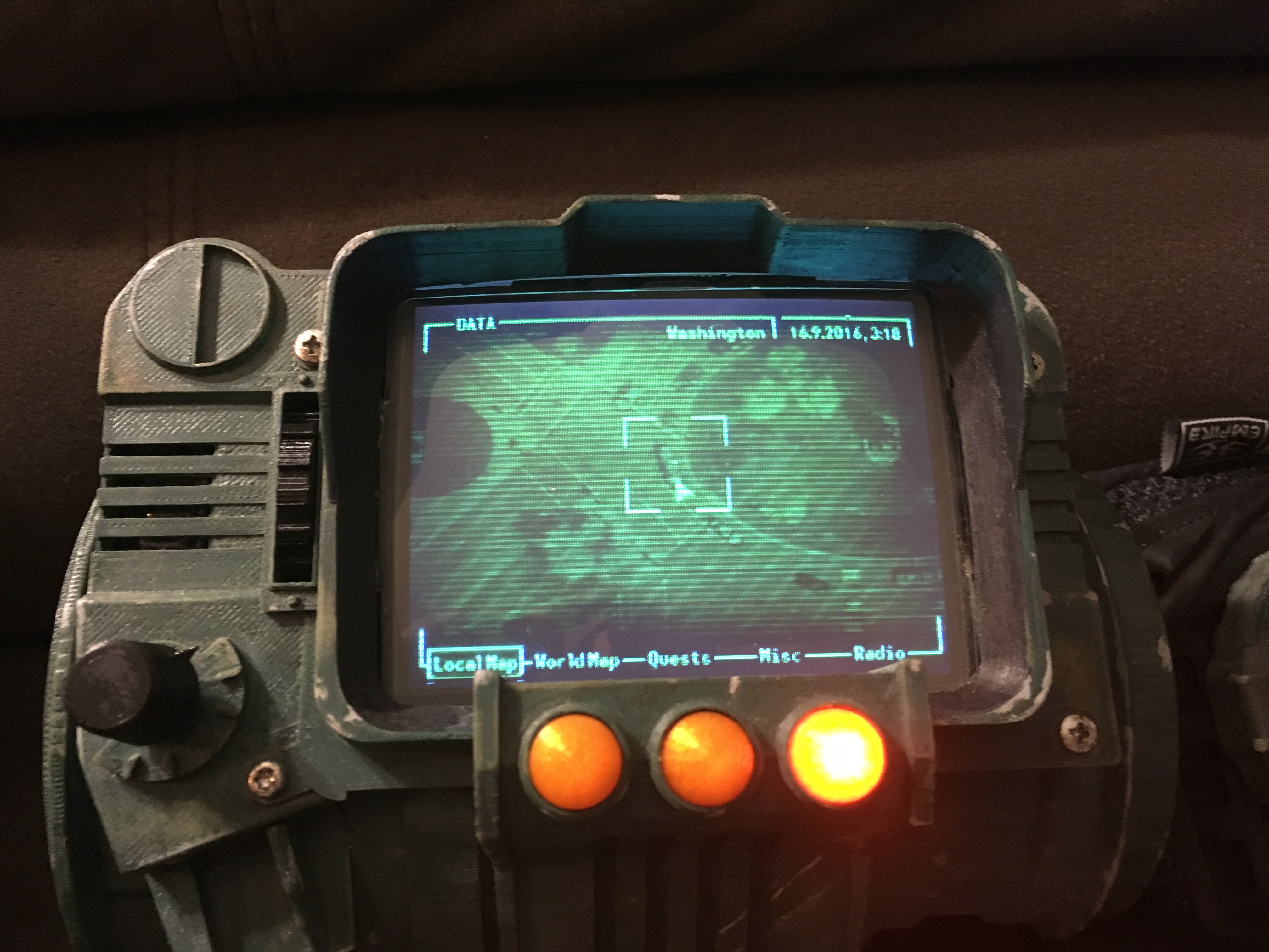

I wanted to take the time to show you guys my pet project that I've building on and off for about two years now.
My goal was to create a fully functional pip boy. Not just in terms of the software, but also in terms of the control interface. Not only that, but I also wanted it to be a standalone wearable unit, which meant internal batteries.
The design is of my own creation and was made in AutoCAD.
Features:
Custom designed and 3D printed (PLA) case and buttons.
Raspberry Pi 2
Adafruit Pro Trinket (Arduino clone)
1x 12 position Rotary switch
1x Rotary encoder
1x 5 position switch
3x dpdt plunger style switches
1x 4" Dalian Good Display
1x Super wide gear magnifying glass for a crt look
Features:
Raspberry Pi 2
1x Rotary encoder
