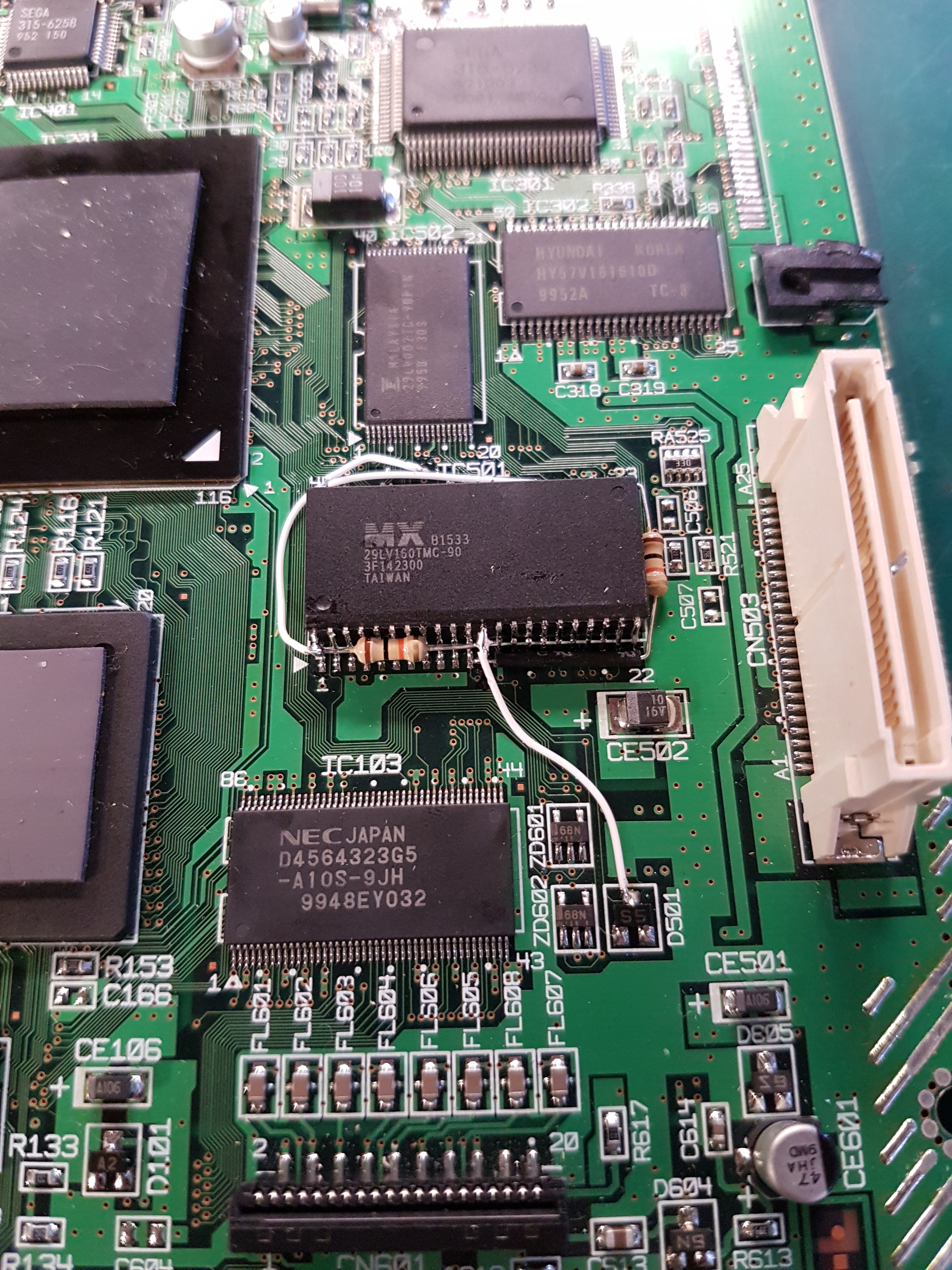

Started off with disassembling the unit, removing the Network adapter port and installing A custom BIOS chip.
I set to always load from the custom bios (won’t need to run the original bios since we won’t have the disk drive.)

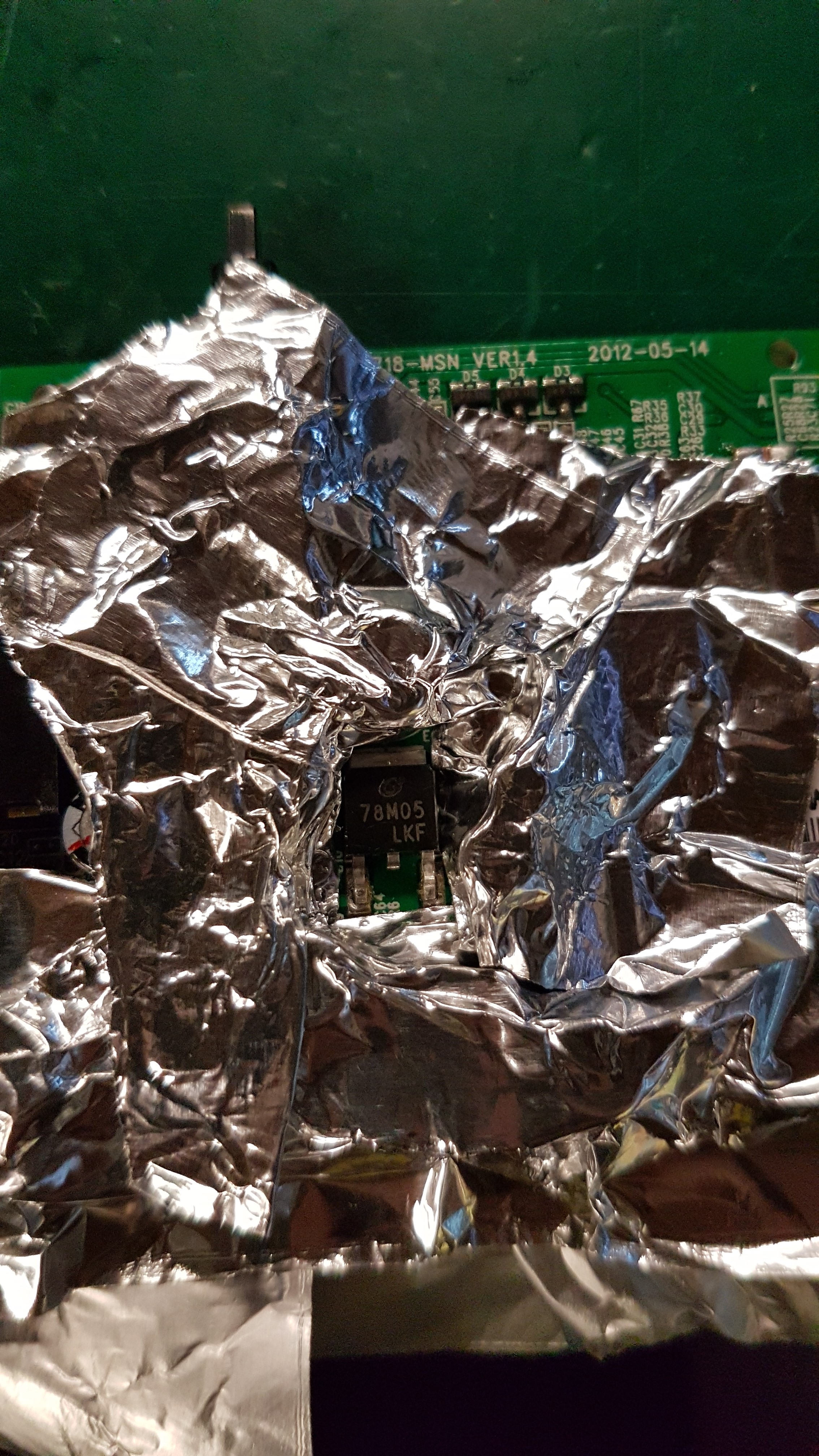

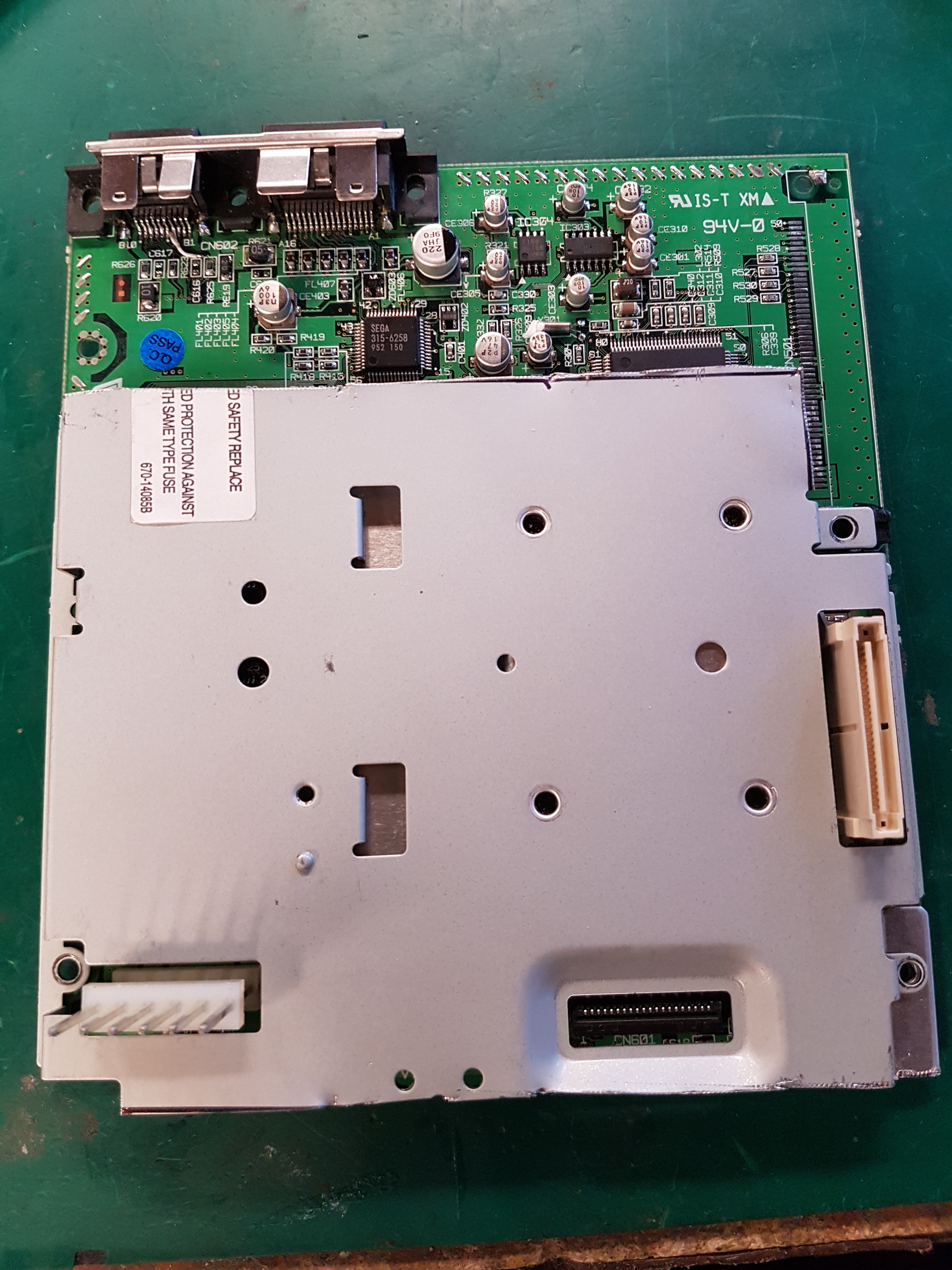

I trimmed the top metal sheet to have more room. I have it set so I can use the original heatsink with the sheet, haven't thought of a better way to have the heatsink yet so I figured this will do for now. Its thin enough but it add some extra weight.

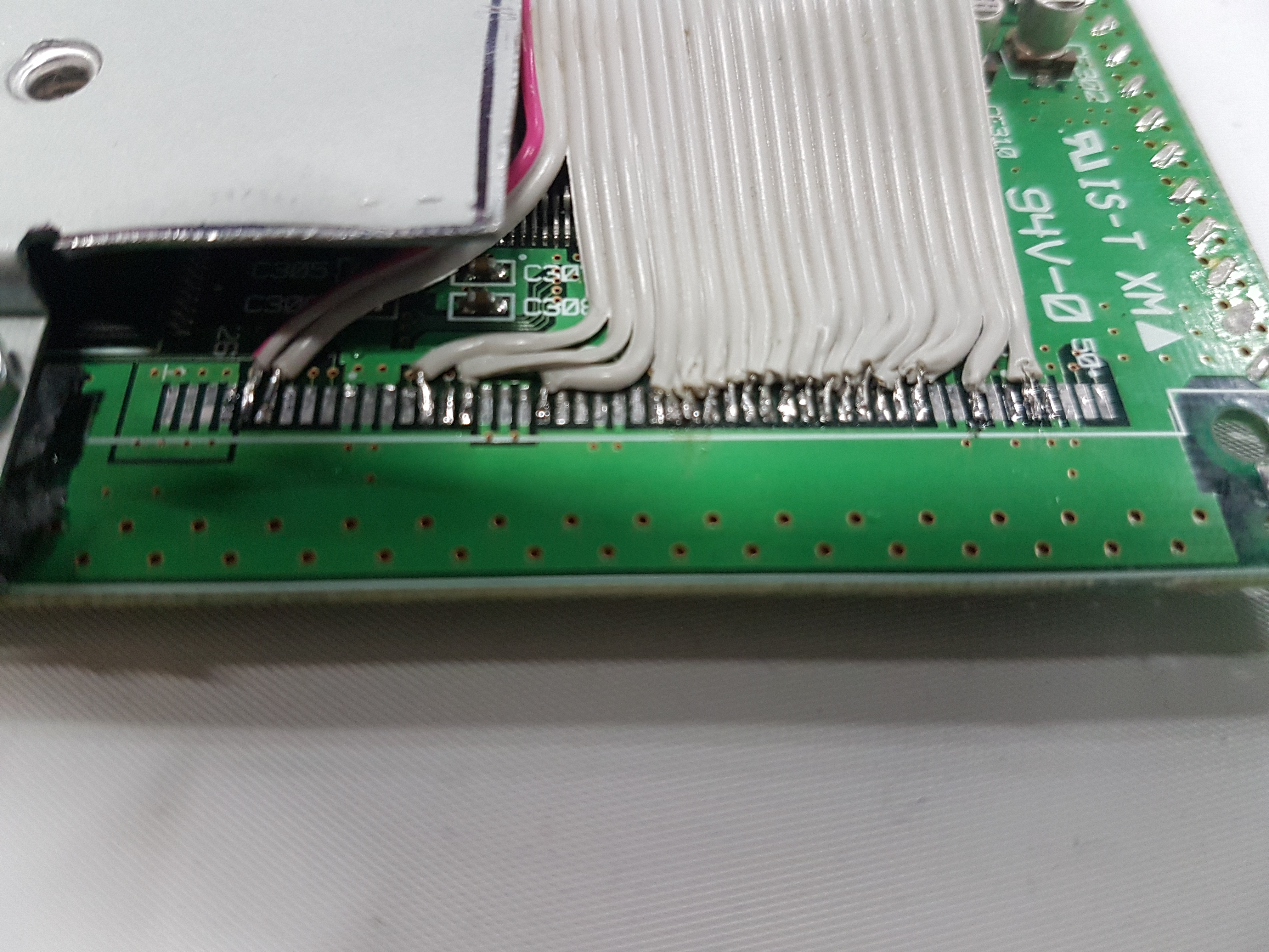

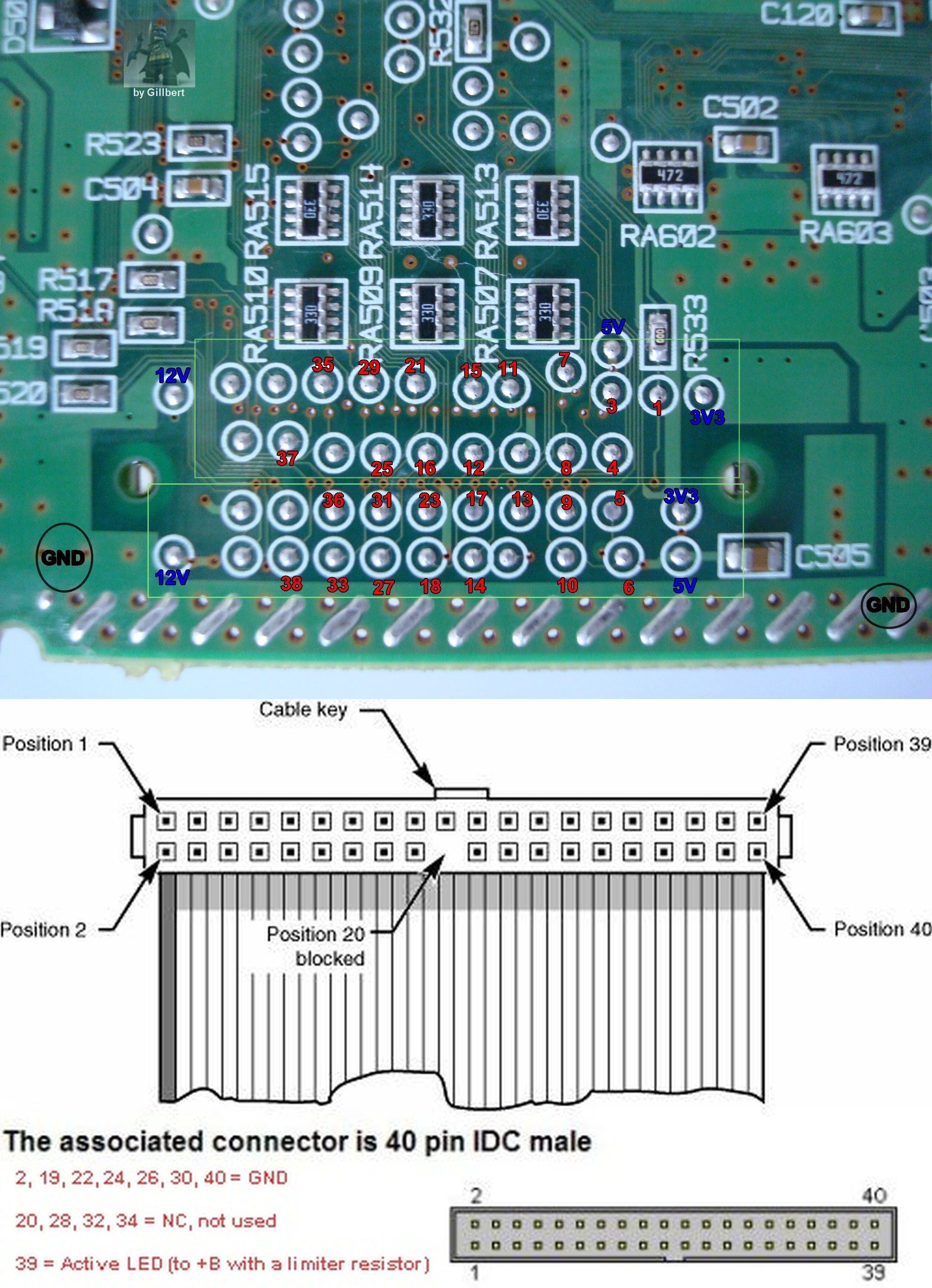

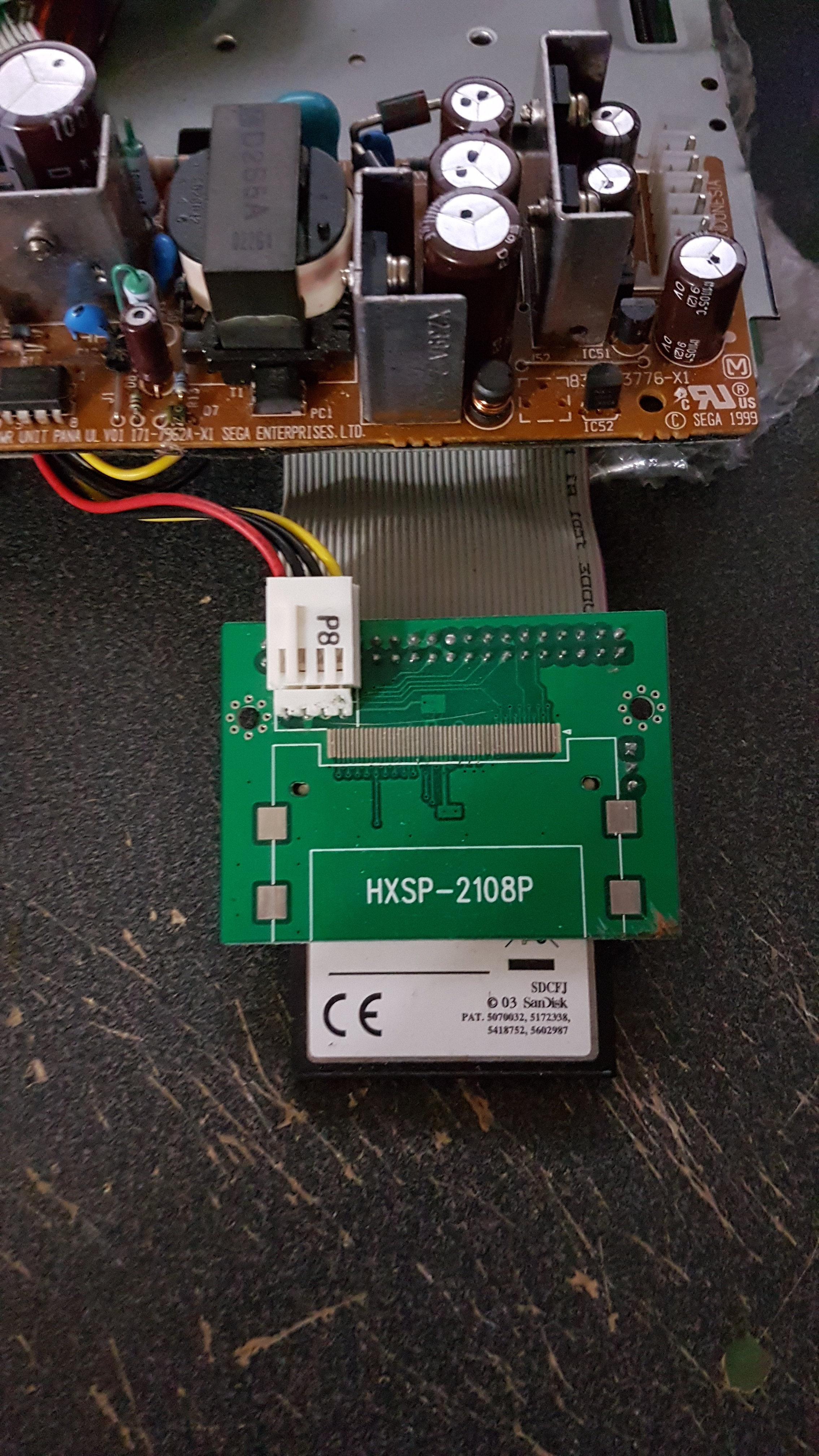

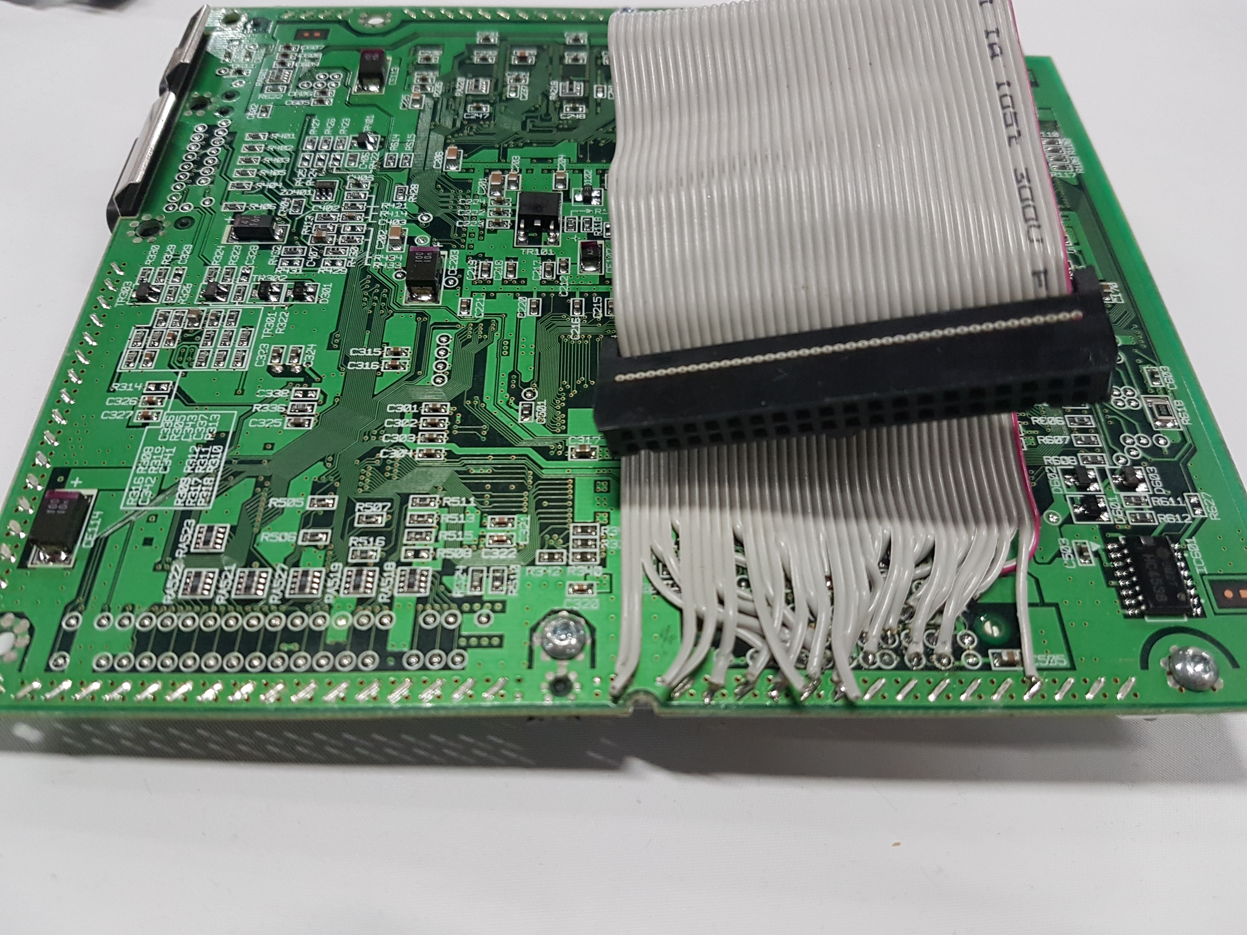

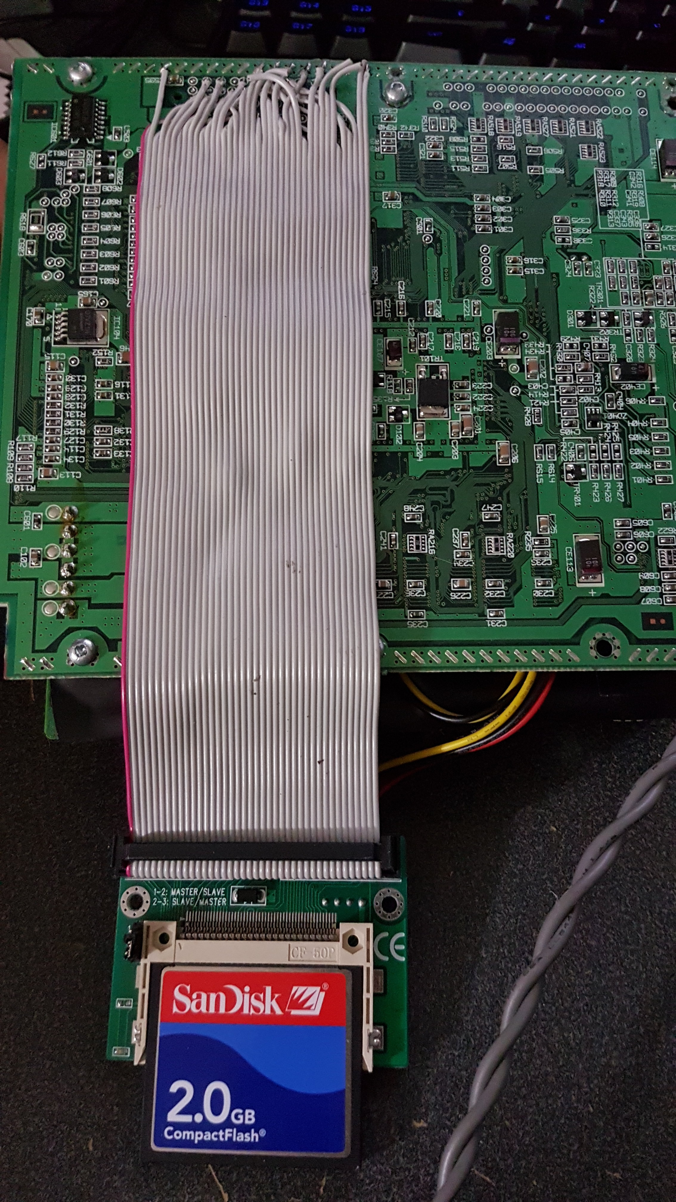

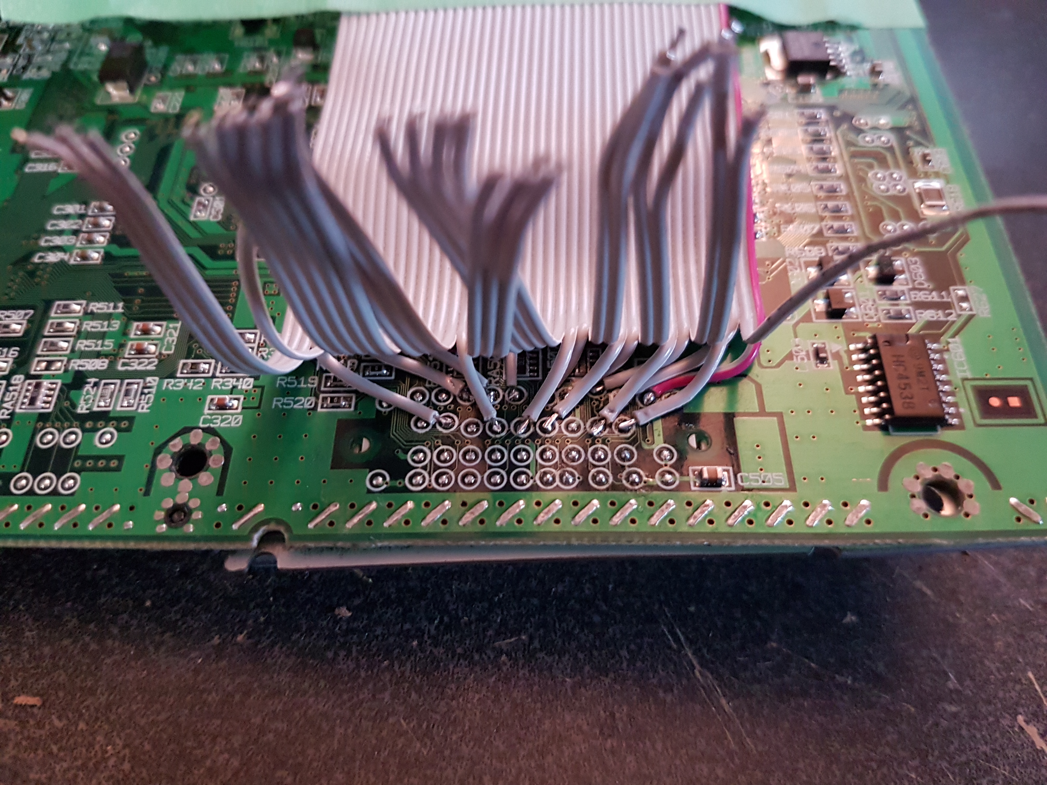

I soldered the IDE cable to the board. I left the plug on the end so that I can easily take it apart for now.
Testing it out it works great, but it was here that I realized you cant run it without the GD ROM (CD Drive) installed. Though I really should have used it with a 3.5" drive cable, the CF card reader I got for that size requires 5v of power and I think a 2.5" can use 3.3v. Ill have to look into it more later and see about ordering a replacement.

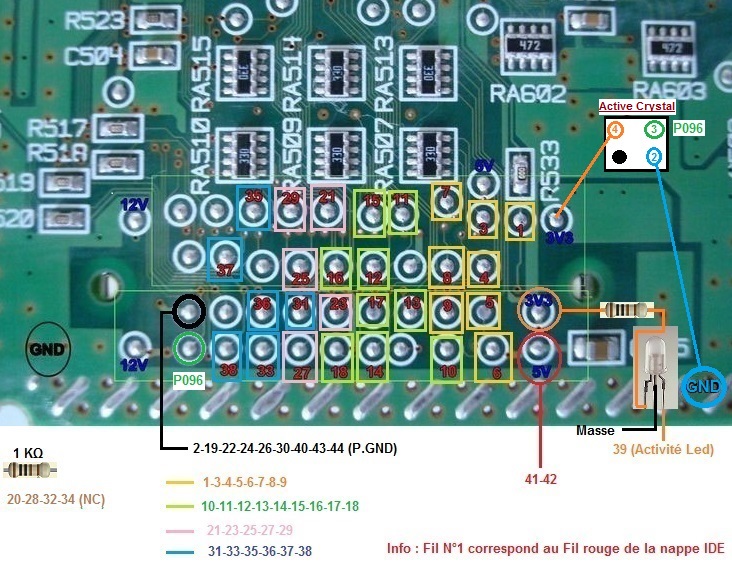

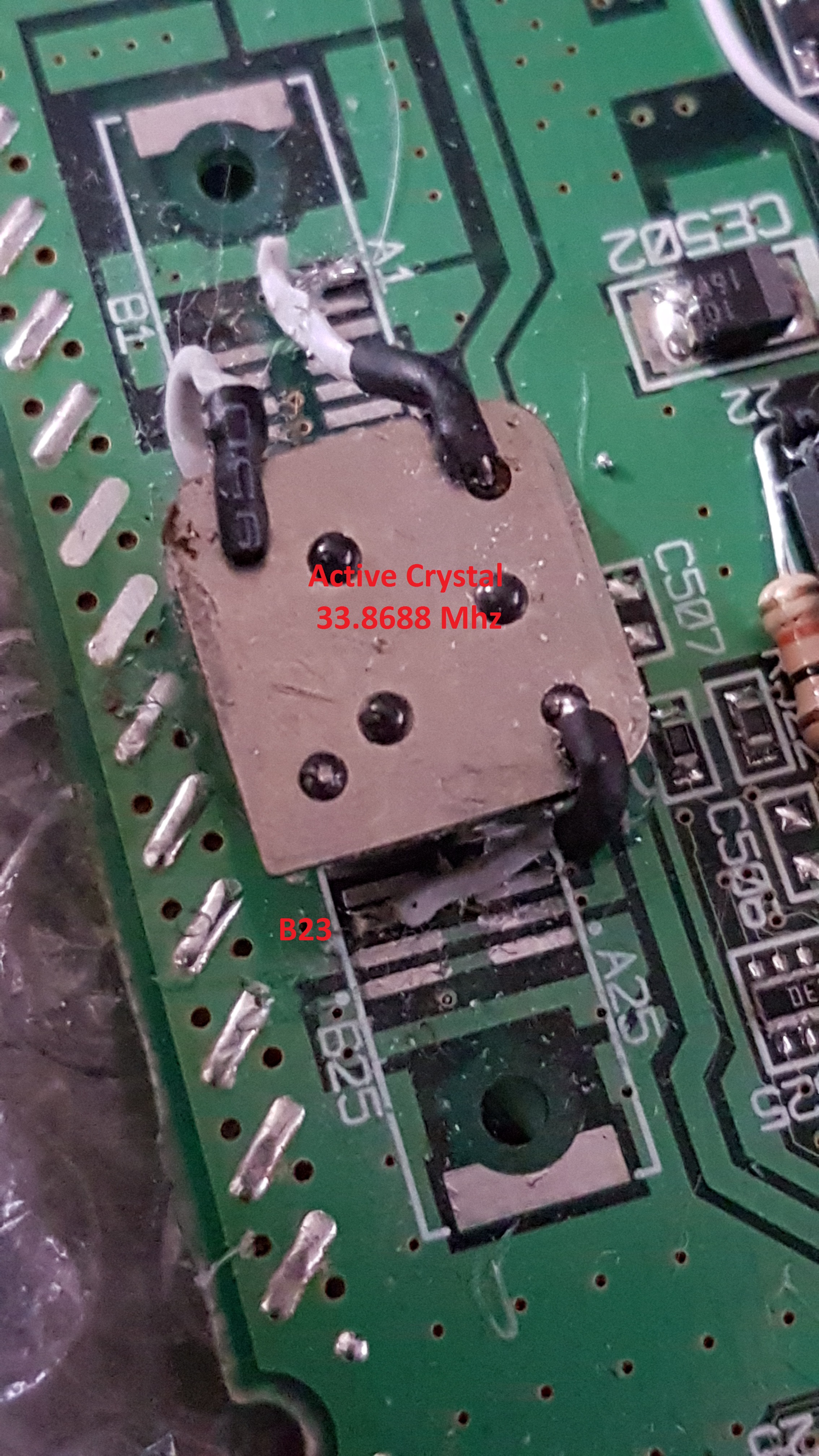

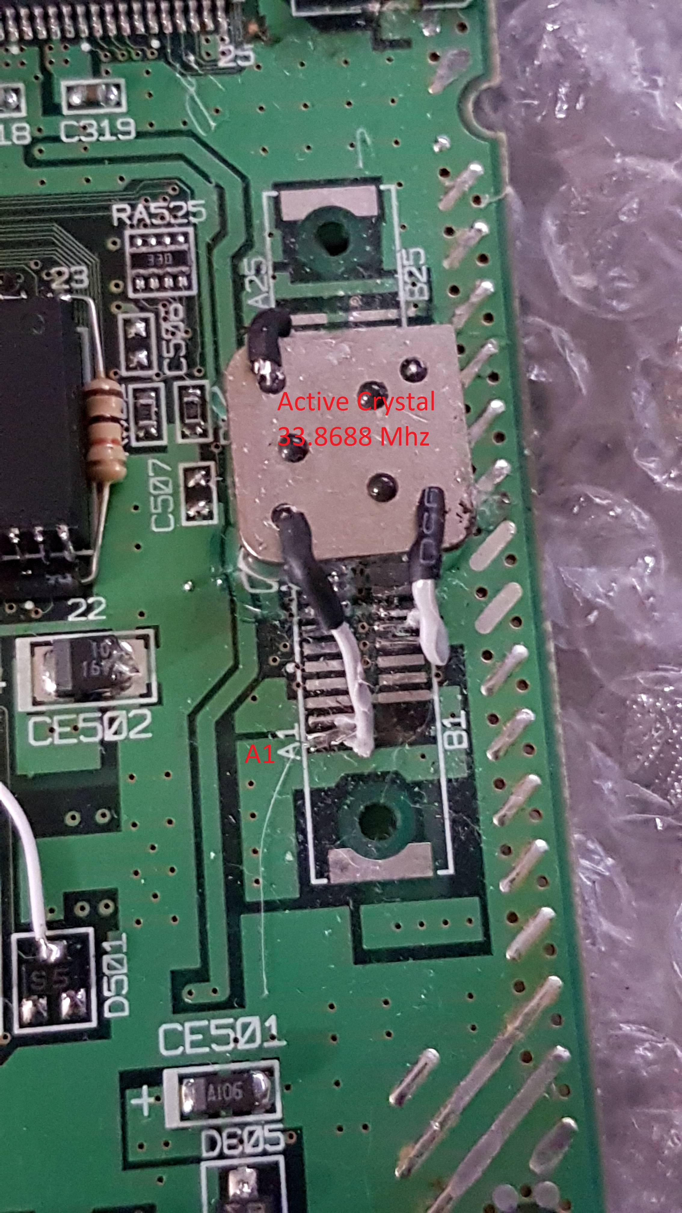

This is also where I realized you can't run it without the GD ROM installed. There is a work around using an Active Crystal Oscillator 33.8688 Mhz, but it was a pain in the butt. I couldn't find any online stores that would sell me just one crystal, so I had to buy 10.
I removed the GD Rom connector and hot glued the crystal where it use to be and soldered the connections to the spots the connector was.
2 to B8 (or any ground)
3 to B23 (P096)
4 to A1 (3.3v)

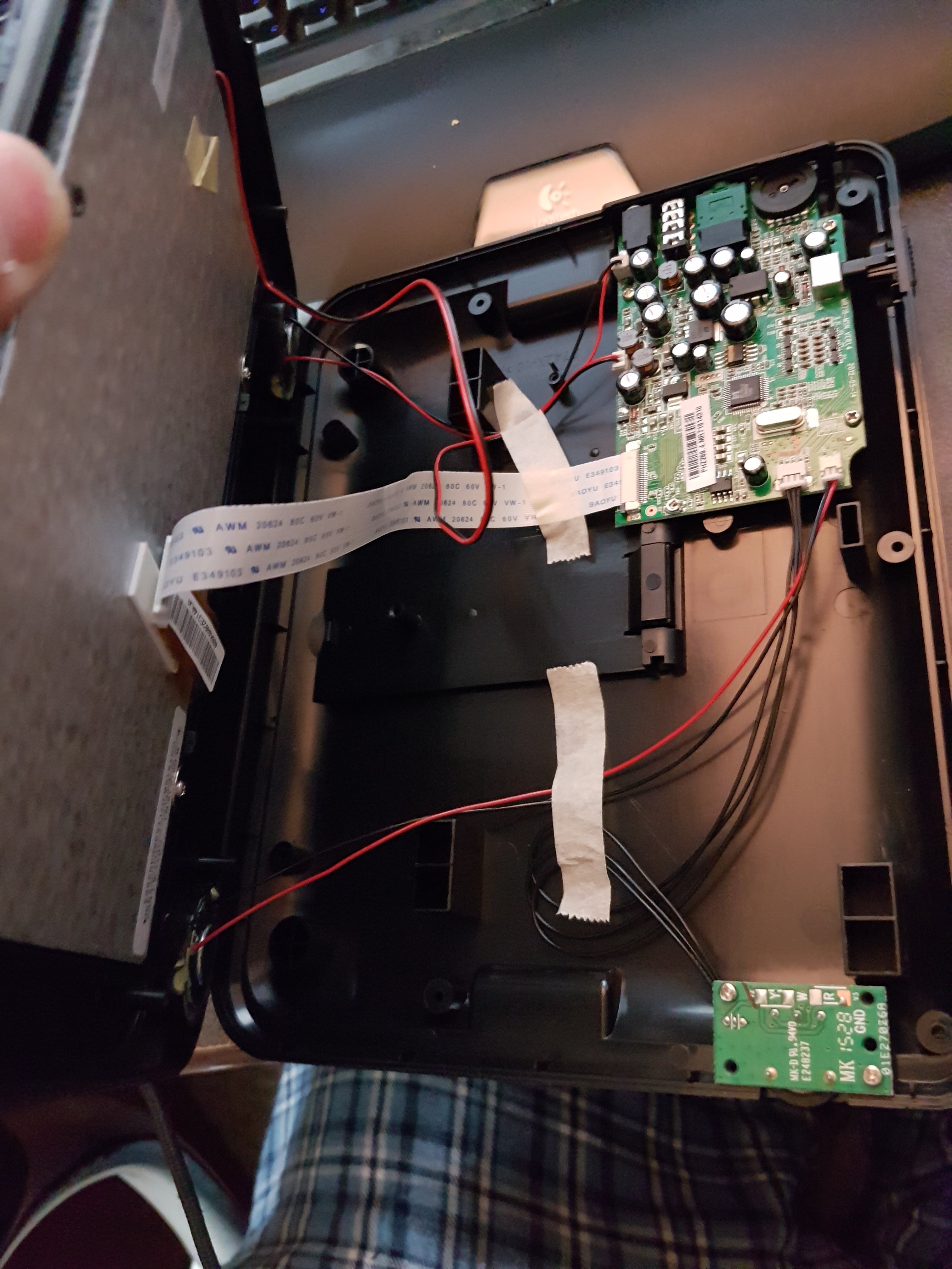

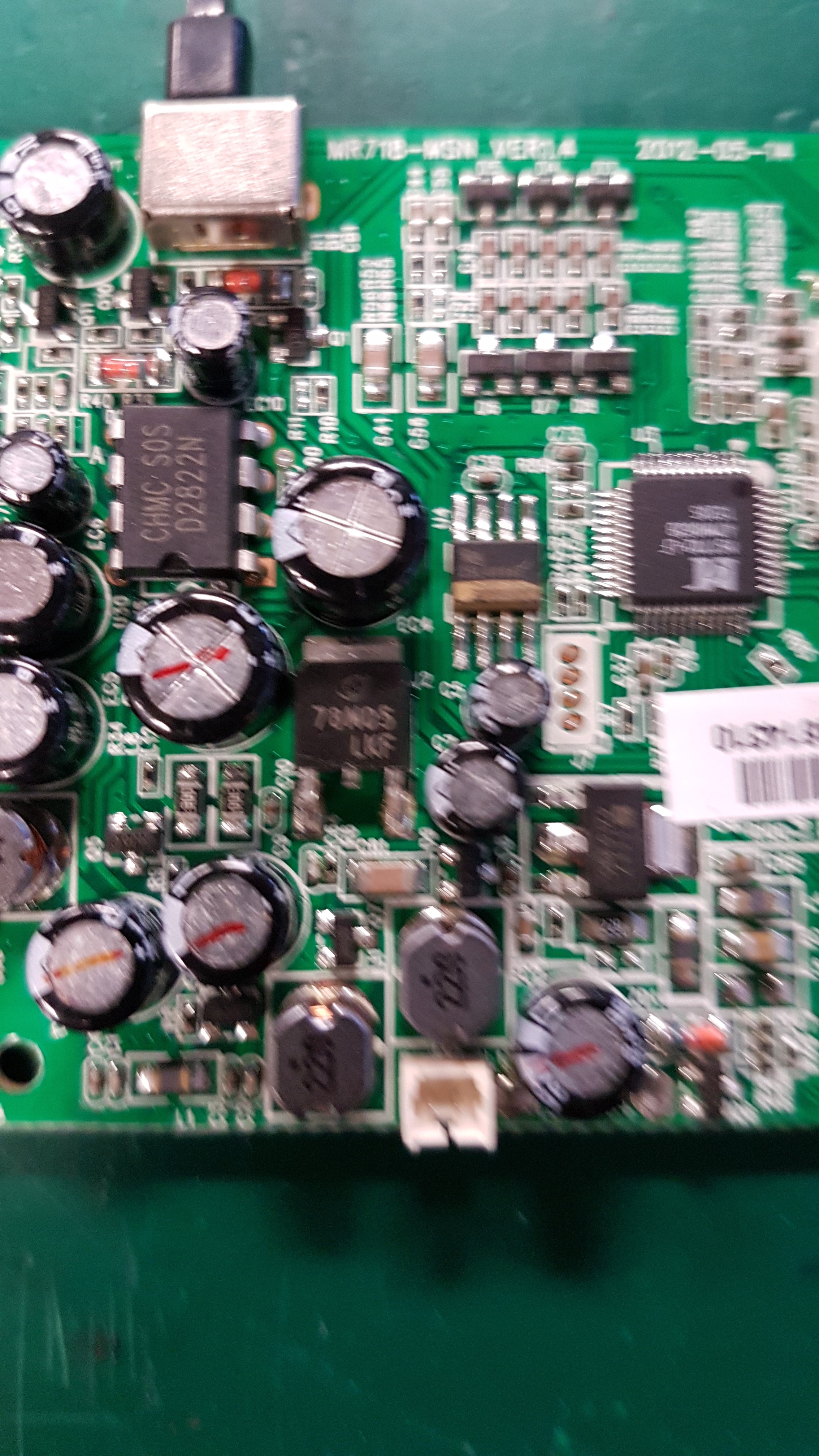

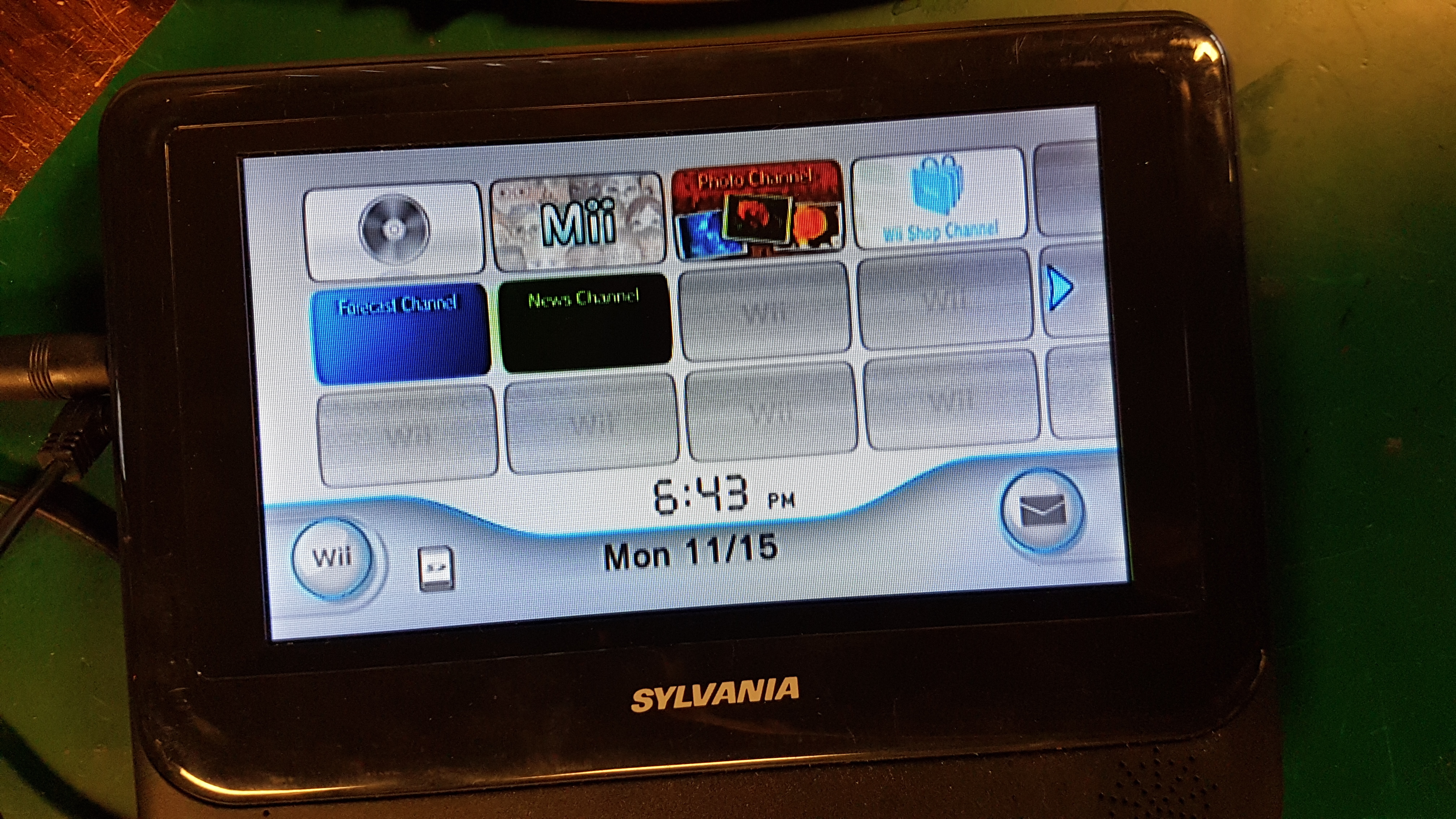

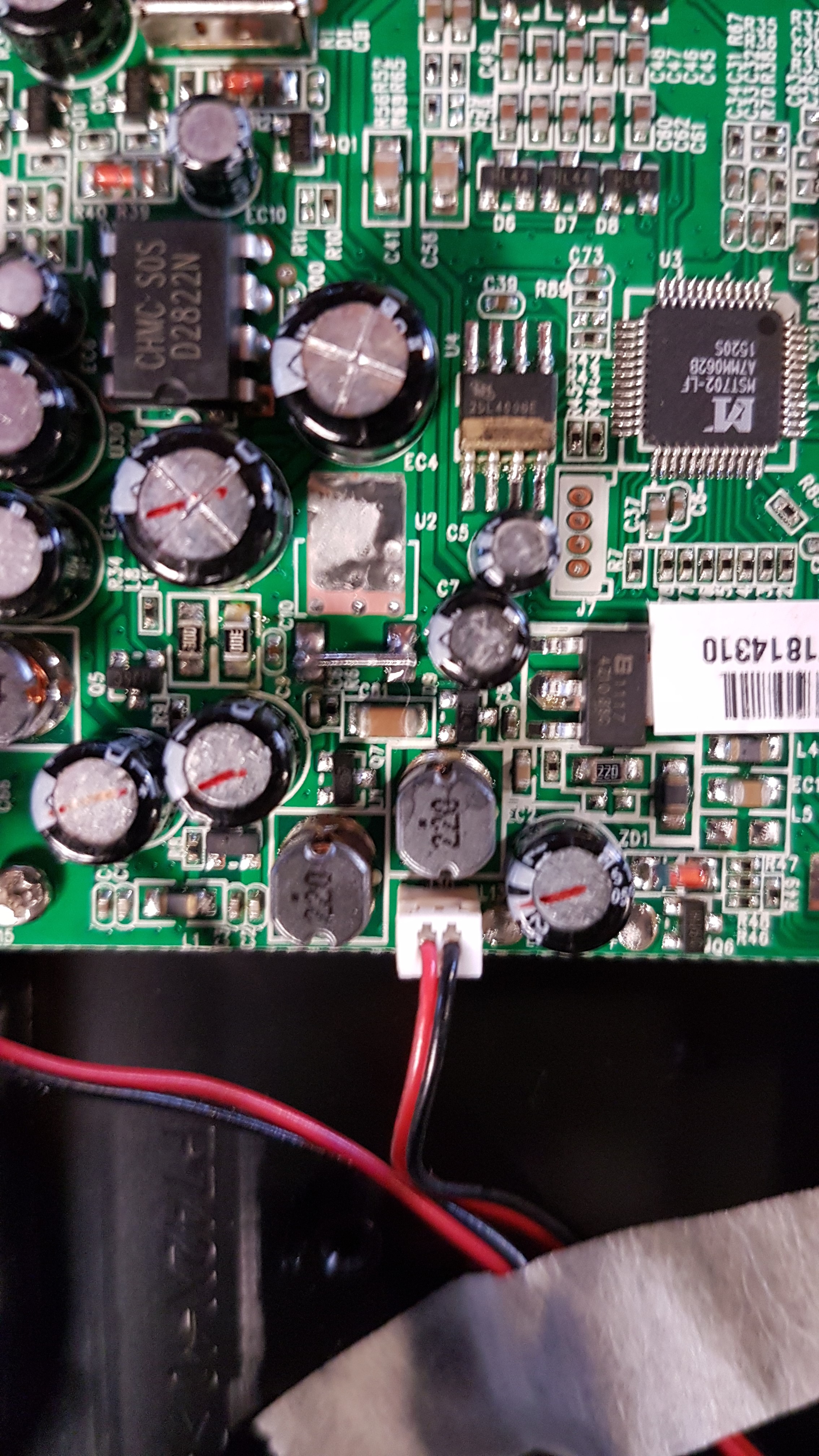

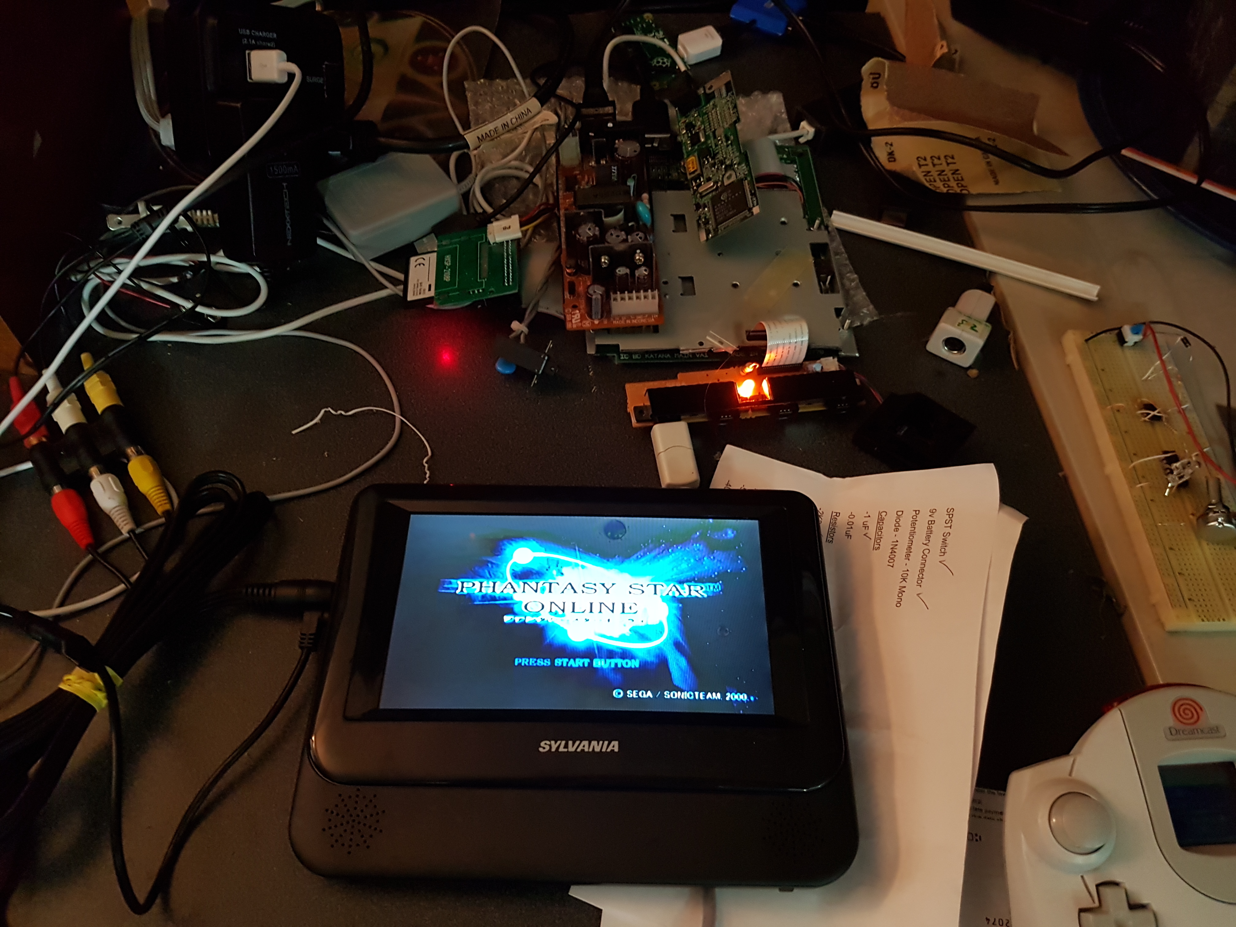

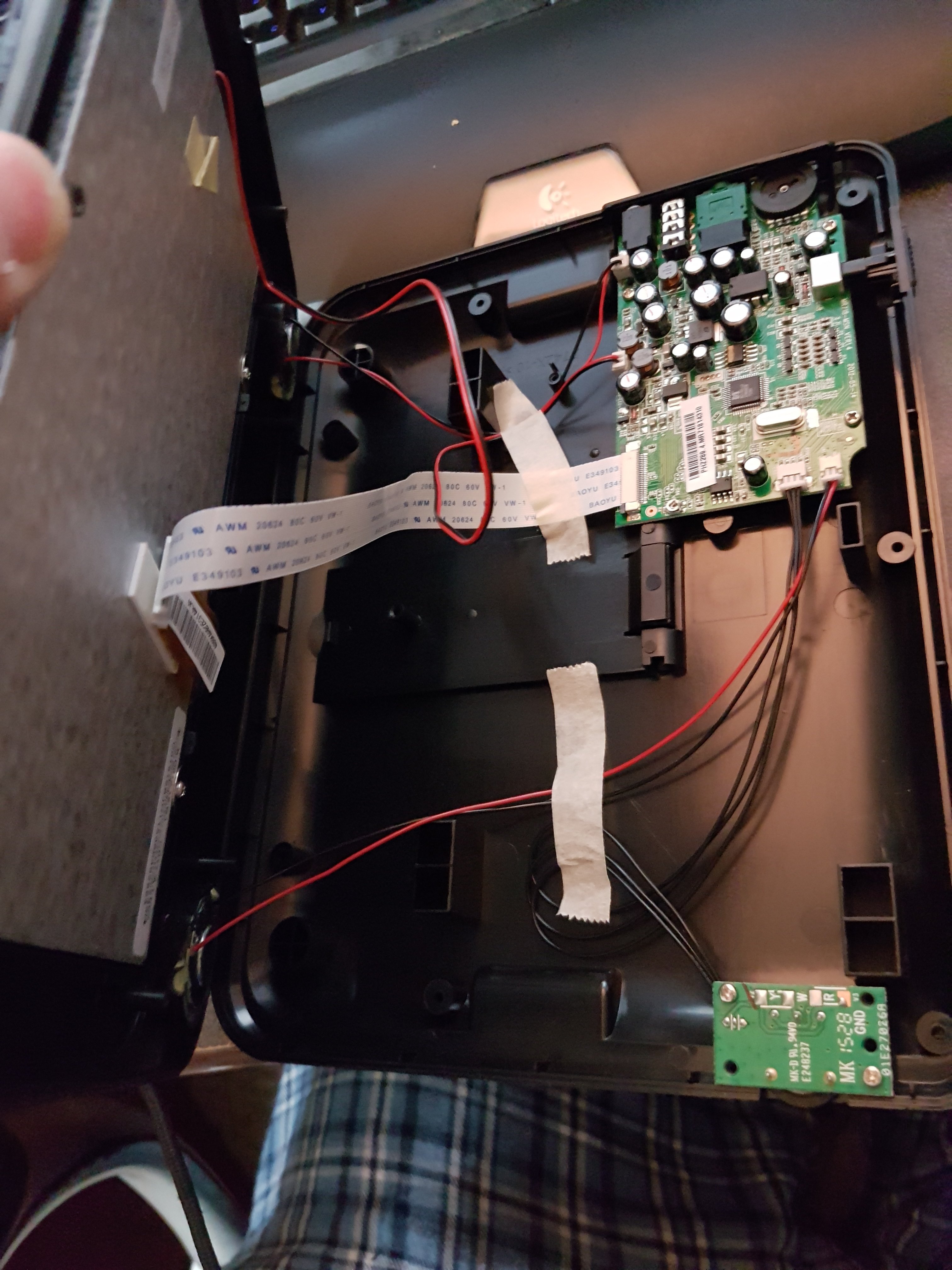

I got super lucky find at a thrift shop. A 7" screen with Audio amp and speakers all in one, but the down side is that it uses composite. But it's a great find for only $10
At first I was thinking of making the case look like a huge DreamCast controller. But I haven't done any 3D modeling before so I'm thinking I might go with something simpler.
Though any idea's on a case would be great!
Looks nearly identical to the screen I have for my project.
Mine seems to run fine down to around 6v.
View attachment 2513 View attachment 2514
I have the same screen, i got it to run off of 5V
https://bitbuilt.net/forums/index.php?threads/can-i-take-this-off-of-my-monitor-board.1333/

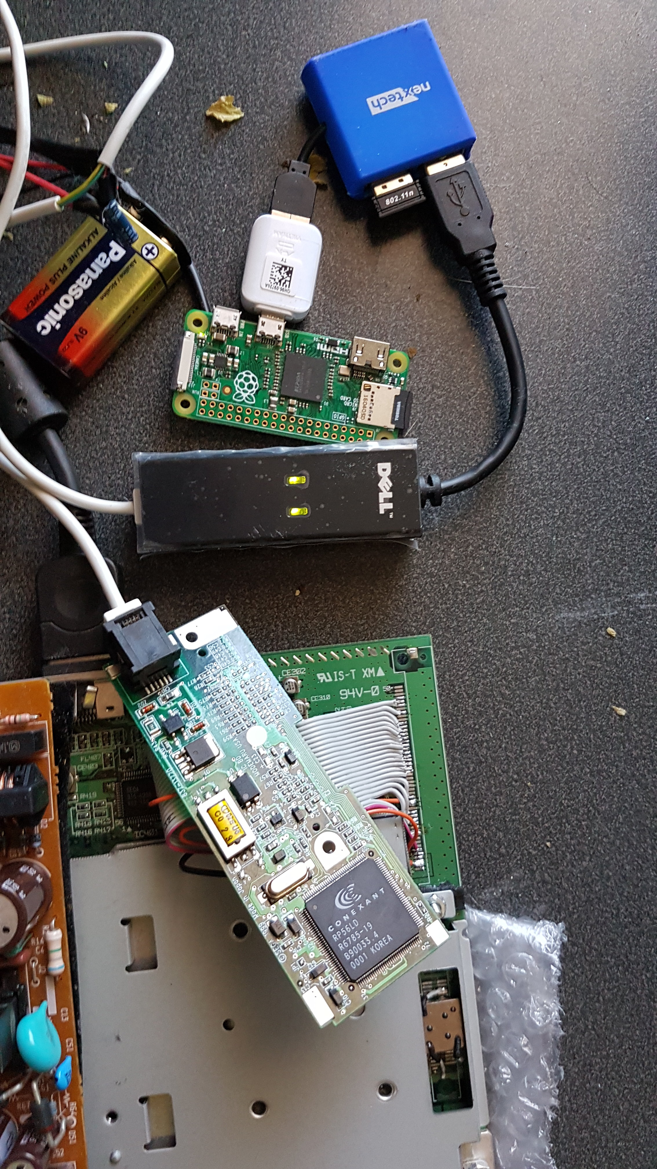

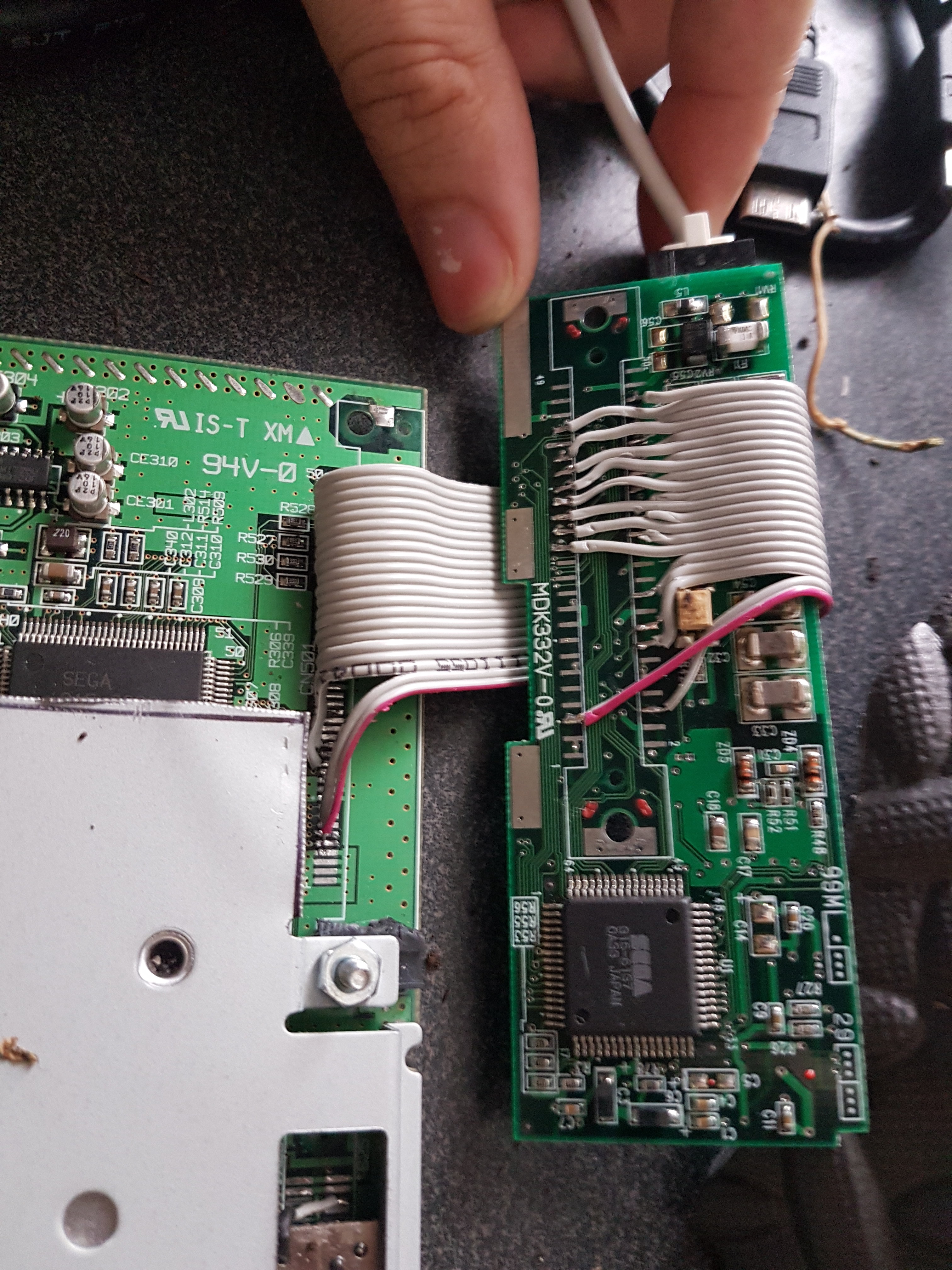

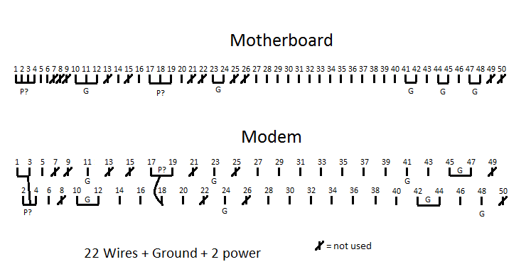

I reattached the modem to the motherboard using some more IDE cables. I gave myself plenty of length so I can position it whatever way might be best.
I made myself a quick pinout so I know what connections are for power and ground and what ones I can ignore.
(lol. these pictures I forgot to connect the Power and Ground wires)

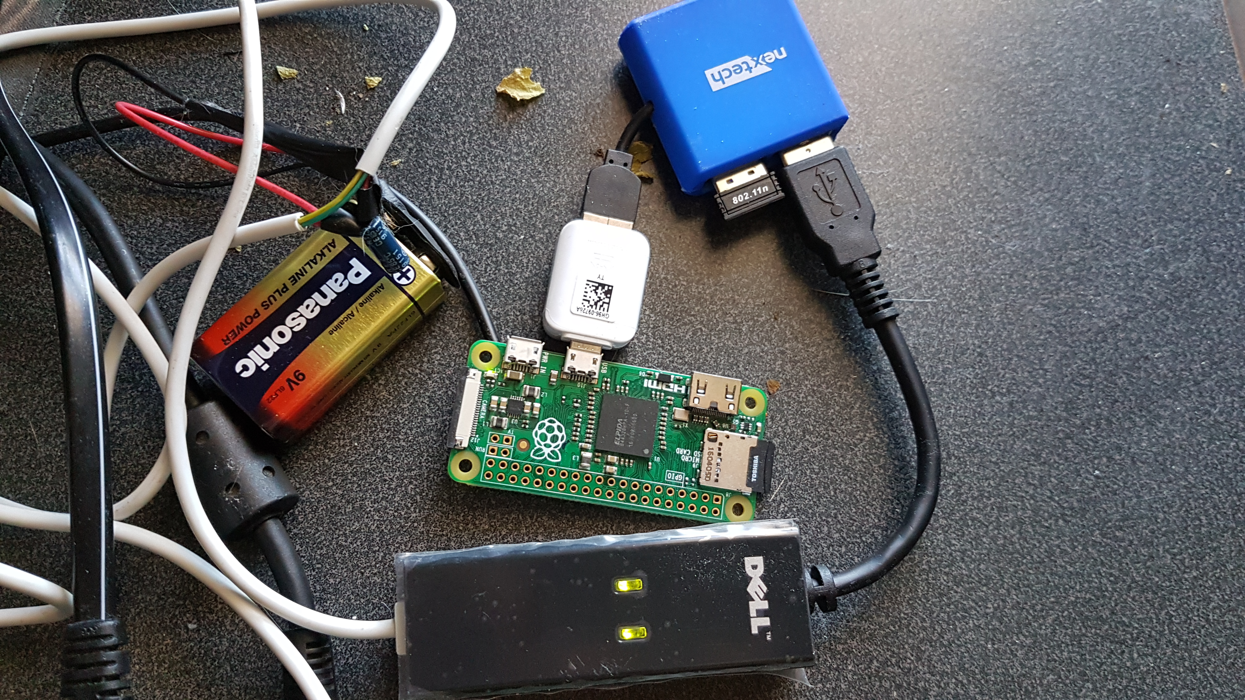

For connecting to the internet I'm using a Pi Zero running DreamPi http://blog.kazade.co.uk/p/dreampi.html
with a USB wifi card and a USB Modem. The connection between the modem's needs a line voltage inducer in order for it to connect properly, which needs an extra 9V of power. I plan to have an extra switch so I can turn on anf off the Pi and modem so I don't use up too much power.

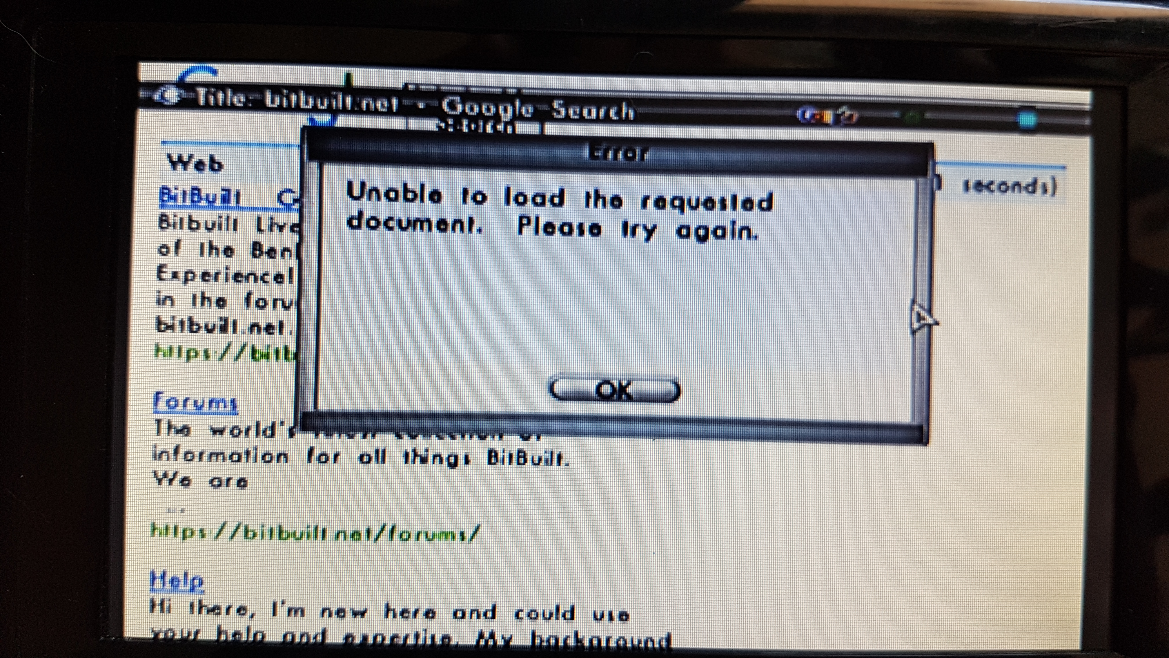

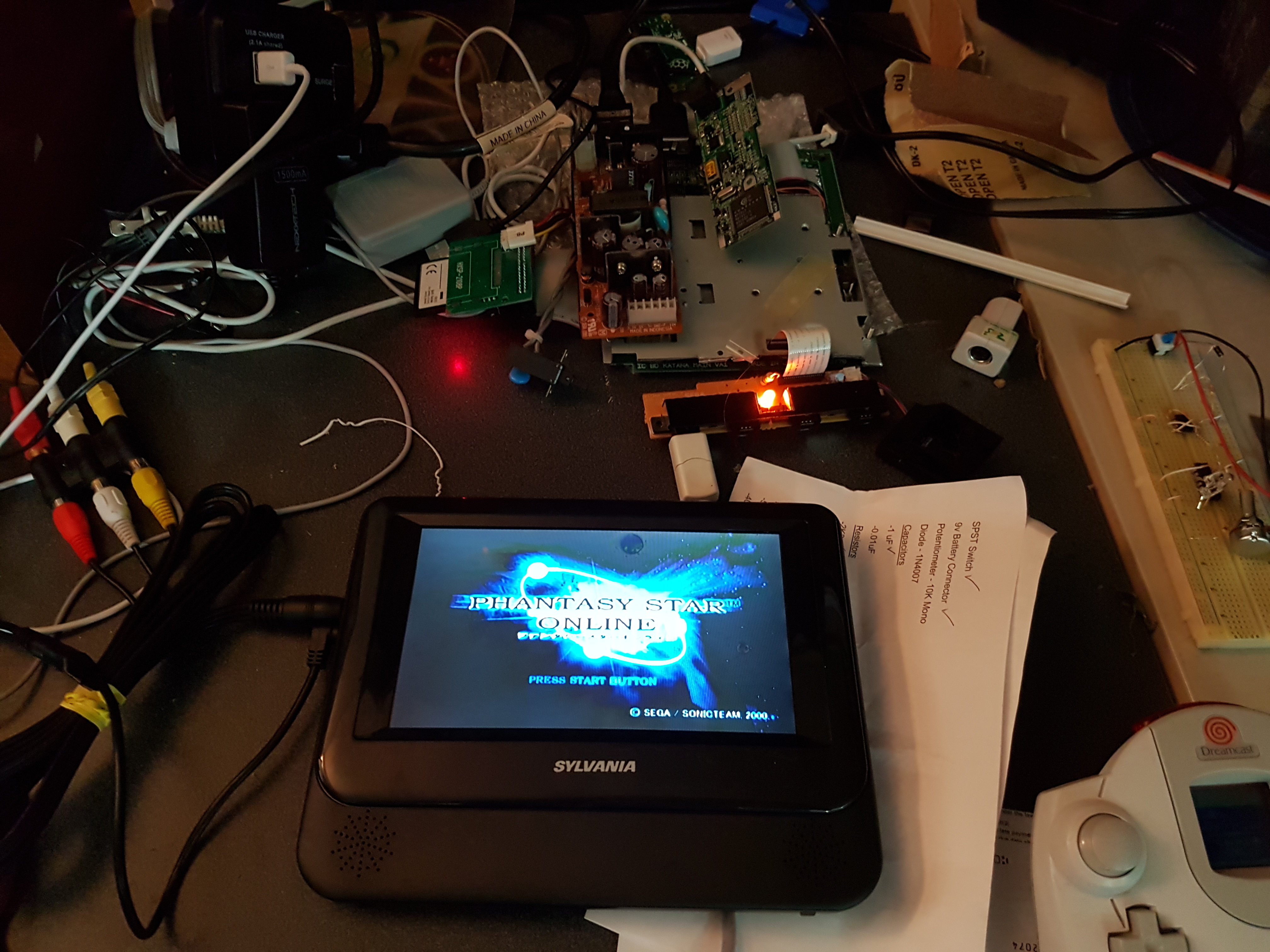

Got it all connecting and working on the internet. It wouldn't allow me to connect to the Bit Built forum, and I need to find a version of PSO2 that will auto connect me to a custom server

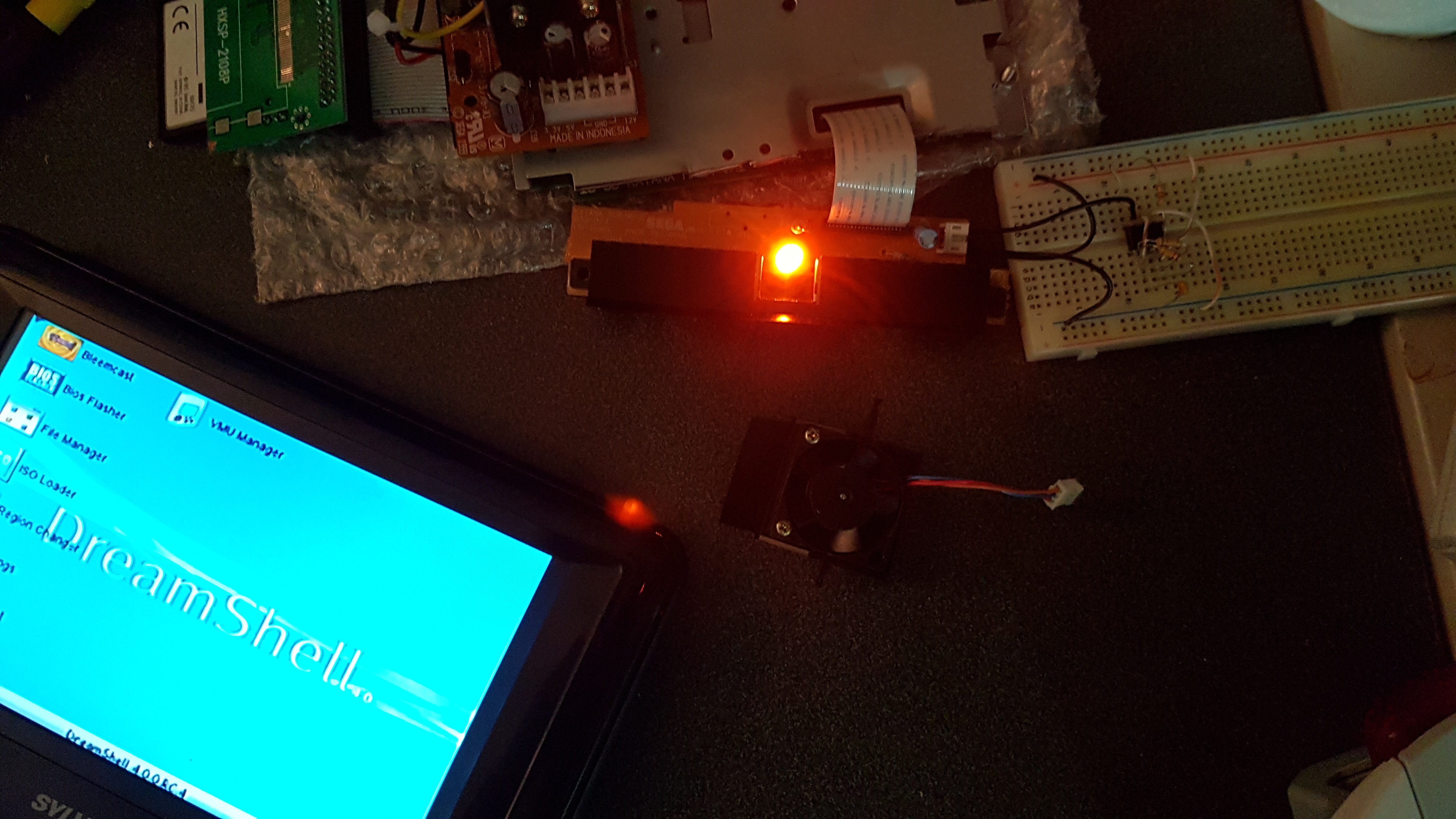

A different 3-wire fan should work but I can't confirm personally.
Or here's a good tutorial on using a small 555 timer IC to replicate the signal https://www.google.cl/url?sa=t&source=web&rct=j&url=http://randomprojectman.blogspot.com/2008/05/even-though-its-pretty-dated-system-i.html?m=1&ved=0ahUKEwi8ppauw_XTAhXLEJAKHUXVBDAQFggcMAA&usg=AFQjCNH_Smzl1d5CLs__HLtGipl84VcALQ&sig2=HNXMbEUk4E4w5eycjAihnQ
Then you can use any fan (or none at all).
I went ahead and gave this a shot and got it working without the fan.
just need to solder it down to a proper board.
One thing that was wrong with the guide is that it said that "the orange pin is connected to pin 5"but its actually suposto be connected to pin 3
