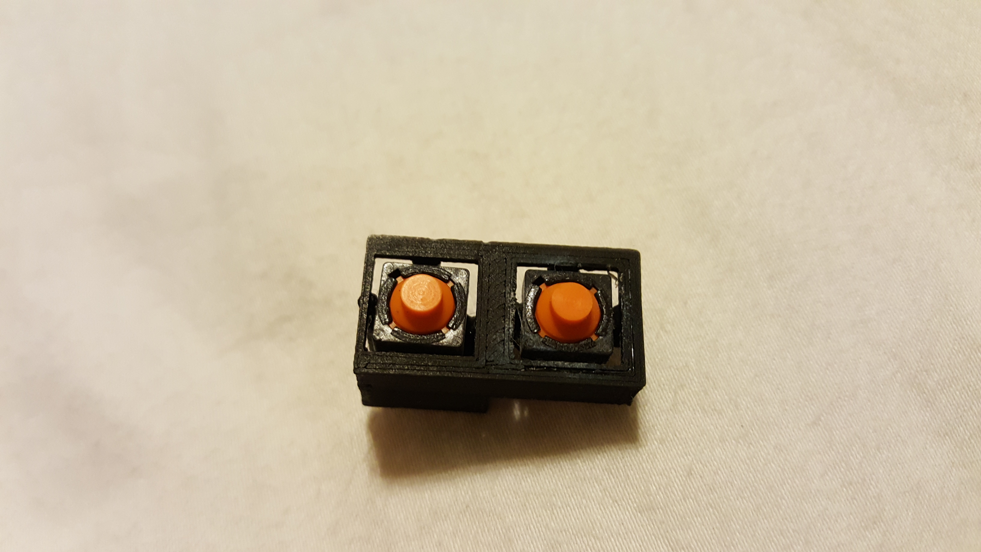

I made some brackets to hold two tact switches together for double tact modding L and R buttons. There are two versions so far: the regular bracket, and the same thing only with a flat base on one side for mounting. Both are included in the .zip, as well as the STLs. This way you don't have to worry about them coming apart. It is still recommended that you glue them together so they can't wiggle at all.
The whole thing measures 13mm cubed, including the protruding squishy tact. The measurements of the tact switches I used are:
squishy tact: can be found in the portablizing BOM
hard tact: 6 x 6 x 5mm
Feel free to use these as you want. If you make a better version, please consider posting it here.

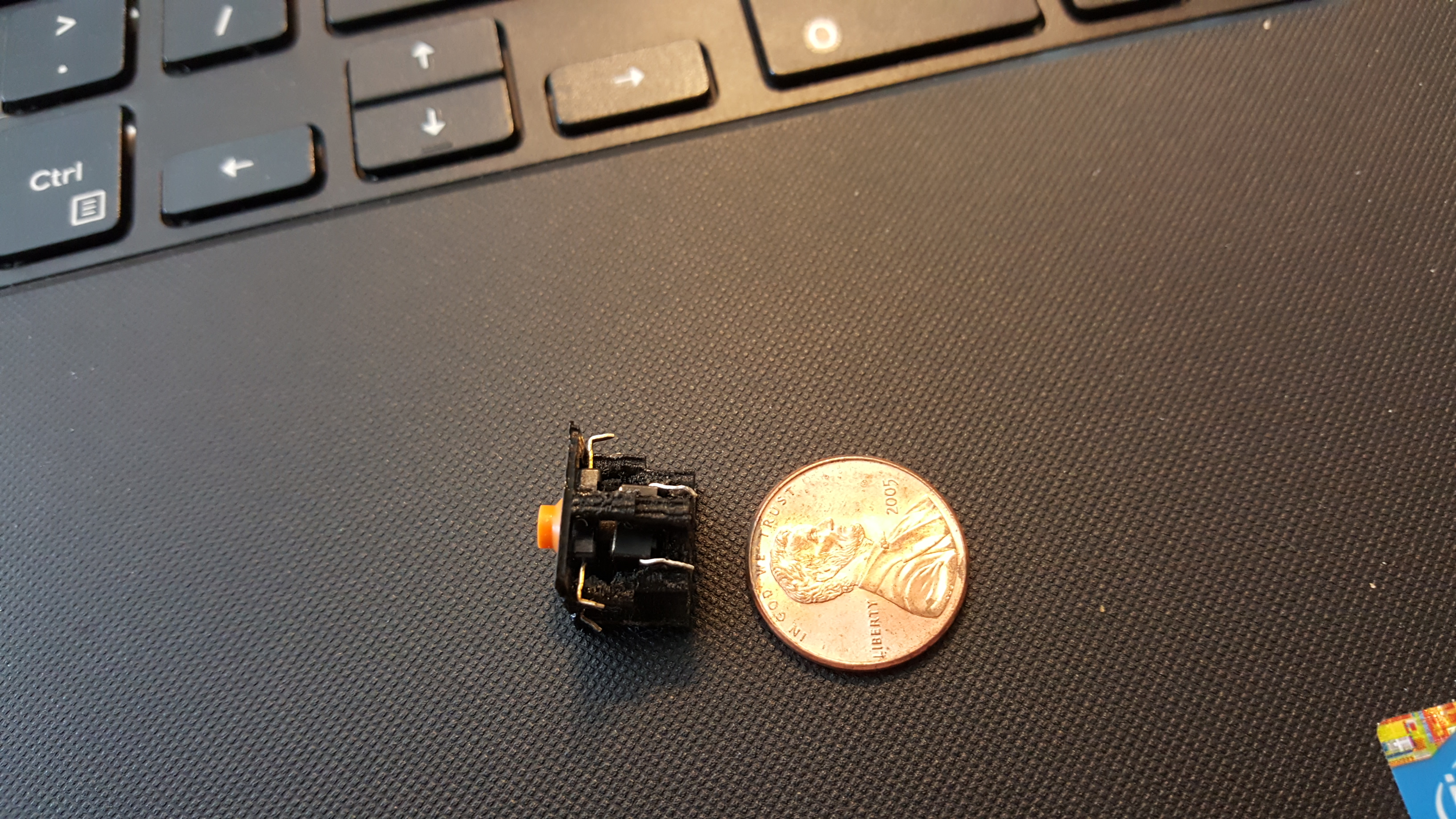

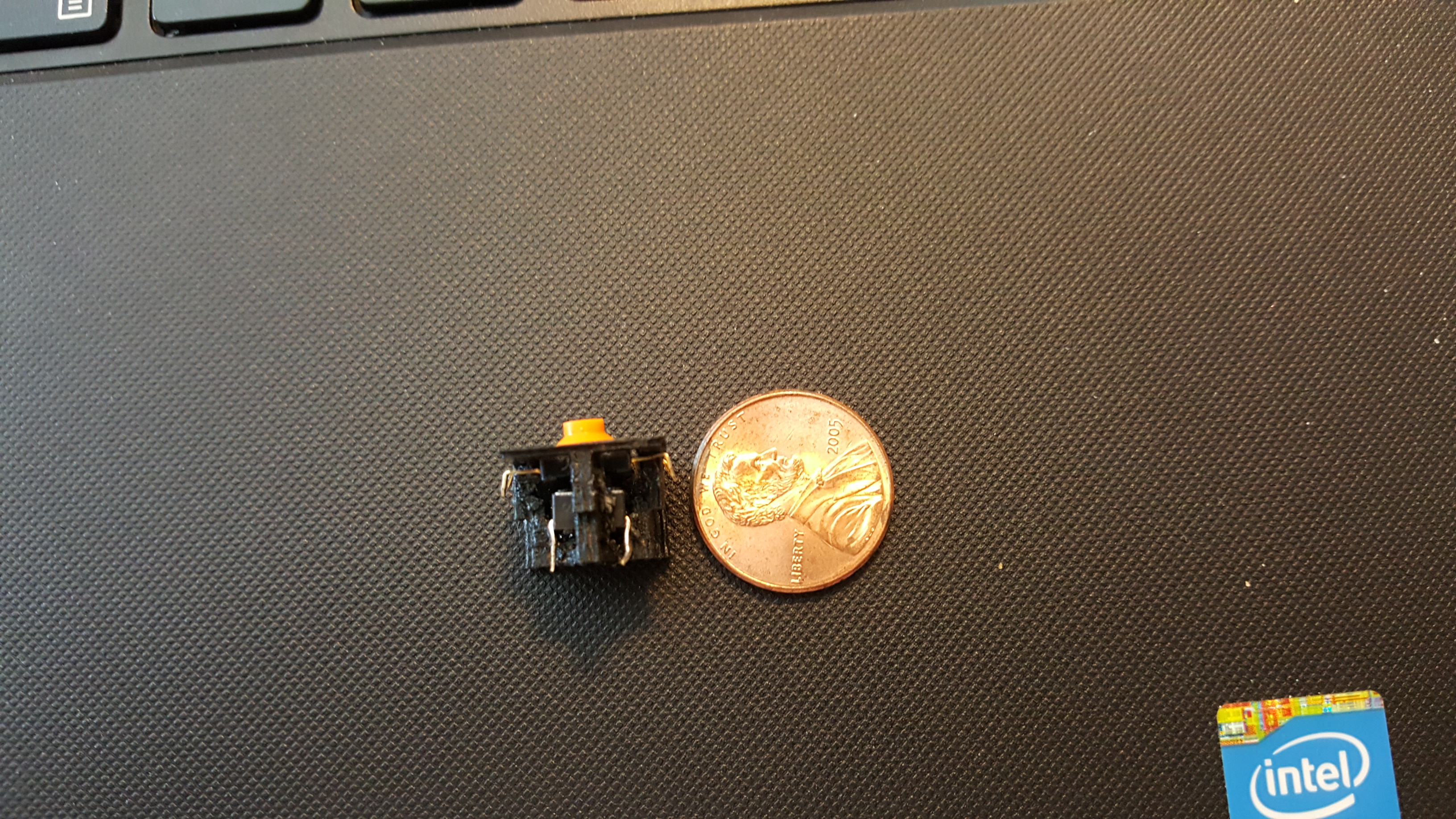

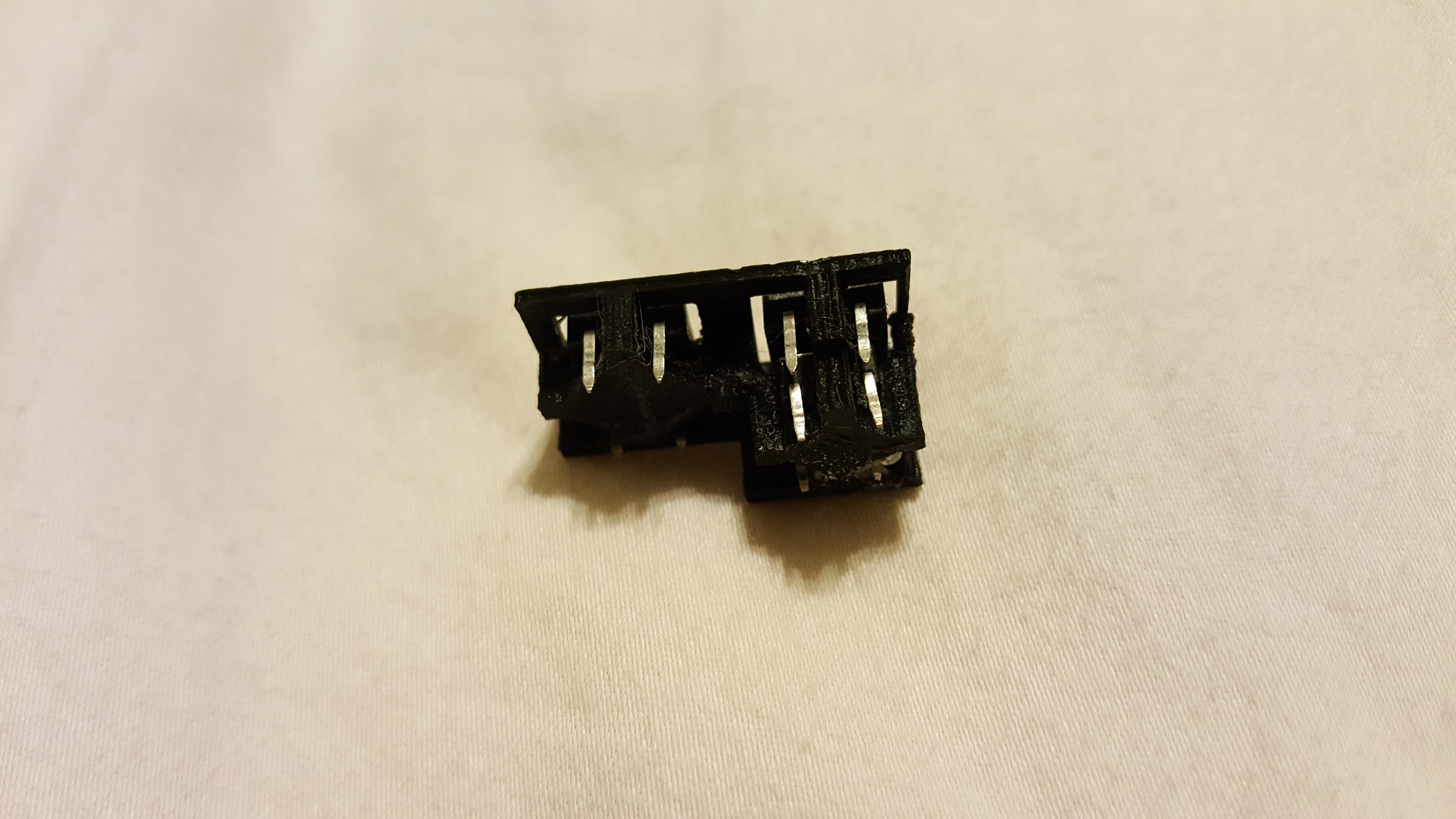

I made a quick print for a faceplate for the USB assembly found in Wii consoles. Normally I would just use the faceplate from the Wii shell and frankencase it in. Unfortunately, the Wii shell allows the USB to fall right through. It holds the USB ports in place and won't allow them to fall through. The faceplate measures 2cm x 2cm.

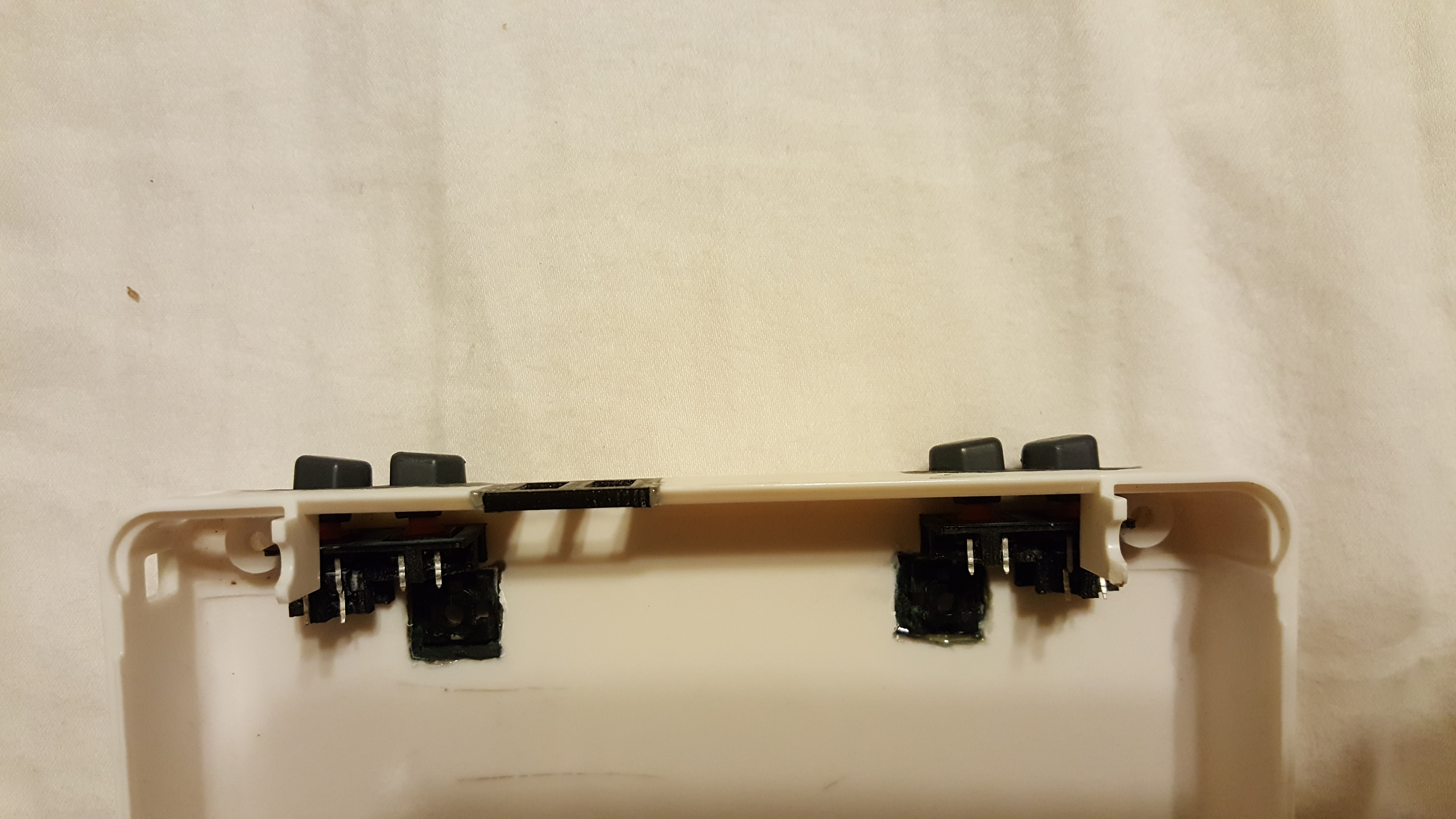

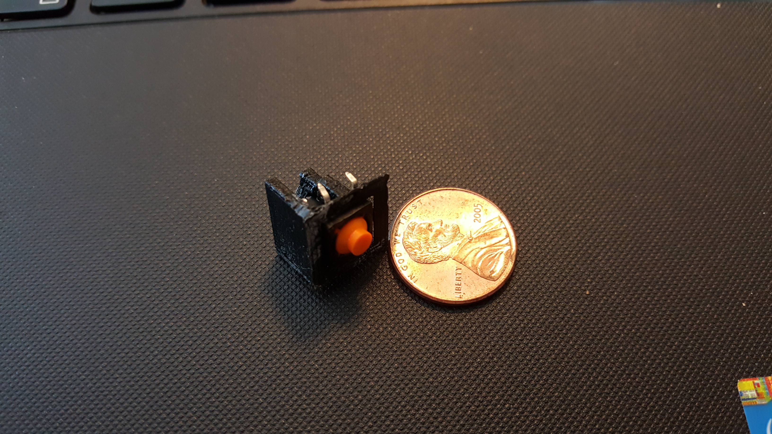

I made the final tact holders that I will be using, and have uploaded them here. However, there are a lot of revisions in between the original and these ones, so please feel free to ask if you want one a little bit different. The third button is meant to be a squishy tact.
