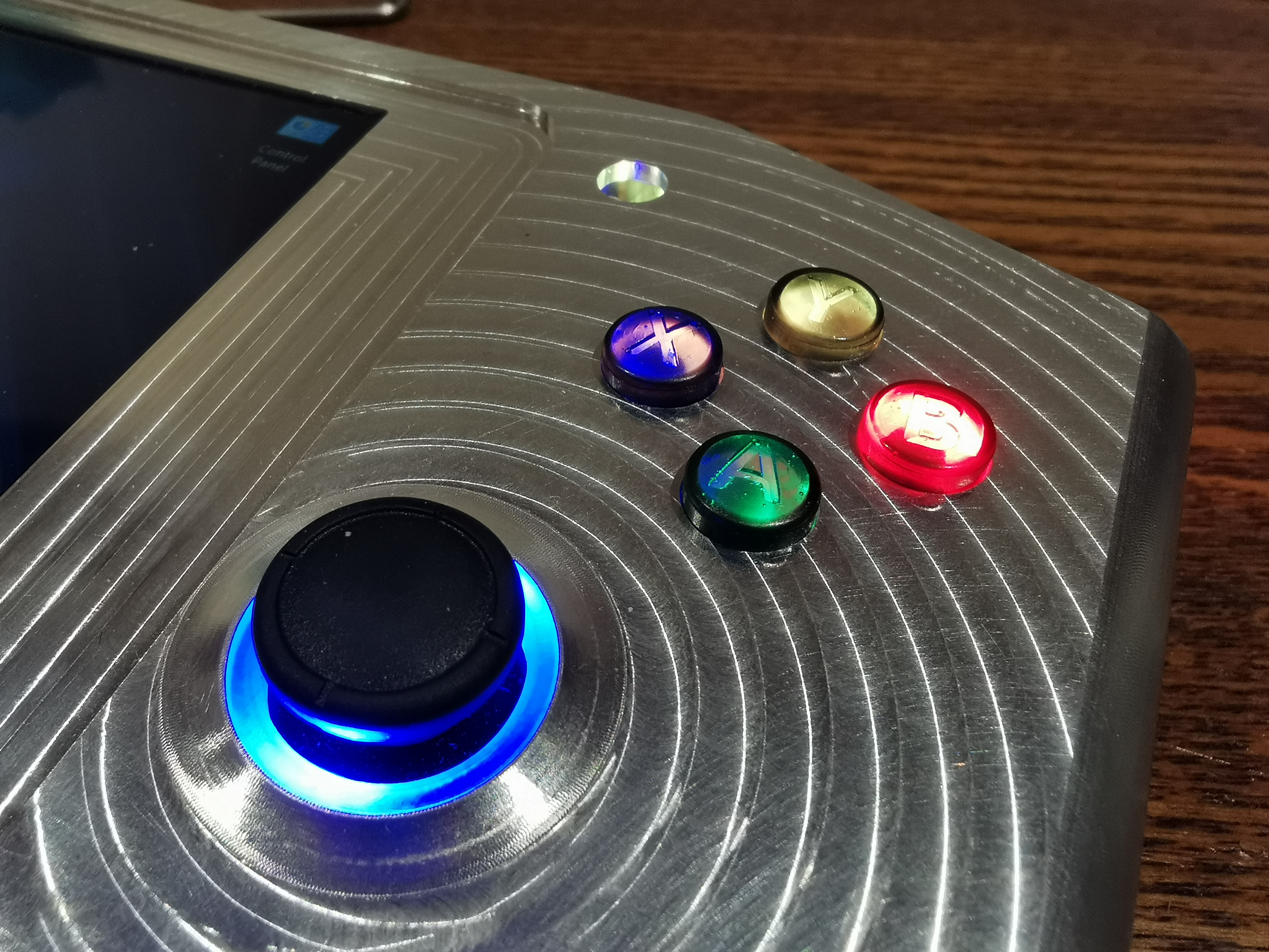

Okay so small update. First semi successful run of buttons. Not exactly what I had in mind but I don't hate them so they'll do for now.

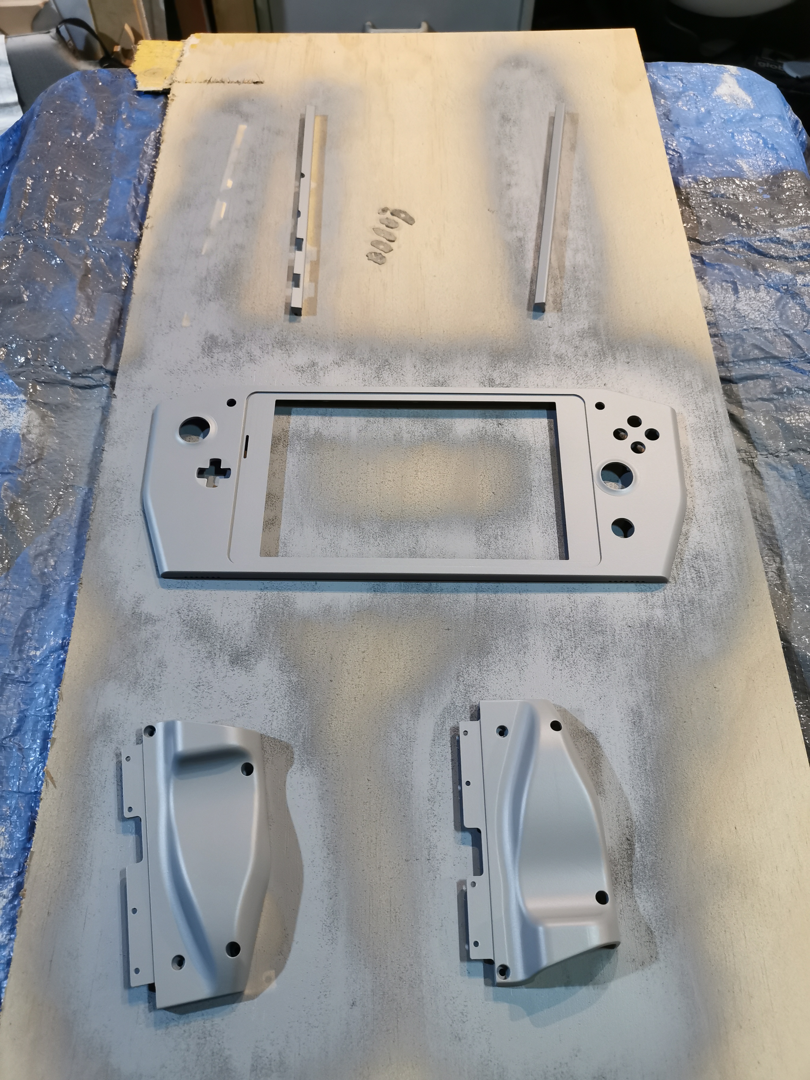

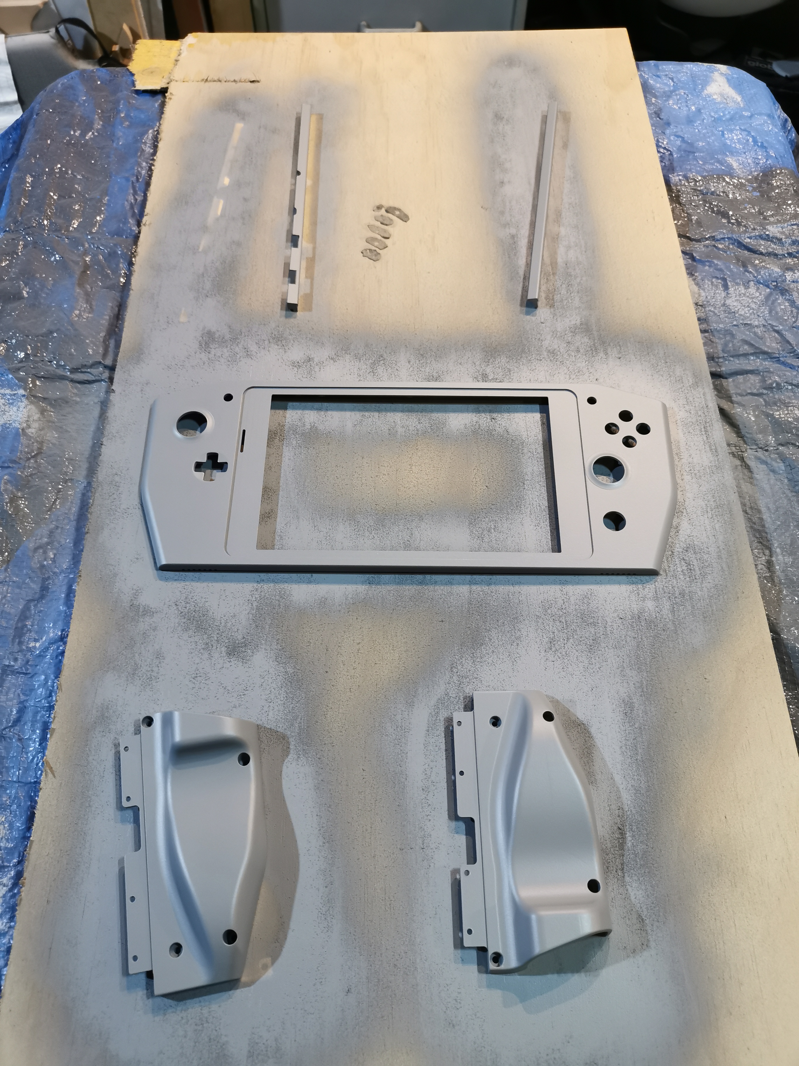

First few coats of metal primer applied and sanded. This is probably the final coat of primer before I move on to colour. Managed to fill up most of the bits I wasn't happy with and the finish is looking great so far! Didn't take much sanding to get a nice smooth surface.
Should be able to get some colour on tomorrow afternoon, as long as the temperature isn't too low for it. It's almost winter here and whilst it doesn't get really cold compared to a lot of other places, it is still too cold for painting by the time I get home from work some afternoons. Fingers crossed for a nice warm day tomorrow!

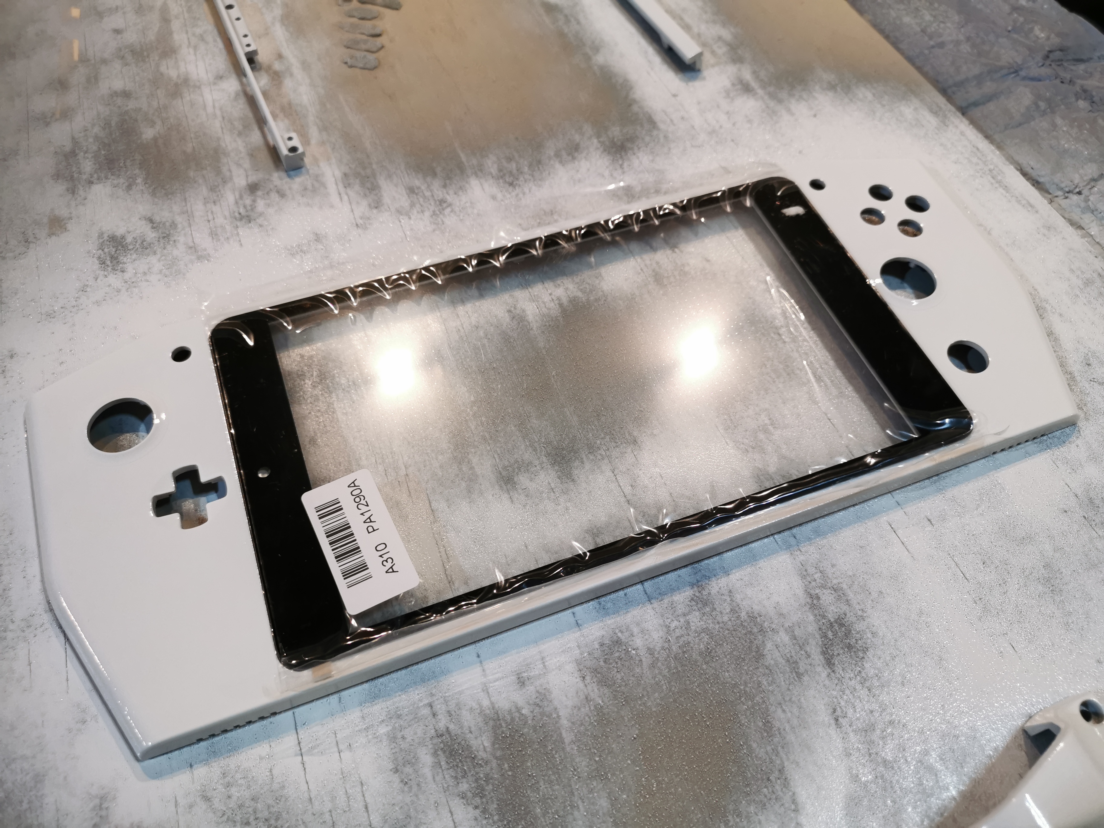

Got some white on this afternoon. Looking good, little bit of an "orange peel" effect in the paint at the moment, but should be able to get rid of that with some 2000 grit sand paper before I move on to the clear coat tomorrow. Also chucked the touch screen digitiser in to see how it looks in the white housing. Can't wait to peel that screen protector off when it's all finally done!
Will have to do something about the front camera cut out in the digitiser. Not sure what yet, but I'll try and make it as invisible as possible.

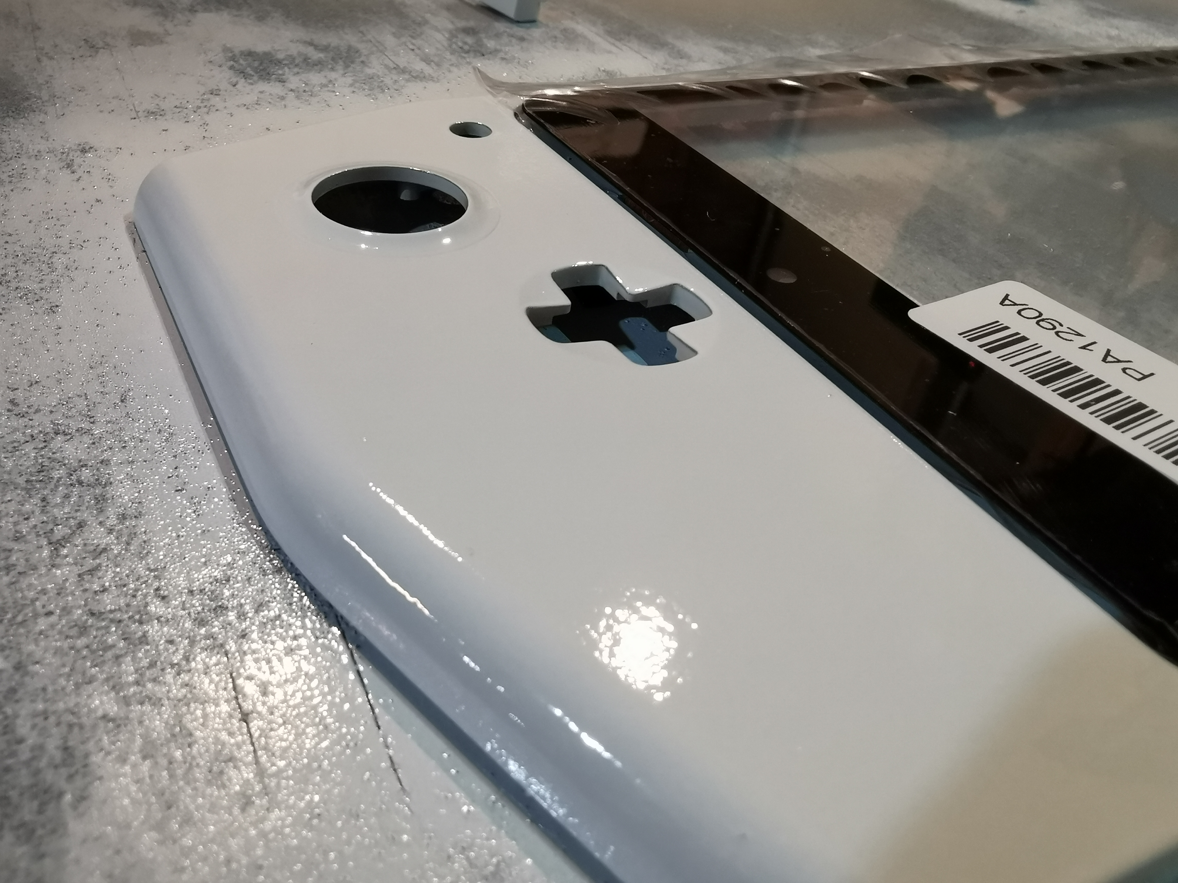

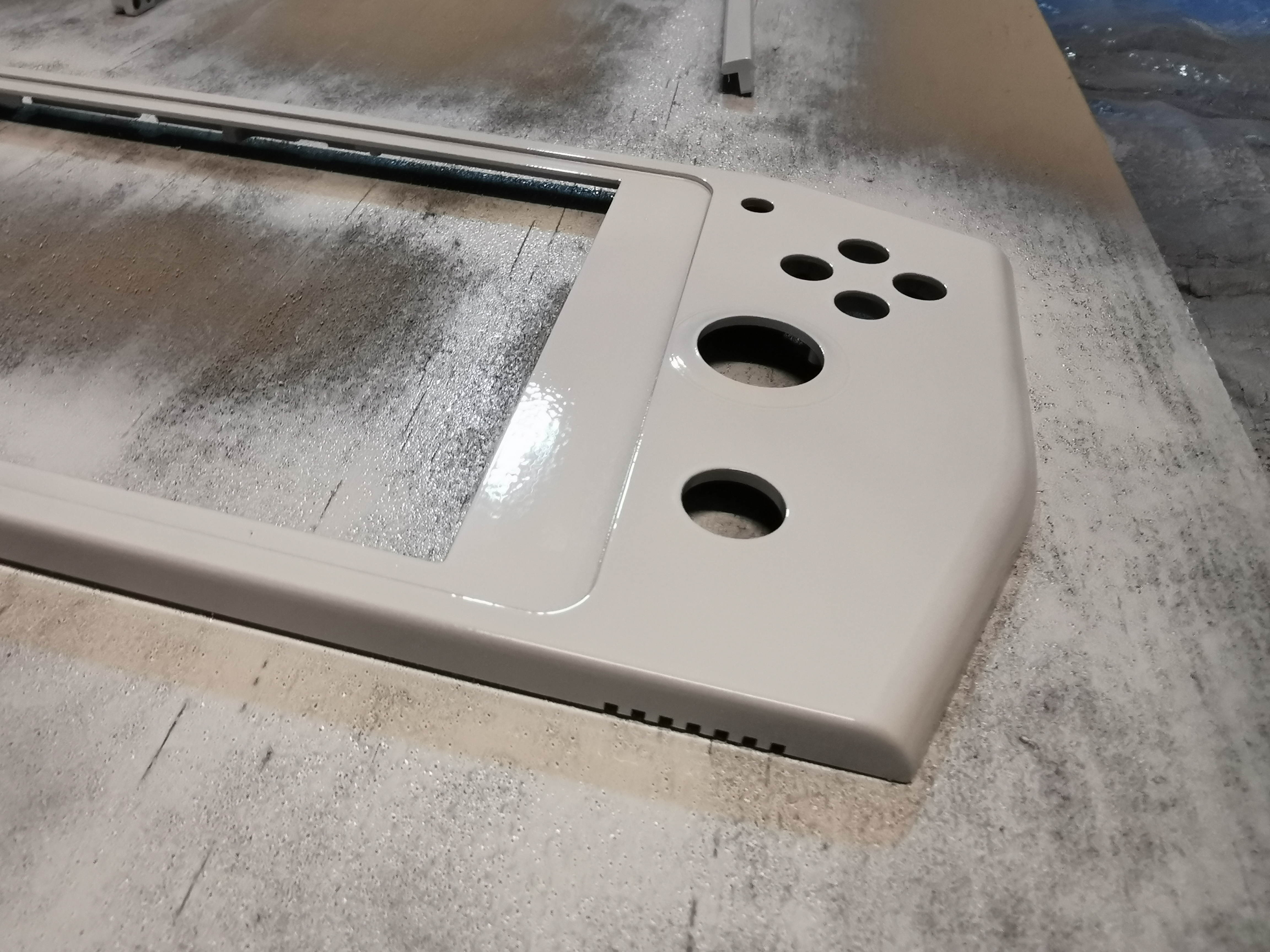

Okay, this paint was a huge mistake. Its had a full 24hr's to dry and it still feels tacky. Its also impossible to sand, it just clogs the sand paper up immediately. Have done a quick bit of research and I think the paint I should have used was acrylic, rather than enamel. So time to break out the paint stripper and try again!
Before you do strip everything back: Enamel really needs the better part of a week to "bake off" and at that point it usually becomes really hard and durable and consistently has a finish as described on the box. We've still got time in the competition so you might want to wait a little to get that enamel finish :)
Yeah I figured it would dry eventually. I painted the housing of my CNC with enamel and I didn't notice the long drying time with it, however because I don't have to hold it to use it I wouldn't have felt how tacky it was while it was still drying.
I'm much more familiar with automotive style paint as I've repainted some car parts before with good results. I should have gone with that to begin with but opted for the cheaper option thinking this would be pretty similar.
Unfortunately impatience got the better of me and I've already stripped 95% of the paint off (just working on the last bits now) so too late to go back now haha.

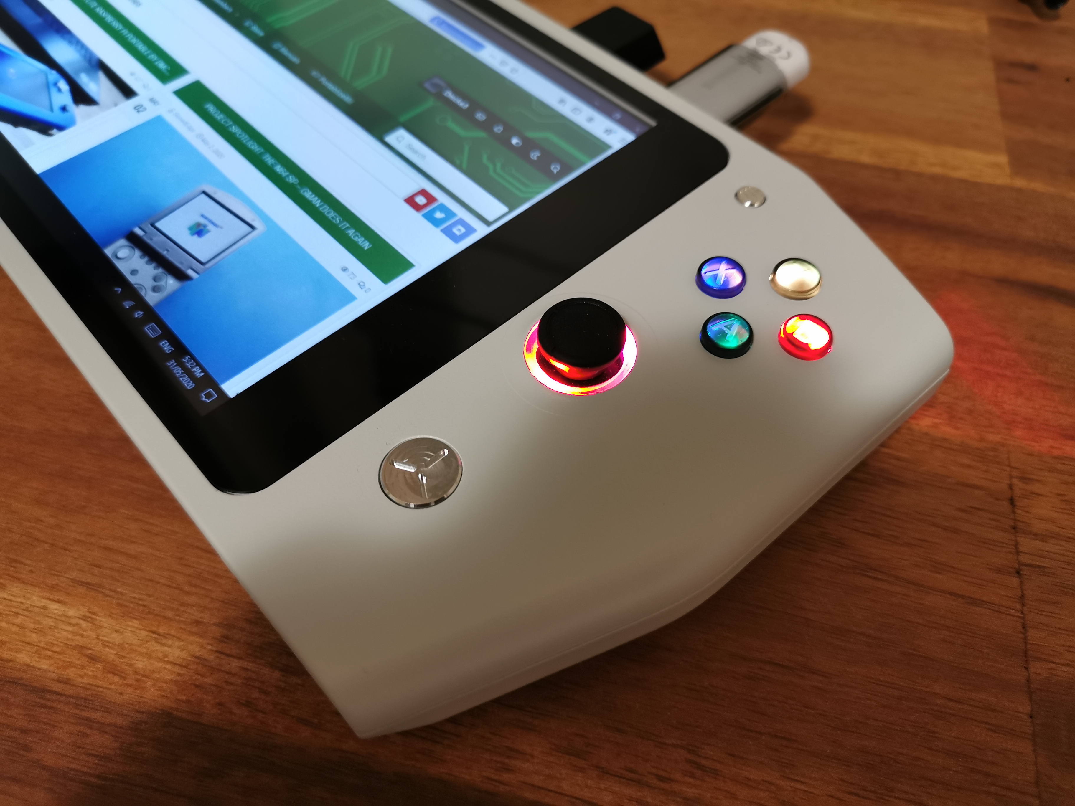

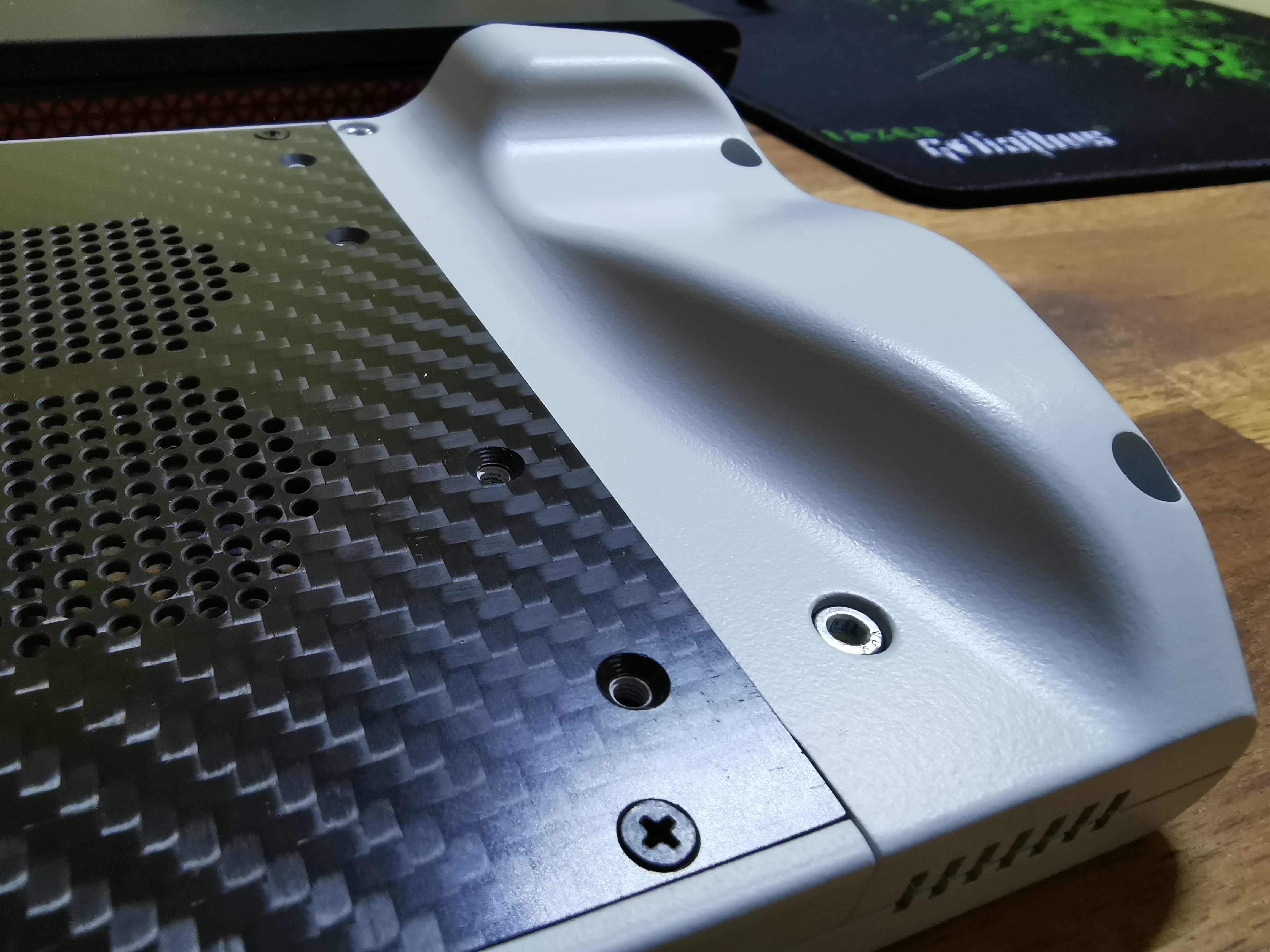

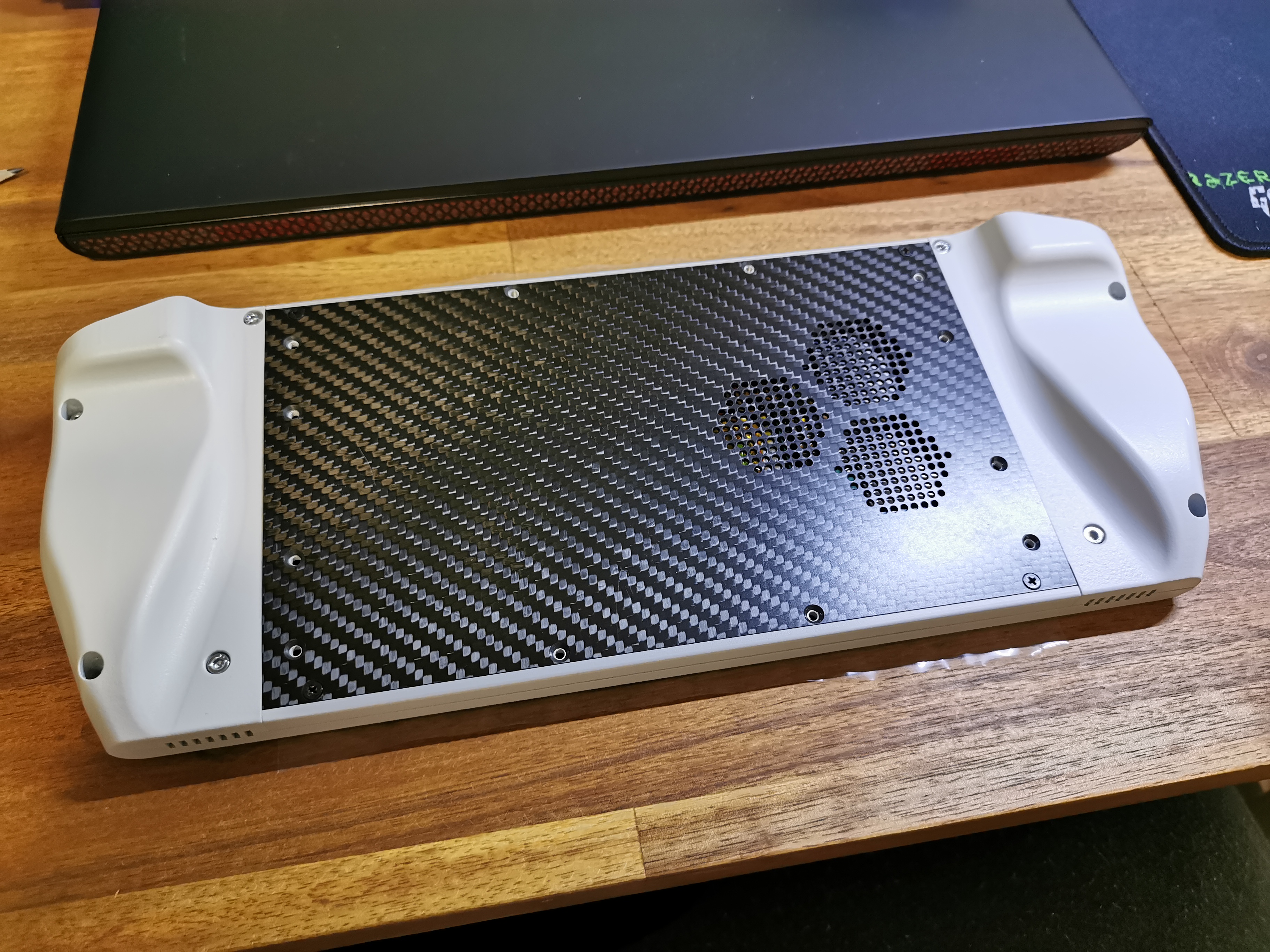

Much happier with the acrylic! I was going to polish it but I'm actually quite liking the matte finish so I've decided to keep it like that. Still heaps of work to do, need to make the remainder of the buttons, the heatsink/fan mount, the left side PCB and tidy up the wiring inside.
One thing I've noticed since putting it back together tonight is that I should have painted underneath where the screen goes black because at the moment I can see a slim sliver of white so I'll have to take the screen back out and fix that eventually too.

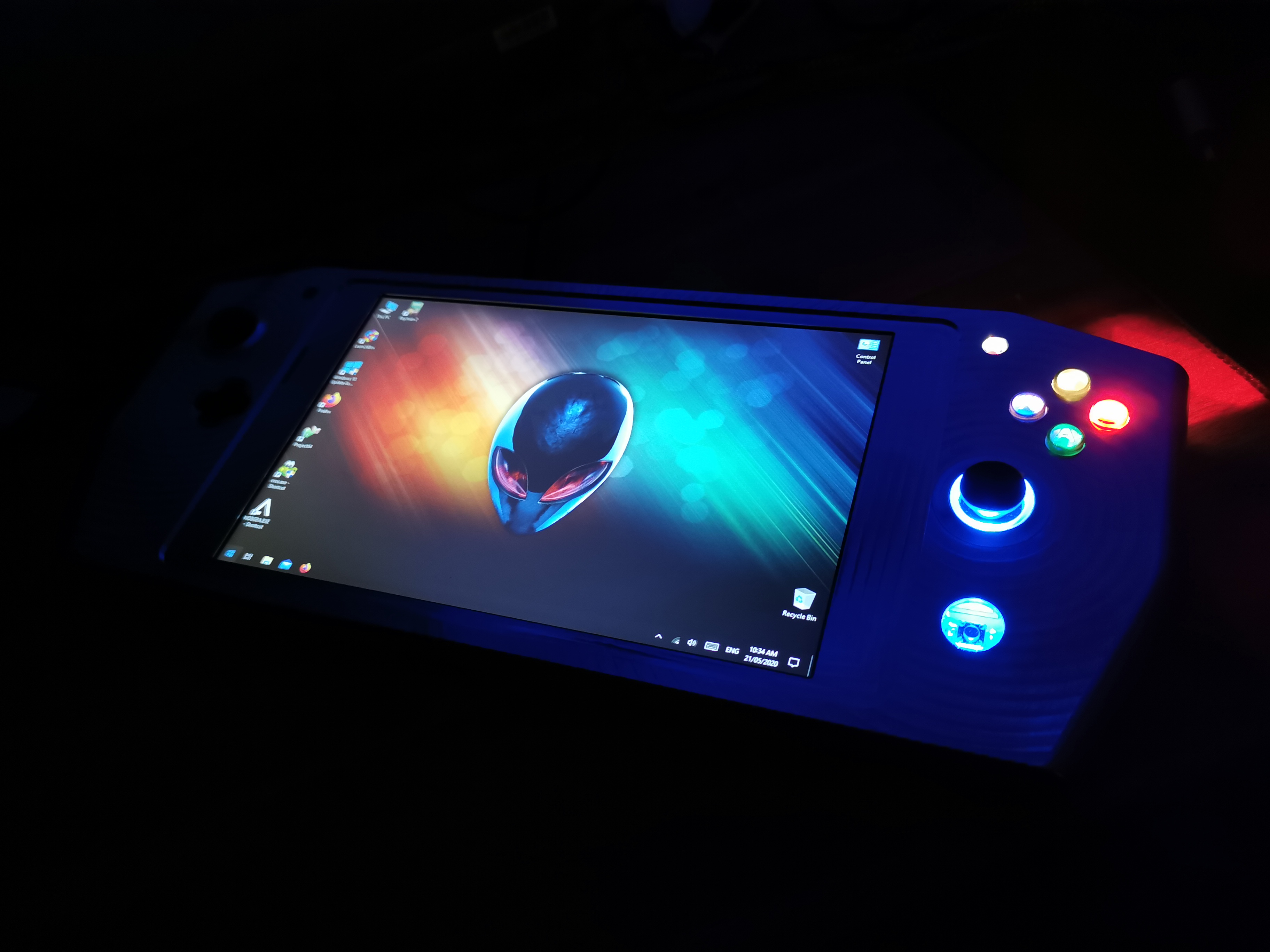

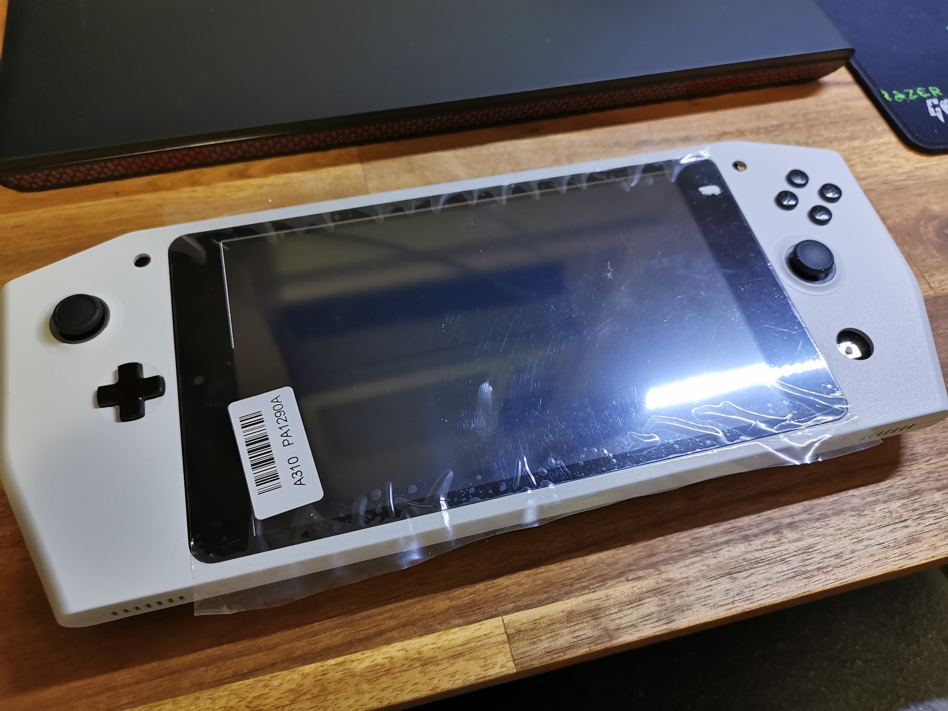

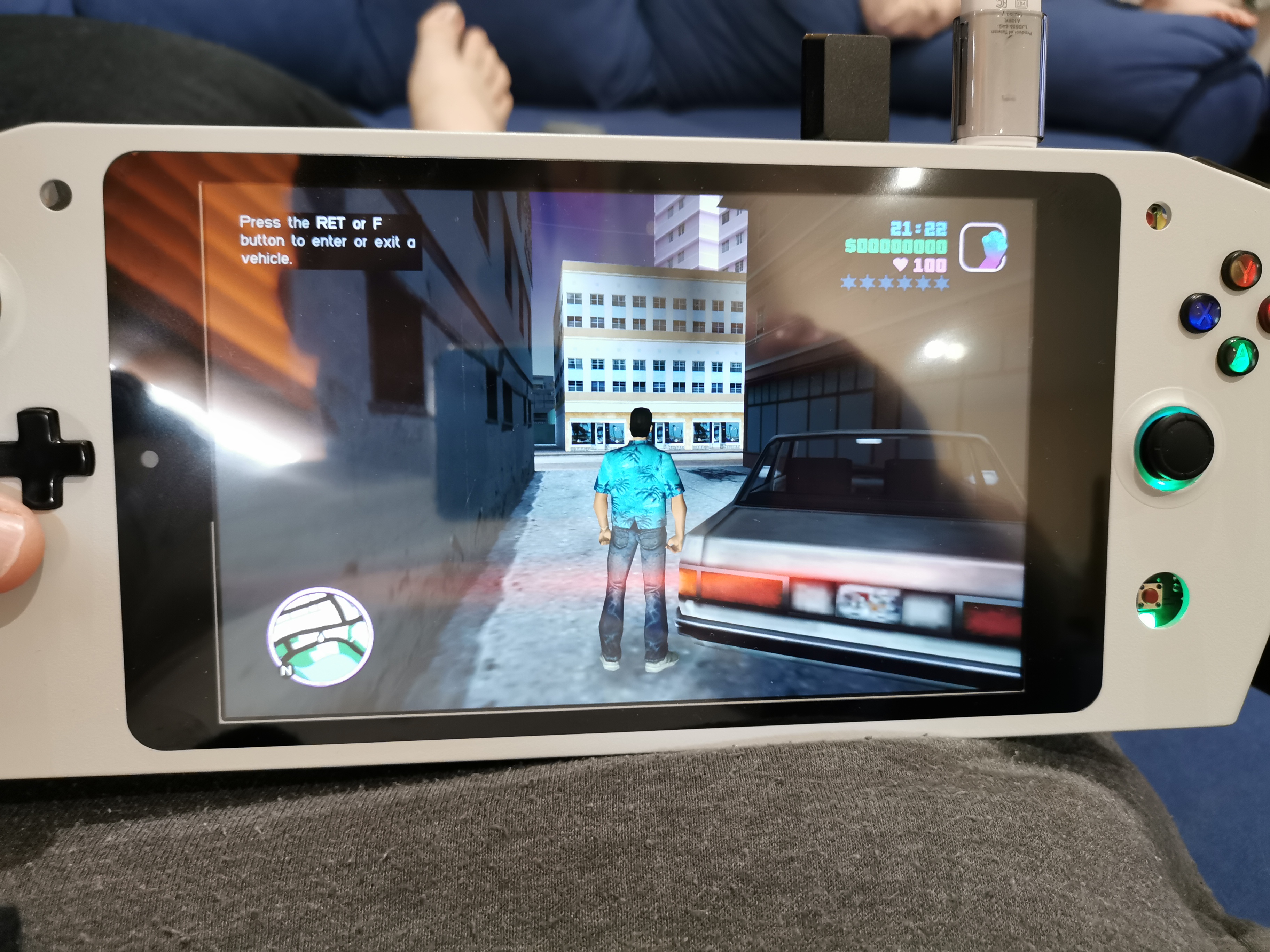

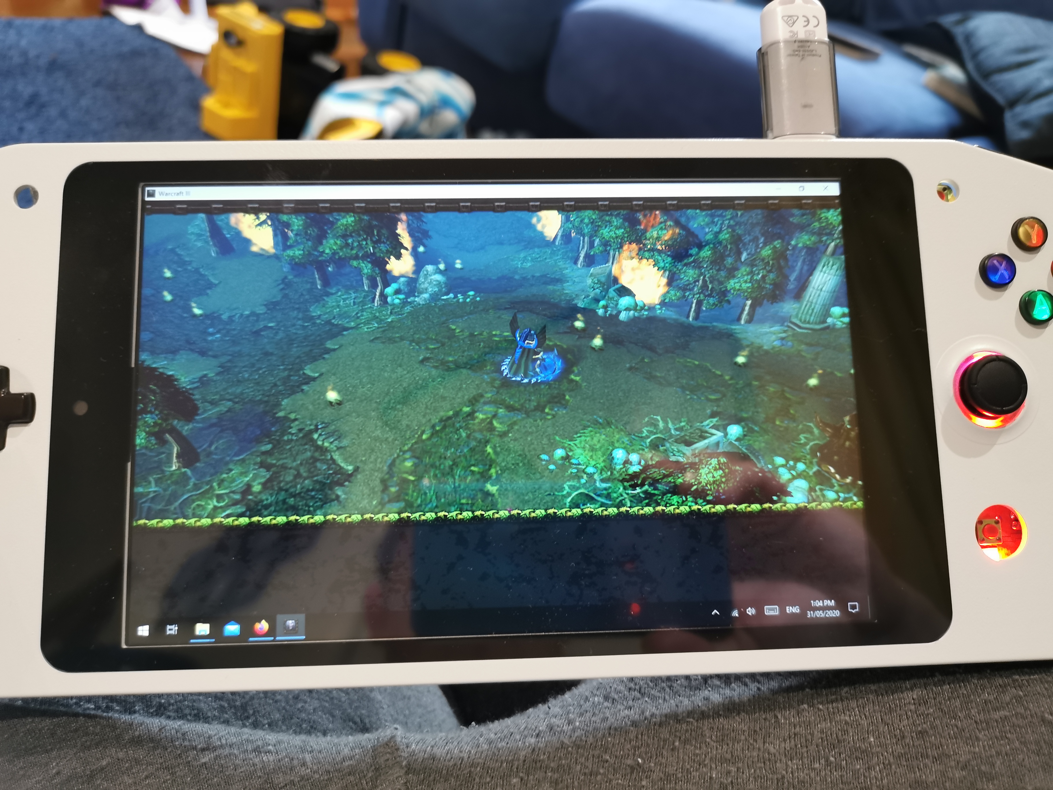

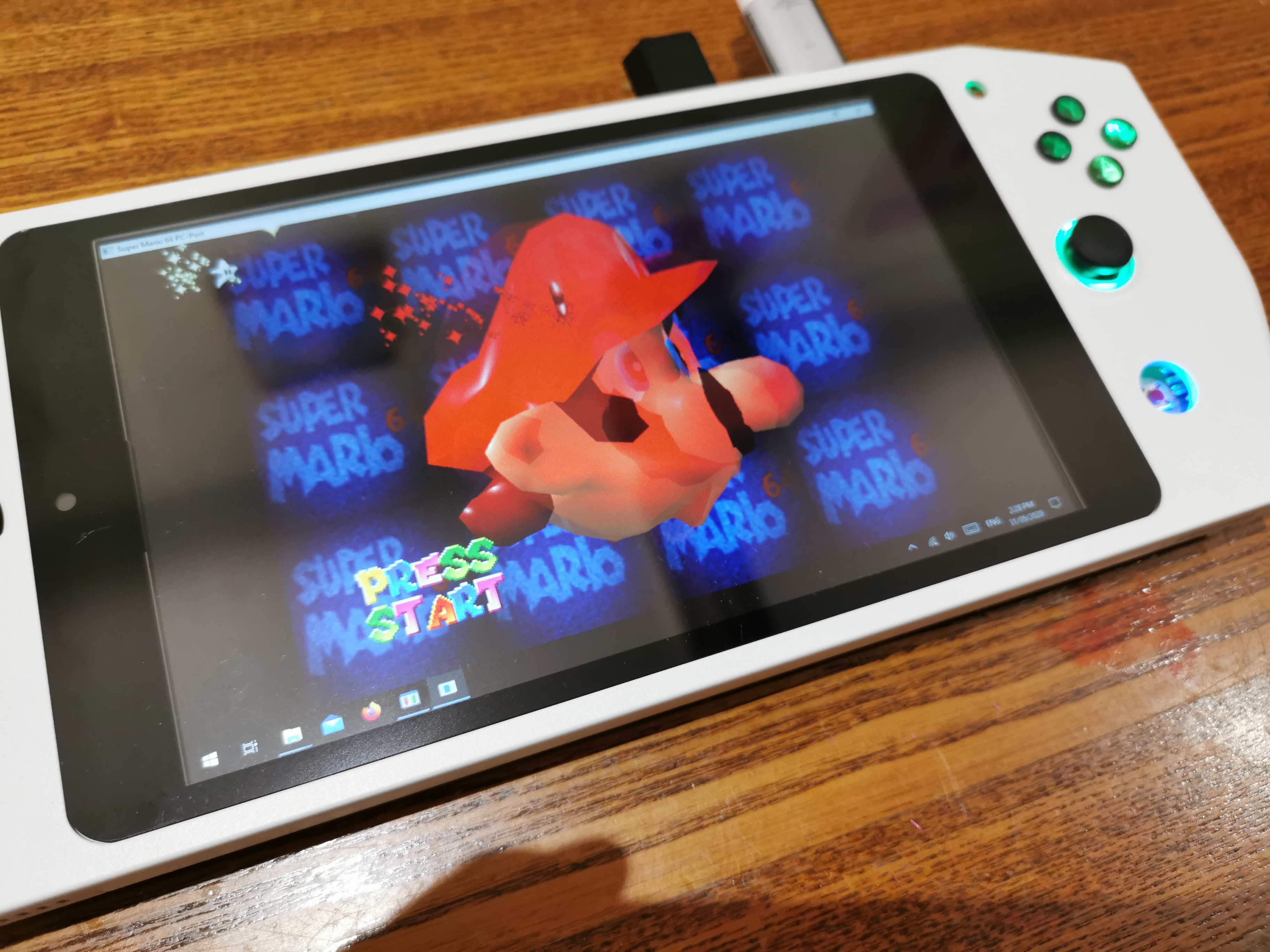

We had a pretty lazy day here so it was a great time to load up some games and test them. Some of the older games are a bit tricky to get running due to the "native resolution" of the panel being in a portrait orientation. Windowed mode fixes it for most but it does bring with it some complications for a few games too. Need to work on the mouse input (maybe introduce some exponential) if I intend to play mouse based games with it. Here's a few pictures of a variety of different games running on it. I also had a go of Diablo 2 but forgot to take a picture. Asides from the mouse input needing some work, it was quite good to play like this! Definitely need to get the other side of the controller done so I can really start testing some of these games properly.

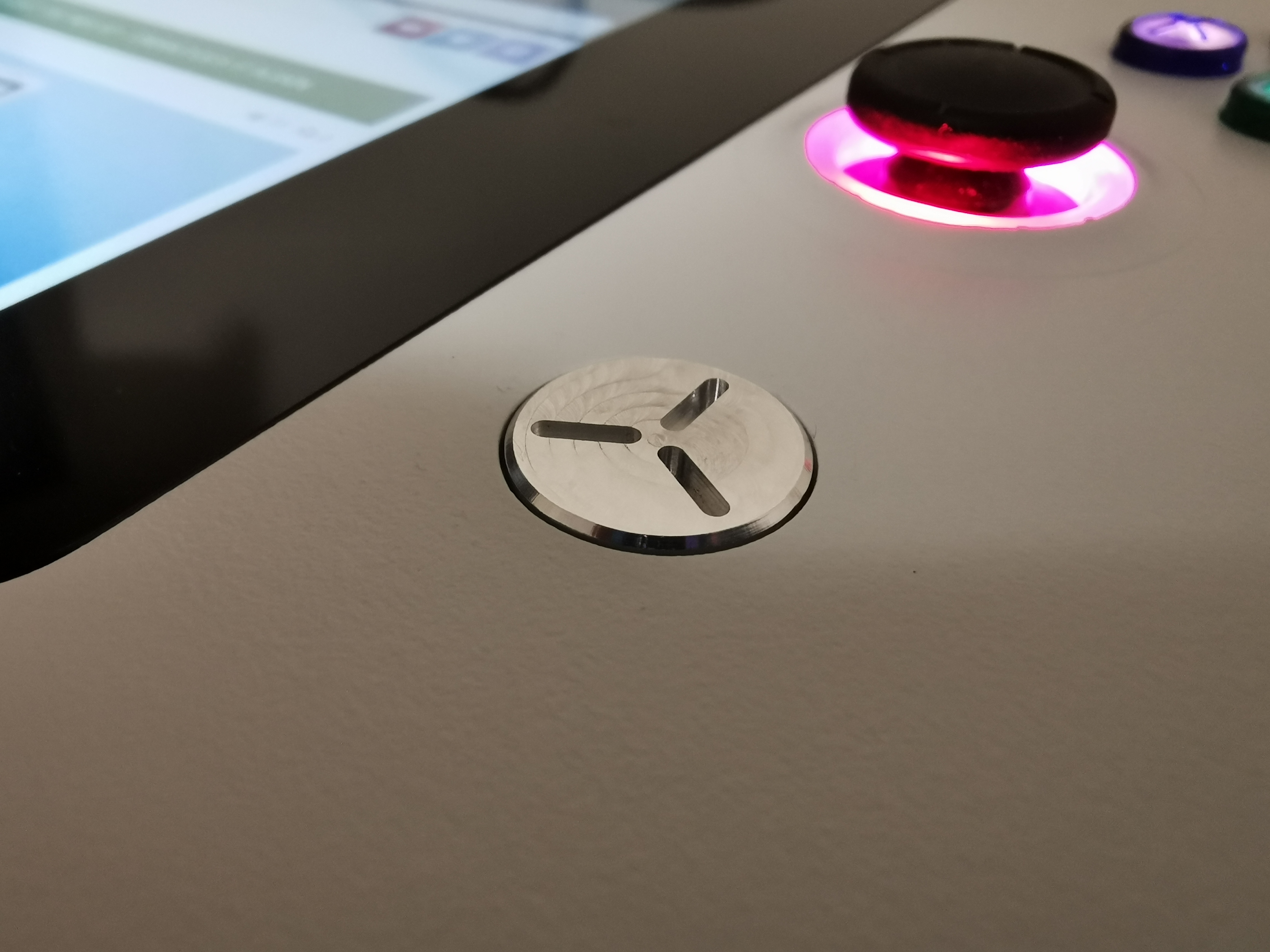

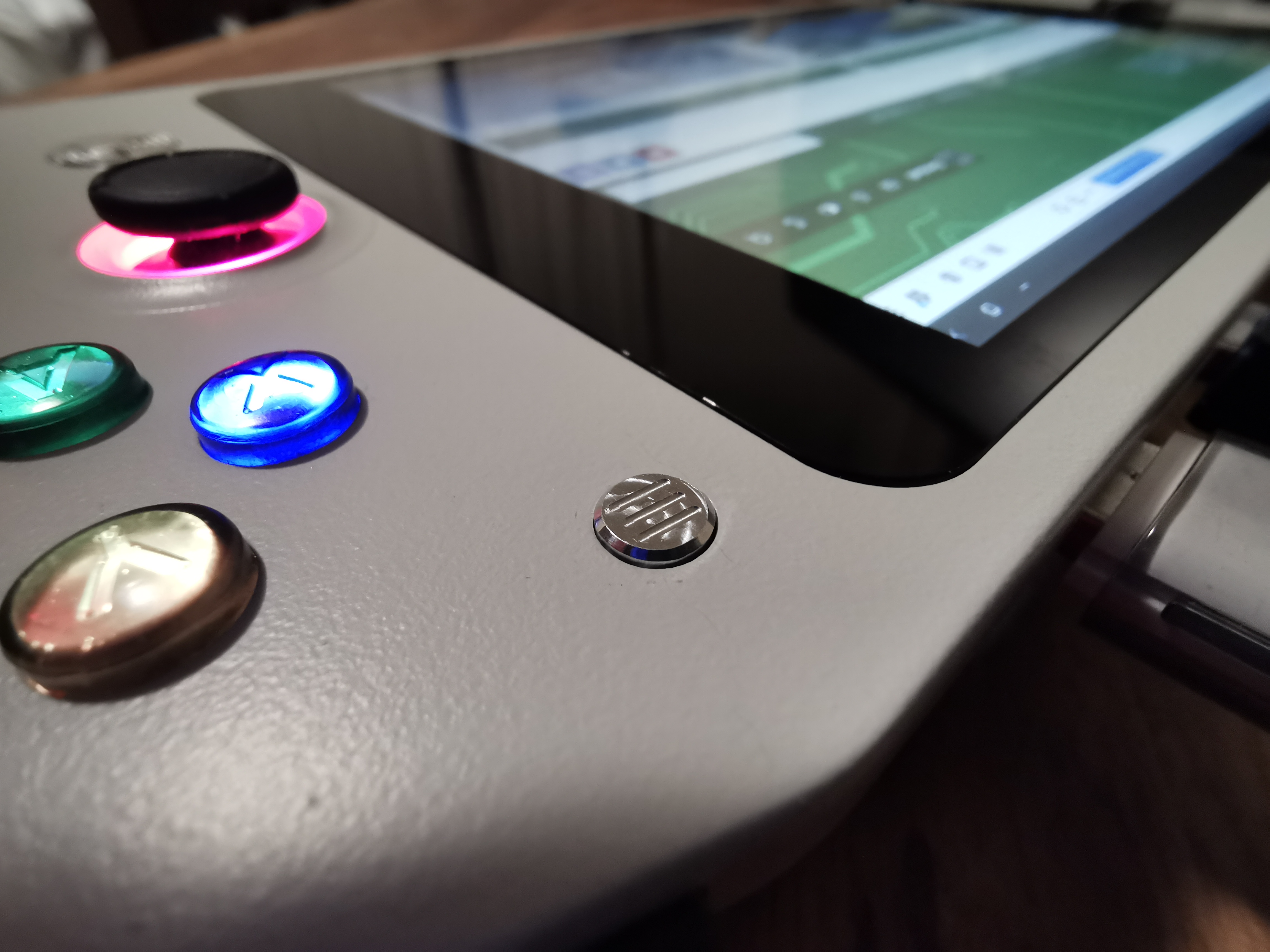

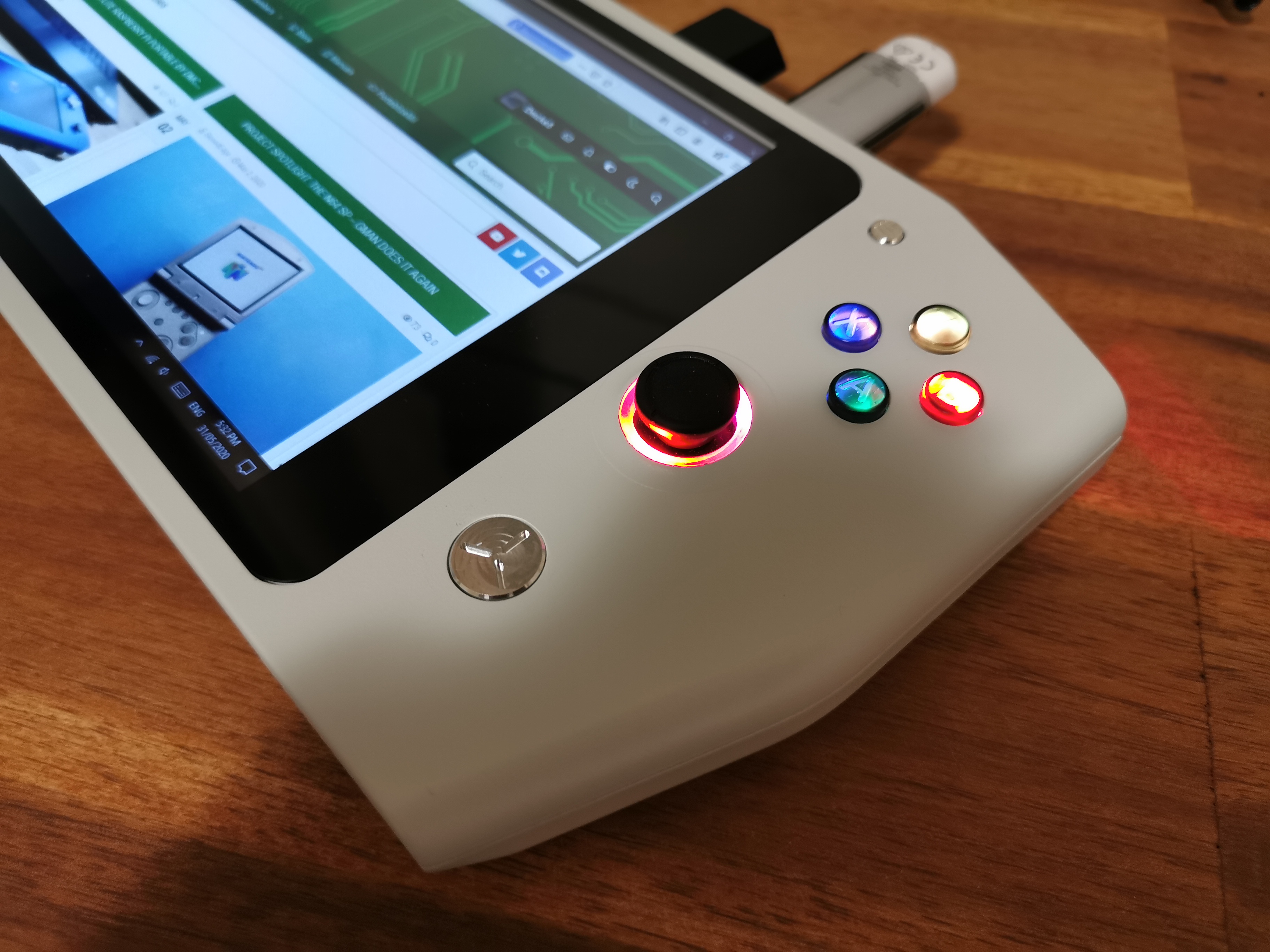

Here's a bit more photo-spam for everyone. Made some more progress with the buttons, thinking I'll leave the start and select buttons aluminium and just sink some black paint into the engravings as I'm quite fond of how they look like this. I have to pull the hotkey button back out and machine the back of it out so I can fit some plastic in there so the "tri-wing" pattern glows but at least I've got something to fill the hole for now.
Also just in-case anyone was wondering, the screen still has its plastic protection film on it which is why it looks a bit funny in some pictures. Once I'm finished I'll peel it off (don't worry, I'll video it lol) and put a proper screen protector on it.
