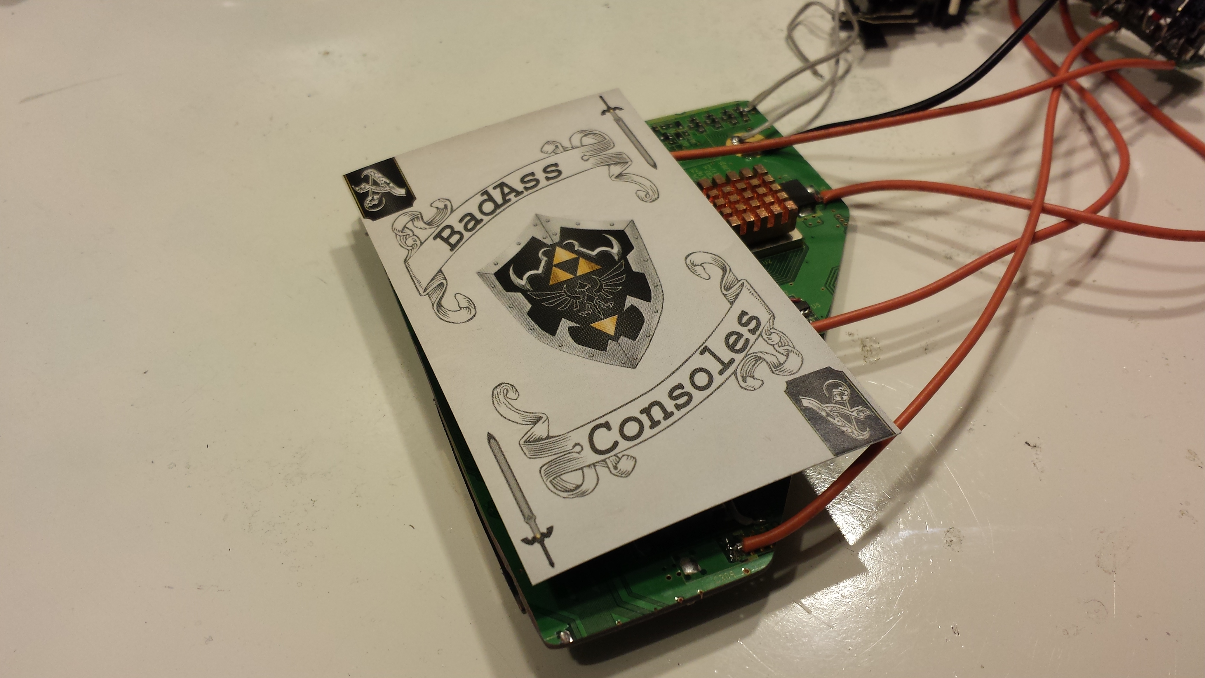

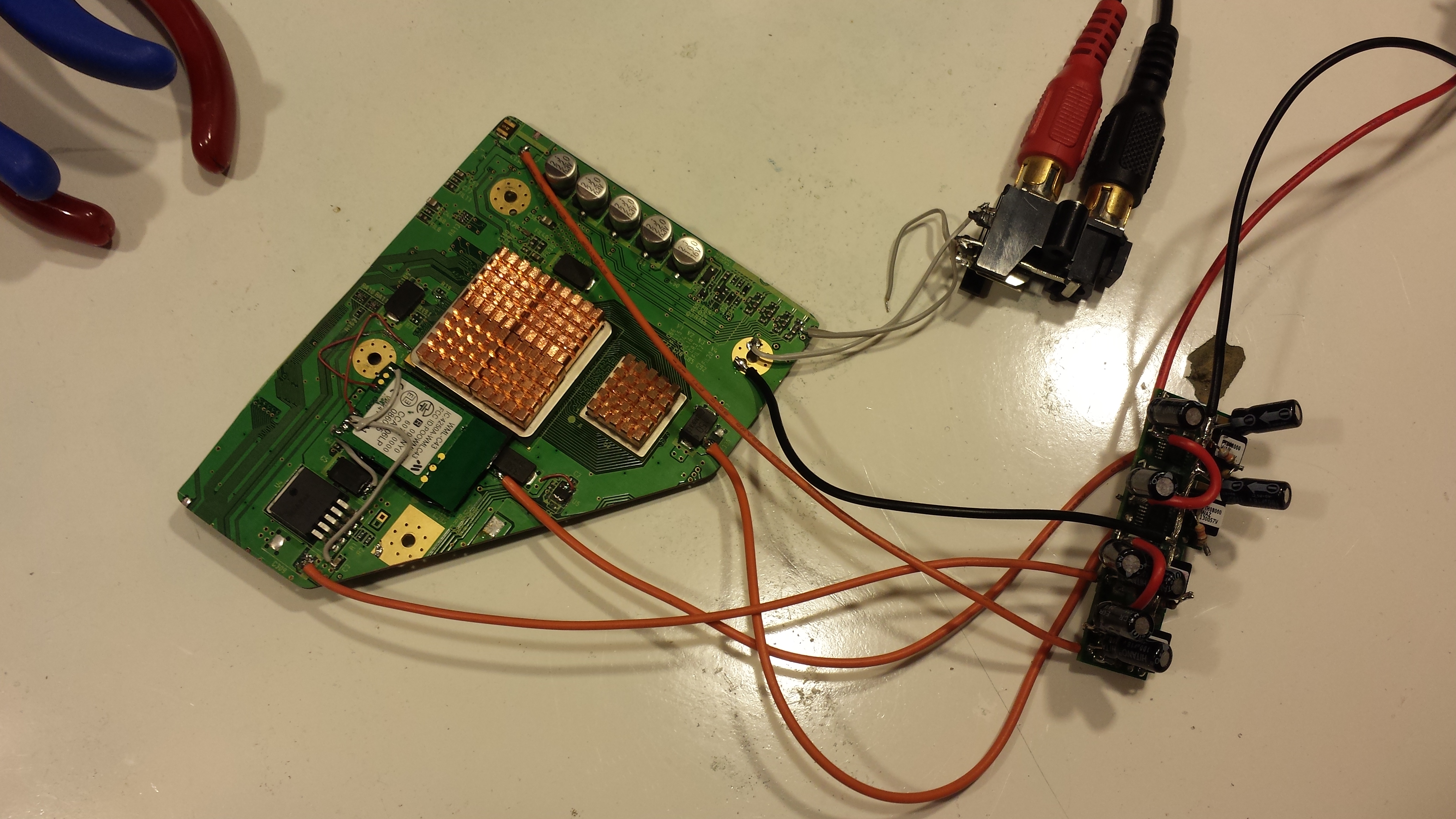

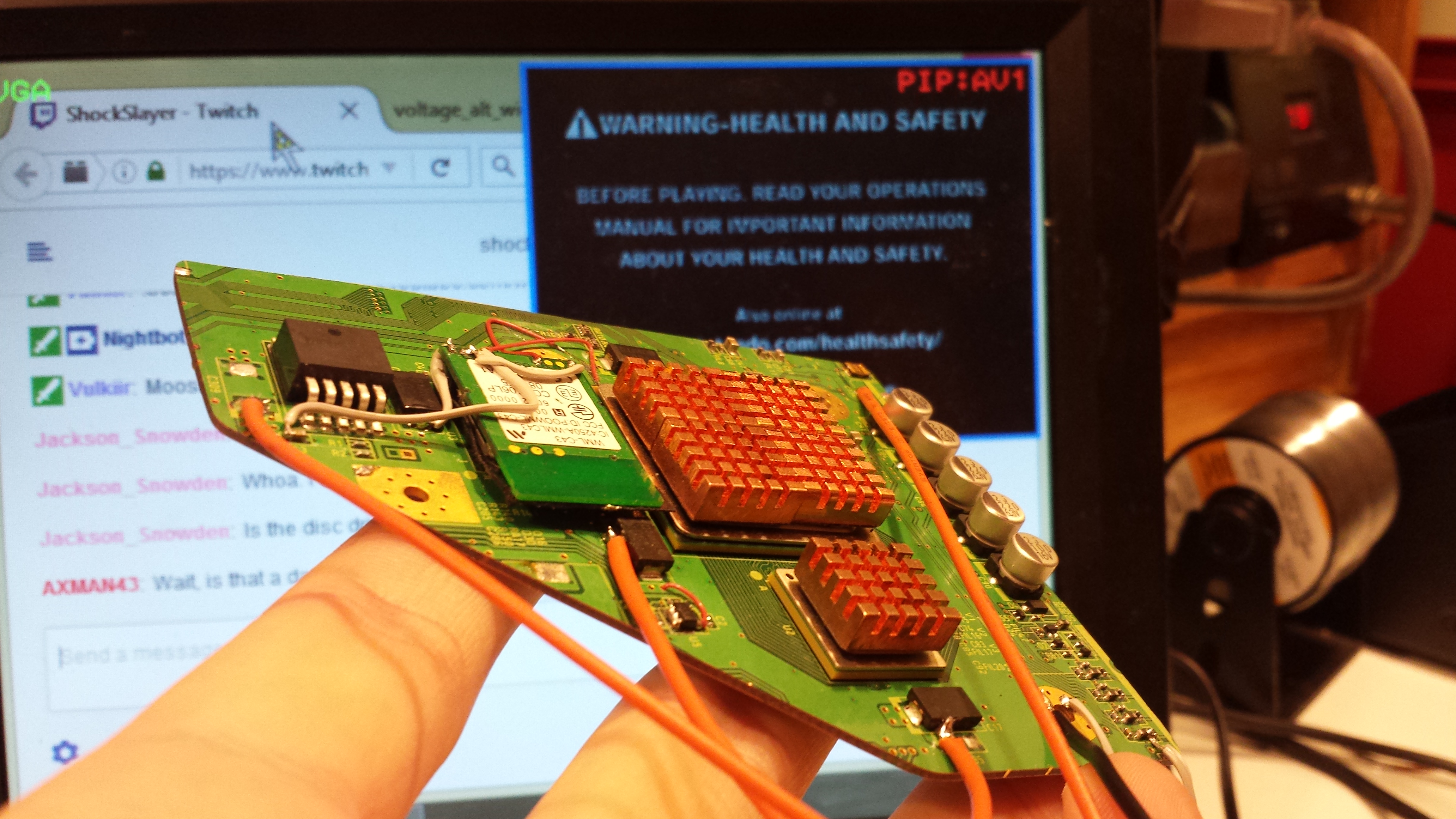

Does anyone have any pictures of their custom regulators wired up to their Wii? I've been looking around but all I see is where the voltages are, on the Wii Trimming Guide. And also, do you need the custom 5v regulator or is that just optional? Thanks

As far as I know, most people don't mount their TI regs on perf board. I think most people wire them up and glue them into the case without mounting them to anything else
Weird, I've seen it done both ways but the more research I do it seems that people are using custom breakout boards if they do mount them somewhere. Make's ya wonder why they even put pegs on them if they aren't made to fit into perf board, lol!!
I will take your advice and wire 'em up, test 'em and glue 'em in. Thanks for solving the mystery for me... I couldn't figure out how everyone had been mounting these dang things, lol!! :)
Well, they are made to fit onto OTHER boards, but not perf board specifically. They are made so you can design a circuit board that the pth08080 module can plug right into.
