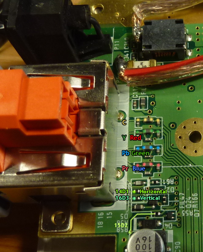

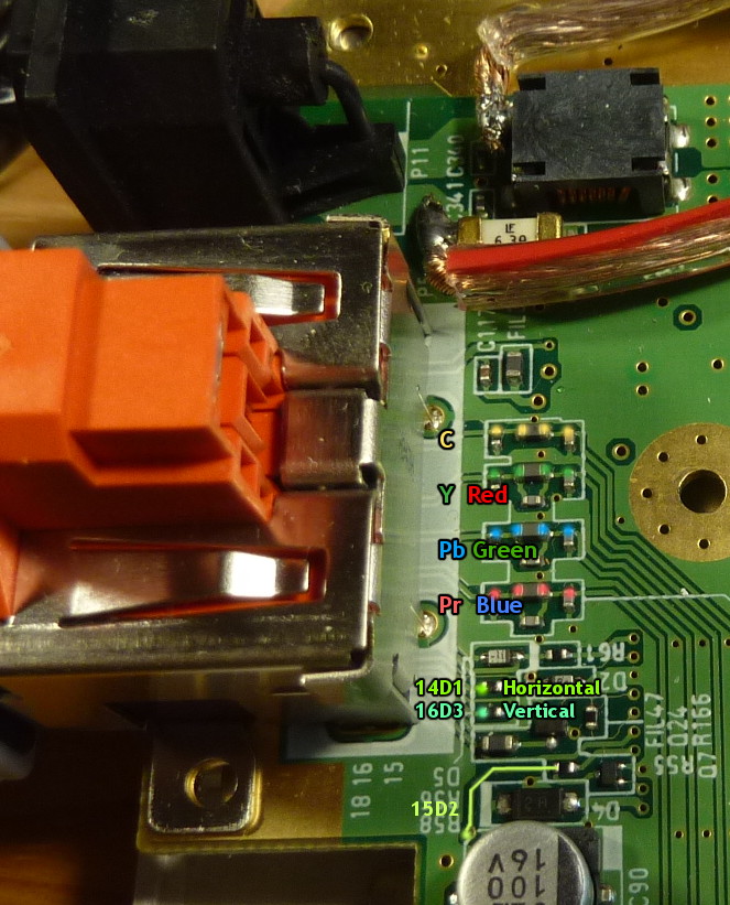

If you're going to keep the Wii Multi AV port, you have a much easier time soldering to the pins there. Below is what I used.
Edit: above is only valid for the RGB pins, the H and V pins are not actually wired this way. I just considered to connect them this way (by separating their traces and instead soldering to the H and V pins of the video chip) so that I could use Multi-AV to VGA cables I considered making, which I never actually did. So you still have to solder H and V from the more difficult pins.
Still, you might as well just skip this step and use Wii to HDMI adapters (with a HDMI to VGA adapter afterwards if you need VGA), if the extra external space doesn't bother you.
Oh wow, that looks way easier to solder to, I will make sure to use these pads instead!
How are you getting H and V sync from those resistors? The sync pins on the AVE are NC.
Ah, thanks for alerting me to that. My idea when I made this picture was to separate the default traces connecting those pins, so that I could connect a Multi-AV plug to VGA cable. (I never went through with that, instead soldering internally.)
Of course in this case soldering to the H and V pins on the video chip (or the throughhole ones) to the marked pins would still be necessary, so only the soldering to the RGB pins becomes easier.
I edited my previous post accordingly. Sorry about the misinformation.

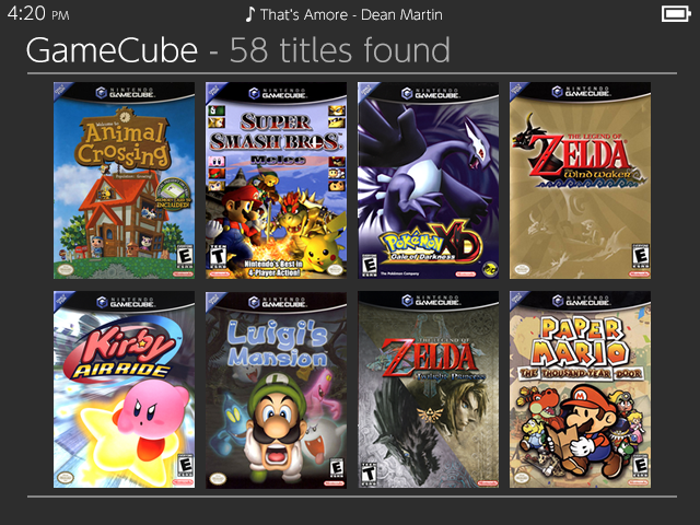

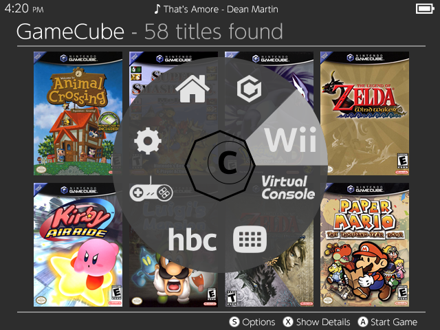

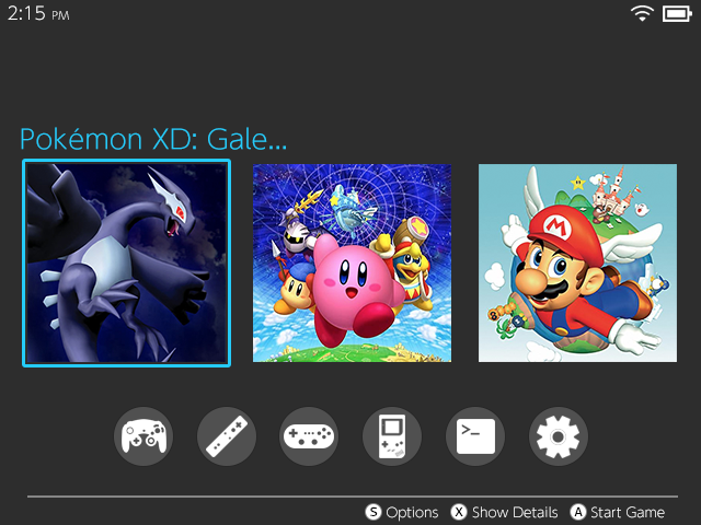

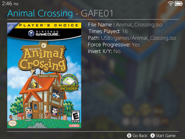

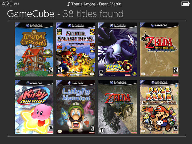

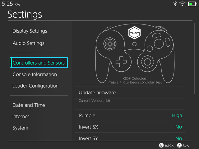

Anyways even though it doesn't really belong in this thread, here's a little look at what the new one will look like:
NOTE: The switch theme is merely being used as a development basis. The stock theme that ships with the new loader will be different.
Hey, regardless of my preferences, the switch inspired interface look great. One piece of advice from a graphic designer by trade; the game display (both group and individual) looks a bit too tight and squished. If you compare this design to the switch, xbox one, ps4, or any modern game launcher menu you'll see the game icons have the space to be physically larger, bat arent to give the design some breathing space. Reducing the size of the game icons will make the menu appear more open and less cluttered. Negative space is your friend.
