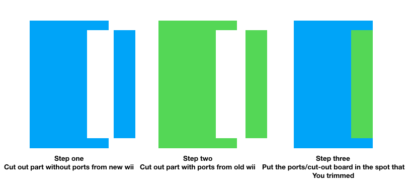

Do you want/need to put the Wii back into its original shell? If not it will definitely be easier (and will probably end up better) If you just cut the board around the ports and use it that way. It really is so much easier that way. And if you're not putting it back in the original case, might as well go with that right?
edit: If you need to put it into the original case or whatever you can also trim out the section where the ports would go on your late model wii, and use wires to connect a trimmed out part of the other board back to the rest of the wii using the trimming guide. It has diagrams for all connections you need to make.

In this case, it would be going back into it's original shell. Simply put, I'm trying to add the gamecube ports back to one of the late-model Wiis that shipped with those removed as a cost-saving measure; the disc drive still reads gamecube discs and the software still supports them, the only obstacle is the lack of input ports. I agree, cutting that portion of the PCB would be easiest but I would like to just remove the ports from an early model board and solder them onto a late-model board to restore gamecube functionality to it.
I meant it more like this:
Then wire them together. You would have to avoid cutting ANY further then where the ports would be soldered in however, as you could possibly fuck it up if you do. Still way easier then the other methods though.
I have a hot air rework station and one of the tips is pretty small (a little smaller than a pencil width) and you can not only control the temperature but also the air flow. Most any hot air rework station has these features. You can then either wave the hot air pencil back and forth until the whole section of the board heats up enough to melt the solder and remove the ports, or you can heat each solder joint up and use a solder sucker to suck the solder up once it melts. Given the size of the gamecube ports, I would go with the latter option personally.
That's an interesting idea, I'll take a look at the trimming guides and see how feasible it is to reconnect all the severed traces.
