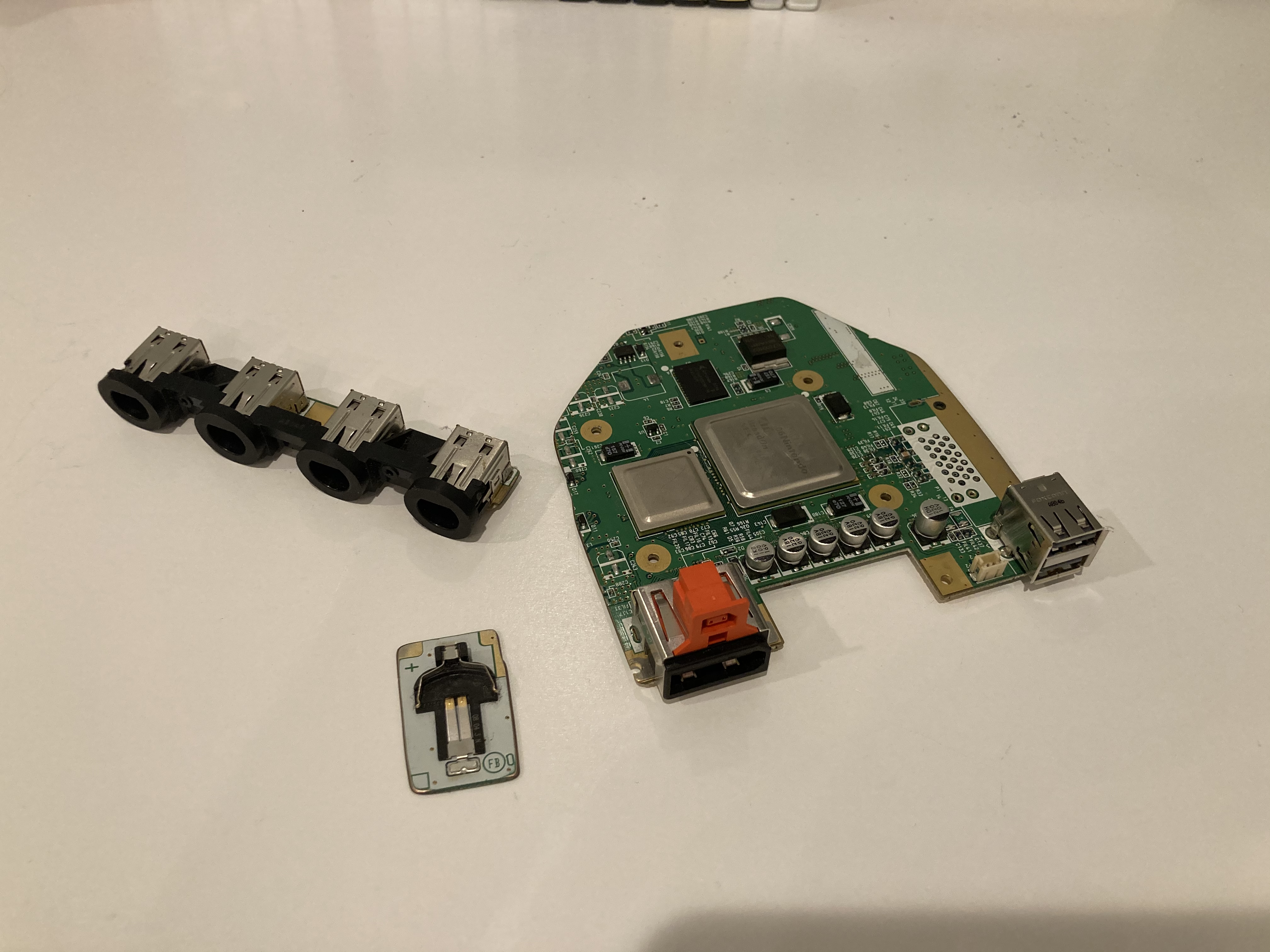

I have the case 3D printing and currently have trimmed and sanded my 6 layer Wii motherboard, GameCube controller ports, and the 3.3v battery holder for the internal clock.

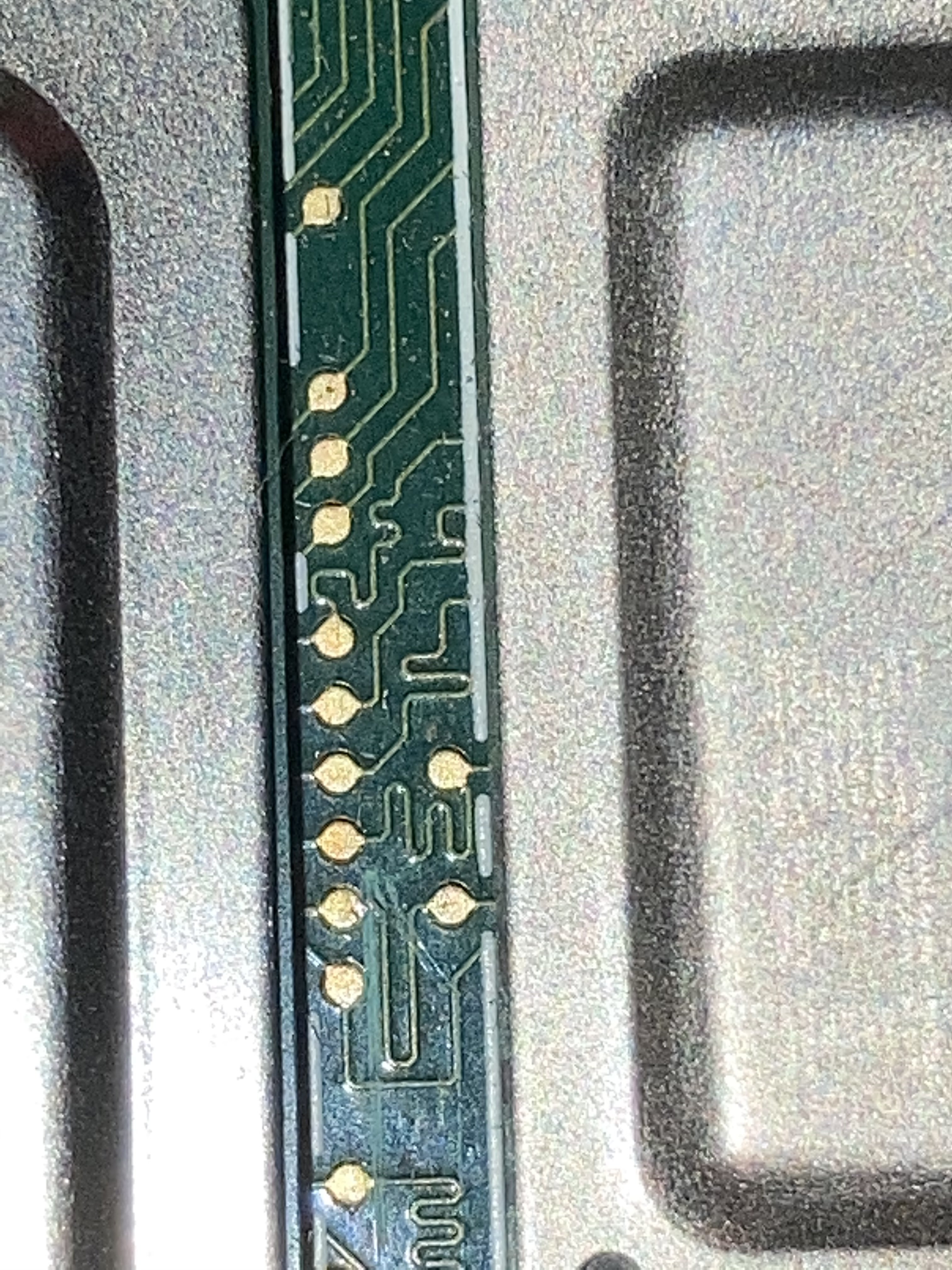

While relocating U10 my soldering iron slipped and scratched some CPU to GPU traces.
After panicking for a while, I worked up the courage to see if it was destroyed, so I broke out the ‘ol multi-meter, and tested on some conveniently placed test pads, and luckily enough it wasn’t broken, Thank God.
-sepencer

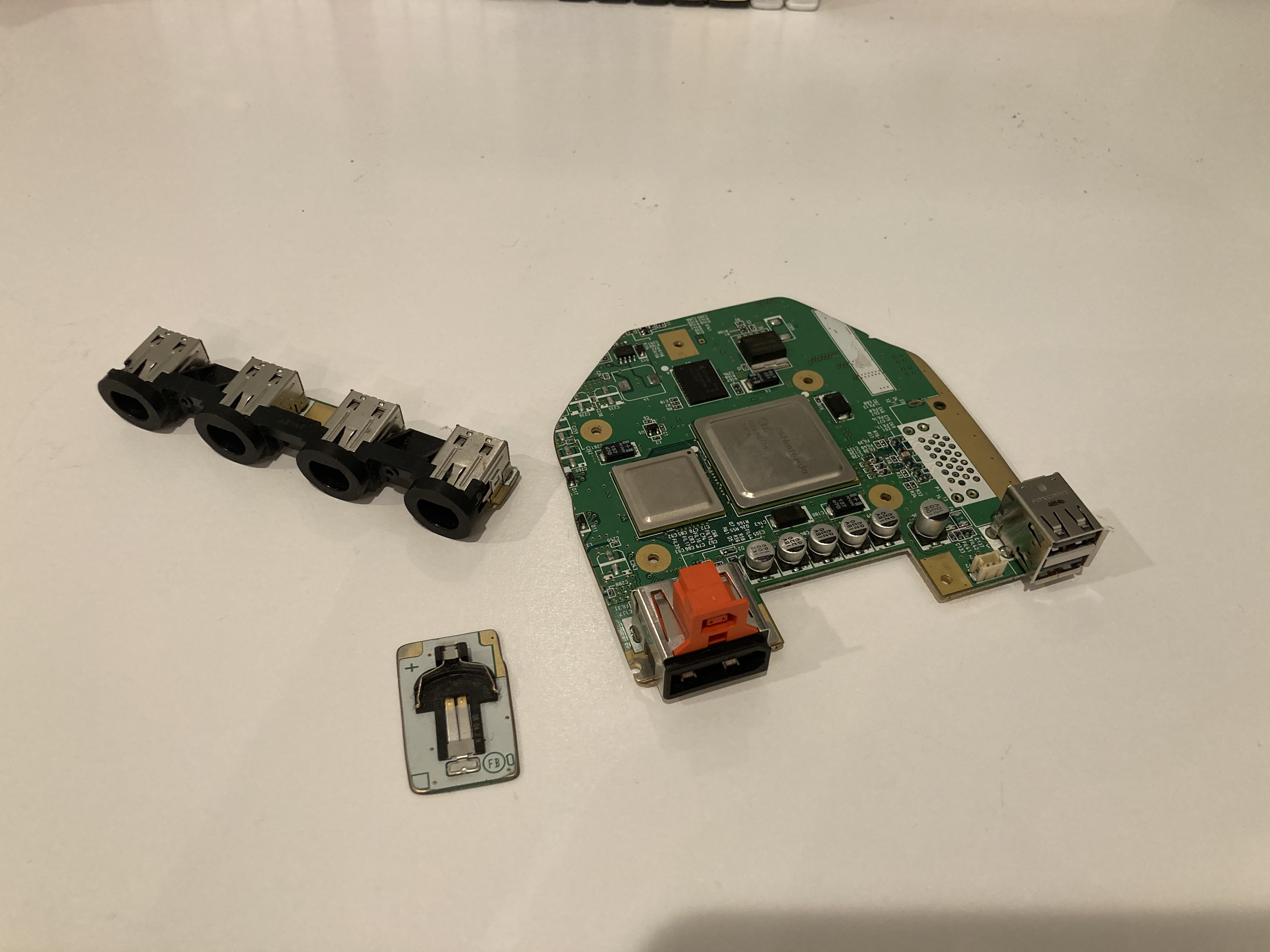

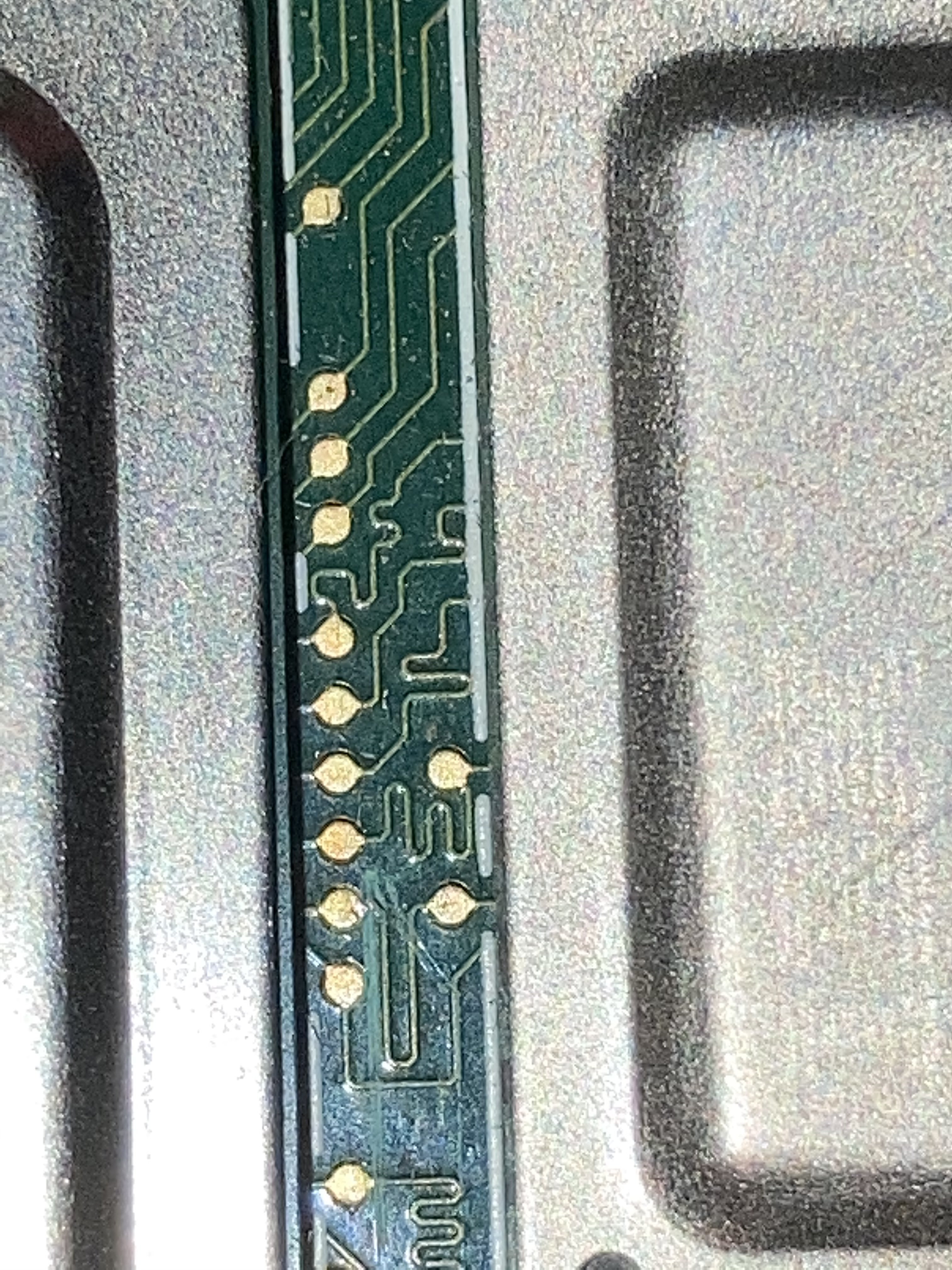

-sepencer

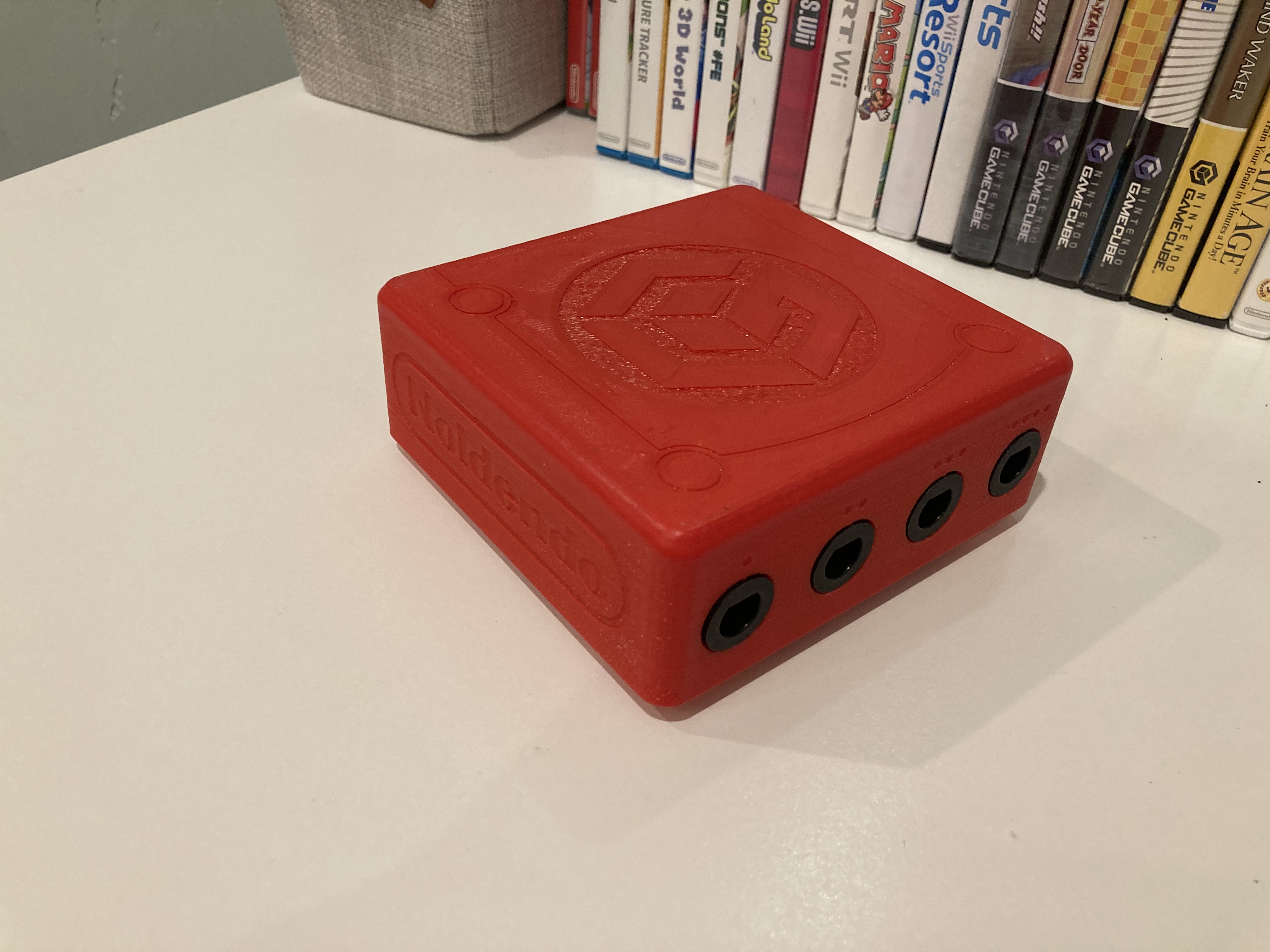

The 3D printed case came out amazingly, and after a bit of wet sanding it was ready to go.

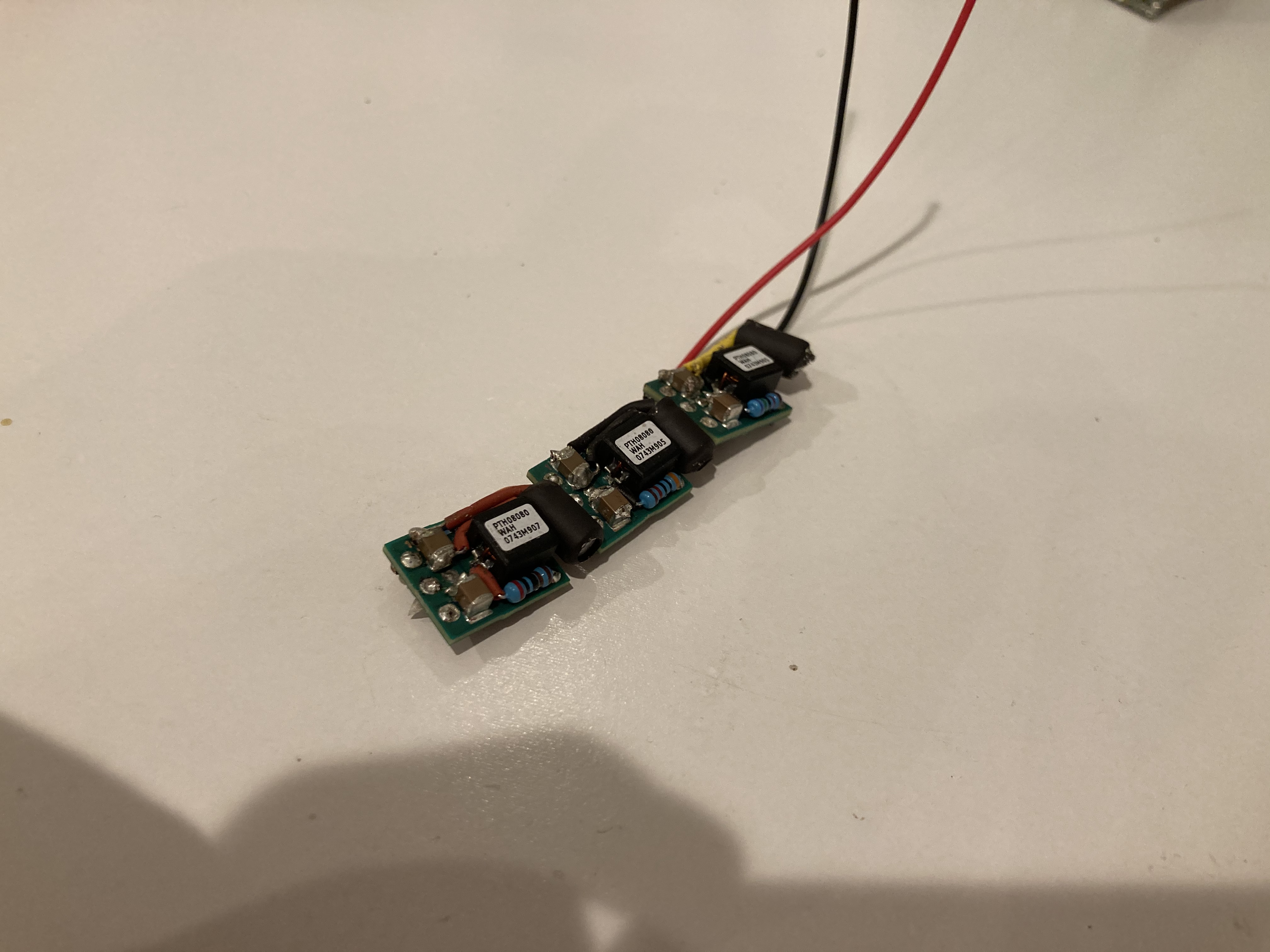

My parts for the custom regulators came, I was hoping to to just get a RVL-PSU from the bitbuilt store, but they are out of stock :/
Though the regulators turned out pretty nice.
