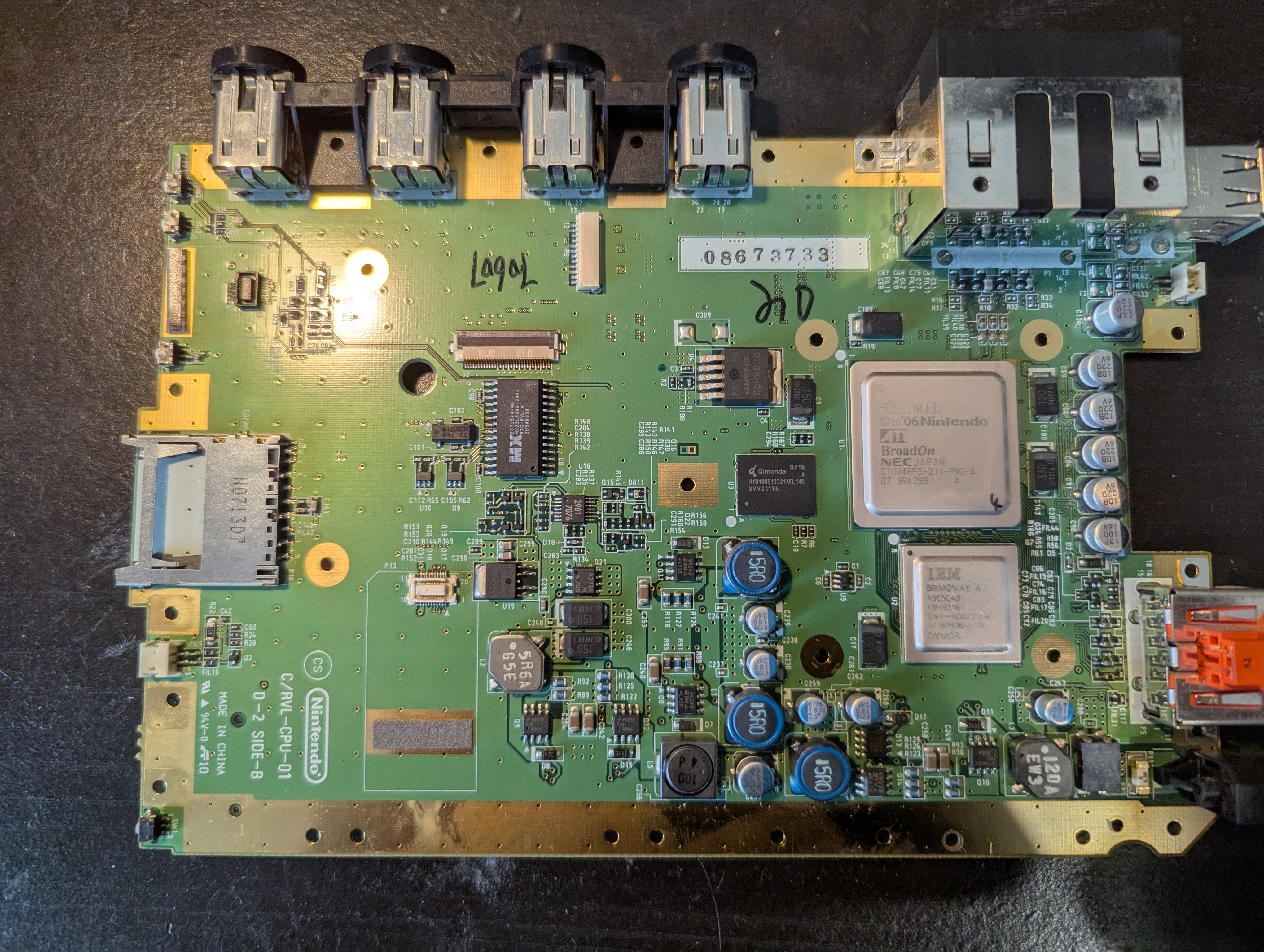

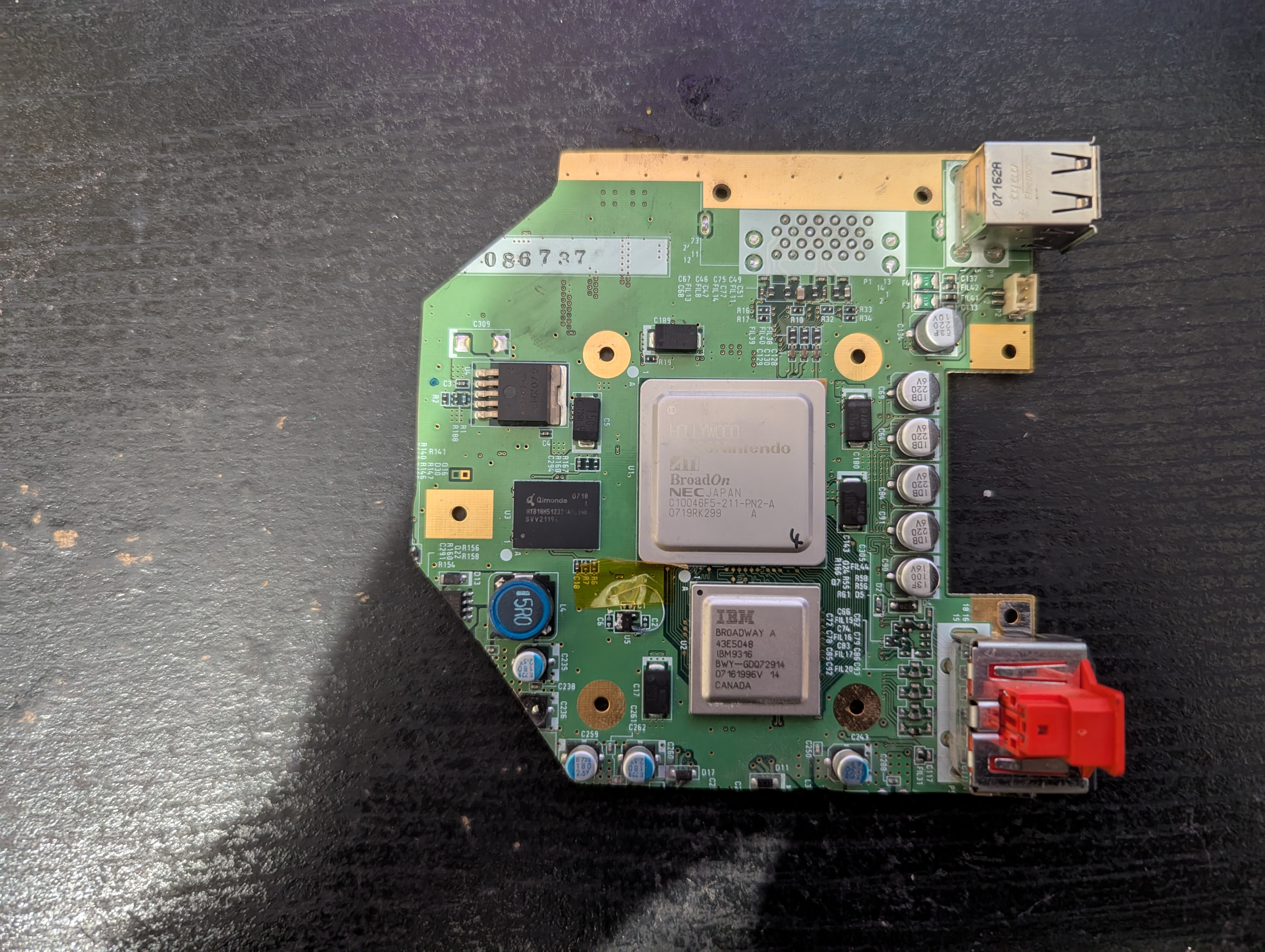

But first, here is the board used :

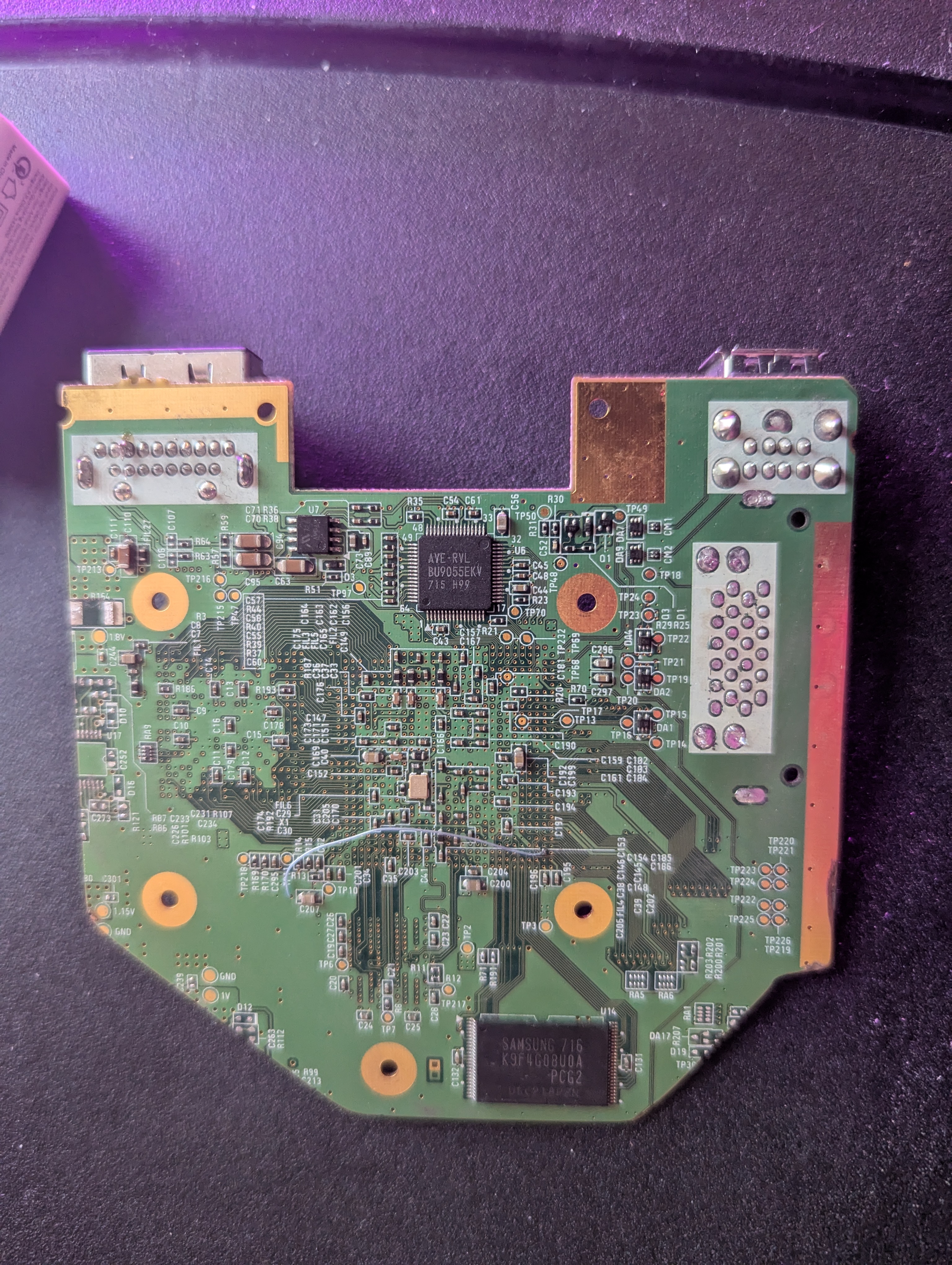

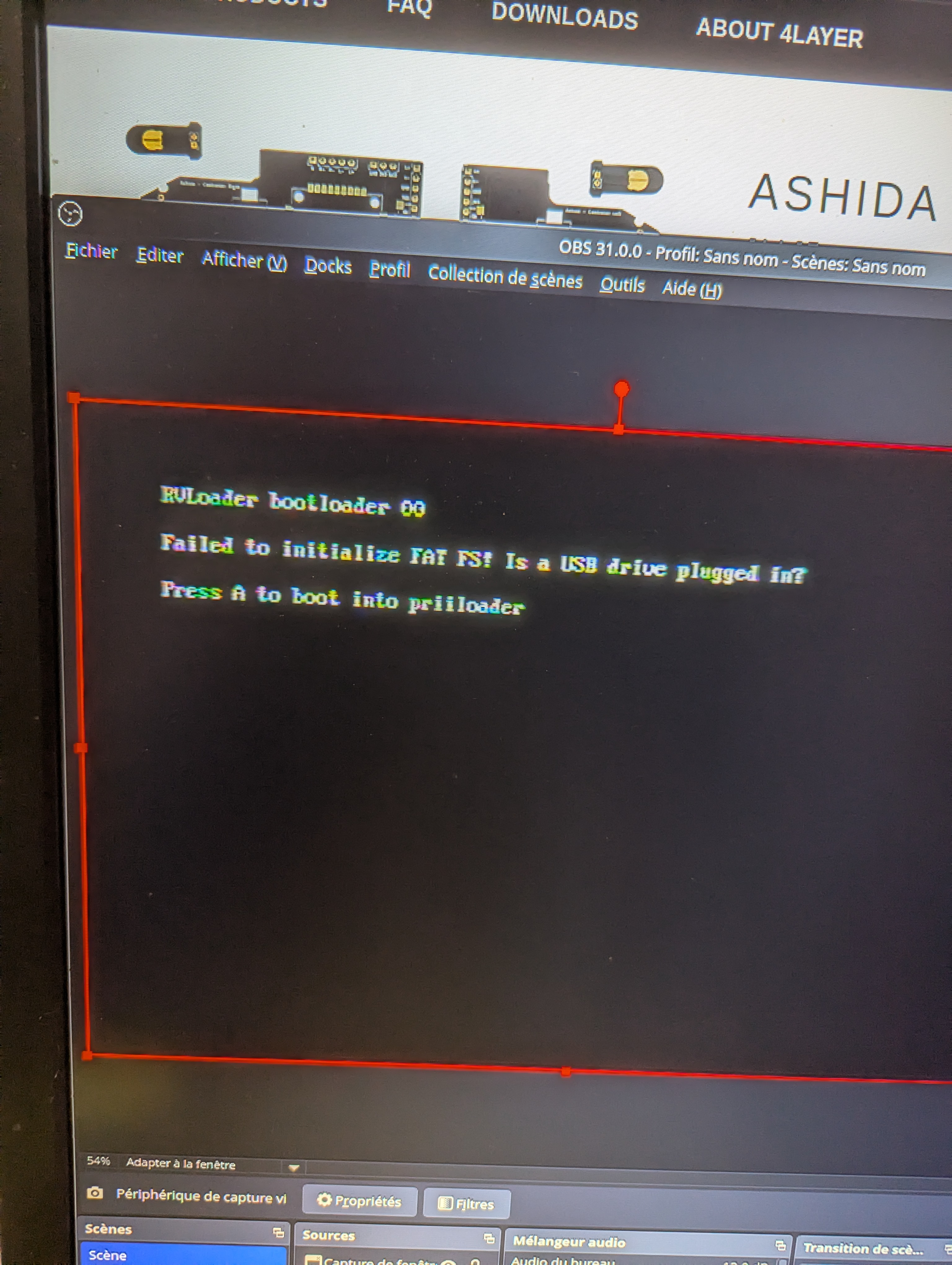

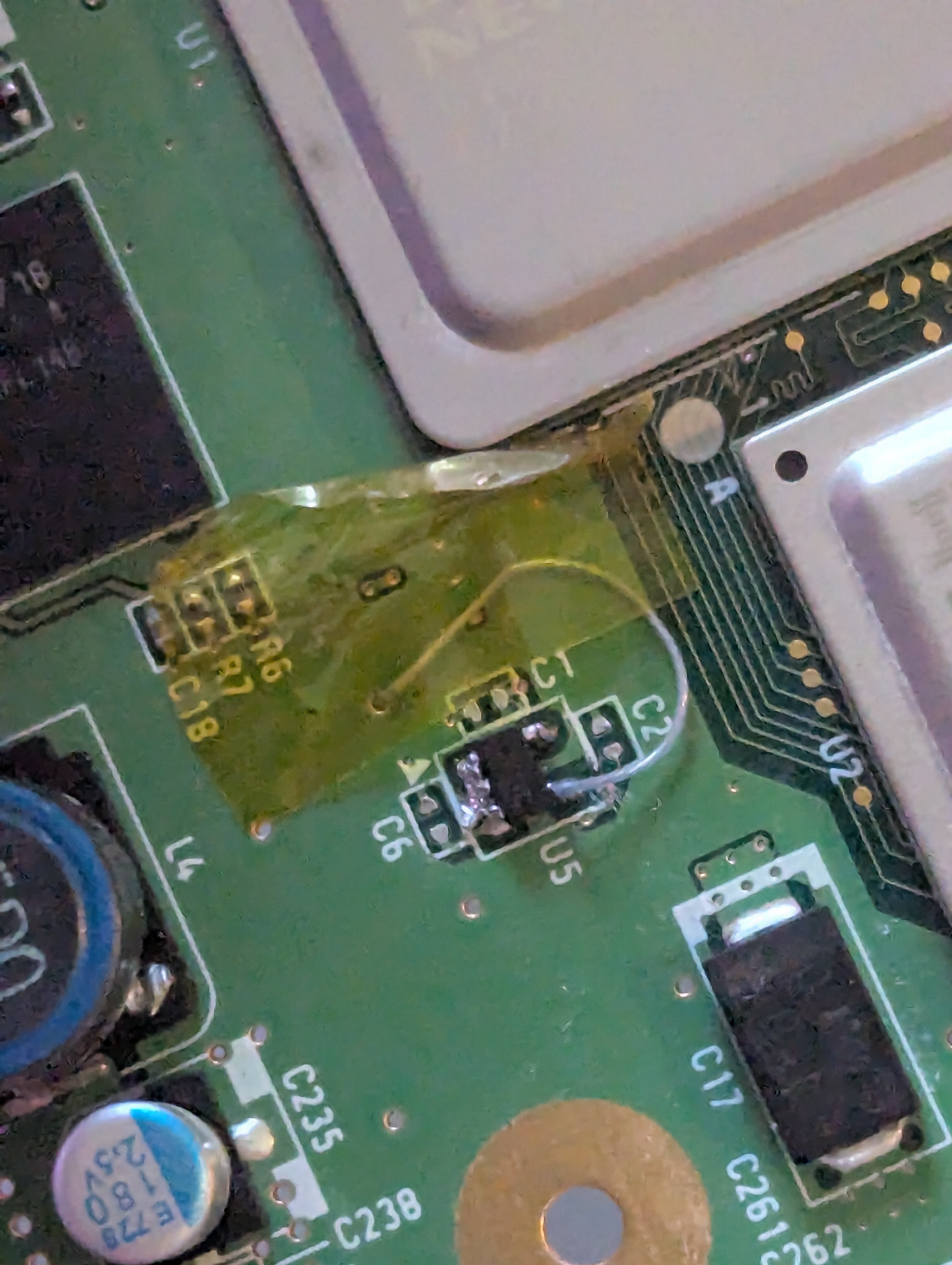

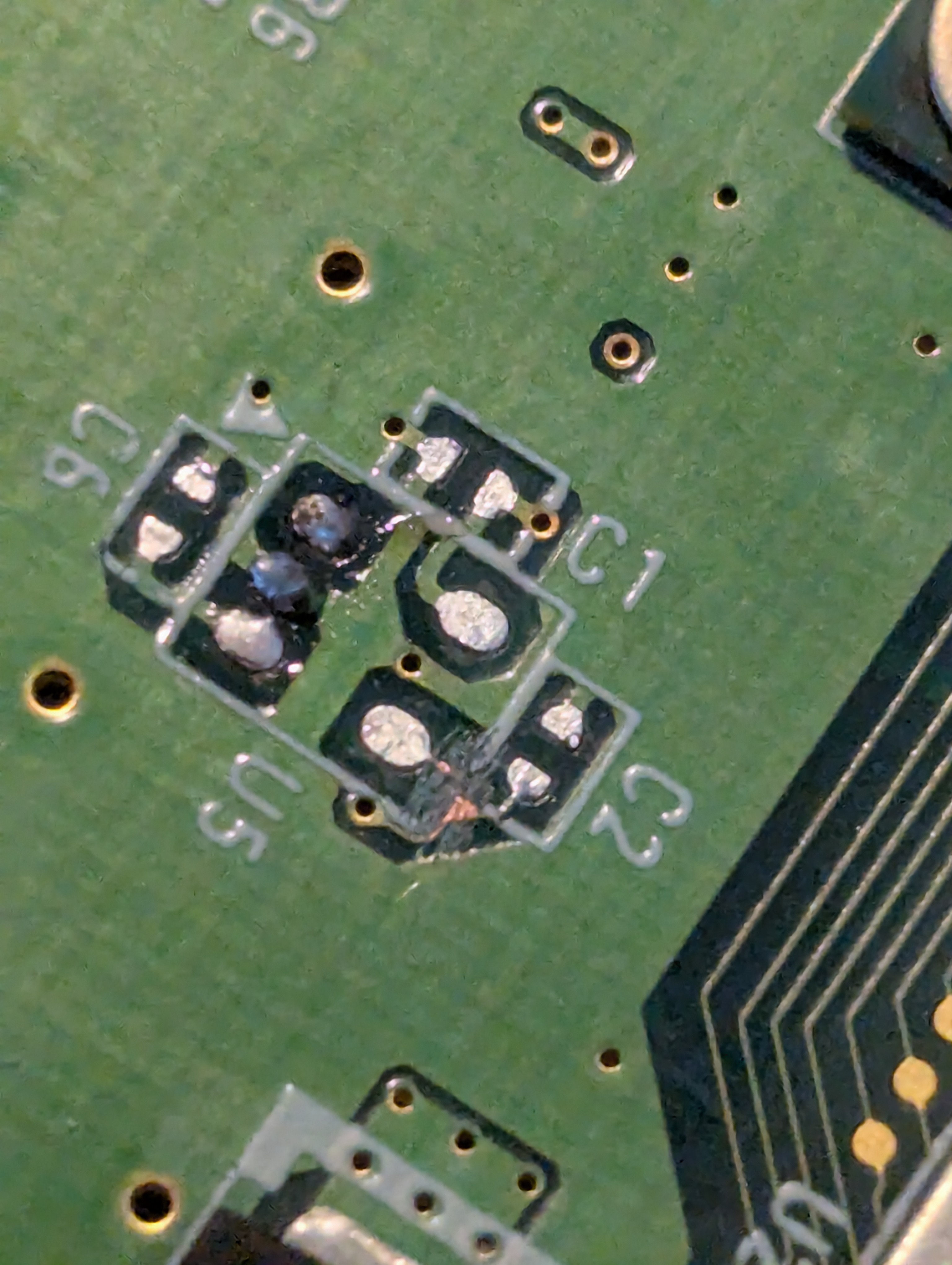

I installed RVloader on it making sure to patch out wifi. I tested it with a game and everything works fine.

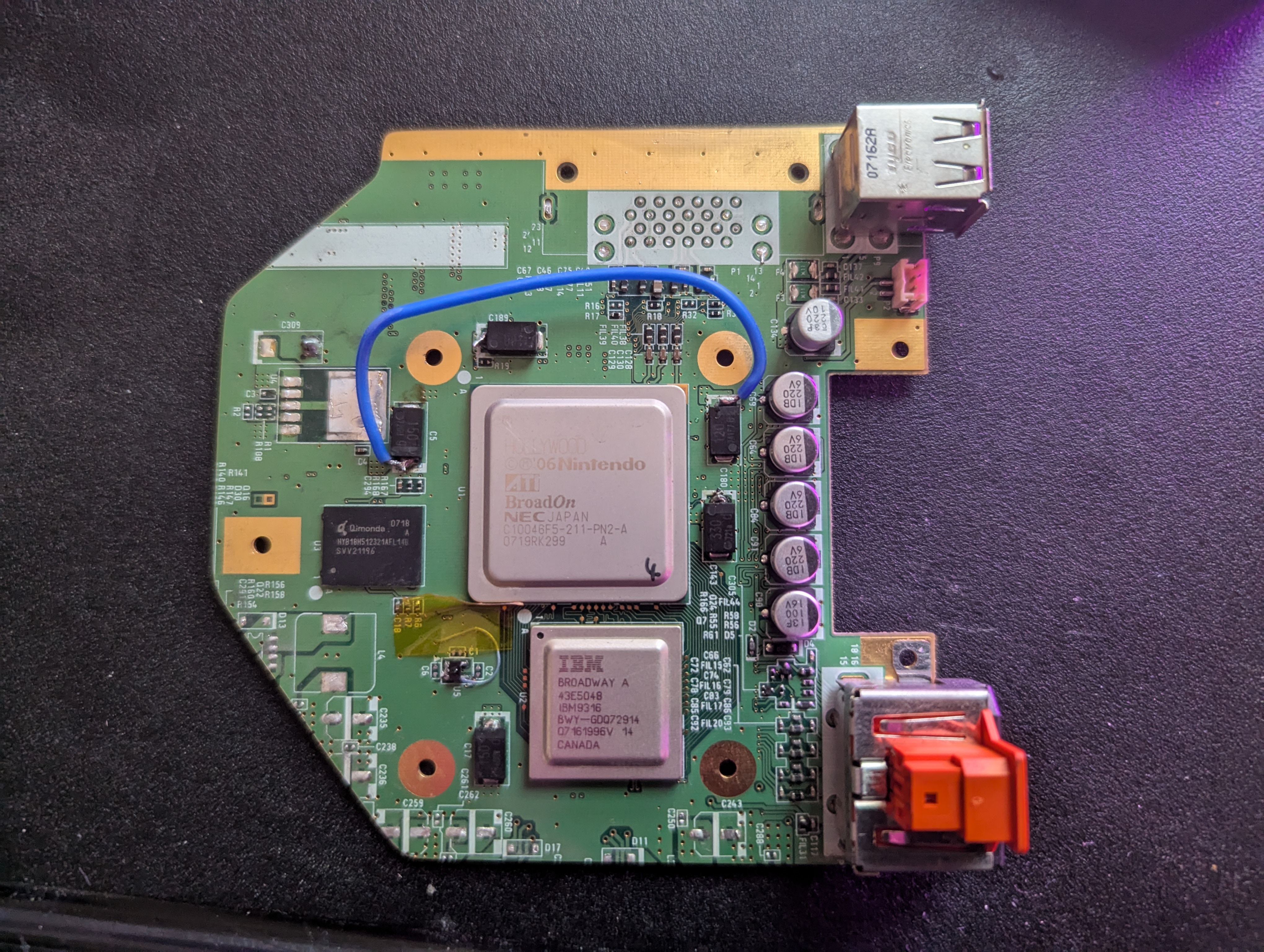

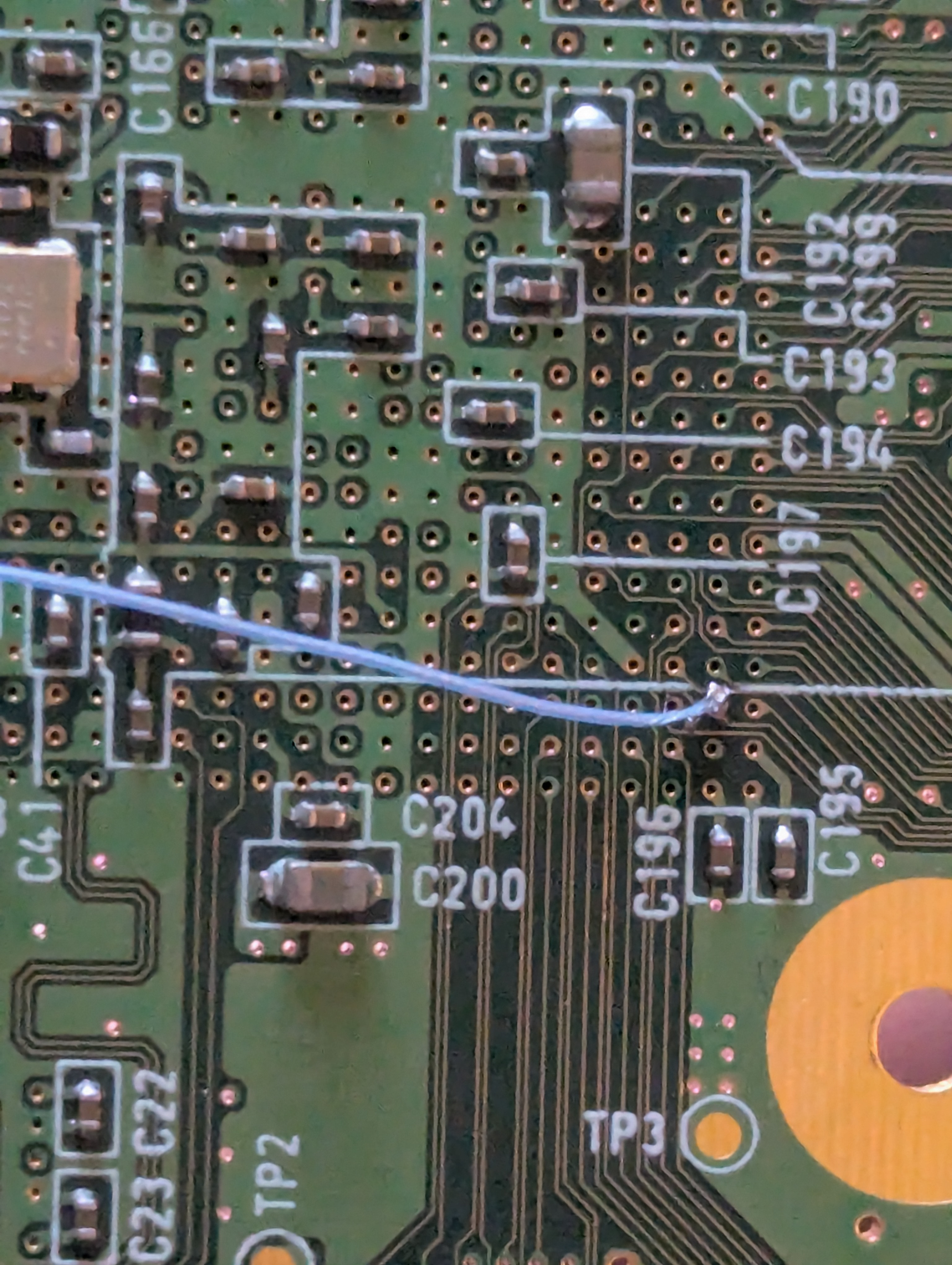

Then I relocated U10 and re-tested. And once again, It booted.
PXL_20241130_120746287.jpg PXL_20241130_125050421.jpg PXL_20241130_125033811.jpg
Then I removed the BIG memory card slot and tested once again. And it booted.

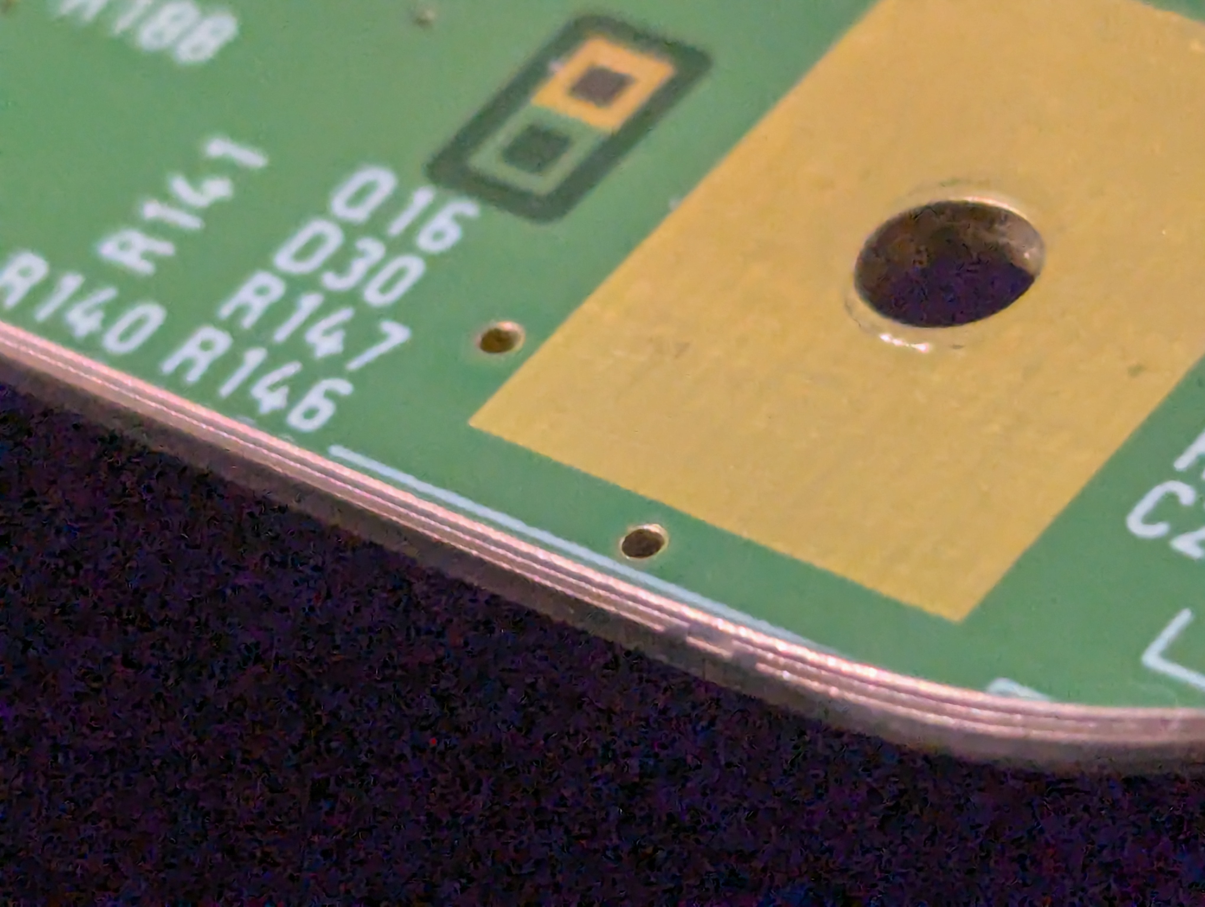

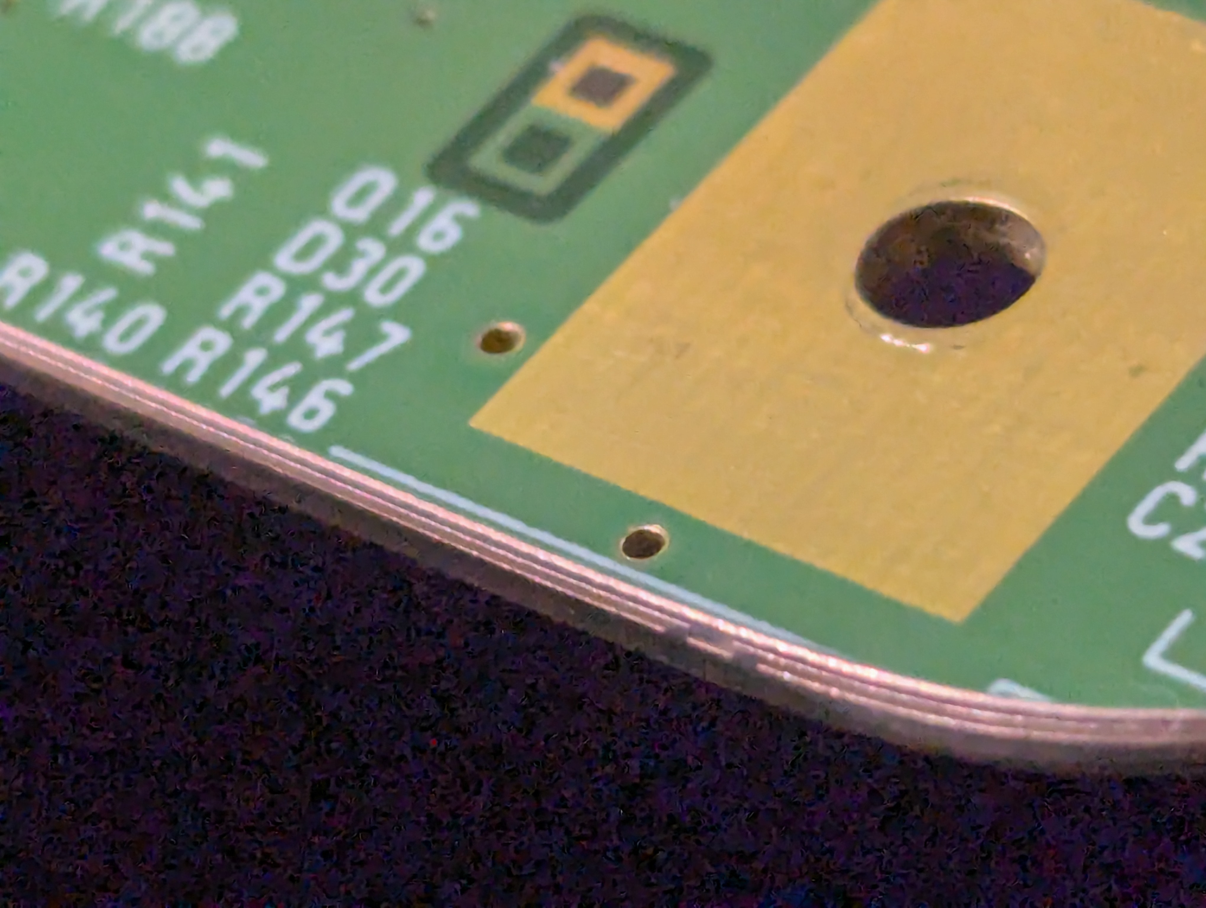

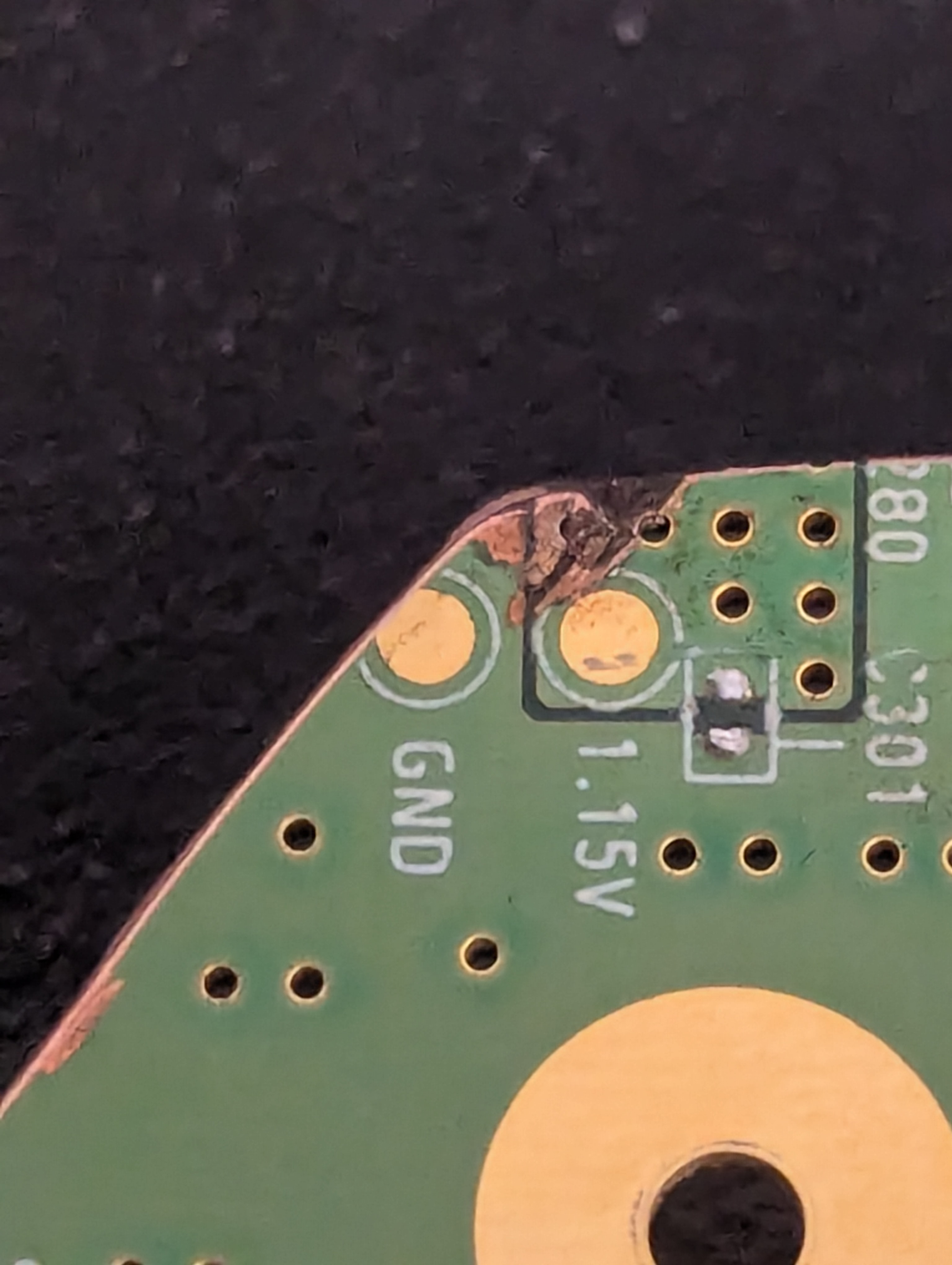

Now it's time for the trim. I made couple of errors here :
- I didn't remove components that were on the path of the dremel before the cut.
- Because of that, I ripped while cutting and damaged a corner on the cut
PXL_20241201_233314296.jpg But since C301 is removed, I hope that this dent didn't kill my trim.
- My dremel need new brushes. It vibrates a lot. Because of that, the cuts are quite rough

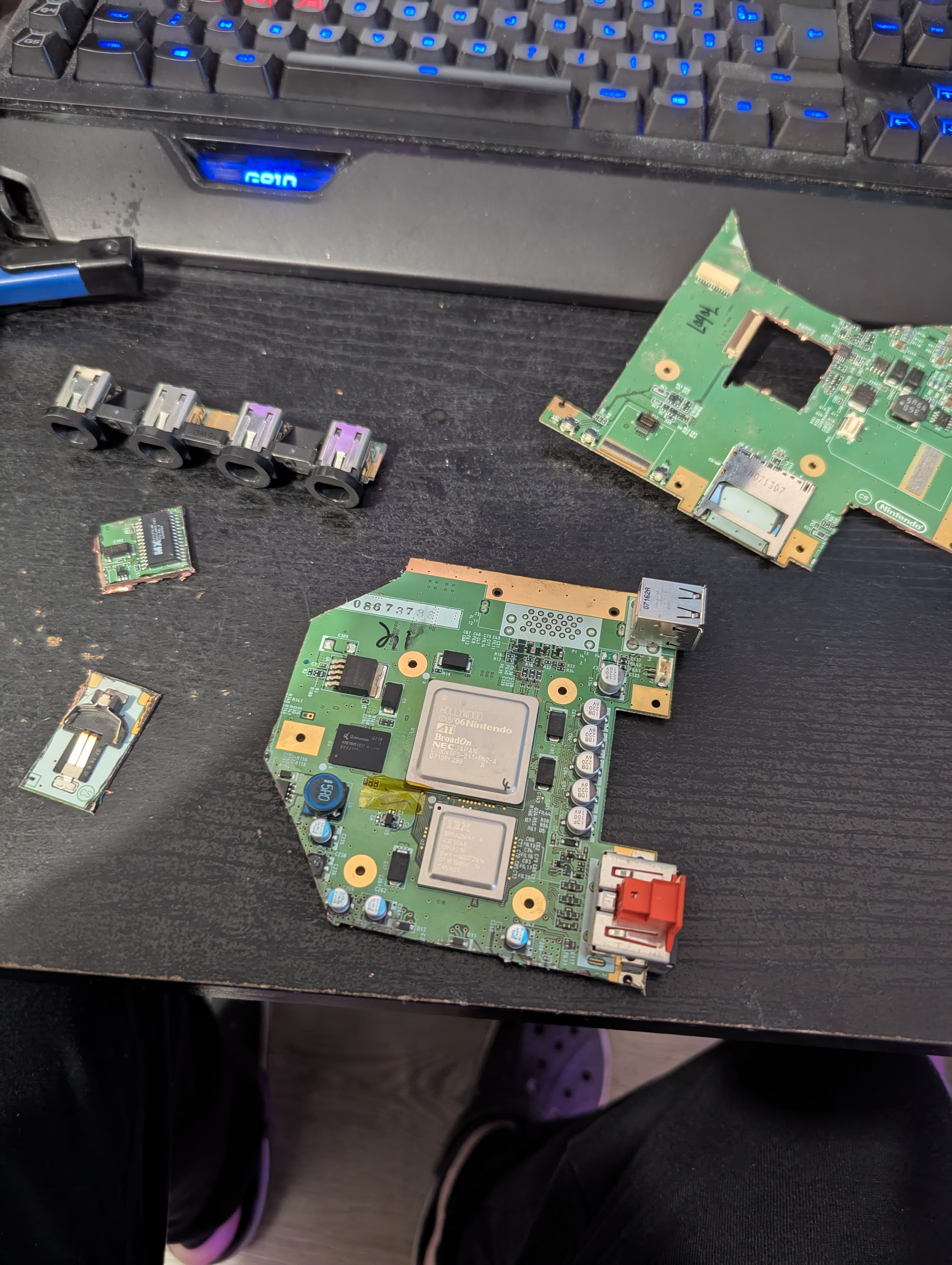

So now it's time for sanding. and removing all the components around the edges.
I got up to 600 grit since I don't have 800

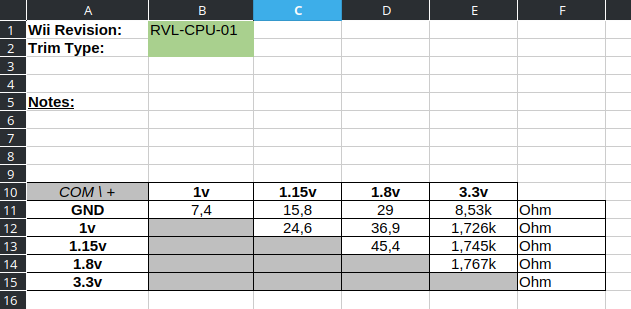

Here are my resistances values :

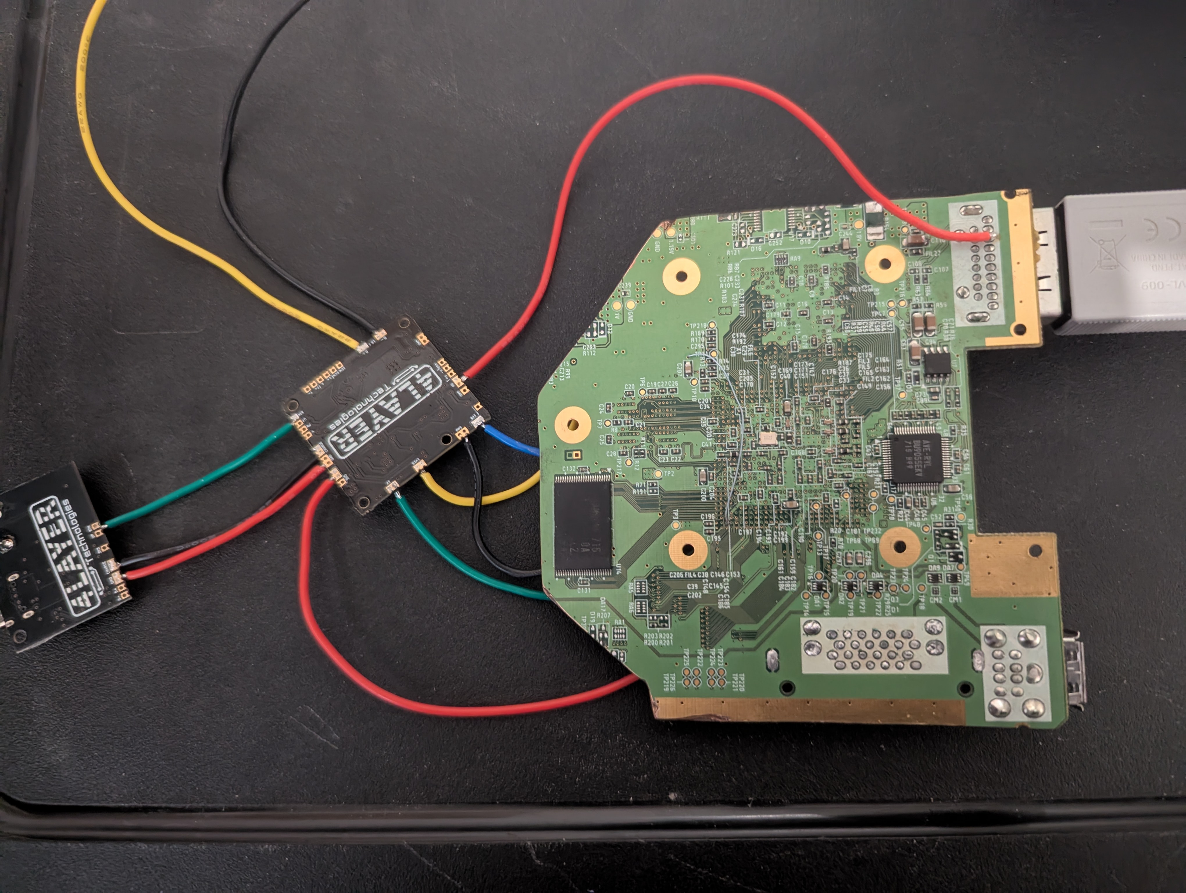

Then, it's testing time ! I hooked up a PMS and a battery (I don't know if it's possible to use the pms without a battery but I didn't managed to do it). Pushed the button and... Nothing...
The CPU and GPU get warm, voltages are good but I got no video signal.
I did a little bit of troubleshooting today and tried different things but nothing worked so far.

A few things to note it is not possible to power the RVL PMS 2 without a battery and also the RVL PMS 2 is not meant to power 6 layer motherboards (Which is the one in your pictures) it is meant for 4 Layer Wii motherboards. This could be the reason for your issues with it booting. It is recommended to use the RVL PSU Plus from Crazy Gadget for Noldendo micros builds or other micro Wii builds. You can purchase one from his Etsy. The other issues you mentioned should not affect the board and your resistances seem fine.

Yeah the 6 layer boards used in the Noldendo draw more power than the 4 layers boards and the RVL PMS 2 does not output enough power for the 6 layer Wii boards. If you're building a Noldendo you'll want the RVL PSU anyways since its powered from wall power unlike the RVL PMS 2.

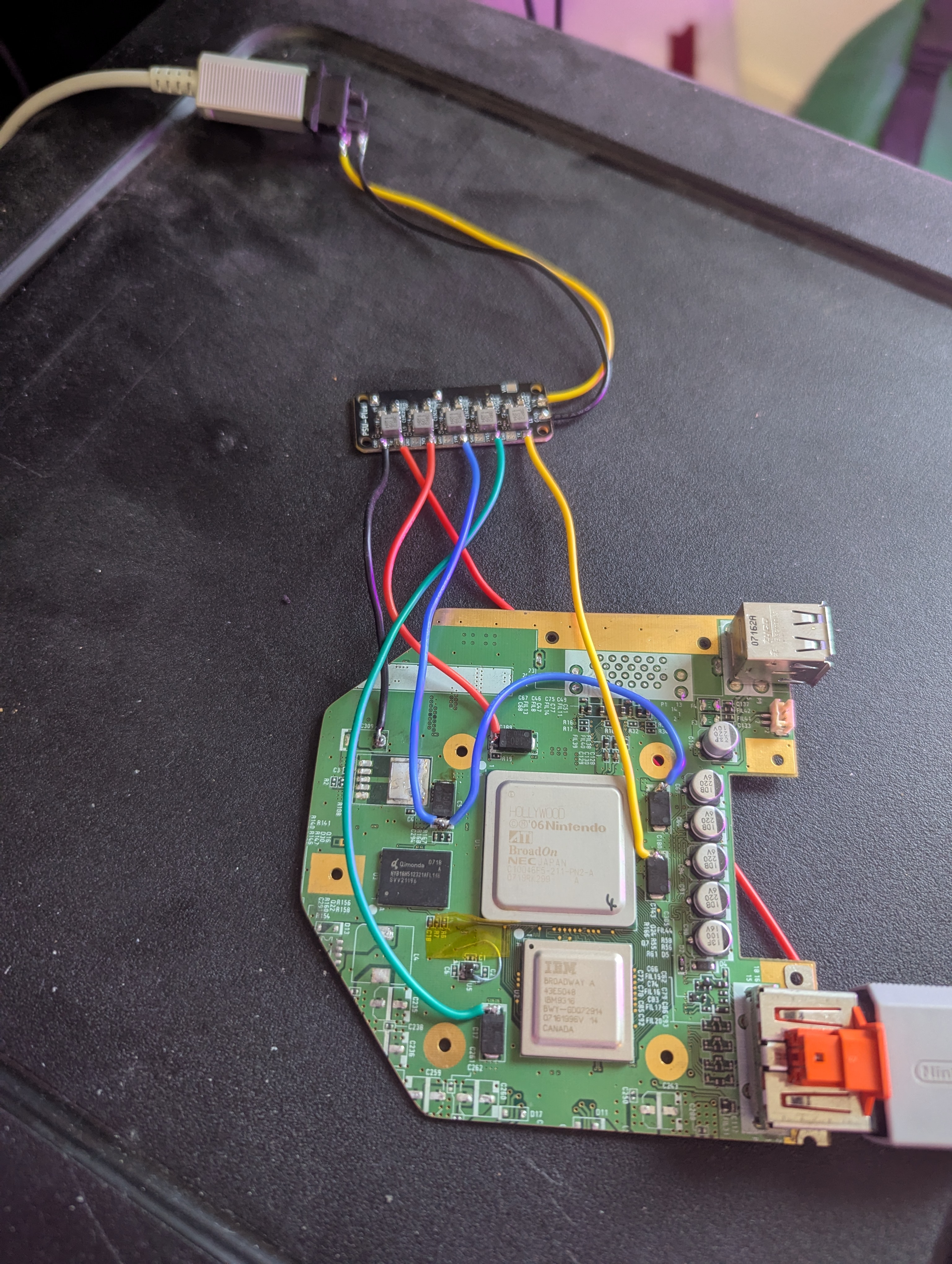

Ok so I recieved the new PSU, quickly wired it up and still no signal... I'll try to investigate the problem in the next couple of days but I don't really know where to start. I measured all the tensions and they're all good.

Did you measure that all the voltages are correct? You could try sanding again to make sure you throughly remove shorts between the layers.
I re-sanded with 800 grit. Still no signal. The edges seems pretty smooth.

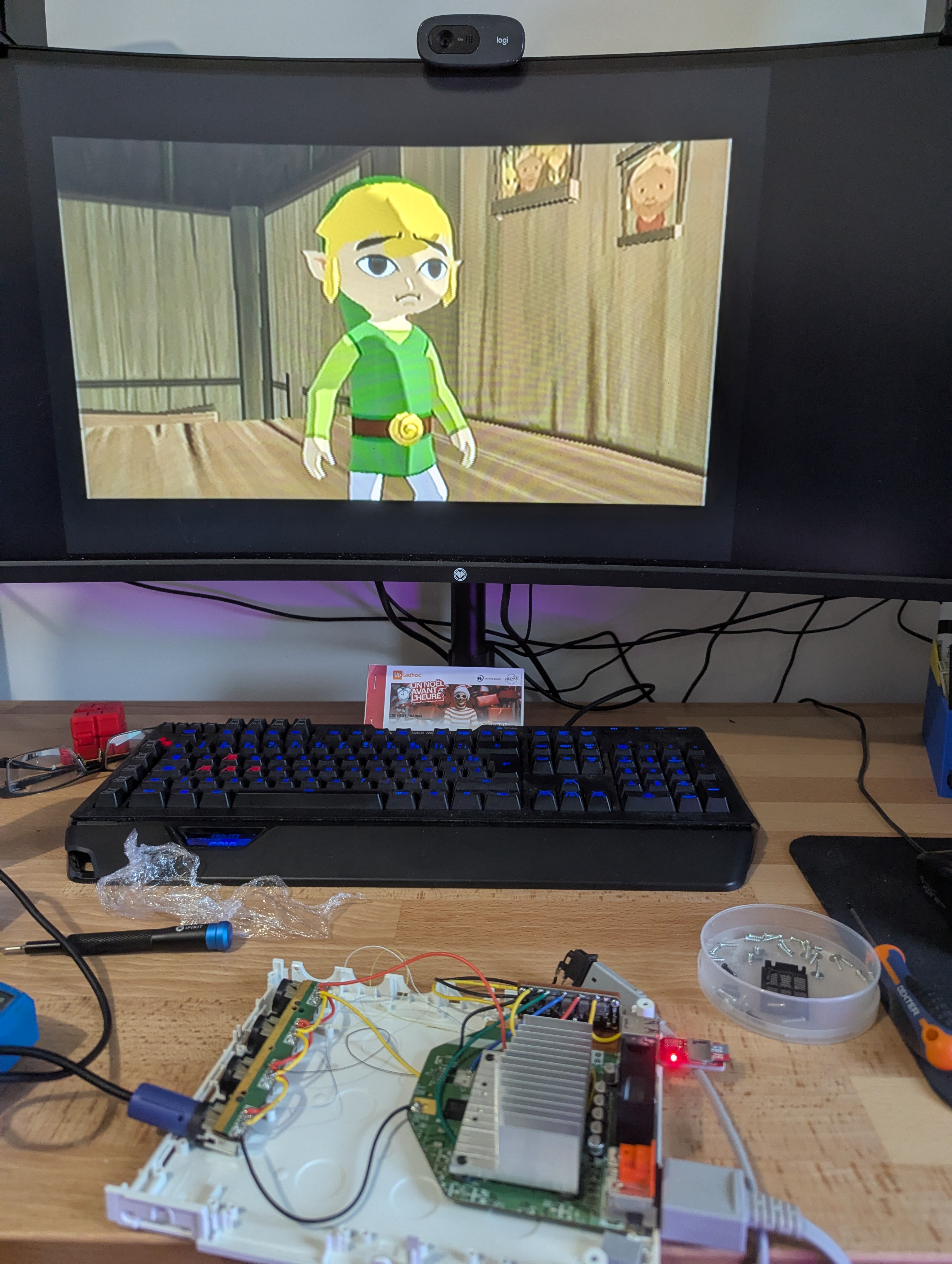

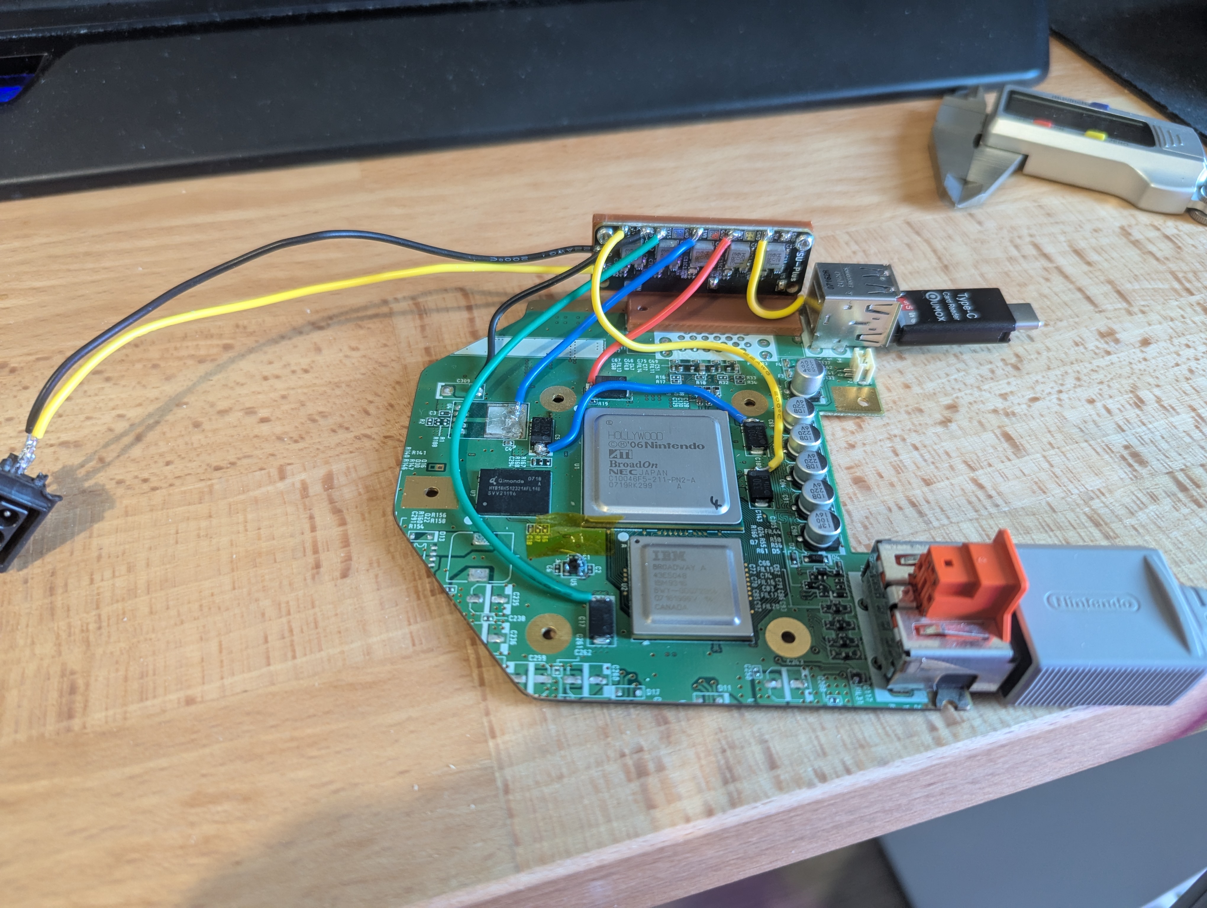

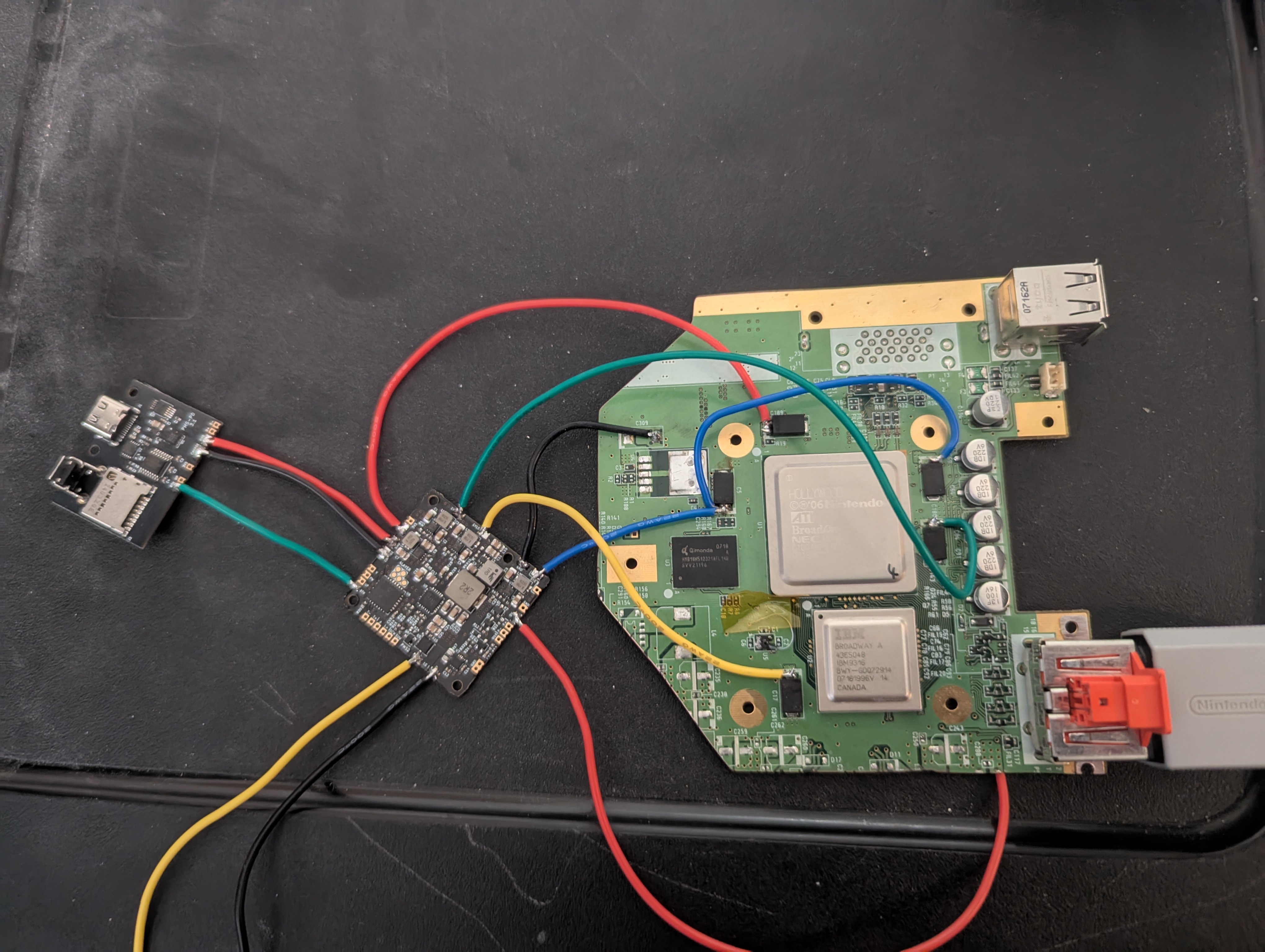

Update :
I 3Dprinted a liittle support for the RVL PSU and now everythiing is nice and tidy (kinda)
Next I sanded and wired up the controler ports. Then I mounted everythiing in the original case just to run it with a game for about an hour to see if everything works fine. And it does indeed work fine. I tested all 4 ports and they all works.

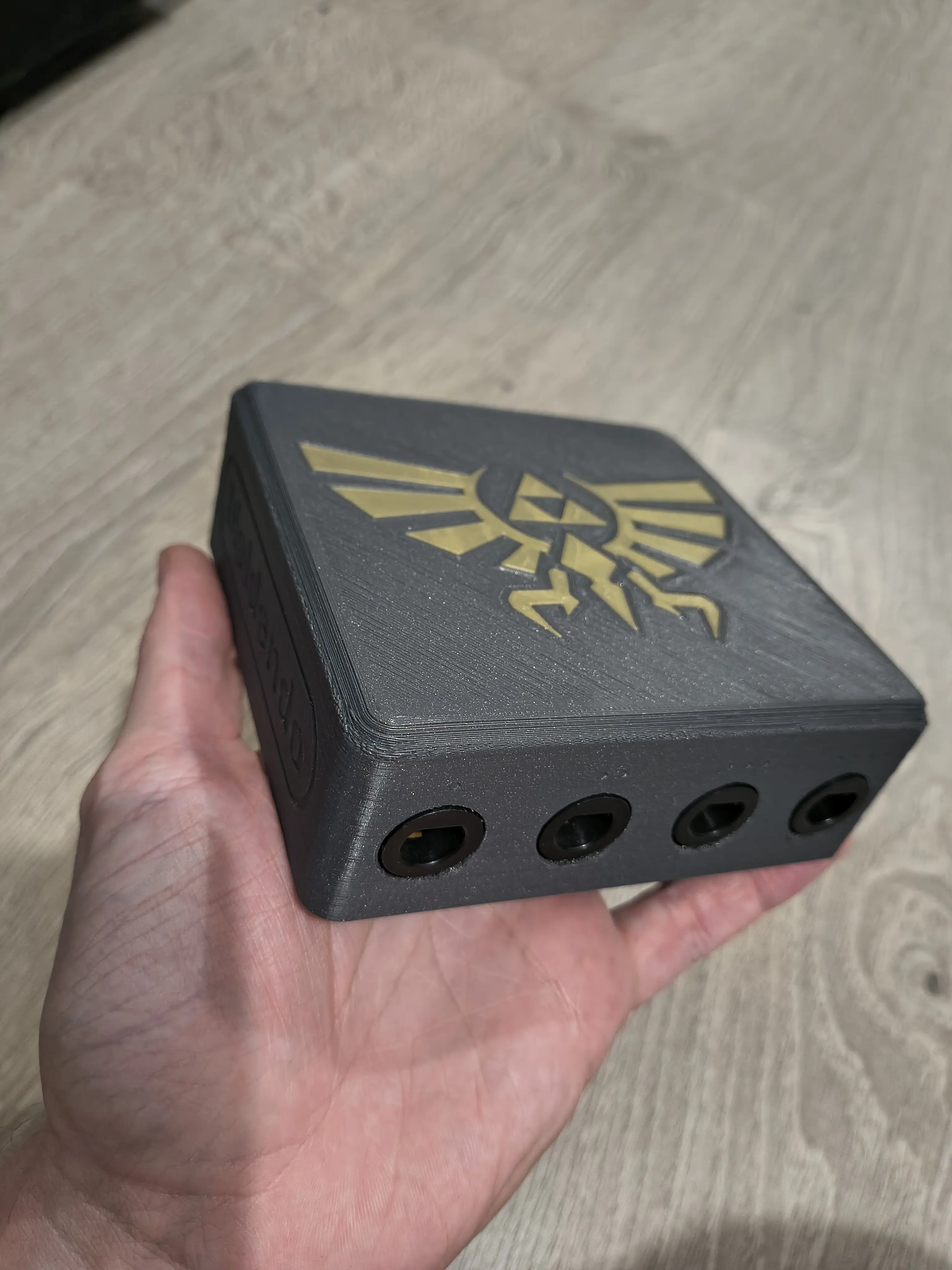

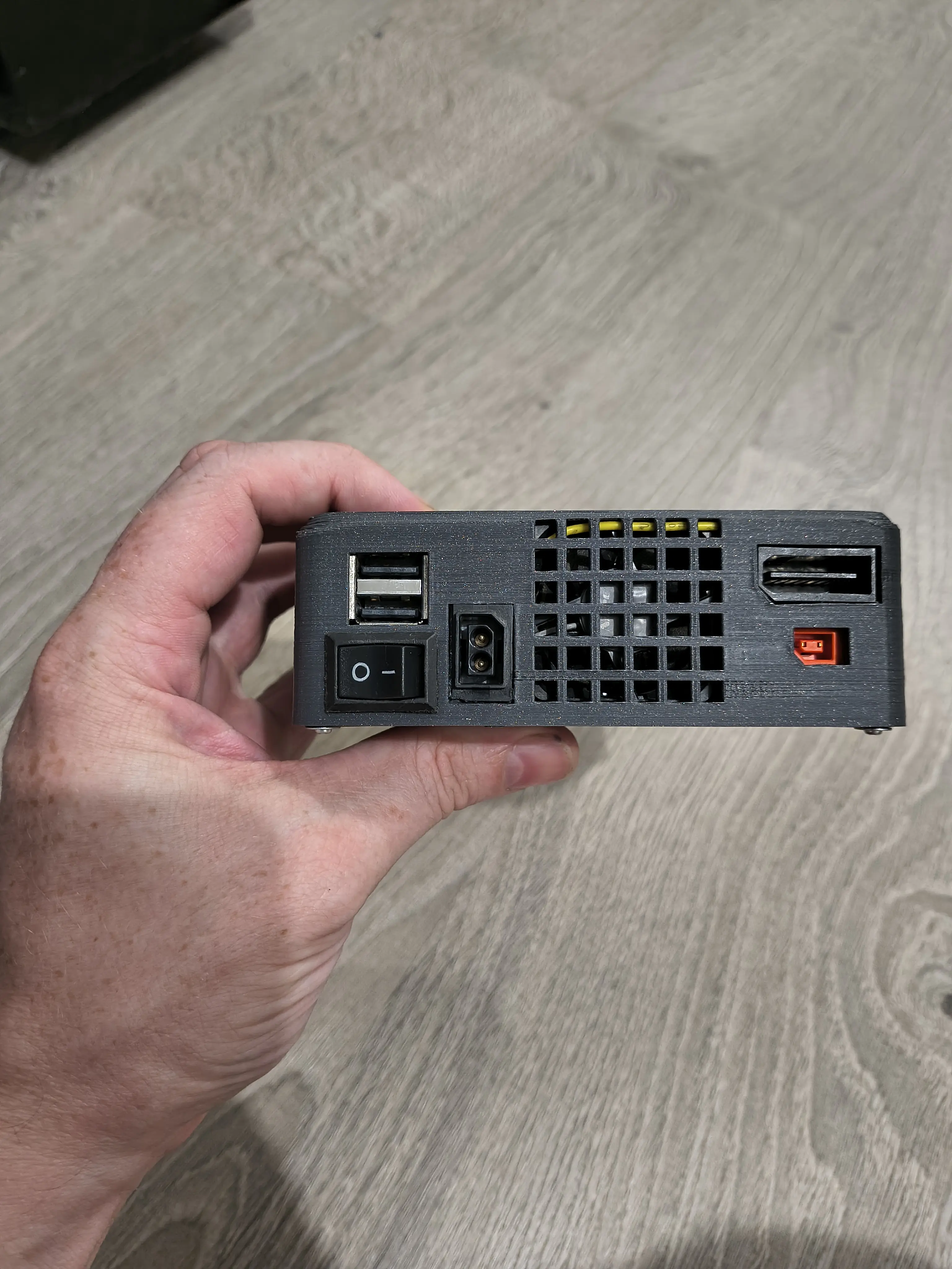

Print the case :
This one I printed a while ago. I modified it a bit to use the original PSU pport and a big on/off switch.
Also, while testing, I noticed that I needed to add 5V to the AV port for my HDMI cable to work so I did that too.
So I putted everything together and here is the result :
It works as it is. I consider it done. Maybe I'll update this post someday if I have the courage to add bluetooth.
