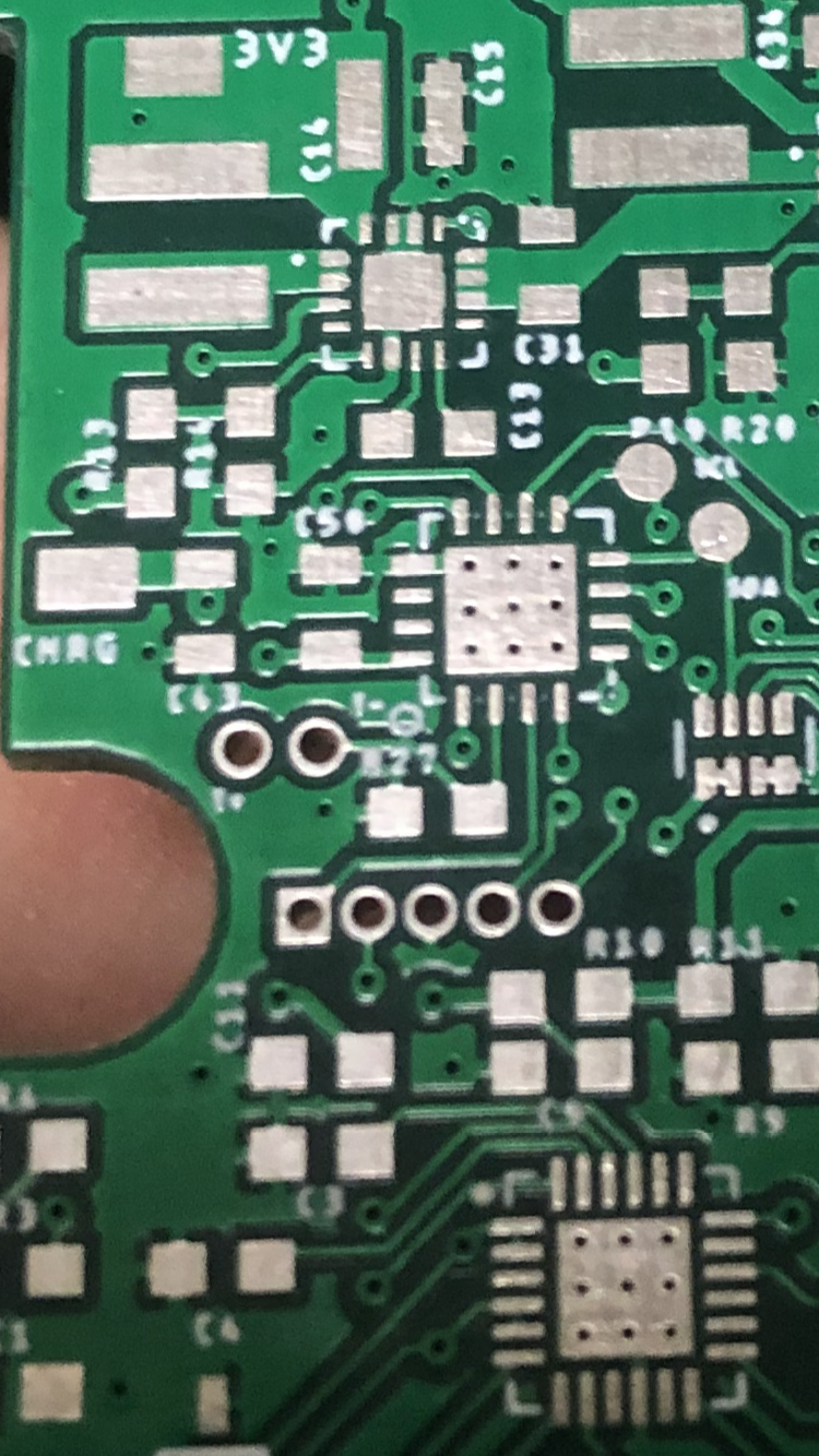

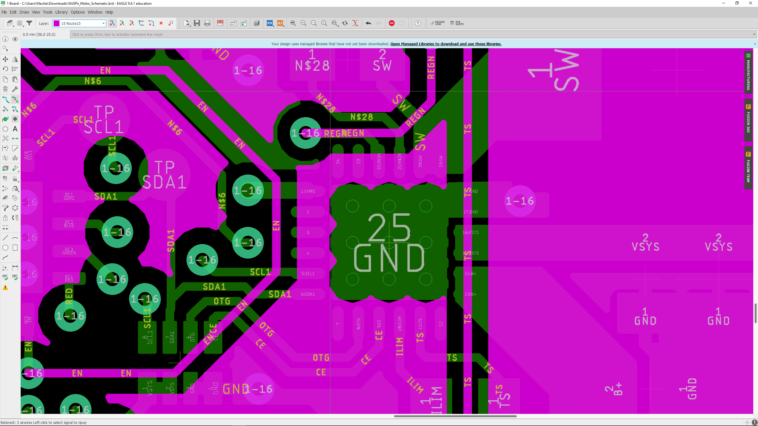

Thanks for your help! Unfortunately I don’t think that this is the problem I’m facing. Rather, I think the BQ25895 ICs thermal pad does not have a good ground connection for heat and thermal conductivity to the GND plane. Upon further inspection of the PCB layers in a gerber viewer, you can see the problem I’d discovered... for some reason the package I had used had prevented the ground plane from covering the IC, despite putting thermal vias everywhere.
As you can see below, I already had put the 10K ohm pulldown resistor for the thermistor attached to to the PIC (R27), so I don’t think that really was the problem in the end. Open to other ideas, though!
