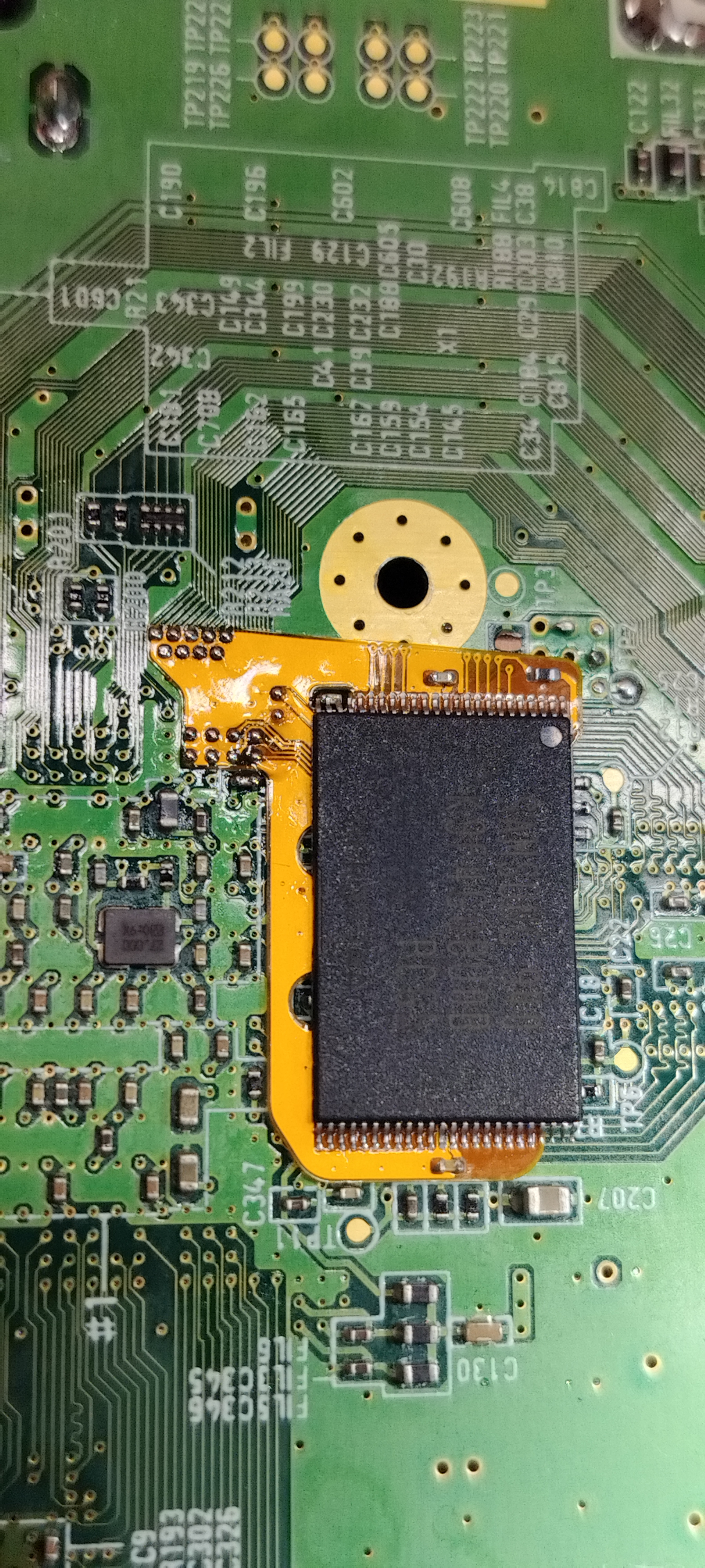

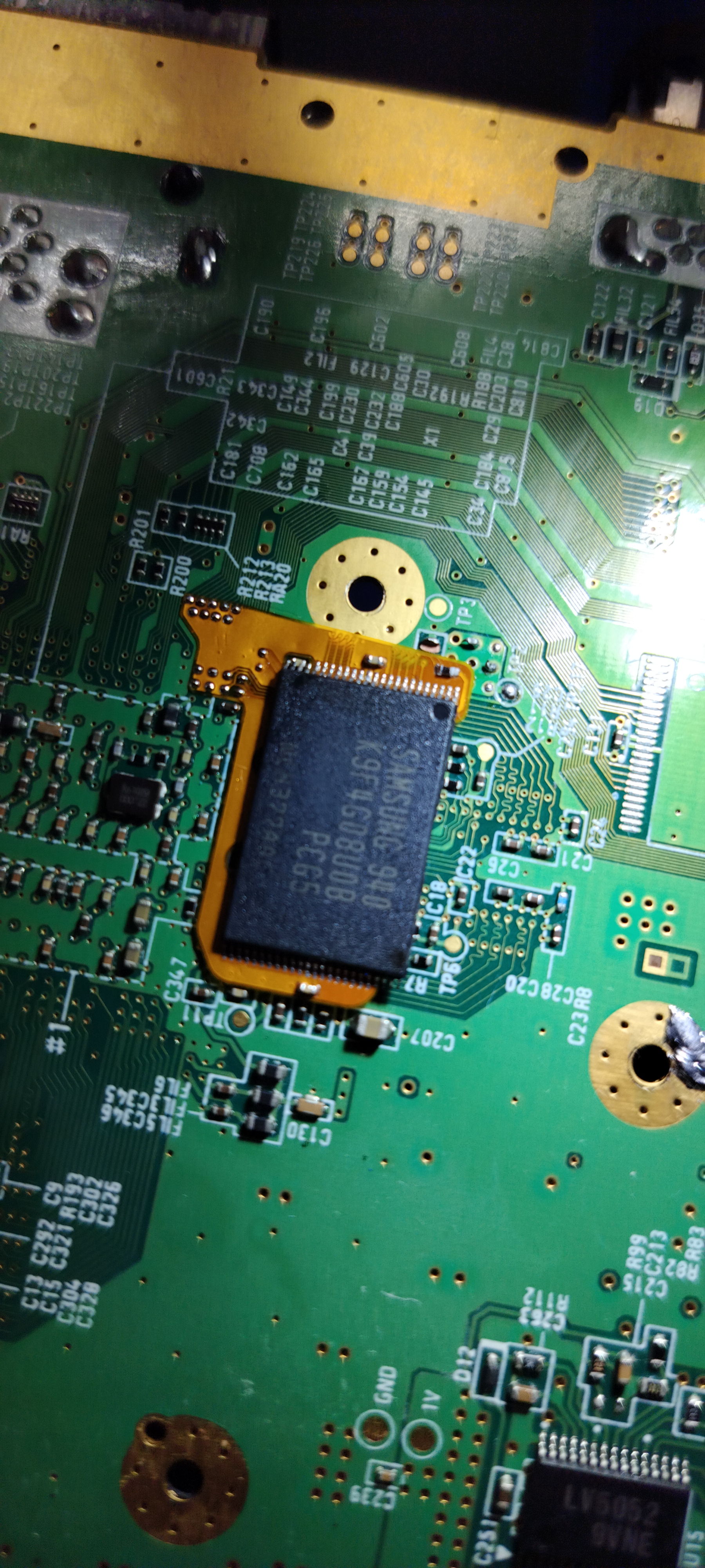

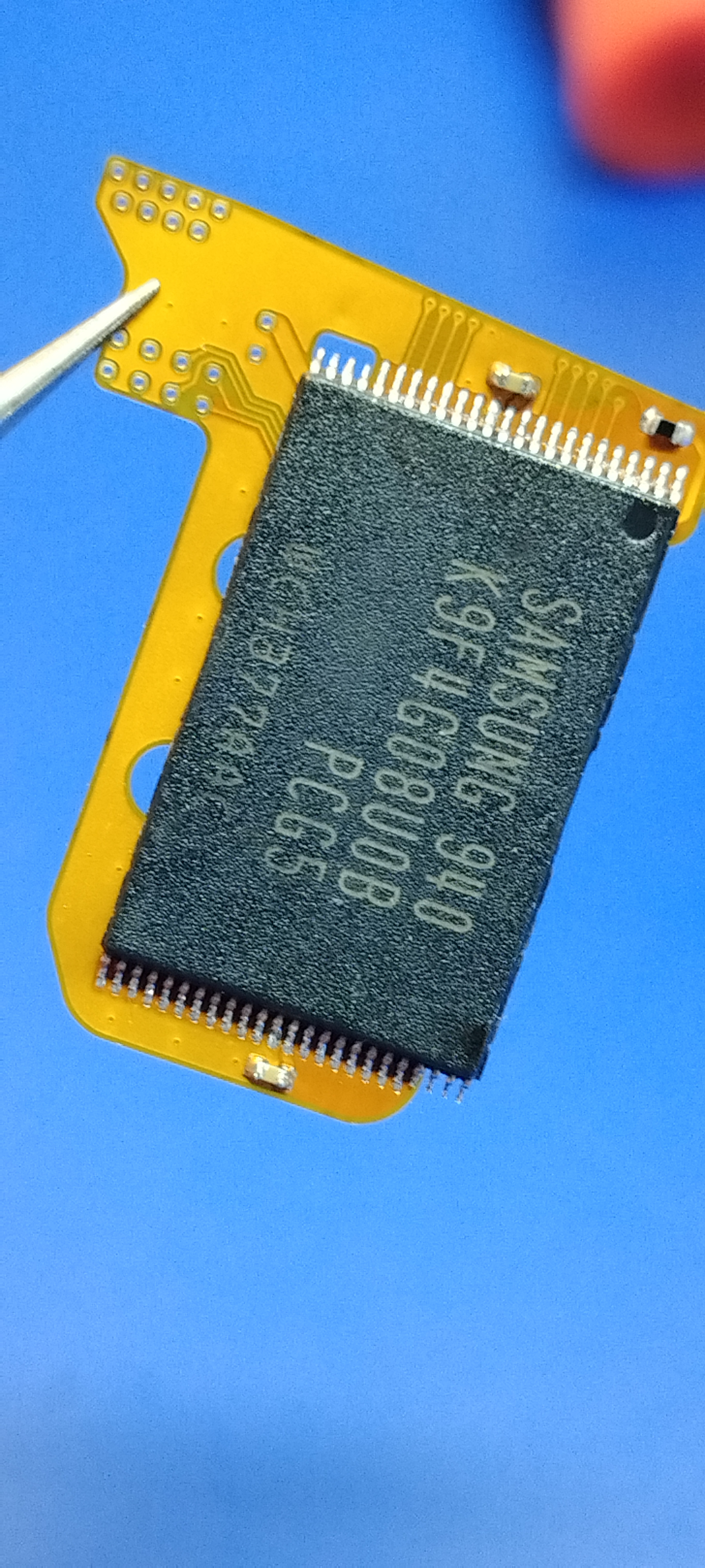

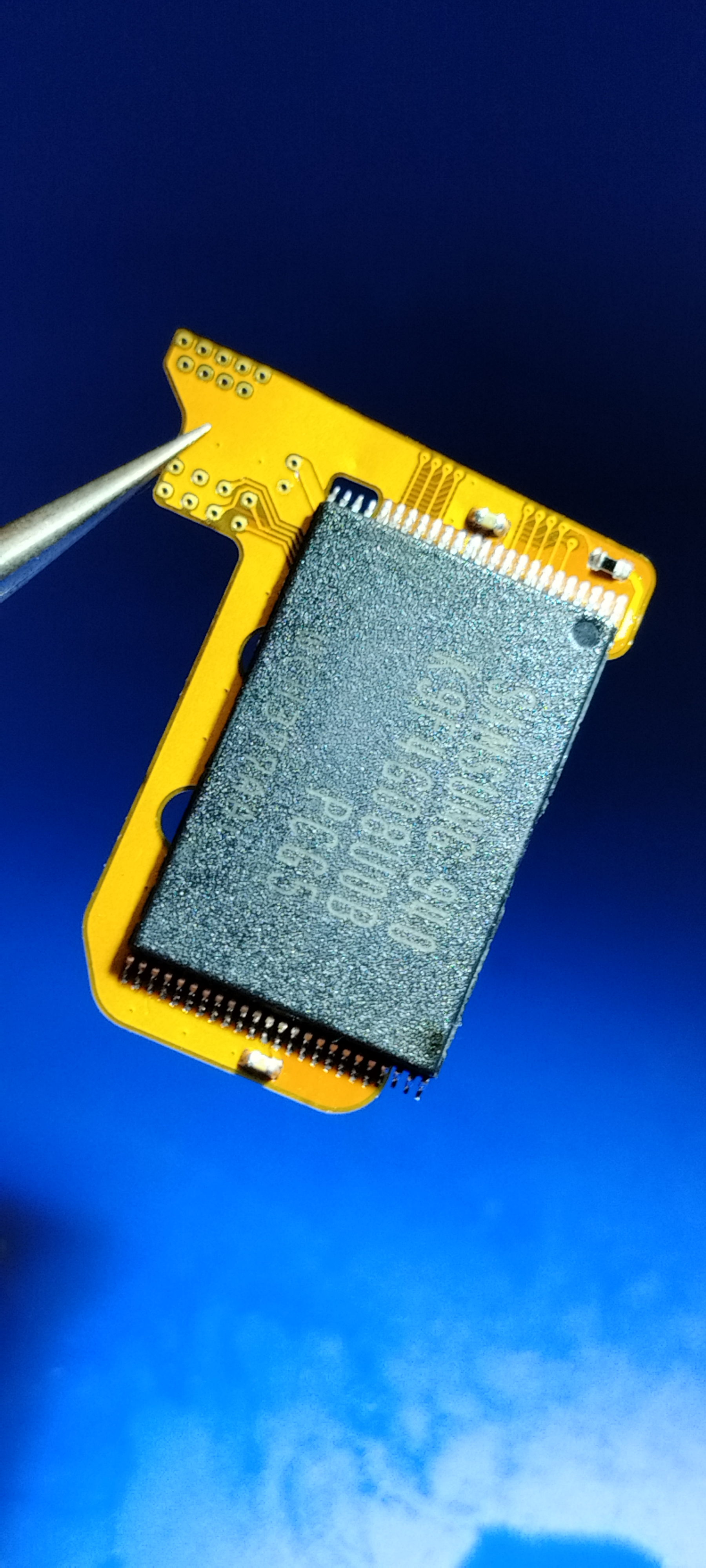

I went ahead and modded my wii and prepared it for the nand relocation. Desoldering the nand was a breeze and I used a little bit of solder-paste to tack on the nand, filtering caps, and resistor. Afterwards I drag soldered the pins and was left with a fairly clean install. One tool that has been a life-saver for these flex installs is a pedicure dremel tool with an ultra fine grinding bit. This allows me to strip these vias easily (as I have tendon problems my hand isn't perfectly steady).
Luckily it booted first try without issue.

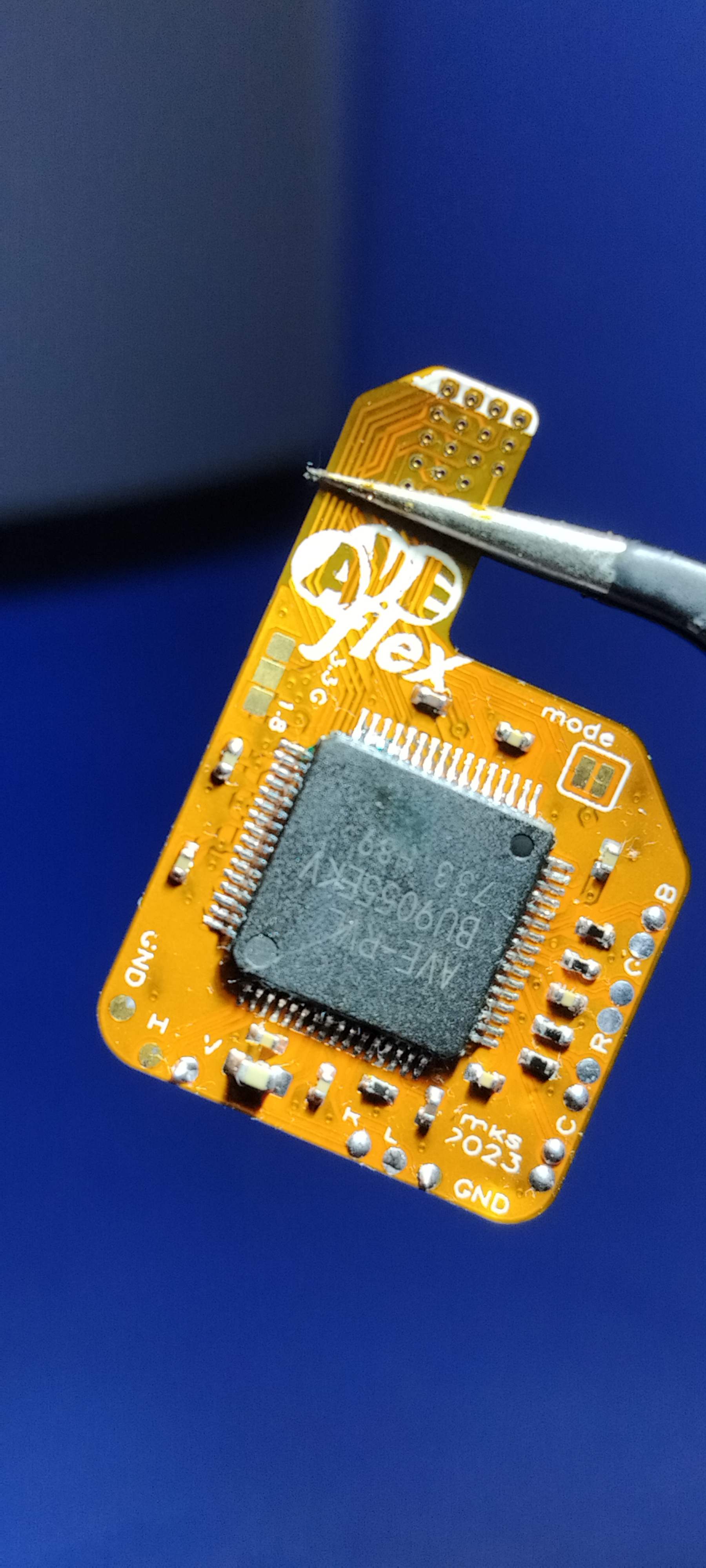

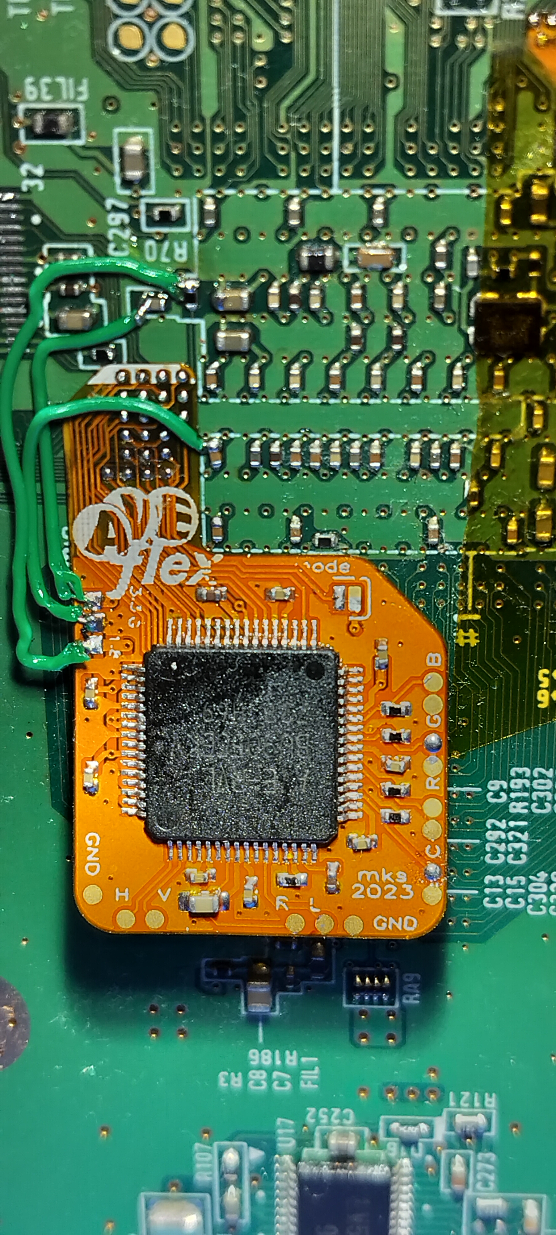

This was AVE relocation day. I happened to have a spare BU9055 AVE from another project, and transplanted it and its components onto the ave flex. Much of the same assembly-wise when compared to the nand. Unfortunately I could not get an image to post today, but will look with new eyes tomorrow. Here were the assembly pics I captured. (the wii does boot as wiimotes sync so this is purely related to the AVE-Relocation).

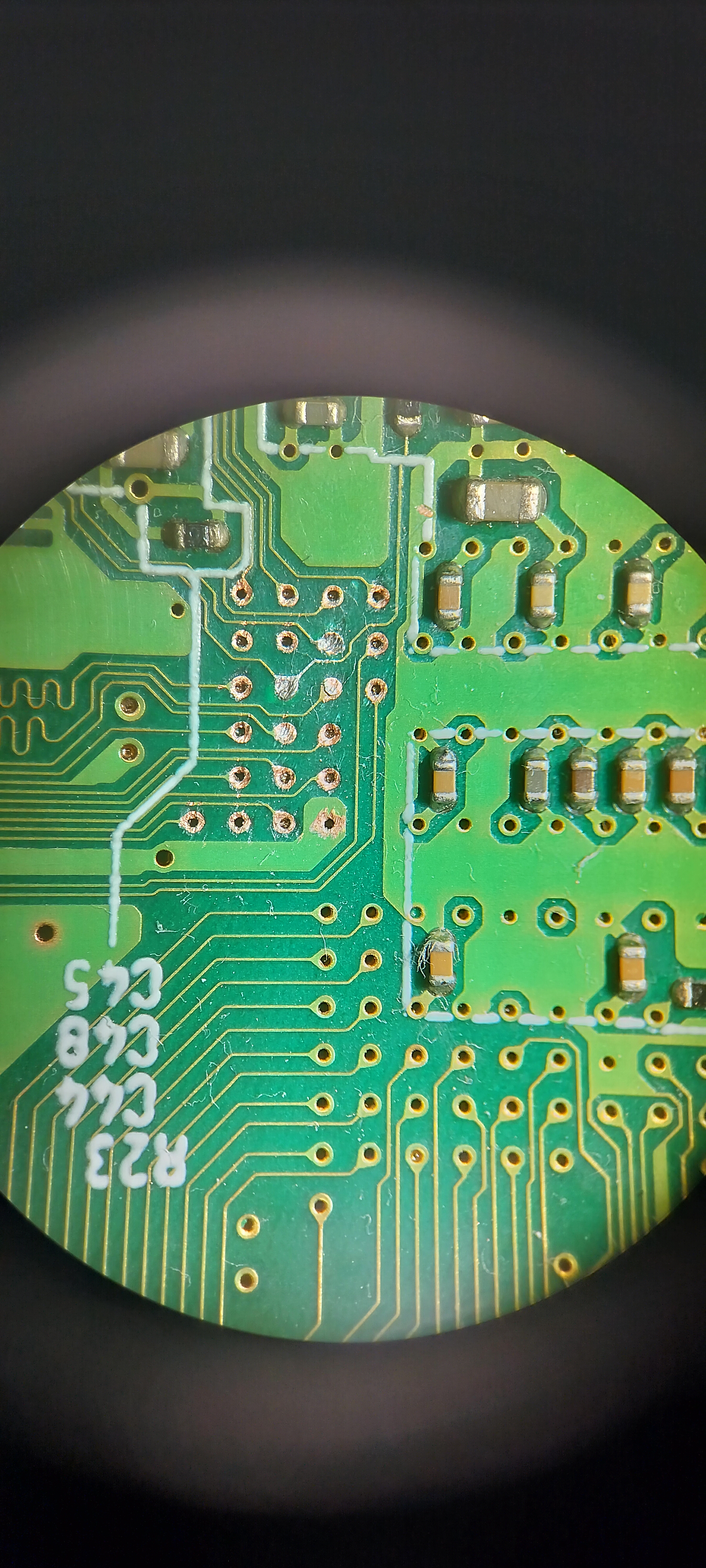

Oof those vias....... for future projects I suggest getting a Fibreglass Pencil
They look like this v
It's an abrasive tool that uses clusters of aligned glass fibers to sand stuff off of metal without damaging the metal. It doesn't require much dexterity and doesn't damage the via, but it is a slower process. They're very cheap, a few dollars each.
Just picked some up. Although in the image some vias look to be "borked" (especially on the i2c Data/clock vias) this is actually just residual solder left inside them as I was probing the i2c lines a while back.
Though this will def help in getting the vias stripped consistently. Thanks for the reccomendation.

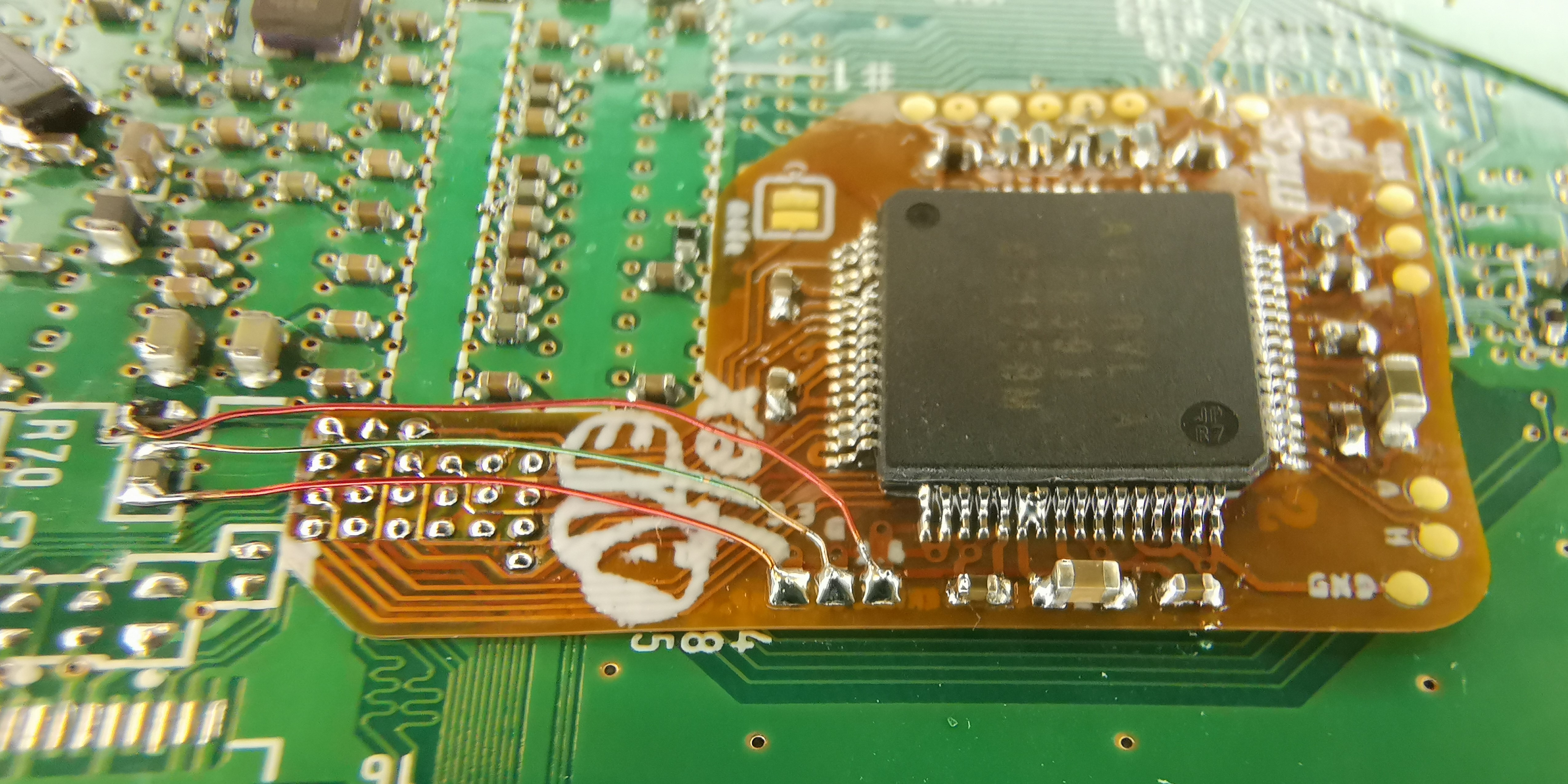

New day new me. I suspect the AVE that I used may have died (just a hunch as I recall the AVE having problems on the original wii it was on). In response I went ahead and transplanted a known working BU9055 AVE. I went ahead and built a second AVE-Flex using the components harvested from the first. However, despite my best efforts I still couldn't get video out. Is there anything I am potentially missing? Keen to hear a response.
Well, first off I'd swap that Kynar for some 34AWG magnet wire:
Did you hot air the AVE onto the flex after tinning the GND pad? If the AVE's exposed pad isn't soldered to the FPC, the AVE will misbehave.
Also, some of the AVE legs on the left side don't look well-soldered. Nudge each one with tweezers under a magnifying glass or microscope to confirm they are soldered properly.
The GPU vias look good, but you should check for continuity between the original AVE pads on the motherboard and the AVE legs on the AVEflex. You can also check for shorts between all of the data lines.
You have solder on the G pad, G is Green of RGB, not GND. There is a GND pad available right next to the Composite pad

I managed to get video output!! Unfortunately the way I got there was a bit odd, I swapped in the Original Bu9955 AVE and it worked without a hitch after drag soldering and touching up some of the surface mounted resistors/caps. Unsure if the very first AVE was cooked, but this confirms the second one I was using to be faulty. I may keep this trim as is or carefully desolder the flex and assemble another flex for the BU9055 AVE. Unfortunately I am pretty busy with work until Wednesday.
