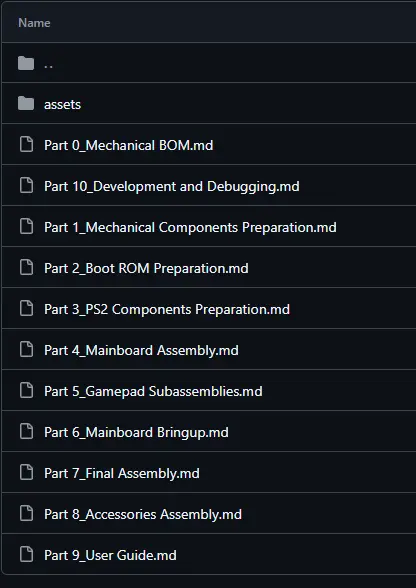

  • The whole assembly documentation is also pretty complete, I think I managed to describe everything needed to build the full portable, including some guidance on how to use it.
  • The BOM for both electronics and assembly should be quite complete
  • I upgraded the bios of the first portable to one I generated using my custom build of PS2BBL - it successfully boots into OSDSYS when no config is found!

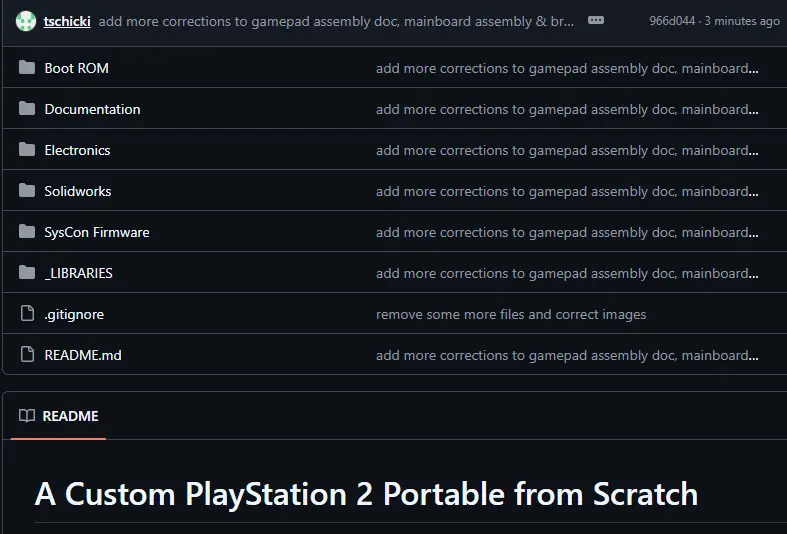

  • The git repo for the whole project was prepared and is up on github already, but still set to private until the release

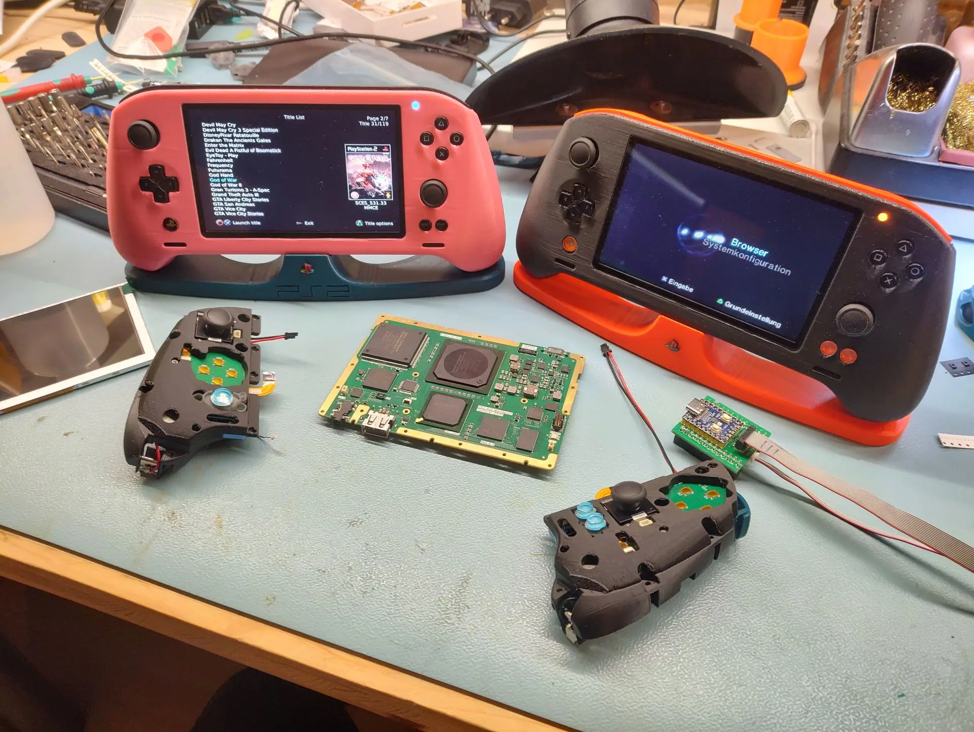

Third Portable:
Last & this weekend (very little time currently) I was assembling the mainboard for the third and most likely last portable.
I already got it to boot first try again (third in a row!), even though I had some issues this time - I managed to use some old solder paste from 2019, which has terrible flow and an almost impossible to clean flux! On top of that the reflow oven showed a thermocouple error in the middle of the bottom layer reflow and during the top layer reflow the fuse popped, just before it hit 240°C. The fuse was on me for using a 6A fuse for 2kW heating elements, the rest was really bad luck :P
In the end it still worked out though! Luckily, because the donor console for it was a nice 90k with 2011 datecode!
The left and right gamepad subassemblies were done Thursday night, and I added some corrections in the respective assembly procedure. Once the heatsink is here (probably next week), I will focus on fully assembling the third portable using the documentation.
After adding all the necessary corrections in the docs I think it's just a matter of moving things around, exporting all the STLs / STEPs, ensuring that all gerbers are present, finishing the readme and preparing the cutting edge post!

Hello, very impressive project
The GitHub files are currently private.
Can you say something about the release date?
Thanks! All design files were released here.

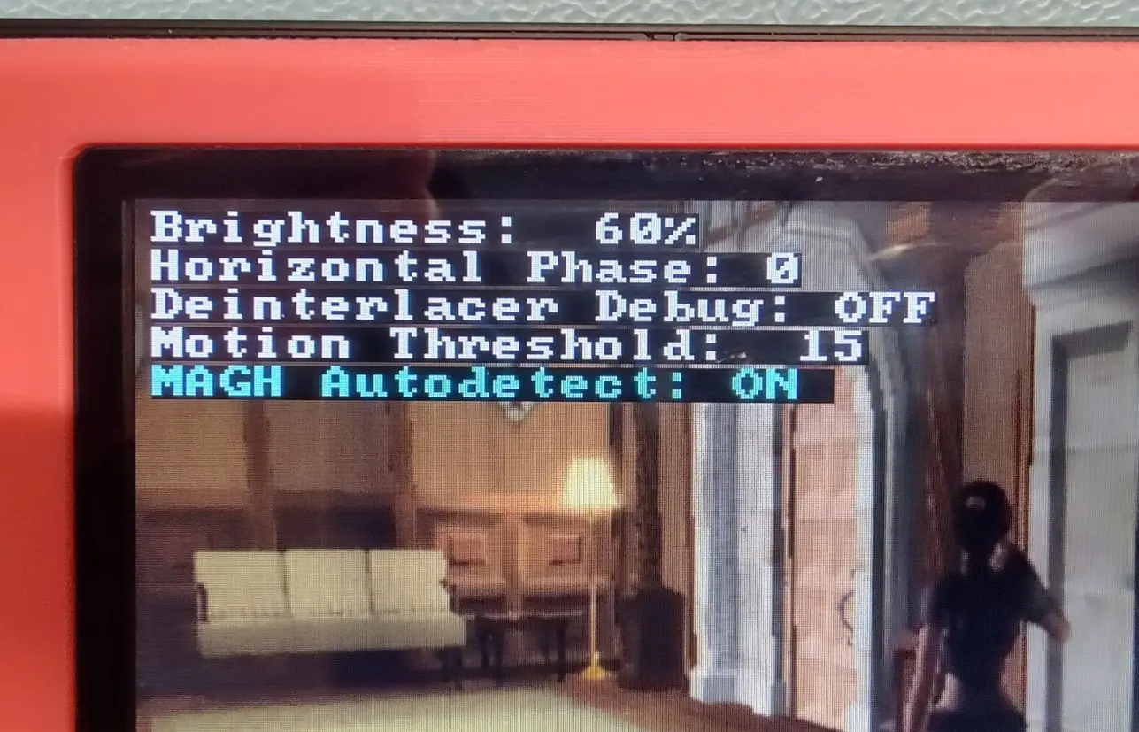

Small update:

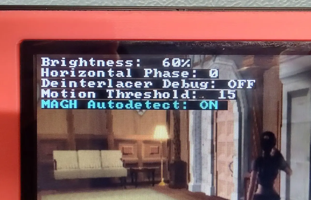

After thinking about the implementation for a while, last week I was working on the last planned feature: MAGH auto-detection.
Over the last months I noticed that for some games the MAGH value, or horizontal resolution, is not static - you have to enter the menu and change it manually multiple times. PAL GOW 1 & 2 were the worst offenders – the game itself runs at 512ix512 (MAGH 4) and all FMV scenes run at 512ix640 (MAGH 3).
It’s annoying to keep changing the settings, so I was looking into a way to adjust it automatically. For this I wrote a module in the video processor that runs in parallel to the regular data path. It essentially iterates through all video data for each frame to determine the currently displayed horizontal resolution, i.e. the MAGH setting. That’s a lot of data to analyze - at 2560 subpixels per line this leads to about 33 Megapixels of data per second. The output is the estimated MAGH value that connects directly to a video processor register the SysCon can read.
In the SysCon menu I added another setting called ‘MAGH Autodetect’ which, when enabled, will poll the estimated MAGH value from the video processor at about 250Hz and recalculate the video settings automatically - if there is a change.
Even though this new feature is quite simple overall, I was surprised by how well it worked in the games I tested, even with PS1 games via DKWDRV! There are some limitations, though: This is the only module that operates by analyzing the raw video data, so the result heavily depends on what is displayed. A full screen of a single color will not lead to a valid MAGH estimate for example. I can also think of a couple edge cases where the MAGH detection can output incorrect values, but I haven’t seen those so far outside of my simulations.
Interestingly, some PS1 games I tried seem to run with a MAGH setting of 7 (i.e. 320p horizontal resolution, or 8 subpixels/pixel) and also get detected accordingly.
But correct detection is not always desirable: here, a MAGH value of 3 (i.e. 640p horizontally) will lead to a sharper image overall - This would be free 2x integer scaling. That’s why I added an edge case here where MAGH 7 is always detected as MAGH 3.
I already pushed the new feature to the repository, along with some other corrections in the documentation.

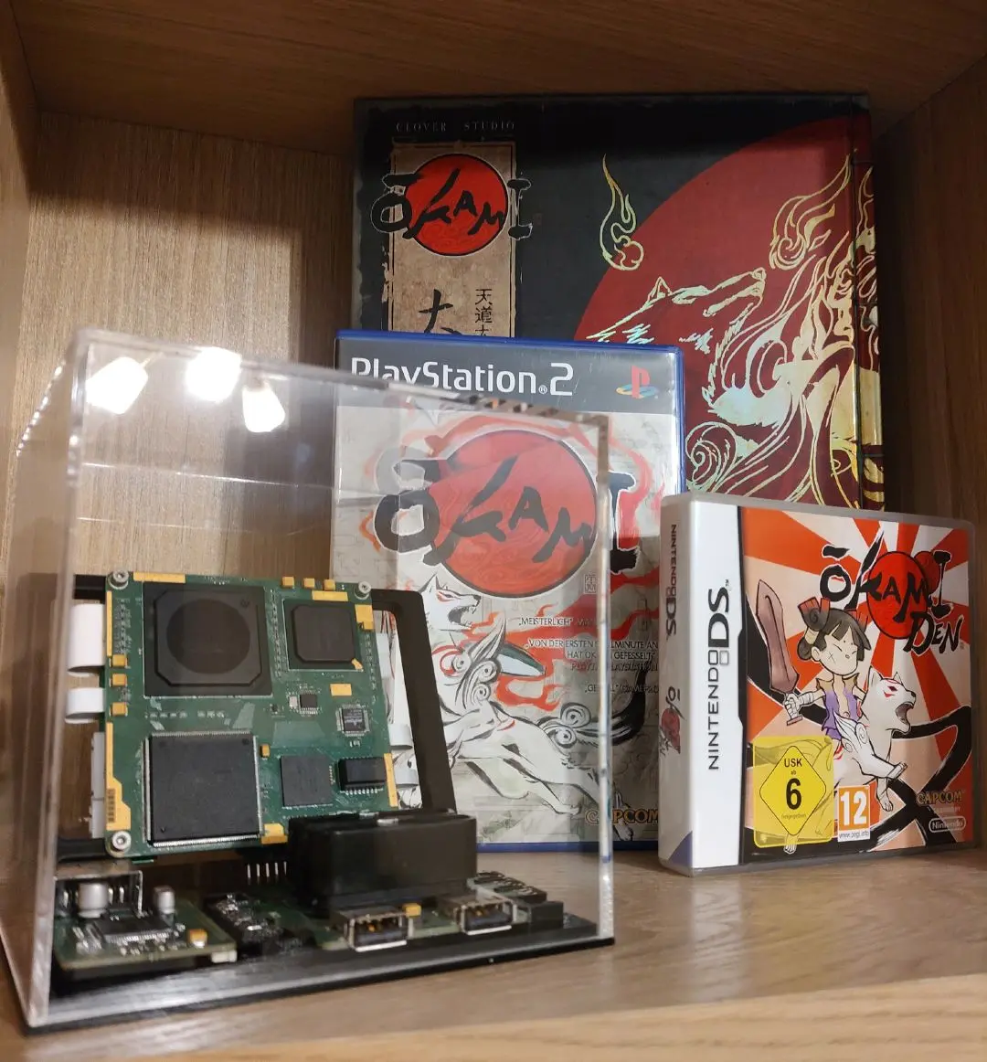

And in case someone is wondering what happened to the custom mainboard that started this whole project, it’s still working 3 years later and recently got a very special place in my collection!

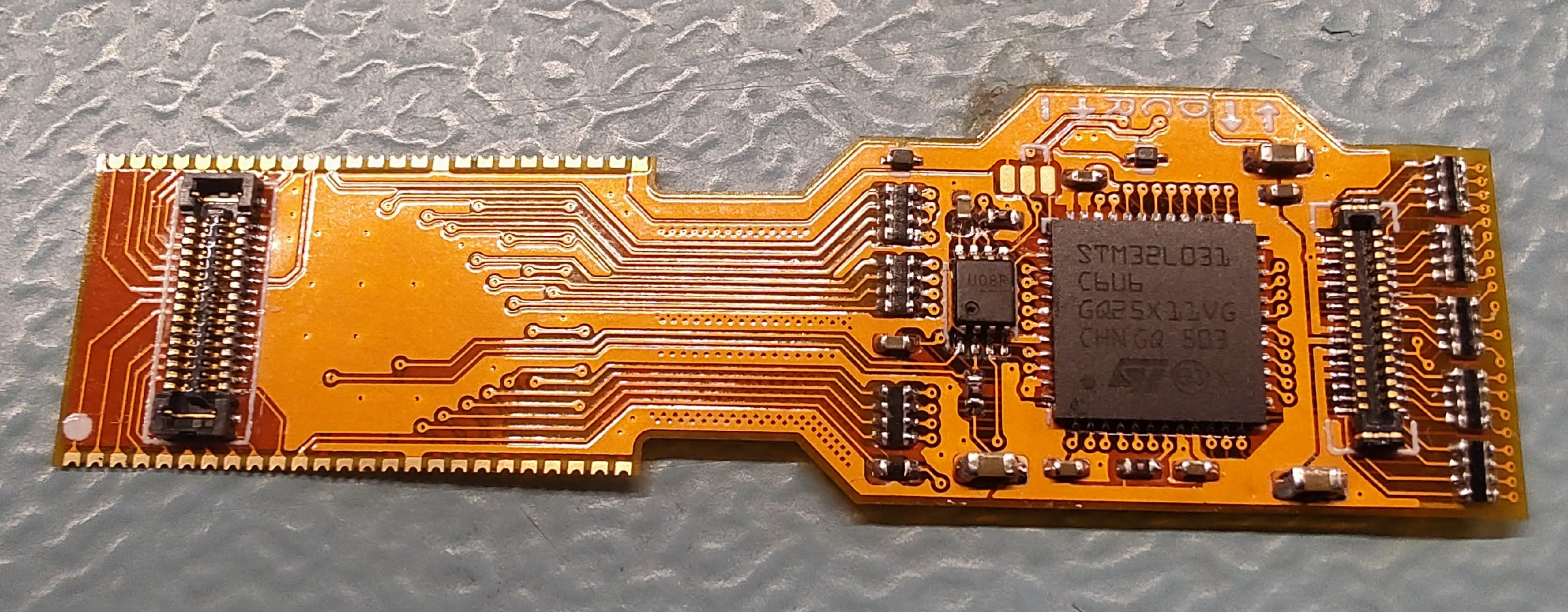

Some time ago I was actually working on a more user friendly version of the boot ROM flex that could be flashed in-circuit via UART, including a command line tool to transfer the bios binary. It worked OK, but I wasn't happy with the mechanical construction and the rather long flashing time, so I stopped working on it.
Looked something like this (TSOP-48 flash and UART on the backside):
Apart from that I unfortunately didn't invest much time into making the bios replacement more accessible, I think the closest thing to a guide you can find is the Boot ROM flashing doc in my portable repo. For the connection diagram you can refer to the schematics of my mainboard or the schematics for the boot ROM replacement I posted a while ago in this thread. Maybe in the future I will pick this topic back up and release it, but for now I'm busy with another project.
