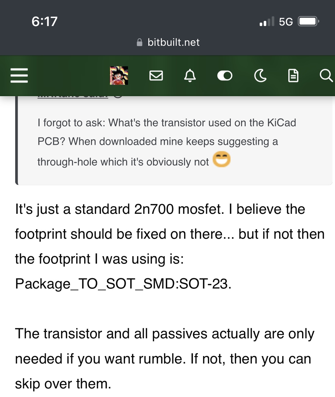

In that post they mention that all you need is the PIC16F18876, the transistor and all passives are only needed if you want rumble. What exactly are you looking for ?

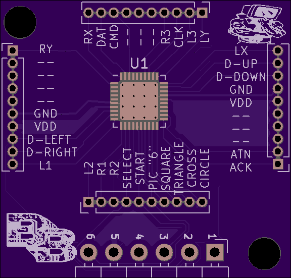

i already do order some pcb from oshpark and microchip also . it look like in the pictures and something i don't understand , i search for pic16f18876, there's 2 shape of that microchip ,one is square and other is rectangle , which one should i take since it's the same . from the picture i uploaded , there're 2 position for soldering either , do i have to solder 2 chip on 1 board or chose whichever i like to solder then left 1 alone?
The footprint on the PCB is square, so get the square one. The pads on the back are for an FFC socket, for builds that use more custom PCBs and want to reduce the number of wires used. You don't need to worry about the FFC socket.
Now's probably a good time to remind you that you will need a PICkit 3/4 programmer to flash the PIC microcontroller with the PS2+ firmware. A PICkit 3 clone will do fine, you don't have to spend a hundred dollarydoos on a genuine PICkit 4
