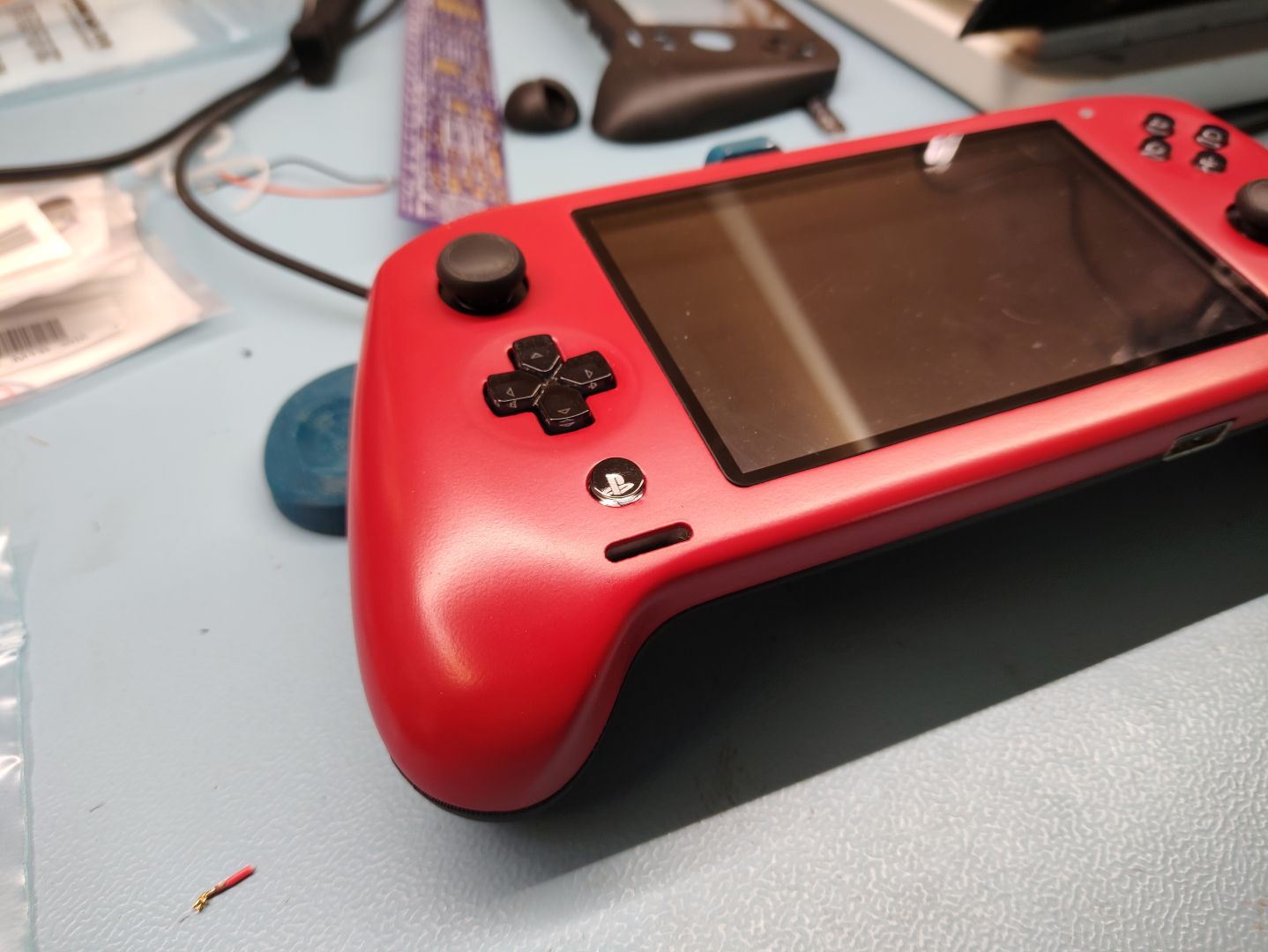

Housing
Since the last update I was looking into filling and painting the housing and I did a little practice run on the front half:
The color is ruby red (RAL3003)I and I actually quite like the red/black combo, might even keep it for one of the final portables. For filling the areas around the overhangs I used some Plasto filler and for the layer lines I first did a rough sand and then used a couple layers of filler spray with fine sanding in between. A clear coat is still missing, I’m considering some 2 component spray paint as I had some pretty bad experiences using the standard acrylic clear coat in previous portables. Still doing some research about which types of spray paint are compatible…

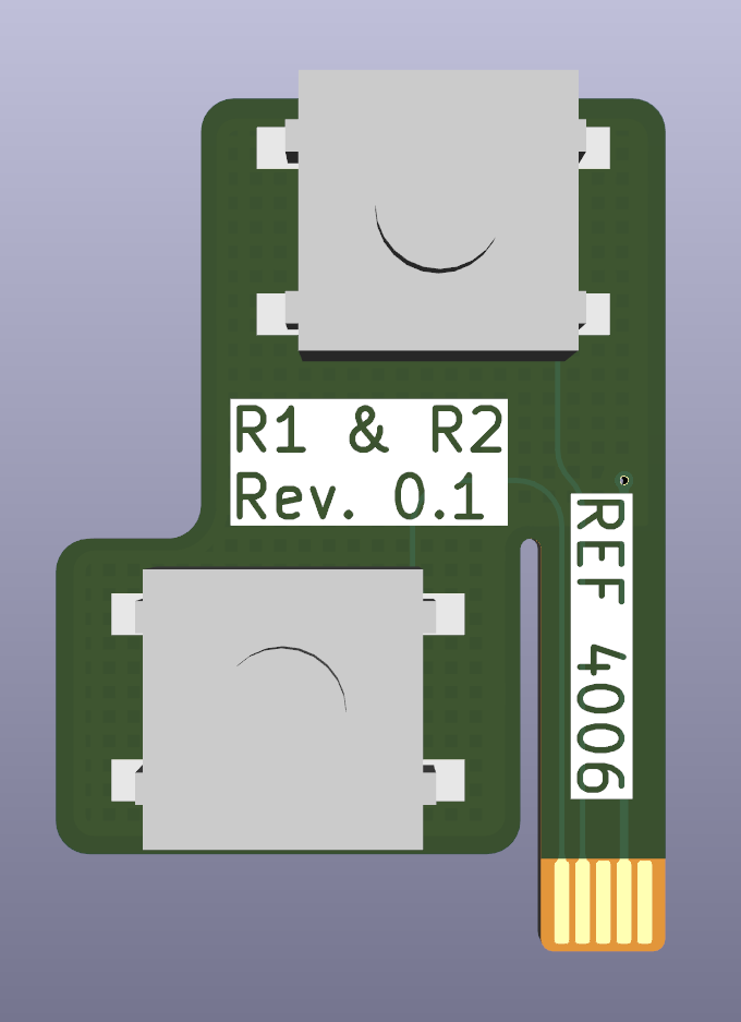

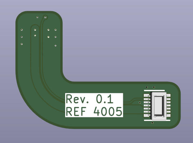

New Gamepads
In the last weeks I was working on finalizing the new gamepad PCBs. The mechanical design was actually already done since last year and would have involved 2 flex PCBs on multiple levels and two folds. Upon revisiting the design, I wasn’t happy with its flexibility and I opted for two 0.8mm rigid PCBs and four small flex PCBs instead.
A big requirement for the new gamepads was to keep compatibility to the current mainboard revision, so I can upgrade the prototype to the latest design for testing.

The rigid PCBs make component placement way more flexible, because it allows me to place the RP2040 on the bottom layer (previously reserved for the FR4 stiffener). In the last revision I put all electronics directly below the analog sticks, but in the current portable I noticed that the sticks protrude about 0.5mm more than they should be; moving them inwards leaves no space below them for the RP2040, so the circuits needed to go to the bottom layer. The shoulder buttons and connection to the mainboard are still implemented using small and inexpensive flex PCBs. Price-wise the new solution is about equal to two big flex PCB gamepads with FR4 stiffener.
Another addition was rumble-support. The respective functions and registers were already in the Syscon and gamepad code since the very beginning, but I always treated rumble as nice to have feature and actually never tested it.
Of course, there needs to be a good compromise between rumble strength and power consumption - it’s a portable PS2 after all – so I’ve chosen 10x3.4mm coin-style vibration motors for the rumble. One consumes about 250mW and after some first tests I think they are actually quite strong for what they are. In order to compensate for their small size, I’m planning to place them in the grips directly under the player’s palm. In any case, there will be a setting in the menu to change the intensity of the rumble (can also be turned off).

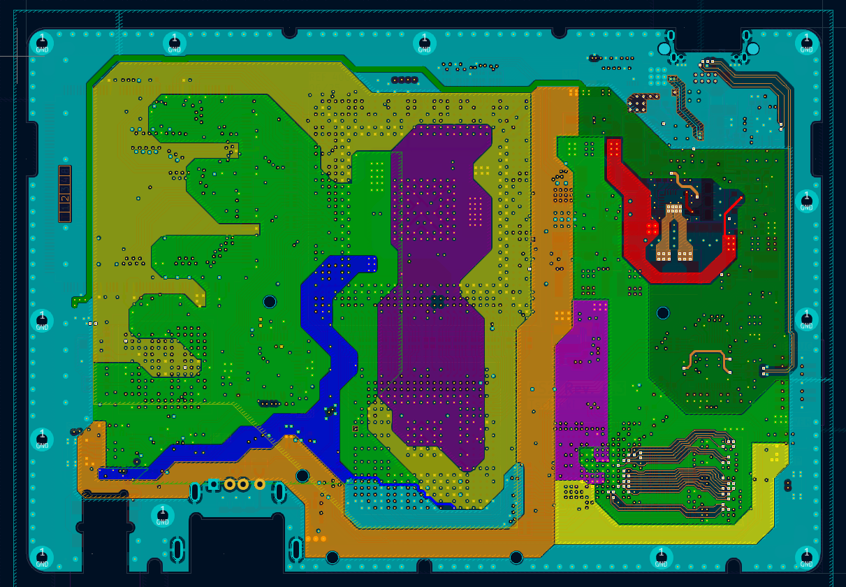

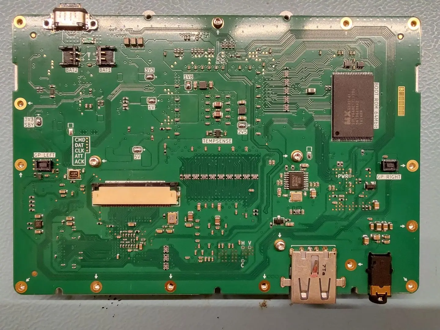

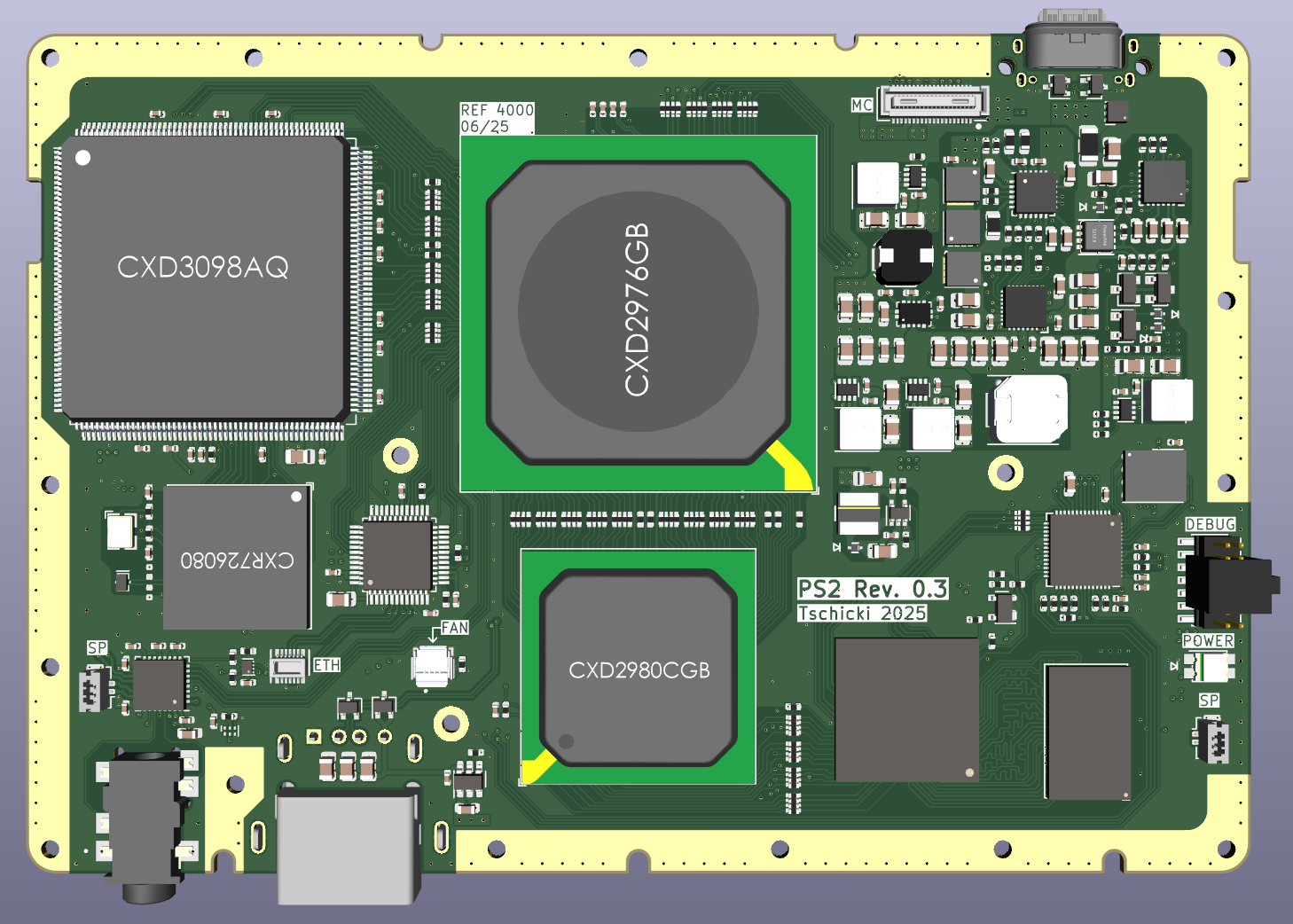

Mainboard Rev. 0.3
I was working on the rev. 0.3 mainboard from time to time and I think now is a good time to report the progress.
The main intention of the next revision is to fix one bodge, consolidate the power planes on (mostly) one layer, add the 64Mbit boot rom mod, optimize the BOM and fix a few potential oversights in rev. 0.2.
Here you can see the new power routing on inner layer 2:
Inner layer 3 used to be a (mostly) power layer too in rev. 0.2, now it contains a GND pour and lower speed signals. Apart from that, some video traces had to go to inner3 as well, but I made sure to add adjacent GND. In order to have an easier time routing power, I had to slightly adjust component placement in the power management section. For the new power routing I would have preferred a stackup with 1oz inner copper, but JLC doesn’t seem to have an affordable and suitable alternative. But 0.5oz should still be fine for this application.
The battery connectors are still unchanged, as I couldn’t find any more suitable low-profile connectors for the application + soldering the wires was a no-go for me. I actually found a cheap crimping tool on aliexpress that can be used to crimp EZmate HC connectors properly, without spending 500 bucks for the tool from molex. You find it as “IWS-0302BS” on aliexpress.
Additionally to the other changes, I swapped the 16Mbit flash of the Syscon for a 128Mbit flash (same as the SD2PSX to save BOM items). The 32Mbit PS2 boot ROM was upgraded to my latest circuit using the 64Mbit NOR flash (actually not necessary currently, but good for future-proofing). Lastly, I added open drain buffers to the HPSense signal and the BOOTSEL of the Syscon. The first is to avoid and potential problems with switching between headphones and speakers and the second one is to mitigate the “random start pressing” bug I described earlier.
The BOM was also further optimized, especially some of the capacitor values. In total we have about 760 components on the mainboard now… not counting the gamepads and the memory card flex.
Currently I’m still looking into an alternative for the USB A port from a 79k console. The port from 90k consoles is just ever so slightly different that it doesn’t quite fit (not even when flipping it). So that’s still ongoing. GND via stitching, fixing some clearance rules for the differential pairs, reworking some of the polygons, going through the DRC check results and reviewing schematics & PCB are also still on the list of things to do.

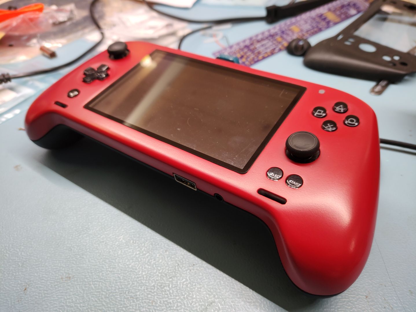

Housing

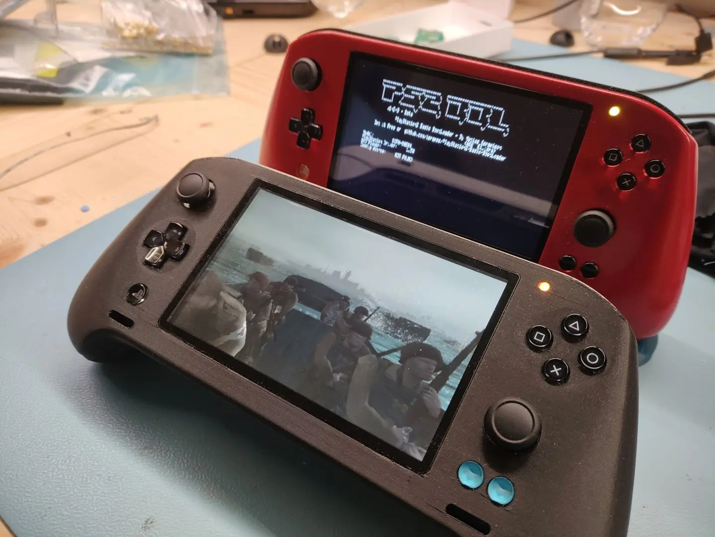

View attachment 39212View attachment 39213

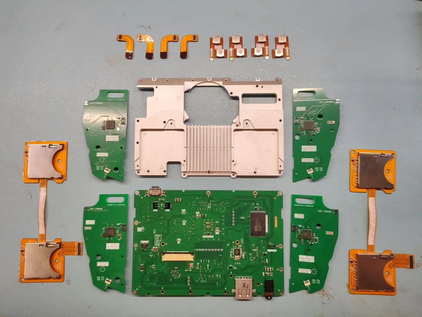

New Gamepads

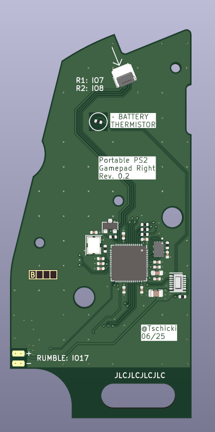

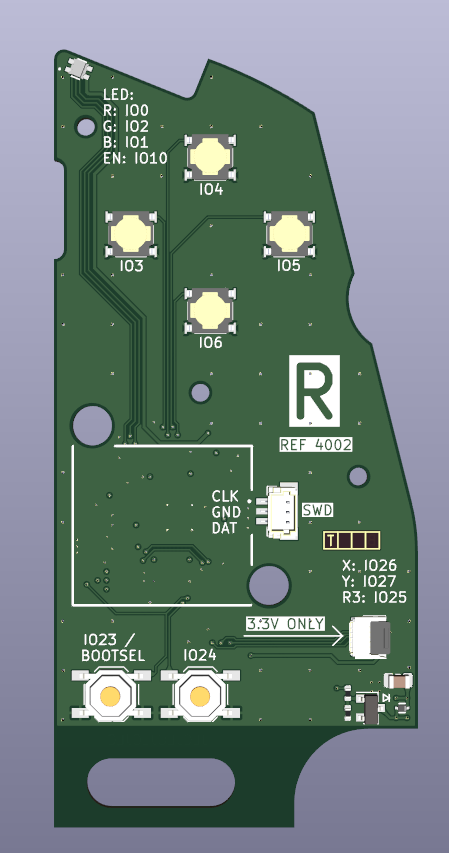

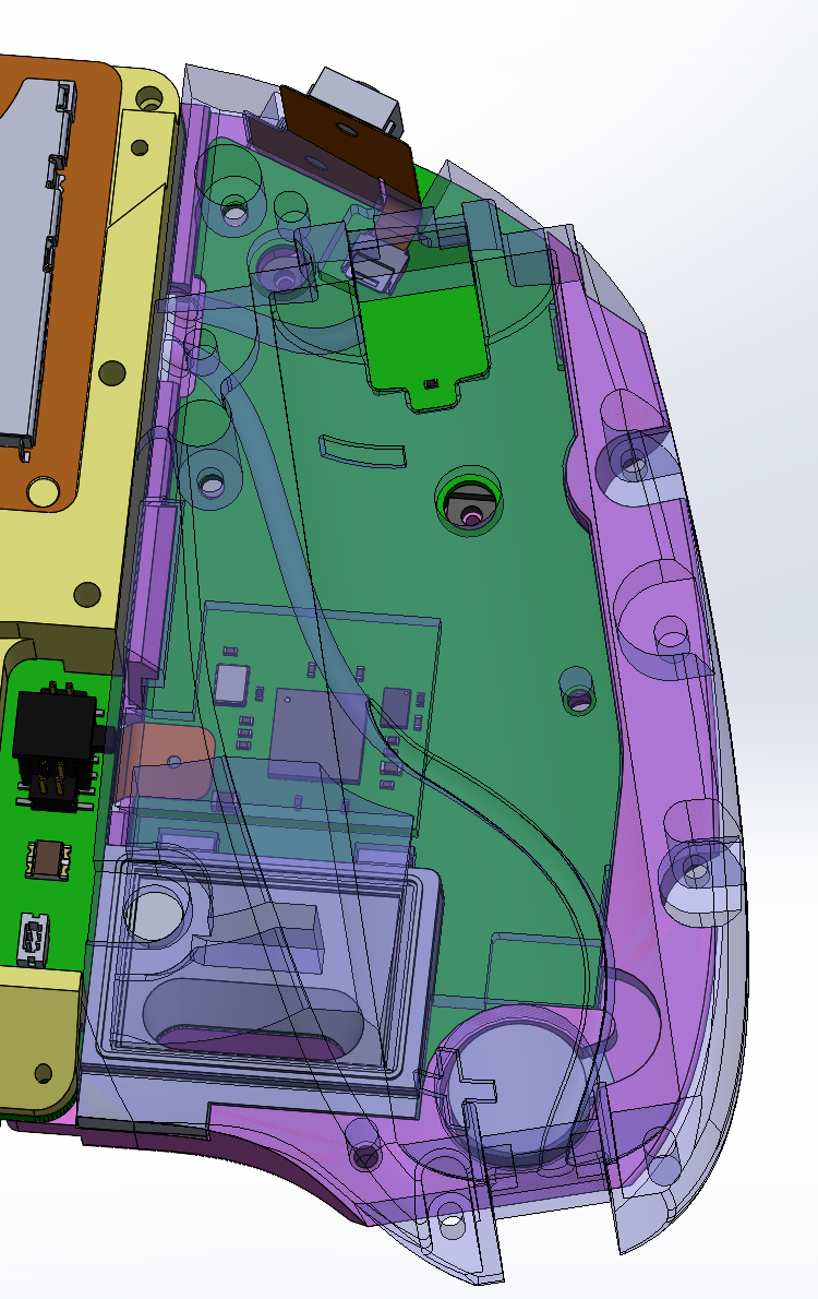

This would be the right gamepad:
View attachment 39203View attachment 39204
And the two flex PCBs for the right gamepad:
View attachment 39206View attachment 39205

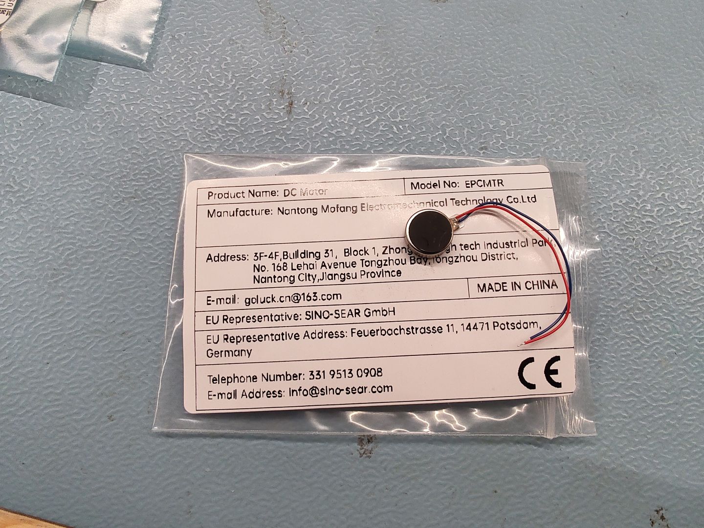

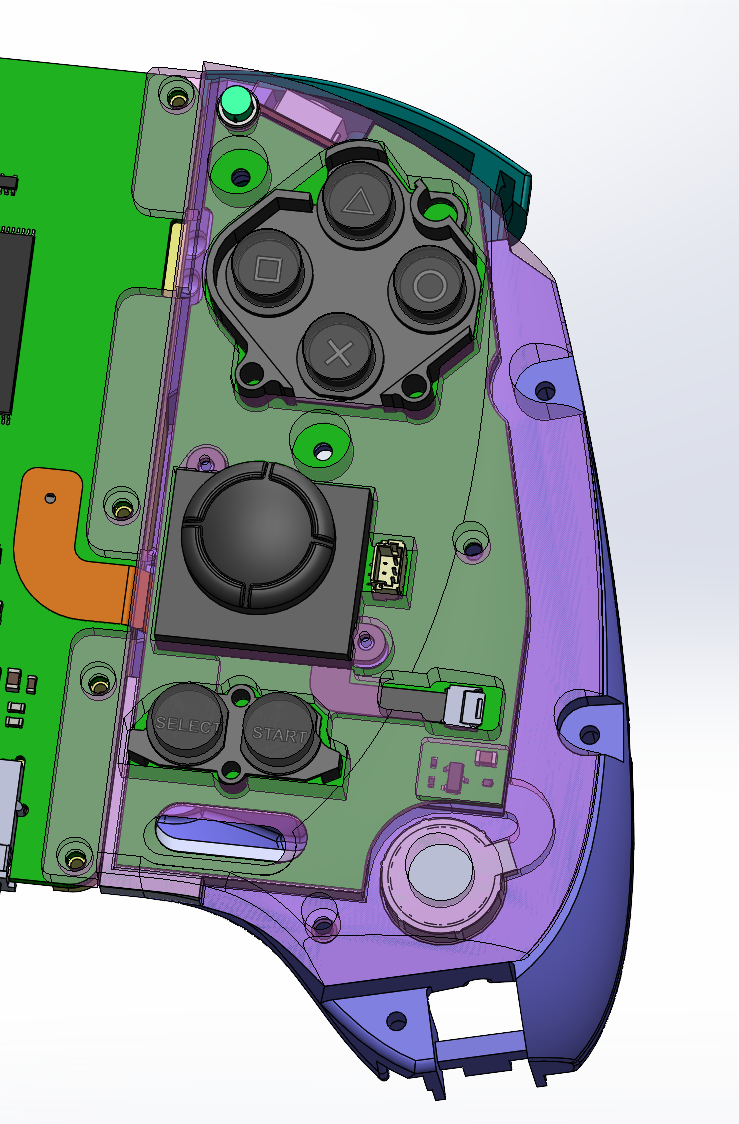

There is how the mechanical design looks right now:
View attachment 39210View attachment 39211
All the gamepad PCBs were manufactured already and are on their way from JLC, so I guess in a week or two I will have a functional prototype to play with.

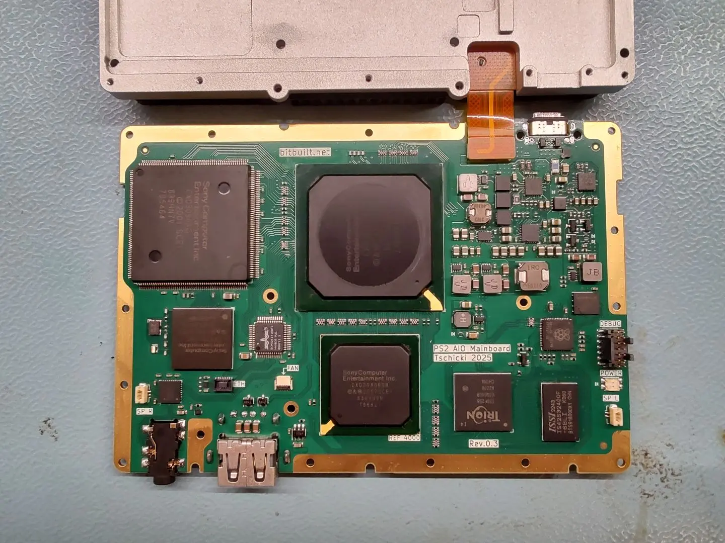

Mainboard Rev. 0.3

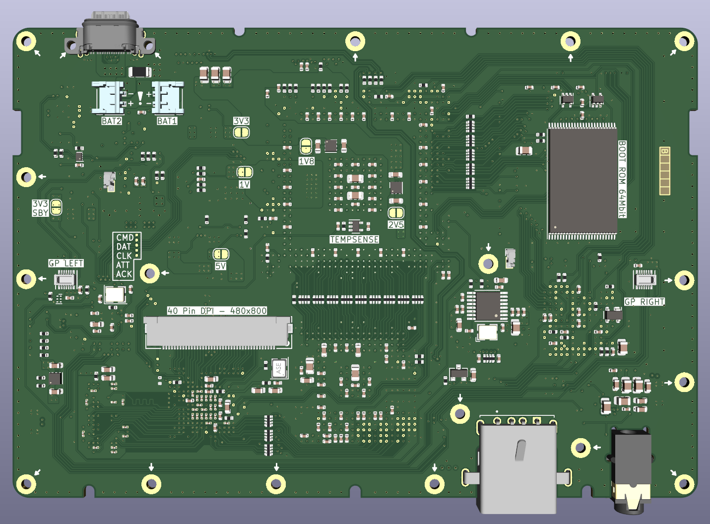

View attachment 39207View attachment 39208

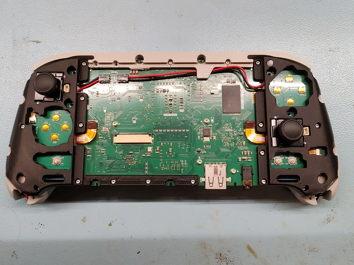

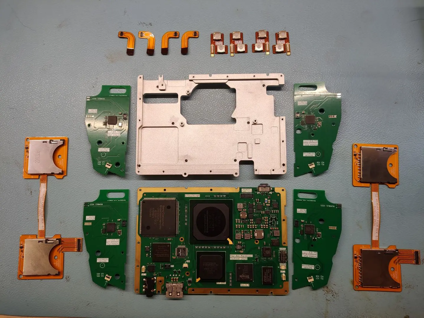

As promised, a small update about the gamepads:
All PCBs finally arrived and were assembled. After flashing the new gamepad firmware and updating the syscon it was time to test! And to my surprise, rumble worked first try, kind of:
So, the dualshock 2 has a "strong" and "weak" rumble motor, the weak one can only be turned on/off while the strong one can be set to a value of 0 to 255 for adjustable strength. Naturally, I mapped this to the PWM so that 0 would turn off the motor and 255 would turn it fully on (3.3V). What I forgot was that the rumble motors I use only start spinning at ~2V, so actually the PS2 input of 1-255 needs to be mapped in a way to create 2V-3.3V and 0 should disable PWM. That's why in the beginning only one rumble motor was spinning most of the time. After adding the respective mapping function in the gamepad firmware, rumble was working as expected.
The syscon menu now includes a rumble intensity setting with a range of 0(off) to 3(full strength) and that setting will also be stored in flash.
While disassembling the portable to swap the gamepad PCBs, I also took the time to update the left and right gamepad subassemblies to the latest mechanical design. Apart from some small tolerance adjustments everything fits quite well, so I think this is not far from the final mechanical design!

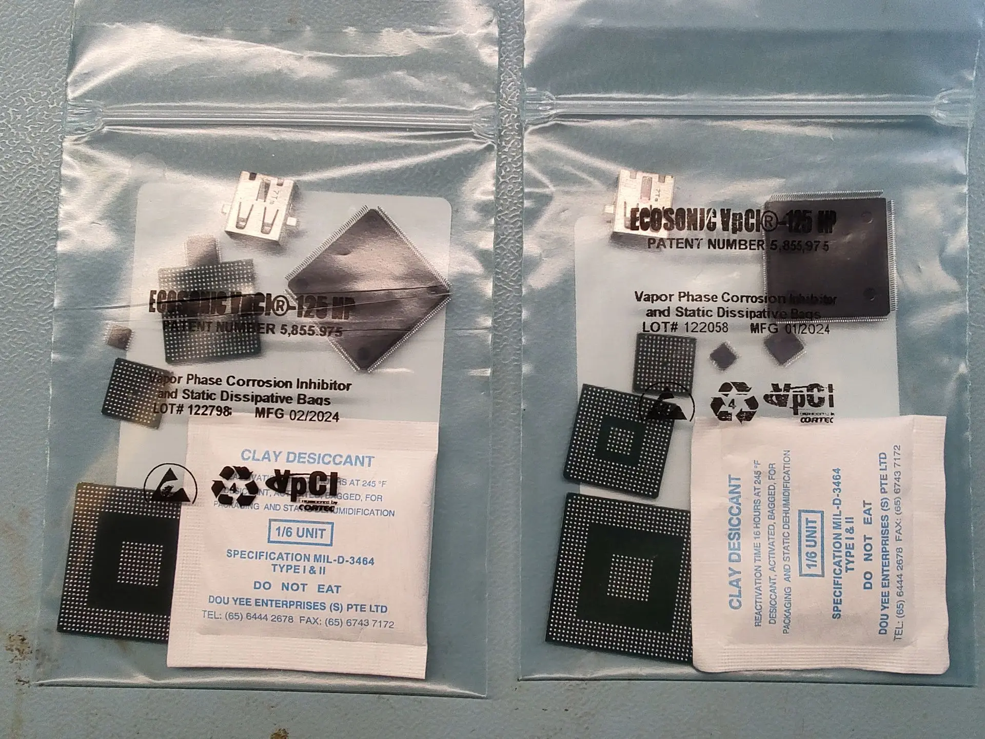

Mainboard and Assembly
The rev. 0.3 mainboard, heatsink, new uSD2PSX and all the required components for 2 portables were ordered and should arrive within the next 2 weeks. On top of that, I prepared two sets of PS2 components for assembly. This time the reballing process was surprisingly smooth, and in parallel I even finished writing the reballing guide!
I’m also still working on filling the BOM for the whole portable. For the first time I have a rough estimation of the BOM cost for the whole portable, it’s in the ballpark of 300-350€ without taxes and shipping costs. Not included are tools, consumables, paint and printing filament. It also ignores the fact that for e.g. PCBs there is a MOQ usually. The mainboard itself is around 130€ to build in single units, this already includes a donor PS2.

Last weekend I assembled Rev. 0.3 of the PS2 mainboard and so far it is fully functional!
The bad news:
Actually none, apart from... I unfortunately forgot to order some components required for assembling the portable. They will probably be here in 2 weeks, but at least the 21700 batteries arrived for testing yesterday! And sadly I ran out of black PLA and PETG, so another week of waiting...
Assembly
Assembly was surprisingly smooth this time! Only a handful of shorts to fix after reflowing and the board bringup was successful the first try, no troubleshooting!
I tried to stick to the same procedure as for revision 0.2, which worked out very well! My main gripe last time was soldering the DSP, this time I made sure to pre-tin all pins with some fresh leaded solder -> solder wetting was much improved, no pins were shorted or unconnected!
The overall procedure from pasting to first power-on took about 12h and was spread over the whole last weekend. It could be done faster, but I also made lots of pictures and wrote down all the steps and tips along the way, to create the mainboard assembly and bringup procedures. They are drafted now, but the formatting is still all over the place.
During the bringup I also refined the steps and simplified compilation of the testing firmwares. I'm planning to describe the bringup in five major steps:
  • First measure the resistances to GND for all supply rails, I created a table now with the measurement results of a known working mainboard.
  • Then flash the STUSB4500 config and measure all supply voltages before closing all supply jumpers to the PS2 portion. The firmware for that is obtained by compiling the SysCon firmware with the MFG_STEP_1 flag set. The gamepads are also flashed with their firmware here.
  • Then testing whether the PS2 portion is functional (i.e. boots) without batteries. The firmware for that is obtained by compiling the SysCon firmware with the MFG_STEP_2 flag set.
  • Then flash the MAX17320 NVM config to enable usage with batteries. The firmware for that is obtained by compiling the SysCon firmware with the MFG_STEP_3 flag set.
  • The last bringup step is to flash the normal SysCon firmware by disabling all flags from above and testing whether the system runs off batteries.
Here is the mainboard itself:
The left and right gamepads, flex PCBs and the memory card flex were also assembled, actually pretty much the same way as last time. Here I'm still missing the speakers, some buttons and black filament. I also took the time to document the assembly in a procedure, with images.

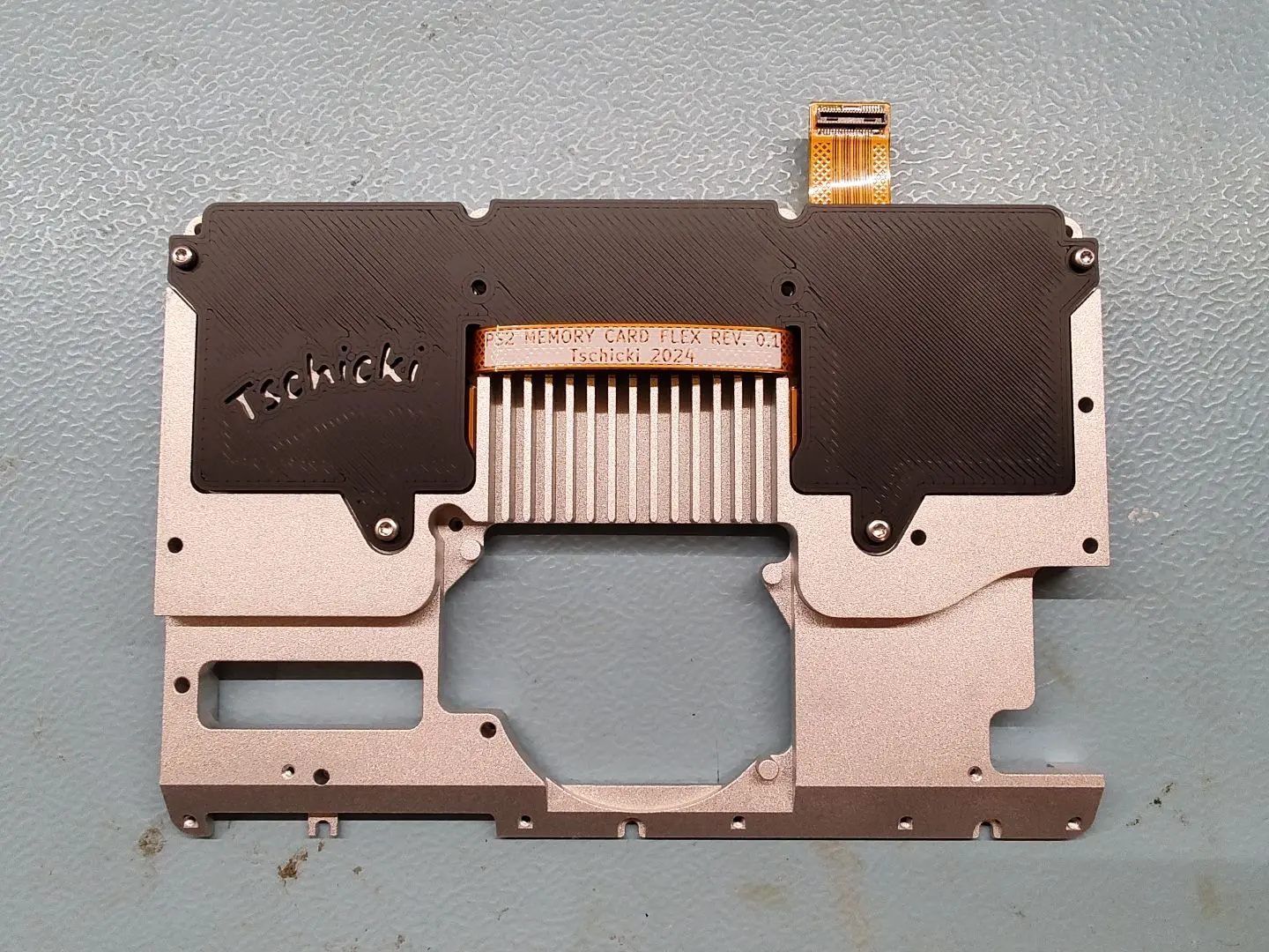

Here are some pictures of all the assembled PCBs and the heatsink
The heatsink is really nice and not warped this time, I opted for bead blasting to get a beautiful surface finish. I still had to tap all the M1.6 threads myself, as I couldn't justify paying the premium for JLC doing that. Due to the improvements in the design, this was actually really easy to do now. It's still one of my least favorite things to do, but at least it was quick and easy this time...
So here we are... I assembled everything temporarily for testing and used old housing parts for now. There is still no switch lite fan, so I should only run it for a limited time before the EE gets too hot. Also no speakers yet, but I verified that it outputs audio on the headphone jack.
