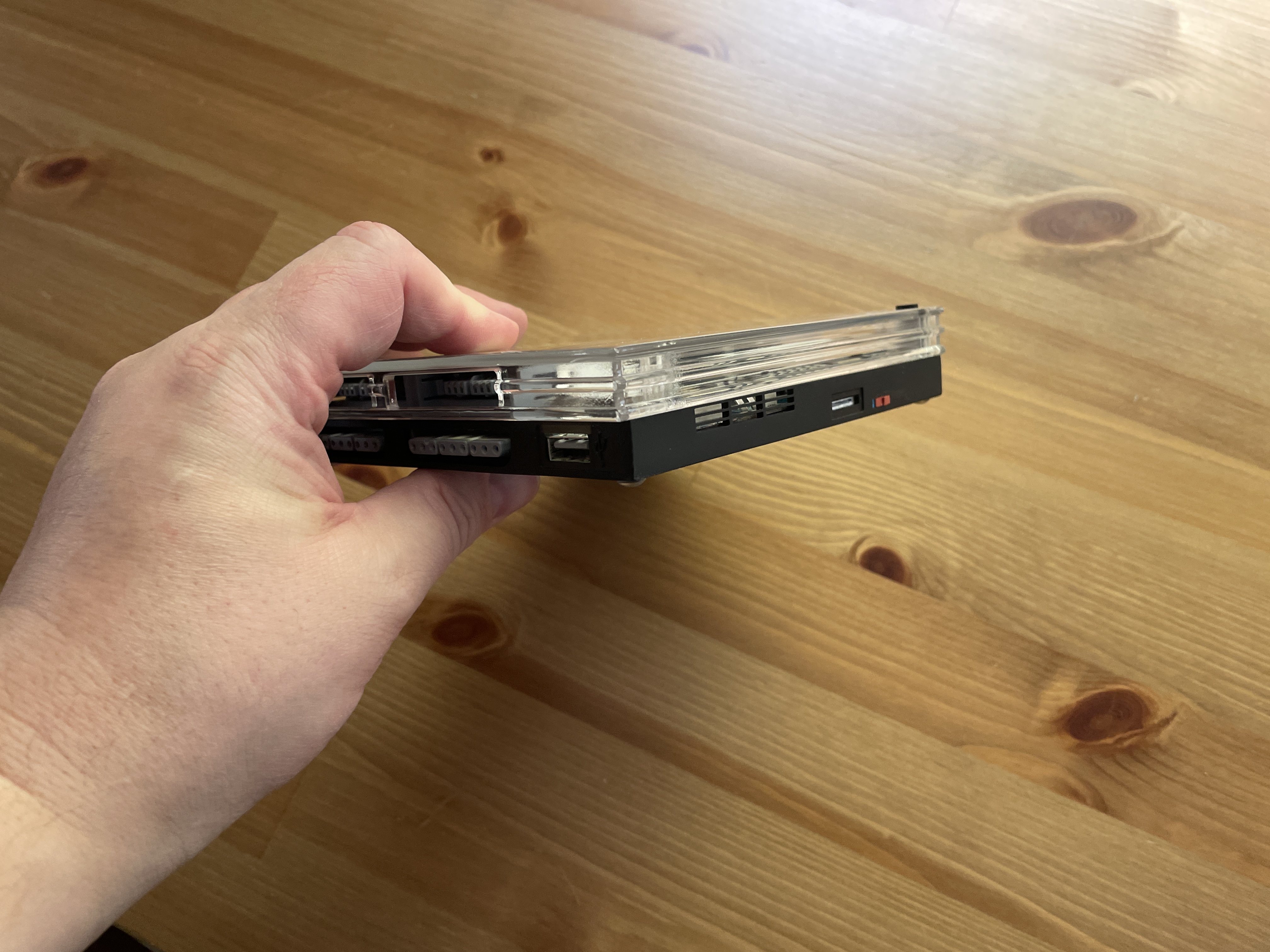

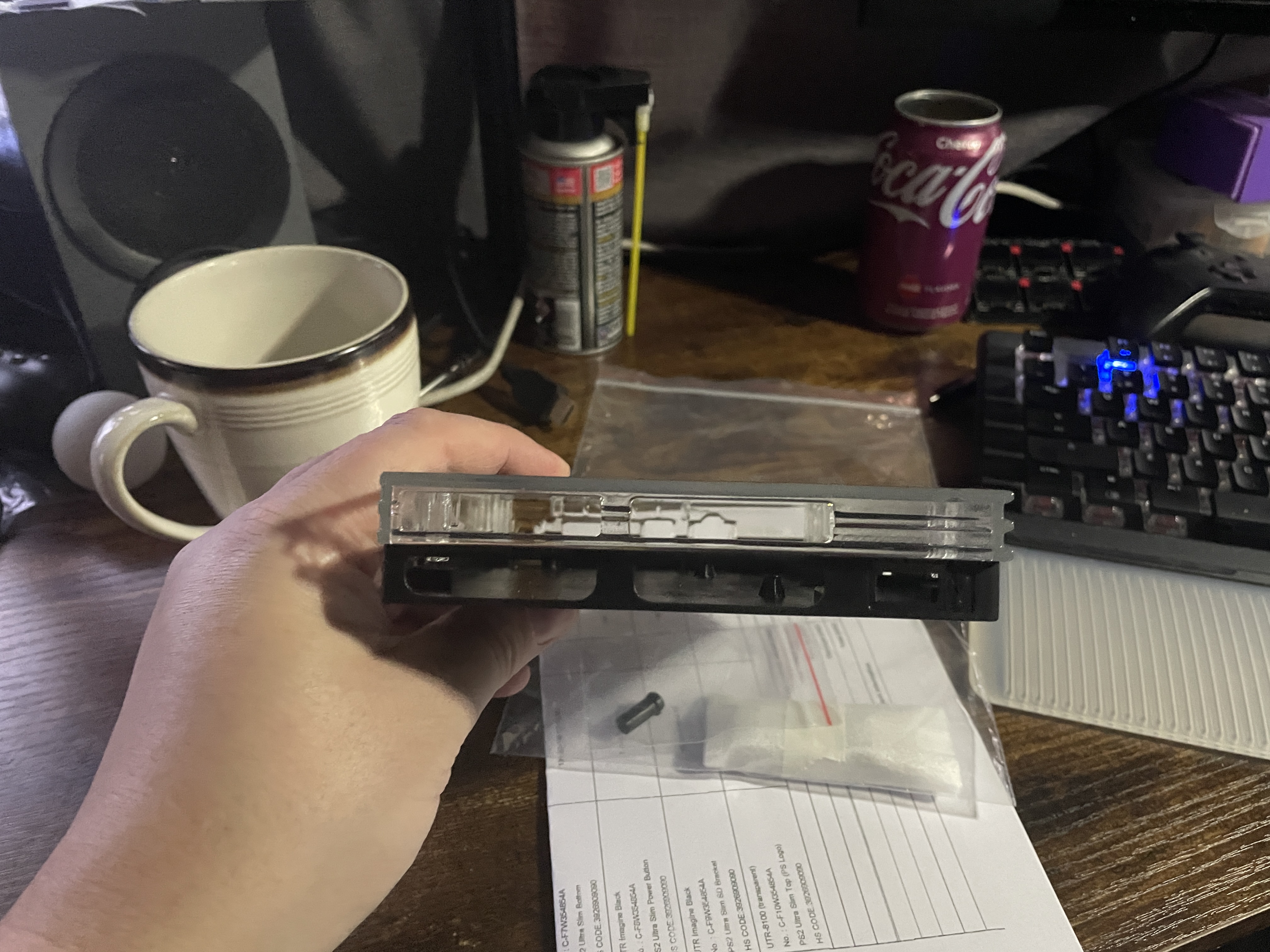

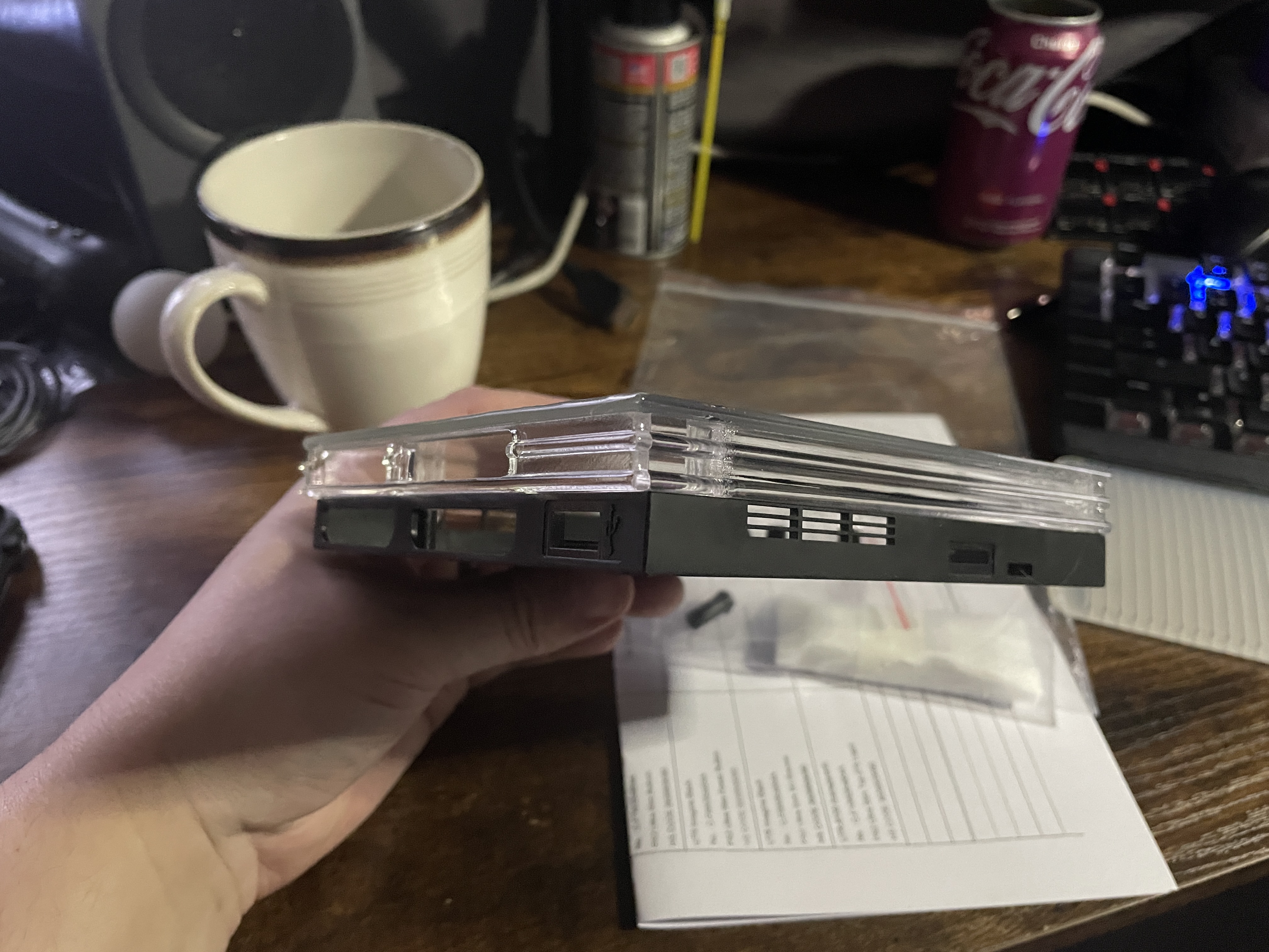

Updated photo - I’m looking for someone to print a translucent “smoke” shell for it, but in the meantime I think it looks pretty damn good!

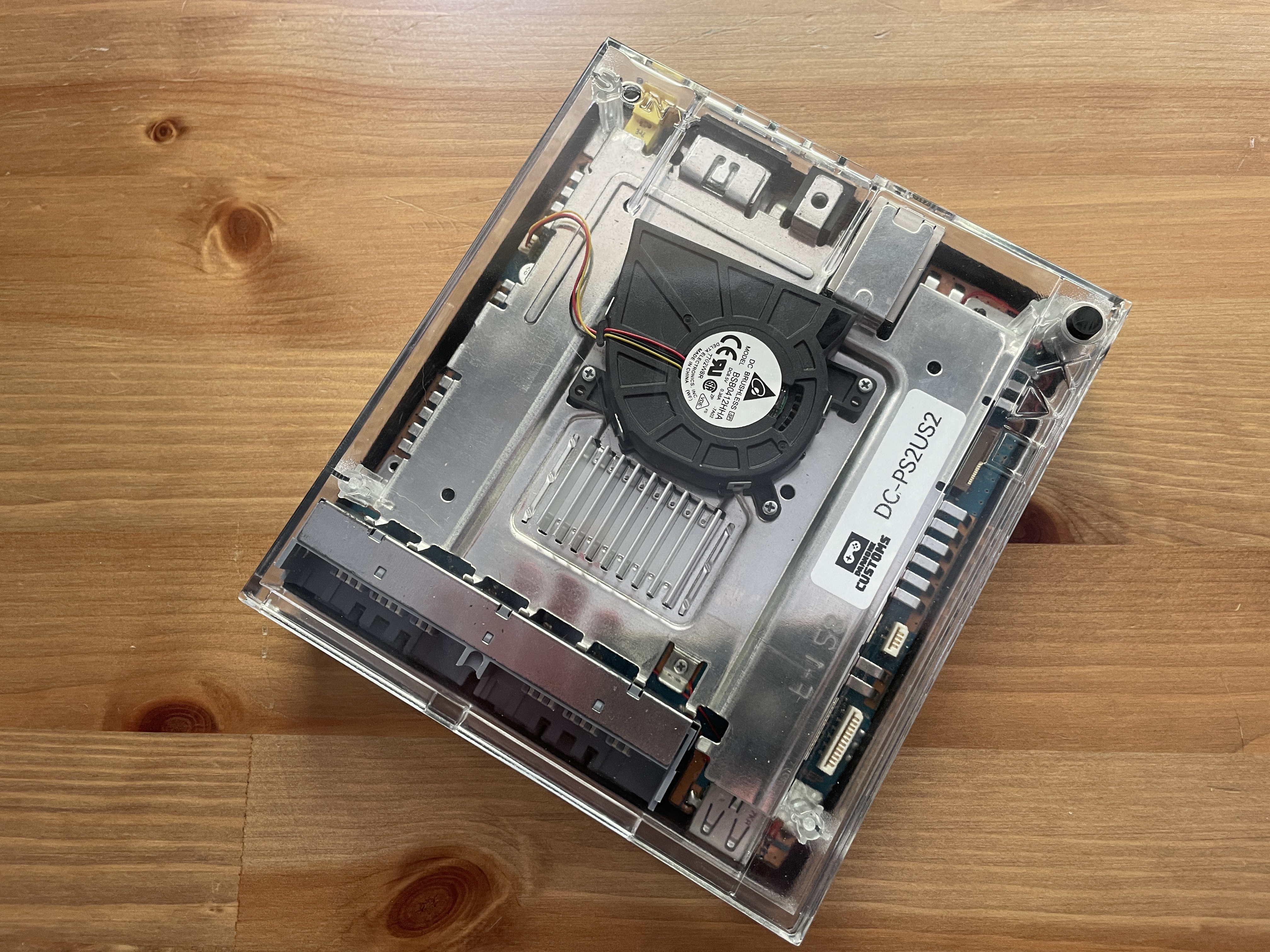

If you can afford it, PCBWay does it, but if you can find a way to not pay $150 I'd love to know where lol -- I was thinking my final build was going to be translucent blue

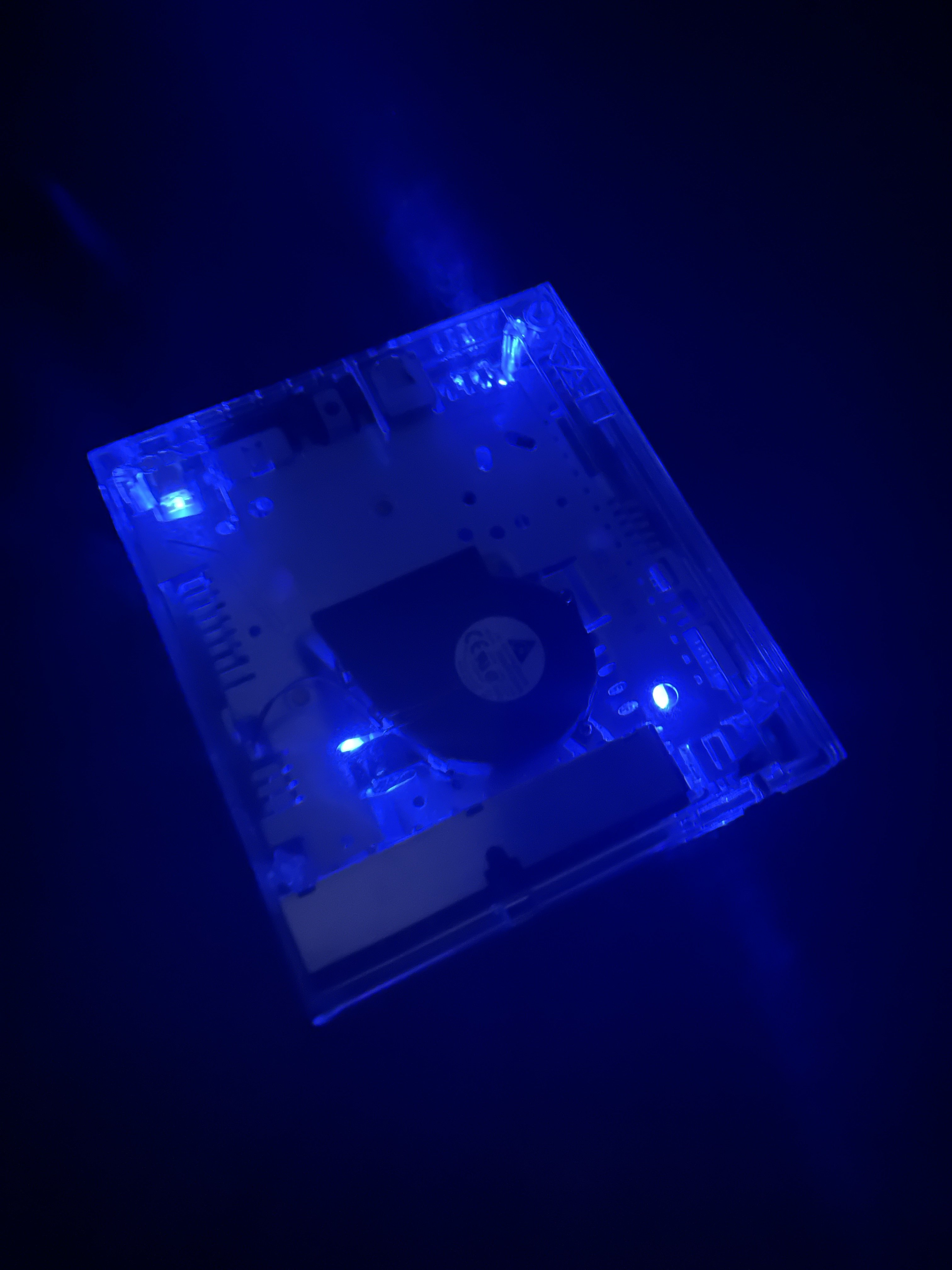

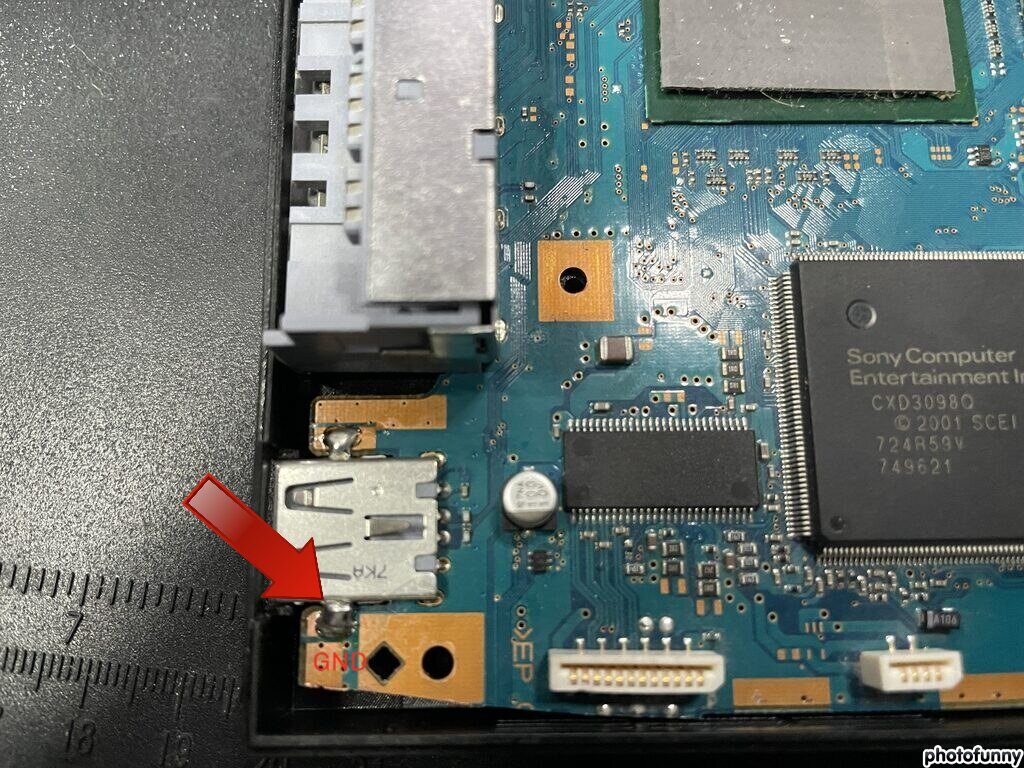

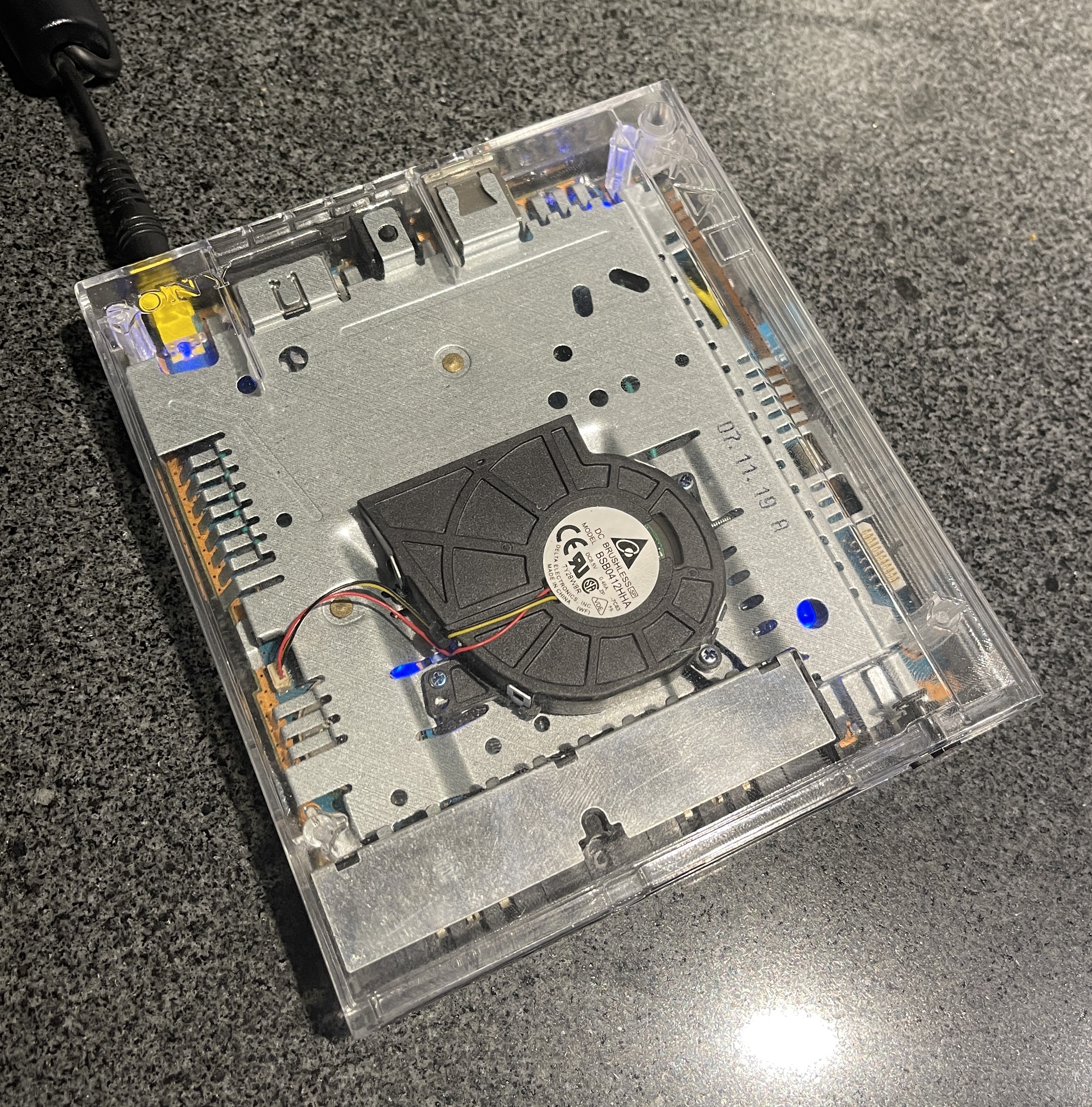

K newest build is done and dubbed "Oreo"
Oreo Build VOD

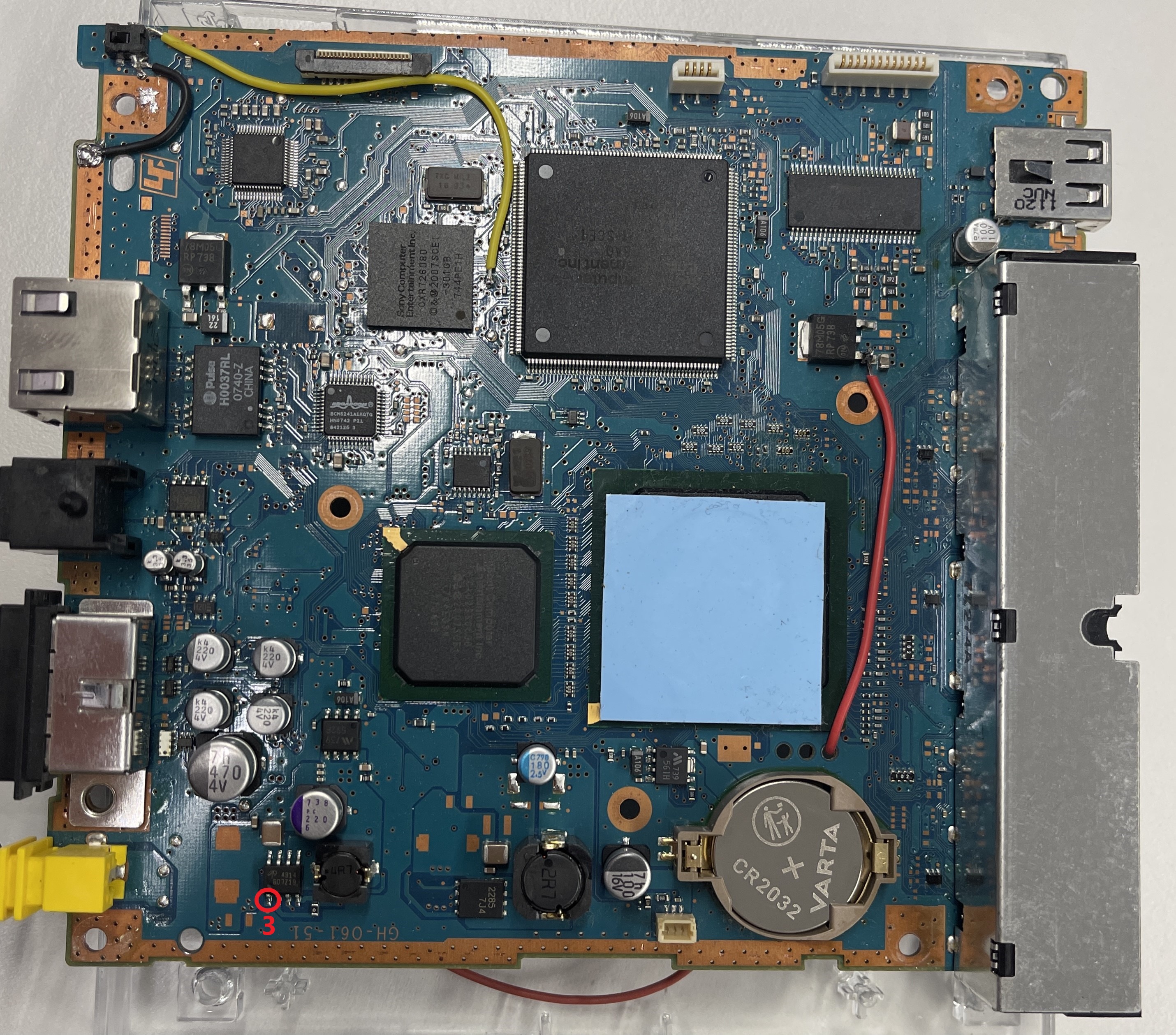

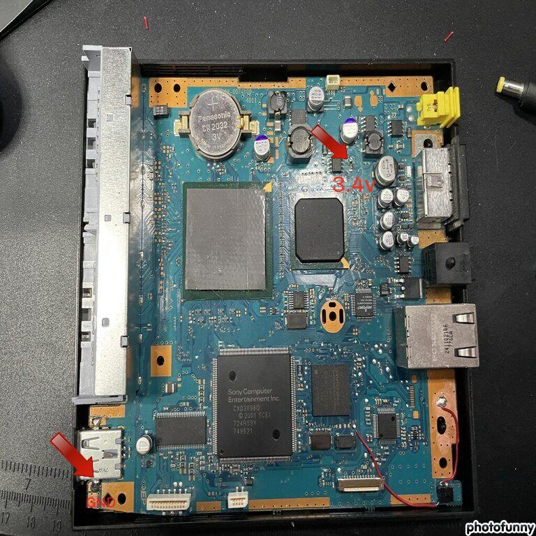

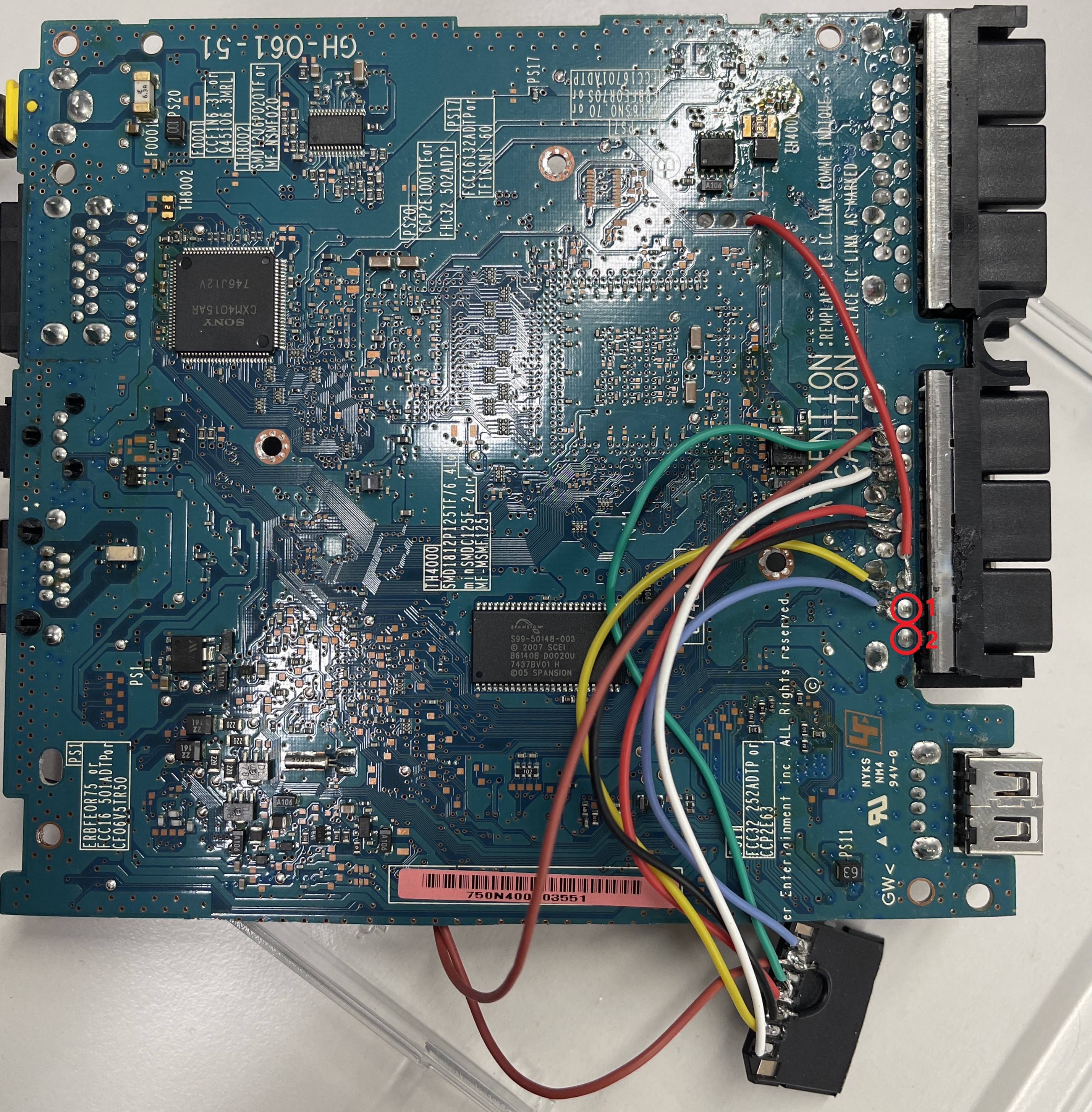

Besides the build included pics of points I'm using for my LED installation
Original VOD was having issues on twitch so uploading the current build to youtube

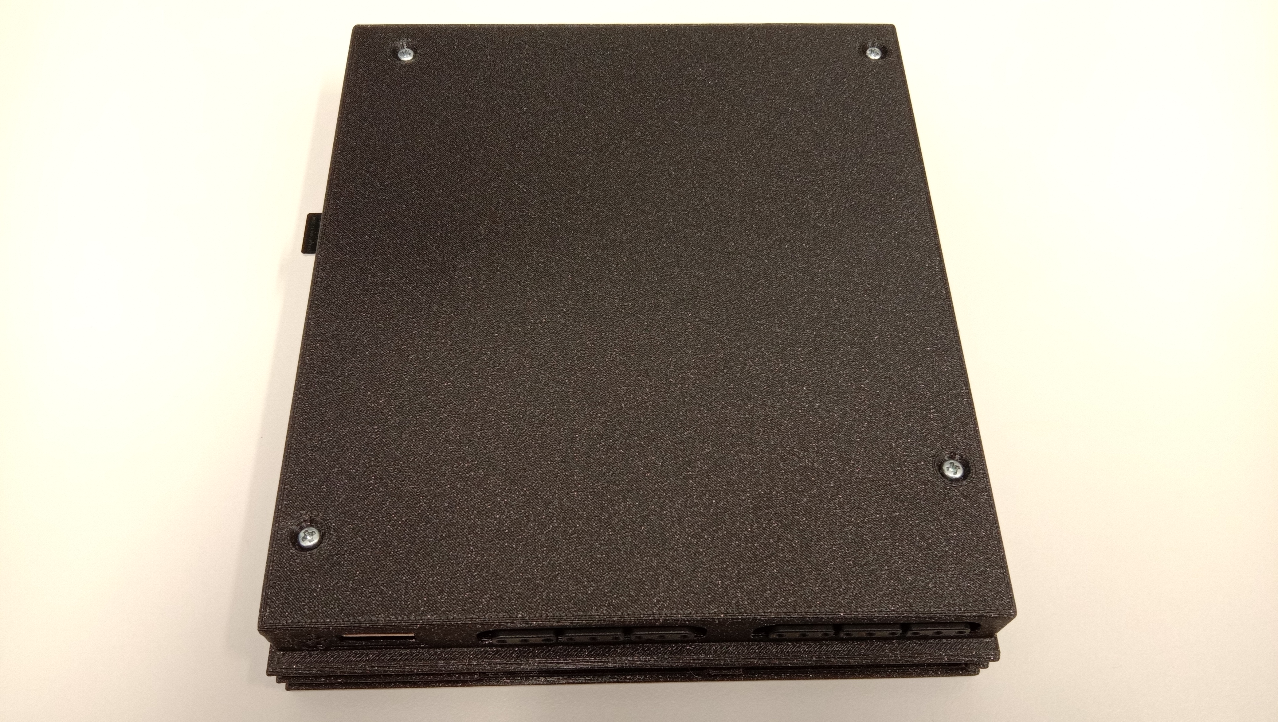

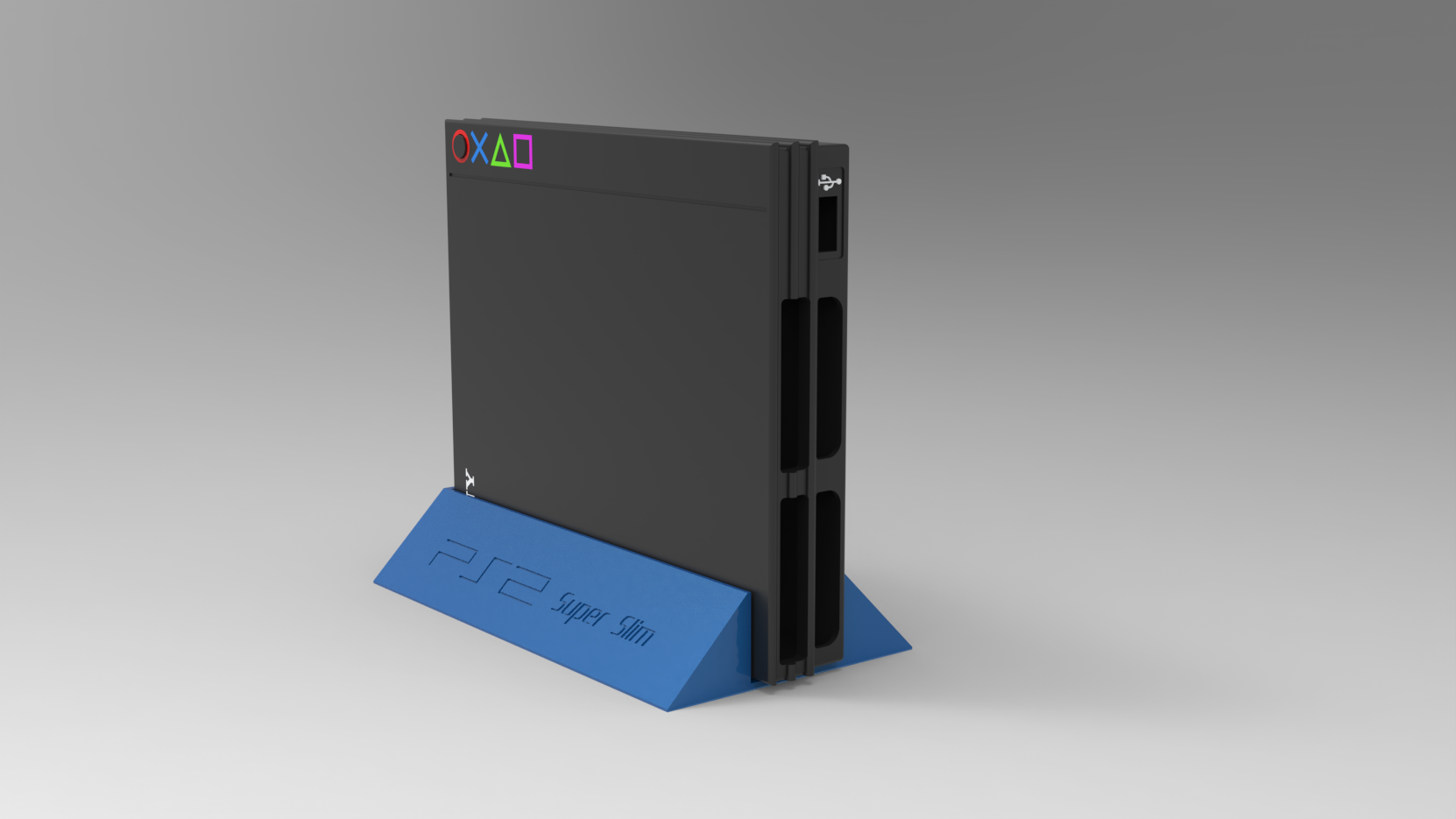

So this project has no worklog as it was completely off the cuff and went from concept to completion in a day and a half.
The PS2 Ultra Slim

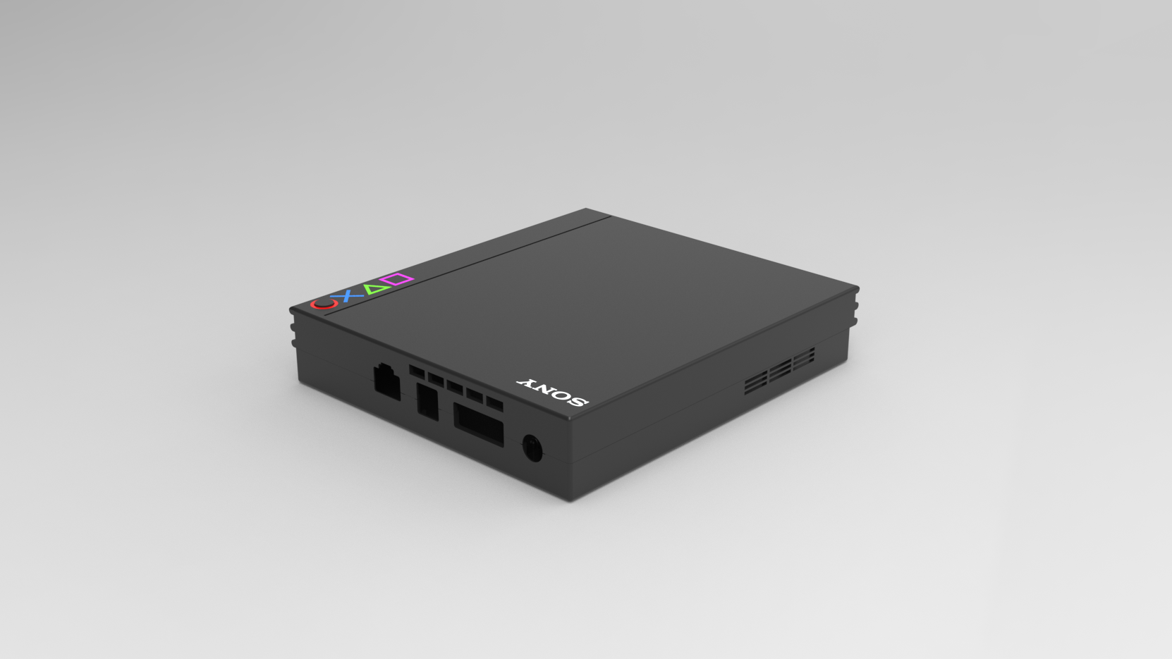

Renders:
View attachment 22986View attachment 22987View attachment 22988View attachment 22989
Real Pics:

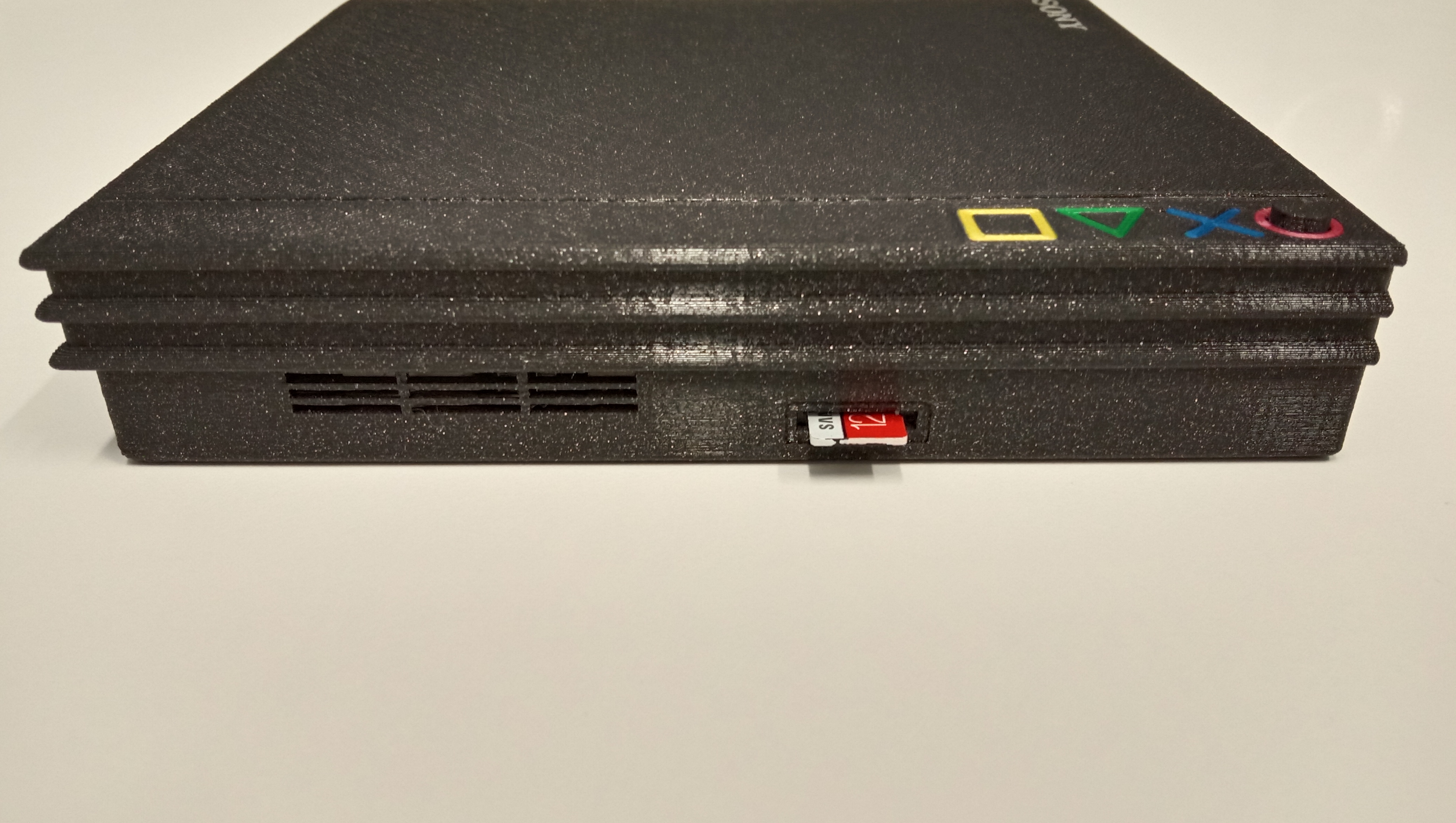

View attachment 22981View attachment 22982View attachment 22983View attachment 22984View attachment 22985​
Features:
-Almost half the width of a stock PS2 slim as it nixes the DVD drive and one of the USB ports.​
-Added mounting for an internal micro SD card card adapter for SD loading.​
-Improved cooling over stock with an additional intake and a guided exhaust.​
-Re-purposes the lid switch to become the power/reset switch.​
-Designed to not need supports to print the main case.​

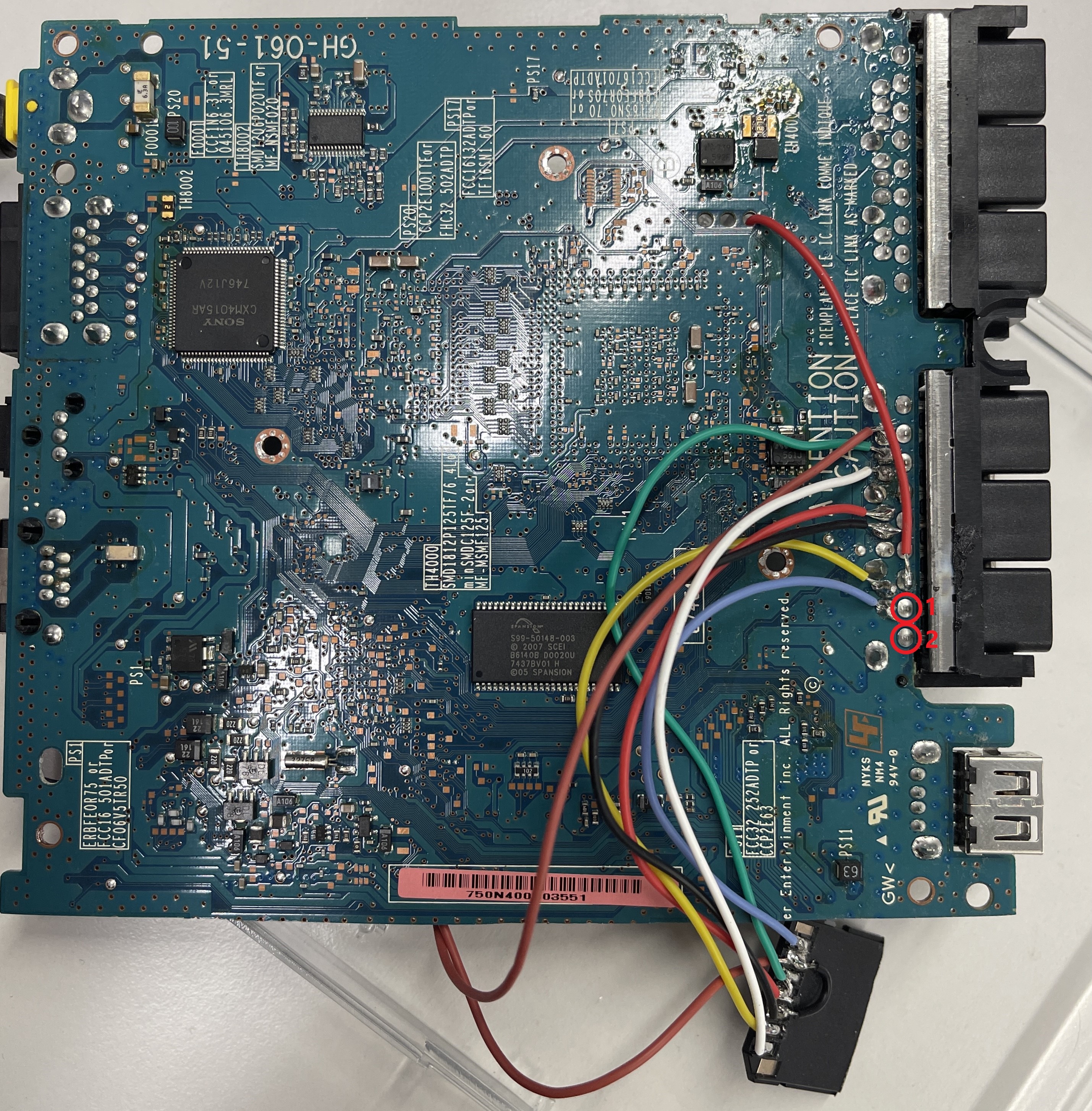

weak do you make a housing that would support the uncut pcb and the power switch setup with both usb's by chance i love your mod i worry about my skills is why im asking and would be willing to pay for the housing setup sir i only ask because im just learning how to solide.
Then what's the point of making it smaller :P I mean do disc drive is smaller but wear is the fun in that. Please don't take that the wrong way I do see your point.
Anybody has built it with a SCPH-79004 Mainboard? The Reset soldering doesn`t work.
I need more help. Specialy my board seems not to work. For my board i need a second workaround to soldering, that if i put the AC in, the ps2 starts immediately. Without to use this reset button.
It sounds like your reset circuit is shorted then or at least grounded out. I would troubleshoot the reset line before proceeding with anything else
Oreo Build VOD

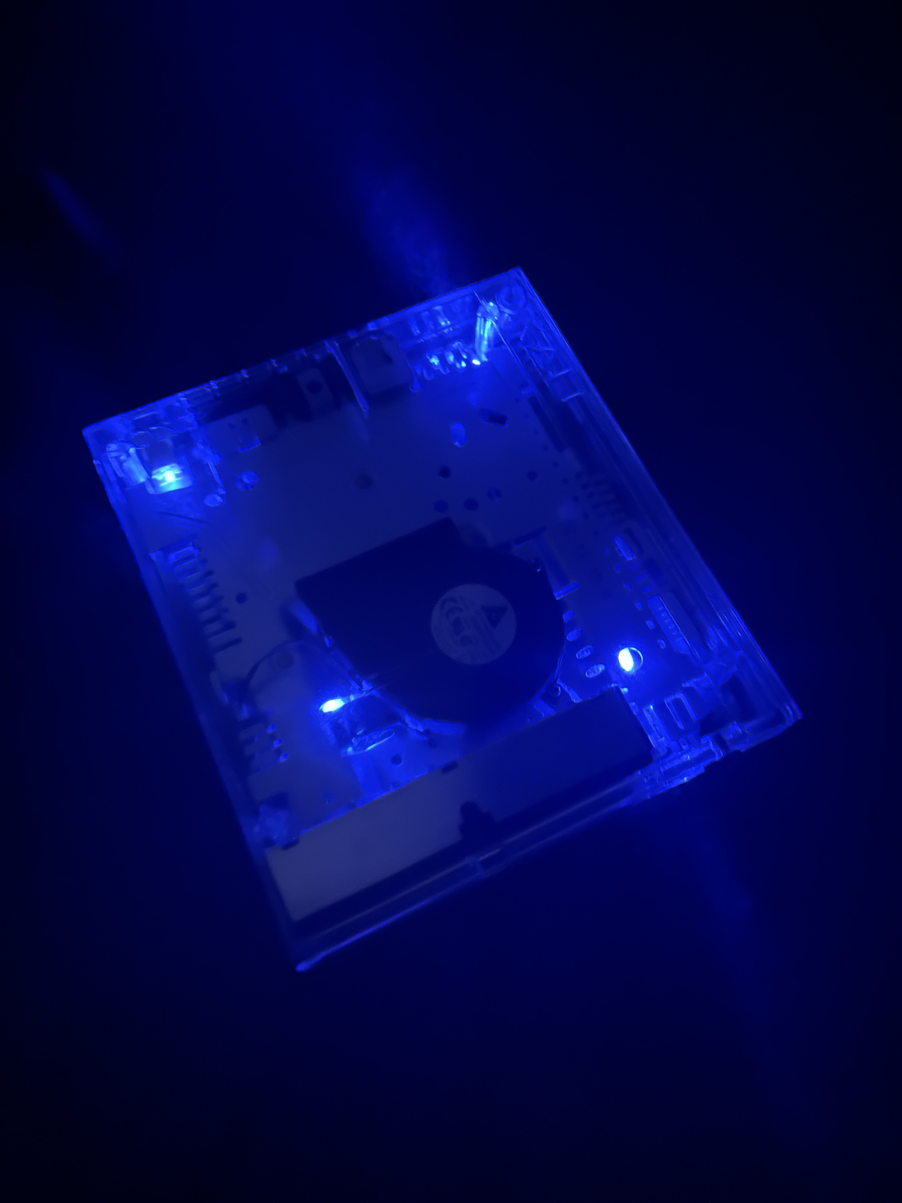

Such a great job! This inspired me to put some LEDs on my PS2 ultra slim as well. But unfortunetly i have to work with an 79004 motherboard and I have no clue where to solder those to x)
Hopefully someday anyone out there is going to attempt such a mod and can provide some pictures so I can recreate it :D
It just looks so much more stunning with some LEDs in it ♥

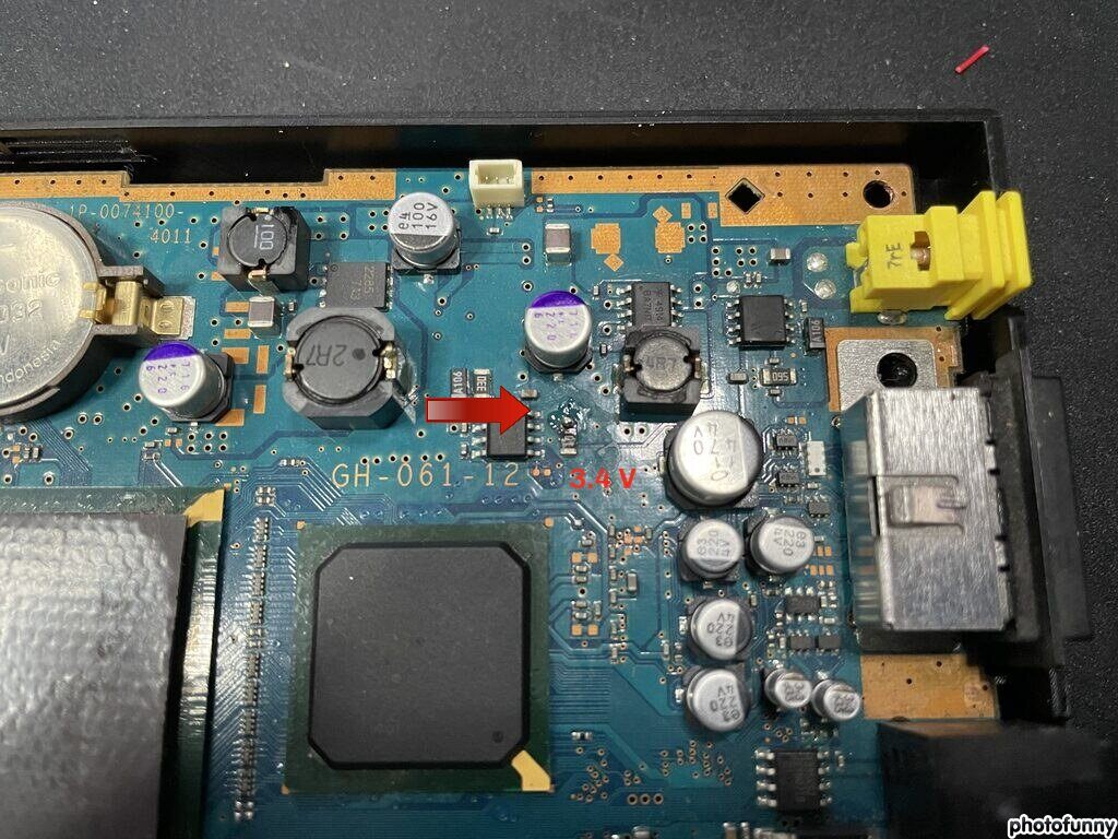

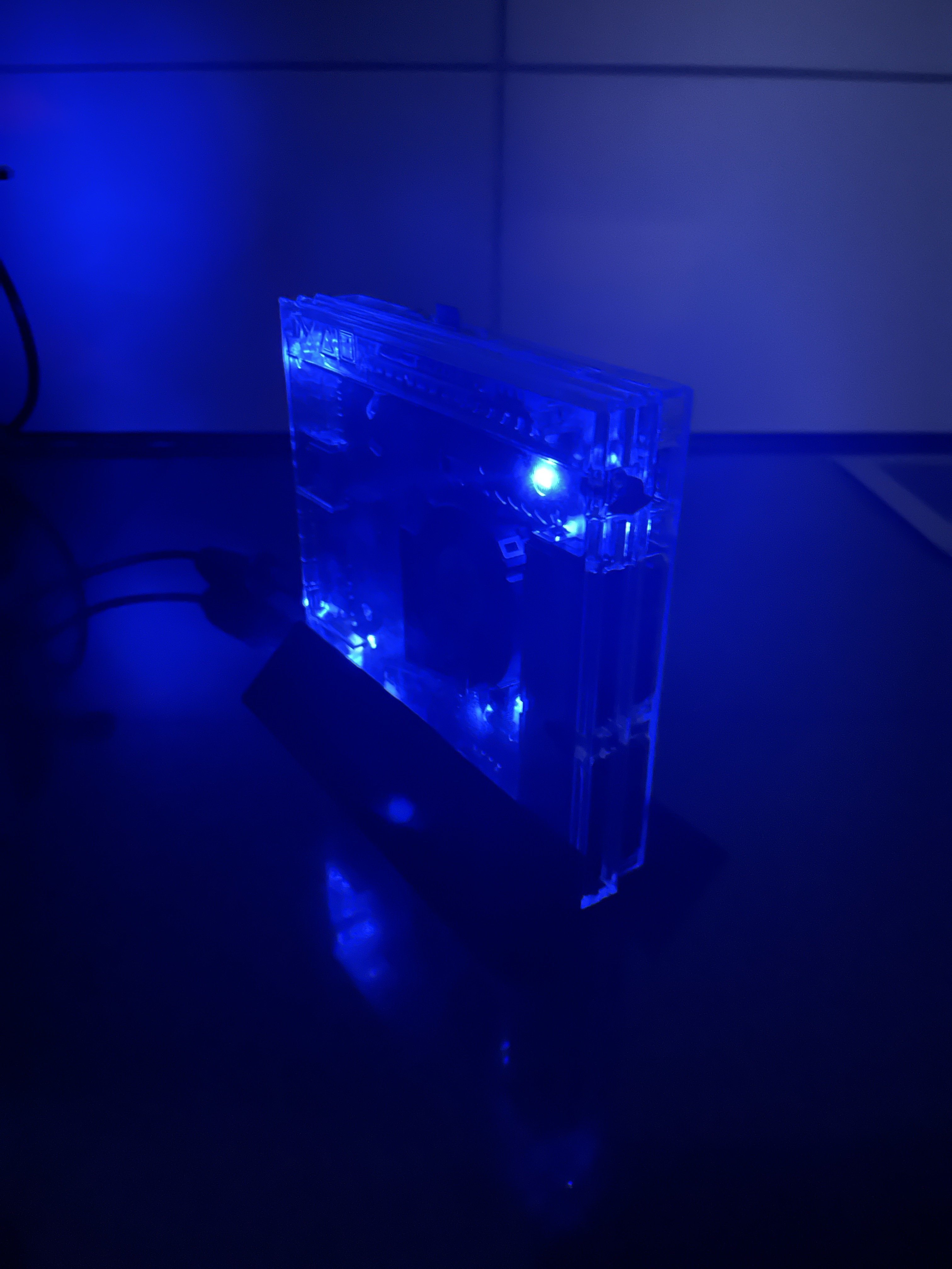

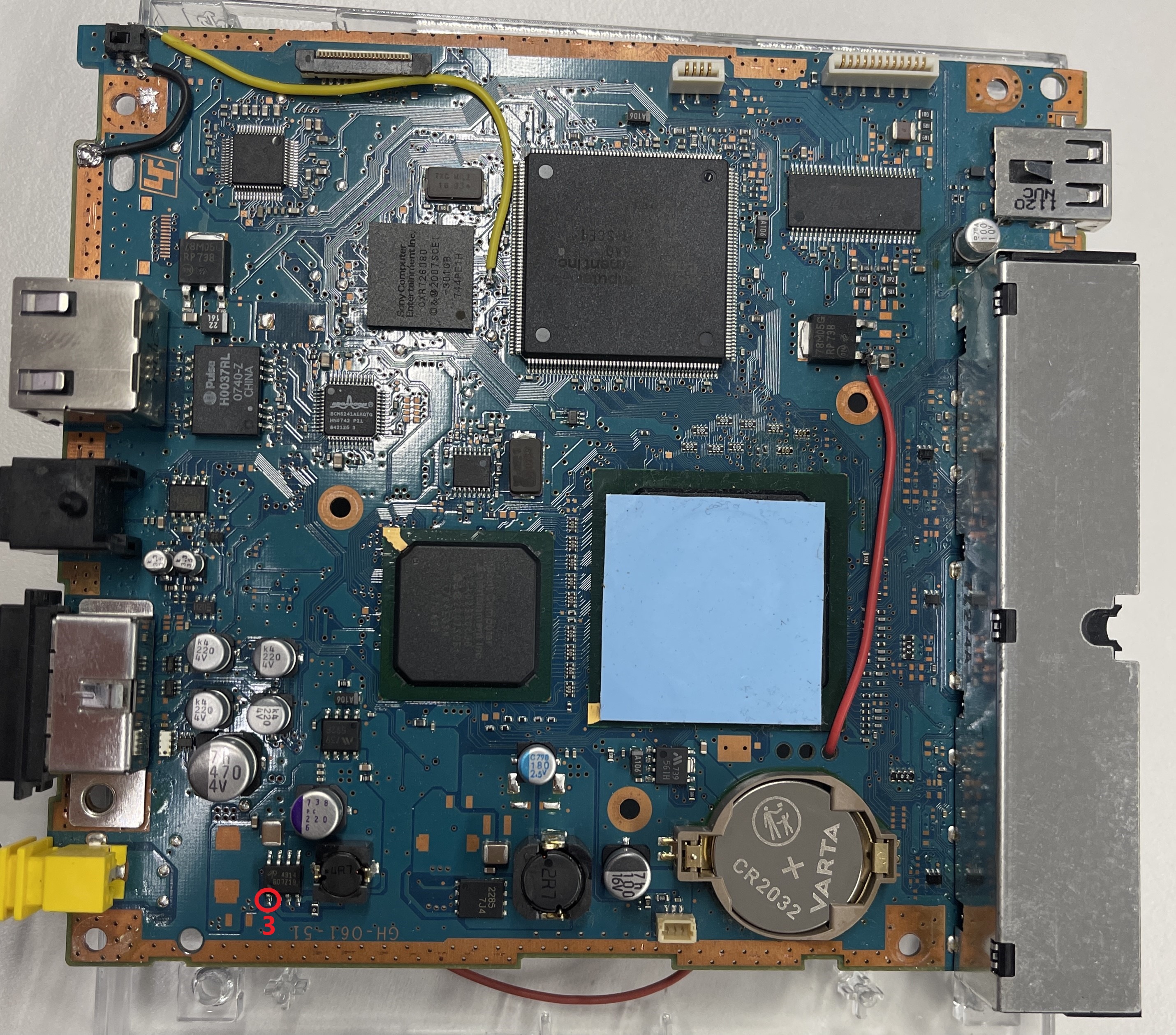

Thank you for the comments. You should be able to prove for a suitable source if you have a multimeter, at a minimum you could power your LED's from the 5v rail and use a resistor calculator to get to the correct voltage.

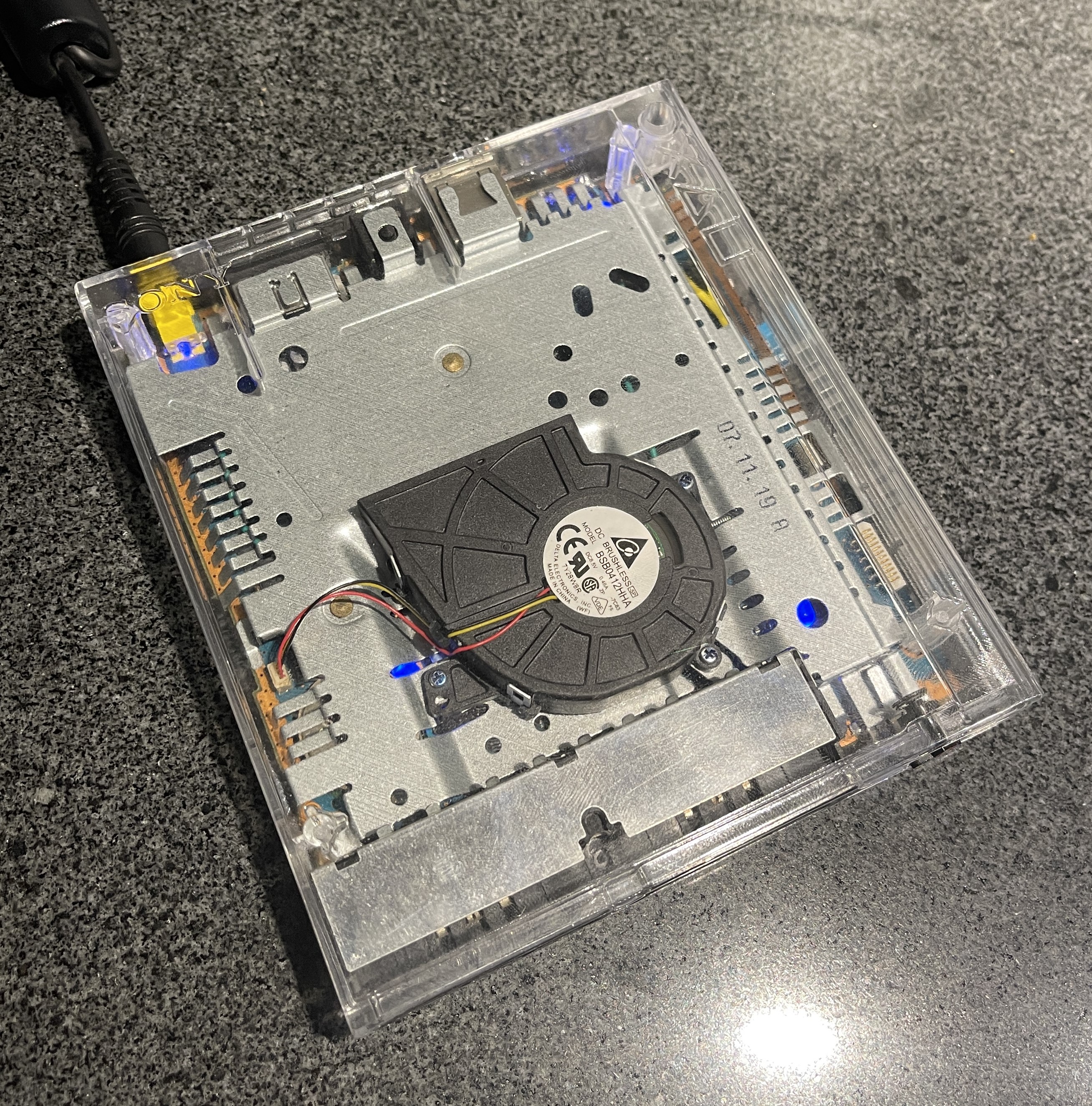

Just for a quick update ... I got my hands on a multimeter and meassured various point on my 79004 board. I found 3 point, that provided 3,5V.
I marked them in this picture. Since I didnt find anything only, at least now the info is out there :D

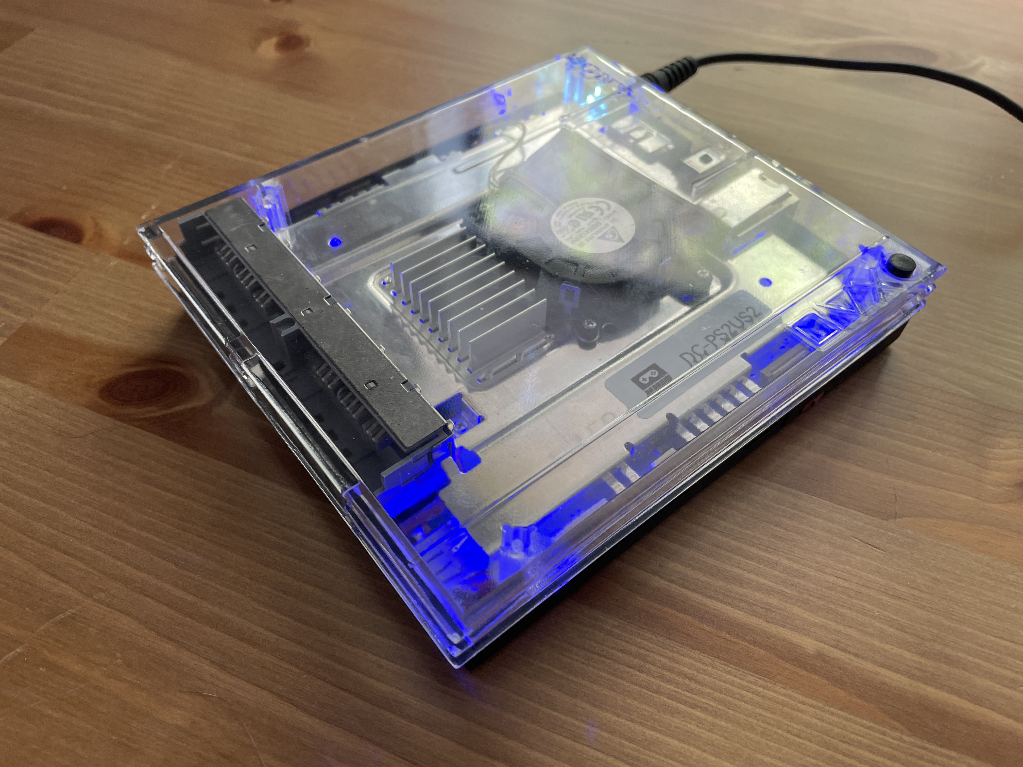

I soldered my LEDs to point 2. And here are the results :)
The LEDs are not noticeable when the lights are on. But they shure light up the system when my lights are out!
Its more like an indicator if the console is running or not. Otherwise the only indicator is the fan spinning.
I'm quit happy with it ♥ :)
And i Have to thank this forum so much! Otherwise I could have not built this thing. so thanks to everybody in here :)
View attachment 26723View attachment 26724
View attachment 26725View attachment 26726View attachment 26727

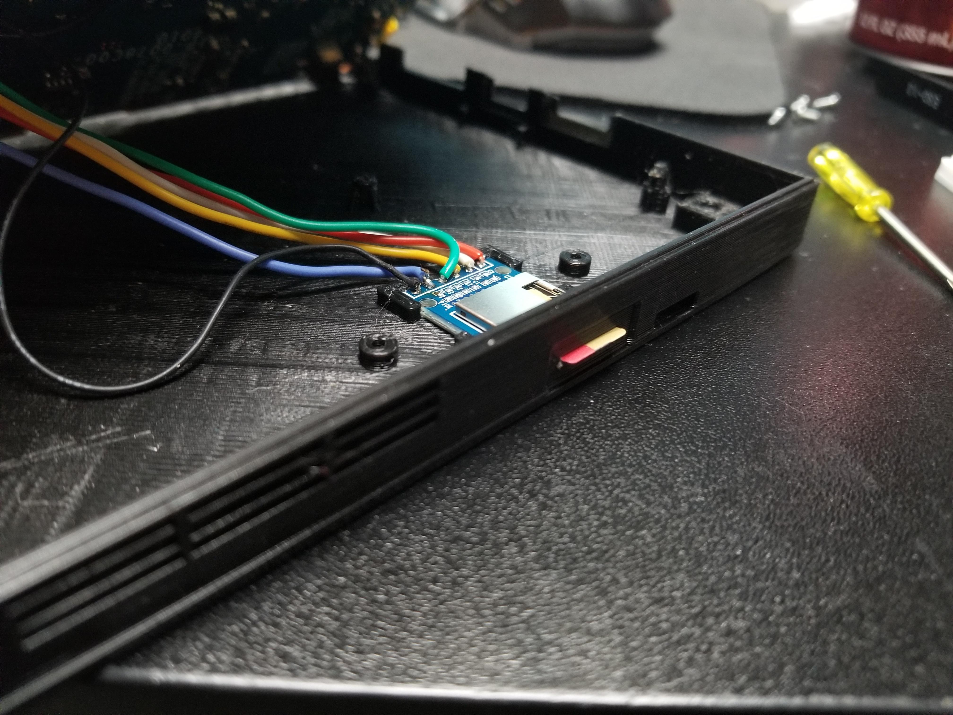

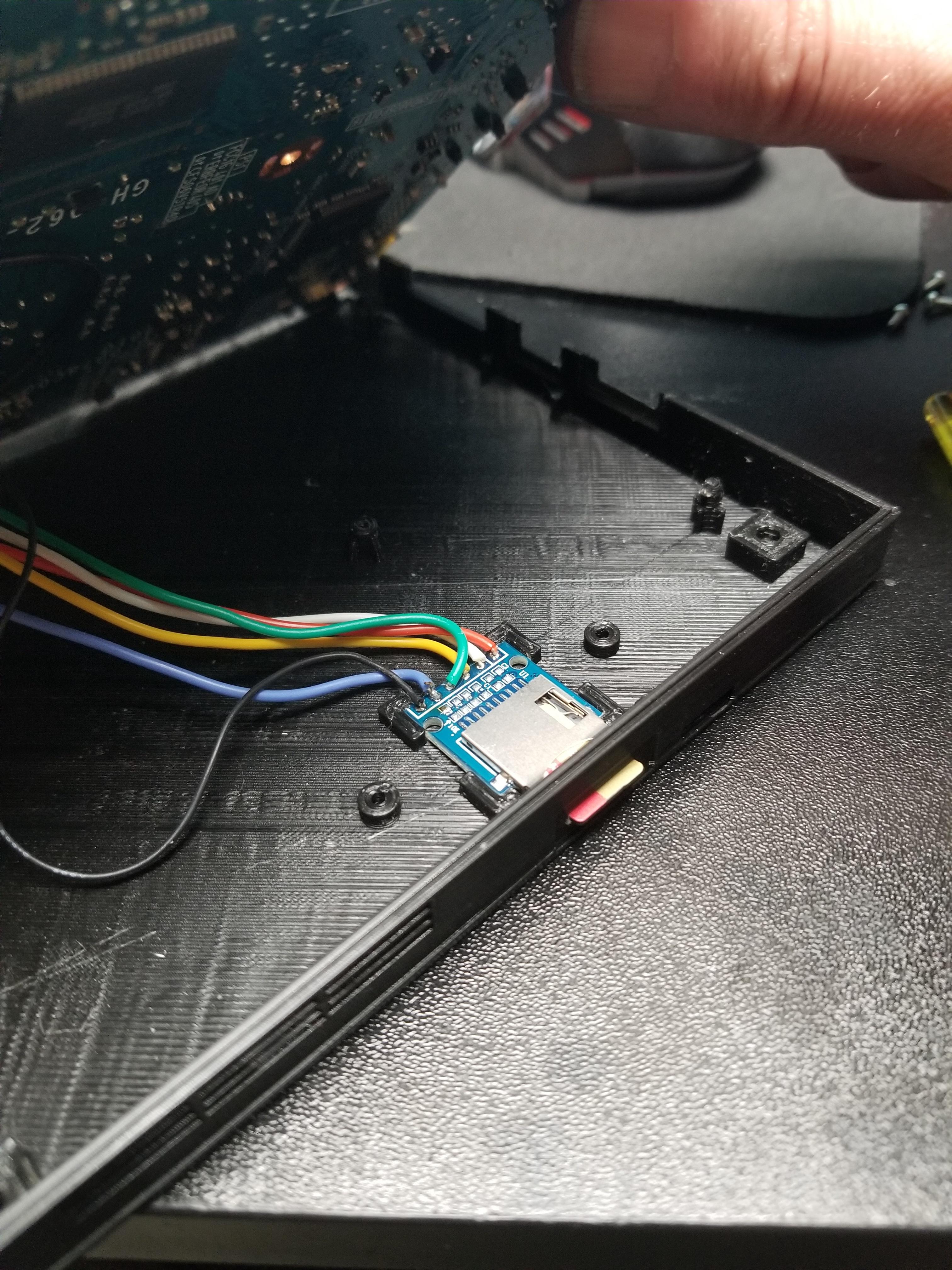

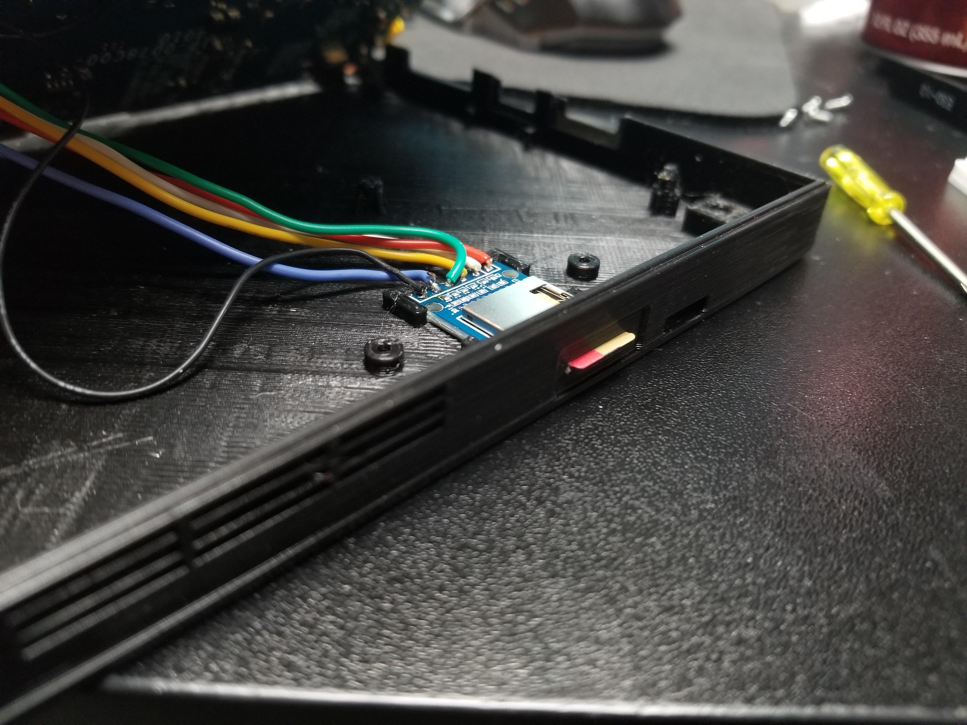

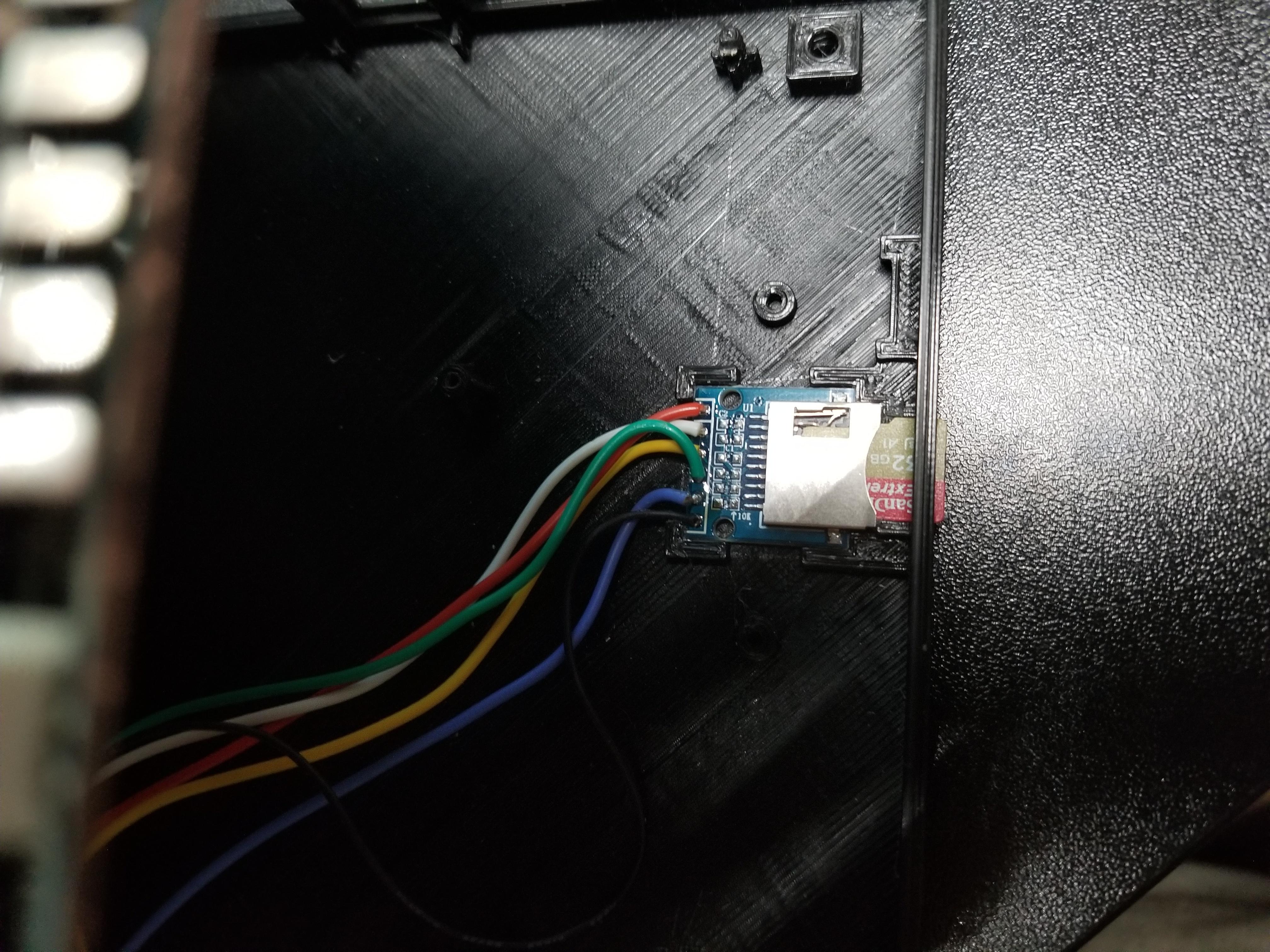

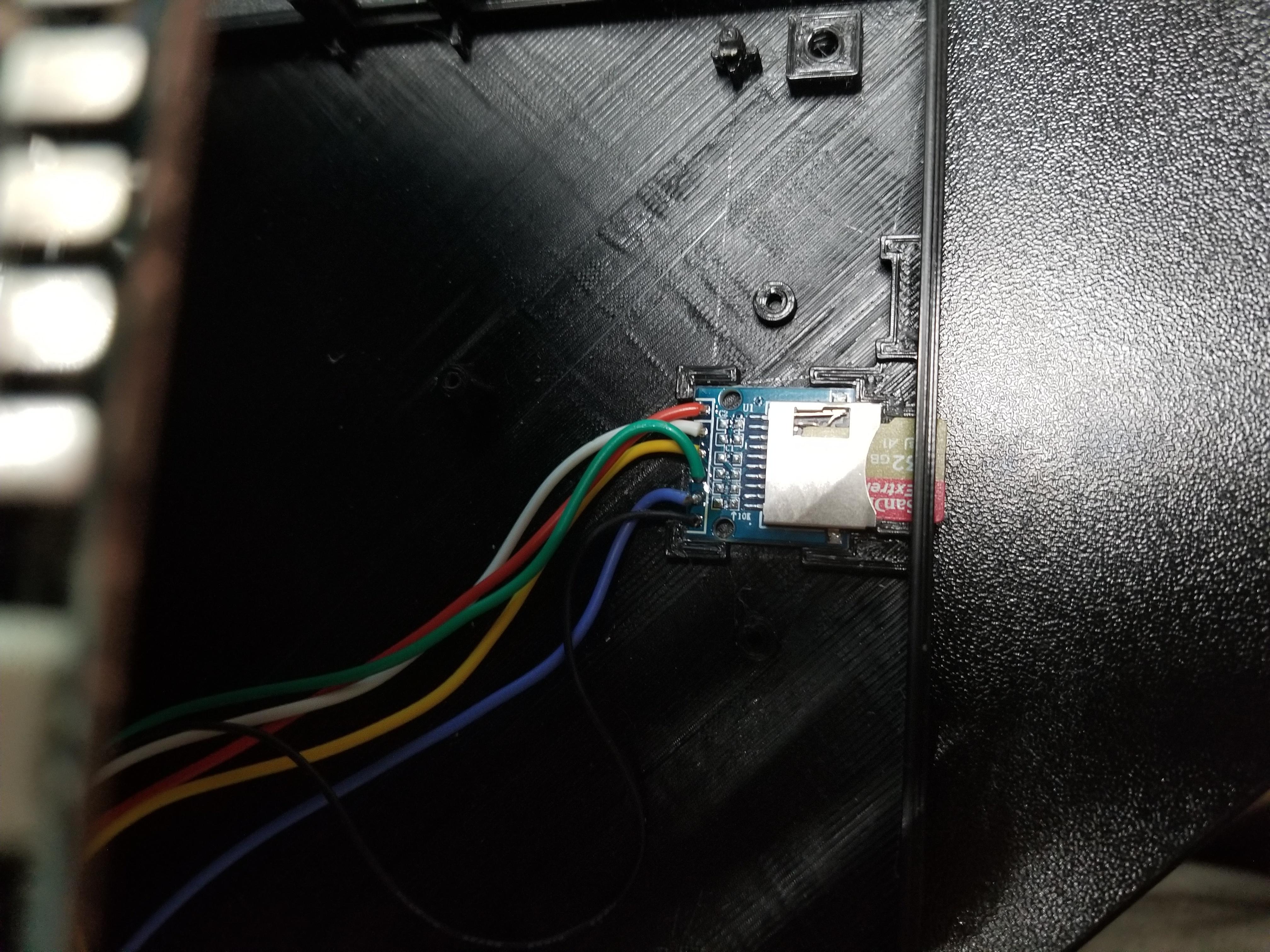

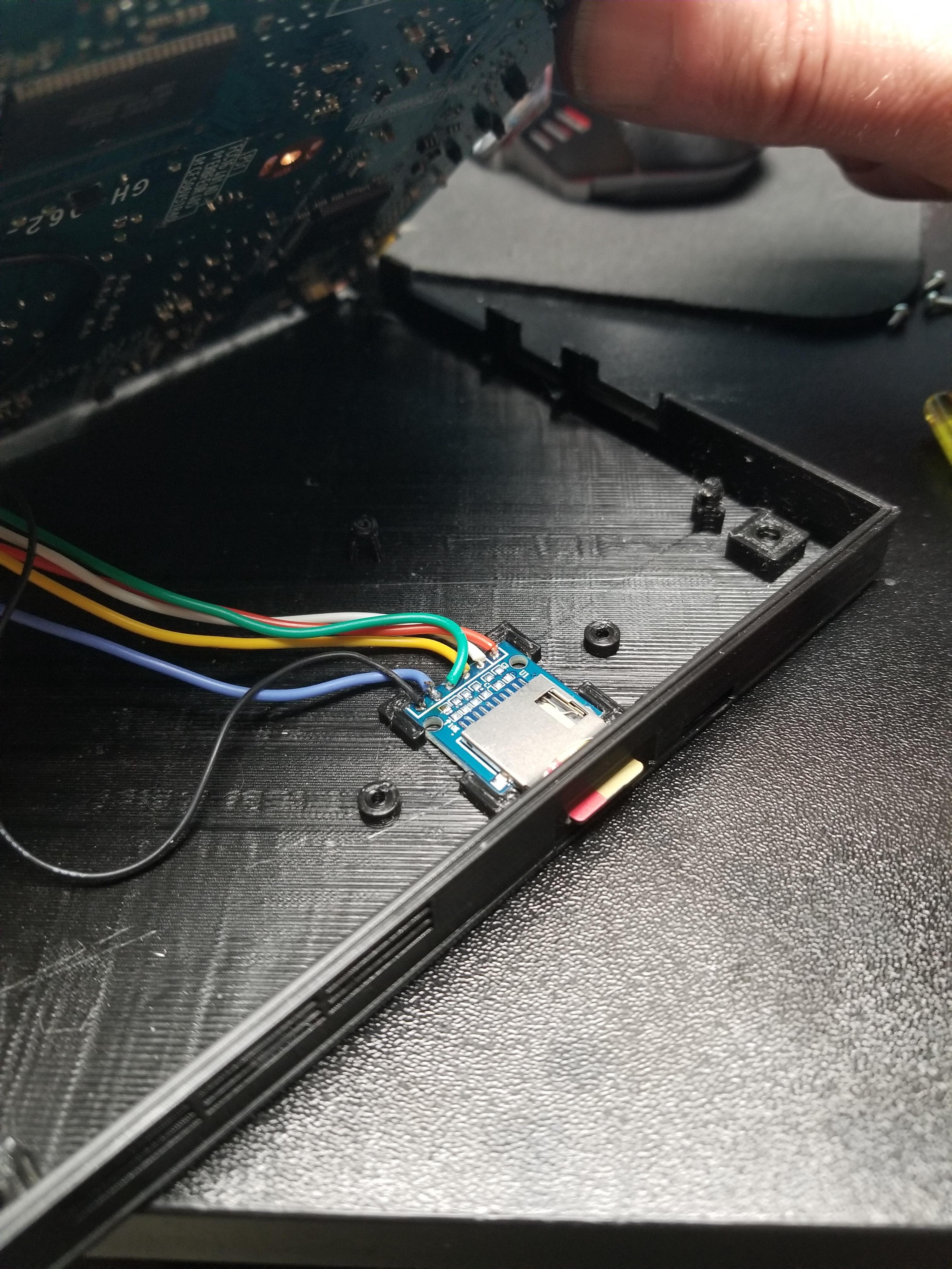

@Wesk: I've replaced the SD micro adapter portion with one of those cheap Micro SD Arduino Modules in my personal build remixing your file. With your permission, I'll release it here. Otherwise I'll just keep it to myself. The problem with this is that the module doesn't have an ACK connection and I figure I could just wire it differently, I figure I'll just make my own mock memory card that fits the design of the front and be done with it since I don't plan on using the second port anyway. Also, I was using an SCPH-79001, so my lid switch was located to the power board rather than on the board itself. On the 79001, the board just ends about 15mm in so I designed a place holder for a simple tact switch there as well. Of course others would have to use a similar type of switch to make it fit properly or I can provide an editable file for that as well. Mine has about a 5mm pole in the center so it works fine with the button presses and creates an 'L' around the pole so it isn't going anywhere. Oh yeah, I redesigned the SD bracket as well to fill the space above the SD card so the card doesn't get lost inside the case upon insertion. Here is my reddit post of the "prototype" I made, which is most likely my final version as far as it goes for myself.
View attachment 26728View attachment 26729View attachment 26730
Hi there, can you please post your edited stl?
