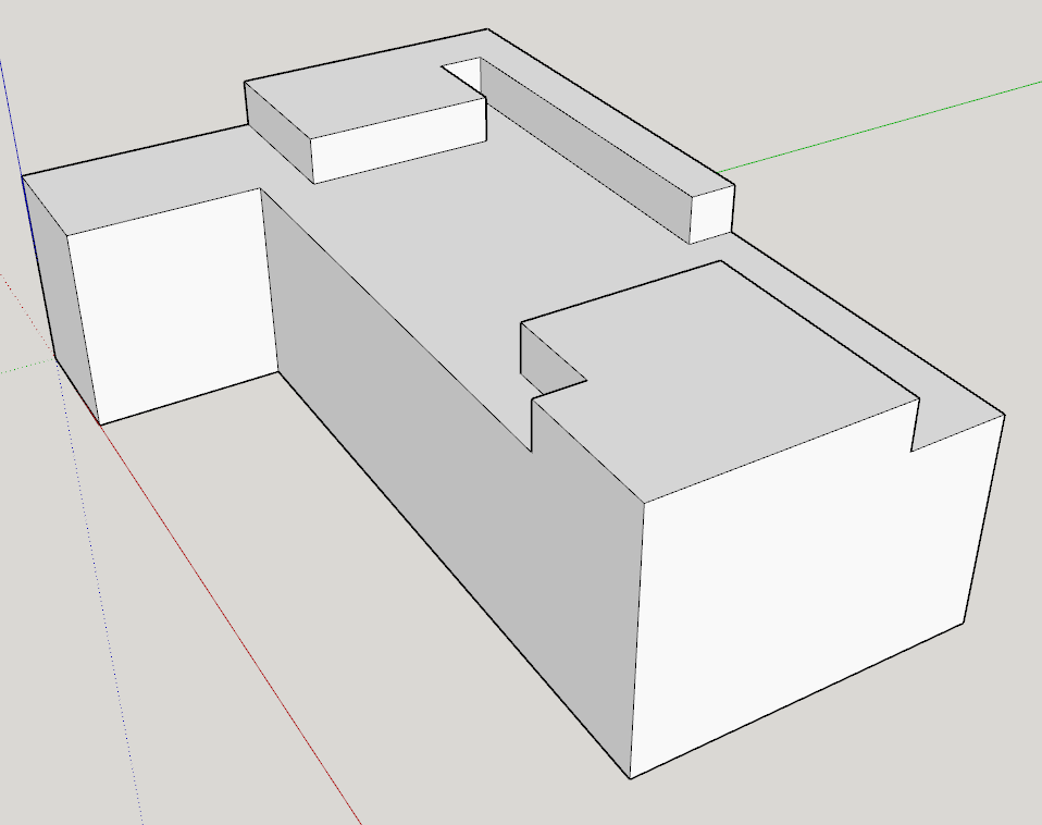

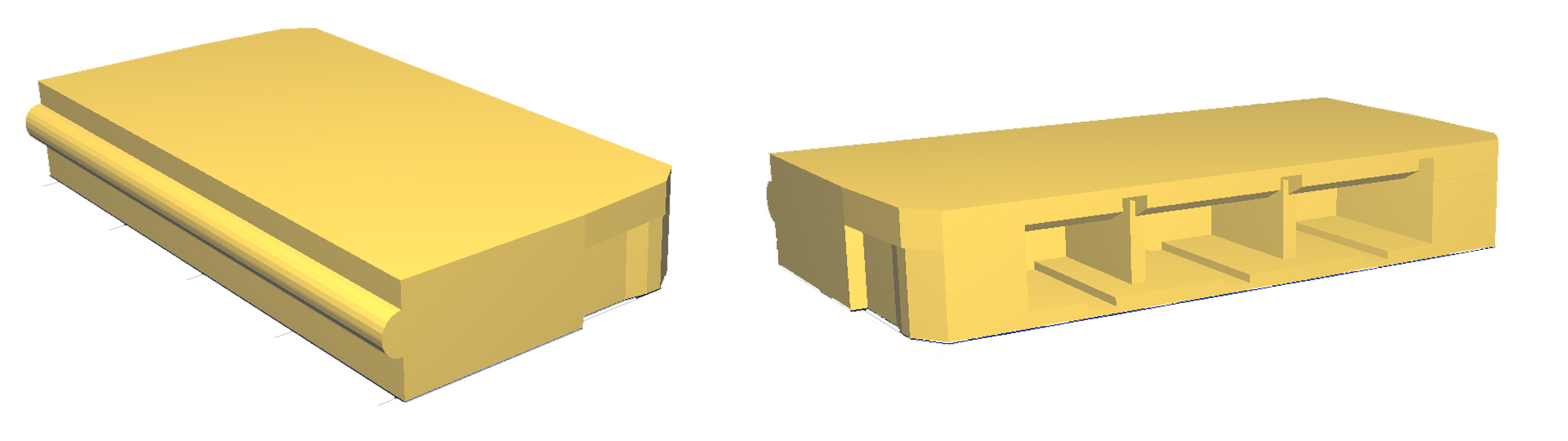

As mentioned previously, here are files from my personal contributions including the dummy memory card placeholder and power button spacer for the SCPH-79001. I have not seen any confirmation on permission to share my edits to the files already provided so at least for the time being, those will remain unprovided. Also, please note that the memory card placeholder was intended to be a semi-permanent solution in my build. It's not intended to be inserted and removed easily. You'll most likely have to open up your case in order to remove it once plugged in. The power button is intended for tactile switches such as this one with a 5-8mm pole in the center.

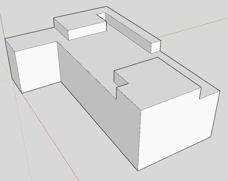

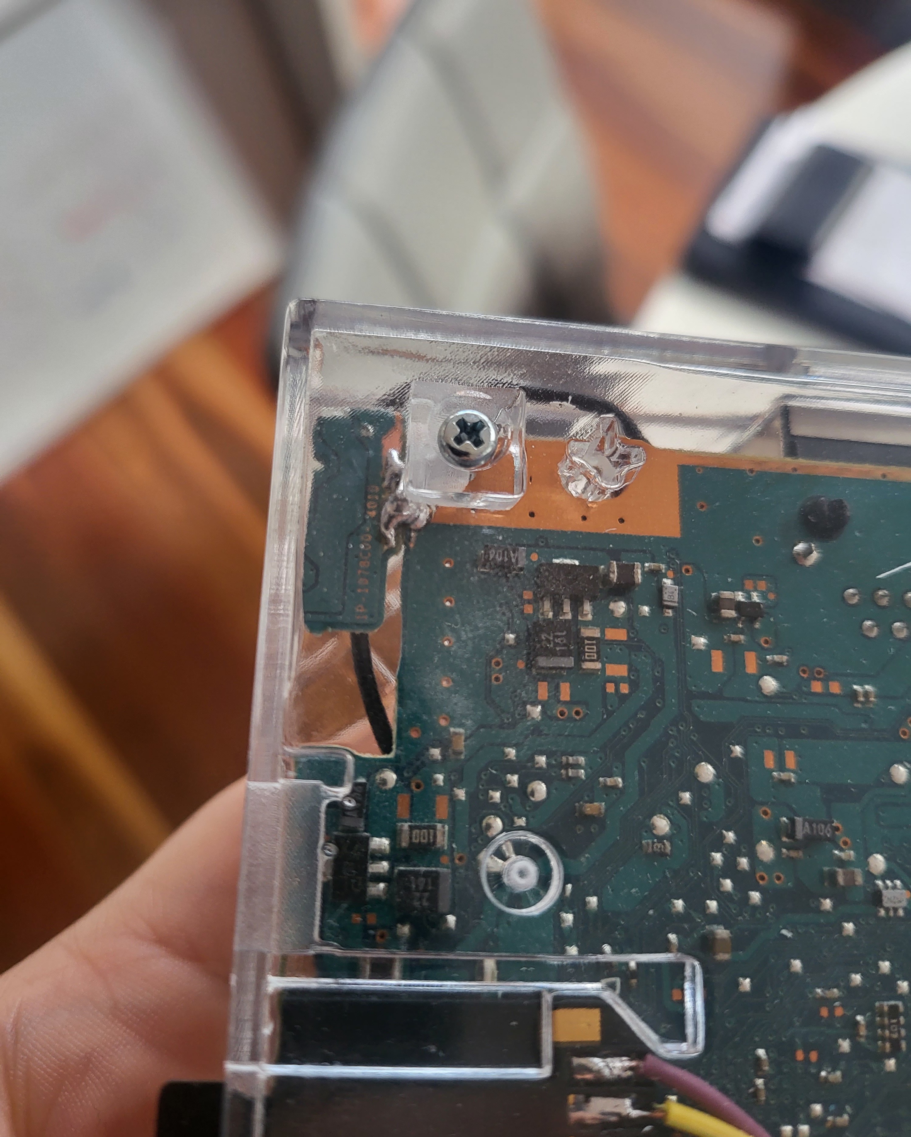

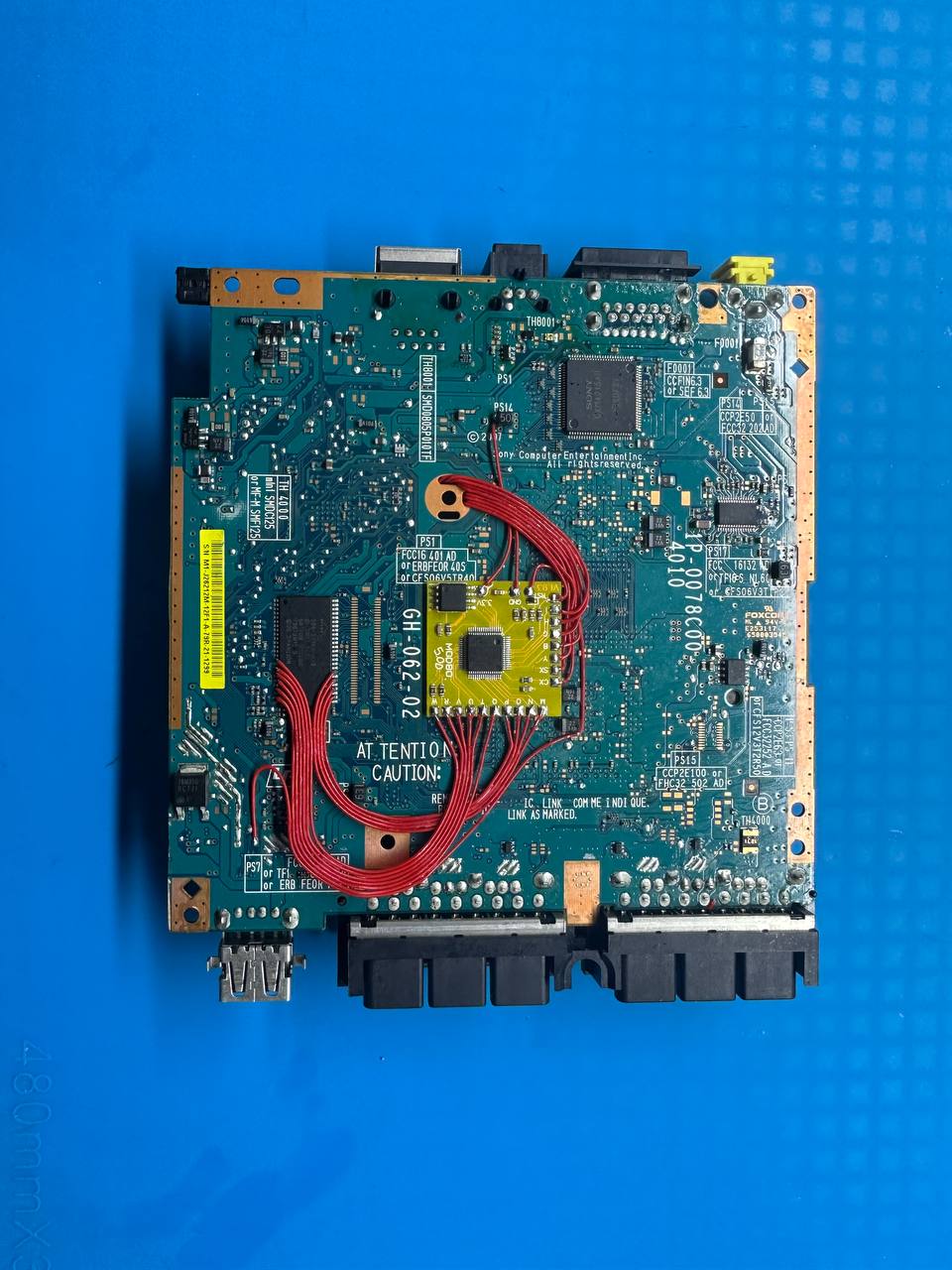

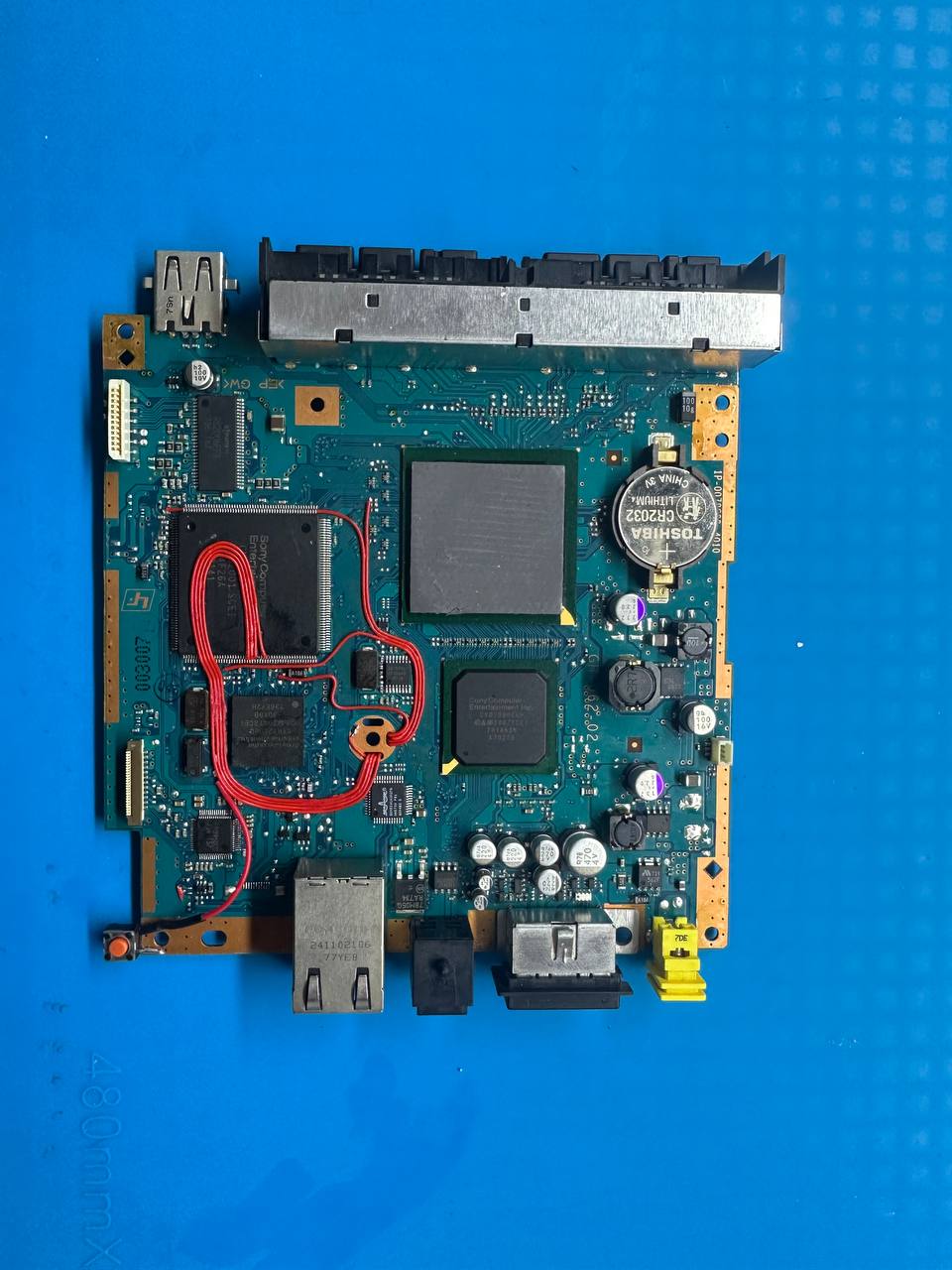

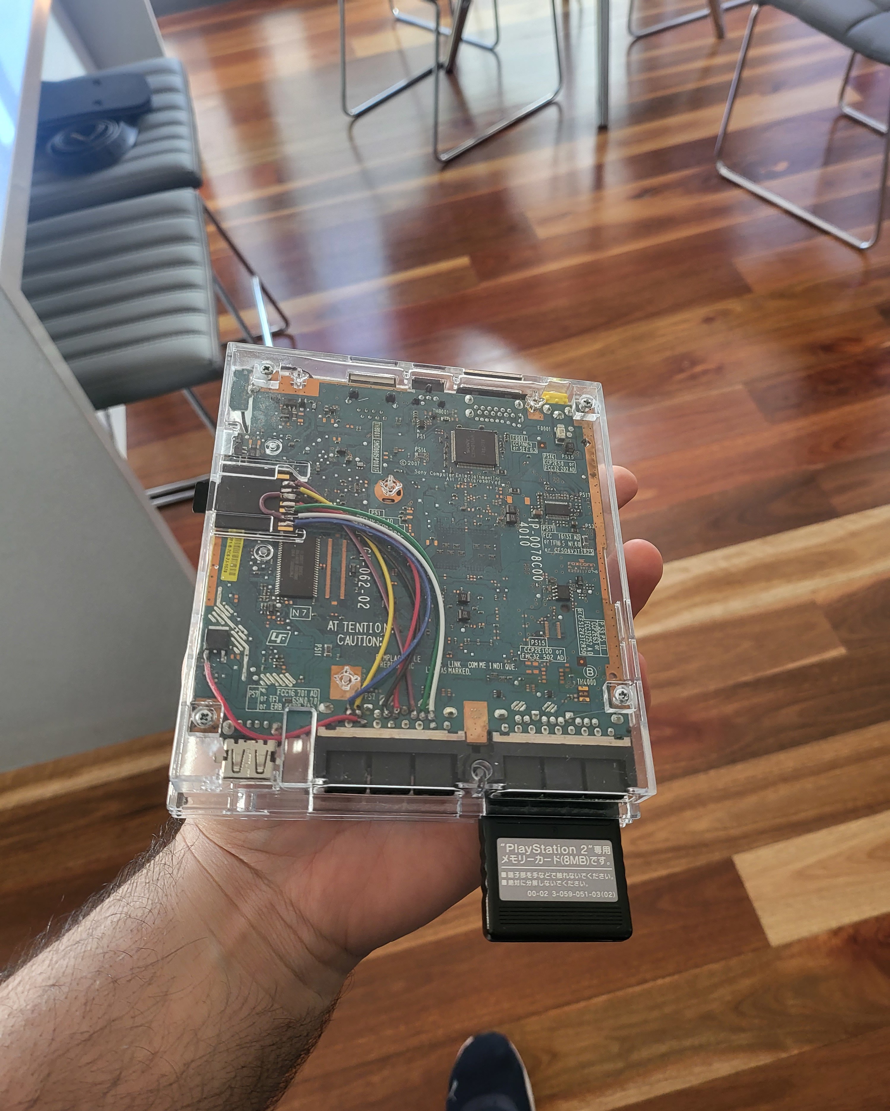

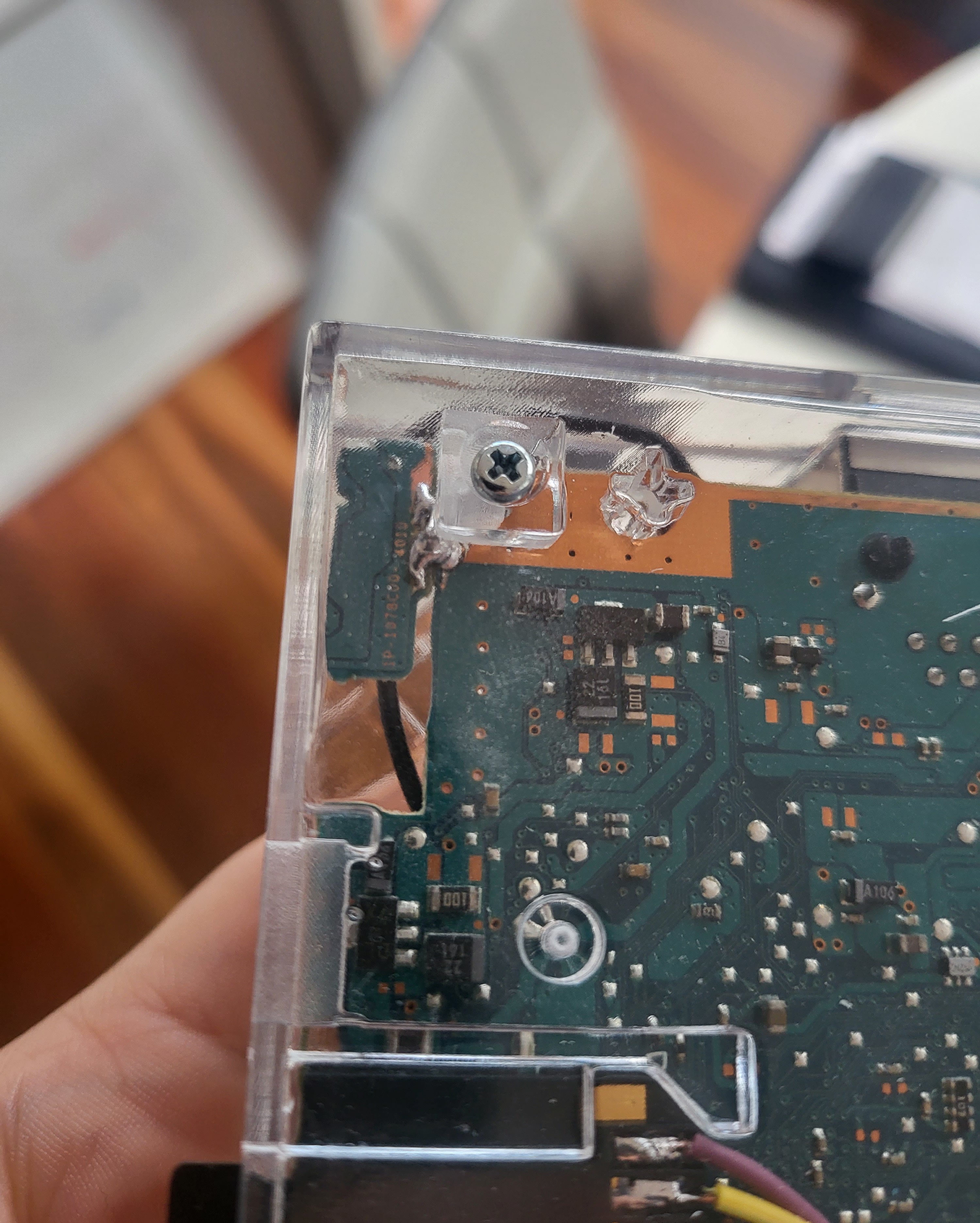

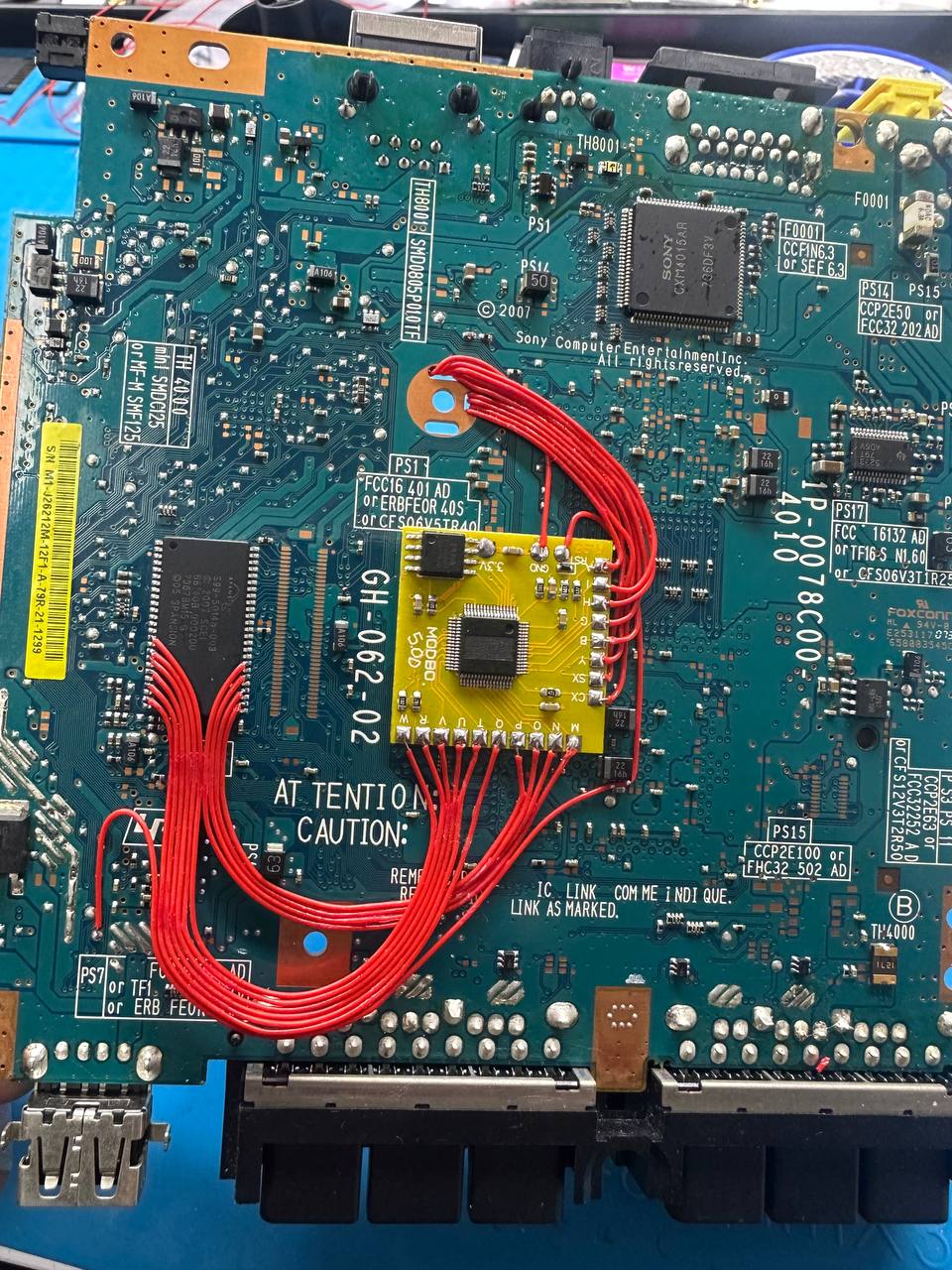

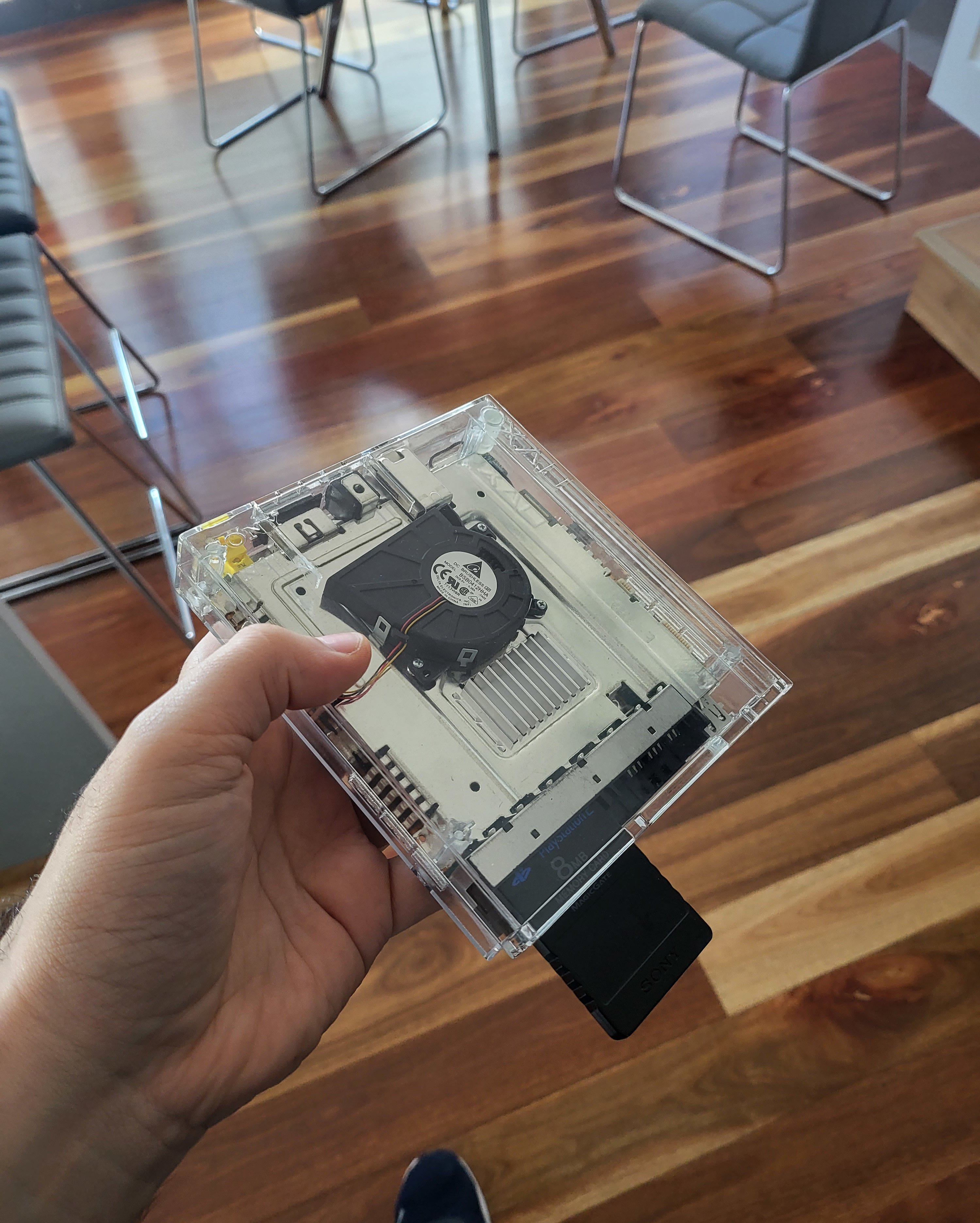

Just wanted to say, confirmed a build using SCPH-79002. This mb didnt have the lid detection switch on the motherboard itself but instead on that extra board connected via the small ribbon, what i did was trimmed this extra switch board into a rectangle, shaved away the solder mask on both this board and the motherboard and then joined the two boards with a large blob of solder from the underside (see third image), its very rigid and touches the 3d printed power cylinder. I had to use the reset pad pointed out by another user here to get it to power on but otherwise was a pretty straight forward and fun mod.
I still have issues with the sd card but i think its more to do with not choosing a samsung or not using the 100ohm resister.
Still need to order leds for it and shorten the cable runs, its a bit messy.
an internal blueretro mod would be nice for this too
for reference i used a dremel to cut the initial line followed by a dremel sanding wheel attachment for cleaning the edge. I sanded with the wheel at 45deg from top and bottom of the board (effectively creating a triangular edge) to avoid cross plane shorts
Thanks Wesk

Thanks Wesk
I do have one query though, does anyone know if there are pads exposed for the standby and active leds usually seen on the power/reset button? I'd love to hook into that and retain some factory led function.

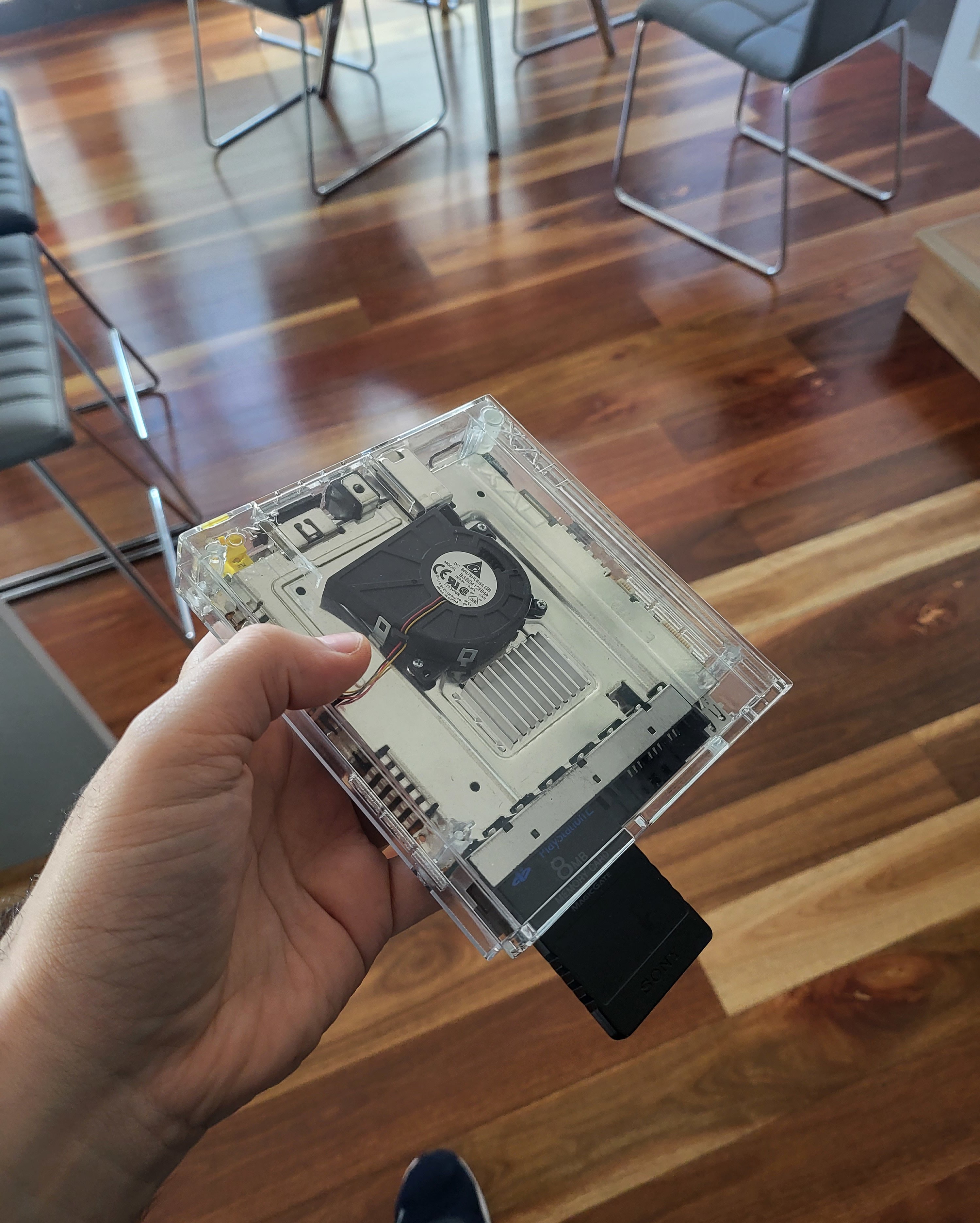

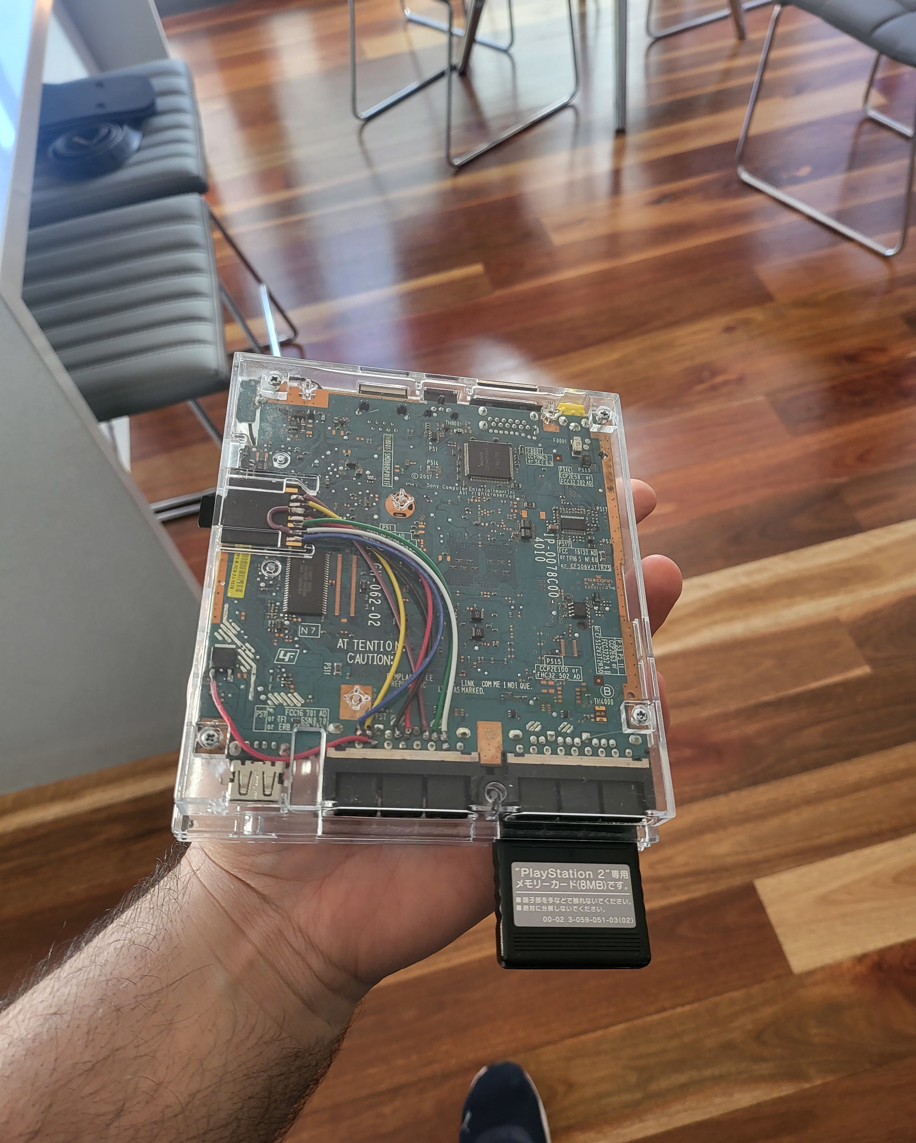

One more button solution)
next one step)

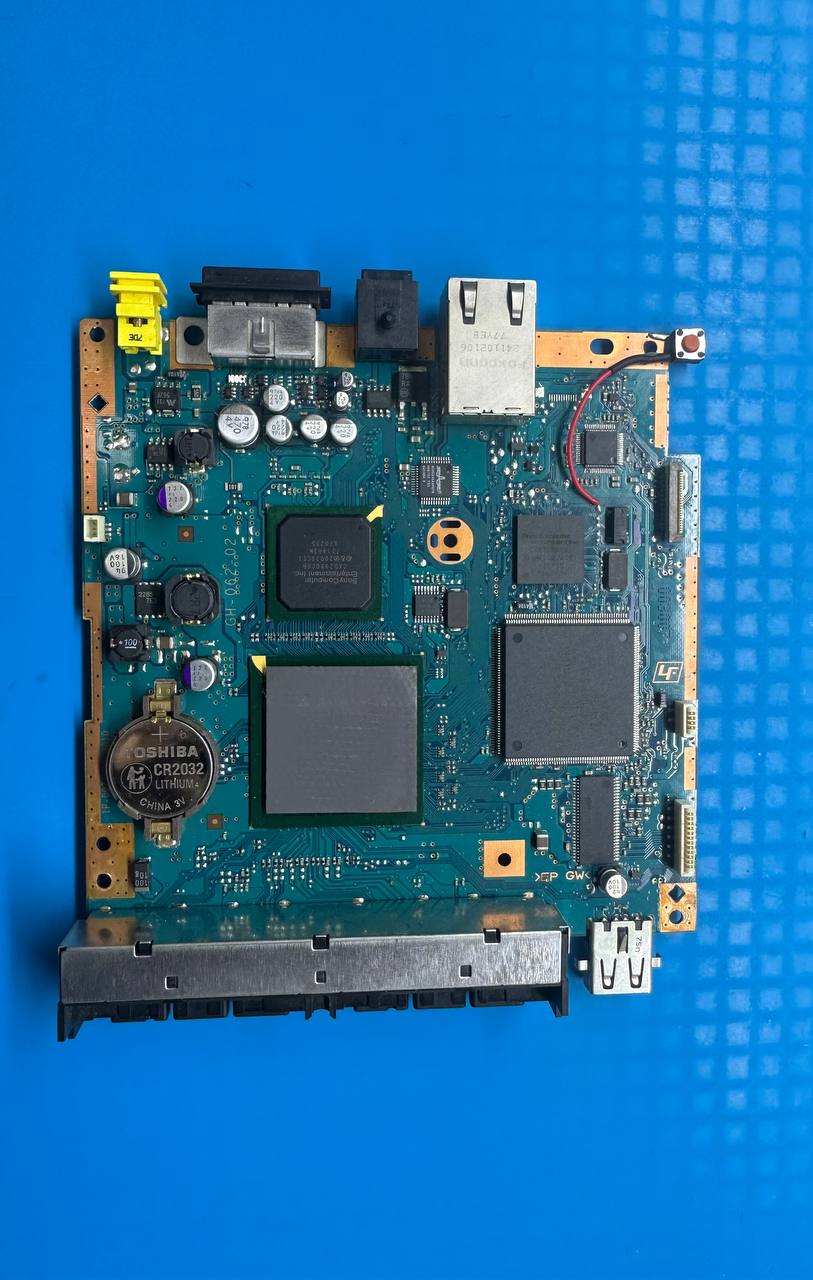

Awesome mod! The MX4SIO worked for 2 days (100 Ohm, 79001) but now for some reason neither OPL nor ulaunchELF sees the sdcard. It shows up in the browser but it's blank. I probed each memory card point for a short but found none. Any reason why this may happen? (USB works fine)
Edit: It was the SDCard adapter, maybe the stress of pushing the MicroSD in bent a pin or something. Swapping it out fixed it.

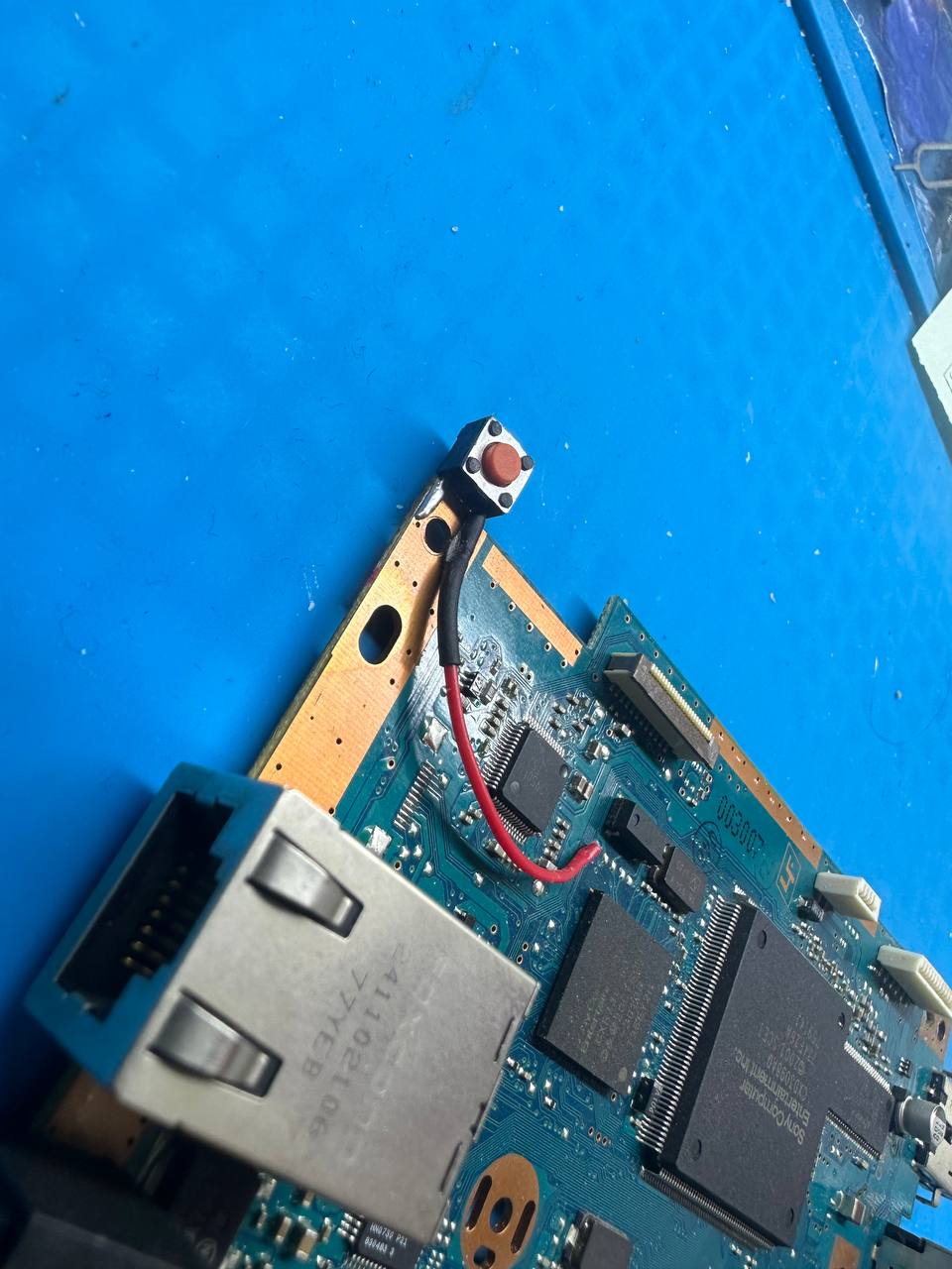

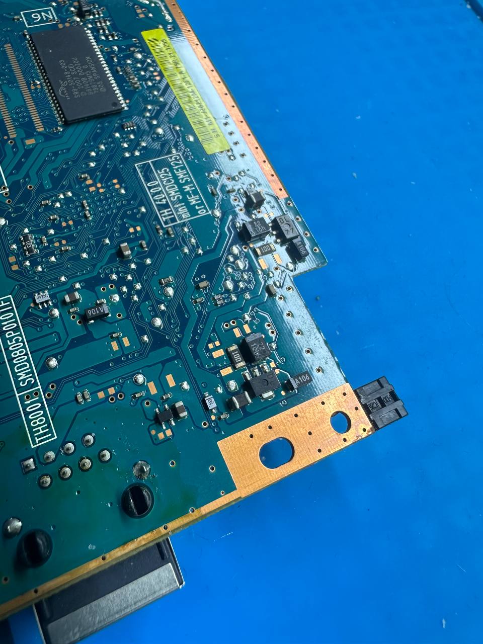

I see we have the same board. What power switch do I need to get since mine is missing the lid switch? Thanks
I believe the lid switch is just a momentary push switch, so any basic tact switch would do the same job. You might have to shop around to find one that has the same height as the stock lid switch though, else you may run into trouble getting the tact switch to fit under the printed power button

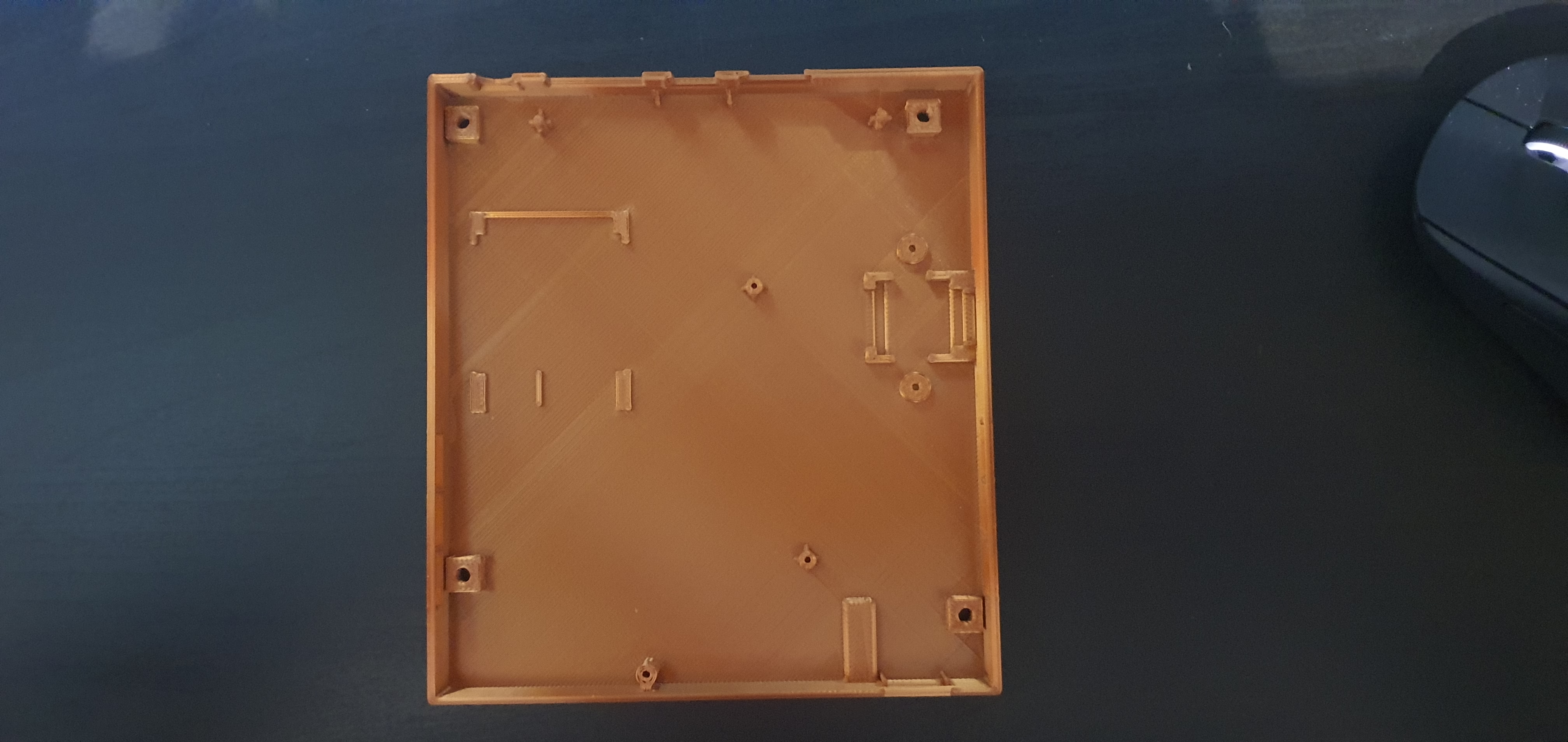

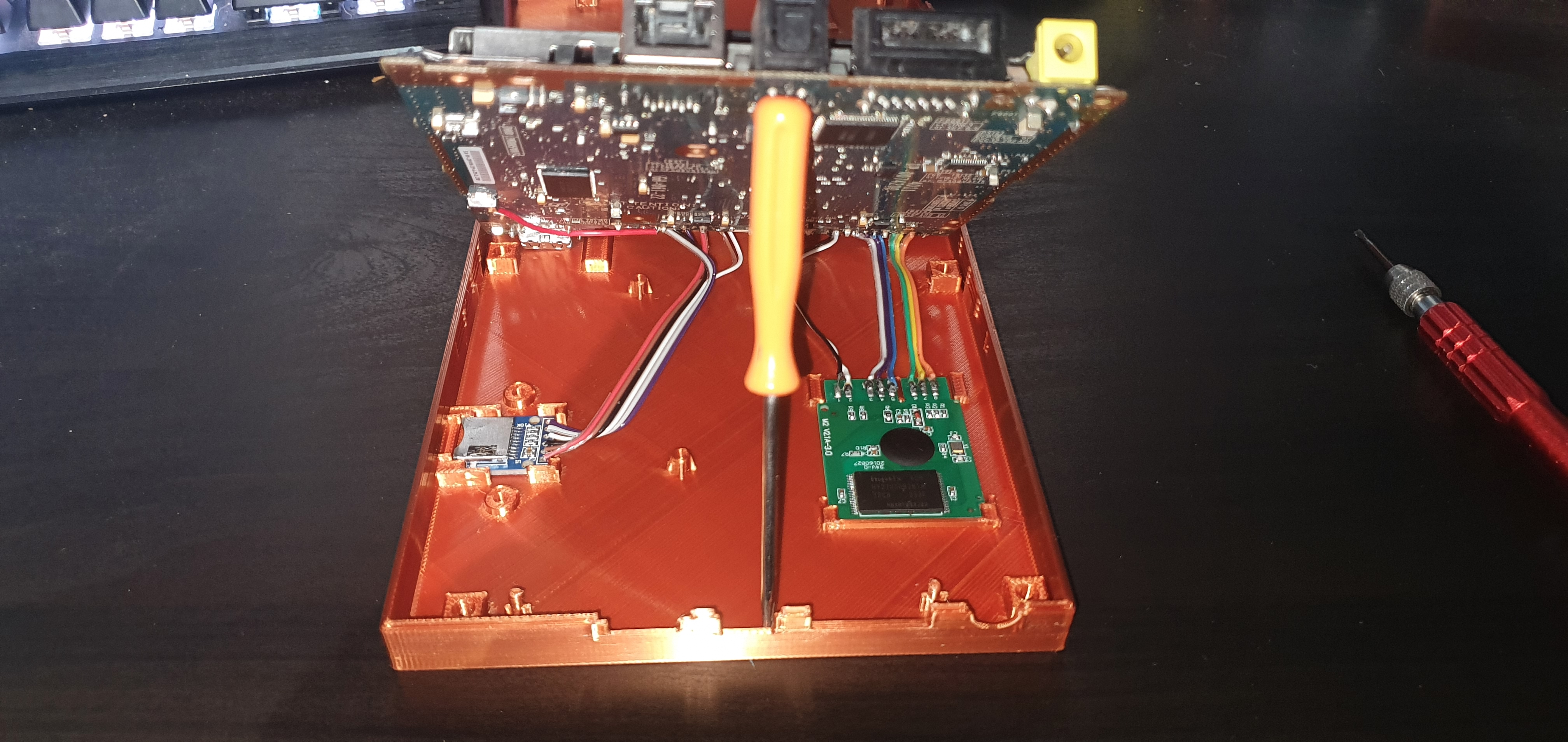

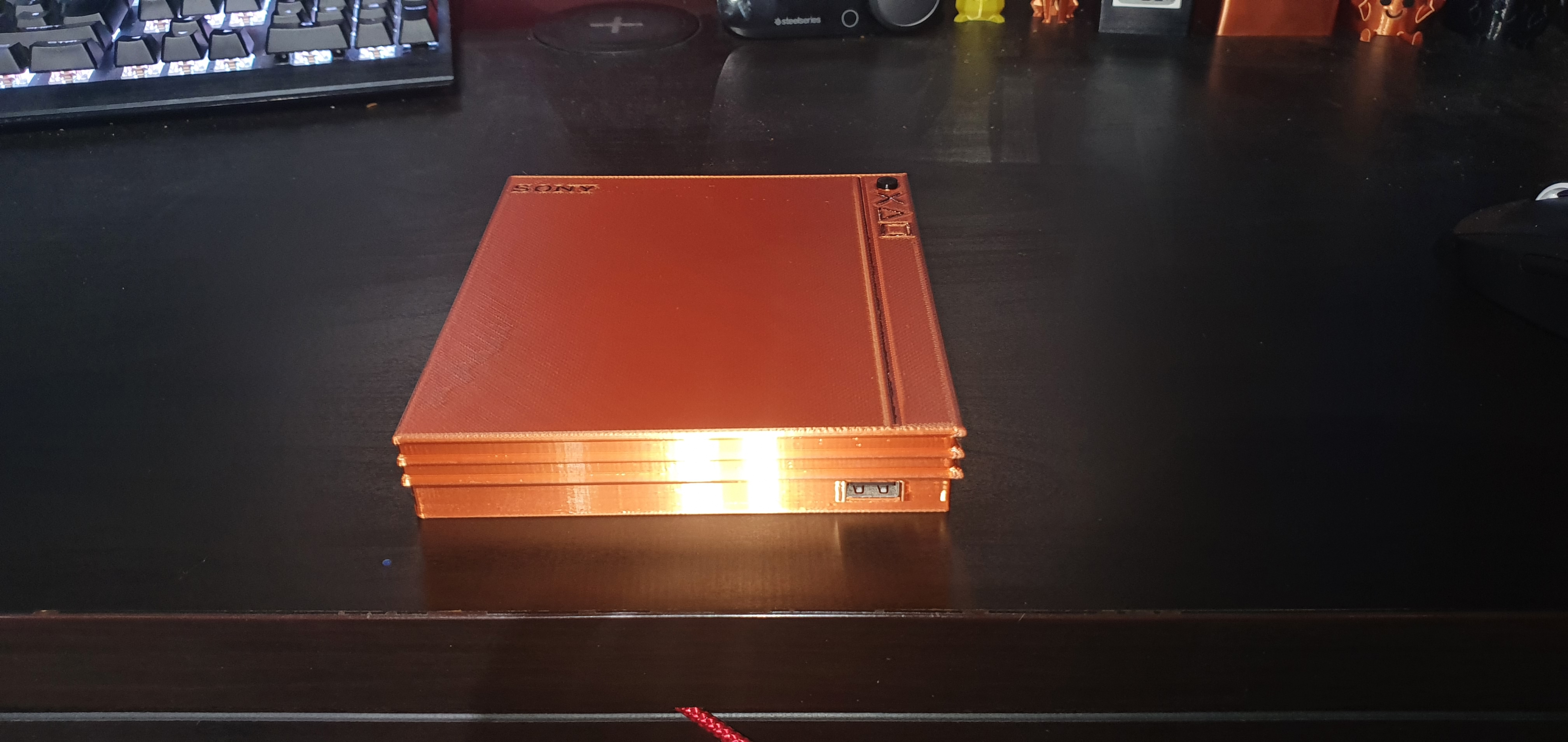

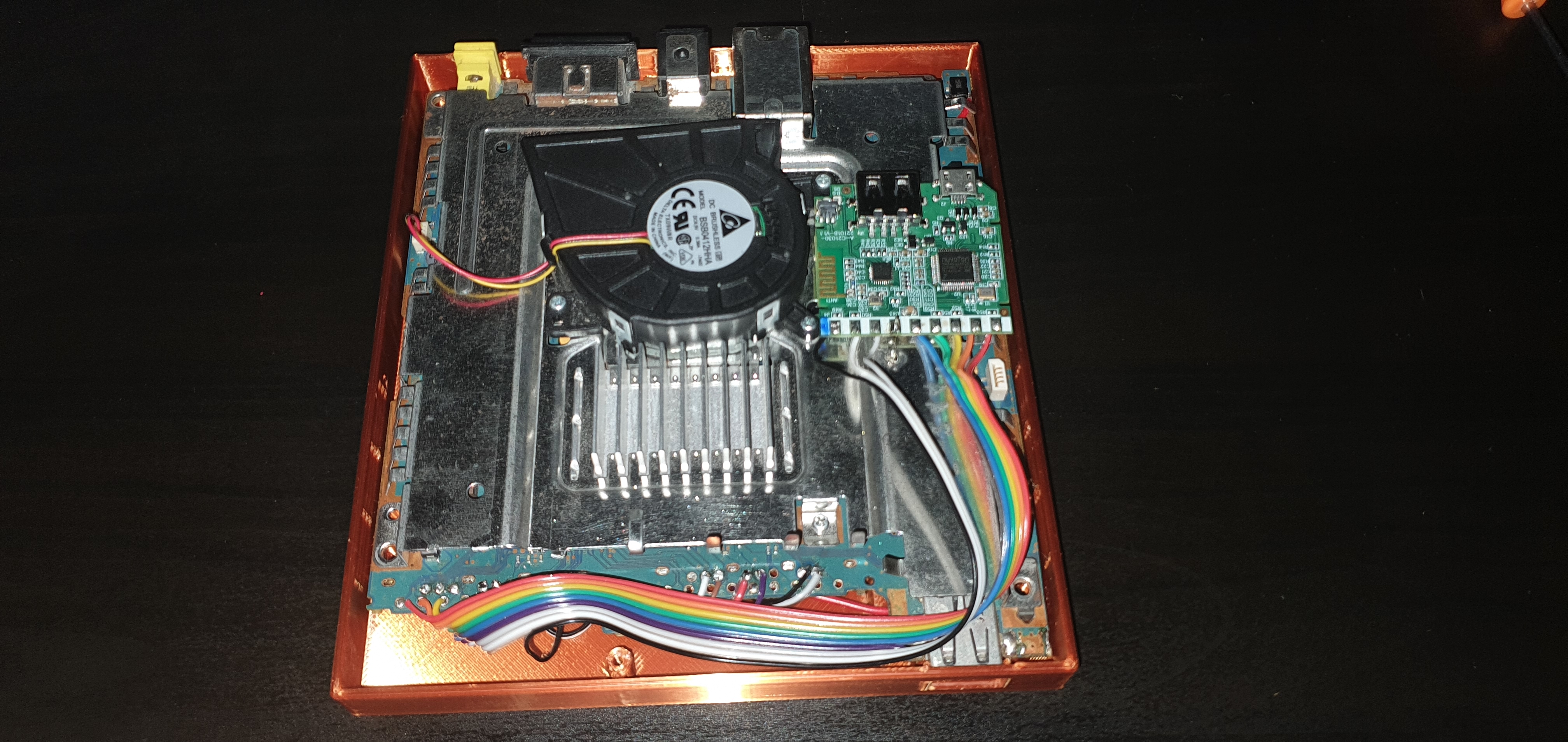

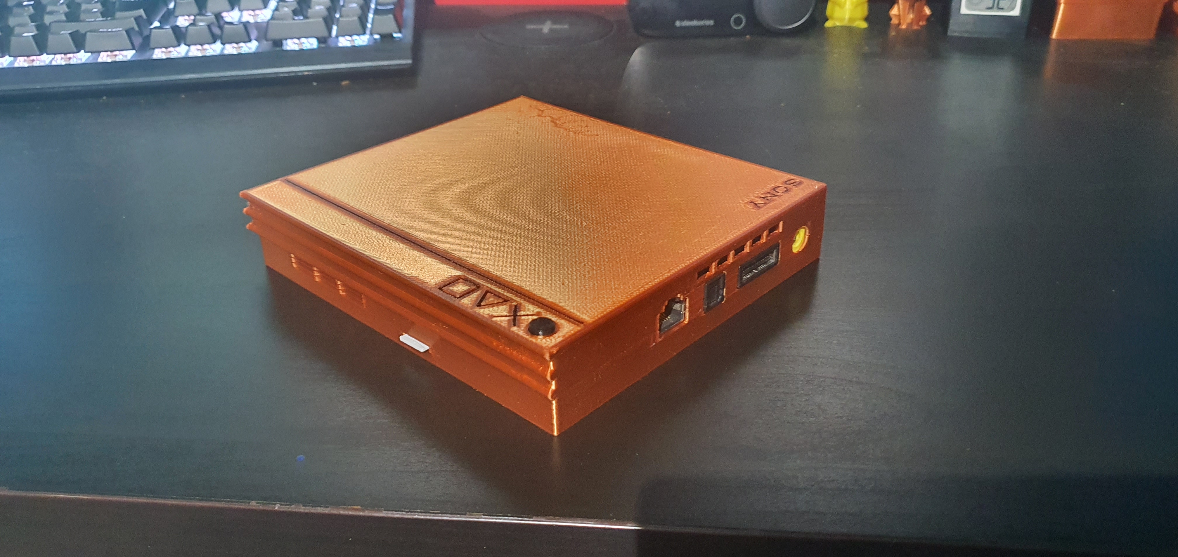

I managed to find a 79003 with a bad dvd drive cheap. Browsed this thread looking at other peoples mods, put some of my own in and ended up with this last week on my week off.
PS2 MODS
Removed controller and memory card sockets
Internal fmcb memory card
Internal brooks wingman paired to ps5 controller. Soldered to the top shield on stand offs to keep secure
Better sd card adapter
Case MODS
Filled controller and memory card ports
Removed and smoothed usb logo on front. I couldnt get it to print clearly.
Socket for fmcb memory card, clip fit so no bracket needed. Only comes out with a flick of a flat blade
Moved sd card adapter to the right some so it sticks out enough once smoothed, clip fit so no bracket needed. Only comes out with a flick of a flat blade
Thickened up the areas around the rear i/o to be the same as a factory case for strength
Printed on aquila pro. 0.2 layer, 100%infill, 50%perimeter overlap, no supports. esun pla silk copper because thats what i had the most of. Sharpie in the logos to make them stand out a bit.
Bottom 3hrs48, 20.87mtrs
Top 5hrs27, 25.11mtrs

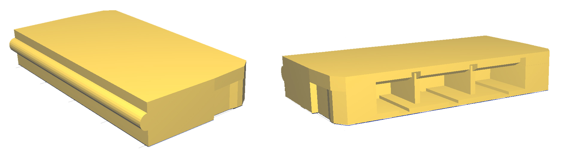

Hi! I'm making this mod, but instead of the sd adapter i will use a sd card module for arduino, and i need to modify the case 3d file to fit some other mods on my board (internal hdmi port, internal ssd along the remaining usb port and a couple of toggle switches for managing the game input)..So, I was wondering Do you have by any chance the 3d model of the PS2 79k board?
