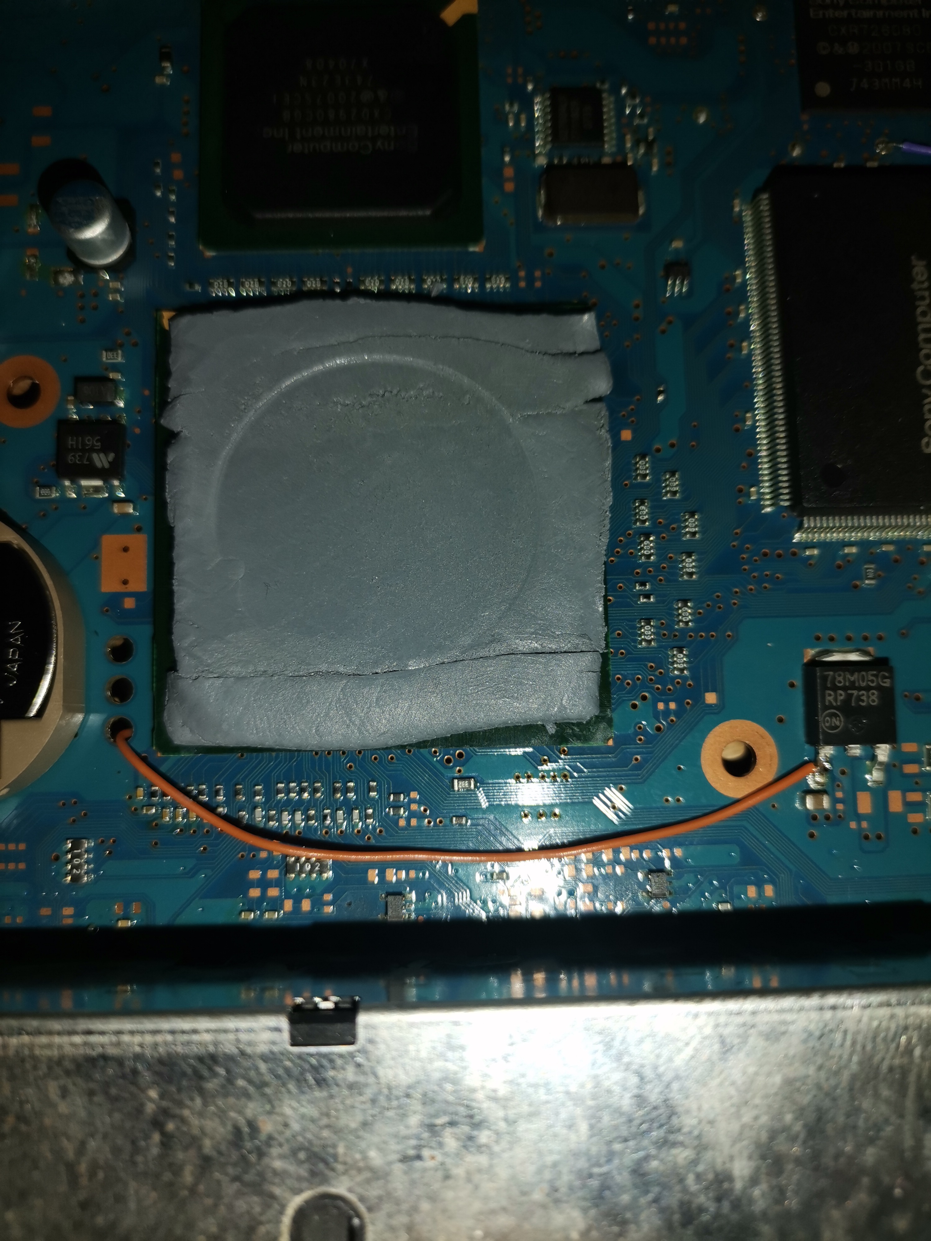

I was going to pull from cap's at first and then came to the conclusion that that's not such a great idea, so probed some resistors for a good stable 3.4v source.
I wanted to go for subtle lighting but im thinking adding 2 more would be okay.

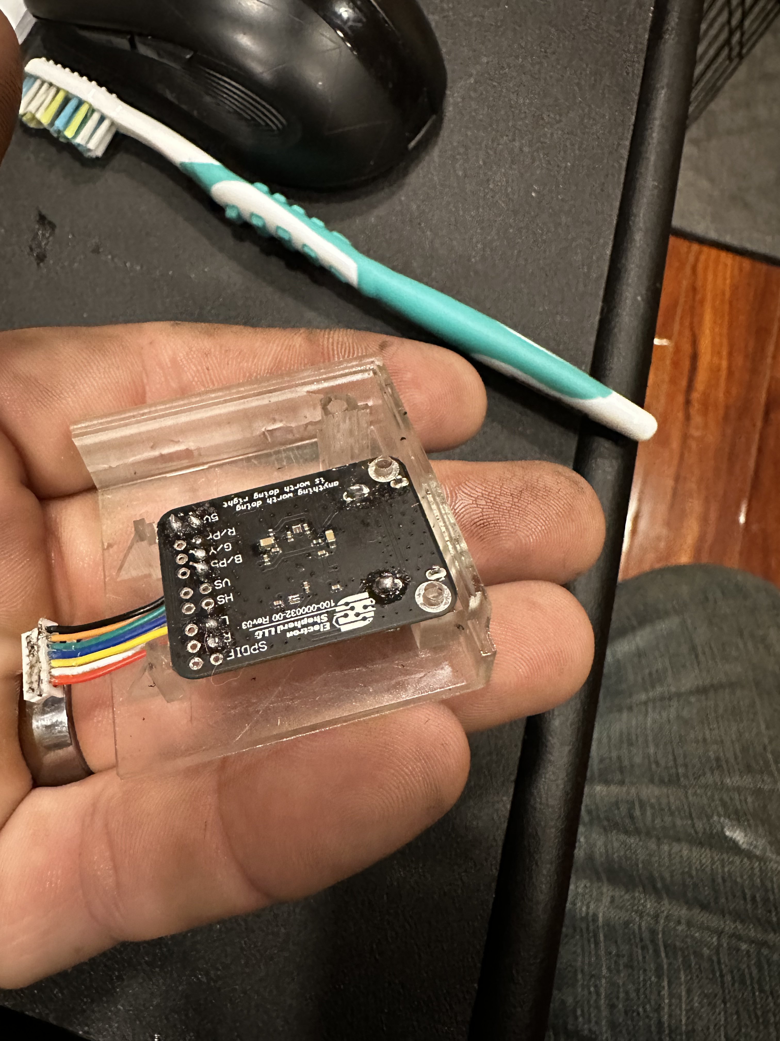

Her just got my Shepard analog hdmi would you be able to show my what pins you used and how you wired it
Seconding this. I have enough to do the main build now but when I buy the nice shell I'd like to have that HDMI port. Also did you cut that opening for it out of the top shell or no? I have a nearby makerspace that did me a solid for prototyping casing.

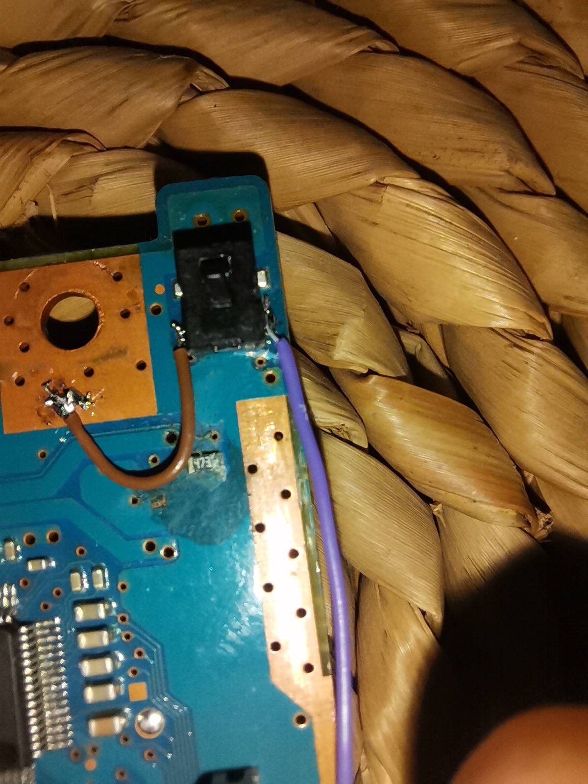

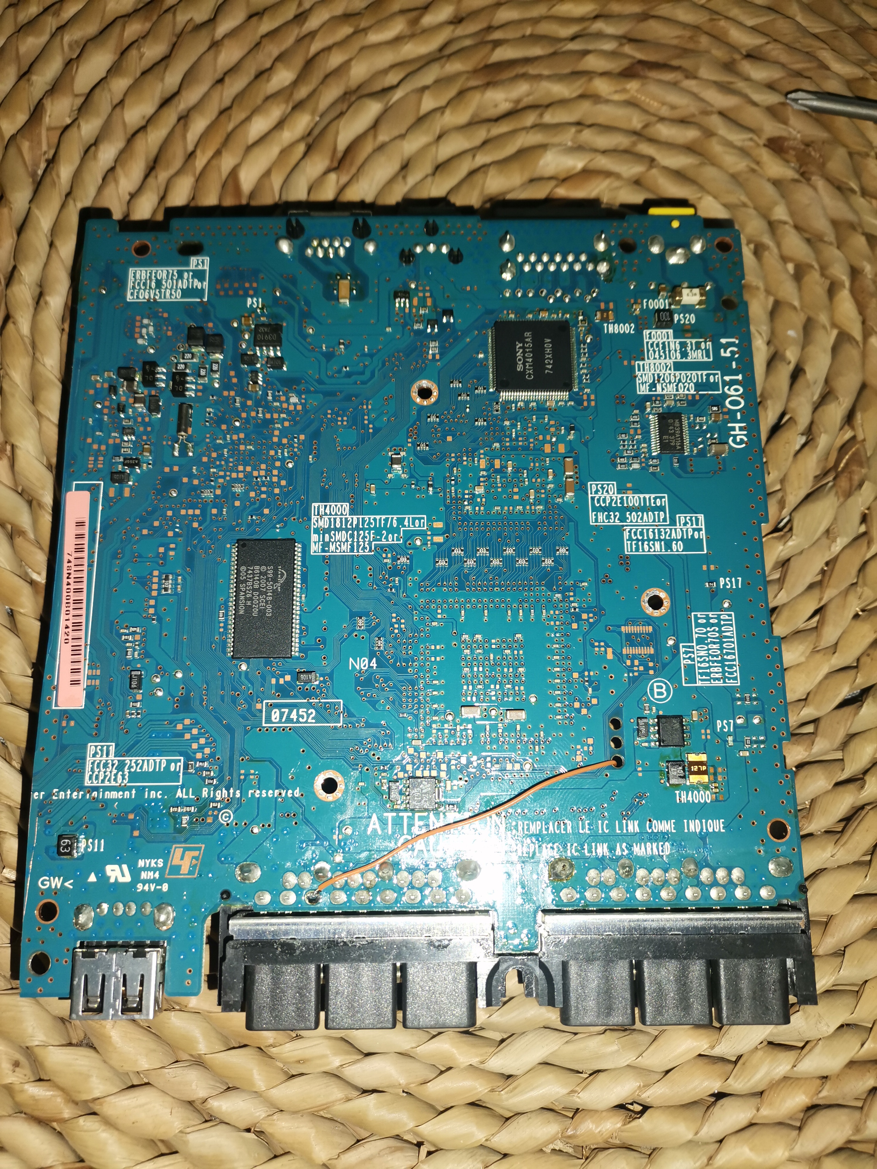

Everything works as it should, including the power reset switch PAL 79004. I've cutted one track under the purple cable.

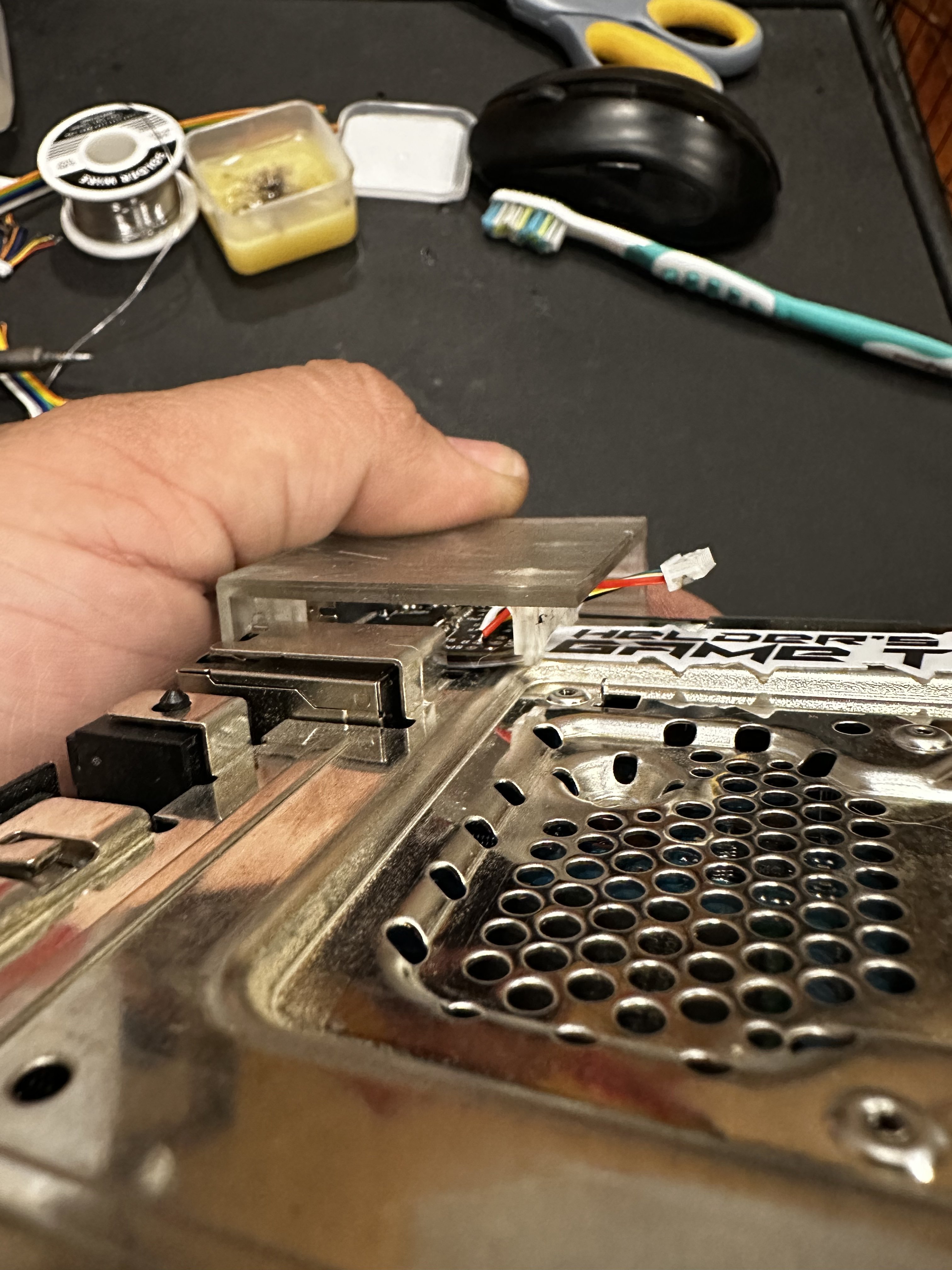

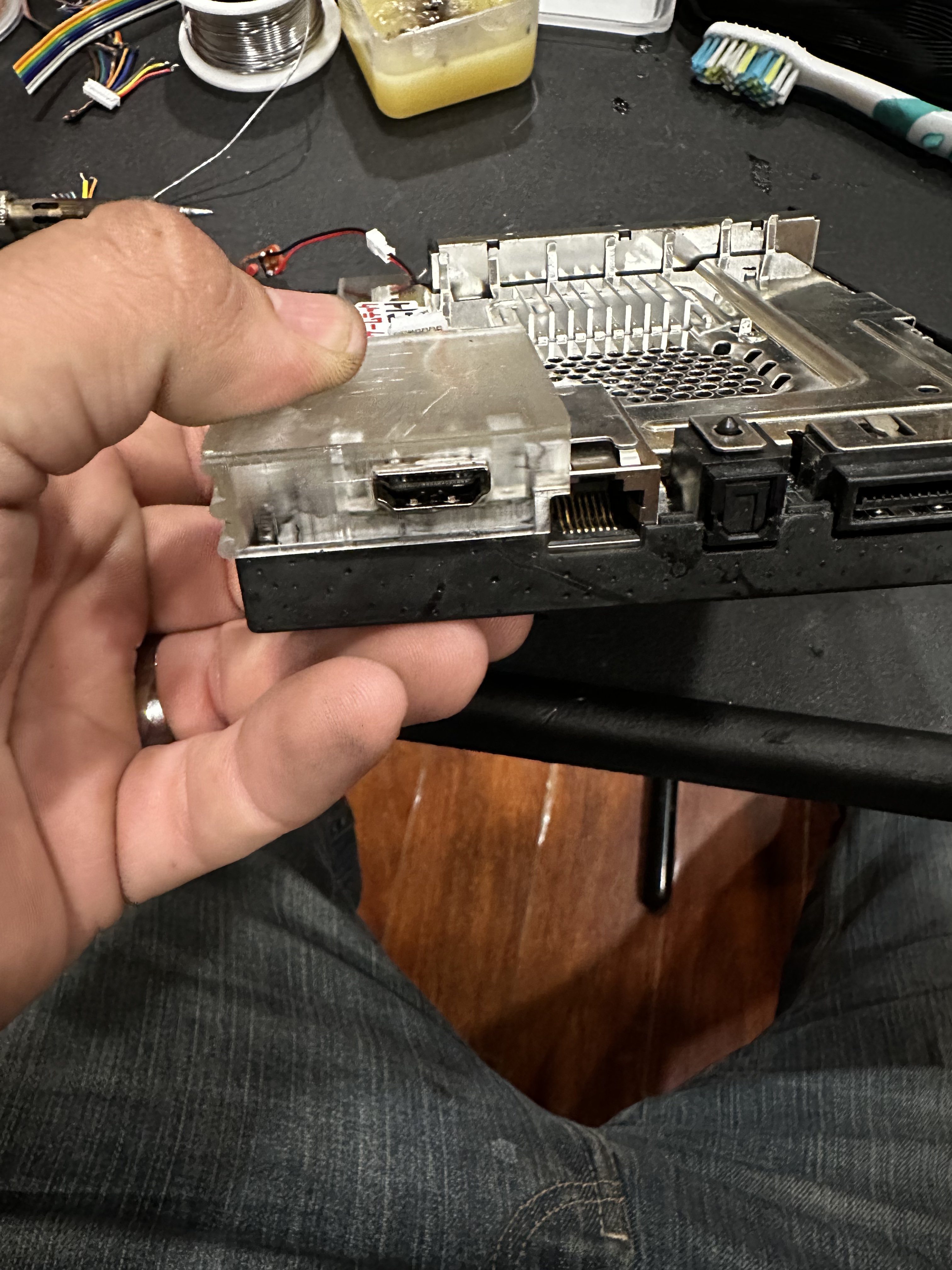

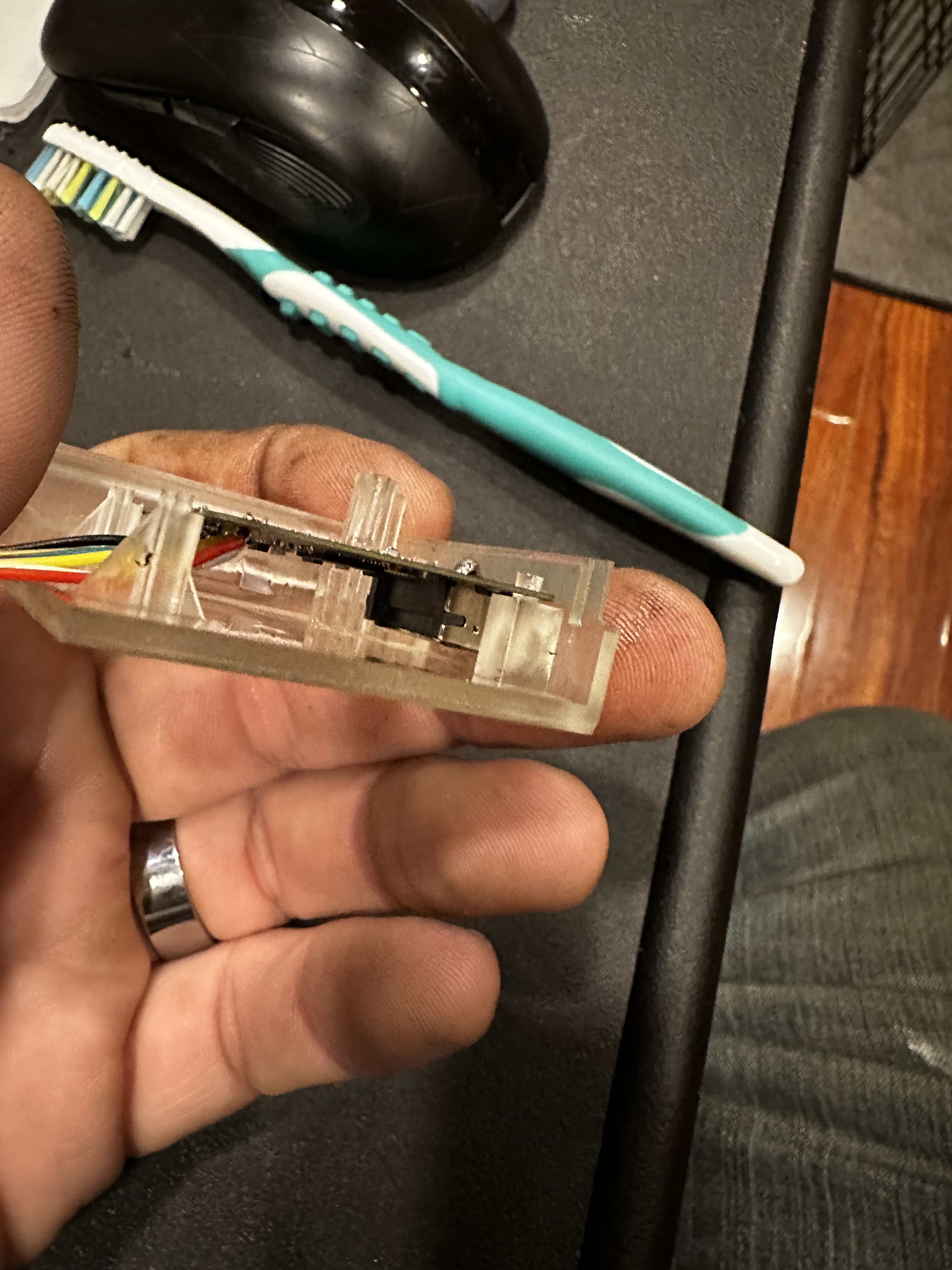

I do my own cad designing so I added the shapes in the top but I actually figured out the wiring and am working on a top shell design that will hold the Shepard hdmi pcb in place should have the Stl done tonight and will test pront tonight
Thanks. I've got a place that'll help me get the prototype prints before I buy the big one so this will really help me get the build just how I want it first.
So I did a test print last night and success. My design to hold the Shepard hdmi pcb works perfect I will e corporate this into wesks original design for anyone who wants to used it
I'll take twenty lol... although I see you mounted a connector to the wires... how's that work and where'd you get the part?
It works ok I bought a pack of generic connectors off Amazon and they work ok but can be sensitive

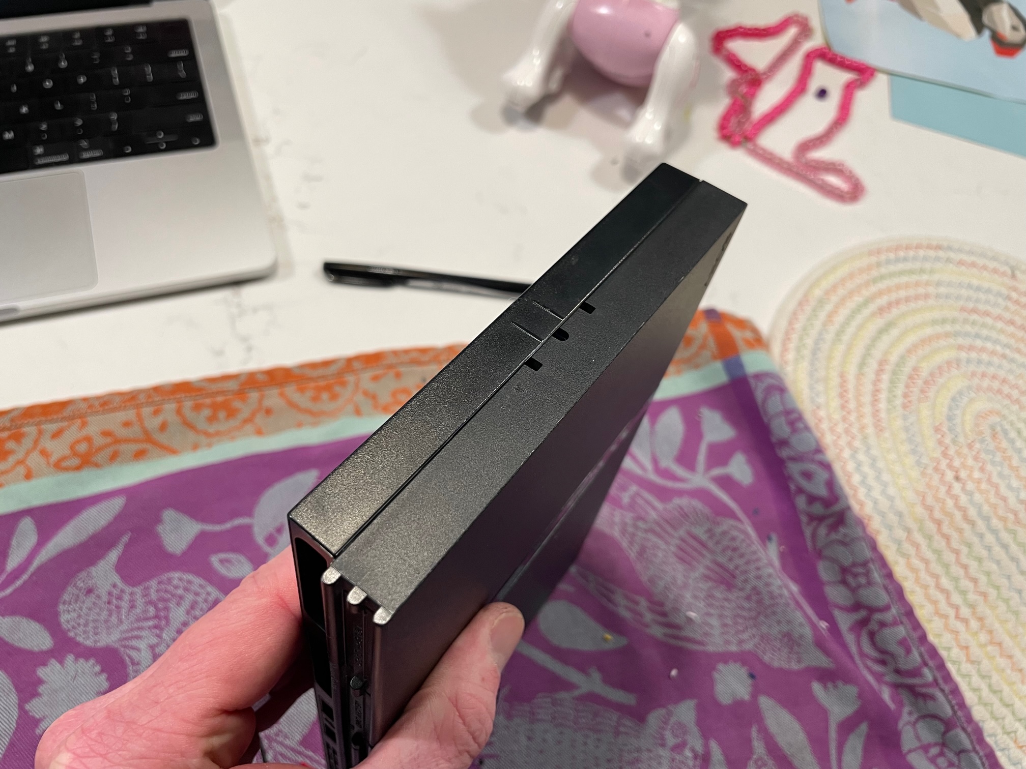

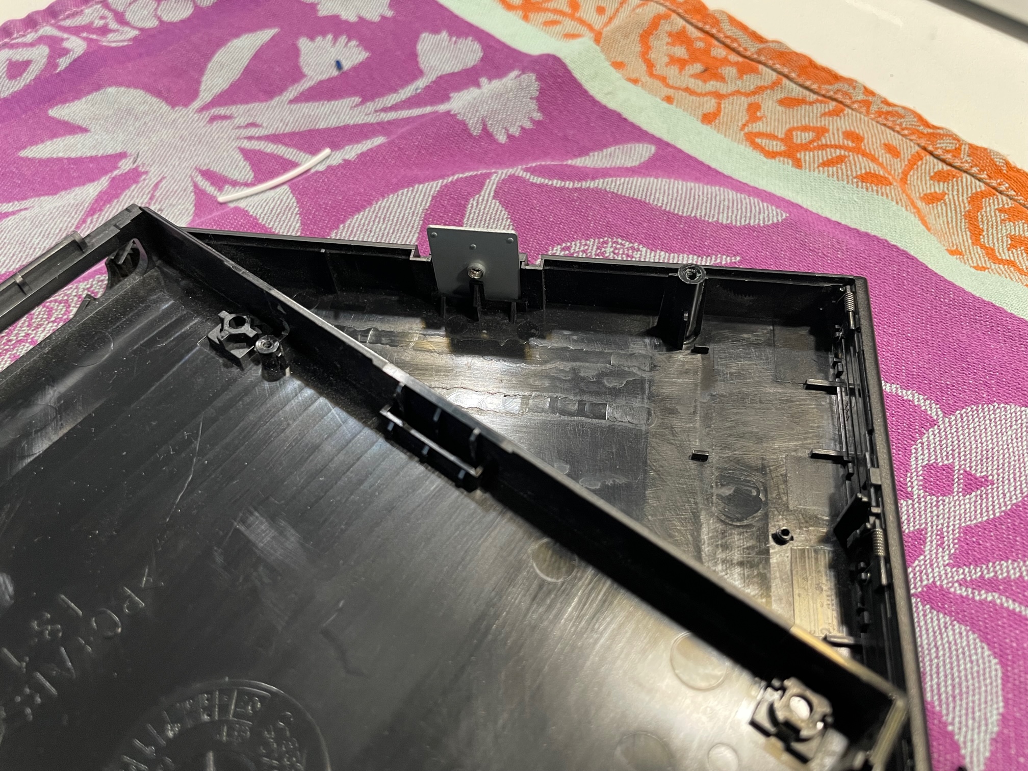

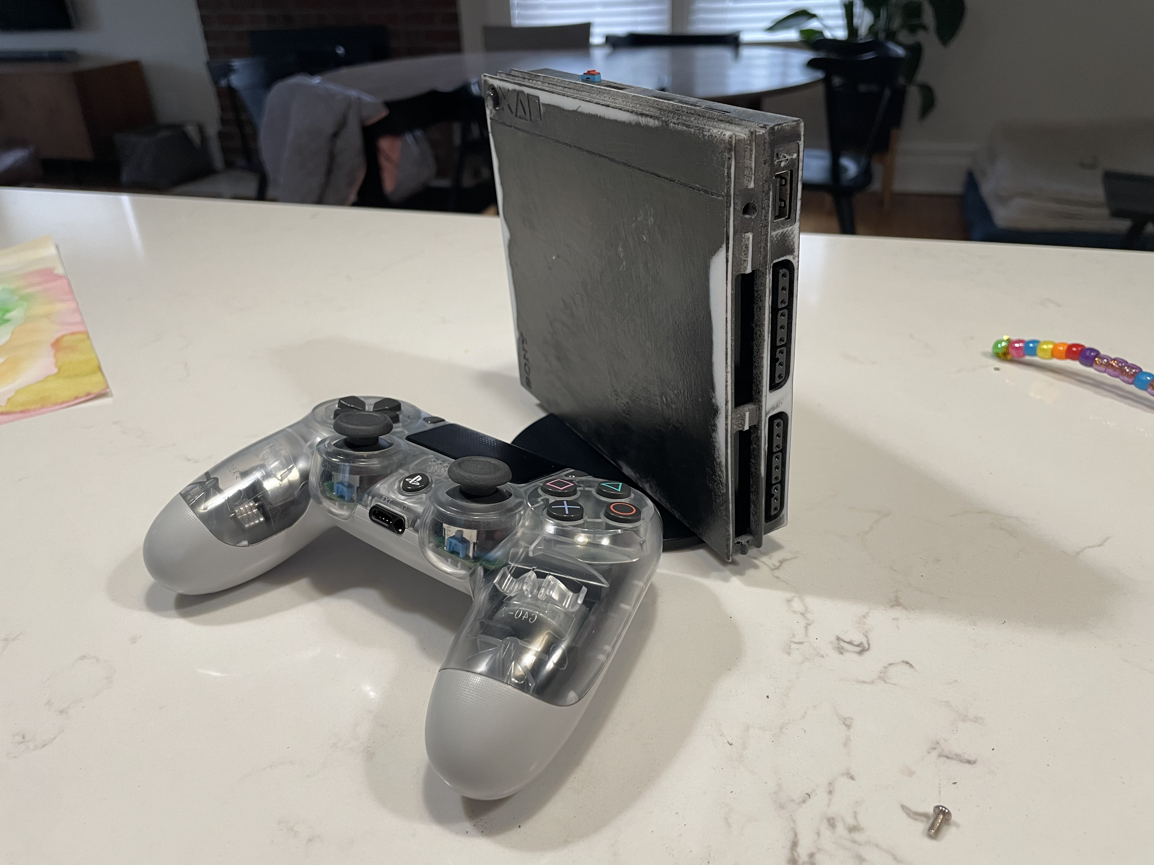

My motherboard had no lid detection switch, but you can wedge a small tac switch in the corner and it works fine with the 3d printed power button. I'll take some pictures soon (I need to get a better looking shell first), but in the meantime I had 1 ask/suggestion.
Super minor, but I think it would be sweet if the case could support the bracket for the OEM stand (I just think it would look so minimalist & awesome). Again, super minor. Awesome project and surprisingly easy to do.
UPDATE: hacked it together by dremeling out a few places for the OEM stand. A little flimsy, but it works! Added a pic. Please ignore the shell… I ran out of black spray paint lol

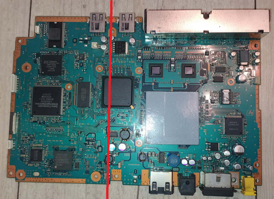

Sure, if you don't want the PS2 to work you can surely remove over half of the required chips to have a 700xx board fit in the Ultra Slim case.
wesk ive never cut a pcb im Leary on doing it in the fear of damaging it did you by chance make a print of the shell to support both usb's and the power switch ?
Not at all. This mod fits the 79k series only.
