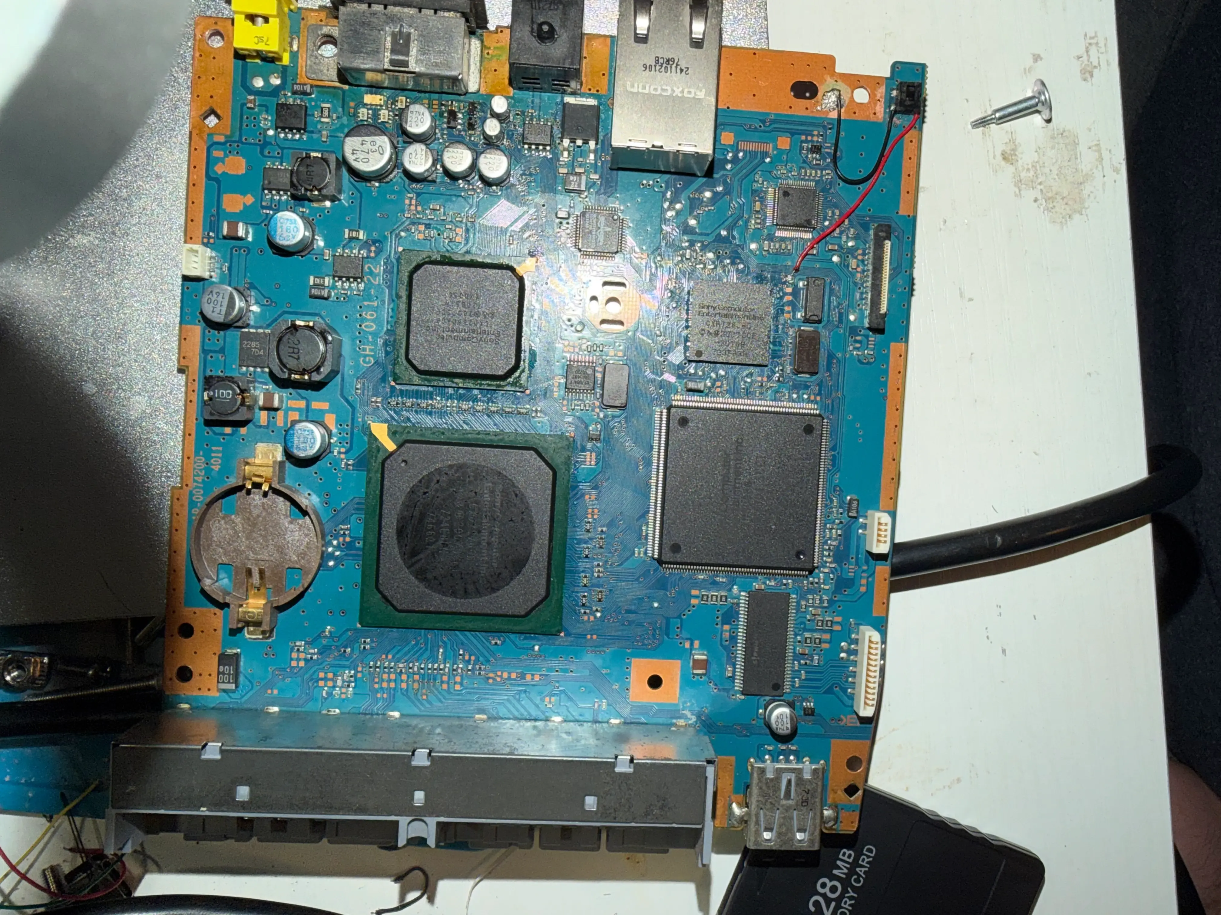

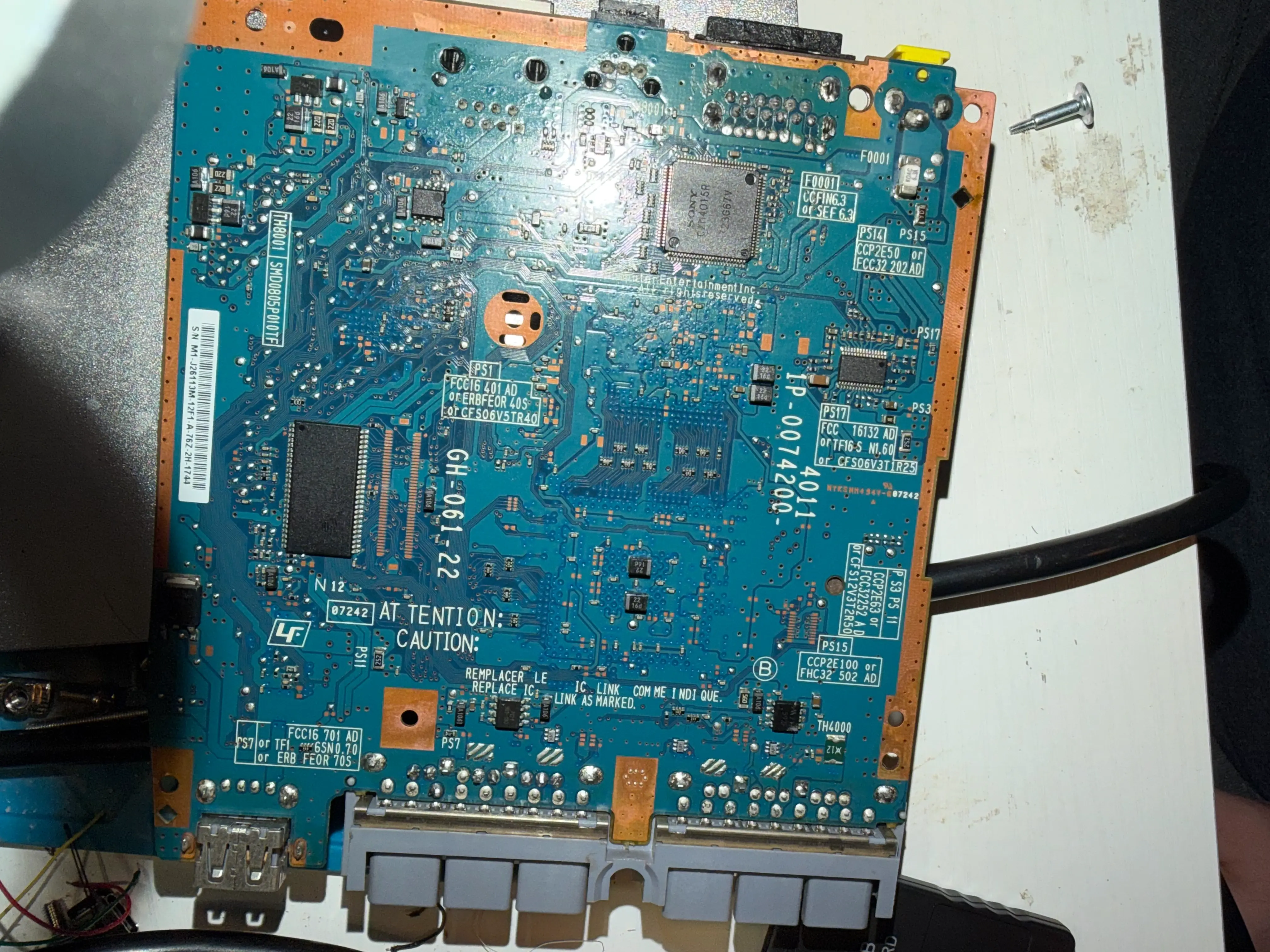

Could you send a pic of the motherboard top and bottom so we can see everything?
im not the best at taking pictures, hopefully these are clear enough.

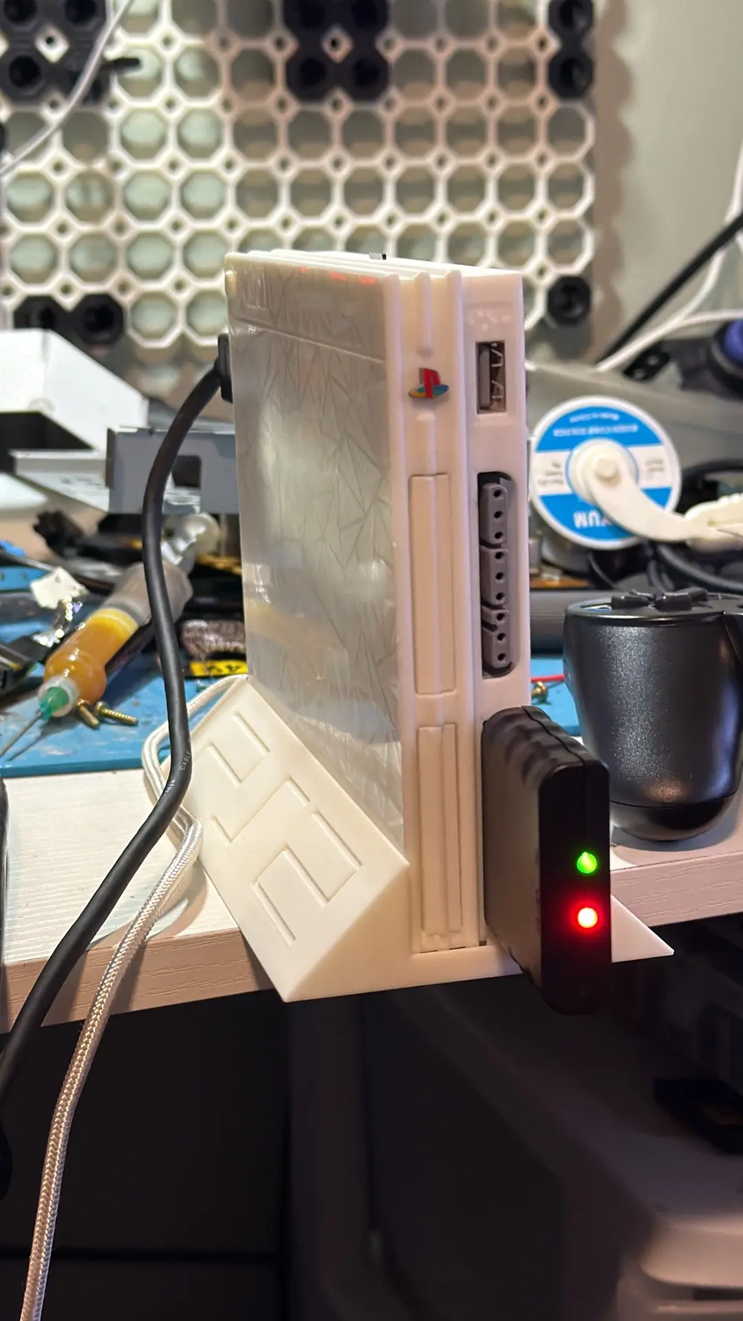

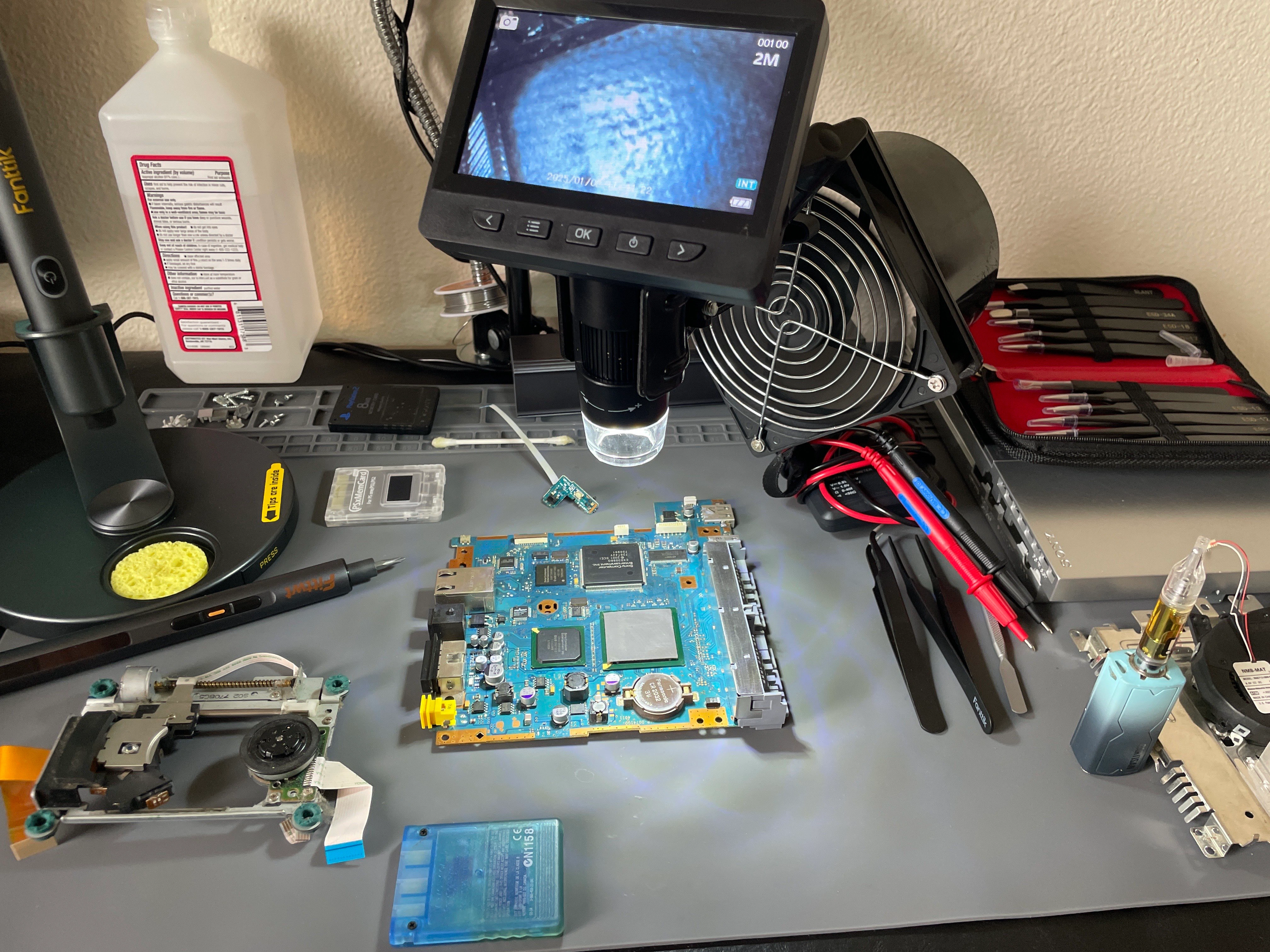

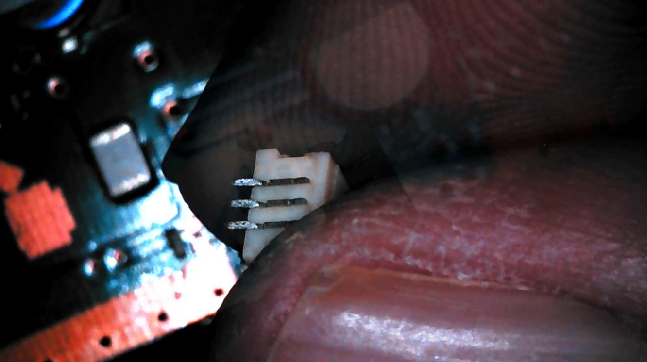

Edit: The SCPH-79001 arrived today, I managed to grab a fairly immaculate specimen. Got the console dissembled, and cleaned managed to tear the fan header from its contact pads while trying to unplug it, it broke off pretty clean, not real worried either way. The console itself came apart in what felt like 5mins, super elementary tear down.

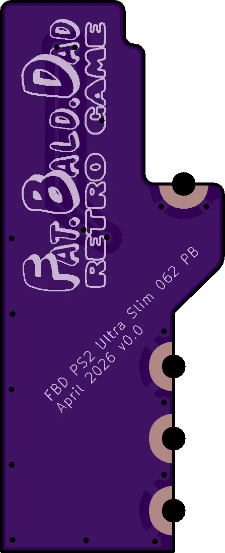

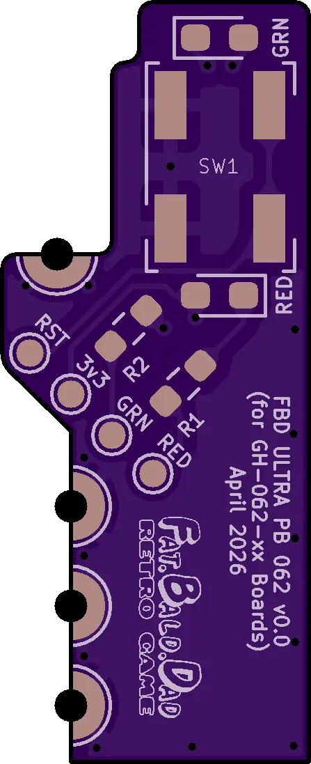

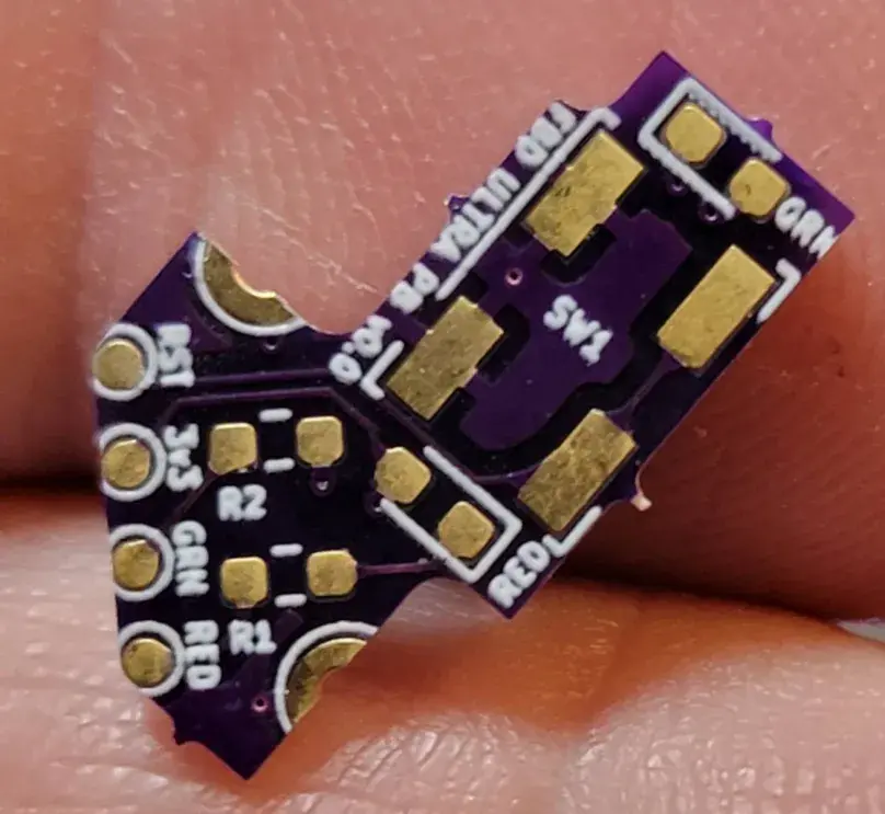

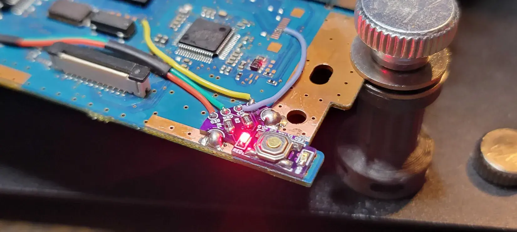

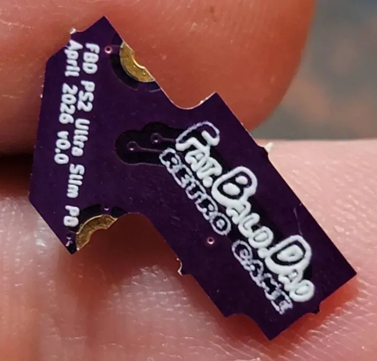

I finally got around to making my own boards to replace the lidswitch.

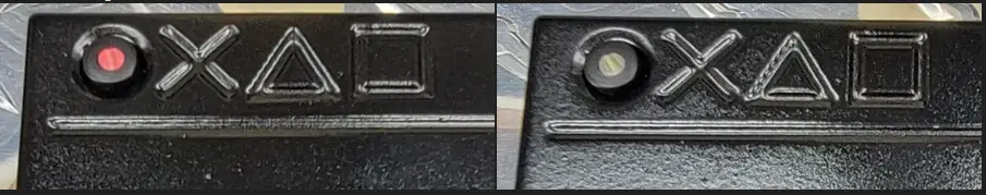

Got boards for the 062 (missing lid switch) on they way to test.

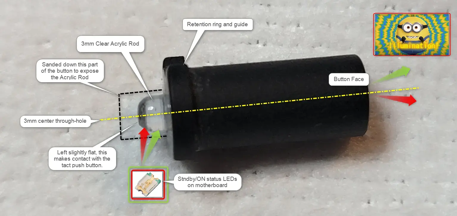

The LEDs are mounted near the actuator so the light illuminates at the face,

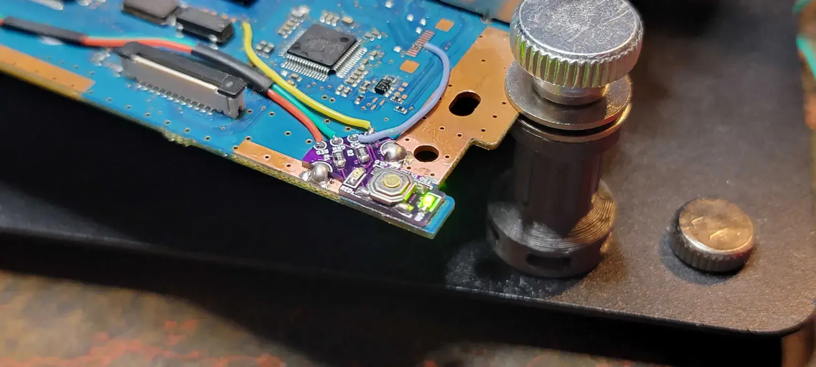

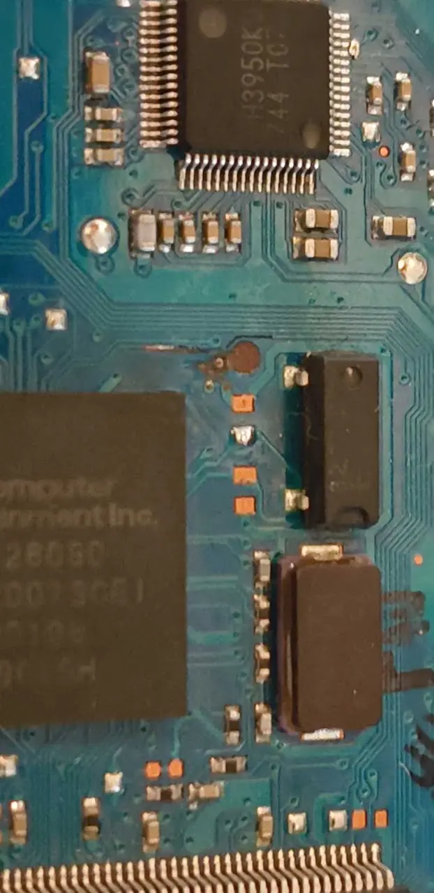

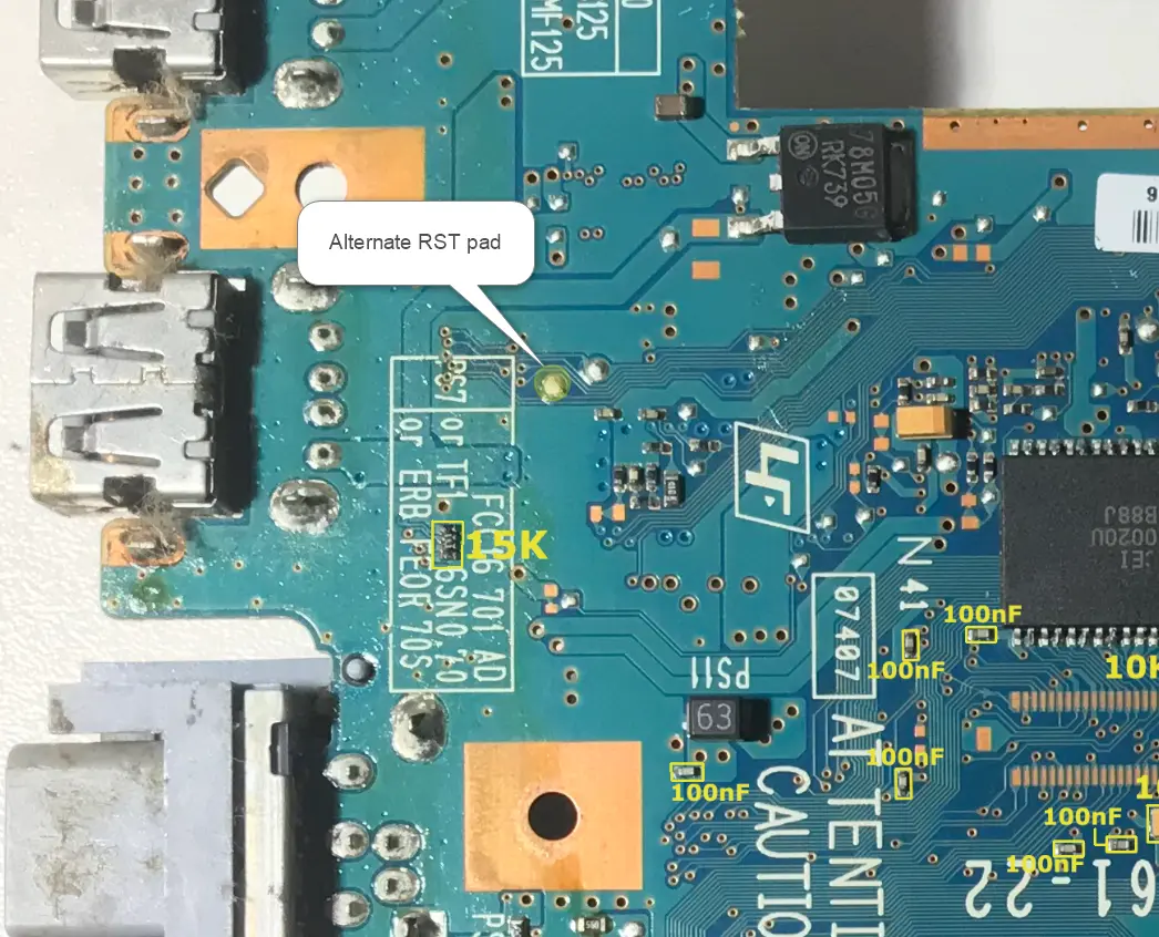

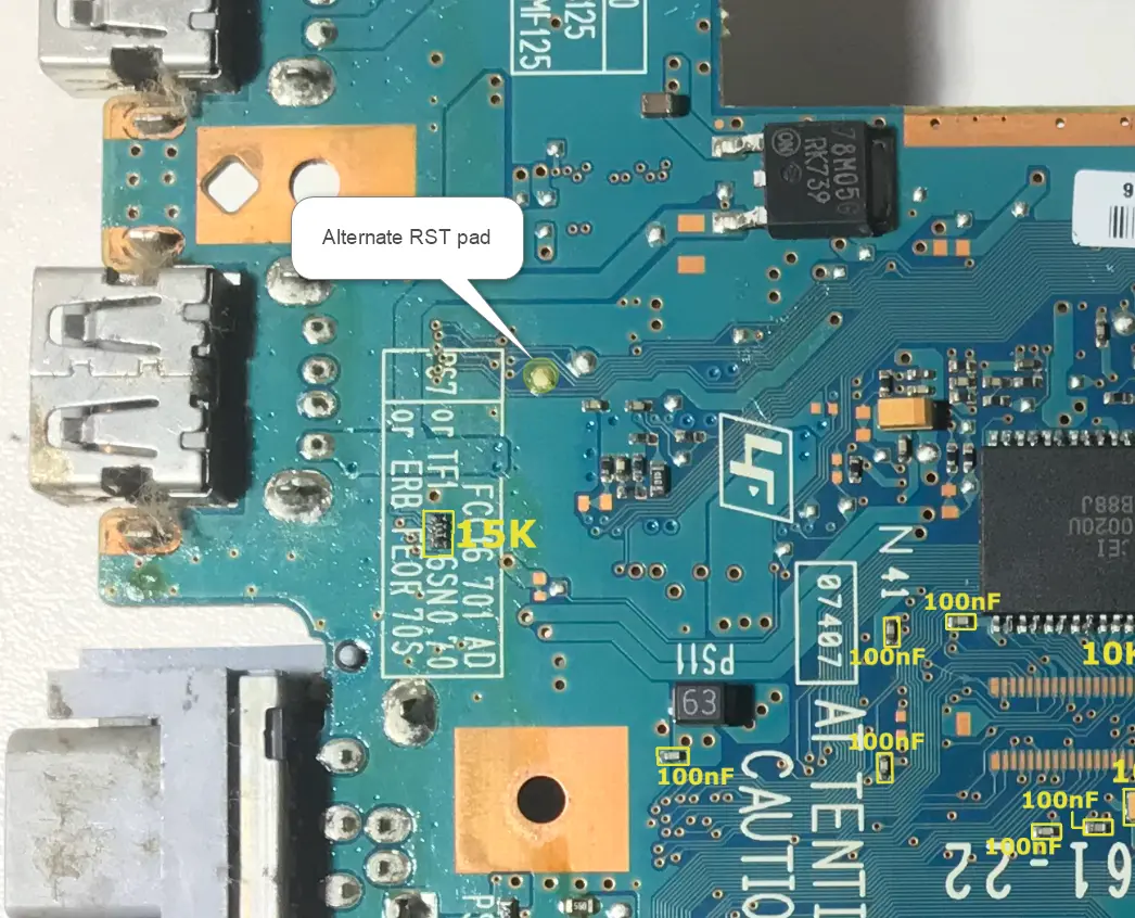

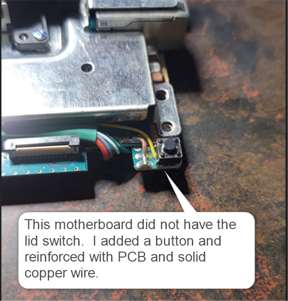

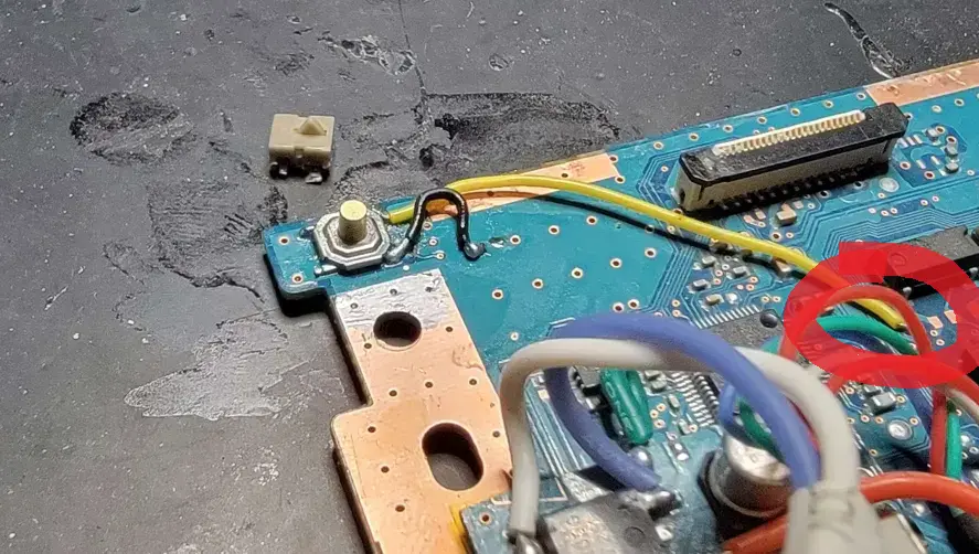

Hey there. I just started doing this mod but just now got to a problem. Firstly, i followed the Tutorial until i need to test my console and currently it does not turn on. When i wanted to check my solderjob (I rarely ever solder so i maybe did something wrong) the Pad for the Reset Switch got ripped off so now i have a plane PCB there. Is there any way to salvage that? Also i do have a 79003 so i needed another switch so i wanted to ask if there is a specific way i need to connect it?
Thats the switch i ordered: https://www.reichelt.de/de/de/shop/produkt/kurzhubtaster_6x6mm_hoehe_8_0mm_1_schliesser-375520
Update: Since i cannot connect the actual Power Button since it was connected to the now cut USB Power Outlet, i cannot even see if the playstation still works. Does anyone know what i need to do?
Check this out, maybe it will help answer some questions. The fan is useful to have connected, it will start on power up.
Post again if you still need help.

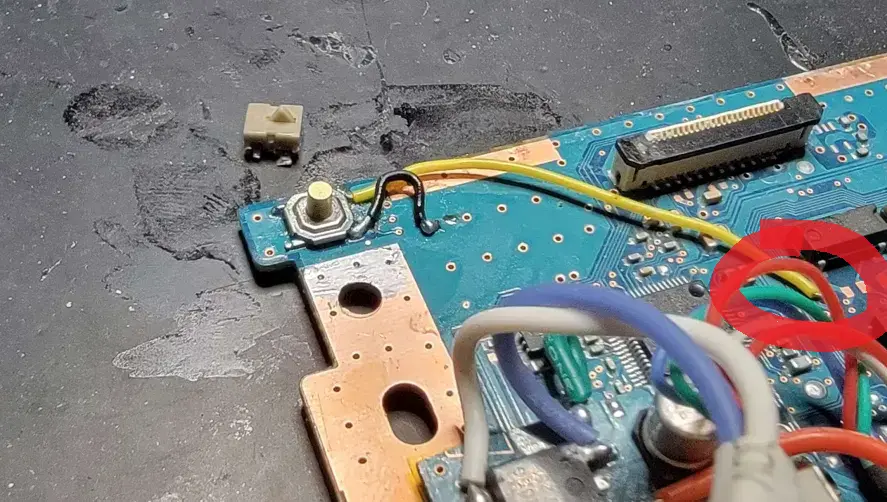

Hey there. Thank you so much for the answer. Sadly i just realized that i probably miswrote what i meant (Sry i am not nativly speaking English) I meant the Pad where the Switch should connect to (the Yellow cable i marked here)
The Switch itself is connected losely until i can mount it to the bottom of the case. I was able to scape off a bit ot the traces to connect the switch further down on the trace. But since these are so small they dont stay there and when i try to hotglue them in place the cable already came off. Currently its not holding whatsoever.
Sadly i dont have much experience with soldering. Is it still Salvageable?
Also if i misunderstood your answer im sorry. I just thought that my wording might have sent you down the wrong path.
If you need any more photos or infos, feel free to ask.

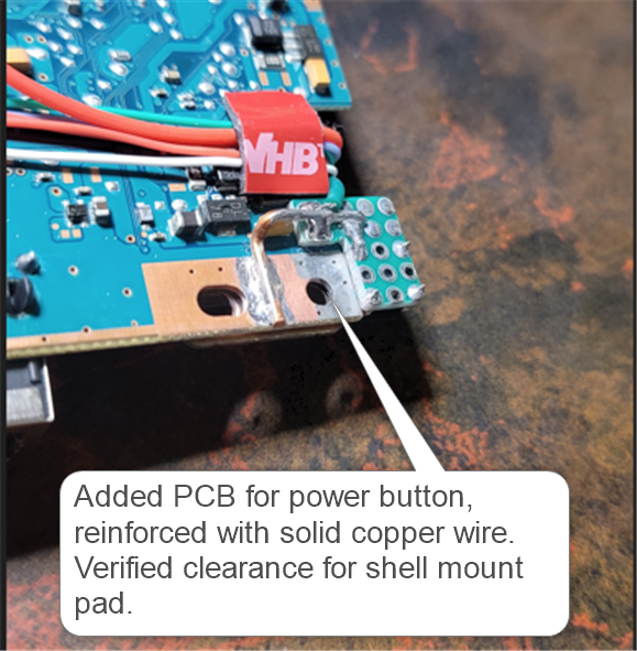

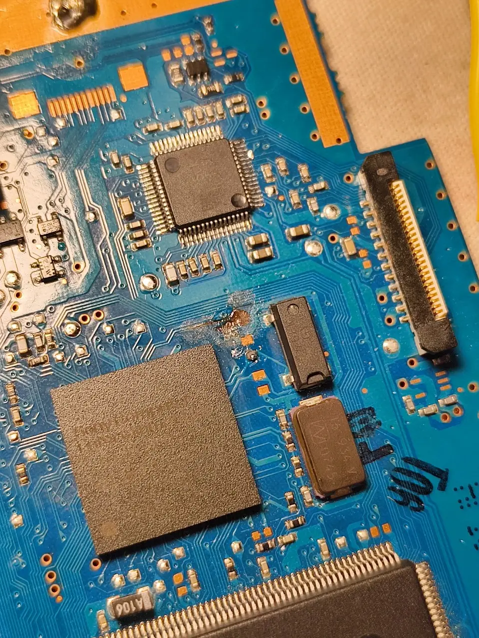

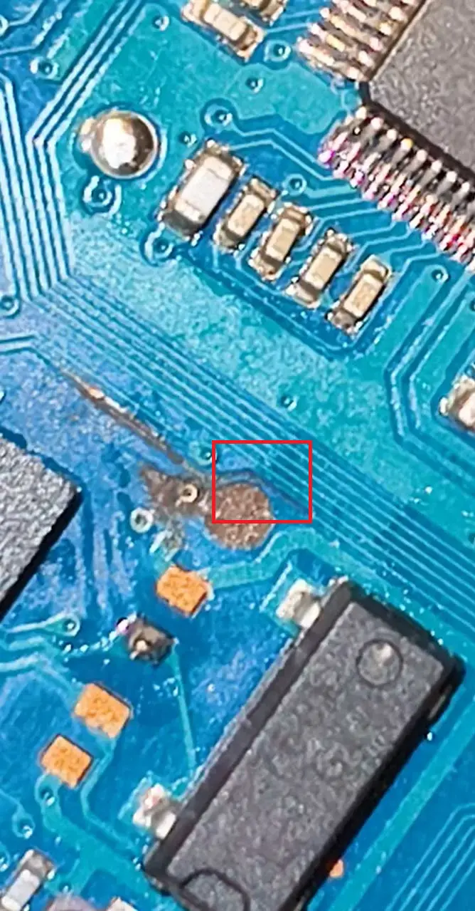

OK, let me take a closer look. You have some IPA to clean the flux off that spot adn maybe get some closer pics?

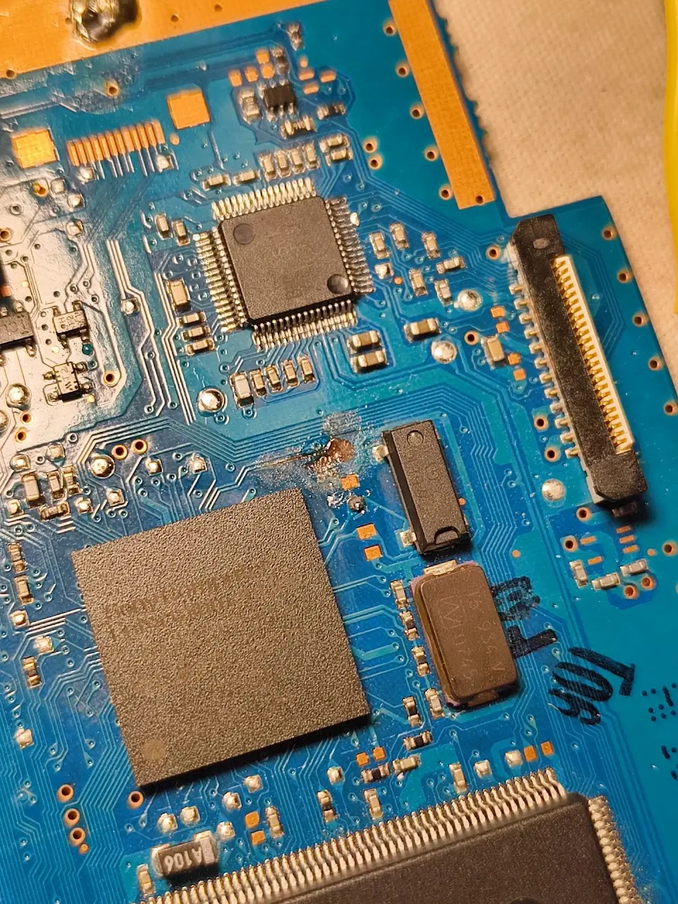

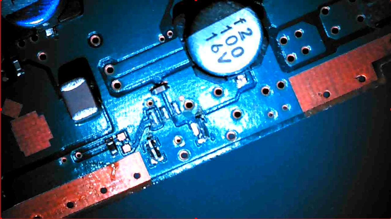

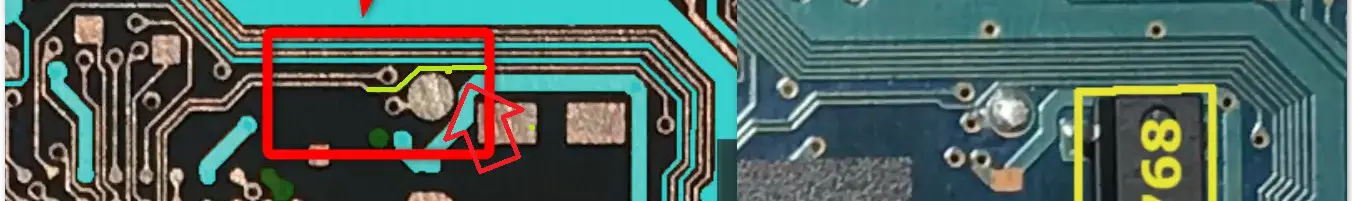

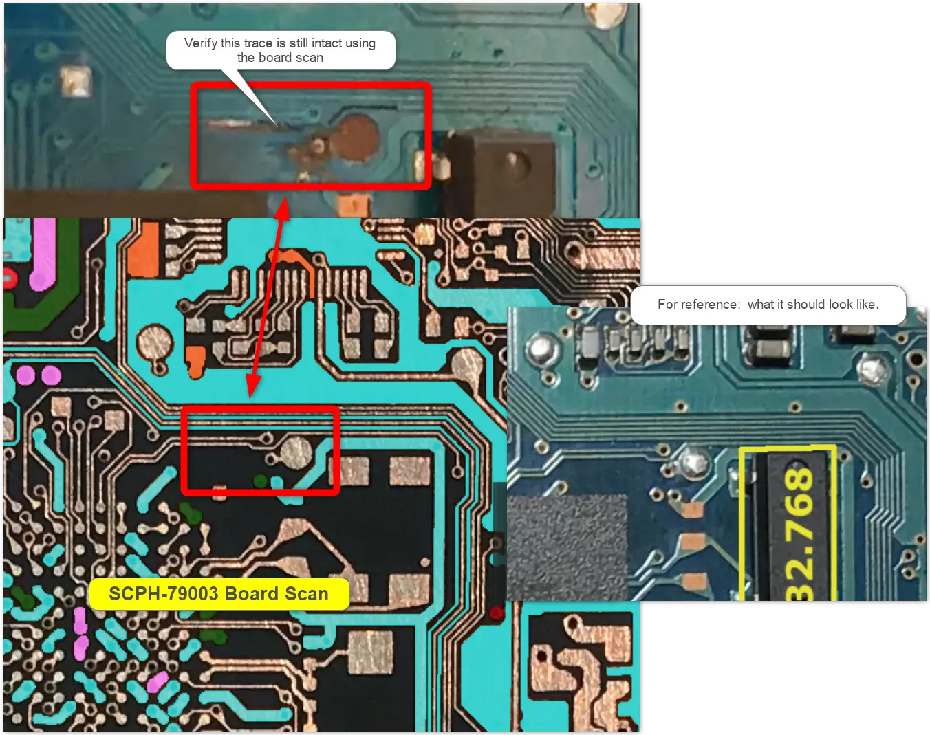

Thank you so much. I just tried soldering the switch to the new pad and turnes it on and the fan spun normally. It currently looks like that this trace here, is completely gone and not connected correctly (my Photos are not good enough to correctly show it i think, but via eyeview i´d say the trace is disconnected):
Here is my Photo i took via camera (Sadly i dont have the correct equipment to take such detailed photos, i veen turned on the light so the copper would shine more)

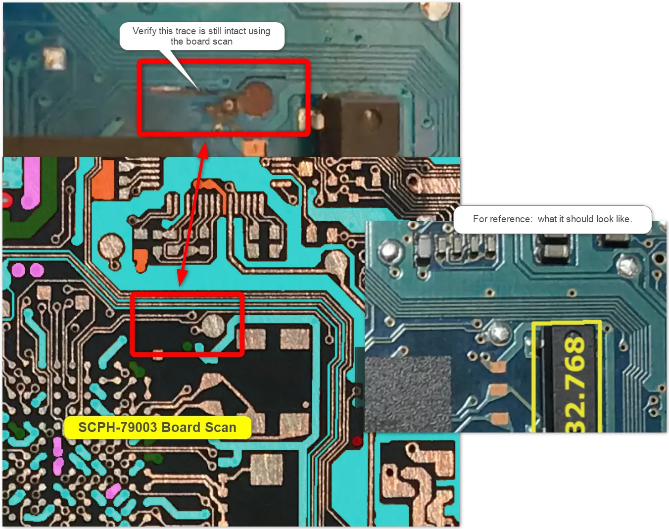

There the copper line is complety ripped out and does not make a connection. Do i need to connect that trace again? Or is that trace irrelevant/does not need to be connected perhaps? (I definetly think that doesnt happen often or ever in circuitry.)
@ImCriptix
That chip is the Mechacon, if that trace is tied back to the Optical drive then maybe not. I would have to investigate that further. If the board powers on and ou have a dsplay. See if you can drop in a FMCB and MX4SIO and try to see if a game loads. Or repair the trace.

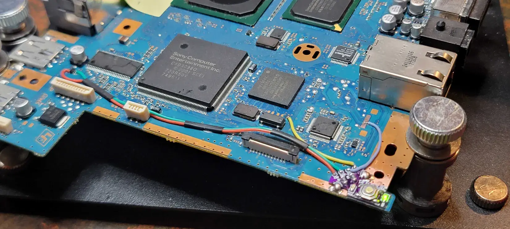

Almost done.
1 Board is cut and powers on
2 HDMI Electron shepard done and working
3 The internal sd card mod
