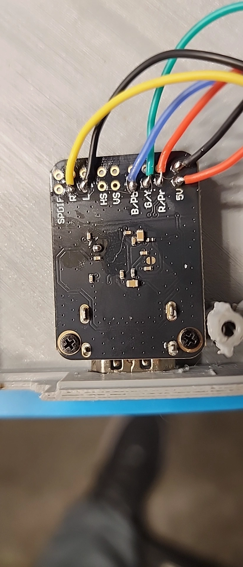

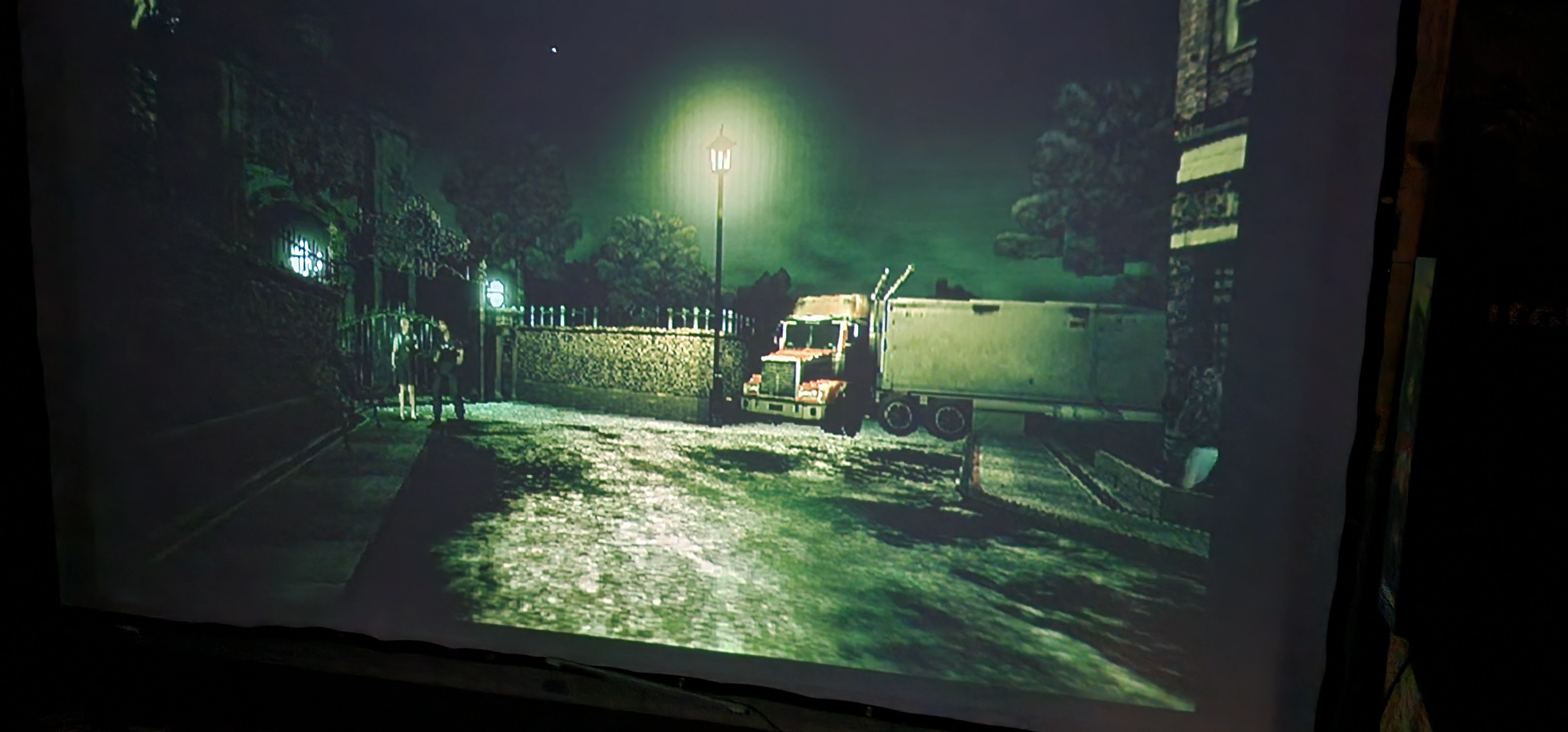

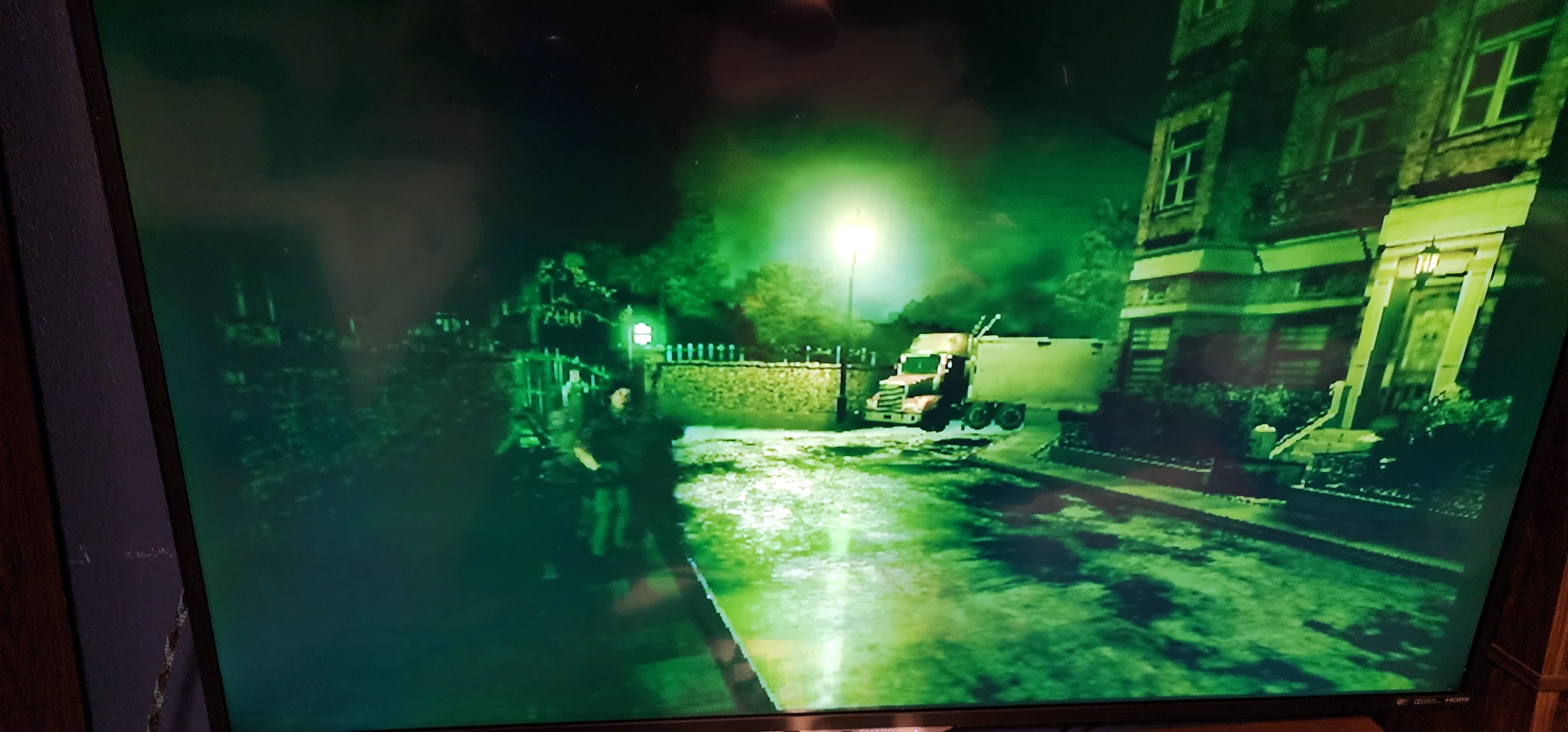

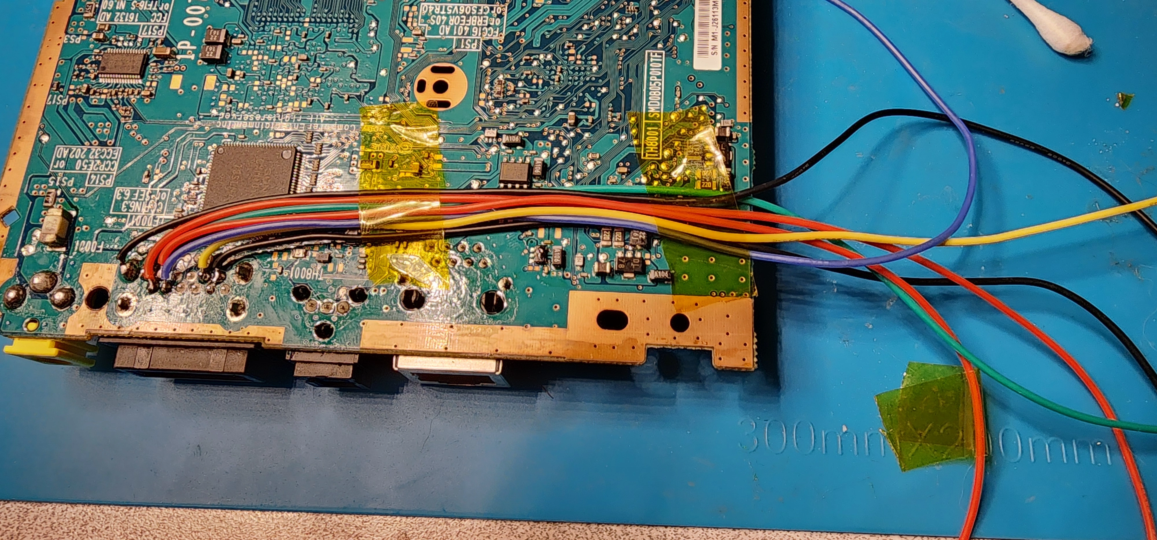

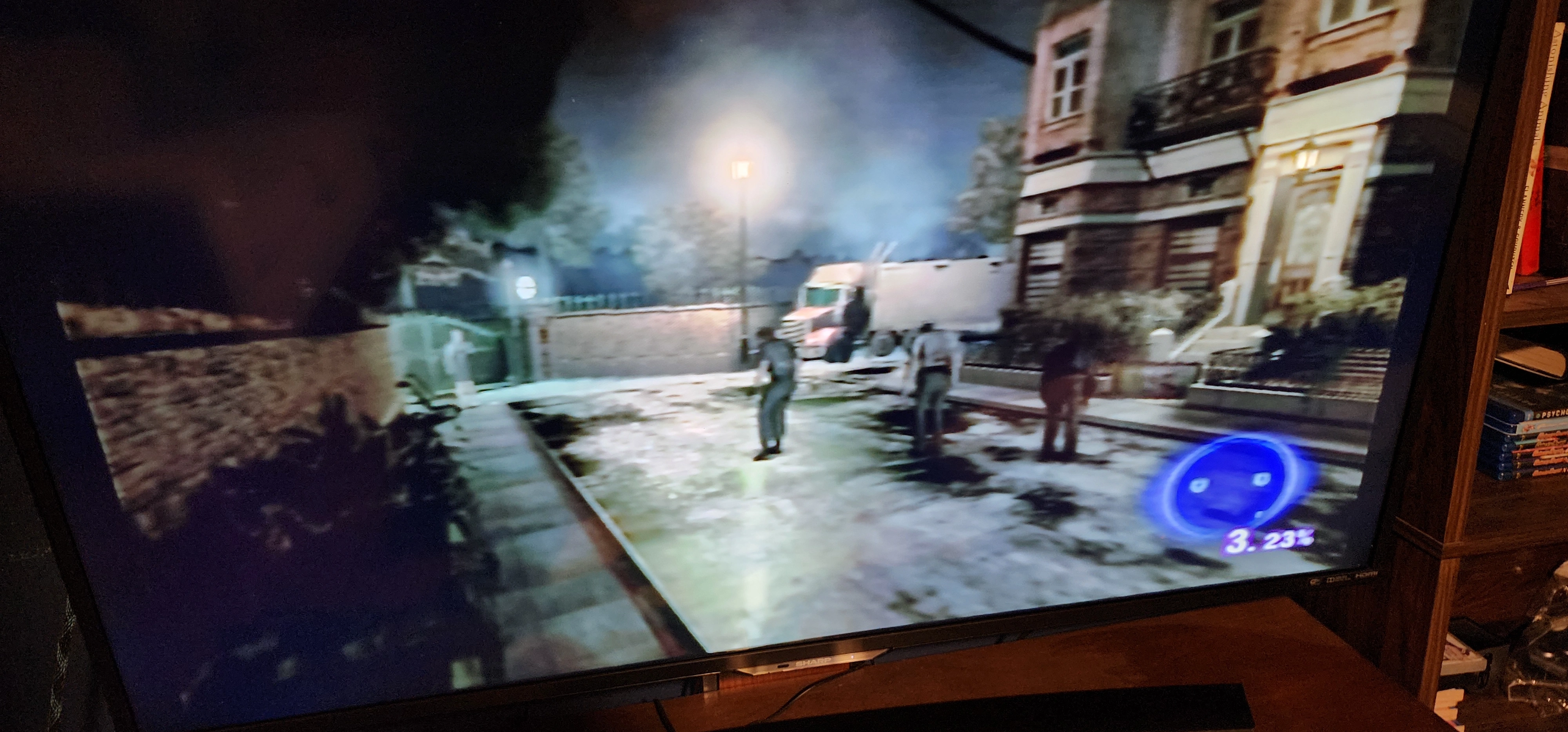

So I have a ps2 ultra that works great and decided to do another. I was doing an order on Aliexpress and happened to to recommend electron analog on there since I had an order going and free shipping(I should have ordered the valentines day special).. but when it arrived it only appeared to be a clone with no branding... once installed the picture was very dark during gameplay but audio . Can anyone confirm that its the Clone causing that issue? And apologies to the people at Electron Shepard for not ordering directly this time...

How does the video look from the original AV port? Do you have a way to test? I know some newer televisions don't have component inputs anymore and I am assuming that why you are asking here?
I went ahead and sent over the solder from the other side with HDMI picture it looks a lot darker than the photo. I'll send a photo of how it looks on AV when I get home on my TV with a side by side comparison.

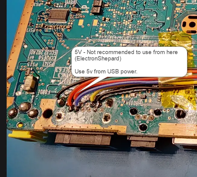

One thing I noticed. I know your clone board is "working" but the real ElectronAnalogs will not work from power here. It cannot provide what is needed (directly from ElectronShepard support).
Use 5v from the USB power rail. Maybe with this clone its the same scenario. Maybe check the voltage on the clone when powered on, I would assume it will be less than 5V - that could be an issue.
Thanks! I will give this a go tonight as well. I did run my other 79000k the way shown above and its as crisp as AV can get lol, but this board could have some different fluctuations I got it for $20 and power plug was already re-flowed

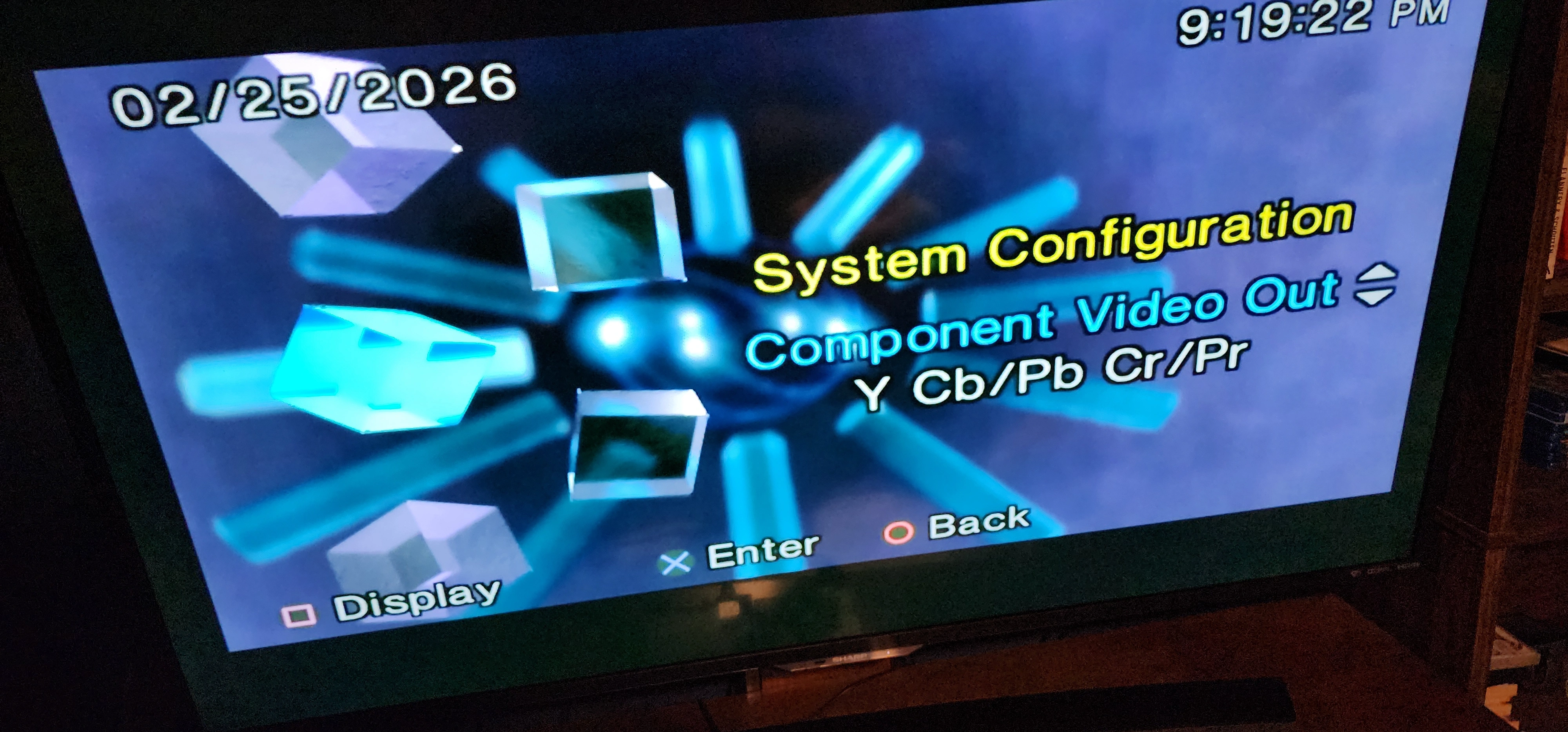

I moved the 5V to the USB port and the picture is still the same. I tested wires with a Multi meter as well from one end to another and had continuity. Something has to either be up with one of the color wires with a weak signal or its the clone. The AV photo shows no green but I did amp the brightness up some but thats always needed on LCD tvs. Also the System Config screen is on the HDMI and does not have much green tint besides the black borders.

It is safe to conclude that since we are taking the analog signal from the same contacts the AV cable uses, and the component output to your LCD display looks fine, your wiring is correct. The adapter is the problem.
Ive decided to do my first refund through Aliexpress on the 2 I ordered, I'll buy the correct ones after they have accepted the return.
