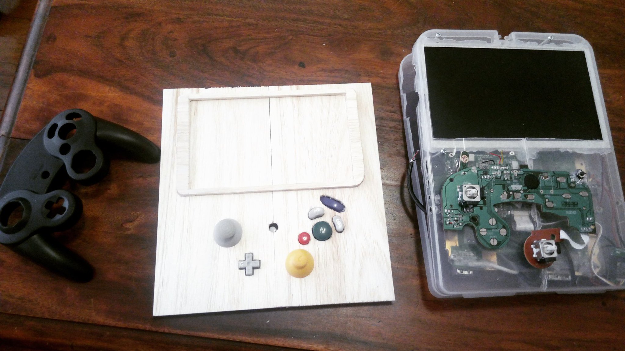

Secondly, here's my WIP portable, which I'm naming the "Nontendo Woi".
Features:
  • uncut Wii MB
  • 7" screen
  • 3300mAh Li-Ion battery
  • custom see-through case
  • Access to 2 NGC controller ports
Planned Features:
  • In-built NGC controller mounted in/on lower front
  • Case sleeve to make it look like a GameBoy? Maybe?
  • Carabineers in the back of the case, for mounting on a car headrest
Current Issues:
  • Cooling fan obstructed & not able to spin (hot glue in the wrong spot?)
  • Limited battery life (1hr approx. play time)
  • Case not closing flush (nothing some PCB nuts and bolts won't fix)

Thinking about the final look I want for this thing, I'm now leaning towards building a balsa wood case, shaped like an oversized GameBoy, that would house the controller component/s as well as everything that's in it at present. Balsa to keep it lightweight, and for a nice soft texture when handling the unit, and wood for a medium I'm confident in working with and for a cool "steampunk" look.

Started work on the balsa wood case. I'll be able to make it shorter, but it'll be wider by necessity. Still a comfortable size for large hands.
