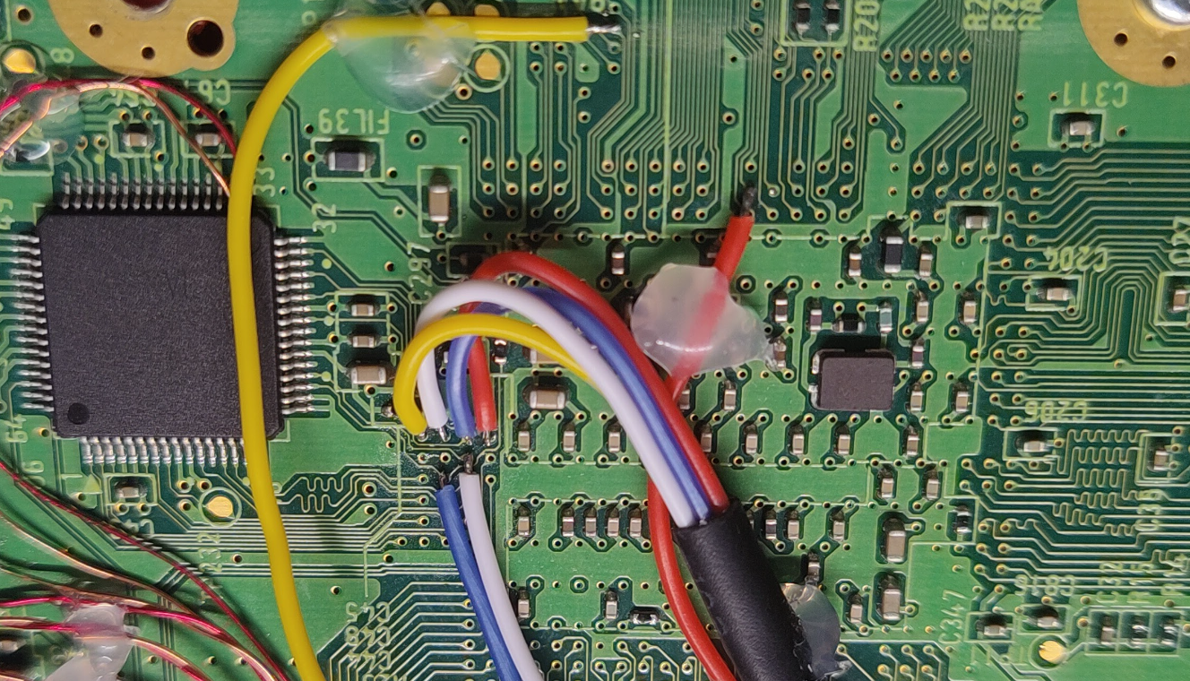

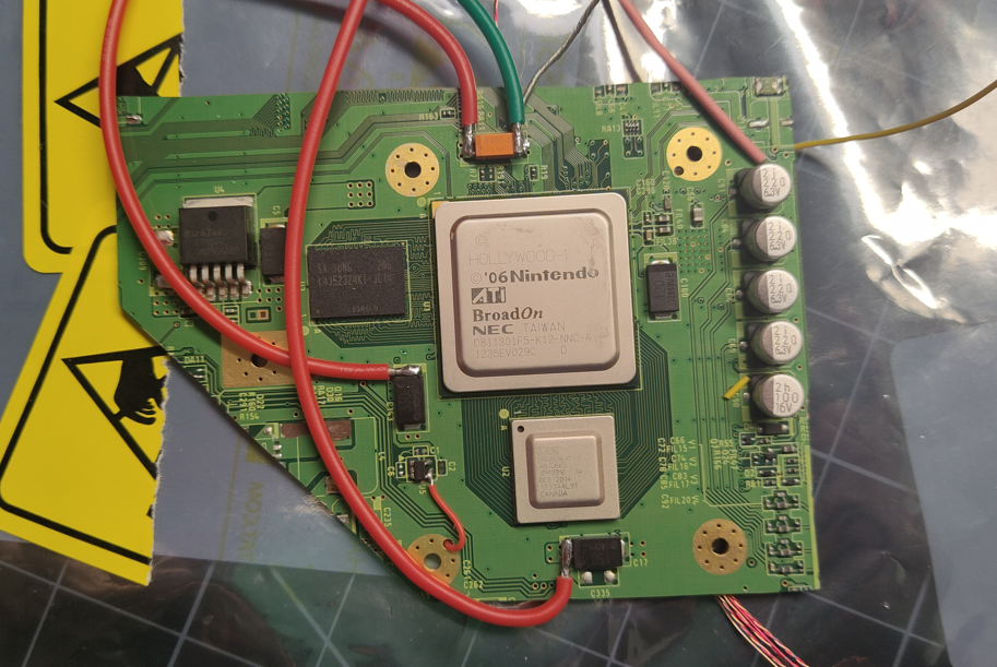

Is "scuffed" an Australian slang? It's definitely possible it's damaged since it wasn't working when hooked up how it was supposed to be.

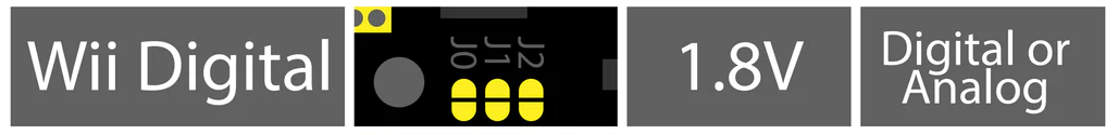

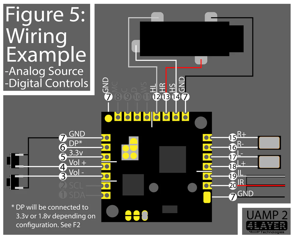

I was wiring it for analog which calls for 3.3v but left my comm wiring hooked up because I didn't expect anything to change and at this point I had another board on order.

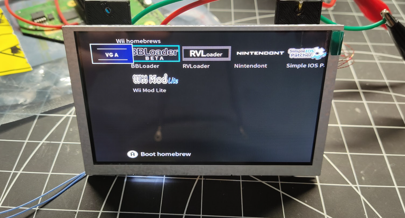

That's when it appeared in RVLoader and started working. I then removed the analog jumper on J2 and everything was great until I tightened all my screws and popped my display driver board :(

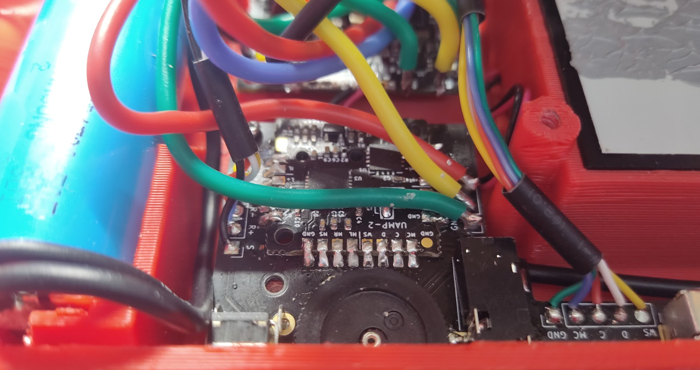

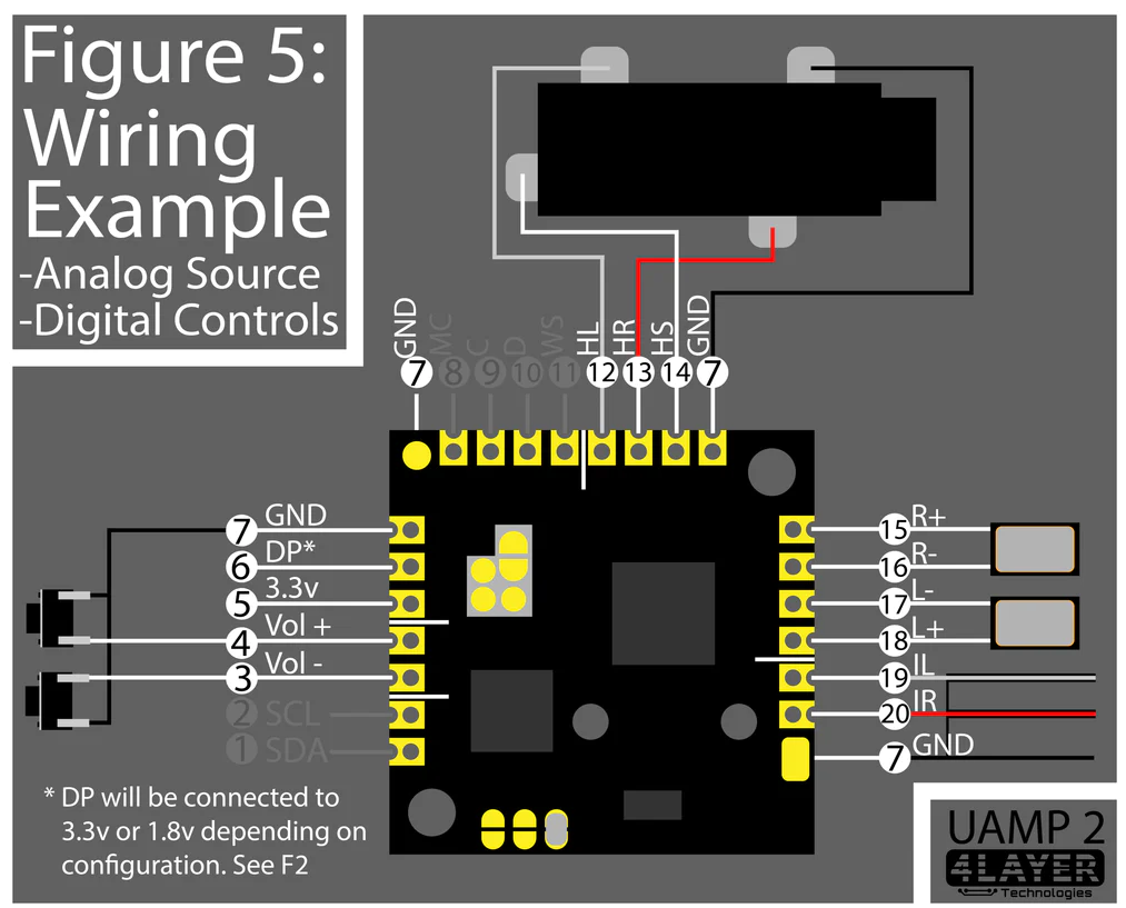

Don't worry gang, I haven't given up on my Ashida. My new driver board fixed all my issues except my funky audio board.

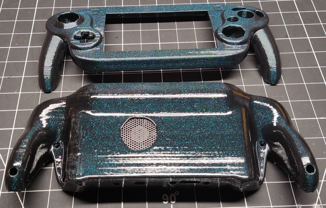

I decided to get a new 3D printer to try my hand at printing ABS and then acetone vapor smoothing it in my custom chamber I built. It's not been going well as printing in ABS is difficult, with LOTS of tuning....
My new audio board came in the mail yesterday and I'll rebuild my Ashida with a fancy new enclosure once I get a decent print done...
Well I let the resin cure for over 4 days and it failed to stop being grippy and that texture just drives me up a wall. Cannot stand it in my hands.

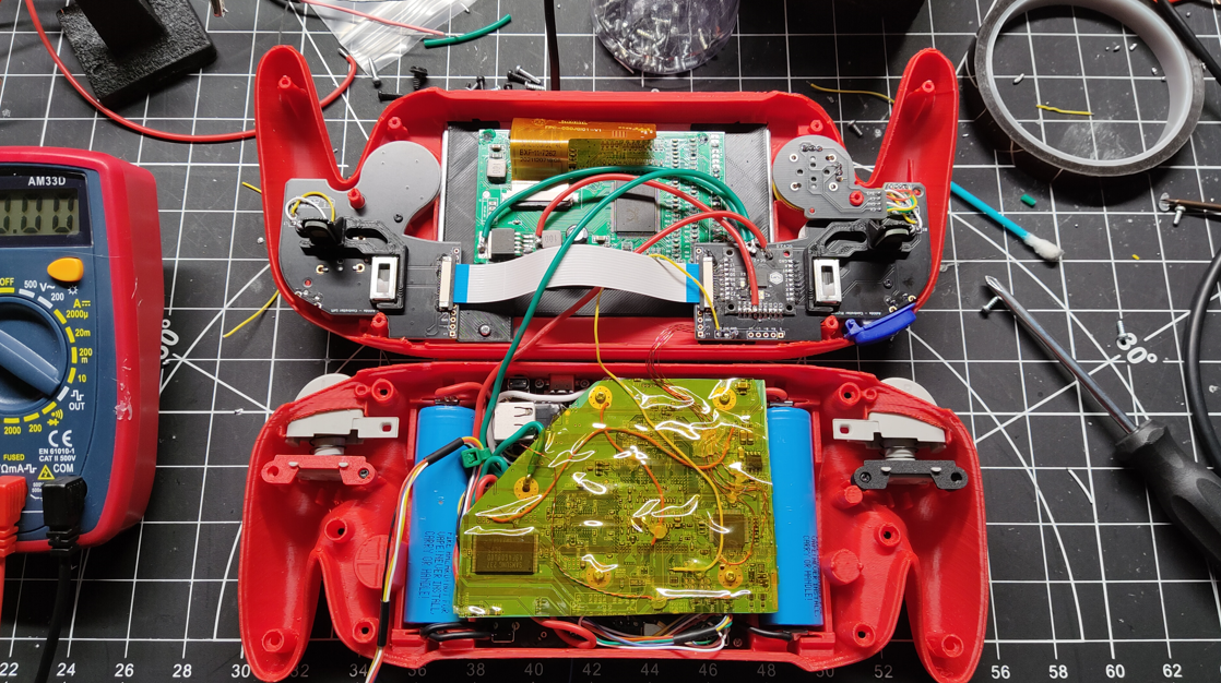

So I threw all the boards back in my old cruddy enclosure. I just wanted something I could play while I hone my post processing 3D print skills.

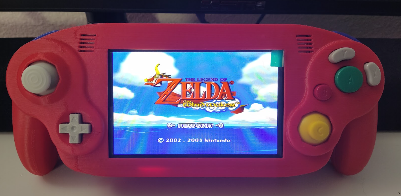

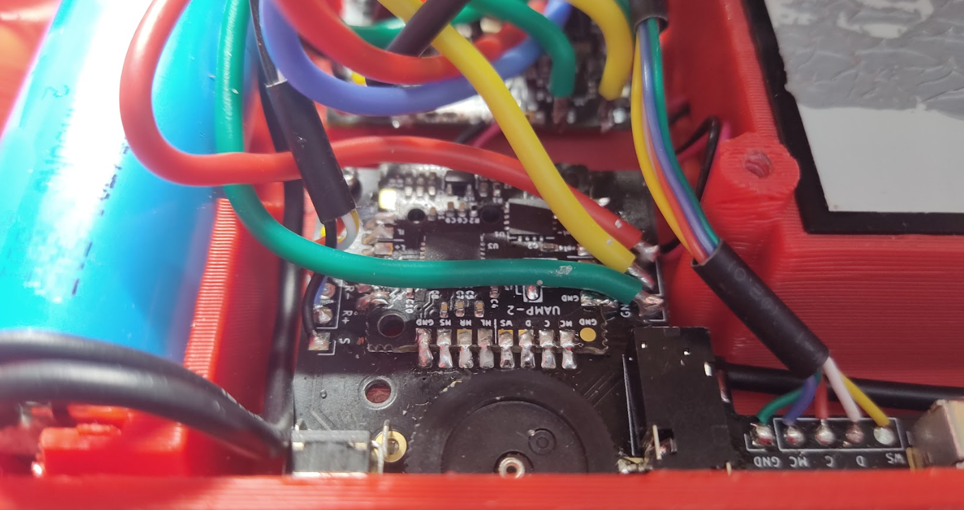

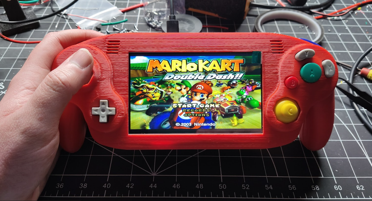

I replaced the audio board and wired it correctly with 1.8v and it worked first time, appearing in RV loader. Everything is functional and I've been playing on it for a couple days every chance I get with very little boot/freezing issues and it just works.
I'm gonna buy another set of boards (once the GC and PMS-PD come back in stock) and eventually build another really nice ashida with HDMI out, and dock-able to a TV with 4 GameCube ports, but for now, I'm just gonna play some windwaker...
Thank you Stitches, Vipe_202, and Customledmods for helping me complete my first Wii portable!
