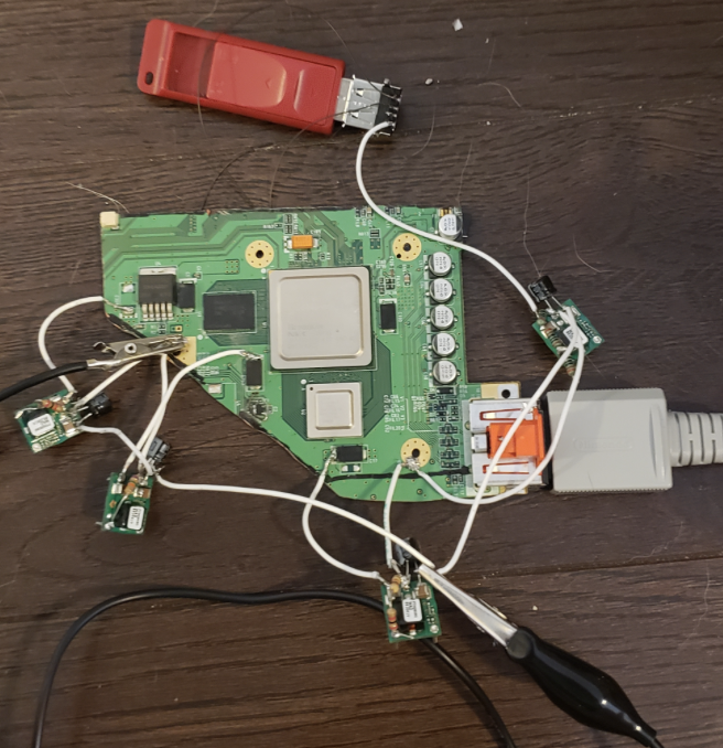

I started work on my first portable a few weeks ago and one dead board later I finally have a setup that boots to portabilize-me post-trim.
Currently using 4x pth08080wad regulators to power the system and I've left the AV socket on for now to help with testing. I do have an RVL PMS coming so I will probably end up using that when it gets here.

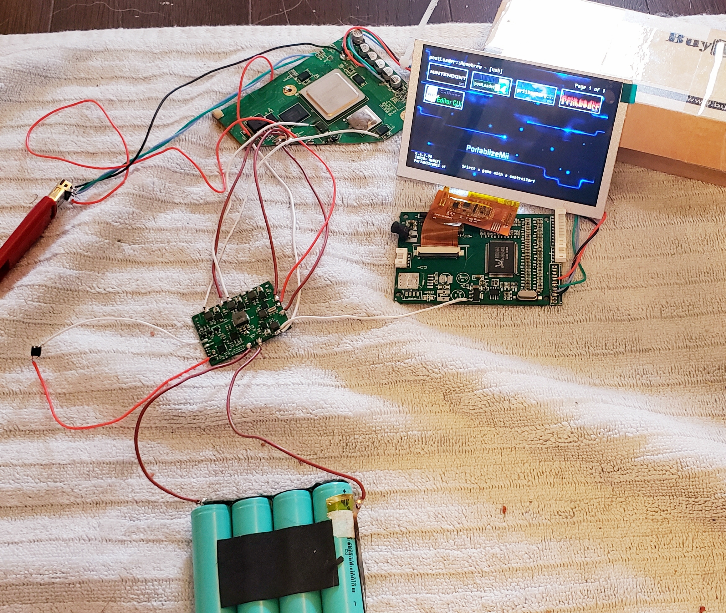

Since the last time I posted many things have happened. I killed the wii board and the regulators but thankfully in the mean time my RVL PMS got here, as well as the gorgeous 3d model I borrowed from predue, the LCD screen and driver too. I bought a new wii yesterday afternoon and between then and now I give you this:
Just waiting for some better batteries to arrive, and then I will begin the process of modding VGA output.

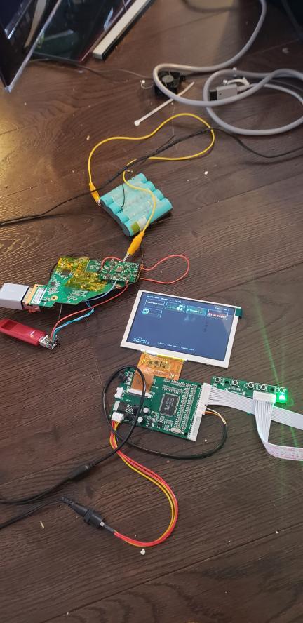

VGA output is a go, I also have the LCD driver modified to run on 3.3v supply thanks to some help from another thread by Louii.
Three main things left to do:
1)Audio
2)Controls
3) Sanding and fitting the components in the case.
I'm going to work on getting the first 2 done because I'd like to get a POC of the whole system before attempting to wire it into the case.
