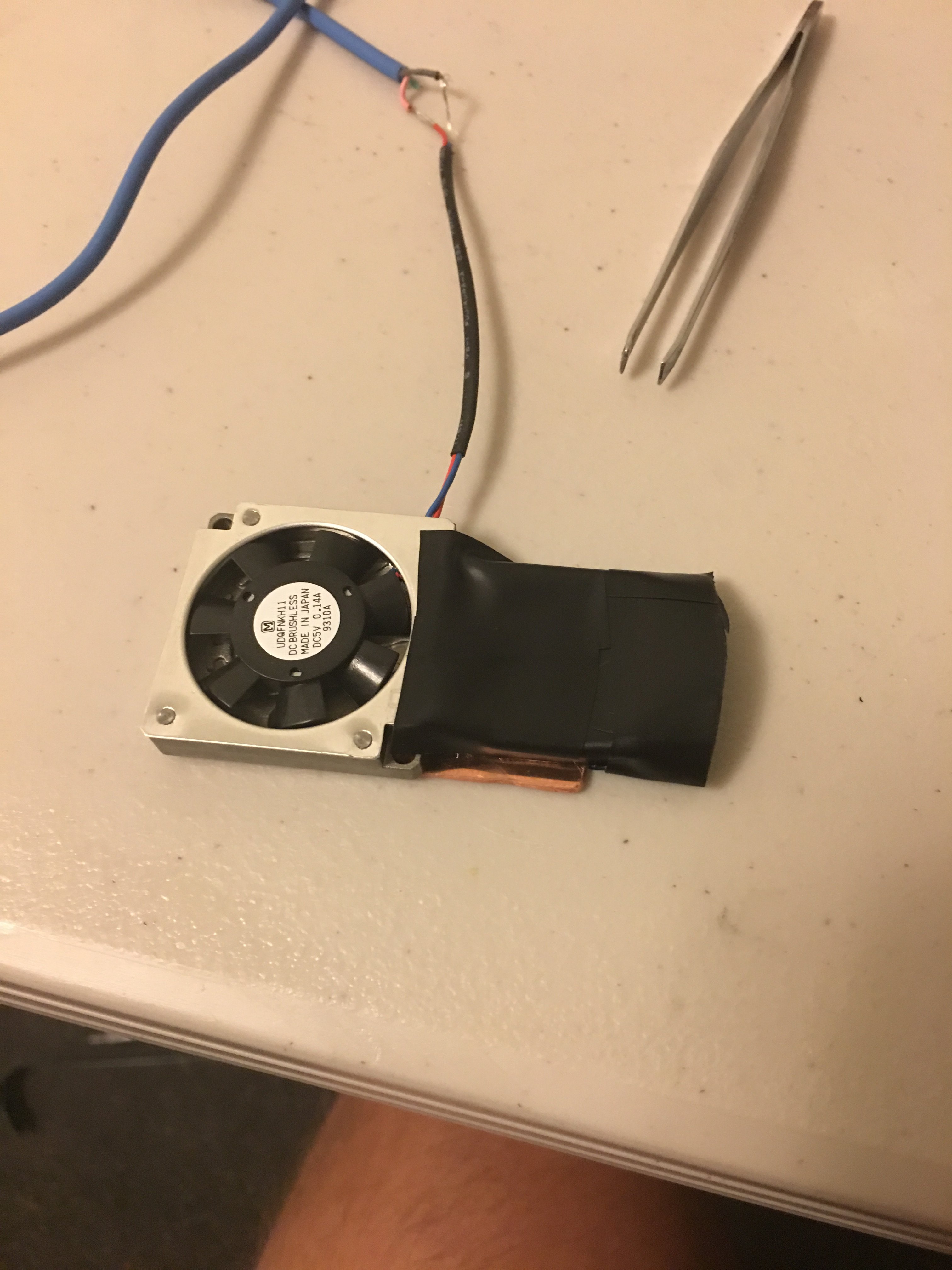

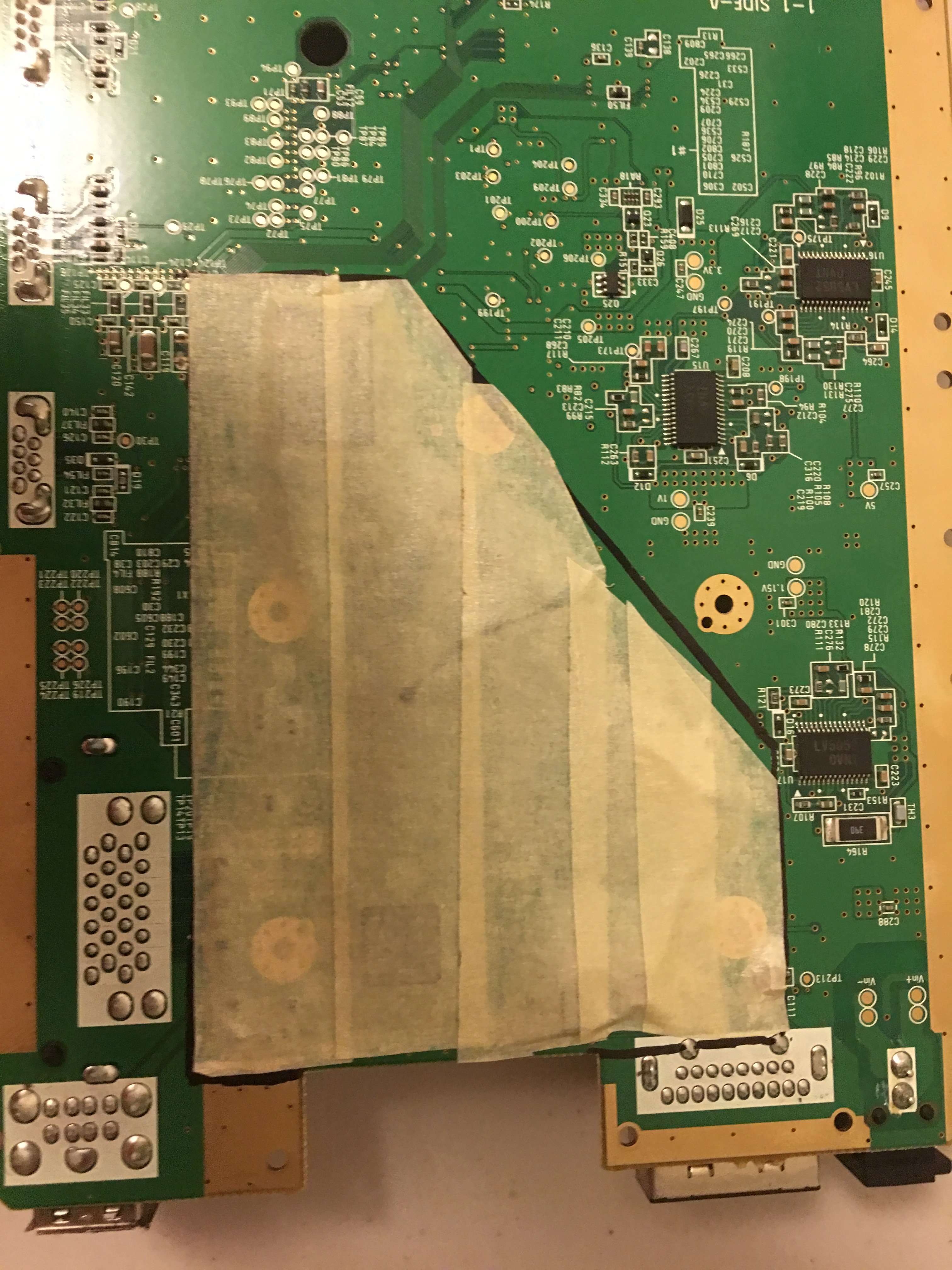

Nintendo TWiiLite(Spencer's WiiP)
I know who's getting that first place prize Awesome portable man! I wish mine could be as good as your's!
Ahhhhh thanks buddy! But once you see the internals, you will most definitely rethink that statement. Haha it's better than my first portable, but still in all honestly, its completely terrible. It looks like two raticate made a nest inside and got a little freaky up in there. Thank you though, the case did turn out really nice. :) and I'm sure yours in going to turn out great!

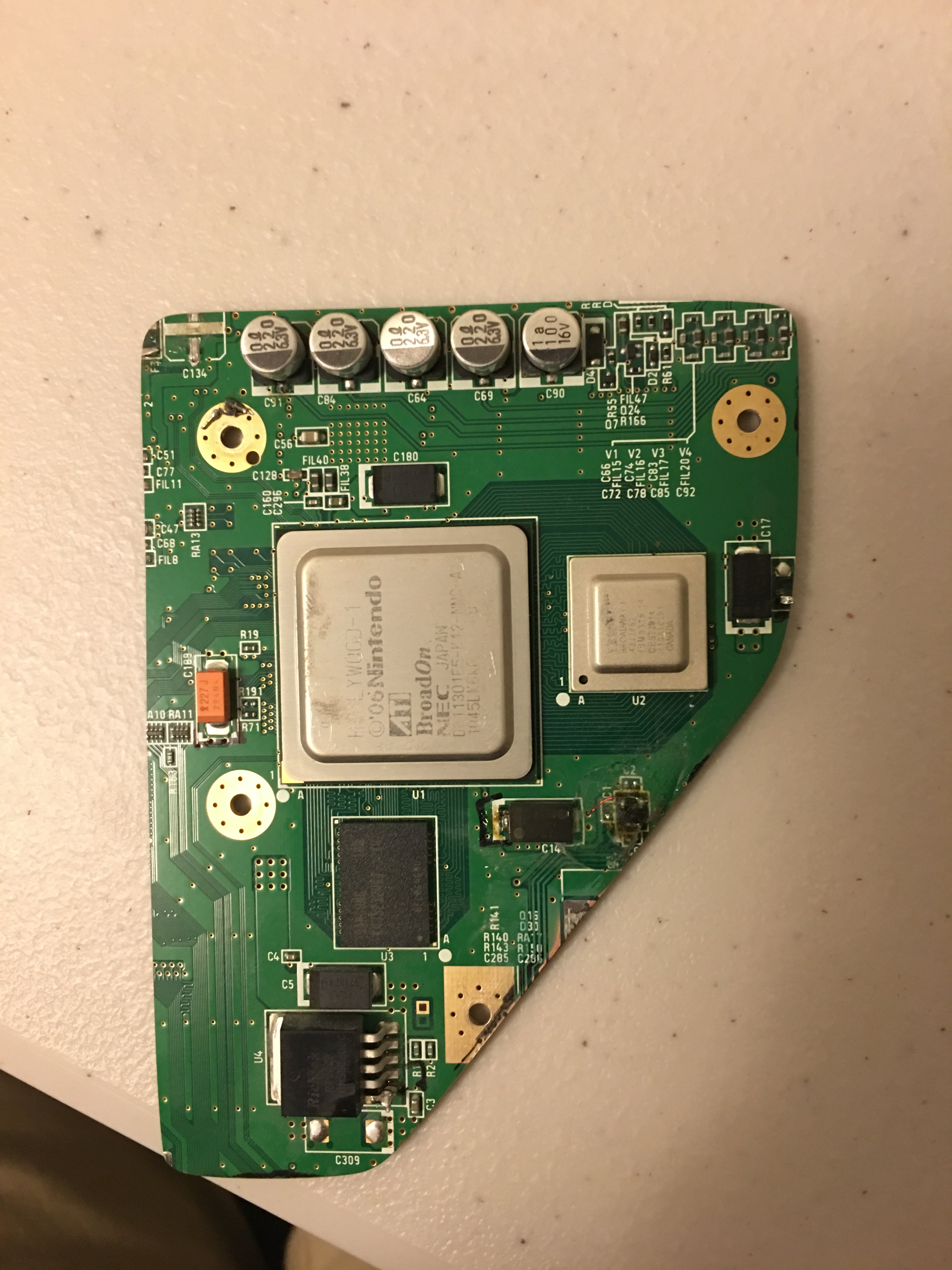

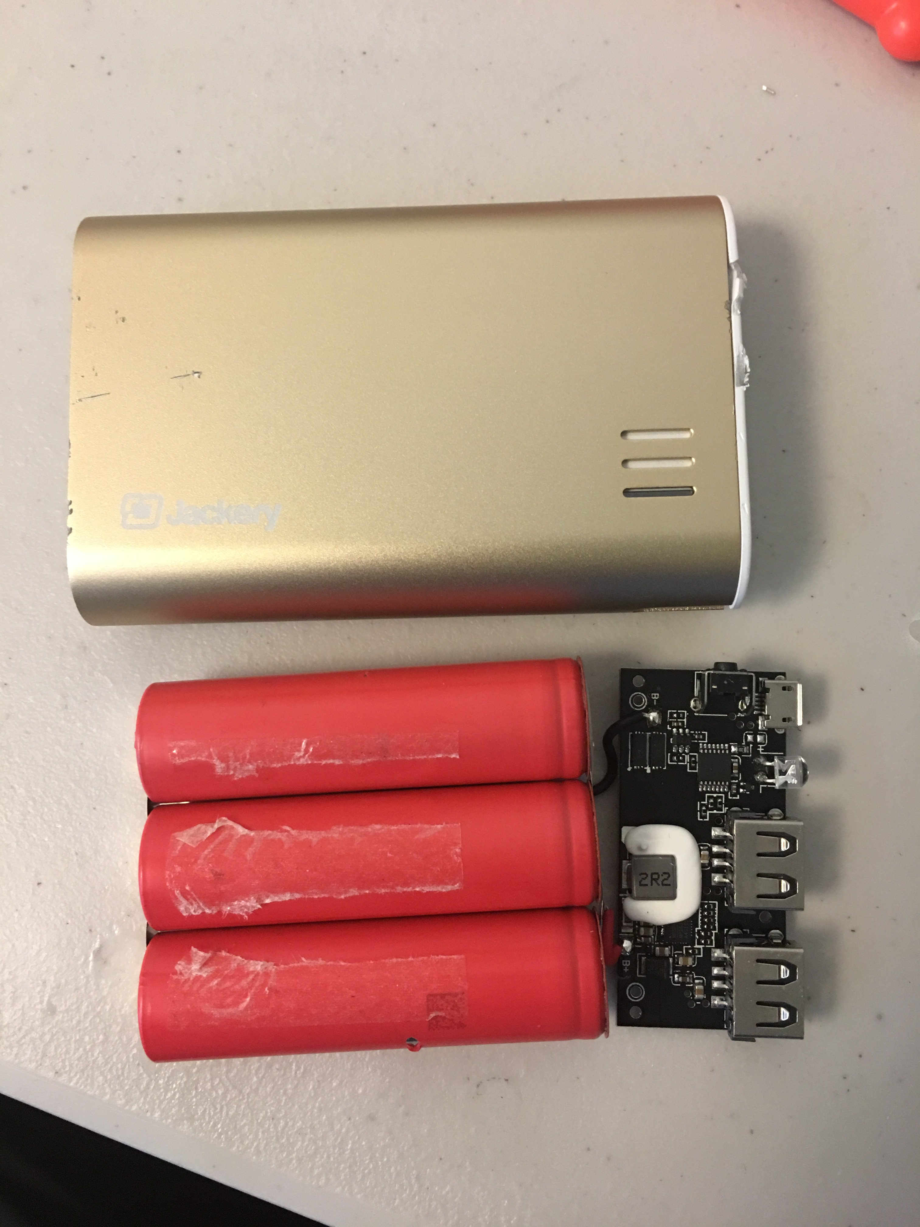

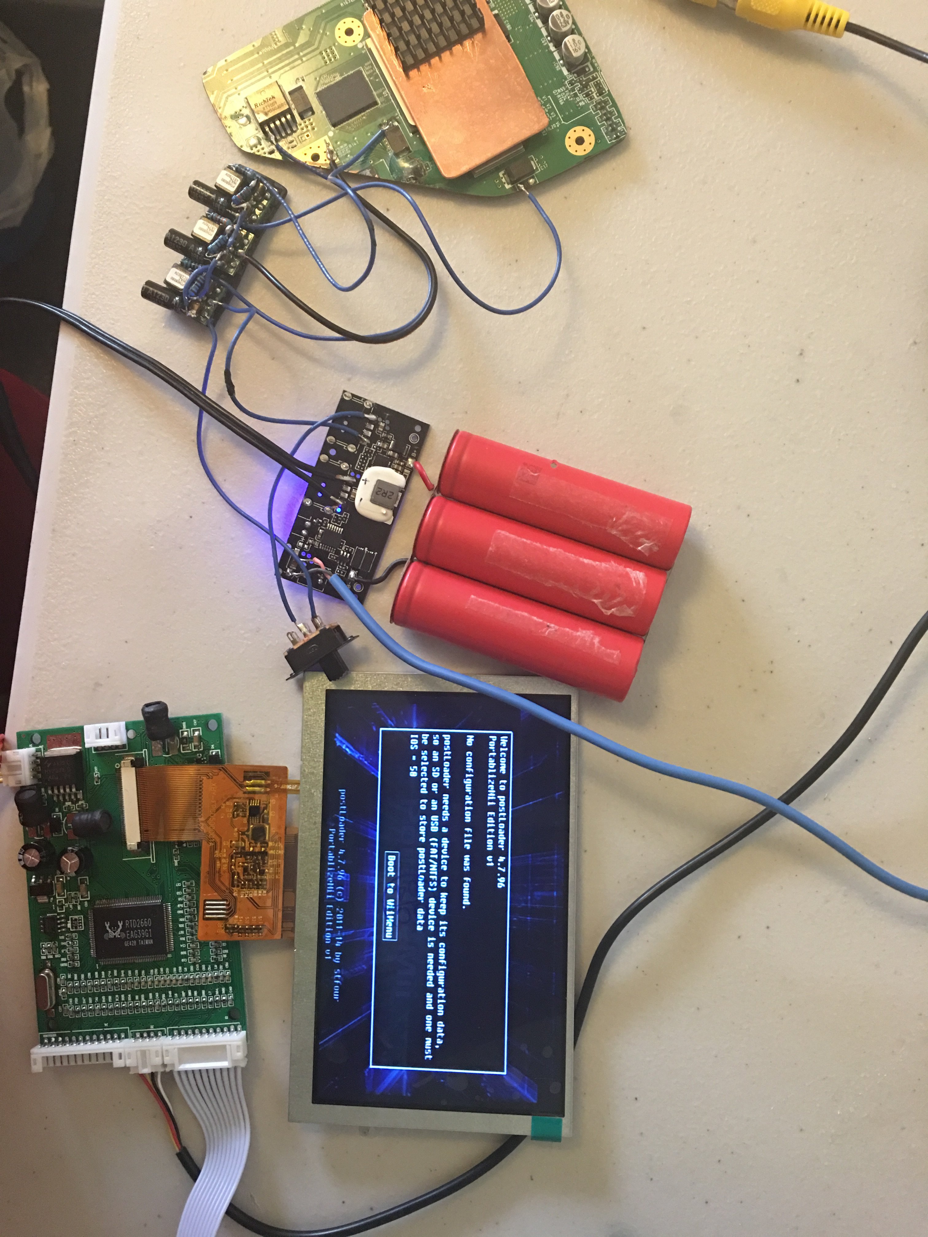

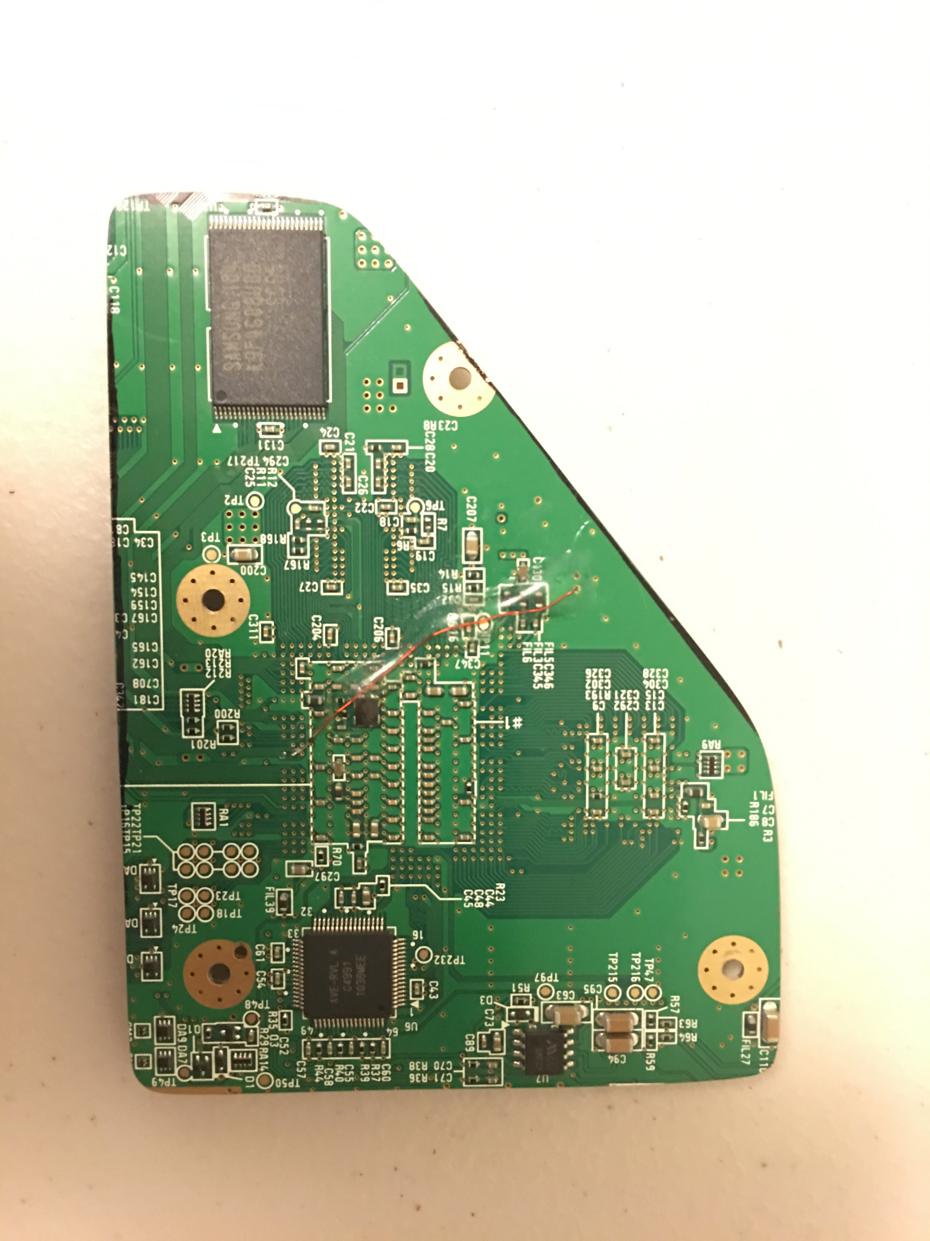

so shortly after I finished this baby up, my screen died slowly and painfully over the course of a week. So that was quite depressing. It was most probably running it on too low a voltage, although the manufacturer said 5v was ok. So I ordered a decent backup monitor from Amazon and @Aurelio helped me mod it to safely run on 5v. :) it was a pain and I half because I pretty much had to take the whole thing apart to replace the screen... but it's all back together now and I love it so much!
Specs:

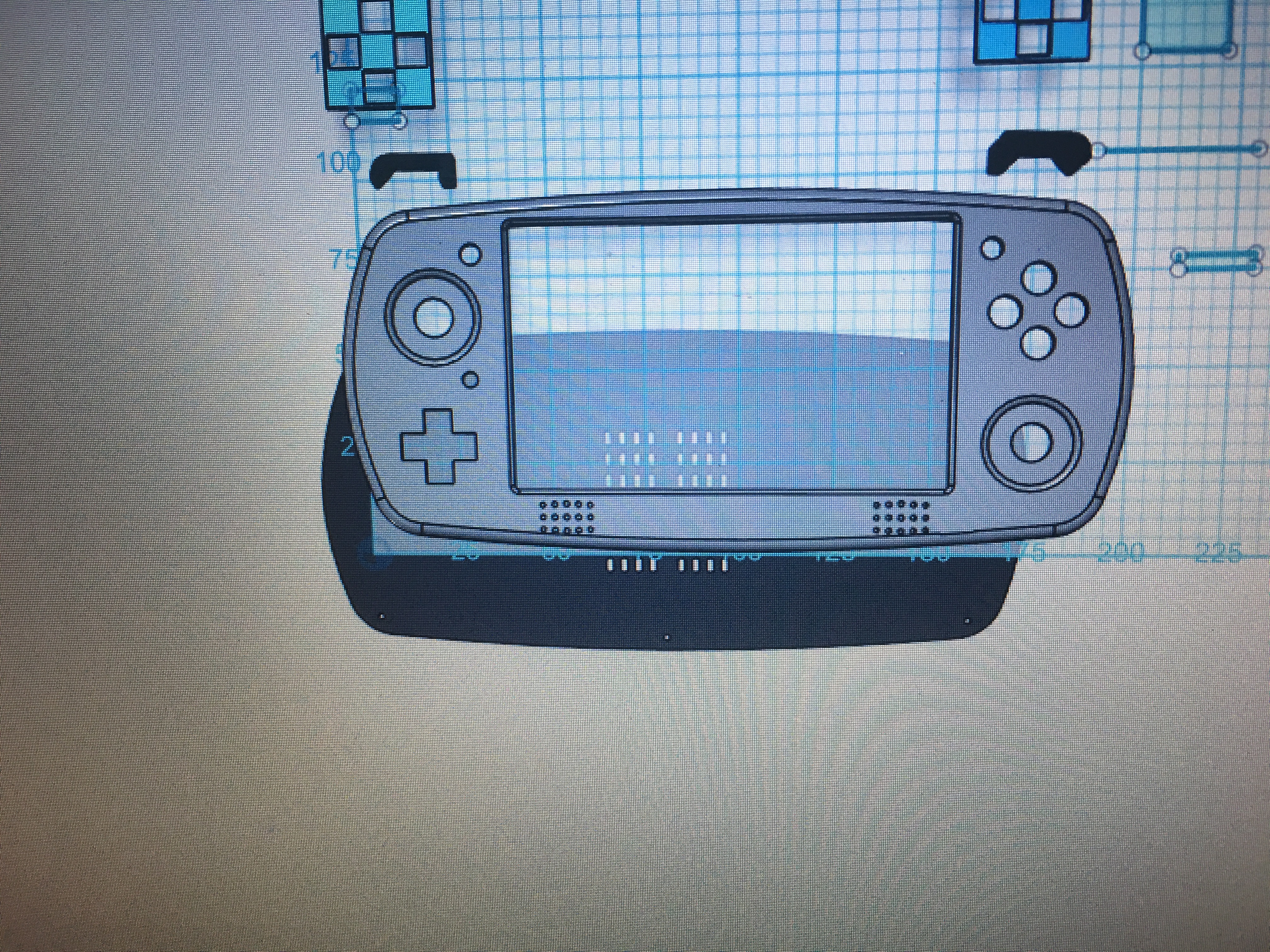

-3d printed case!! huge thanks to @Chaos !!!
-5"composite screen
-10,050 mah portable battery pack(3 cells, roughly 3hrs battery life)
-dimensions at largest points: 200x100x32mm
-component and composite out

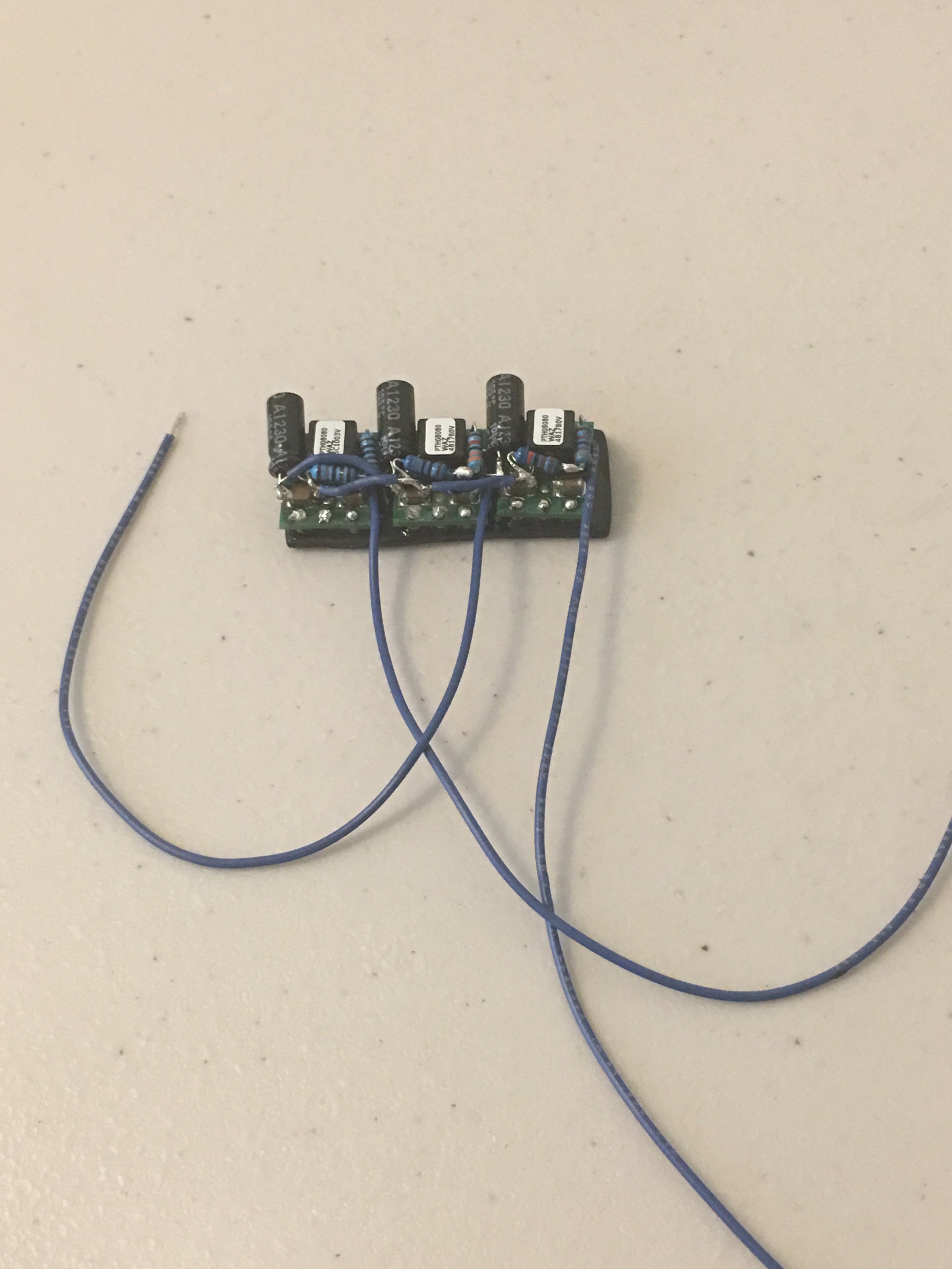

-audio amp with headphone jack by JacksonS
-ds lite buttons, 3d printed shoulder buttons
-built in sensor bar

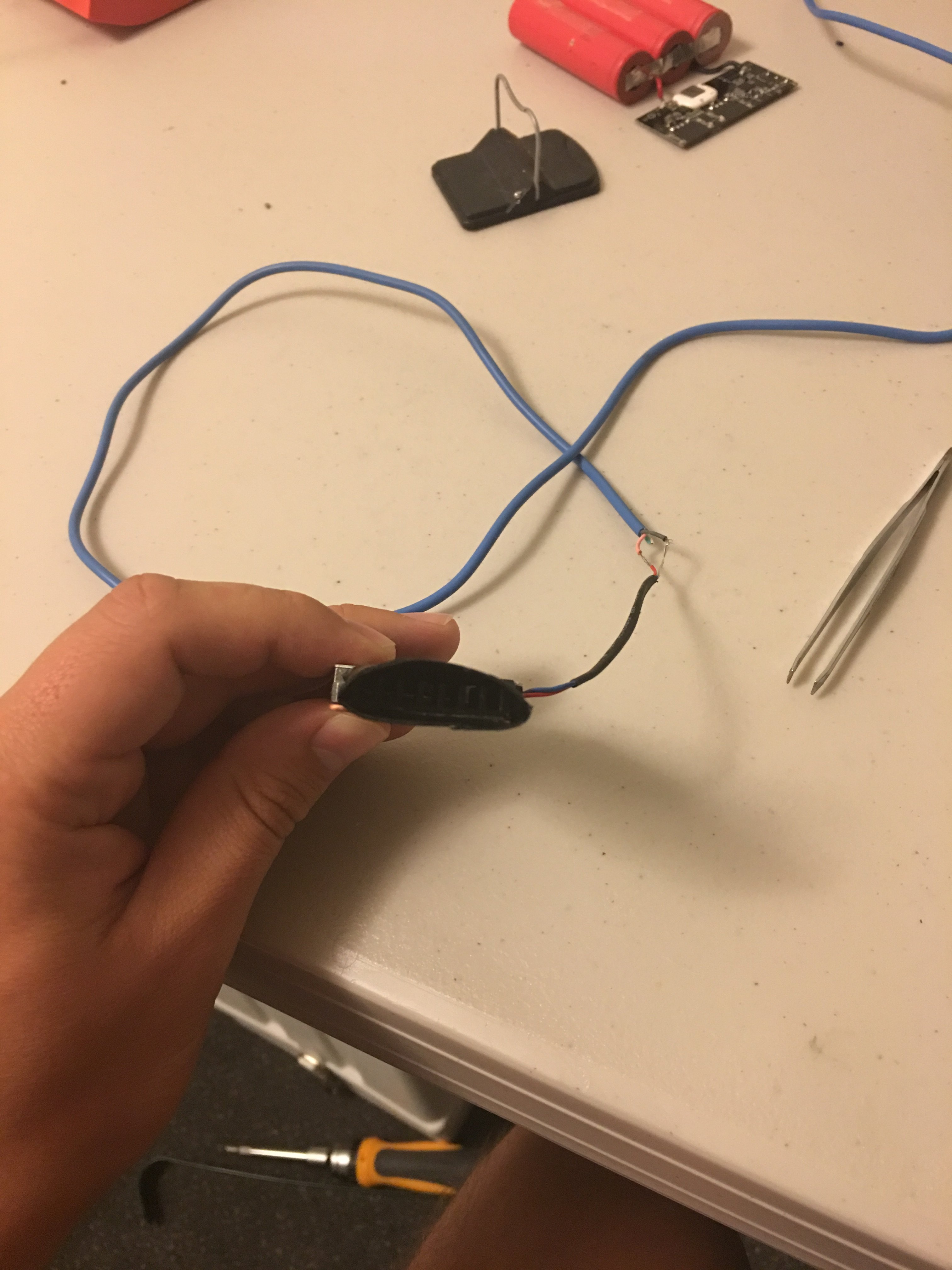

-Camera accessory port
-breakout box port. 4 players. :)

The shoulder buttons are dual tact modded and rotate on a pivot. I really love the way they turned out. Then I have a small switch for the internal controls and one for component out. Then the main power switch, fan exhaust, breakout box port, stock wii video port, and micro usb.

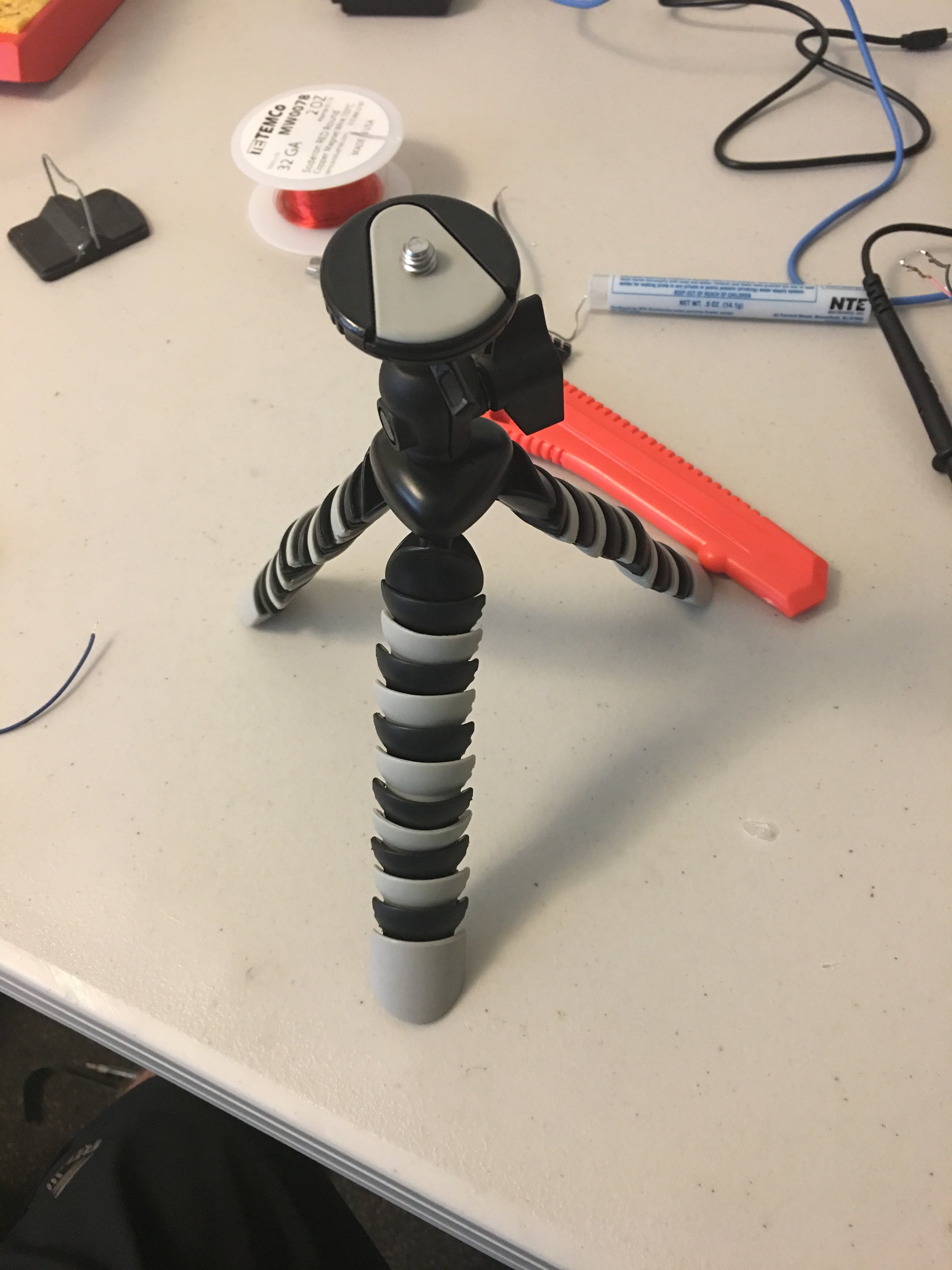

Here's some pics or stands I have that utilize the camera accessory port

And here we have a pile of rubbish. Haha I really wish I would have taken pictures before my screen problem... haha because it actually looked quite a bit better. I had to put it all back together last night because I won't have any other time this week. So it was rushed and looks terrible! But I'm glad it's done so whatever! I may go in and make it tidy later.

I finished painting the front panel a few days ago and let it sit until yesterday. :) I really like the way it turned out. It took tons of thin layers of fast drying primer and sanding to get it this smooth. Haha but I think it was worth it!
