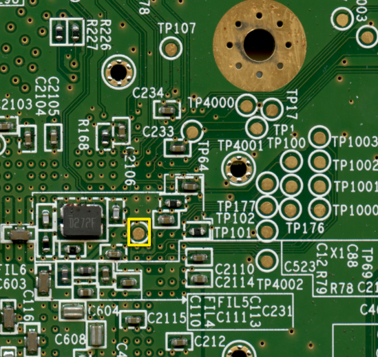

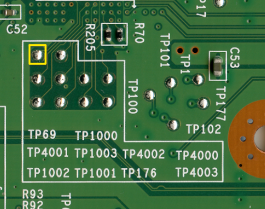

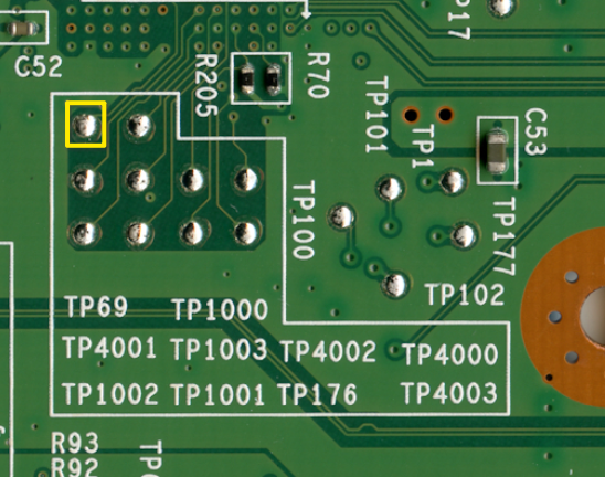

Connect the data pin of the GCC to TP69 on the Wii U board (its under the SoC, near the RTC EXI):
WUP-01/30/40:
WUP-50:

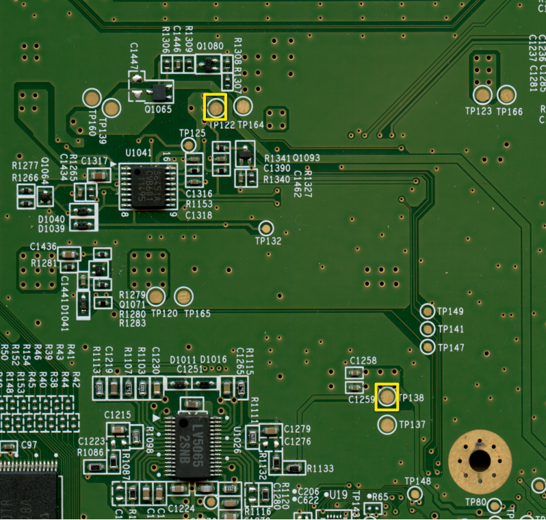

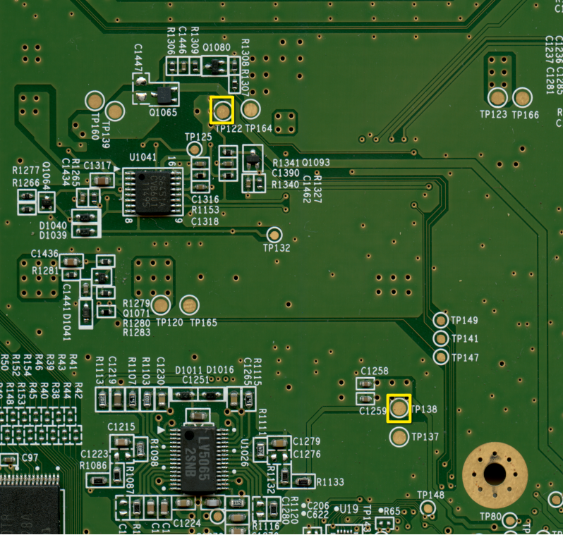

Give it some power (use TP122 or TP138, it doesn't matter which, both are 3v3)
and then ground it. Ground is ground, it doesn't matter where you do it.

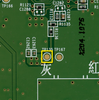

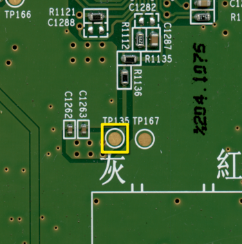

OPTIONALLY, connect 5v at TP135 for the rumble:

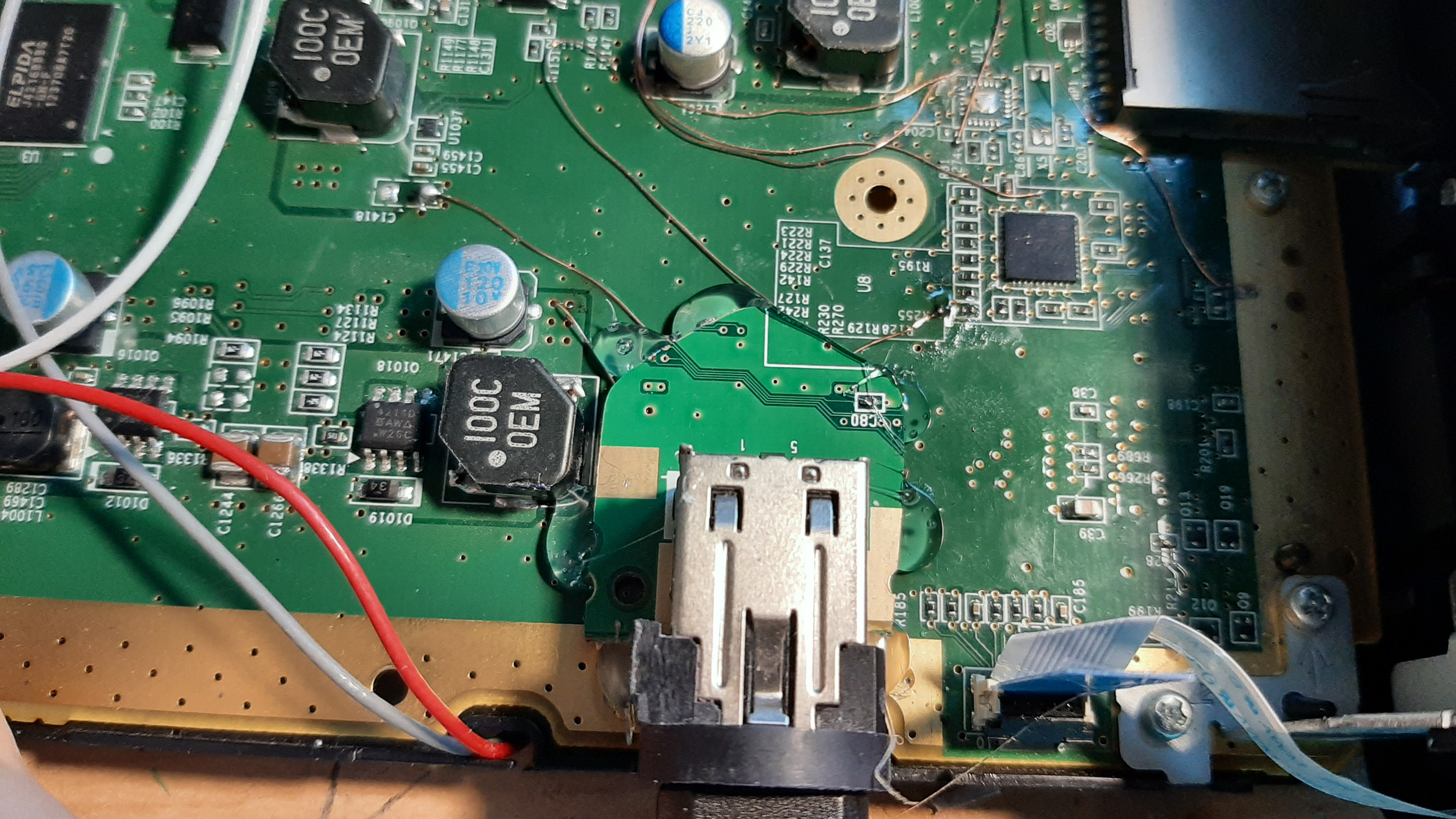

This is what it should look like after
Lastly, enjoy! :)

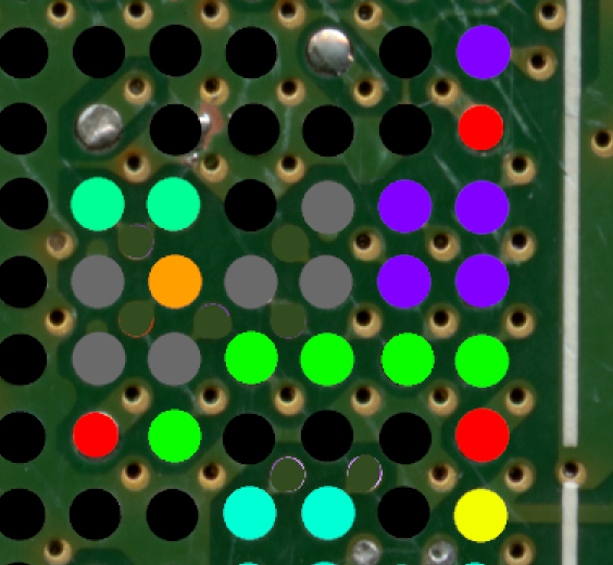

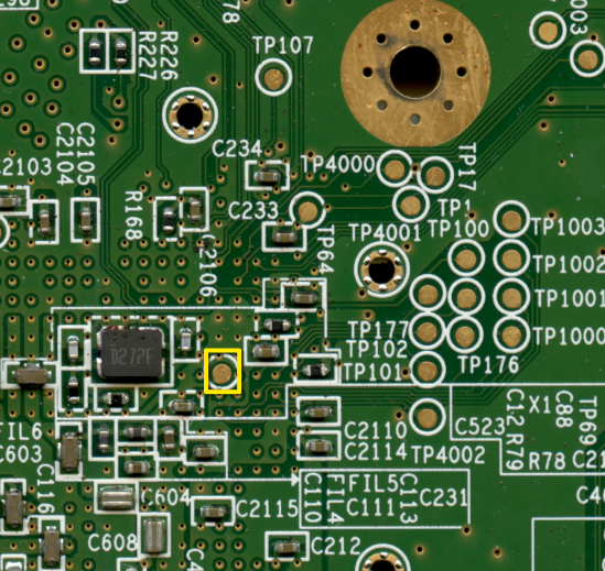

i started to RE the Wii U SoC to try and find the other players, but i come back with some bad news..
The Orange pad is P1/TP69. One would assume that the other players would be near it, so thats where i started.
All of the pads that are colored are for something (RTC/nRST/DRAM/GND/3v/1.5v), so it will absolutely not be one of those.
The grey colored pads are those that lead nowhere or i tried and didn't work.
I doubt they exist, even more so than before. It was entirely unused on retail consoles, and was only for the classic controller on devkits, made no sense for big N to put the other players.
My PC also crashed while I was doing this, and i didn't save, so i lost all progress. The only remnants are screenshots i sent to discord homies..
WUP-01/30/40:
WUP-50:
Any insight into into what each color is? I wonder if the data lines are simply being pulled to 3.3v. Orrrr possibly they lack the 3.3v pullups needed to function.
this is from memory, but i think its mostly correct:
purple - RTC EXI
green - some TP400X pins. i doubt they are for the other players.
blue - DRAM
teal(?) - nRST
red - 3v3
yellow - 1.5v
black - GND
grey - pins i tried but didn't work
